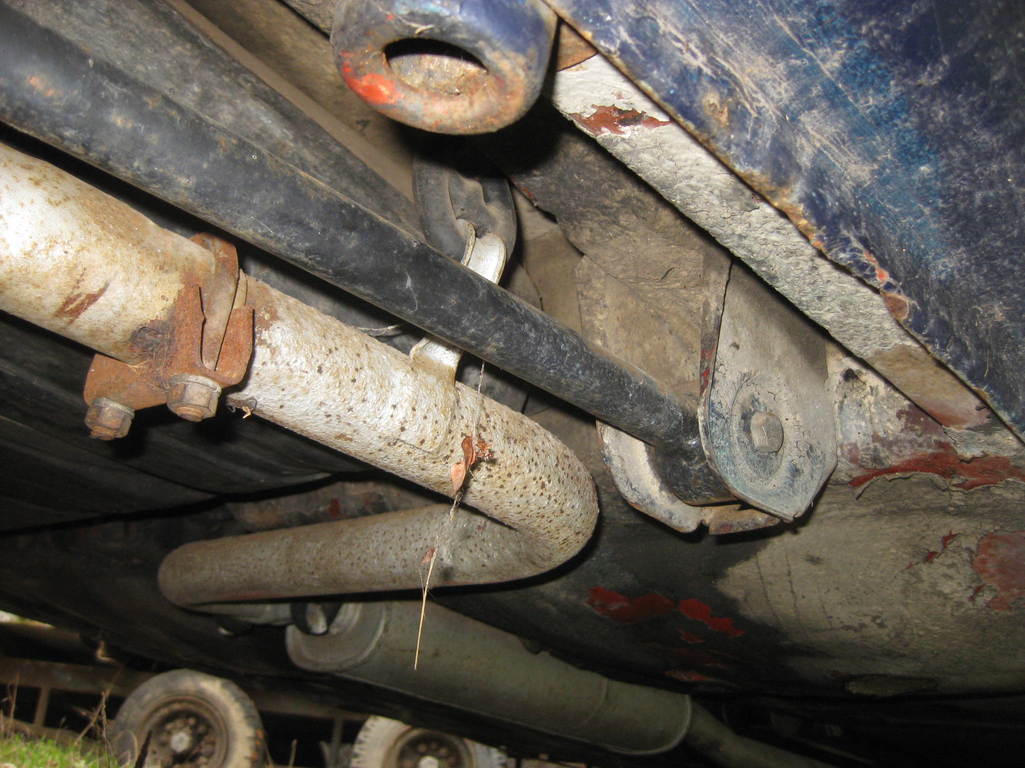

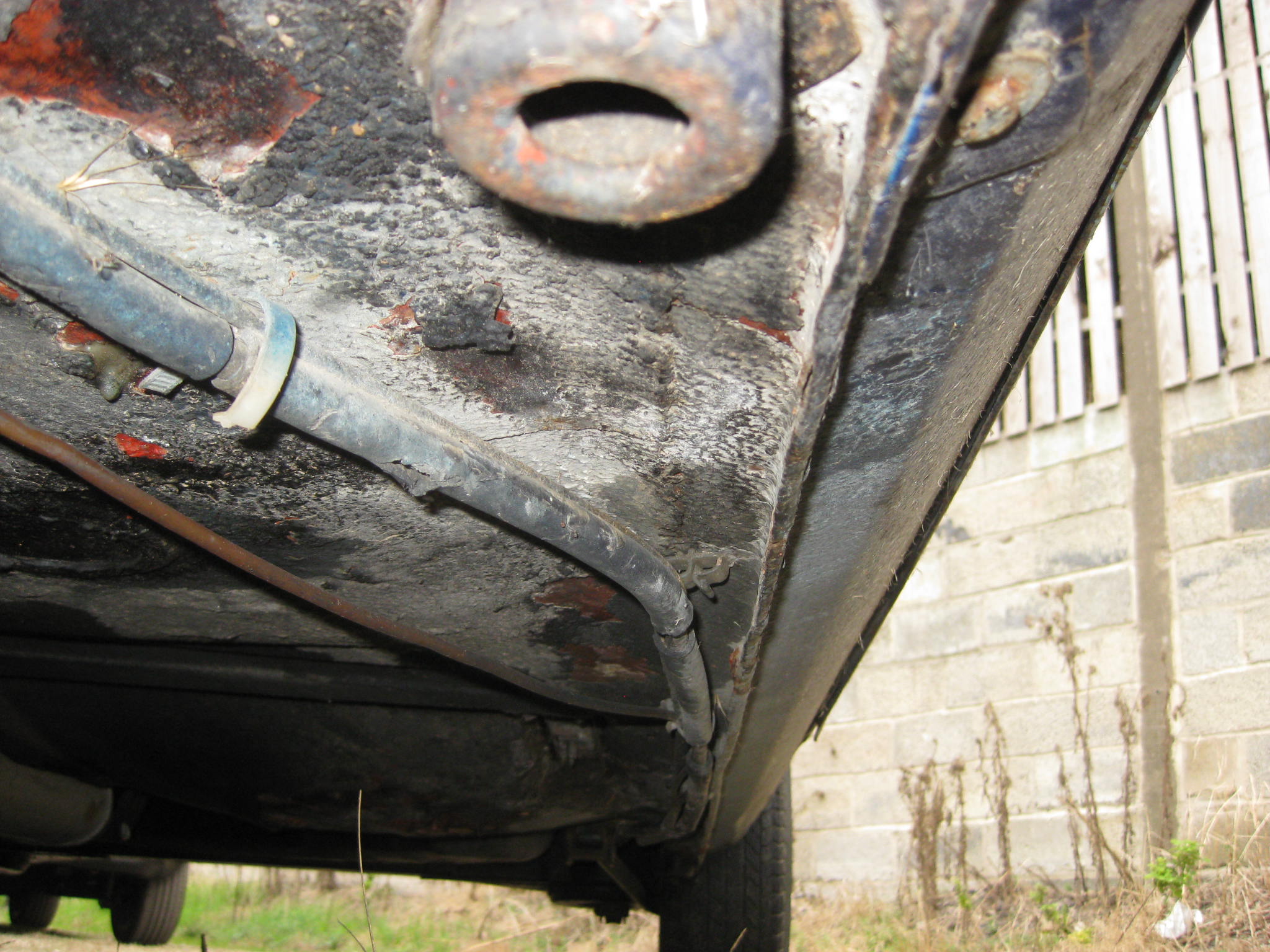

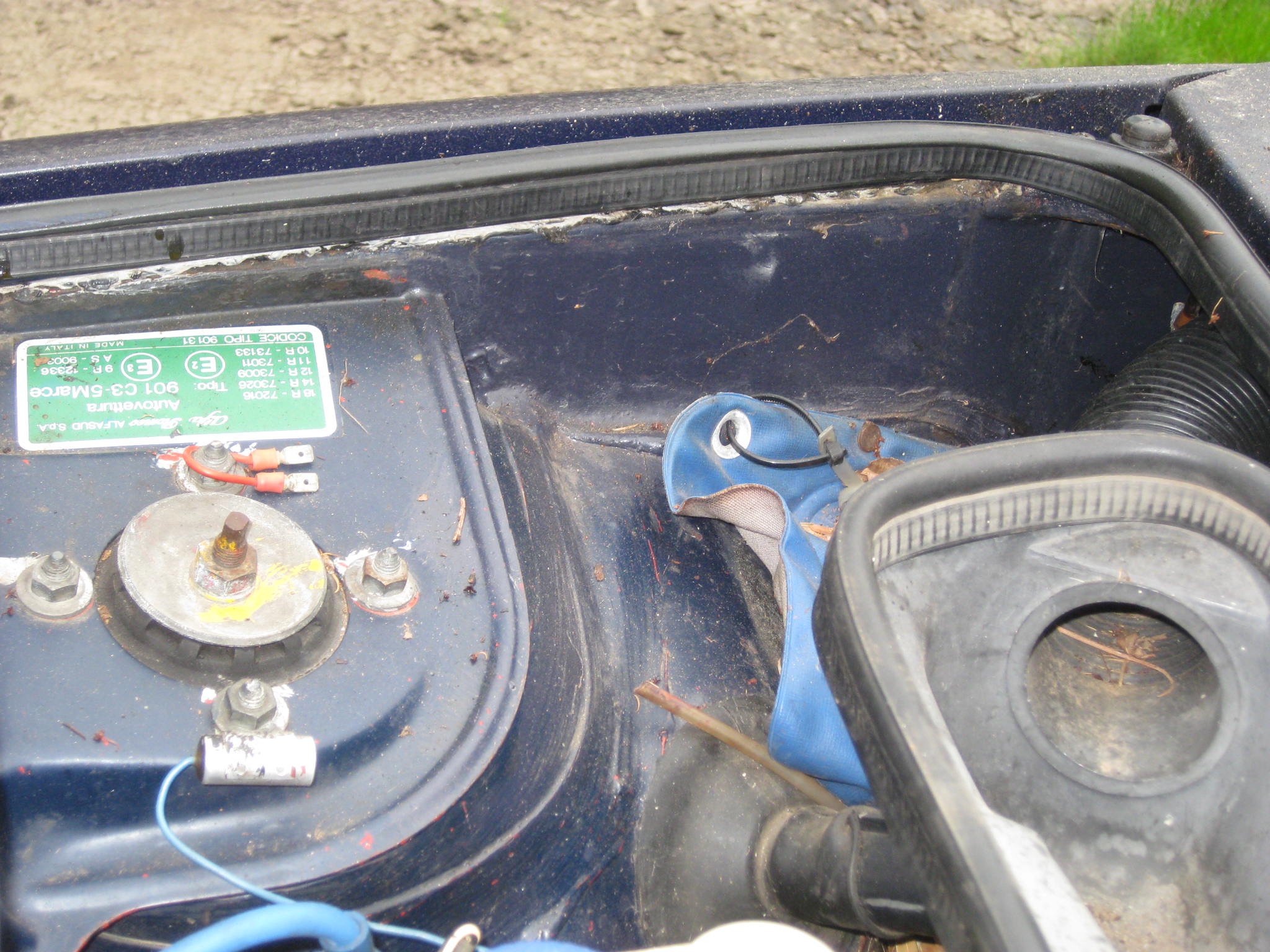

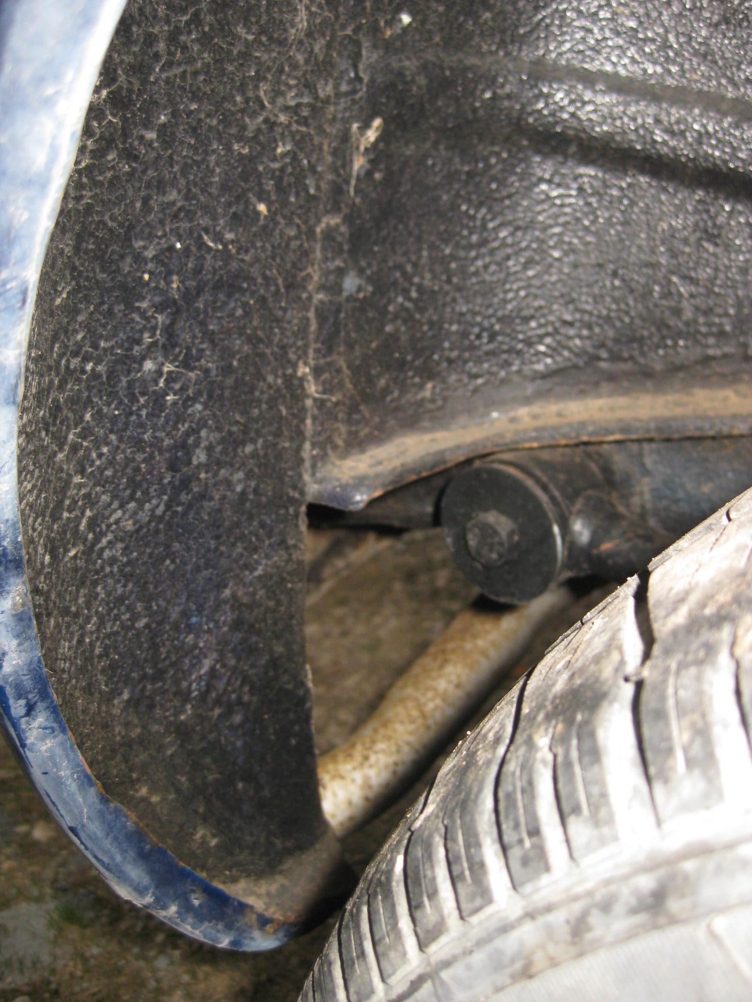

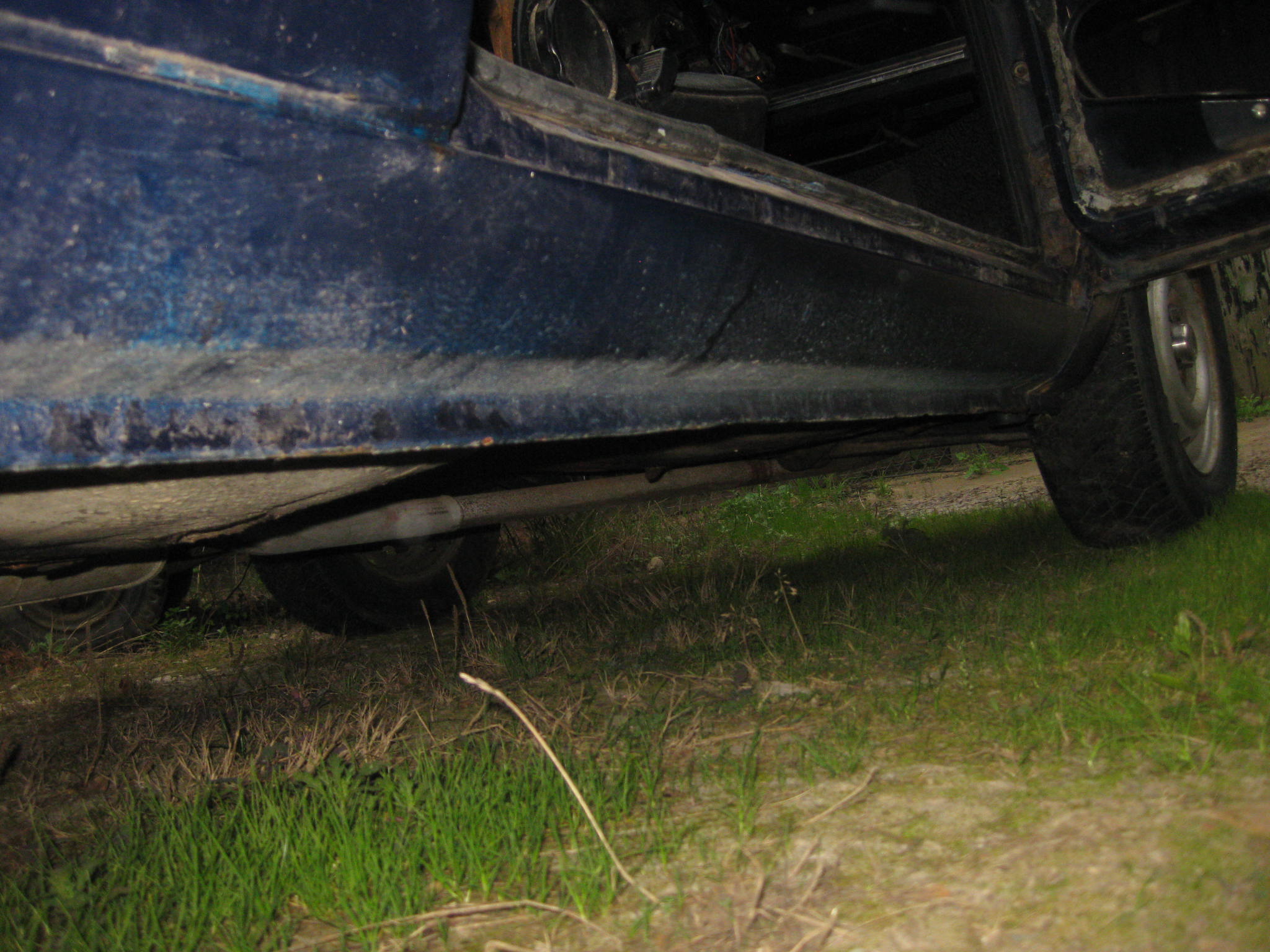

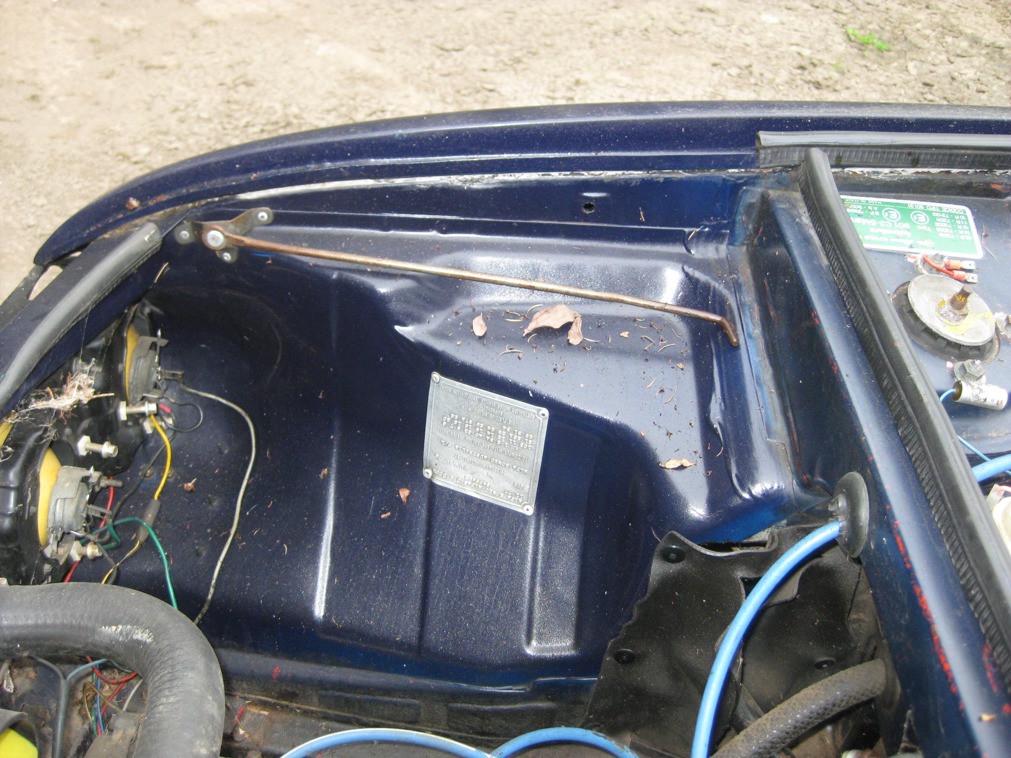

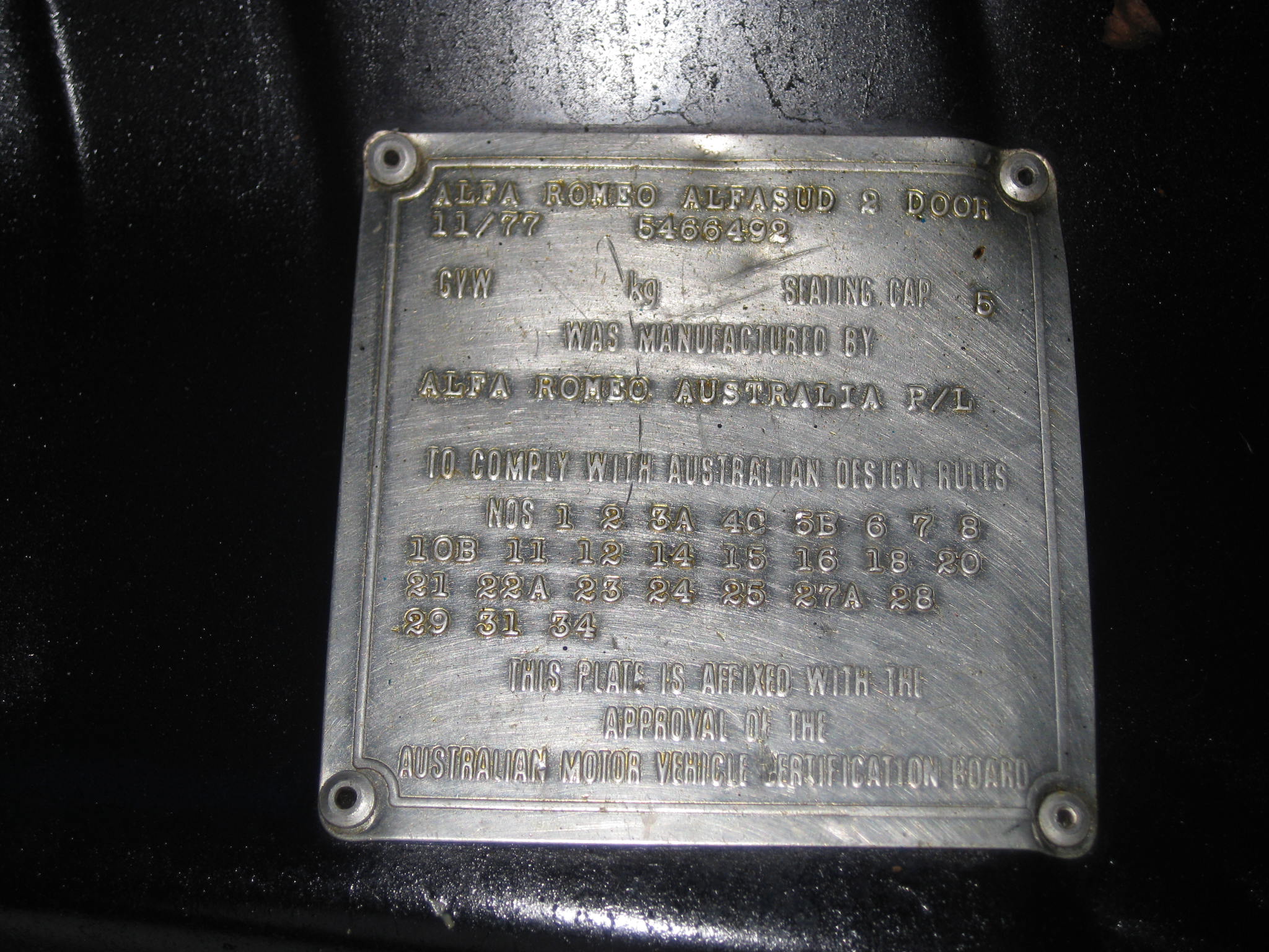

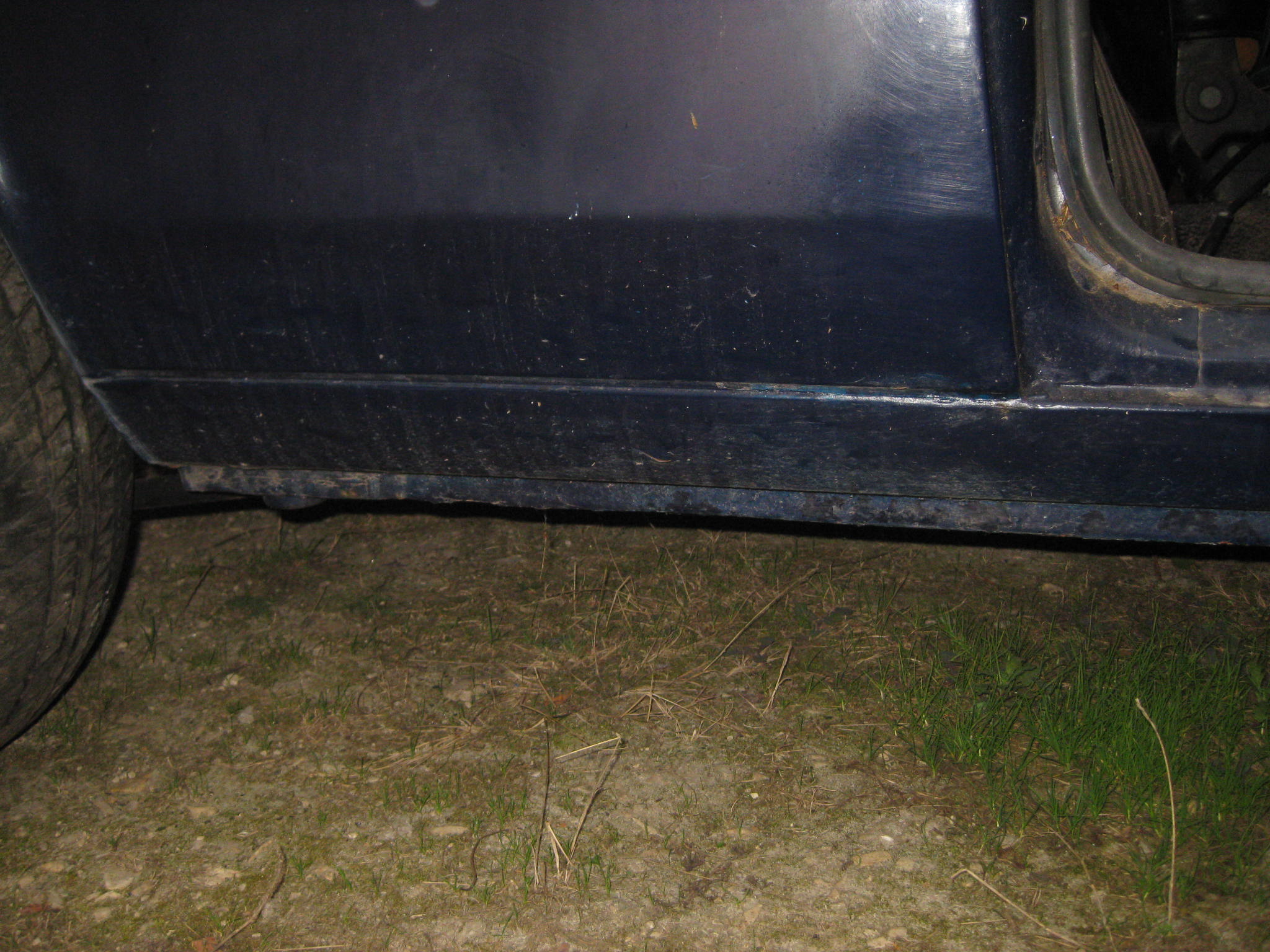

and some more, its still on its original sills and rear arches, there is an interesting ID plate on the O/S front wing which reads 'built in Australia'?!?!
This one:

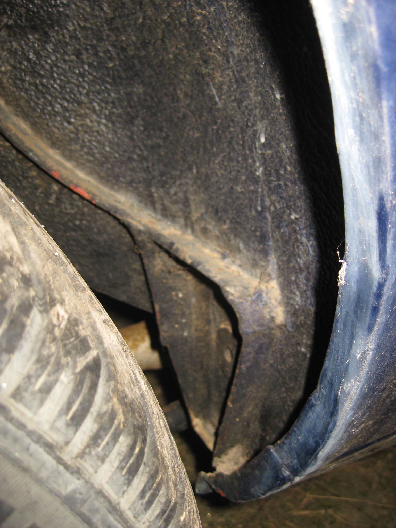

They overdid it with the foam, at least we know it has it......

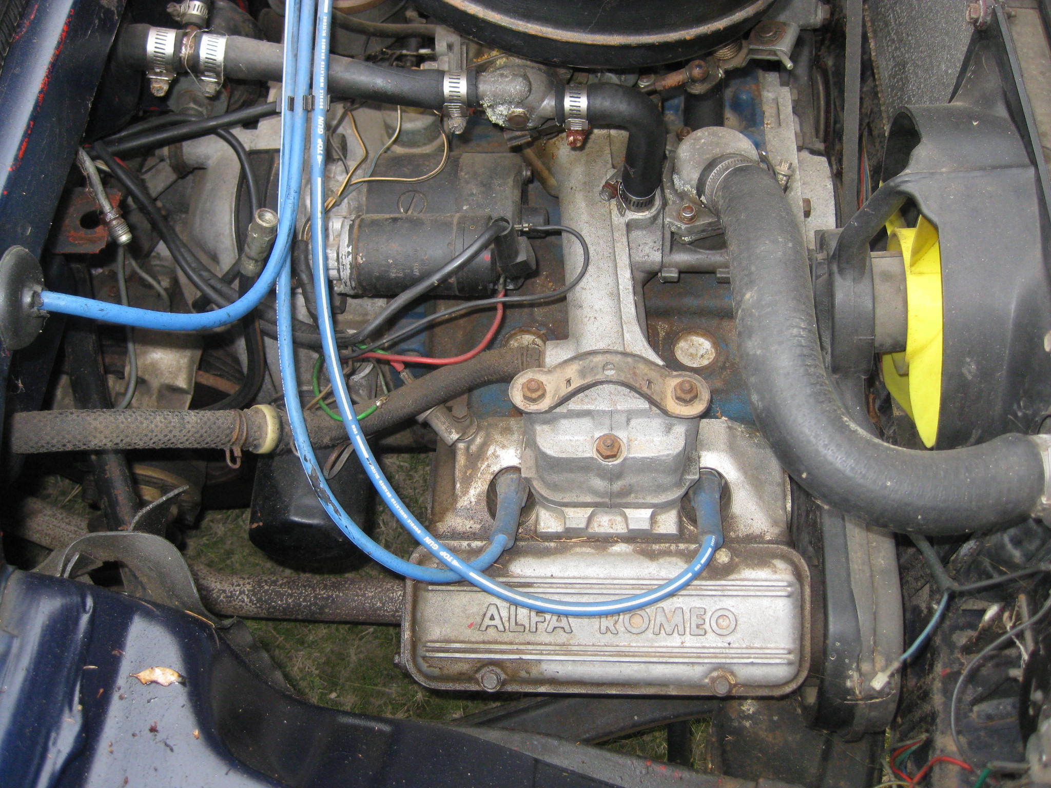

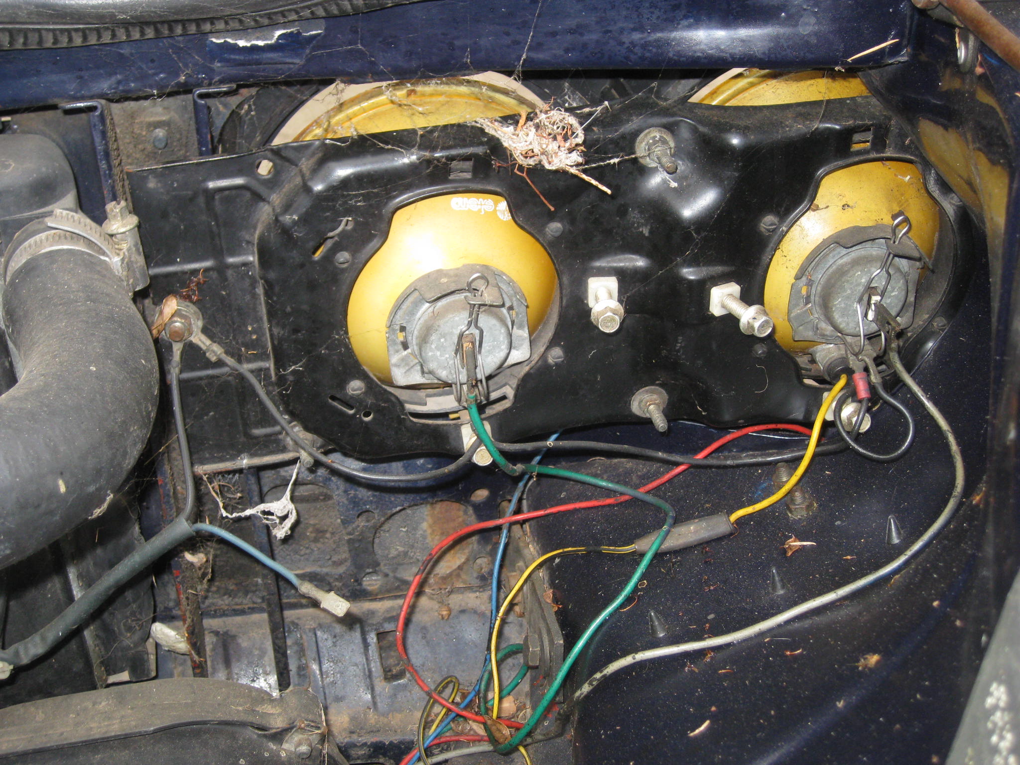

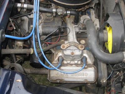

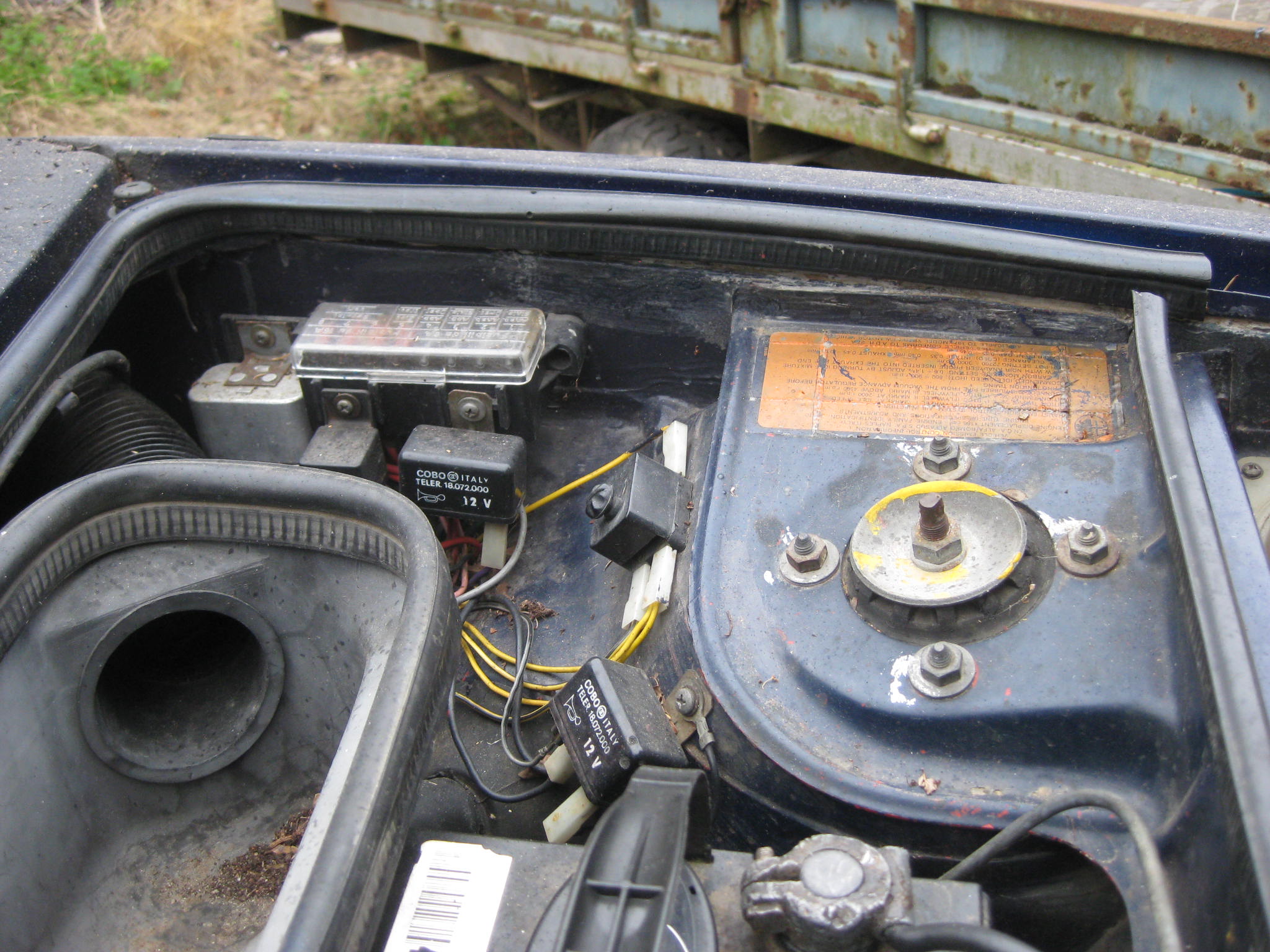

Car is really good under the bonnet....

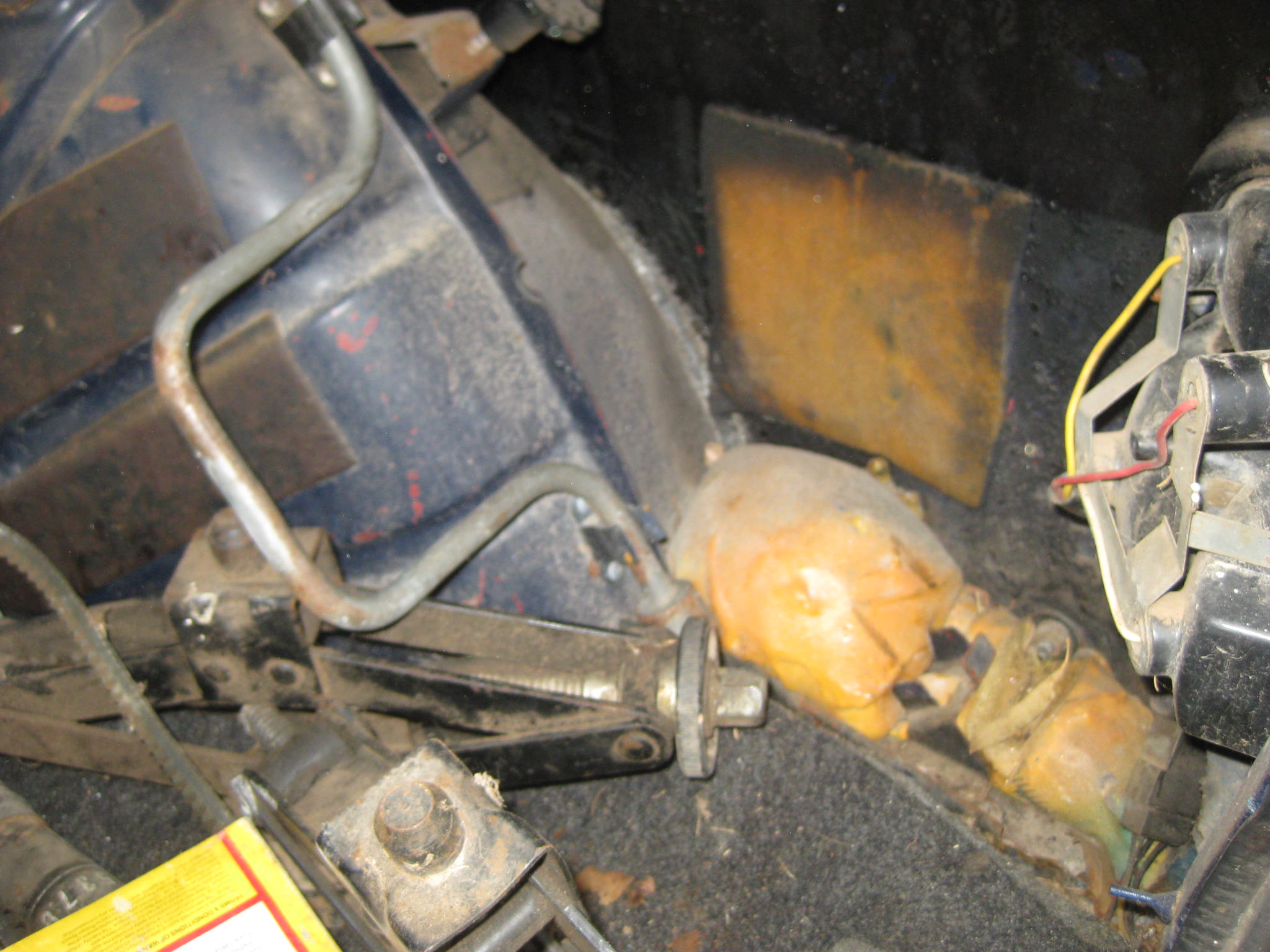

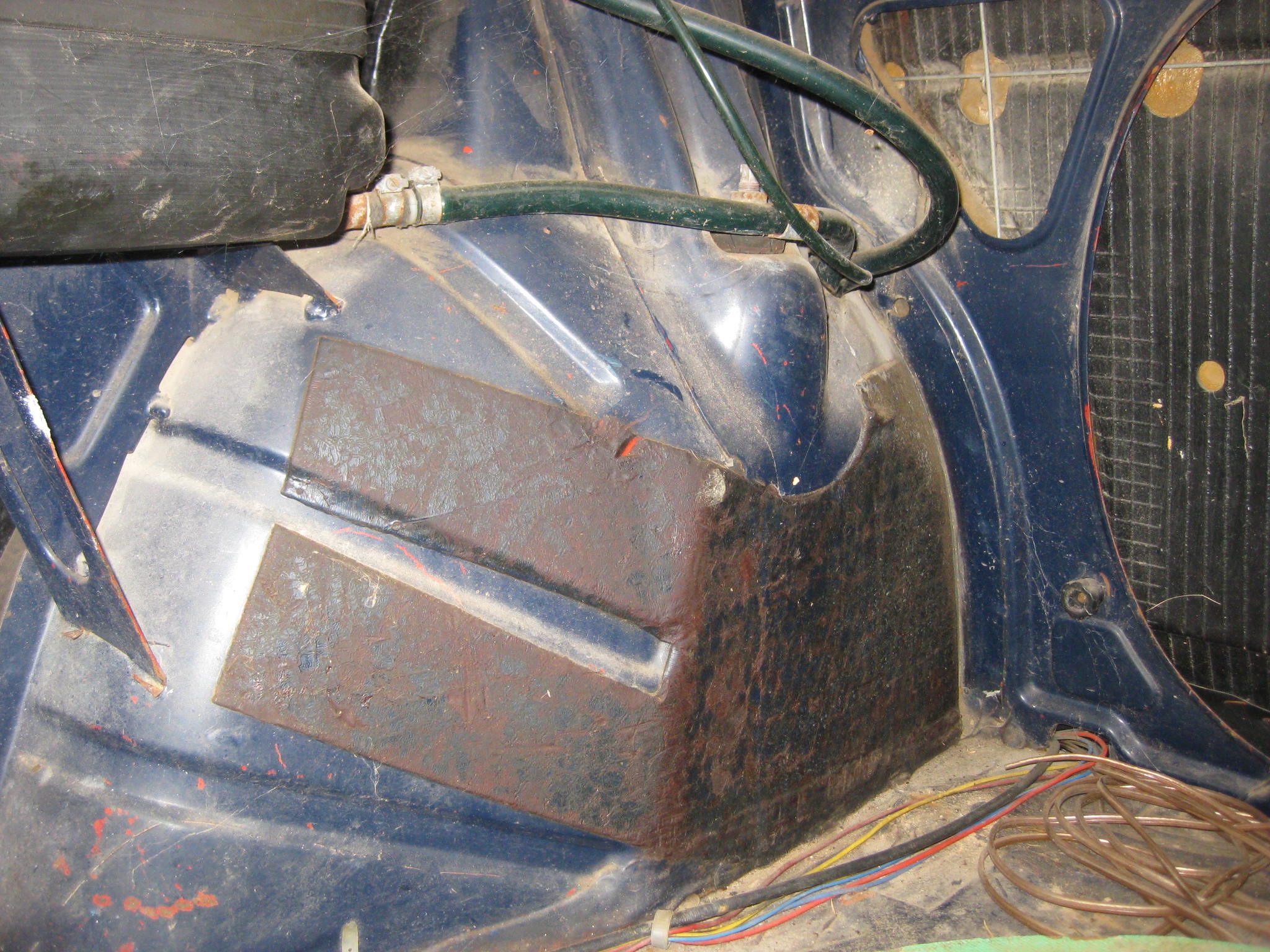

what's the tank in the boot for in the 1st pic? has some green pipes going to it...
already studied the under bonnet pics which have helped me no end for location of relays etc

Not sure exactly where those pipes are going tbh, I will be going back to the barn in a week or so to cover it over once I know its all 100% dried after I washed all the salt spray off it, so I will have a look & take some more pictures and post them up so you have some more for reference

Those green pipes look like some sort of fuel tank breather arrangement to me.

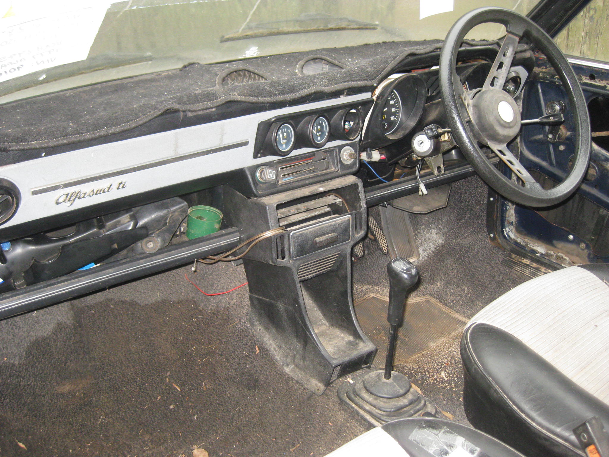

Gear stick knob is from a series three sud.
The way the heater hose attaches to the manifold looks different to my series 1 ti with twin choke carb, is this car on a single choke carb?
It seems to have later cam covers, the earlier cars had black pressed tin ones, no Alfa logo.
Looks like it has a chunky later wheel, but it has an early centre boss.

did wonder if it might be some kind of fuel breather/evaporation device to cope with the heat out there. the green pipes do look the same as the ones used around the tank. odd that it's inside the car though...

I had a 5M sud that had a tank like that in the boot - I think it connected to the oil filler neck under the bonnet and my car also had some sort of air pump thing that was driven from another v belt on the front pulley and it pumped air into the exhaust front pipe.I guess it was all some sort of emission control stuff - not sure but I was told that my car had come from South Africa
So long ago now I cant really remember how it all worked now but I soon took it all off and put a twin choke single weber carb/inlet manifold + exhaust from a UK car on it.

Yes you could be right there mate, if it is then it will all be got rid of, I will have non of that rubbish on any of my carsGary Orchard wrote:The shell looks very sound from the photos

The silver tag in the engine bay is a compliance plate not a build plate.
All Aussie cars have them, it's just to confirm that they have passed all the Aussie regulations.
The plack thing in the boot is a carbon canister, it is to absorb the fuel vapours when the vapour in the tank expands with the Aussie heat, there is a pipe that will run up to the inlet manifold to be recycled into the intake.
Pollution gear to a point, but if it's not there in a hot environment you can cop a fuel cap in the face when you open the tank due to the pressure. Can also work the other way and the vacuum created if it is blocked stops the fuel getting to the engine.
If you remove it make sure the tank has a breather somewhere.
Not sure how it is set up over there without one.
Be interested to see.

ah, very interesting.
did wonder if it might be some kind of expansion chamber/breather unit for the fuel tank as you obviously get a lot more heat down there than damp old blighty.
here we just get a single breather pipe that runs from the top of the tank, through a one way valve then vents to atmosphere. like your system we have to be careful for blockages which prevent air getting into the tank which stops fuel getting out. we don't, unfortunately, have the same issues with heat

Yes that all sounds logical to me, the car should have thoroughly dried off by now after de-salting it so I will go to the barn next week to put her covers on and tuck her in for the winter
