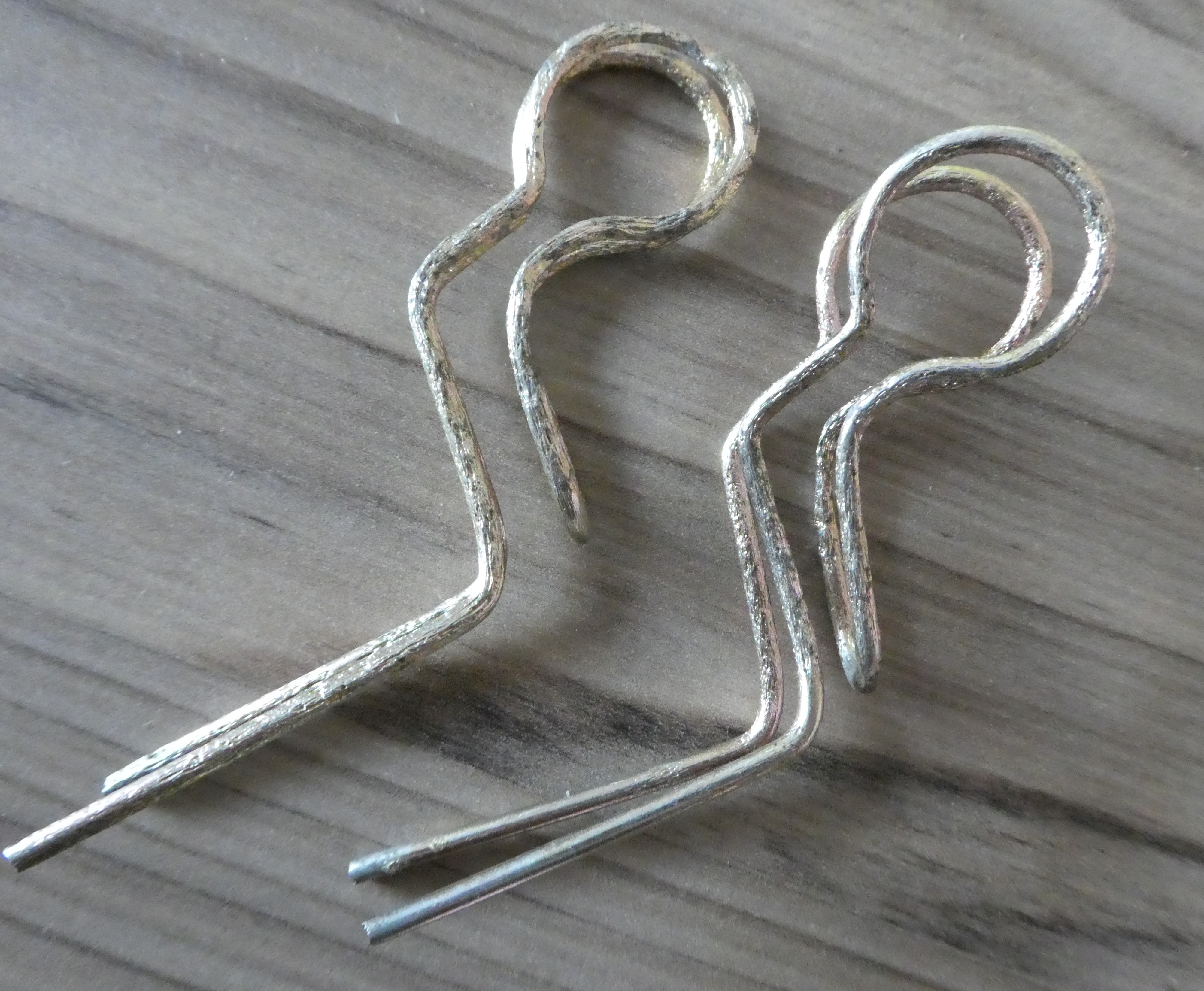

These are in my left over box of bits and wonder if anyone can recognise them, I wonder if they are Fiat.
Re: Another one coming back from dormancy
Hi Junior. They look a bit like the spring clips that hold the bulbs into headlights . Could be Alfa or Fiat as both marques used that style of clip.
Thanks for that, will look again to try to find a use for them. I feel sure they would be handy to someone.
The only other thing I could see them being used for was to hold water hoses in position. Or similar.
