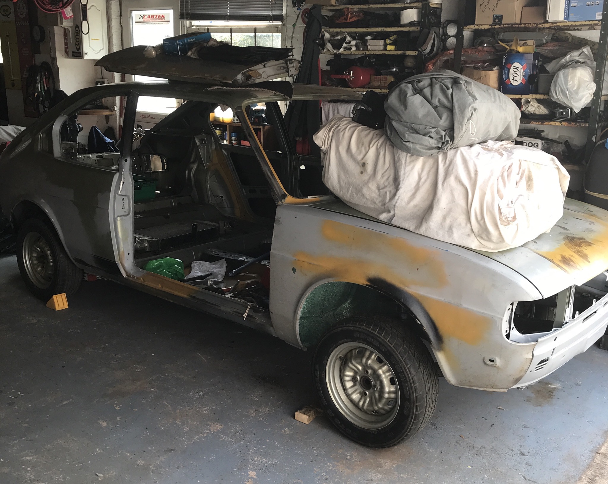

Mg been in the back burner whilst I fiiish the Porsche and the 20vt Engines
Ive just ordered a pile of new panels so I’m hoping to do a bit more on it Soon. I’ve also been cracking on with refurbishing various bits for the sud

Hi Tony It’s mainly Things like The heater assembly That I’ve been stripping cleaning and checking out along with starting to get a few bits powder coated . The gearbox remote is all done pedal box is complete apart from the servo that I still need to refinish. I’ve had the front crossmember powder Coated and I’ll be getting the rest of the front suspension done in the coming weeks
It’s a case of getting as many bits and pieces restored so that when the body is finished and painted the rebuild Should be done quite quickly . I reckon if I have all parts and everything is ready And I took my time I could Screw a sud together in about A week

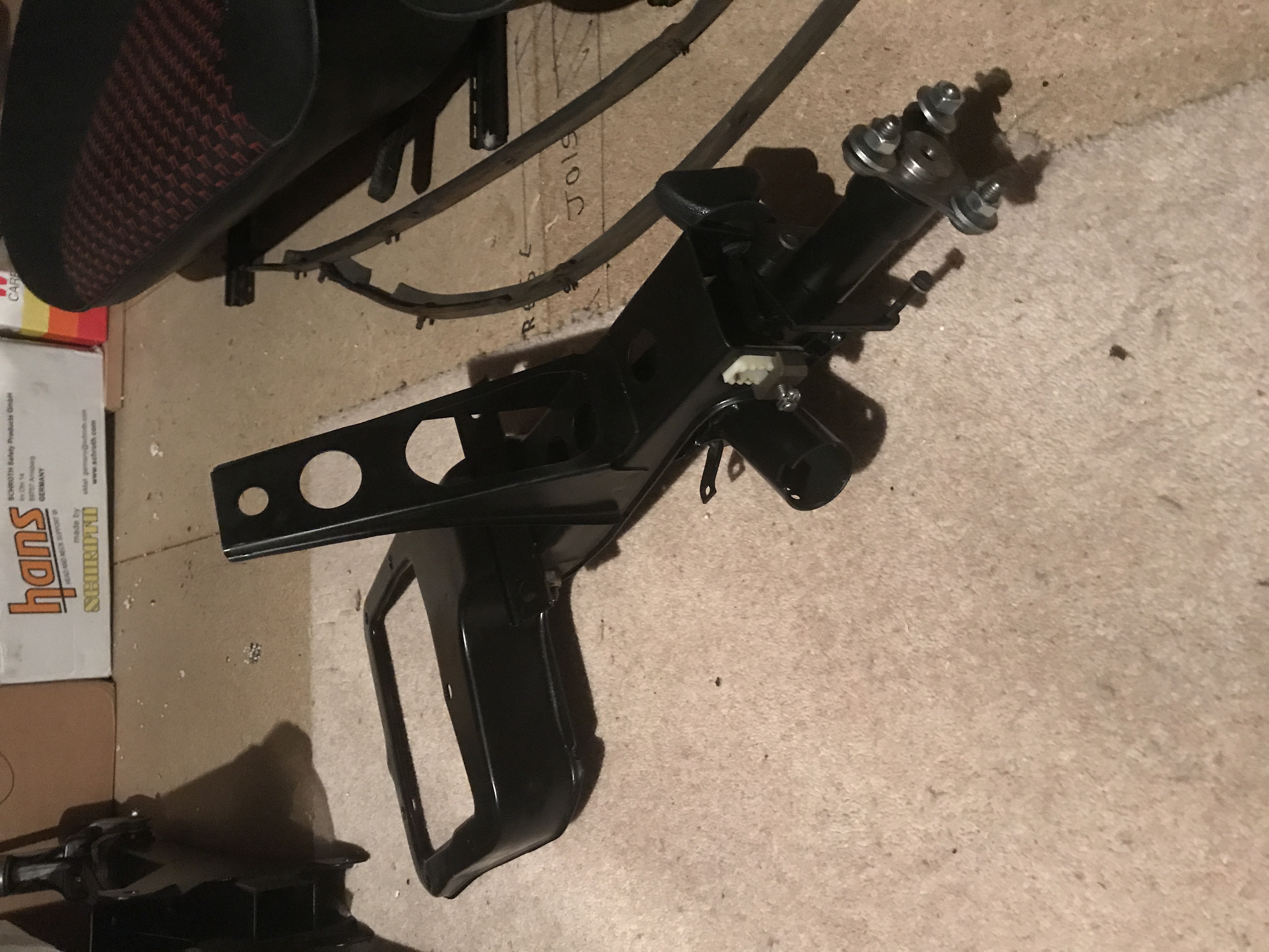

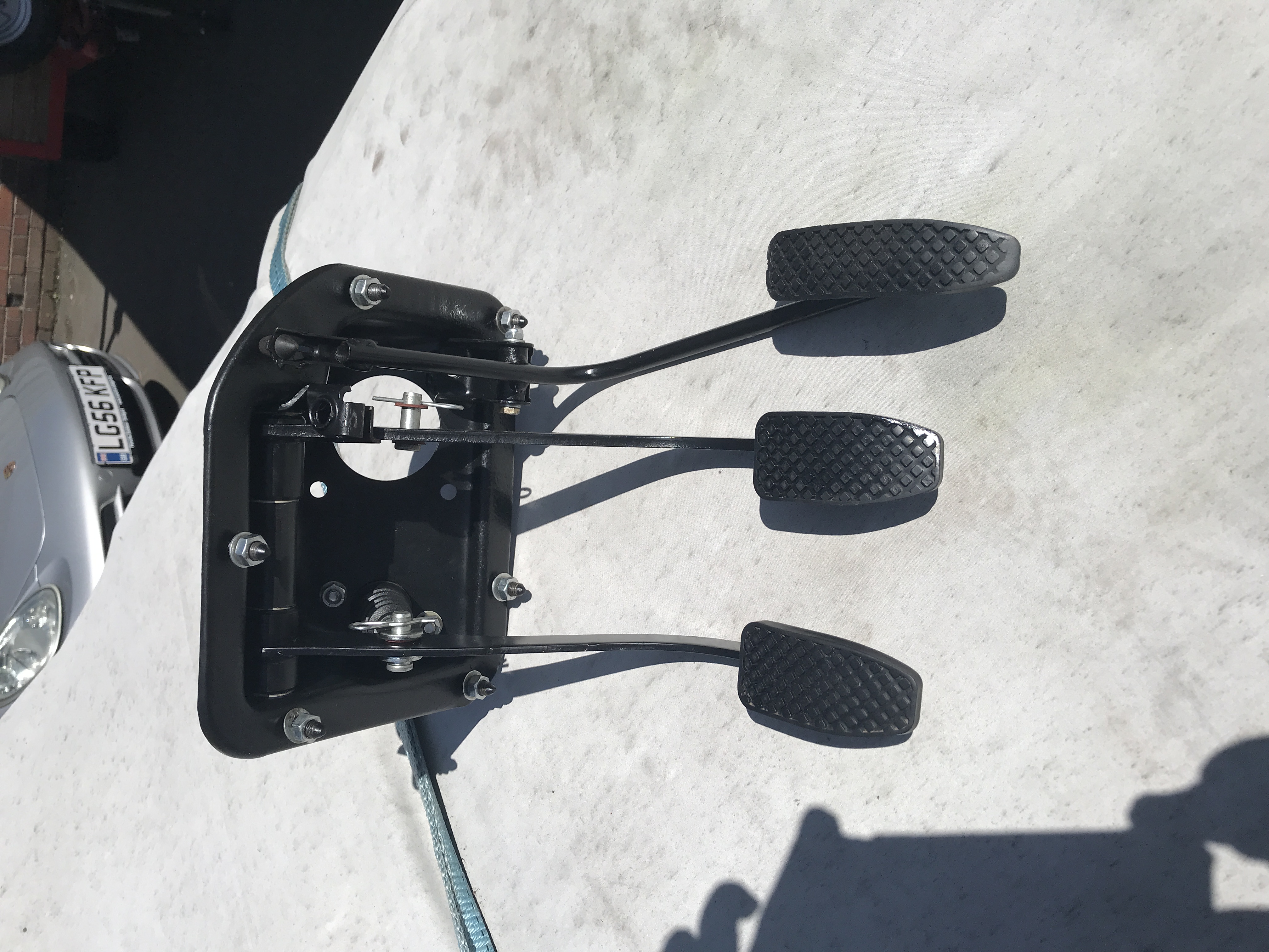

Pedal box all finished and just awaiting a freshly Refinished Servo.

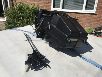

And the heater box. All stripped down cleaned and flushed all linkages lubed
Reassembled.

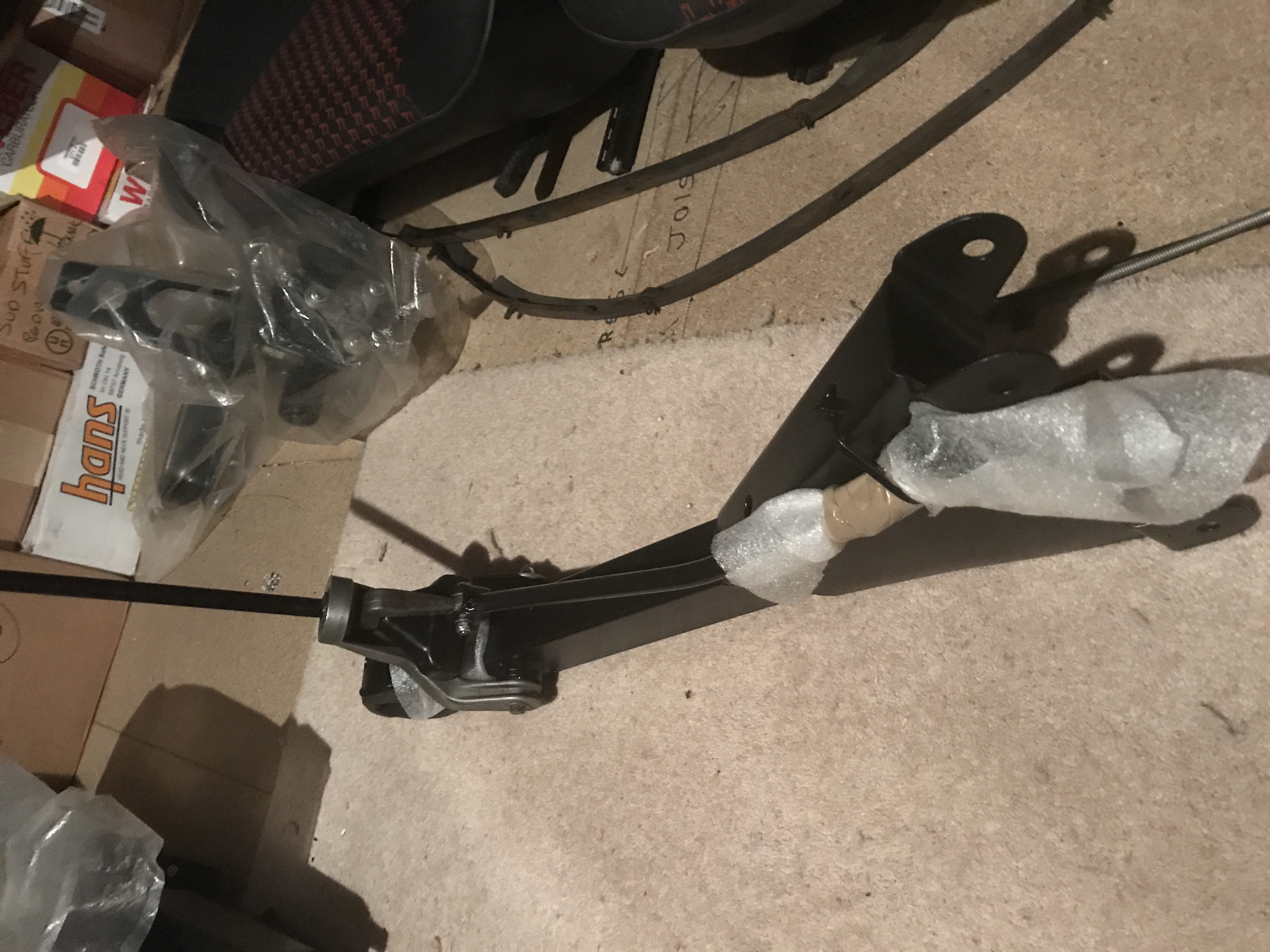

Gearbox remote powder coated And new bushings fitted.

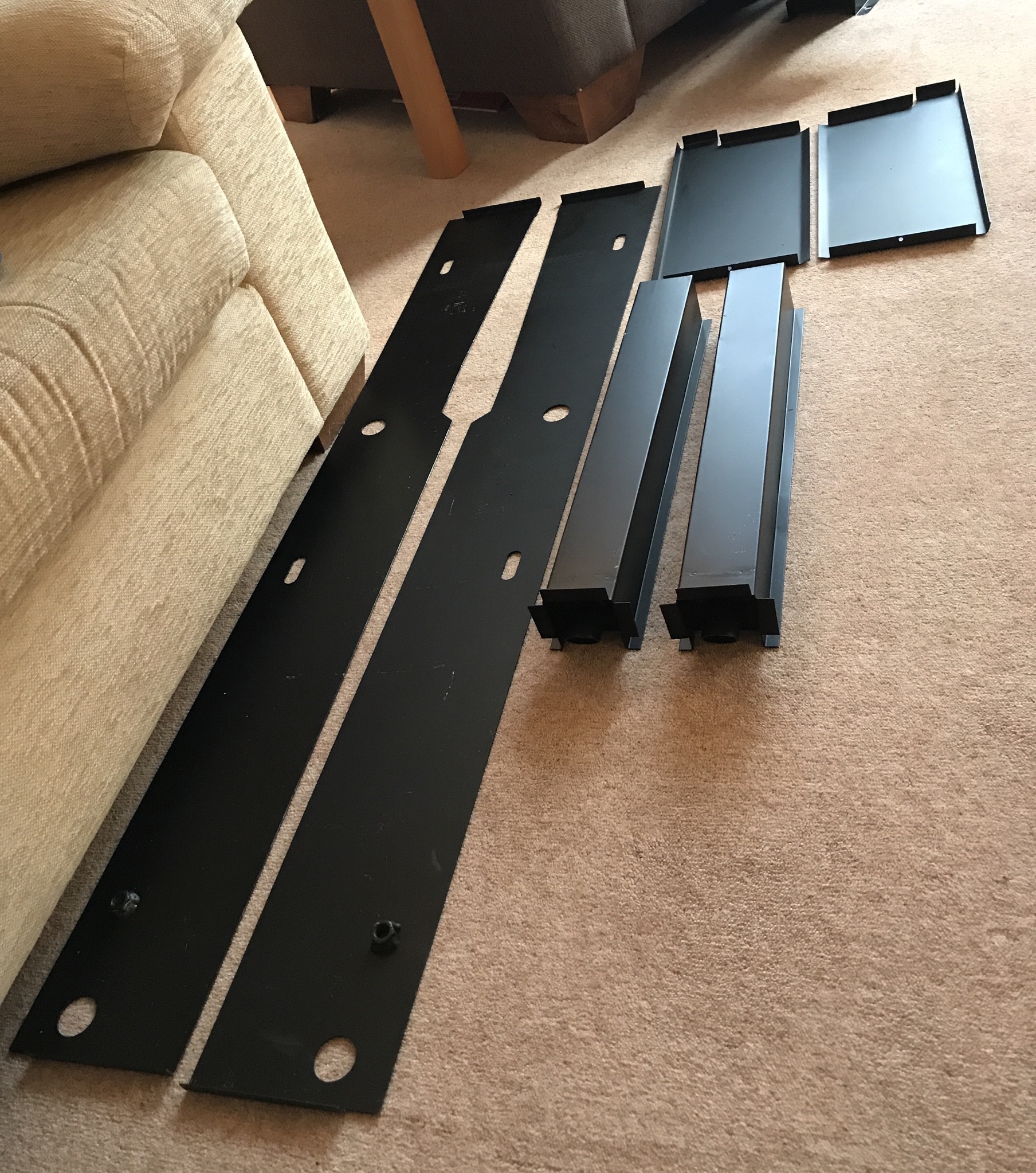

More new panels for the Midget. Inner sills front Toe boards and new outrigger / Jacking points.

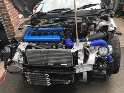

Spent the last few days fitting the New Engine to the Coupider. We thought The Turbo May have suffered but It looks like it’s ok. The engine sounds fine with no significant issues.
May even get to race it this year
Re: LooLoos projects.
Tried it up the street today . Still smokes a bit when it comes on boost so it looks like the Turboski has suffered after all 😭😭. Apart from that it’s wonderful

Alternative turbo fitted today . Seems to Have improved things . We’ll run it up the street A few time over the weekend To raise some proper boost and see what’s what.(We’ve got Very understanding neighbours). If all seems ok then we’ll get the original unit rebuilt as it’s got a sexy wastegate actuator

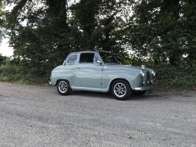

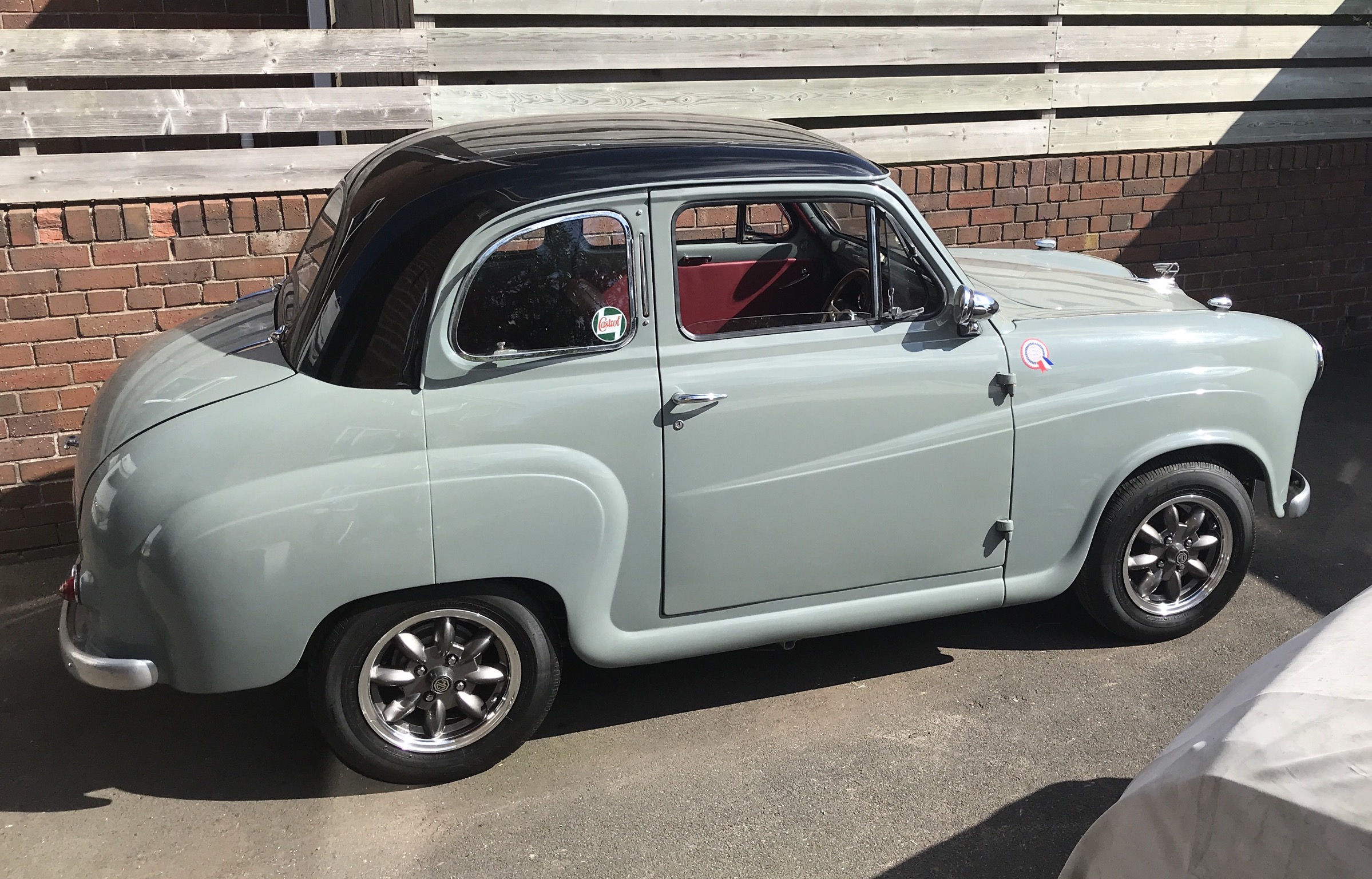

A30 back together now with some new rear springs from a decent supplier . It now Sits perfectly And doesn’t hit the bump stops when 2 fatties get in .
Also rebuilt the dynamo to fix the noisy front bearing engine sounds great now but next winter I’ll be pulling the lump to do a. Fast road build With omega pistons and a nice cam. I’ll also pocket the block To take The 1275 head Off the midget as I’ve got a stage 3 BVH for that.

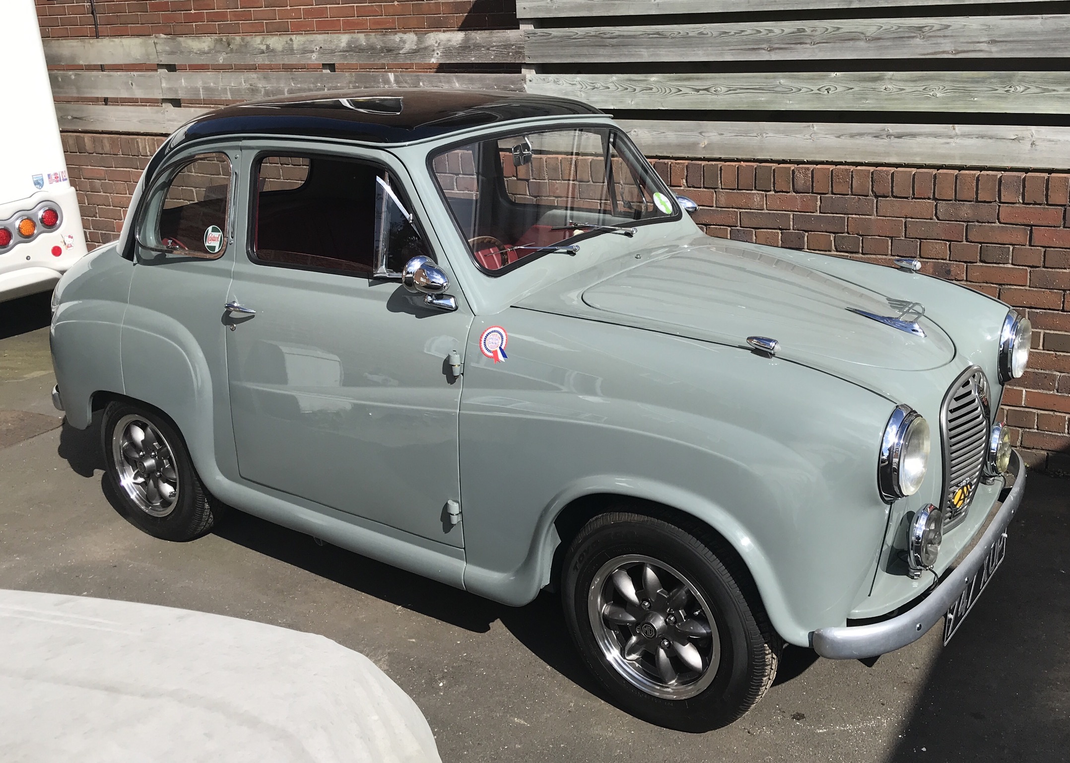

Kev, the wheels look like Rob's Imp wheels.
Kegsti66 wrote: Mon Aug 03, 2020 11:13 pm It does look great Lou, love it. :D
They do look the same as he had on the front, same colour with polished lip...he's got a set of 4 doing nothing now he's put the deep dish 7" wide ones on all round

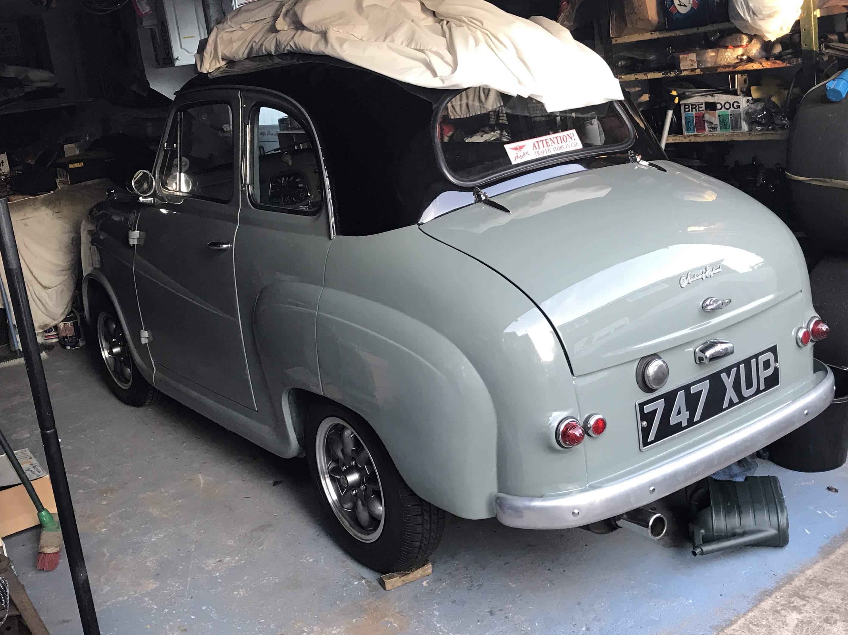

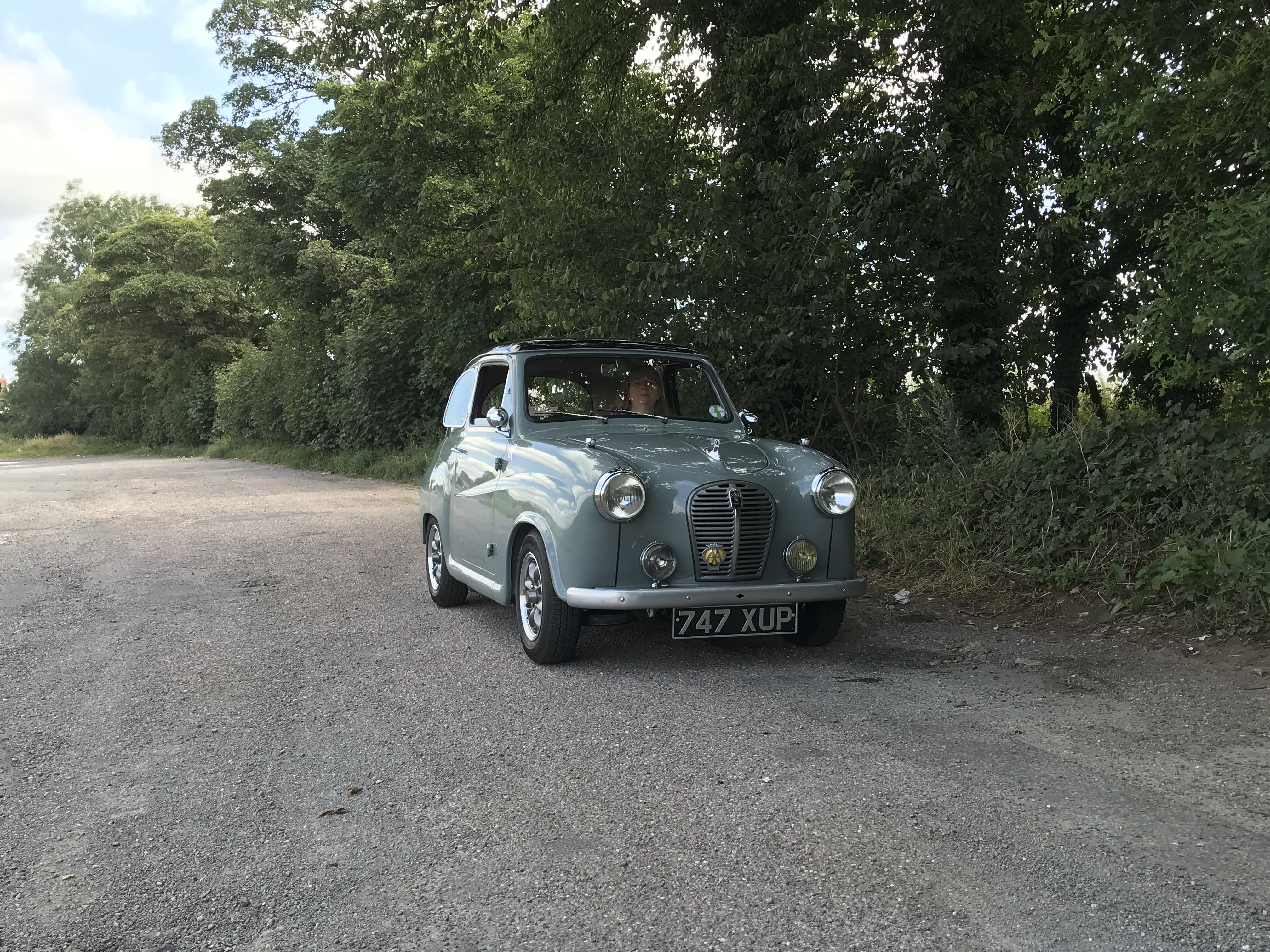

Took little “Jumbo” For a run out today and I have to say he ran faultlessly. It actually turned into the longest single run we’ve ever done with the Little car at nearly 40miles. We always get lots of Admiring glances and Big smiles.
It seems everyone’s Dad or Grandad had one back in the day .

Glad to see you've got correct height rear springs Lou.
When we had ours, lots of people fitted rear springs that raised the car up too much, and they looked ridiculous!
Dave. That was the problem we sorced then from an so called A30 “specialist” and the car sat way too high but more concerning was the stiffness. They were unacceptably hard so we Ended up taking the original 65yo springs to a Co in Brum called Jones Springs (they’ve done work for Car SoSage)
And they reset them and added an extra “helper” leaf Which has really sorted it . The problem now is the Brand new Fronts are still a little soft So we’ll be changing them again For some stiffer but std Ride height Units .
