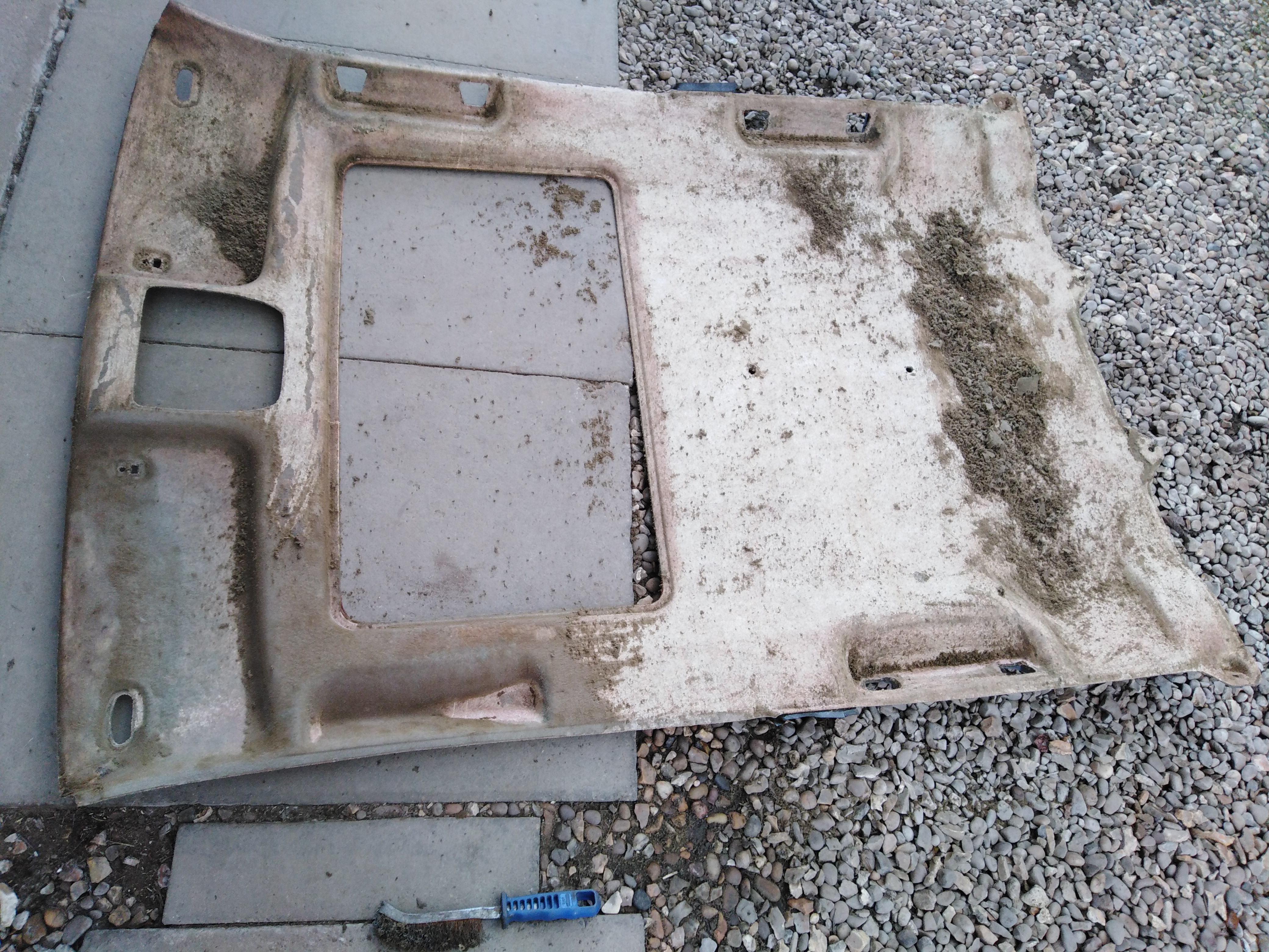

I retrimmed the sliding sunroof cover panel for the new assembly so it will match the new material for the droopy main roof panel.
The roof liner is like a cardboard fibrous material but the original liner glue had failed, well the foam had rotted away and let it all droop down.
Cleaned it all up ready for the new material when I get chance.
This afternoon the planets aligned, nice sunny afternoon with no rain forecast and not that windy.
Quite pleased with the outcome, I'm not that good at trimming so despite the odd crease I'm happy with it.
Giving it overnight in the shed to dry off fully then I'll refit it in the 145 tomorrow afternoon so it's out of harms way!

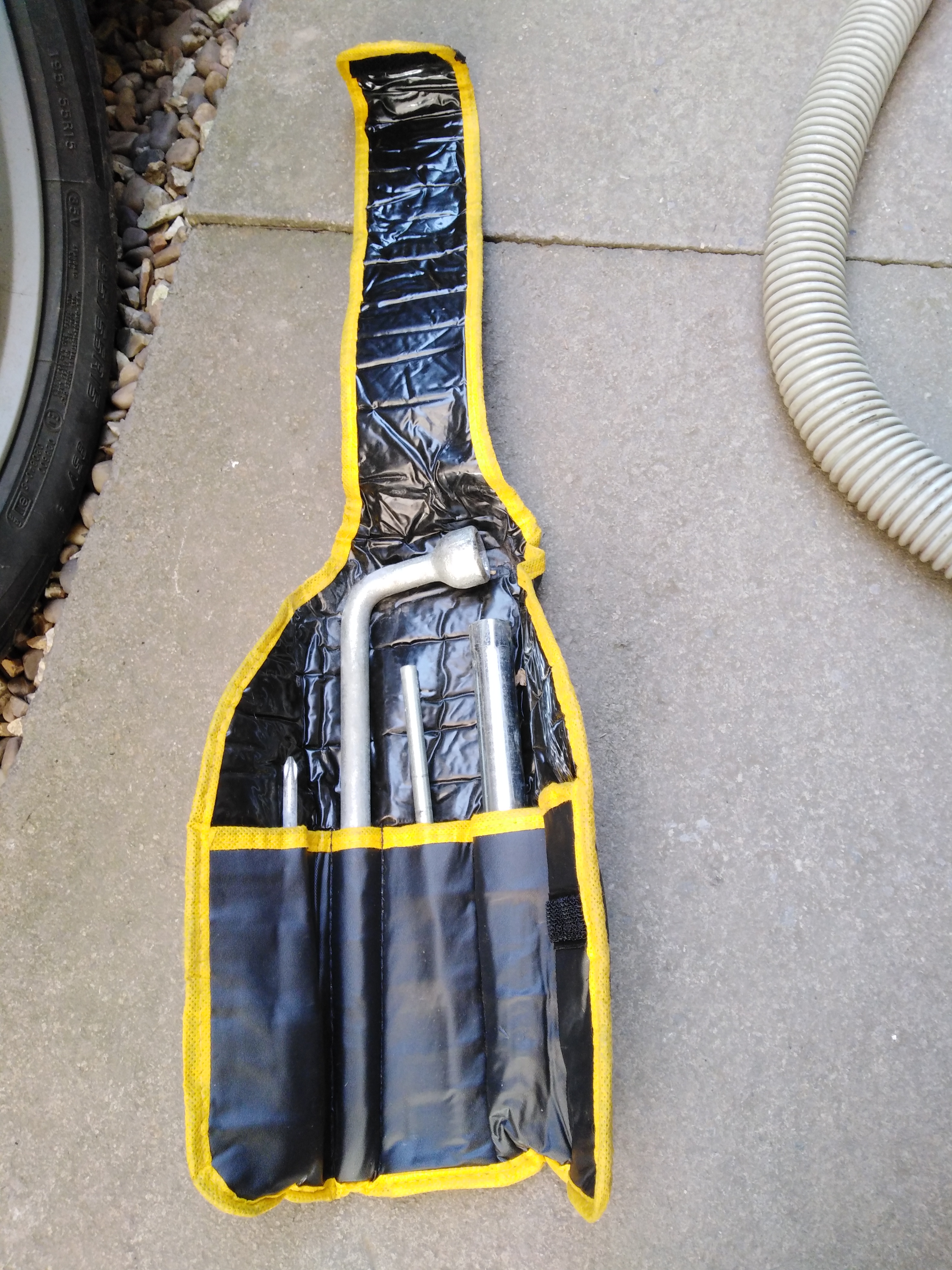

Any ideas what this little tool in the roll might be?
Re: 145 QV
Posted: Fri Apr 10, 2020 9:37 pm
by LooLooSud33Spider
It’s an emergency sunroof handle. If it packs up you can use it to close the roof

LooLooSud33Spider wrote: Fri Apr 10, 2020 9:37 pm It’s an emergency sunroof handle. If it packs up you can use it to close the roof
Ah, that would make sense Lou,
Did the tool roll come from you? Or have I always had it,,, :roll:

I imagine you’ve always had it as your car Has a sunroof it’s not needed on non sunroof cars. basically if you drop the interior light out to get to the motor you’ll see a Flush round Spindle that rotates when you operate the roof It has a slot in it insert the tool and push up to engage you can then turn the spindle to close the roof if it fails electrically (it is Italian after all)

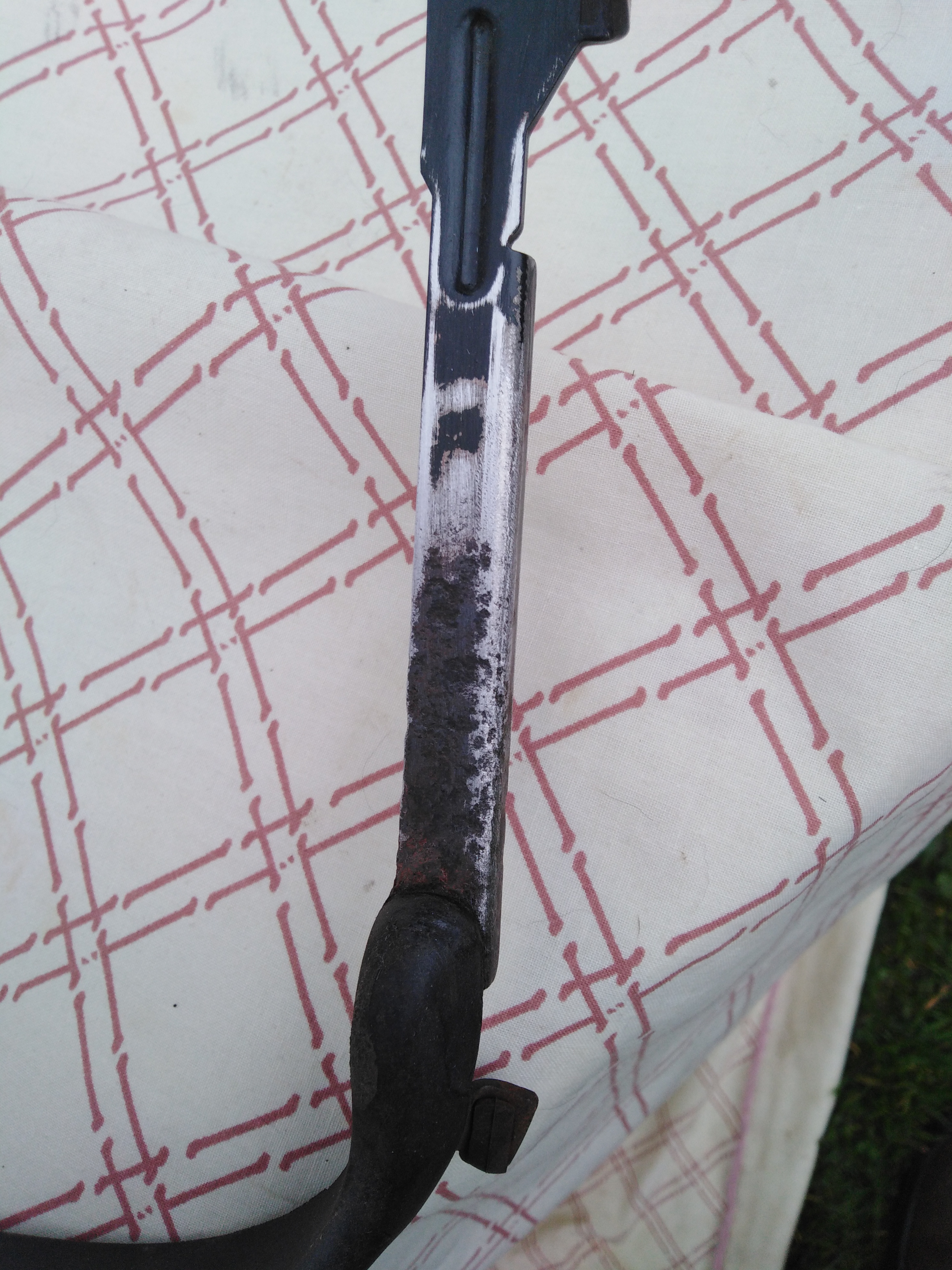

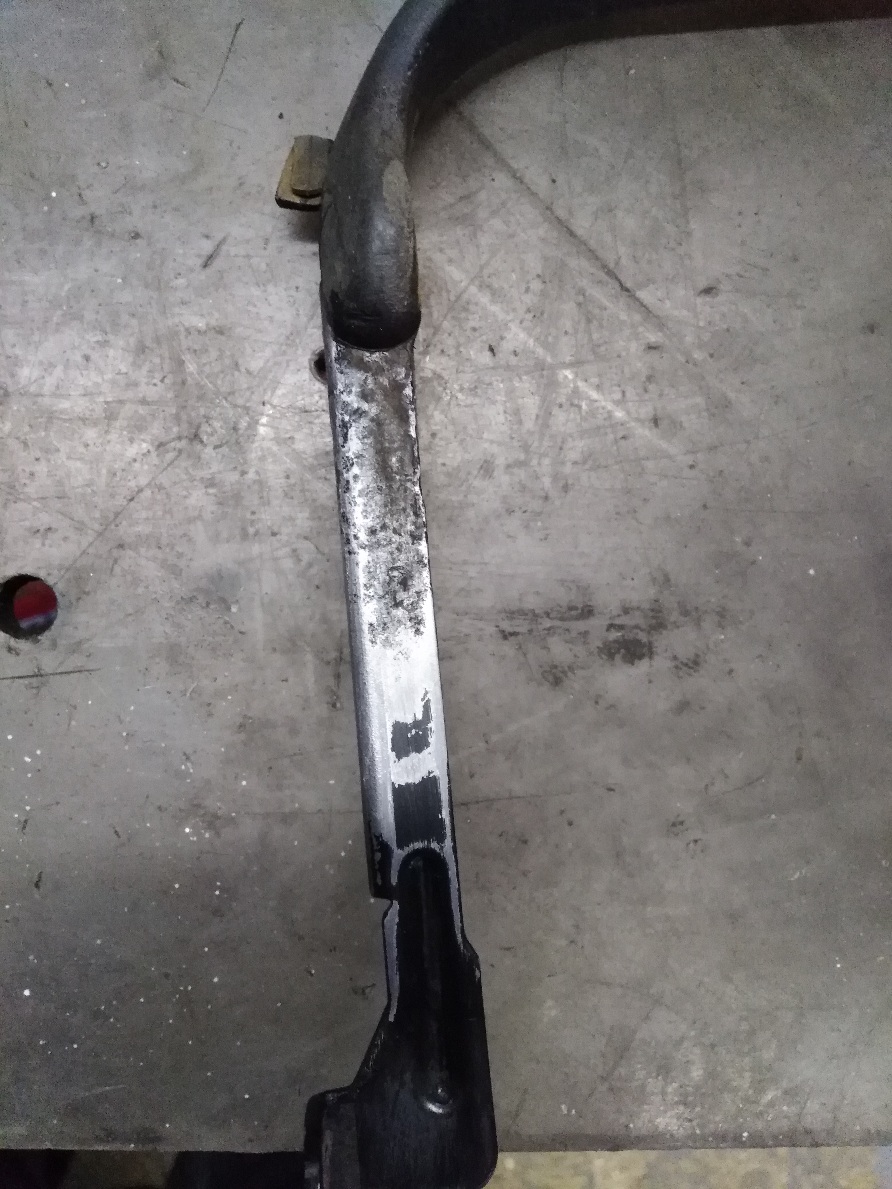

The wind deflector that pops up when the glass panel is retracted back I knew needed cleaning and some rust treating was next now I could get at it.
One side where the glass panel rubs across it to fold it back down had rusted because the paint had been scraped off.
Re: 145 QV
Posted: Sun Apr 12, 2020 8:48 pm
by KevJTD
Rubbed it down and treated with Jenolite, my new favourite substance 8-)
Once that had dried off a good layer of hammerite should hold things back.
I'll leave it a couple of weeks before putting it back on the car so it can harden off nicely. Might even think about glueing a thin plastic slider on it rather than have it rubbing on the paint.

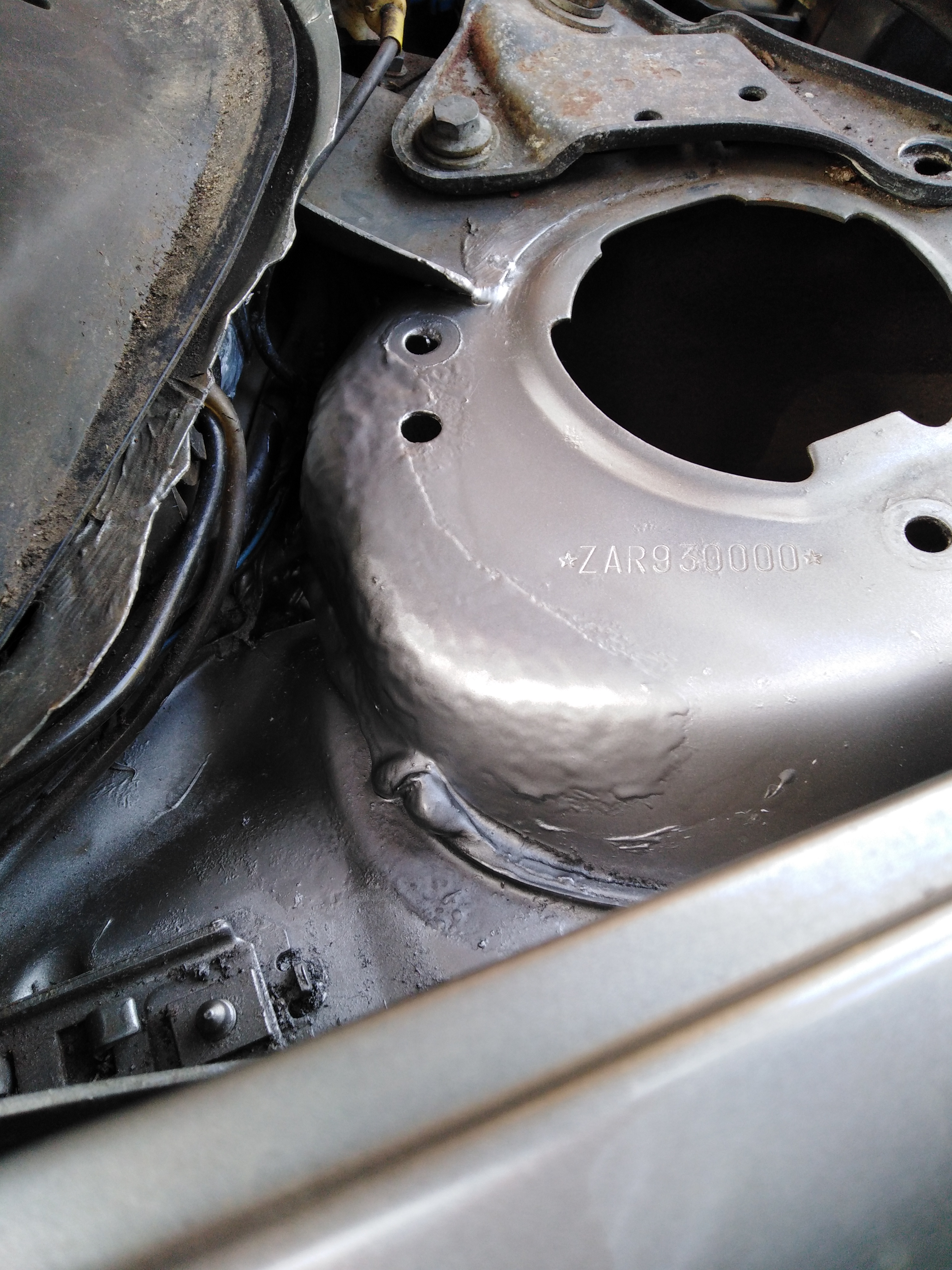

Did decide to tackle a bit of rust on the strut tower that's been bugging me for a while since I spotted it under that rubber corner piece that sits around the bonnet hinge.
Expected it to be needing welding so took the strut off in readiness.
Surprised to see though from underneath there was no sign of an issue, seems it's where that rubber corner piece sits that keeps it damp up above.
Managed to clean off the surface rust and try as I might with a hammer and chisel the tower was solid so cleaned up nicely, treated with Jenolite rust converter, hammerite couple coats then found some 5 wheel silver that was near enough rather than leave black hammerite on show.
Gave everything a couple of coats of tetroseal including the strut top mount then put it back together happy that a potential issue down the road had been avoided.
