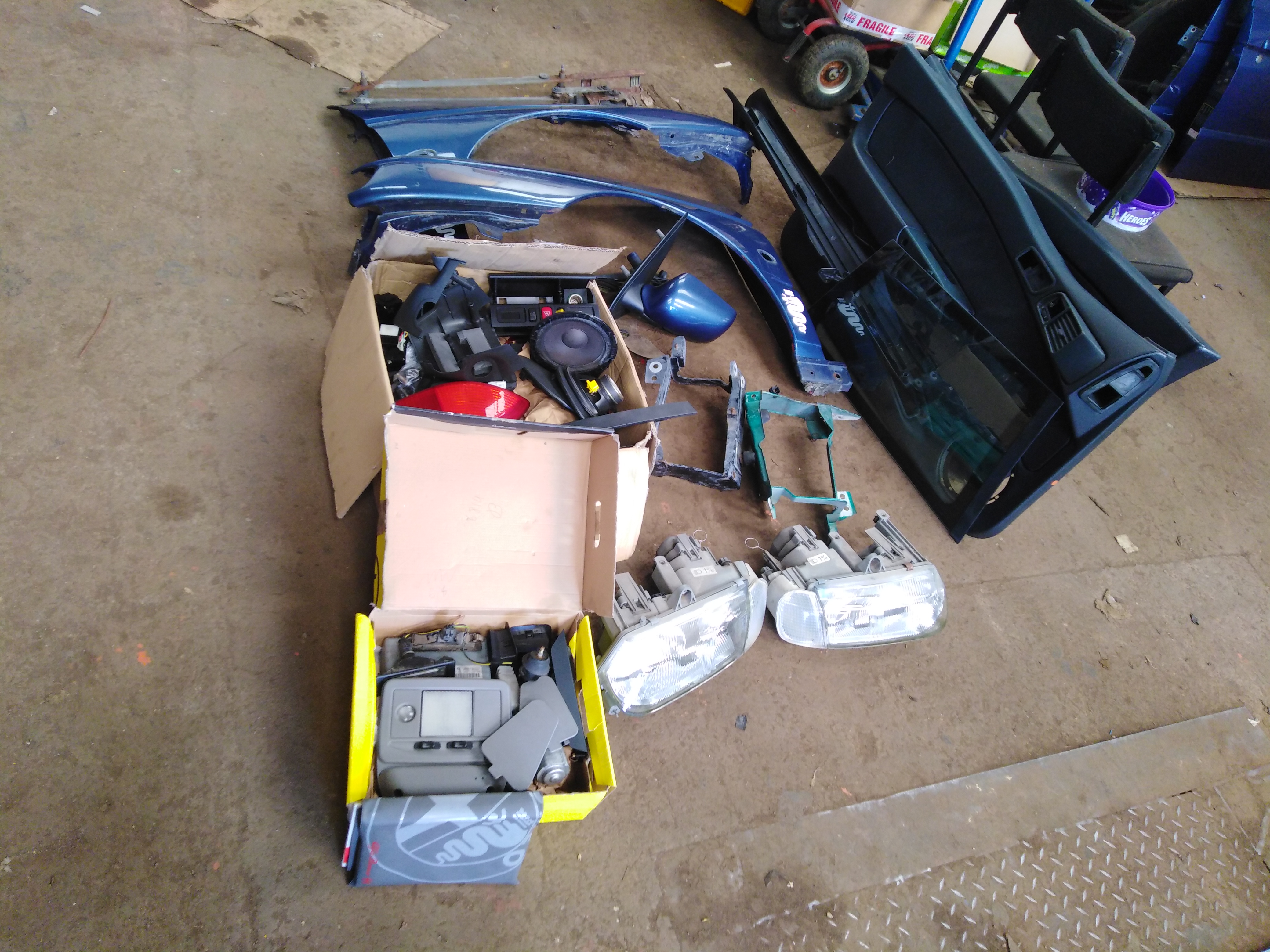

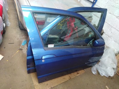

Finally Lou and myself managed to get the planets to align today so I went over to grab a few spares from the scrapyard destined 145 she has there.
Took the Giulietta for a ride over, a door and a few spares should easily go in, eh?
Turns out the more modern a car I get the less space they have, took 3 of us to squeeze a door in, even after we'd took the door card off!
The fact we managed to get 2 doors, plus door cards, both front wings and many other assorted parts in was more to do with stubbornness than anything else, the knees against the dashboard ride home were a simple price to pay.
Thanks Lou, these parts will help keep the 145 going, hoping I don't need them too soon!

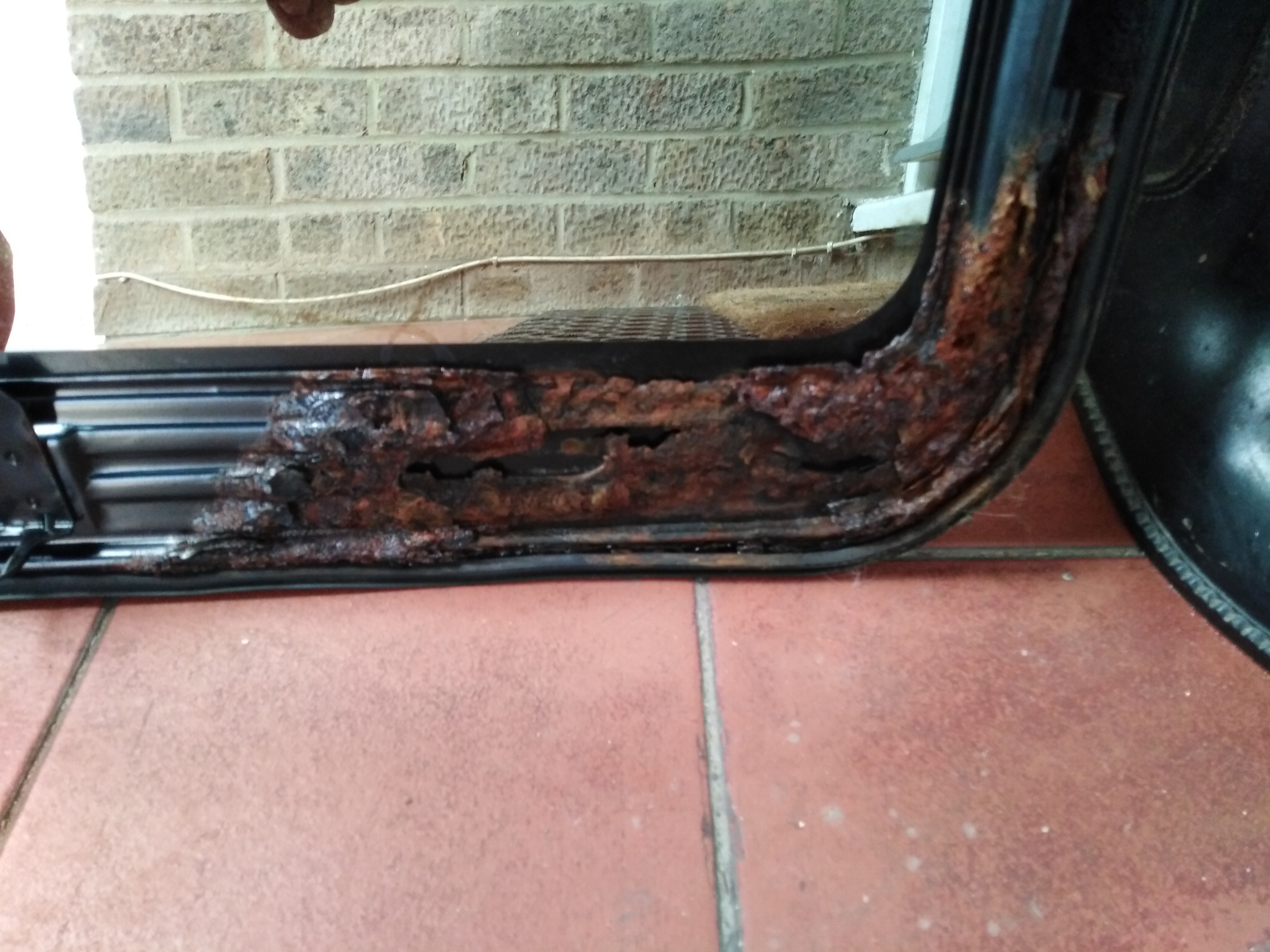

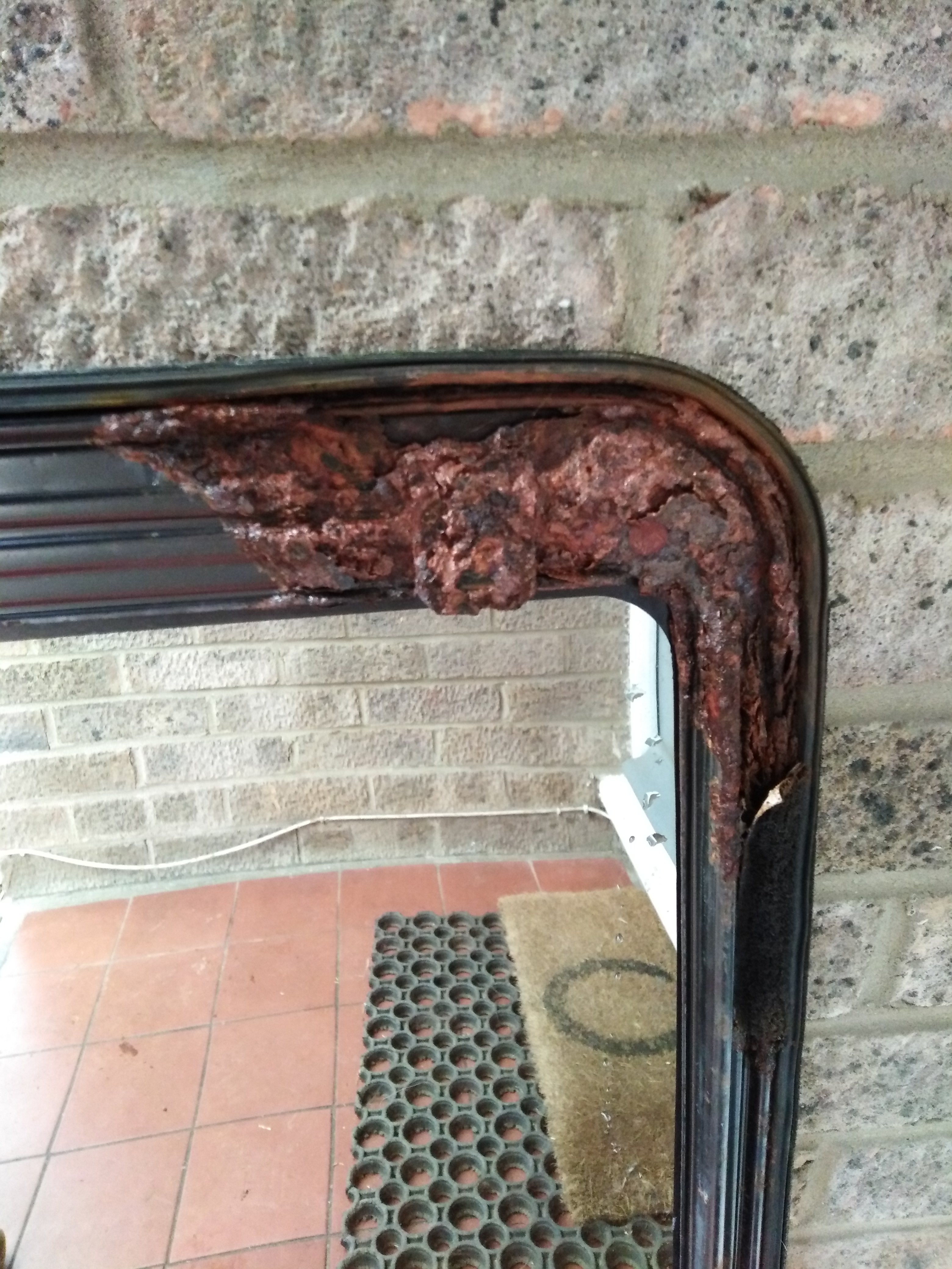

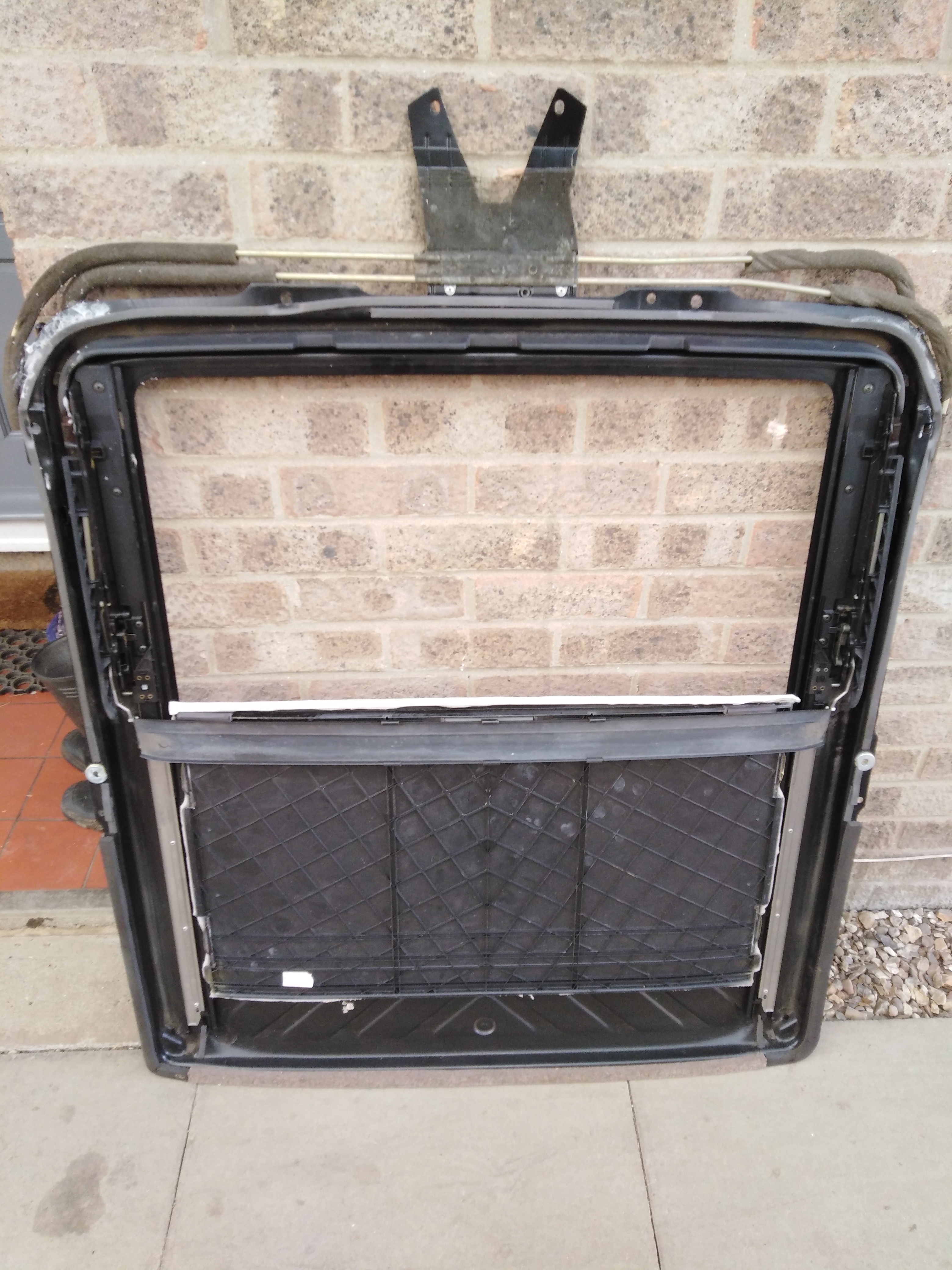

The sunroof on the 145 has always been its worst bit, the frame was rusted terribly and with the seal being a bit leaky it has been letting water in this winter as its parked at home.
I got a very good used one a while ago from clover breakers so that was swapped a few weeks ago. Think I may have already mentioned this.... maybe it got lost in the forum update..
Anyway, the old one was really very rusted and well overdue change.
Relieved that the car roof has no rust on it at all, confined to the sunroof panel alone.. phew! ;)
Re: 145 QV
Changed the whole panel so I now have a functioning air deflector at the front, the old one had a cruddy rusted bracket for the lifter..

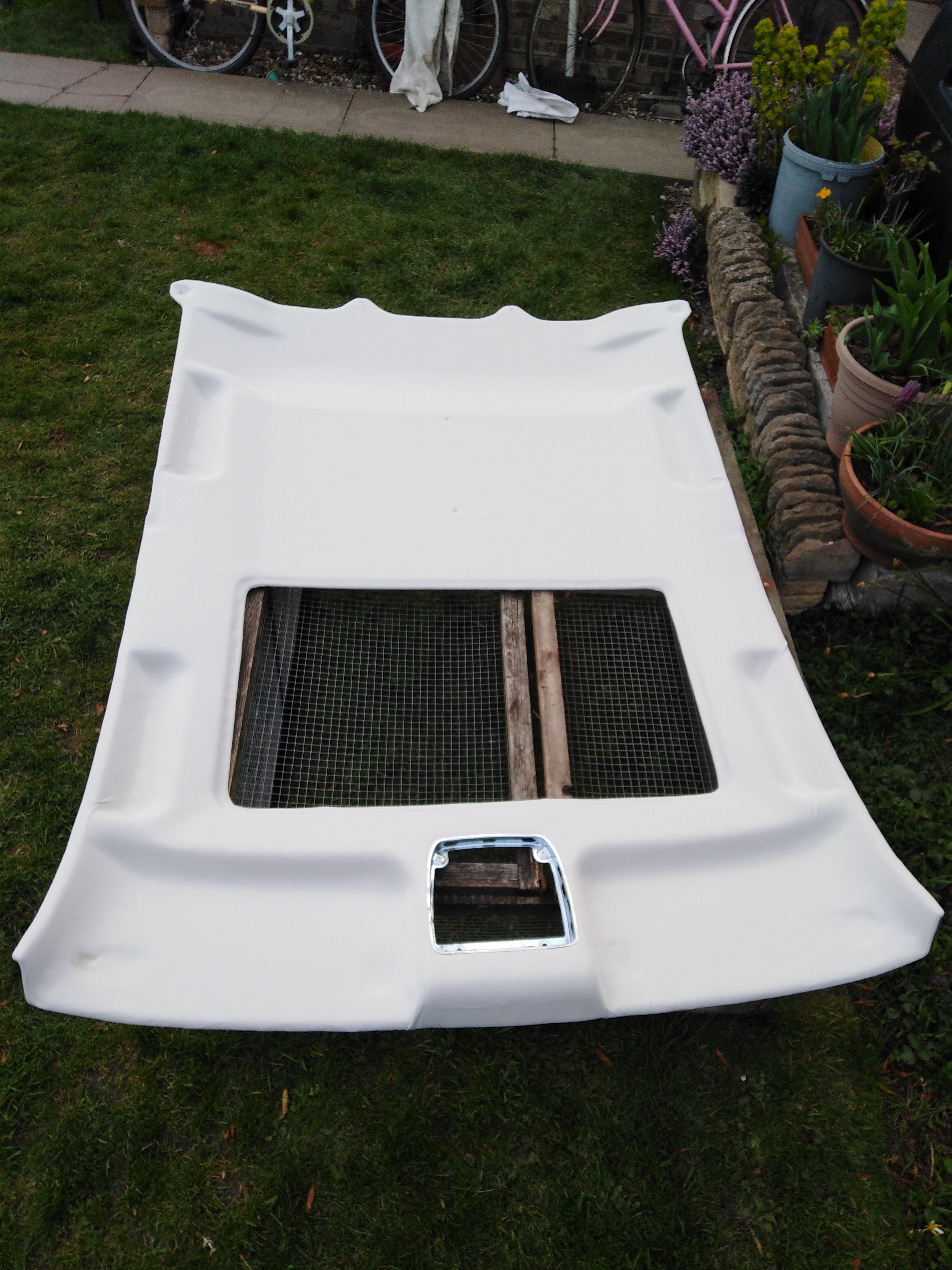

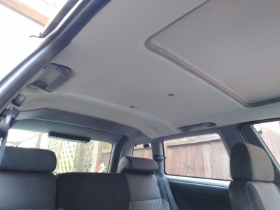

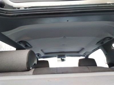

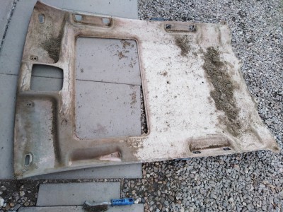

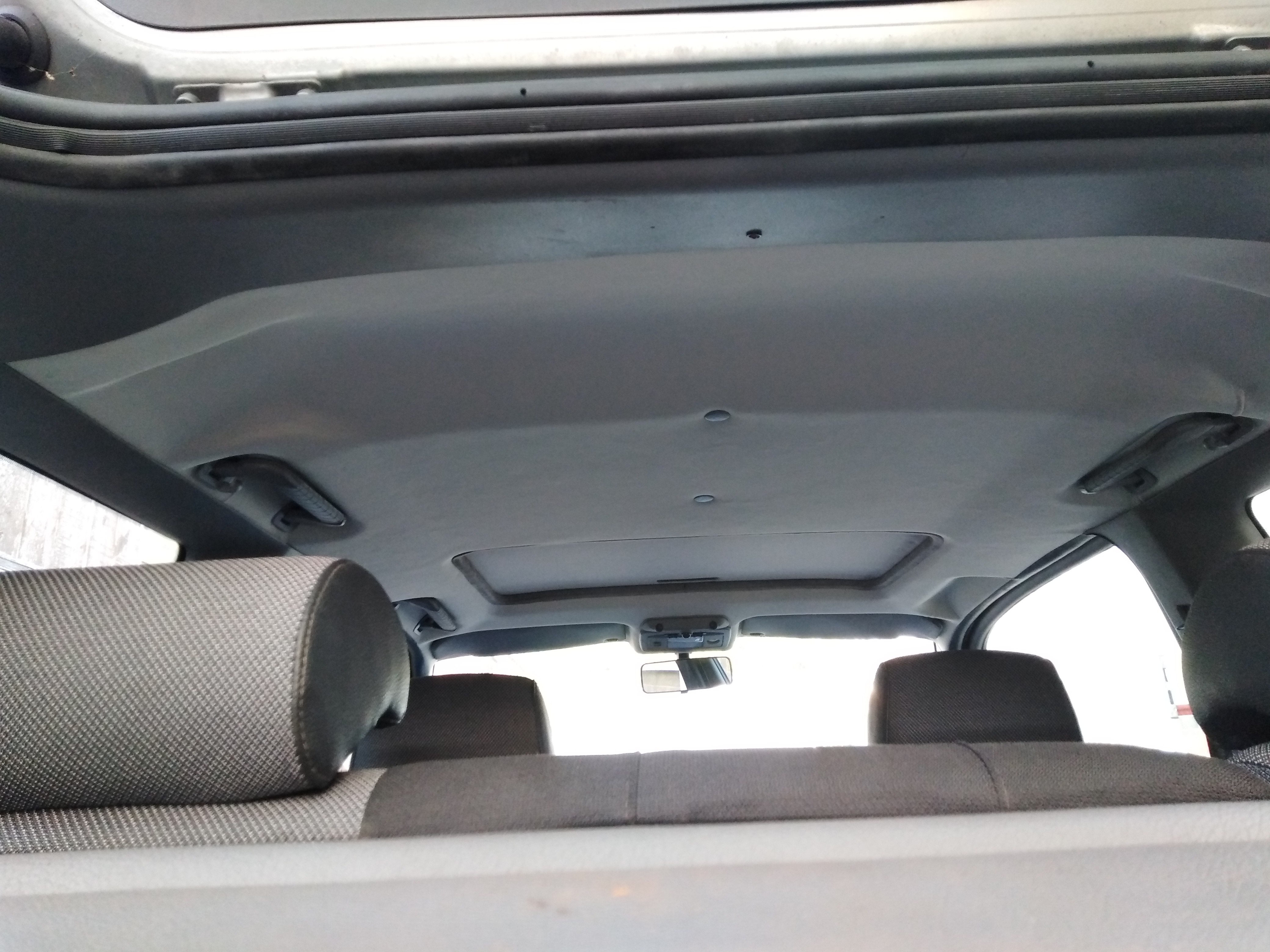

I retrimmed the sliding sunroof cover panel for the new assembly so it will match the new material for the droopy main roof panel.
The roof liner is like a cardboard fibrous material but the original liner glue had failed, well the foam had rotted away and let it all droop down.
Cleaned it all up ready for the new material when I get chance.
This afternoon the planets aligned, nice sunny afternoon with no rain forecast and not that windy.
Quite pleased with the outcome, I'm not that good at trimming so despite the odd crease I'm happy with it.
Giving it overnight in the shed to dry off fully then I'll refit it in the 145 tomorrow afternoon so it's out of harms way!

Safely back in the car now even though there was a disaster earlier on :roll: left it in the garden on some trestles while the sun dried the last of the glue off, well it was dry really but just to be sure. The wind got under it and flipped it on the floor :evil: of course, like toast, it landed material side down. Thankful that the last week or two the grass has dried up so didn't get mud on the new liner.
Fitted it back into the car now so it's safe. Still a few bits to put back in like grab handles but at least it's out of the way and won't get damaged or dirty.
Every time I even sit in the 145 it reminds me what a great car it is.
The droopy roof liner sorted along with the rusty and noisy sunroof should only make it nicer still 8-)

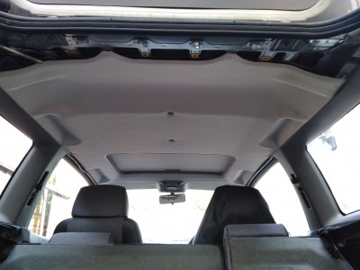

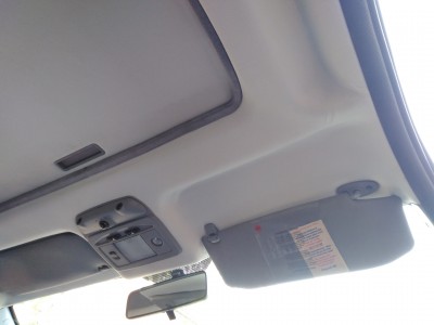

Finished the roof lining this afternoon, sun visors and grab handles fitted which meant cutting holes in the new lining :shock:
Glad it's done and the holes are in the right place! Not perfect but I'm pleased with it, way better than the droopy material that was there.

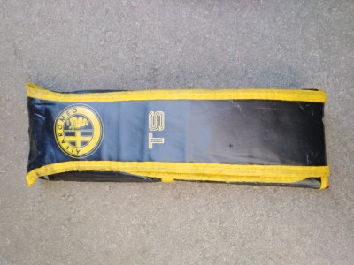

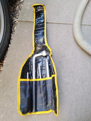

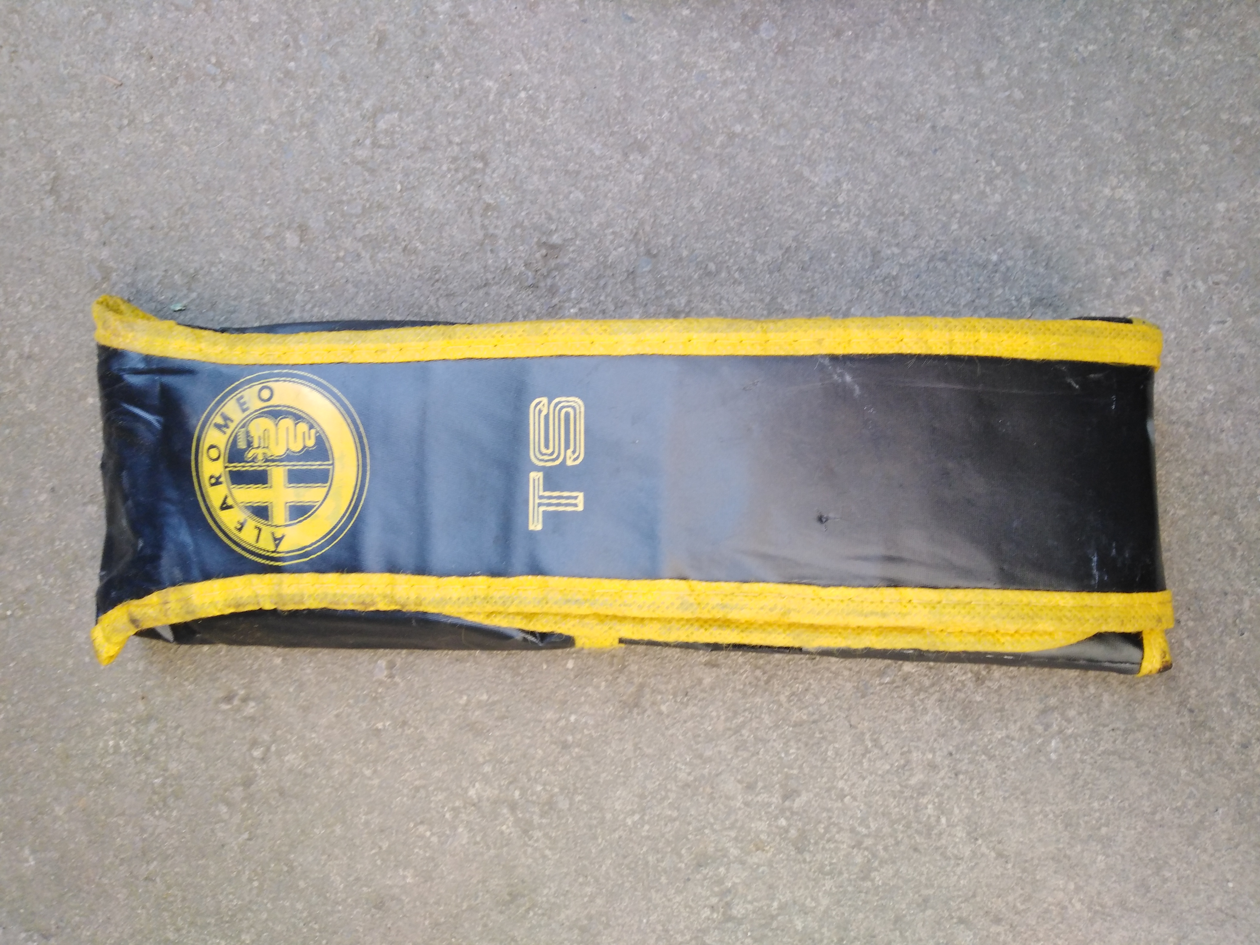

Any ideas what this little tool in the roll might be?
Re: 145 QV
It’s an emergency sunroof handle. If it packs up you can use it to close the roof

LooLooSud33Spider wrote: Fri Apr 10, 2020 9:37 pm It’s an emergency sunroof handle. If it packs up you can use it to close the roof
Ah, that would make sense Lou,
Did the tool roll come from you? Or have I always had it,,, :roll:
Re: 145 QV
Kev that looks so good and even a cool looking tool set too . The Alfa gods are smiling
Re: 145 QV
I imagine you’ve always had it as your car Has a sunroof it’s not needed on non sunroof cars. basically if you drop the interior light out to get to the motor you’ll see a Flush round Spindle that rotates when you operate the roof It has a slot in it insert the tool and push up to engage you can then turn the spindle to close the roof if it fails electrically (it is Italian after all)

Guess you're right Lou, that one I got the bits off from you didn't have a sunroof did it.
Just means I hadn't spotted it in 4 years :lol:

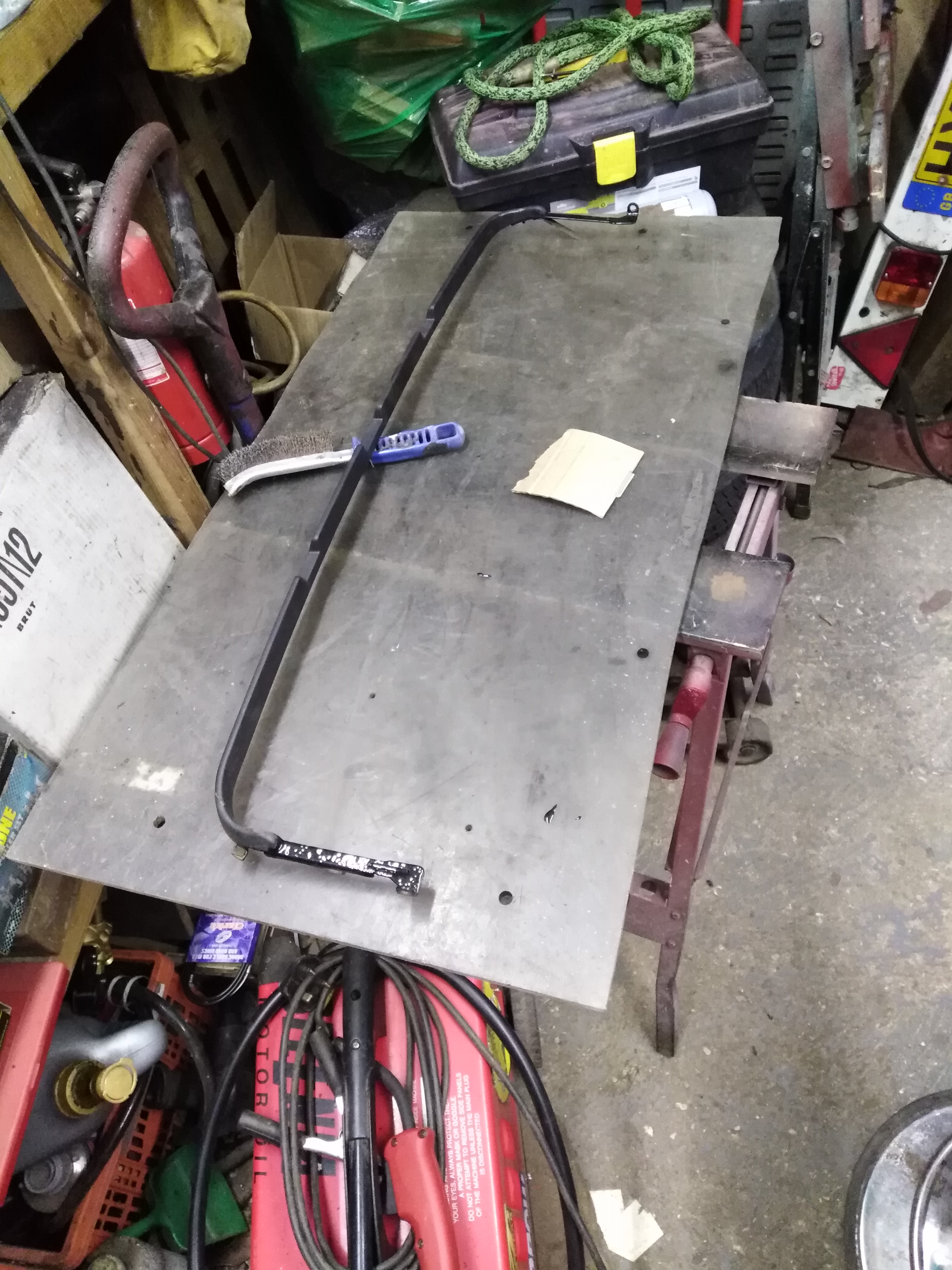

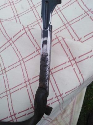

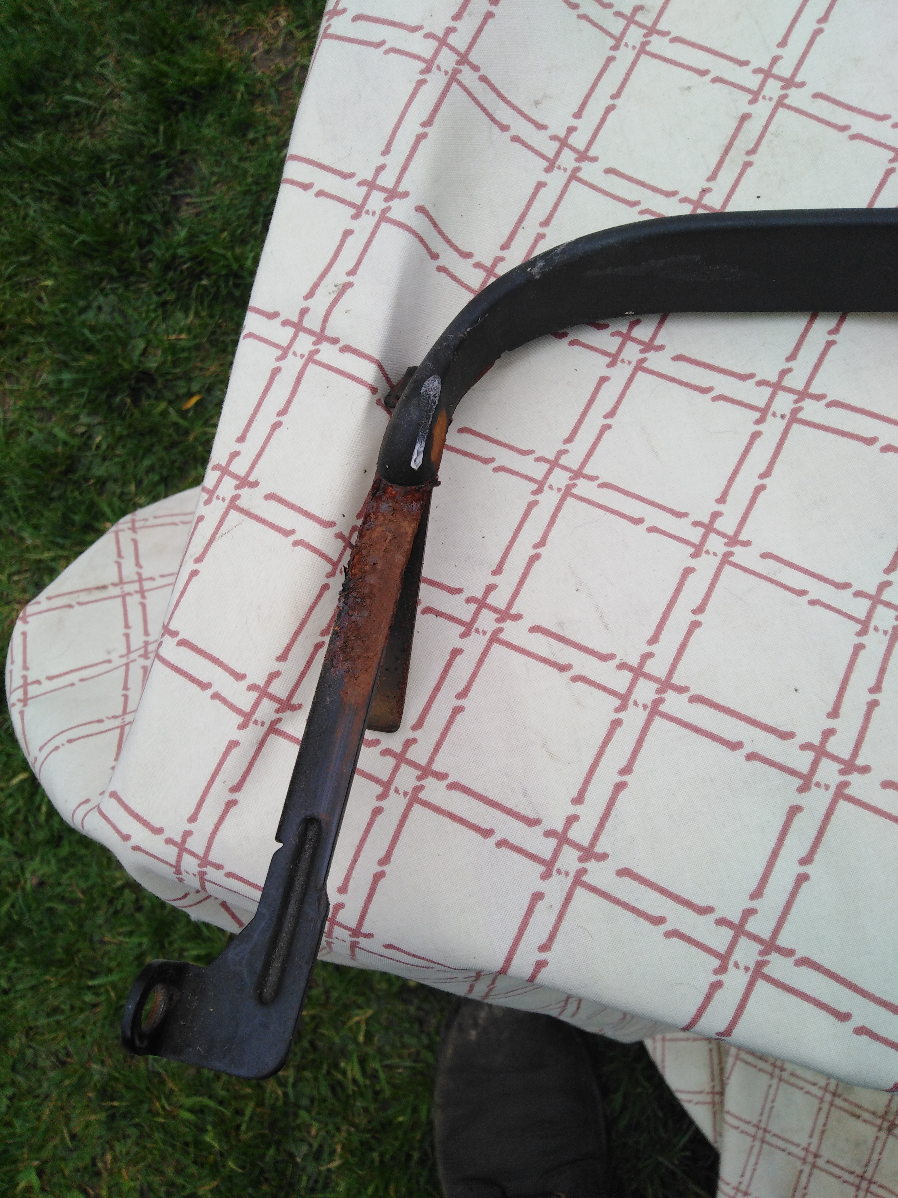

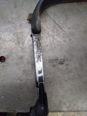

The wind deflector that pops up when the glass panel is retracted back I knew needed cleaning and some rust treating was next now I could get at it.
One side where the glass panel rubs across it to fold it back down had rusted because the paint had been scraped off.
Re: 145 QV

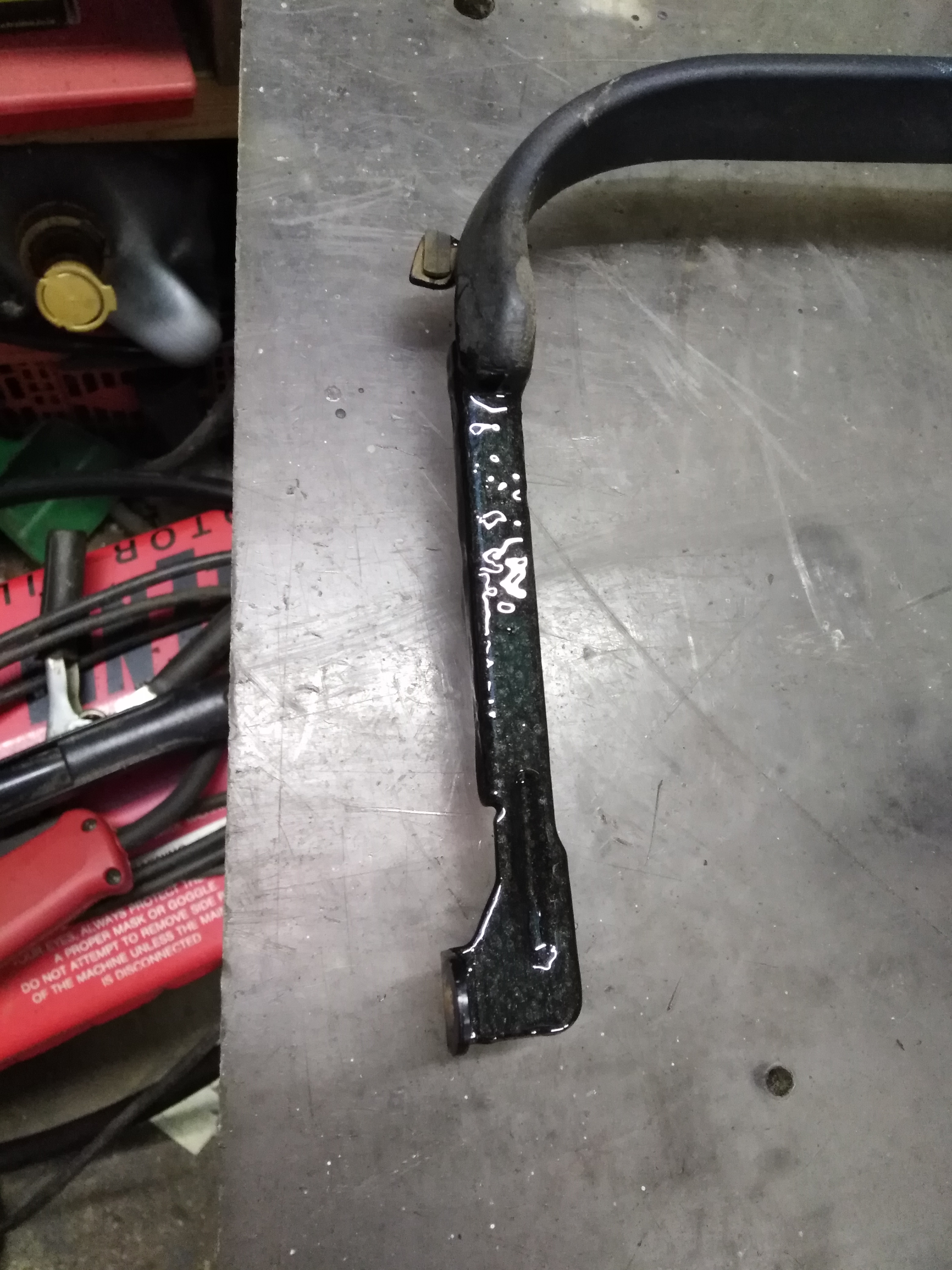

Rubbed it down and treated with Jenolite, my new favourite substance 8-)
Once that had dried off a good layer of hammerite should hold things back.
I'll leave it a couple of weeks before putting it back on the car so it can harden off nicely. Might even think about glueing a thin plastic slider on it rather than have it rubbing on the paint.

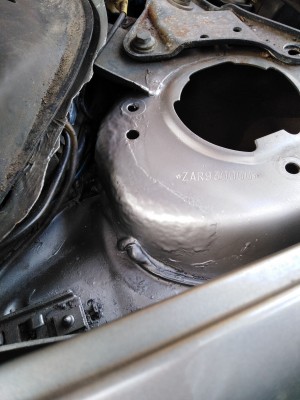

Did decide to tackle a bit of rust on the strut tower that's been bugging me for a while since I spotted it under that rubber corner piece that sits around the bonnet hinge.
Expected it to be needing welding so took the strut off in readiness.
Surprised to see though from underneath there was no sign of an issue, seems it's where that rubber corner piece sits that keeps it damp up above.
Managed to clean off the surface rust and try as I might with a hammer and chisel the tower was solid so cleaned up nicely, treated with Jenolite rust converter, hammerite couple coats then found some 5 wheel silver that was near enough rather than leave black hammerite on show.
Gave everything a couple of coats of tetroseal including the strut top mount then put it back together happy that a potential issue down the road had been avoided.

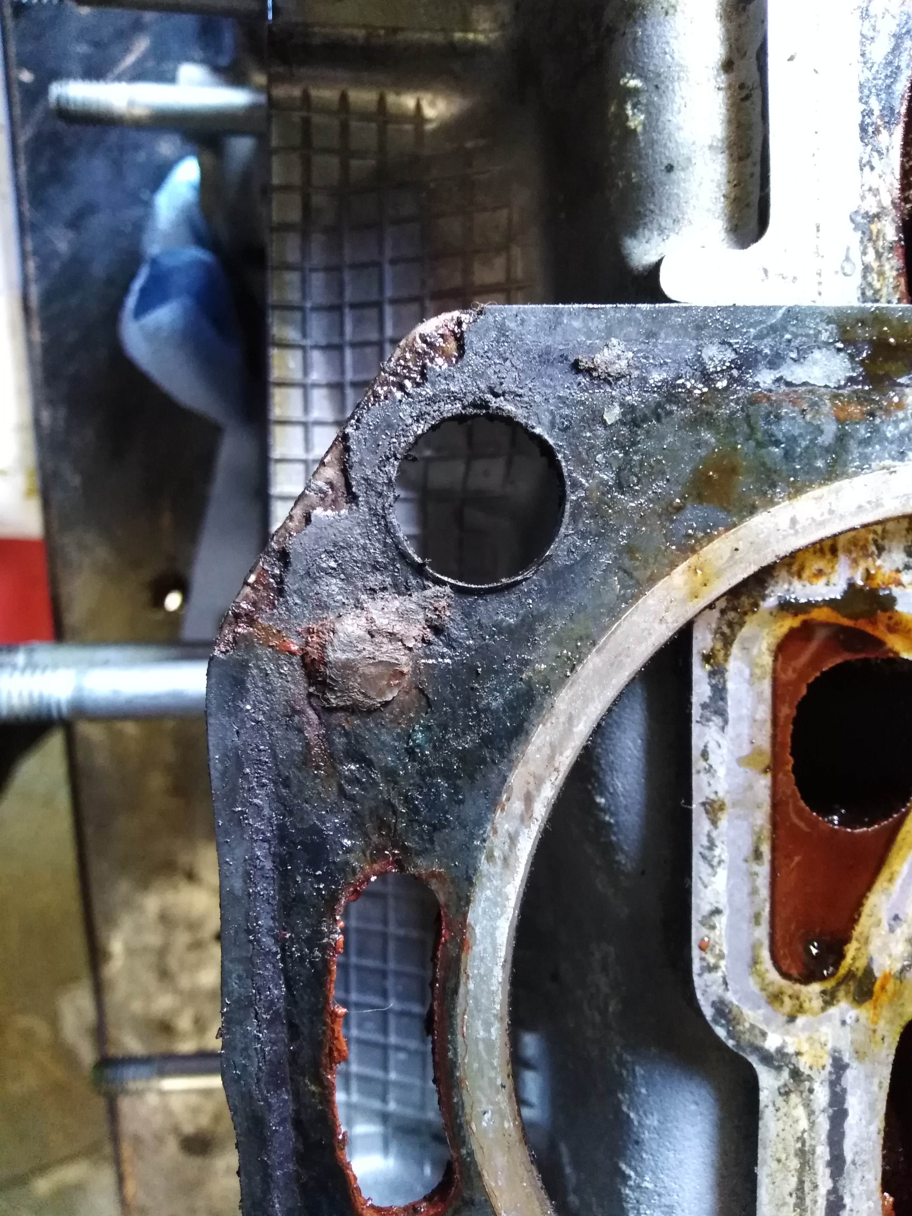

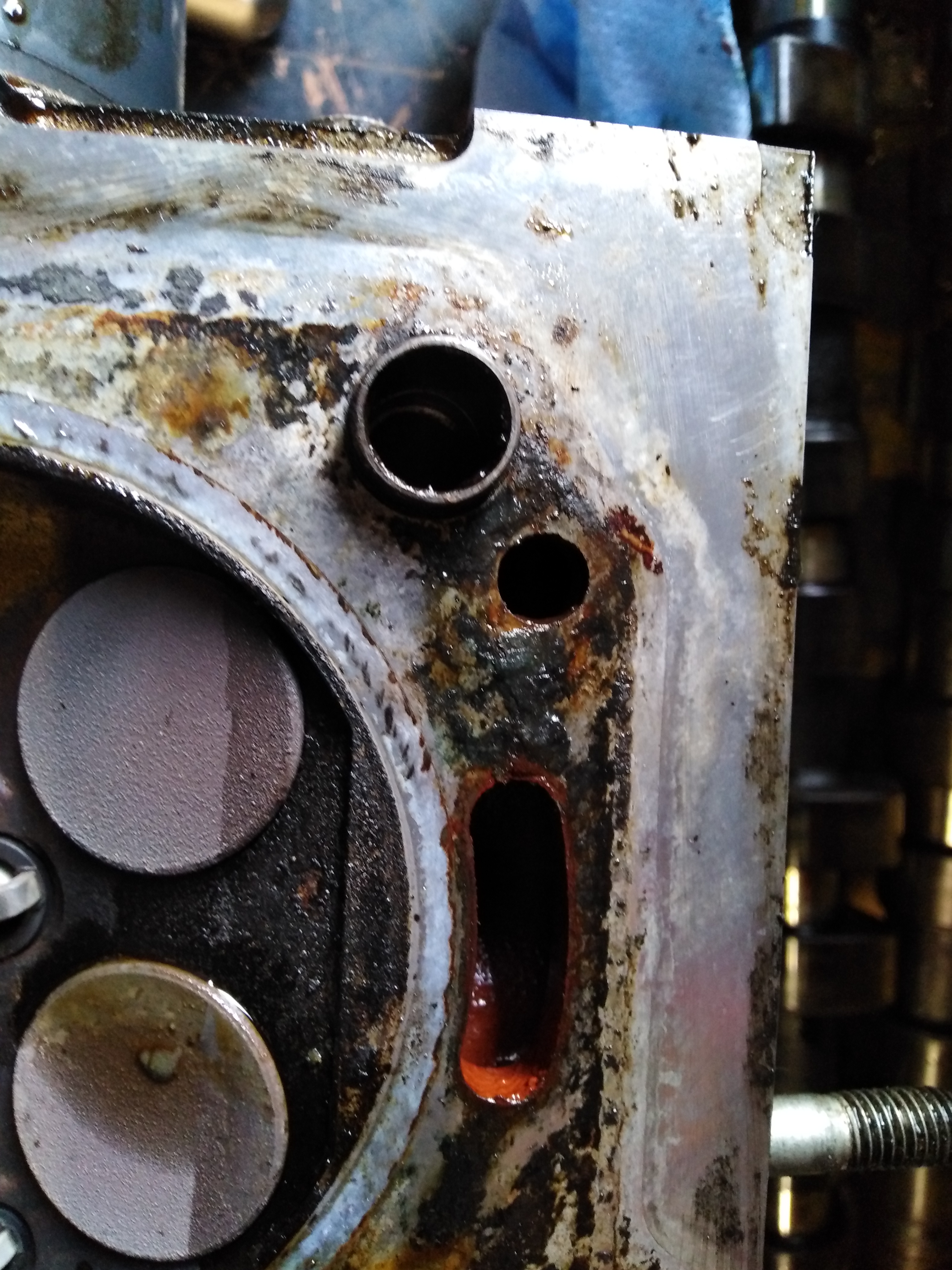

Cleaned off the engine and started it up to see where the coolant had come from.....
Corner of the head gasket :cry:
One step forward two steps back as usual :roll:

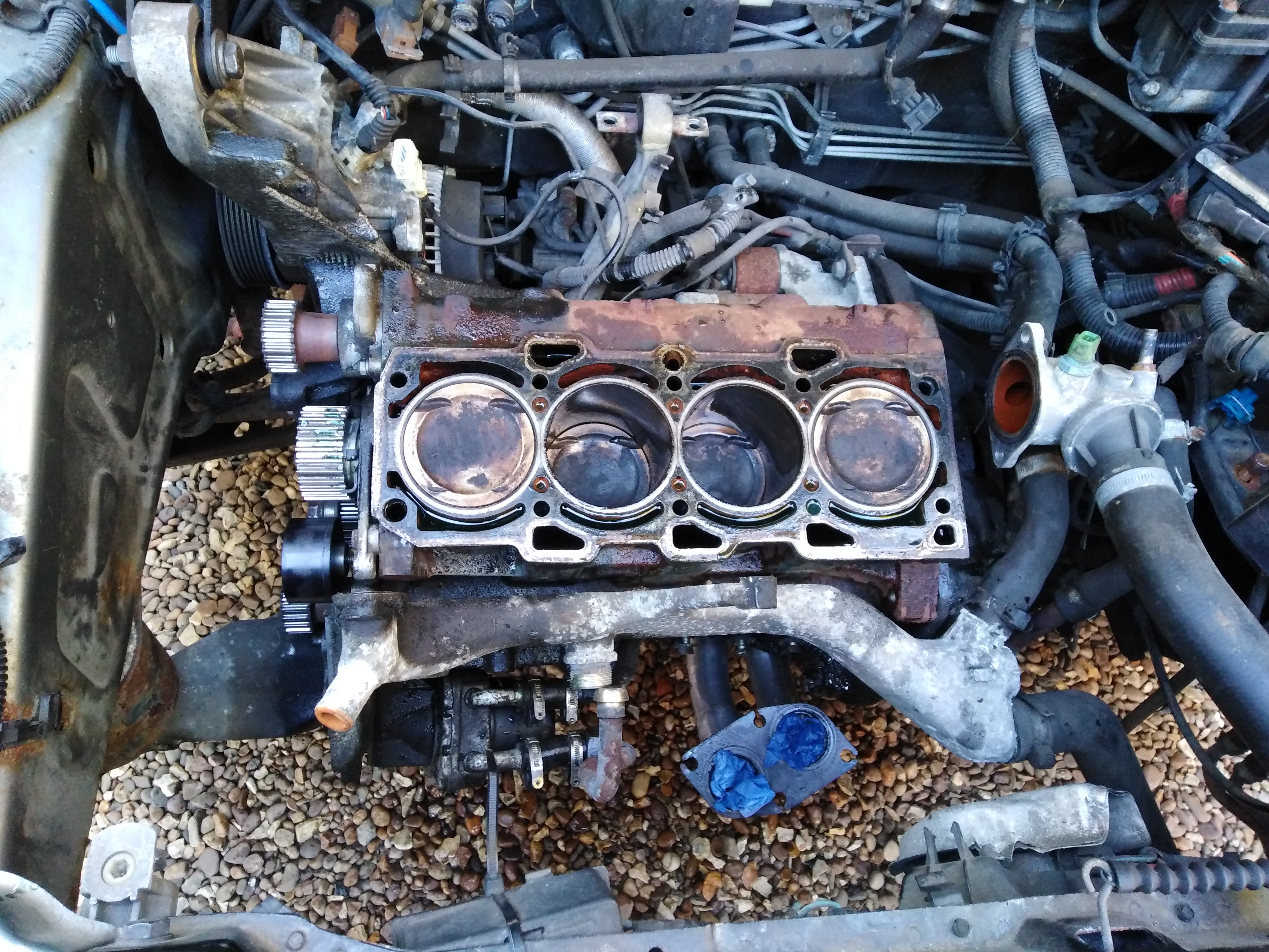

Had planned on doing the cam and balance belts this summer anyway as has been 3 years since I got the little 145.

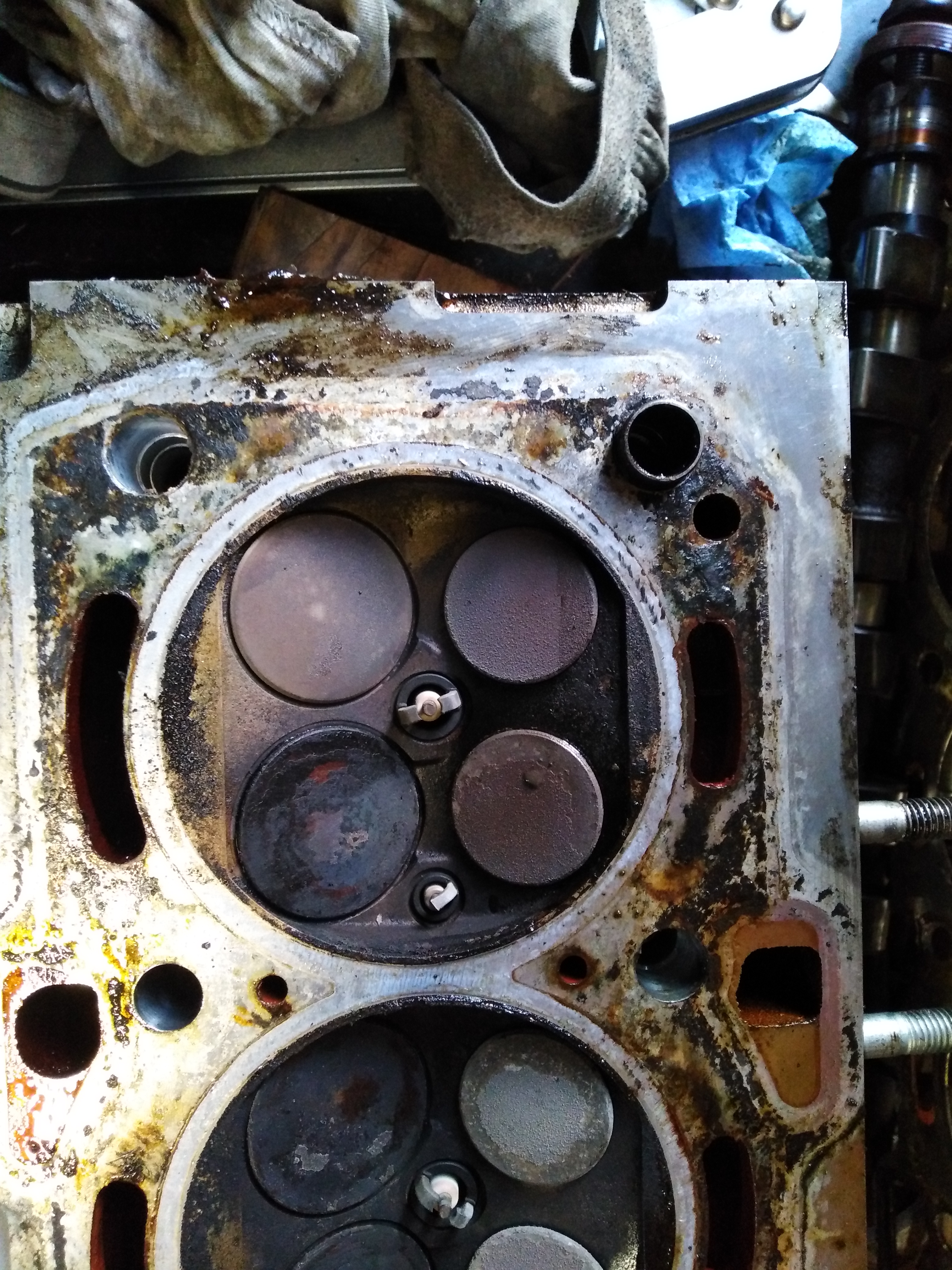

Got the head off tonight and sure enough the gasket has failed on the front corner, belt end.
I'll strip it all down to give it a de-coke, is near 25 years old now after all so if that's the original head gasket it can be forgiven, especially for waiting until a convenient moment to give up teh ghost, could have been much worse! Has never overheated or seemed to use any coolant so should all be well, I'll get the head checked and skimmed as a matter of course but sure it'll be fine.

In my opinion the TS unit is one of the easiest modern engines To work on
I love em . Btw. Kev if you need to remove the variator I have the special tool so just shout
