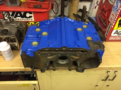

Work in the Body Maybe a bit slow so I’ve made a start on the engine .

Thanks Spacenut . I’ve been painting all my engines this shade of blue for over 30 yrs.

Does look a nice colour.
What paint do you use?
I use hammerite for the blocks as recommended to me by Guy Croft, if it withstands his race engines then it works for me! Goes onto bare metal without any primer or whatever too, seems to last well and be fairly chip resistant also.

Hi Kev. This is a paint by Carplan and is proper engine block paint. I’ve used it for years and never had any problems . After the block was deep cleaned at the machine shop I then treated the block with Kurust till it goes black before painting .
I’ve also found a paint by Granville called “cylinder black” this is also an engine block specific paint that gives a very good std look and gave a great finish and looked like new. I was going to do mine OE black. but then I went to the pub and after several pints of thinking juice i thought sod it. It needs to be my blue .

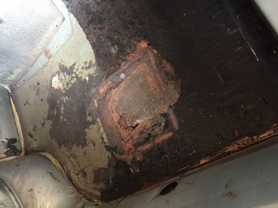

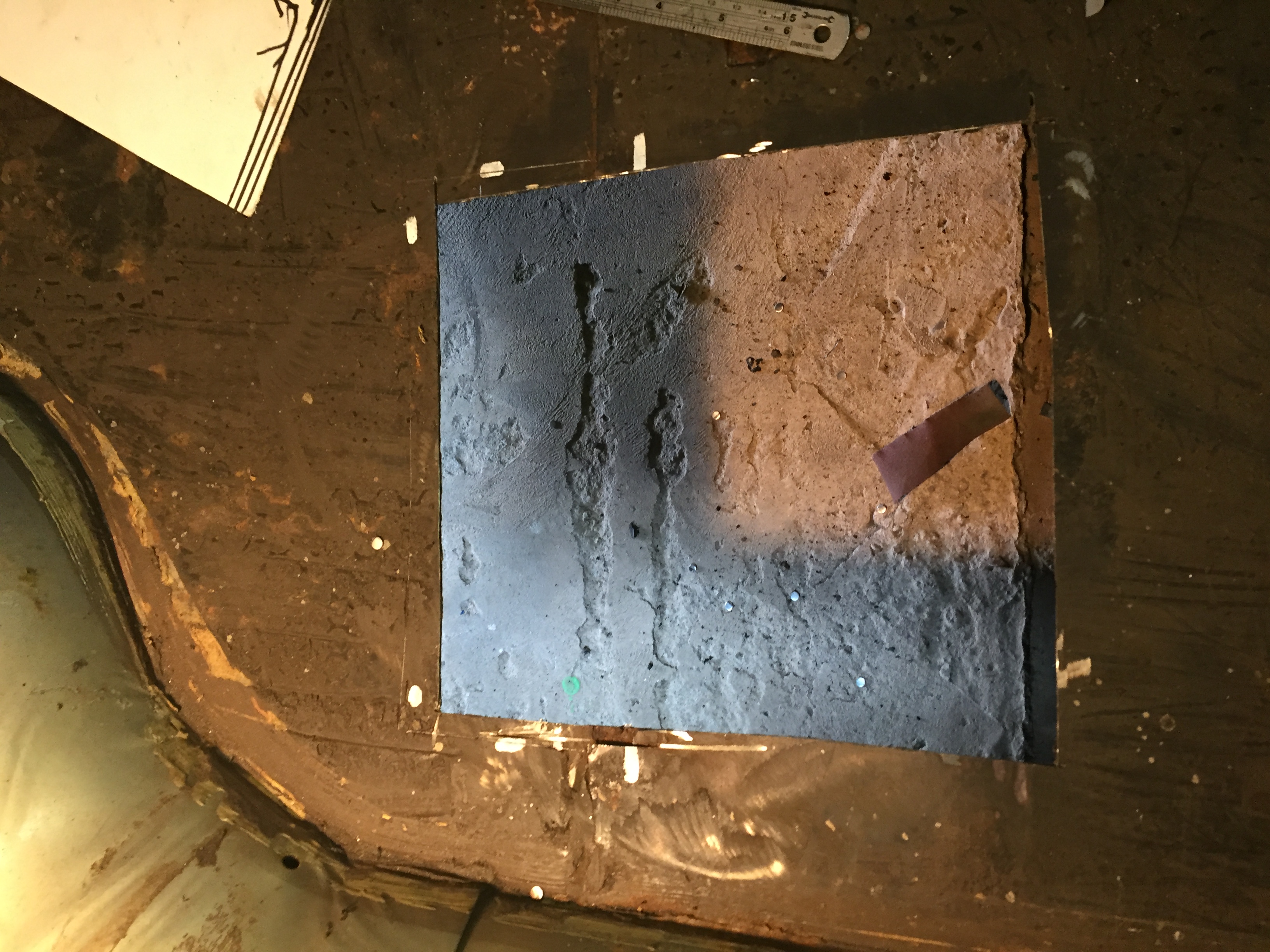

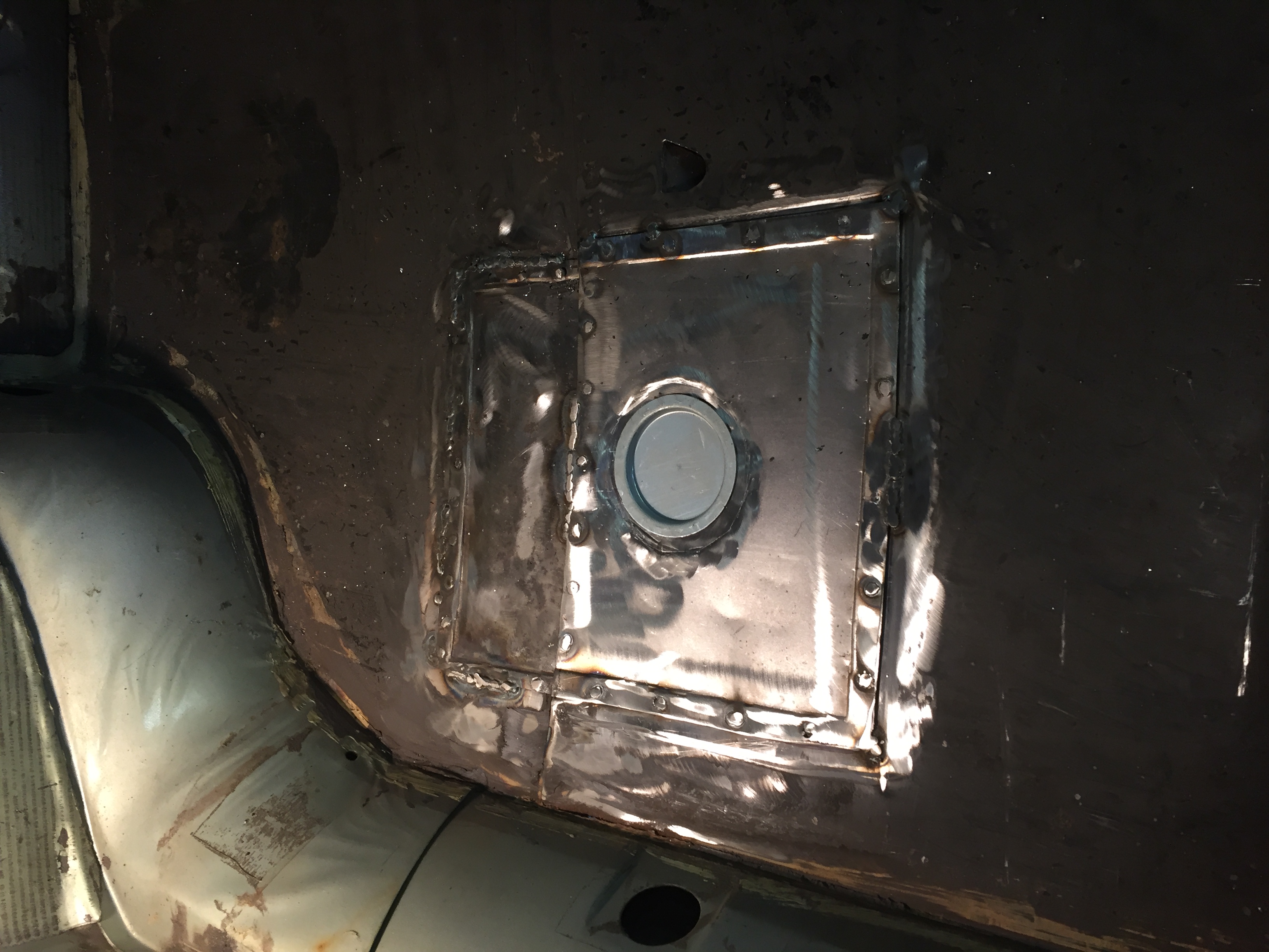

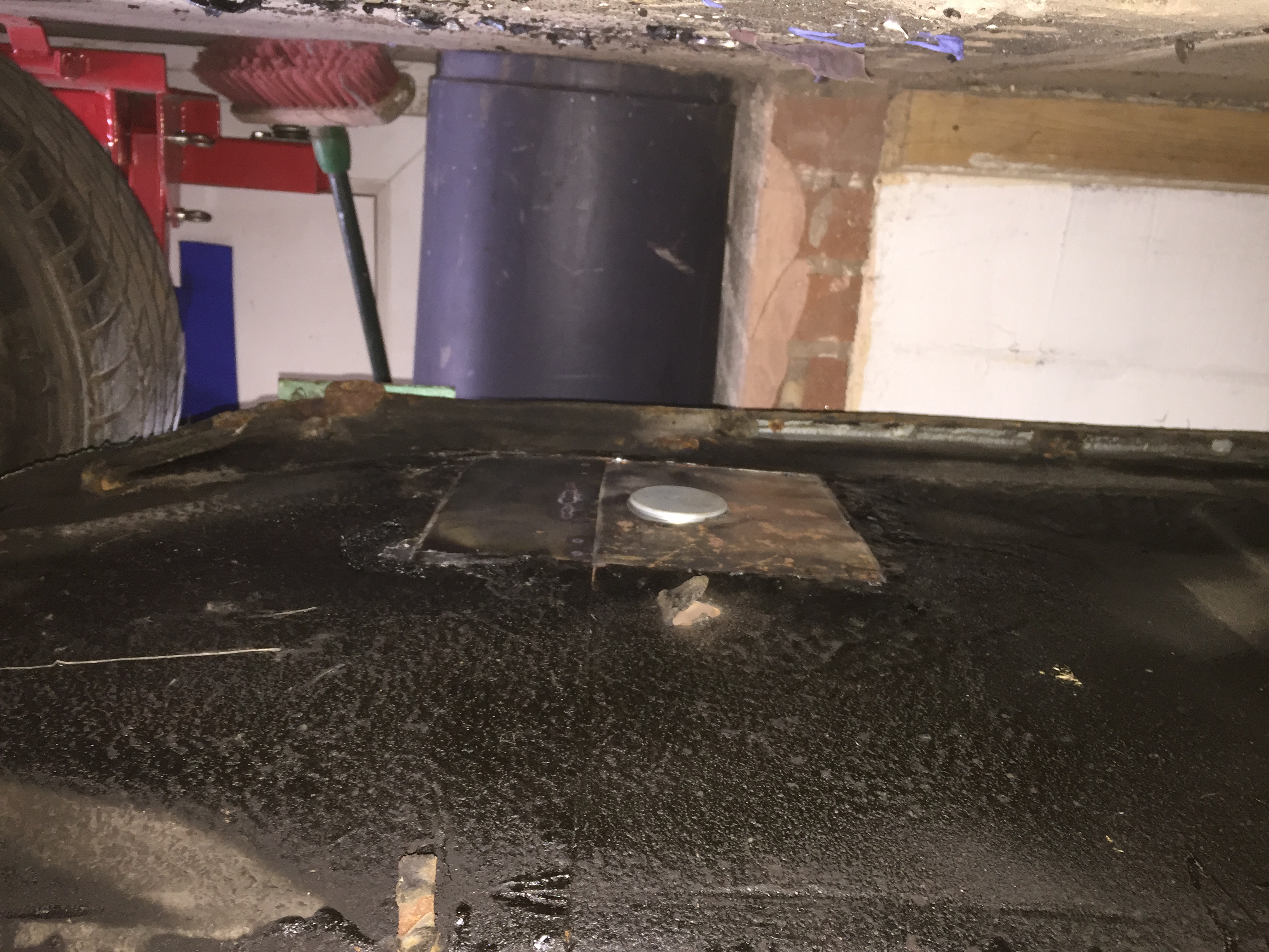

Managed to have a Decent sesh on the Sud today. Decided to tackle the horrible mess that was the NS front footwell.
Ended up Cutting it all out .
And making new panels. I managed to remake the original Seam and Hole. so now from underneath. it’ll look much more like it should do . It will be fully seam welded Before it’s finished

Good work loo
Re: My Sud
Thanks Alfastrut. How you getting on with yours ?
Re: My Sud
I've nearly finished the structural welding. I've got a week off soon so hopefully should finish then. I'm going to try for an mot.. It will look crap but at least I can enjoy it a bit while I pretty it up.

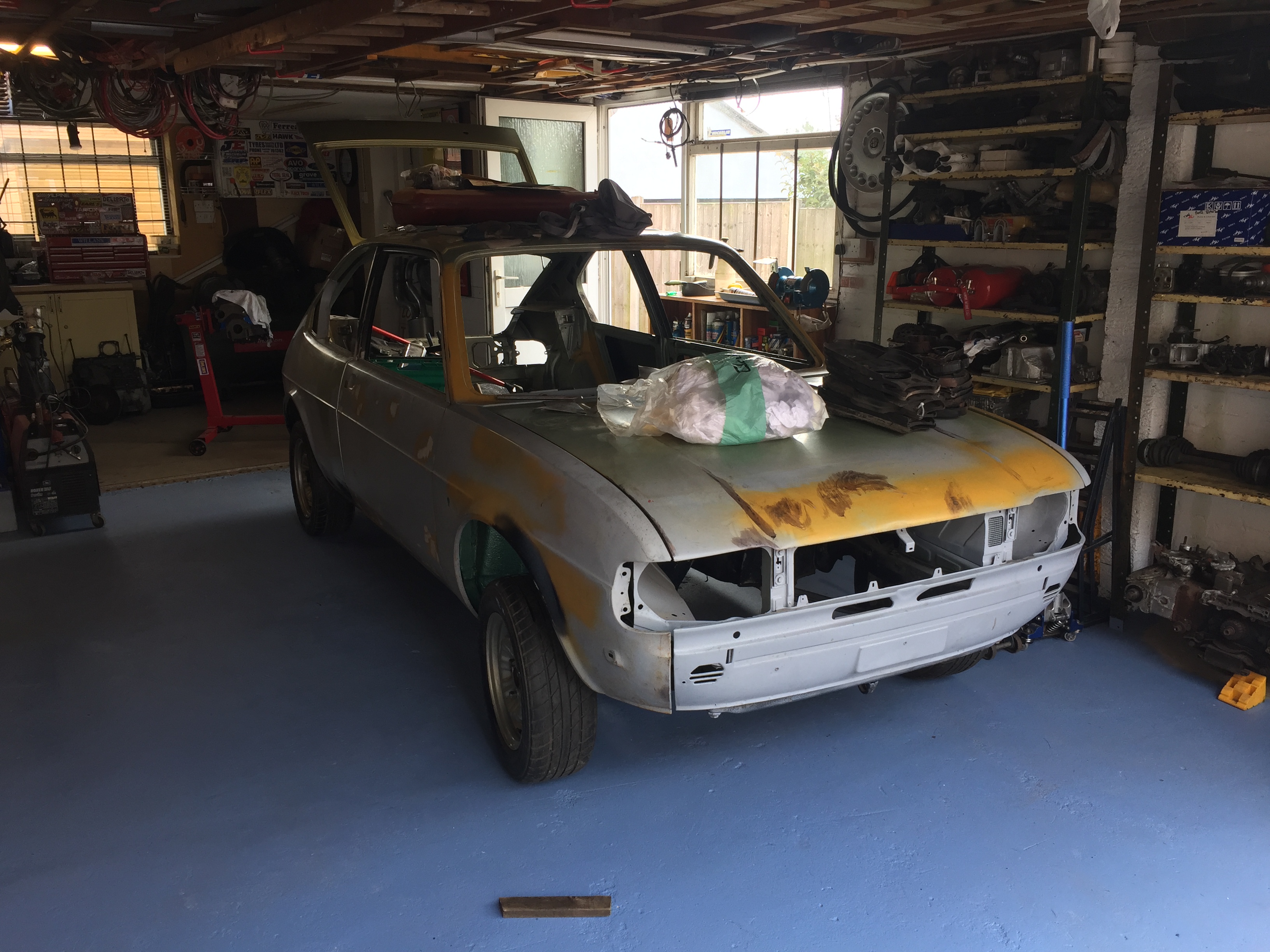

Managed another session on the Sud last week. made good progress on the pedal box area of the bulkhead. It might not look like I’ve done much since starting on the Sud but the work I’m doing is all small bits and pieces on the hidden areas. I’m nearly done on the front part of the car with just a few small areas around the front jacking points then I can turn it round and start in the back of the car.
Also took advantage of the recent good weather to get all the cars out for 3 days and have a good tidy up in the garage. Even managed to paint the floor.
