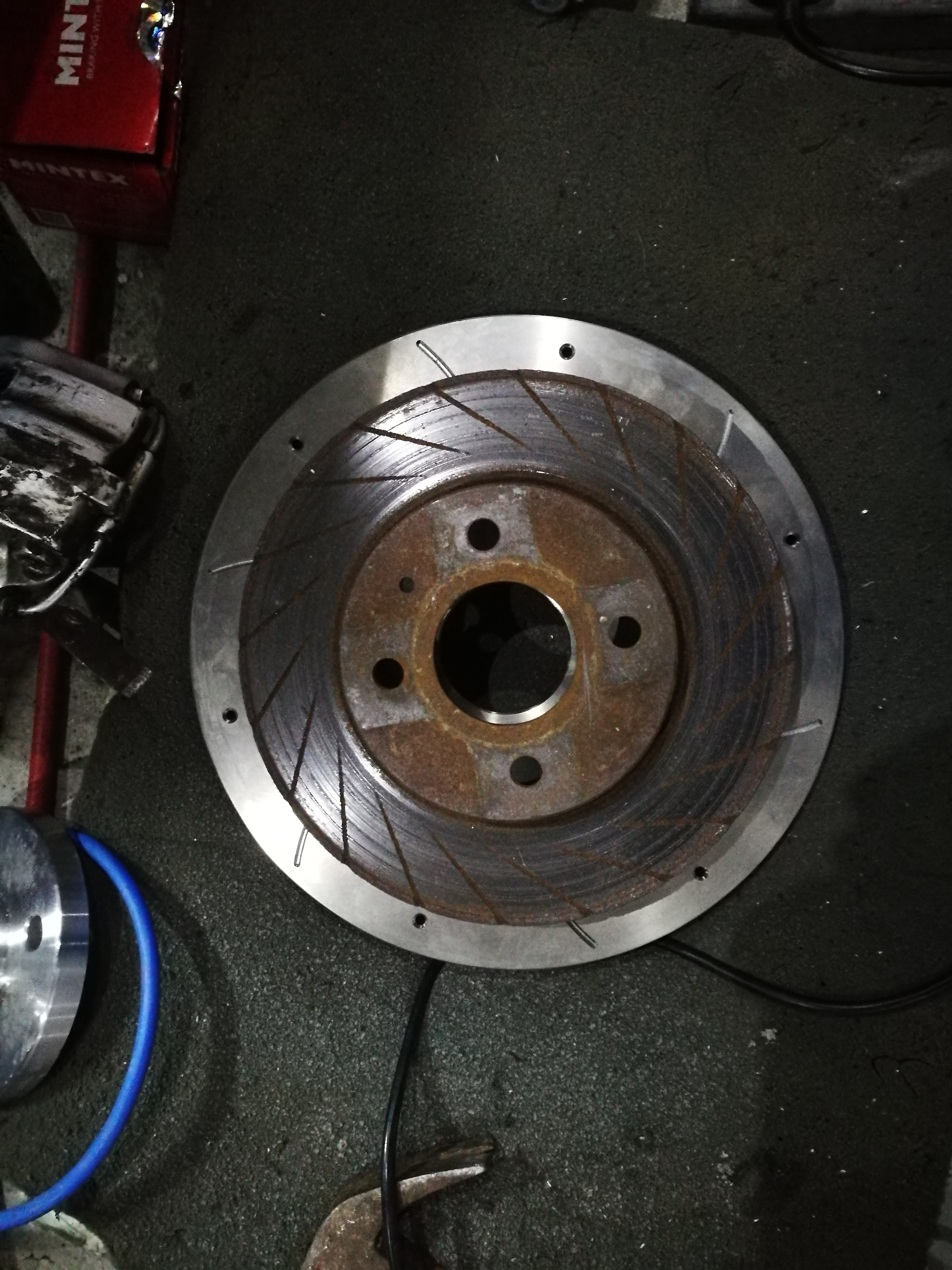

My coupe discs arrived today. So will have a play this week . ;)

Been playing around with brembo calipers this evening. I was thinking about using ally for the bracket . What thickness would you guys use. I've got some 6.5mm plate . I was going to double or even treble up. Is this ok. Or should I just use steel?
Ordered a service kit for them.as one of the piston dust covers was knackered. £23 bargain .

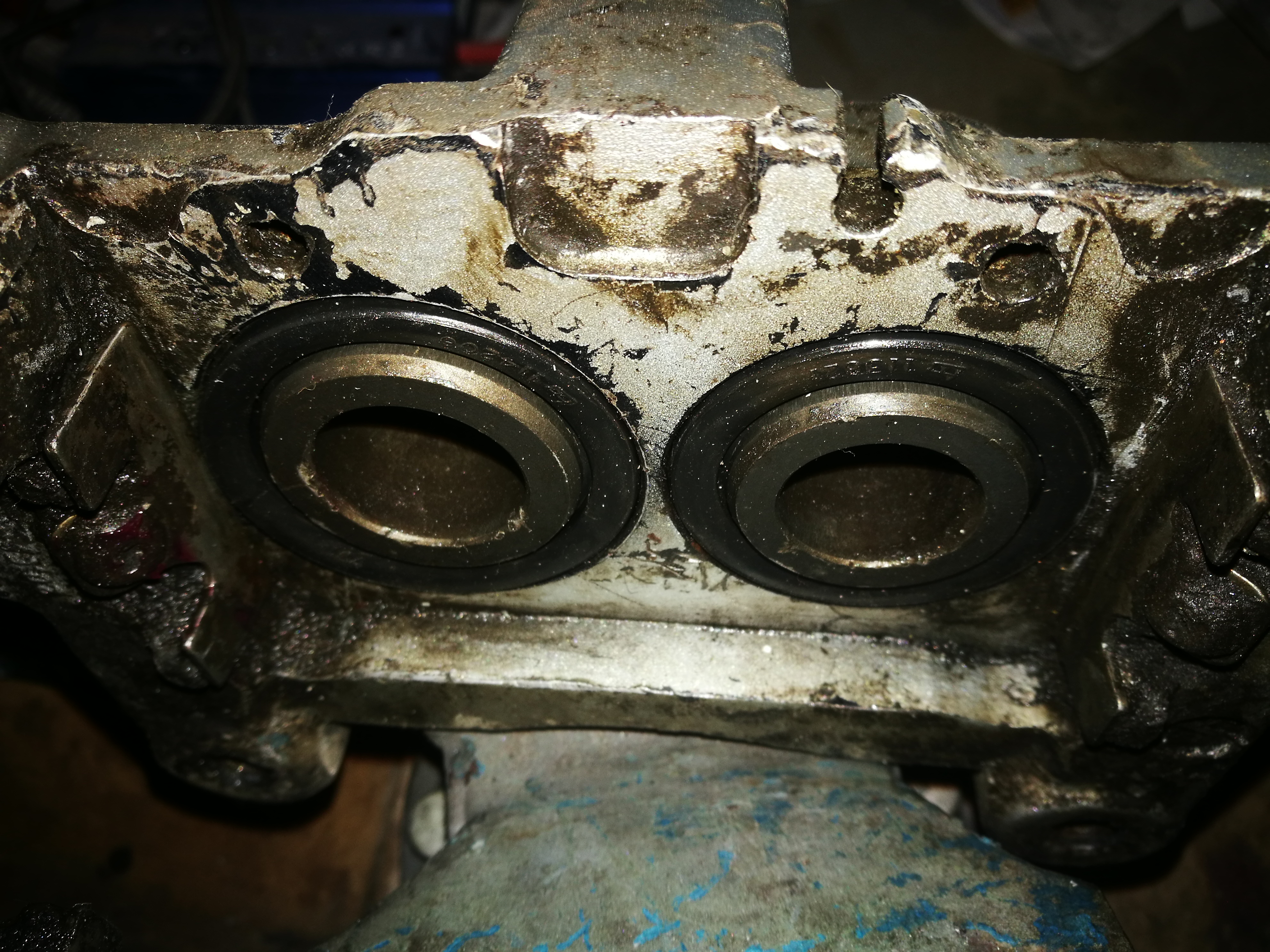

Bit of progress today. Replaced all 8 oil and dust seals on the brembos .One piston played hard ball.but I won in the end. Plus two of the four bleed nipples where seized . One was a pain to get out. The hitting stick helped to free it :D four new one should be here tomorrow.

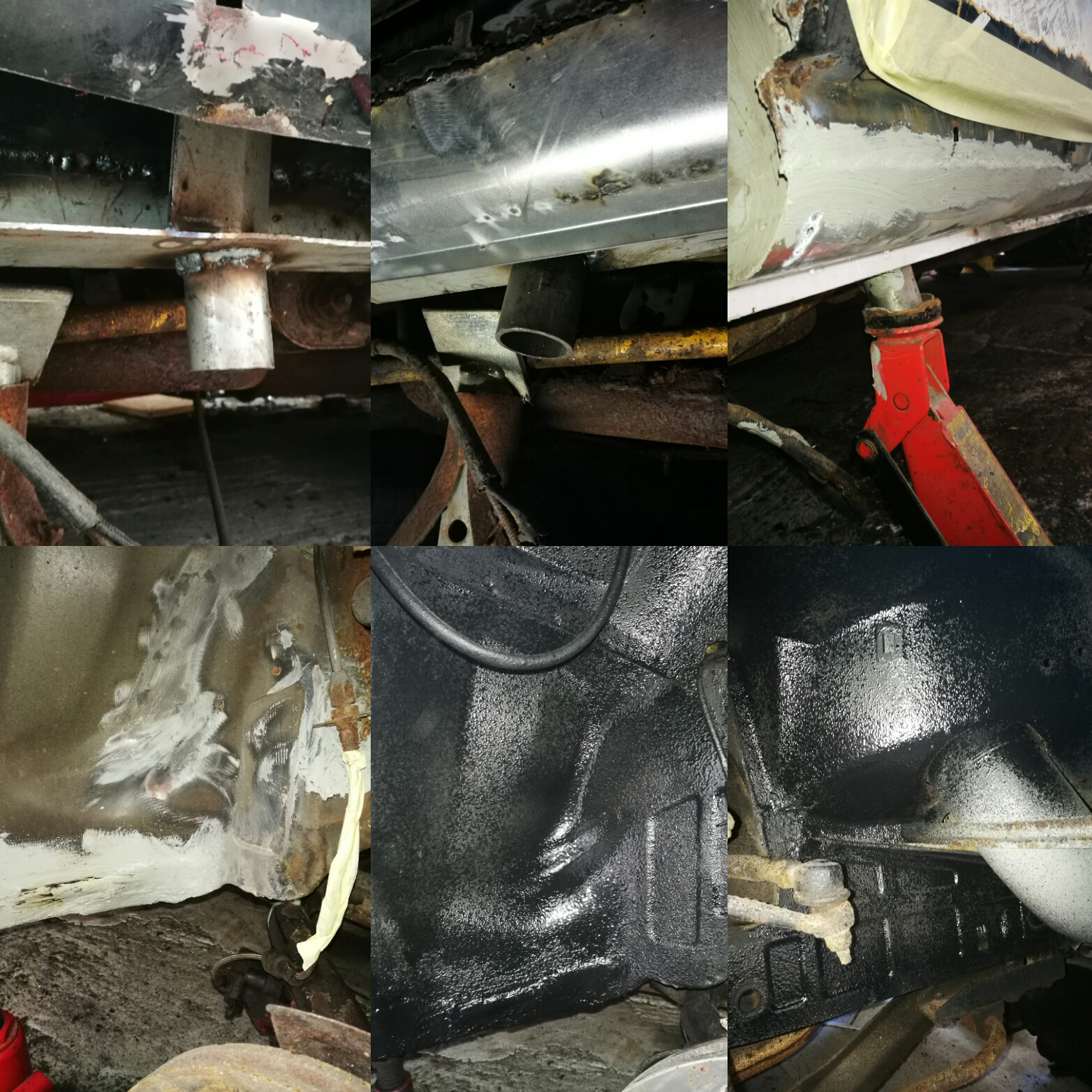

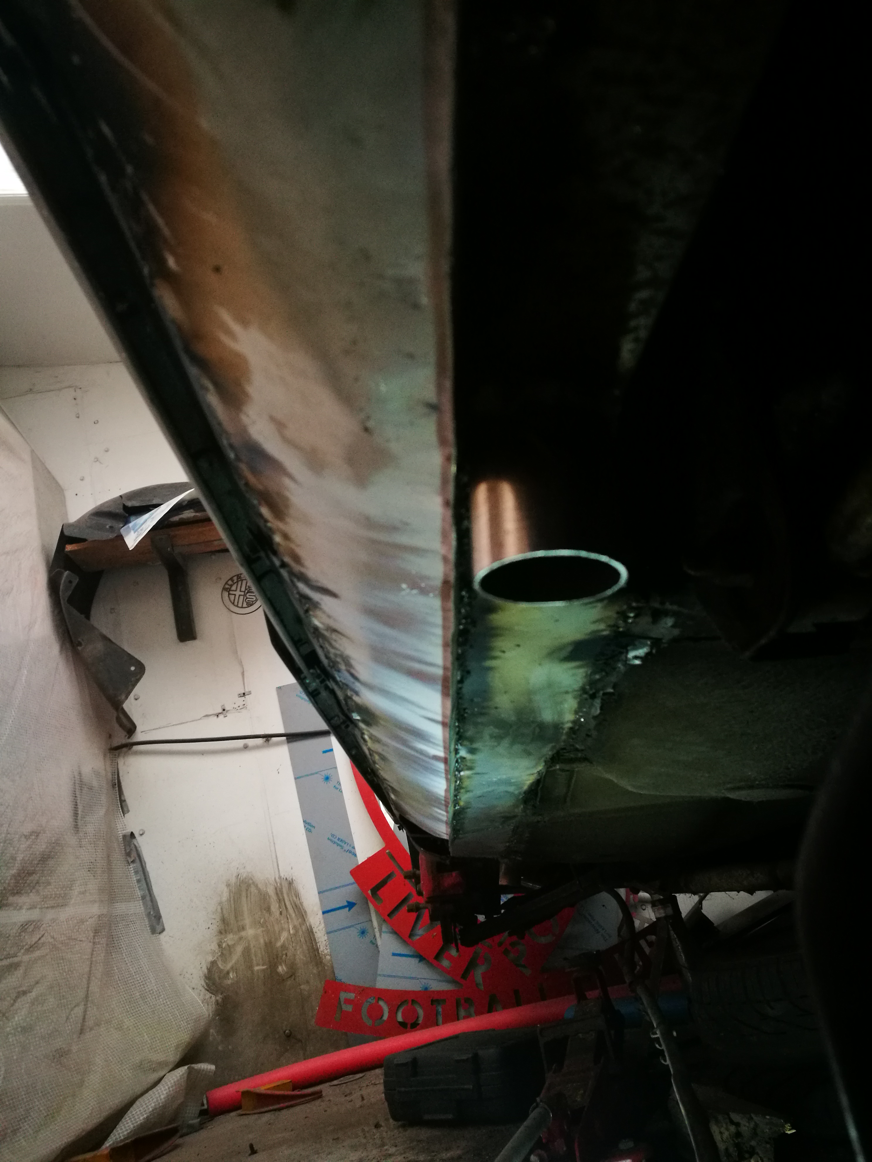

Made some good progress over the last couple of days. Driver's side all welded. Jacking point made with 3mm steel .So nice and strong now .seam silled and undercoated .

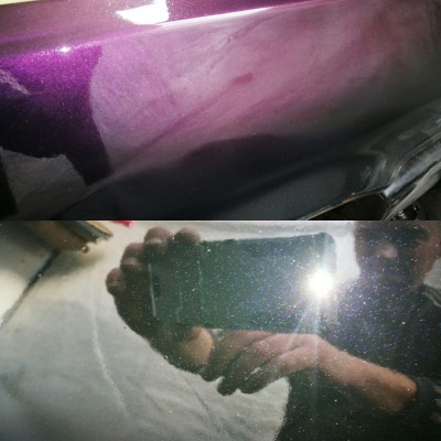

Had a bit of play with pearl ref over the black . But it's to much for to I want . Then sprayed cobalt blue over another panel ,but didn't really do much apart from highlighting the blue flake that I did years ago.
This is a long way off . But want to find something to lay over the black.

I like the purple colour..... :shock:
Re: Alfa 33 s2 16v Resurrection
Veesix75 wrote:I like the purple colour..... :shock:
Yeah it is cool . Red pearl mixed into clear over the black .

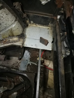

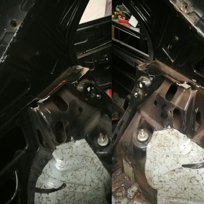

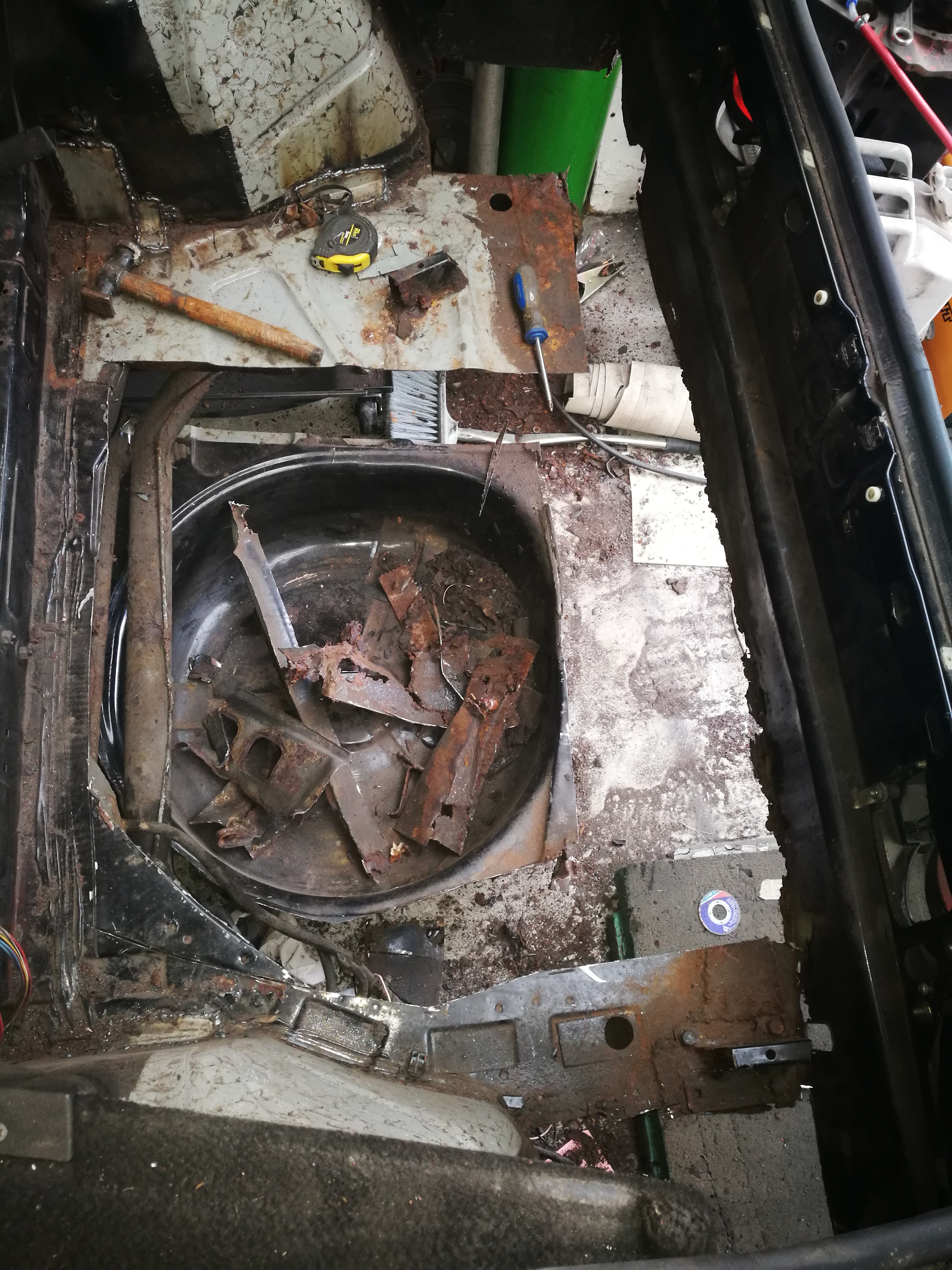

Just a little update. Attacked the boot area yesterday. Cut out most of the rust, plus the wheel well.to put an ally sheet in . That's minus 10kgs for that :D I'll weld up the corners and other bits in the week .

looks like that bootfloor was prety bad round the edges?

Hi adie
Yes it wasn't good . Passenger side was a bit better . But i want to start fresh . Ironically the spare wheel well. Was the best bit :lol:

Bit more done today evening. Welded in one corner.plus welded some box section in. As i was given a heads up about the rear trailing arms flexing as I've cut the boot out . So this should brace it now . I'll finish the other side tomorrow.

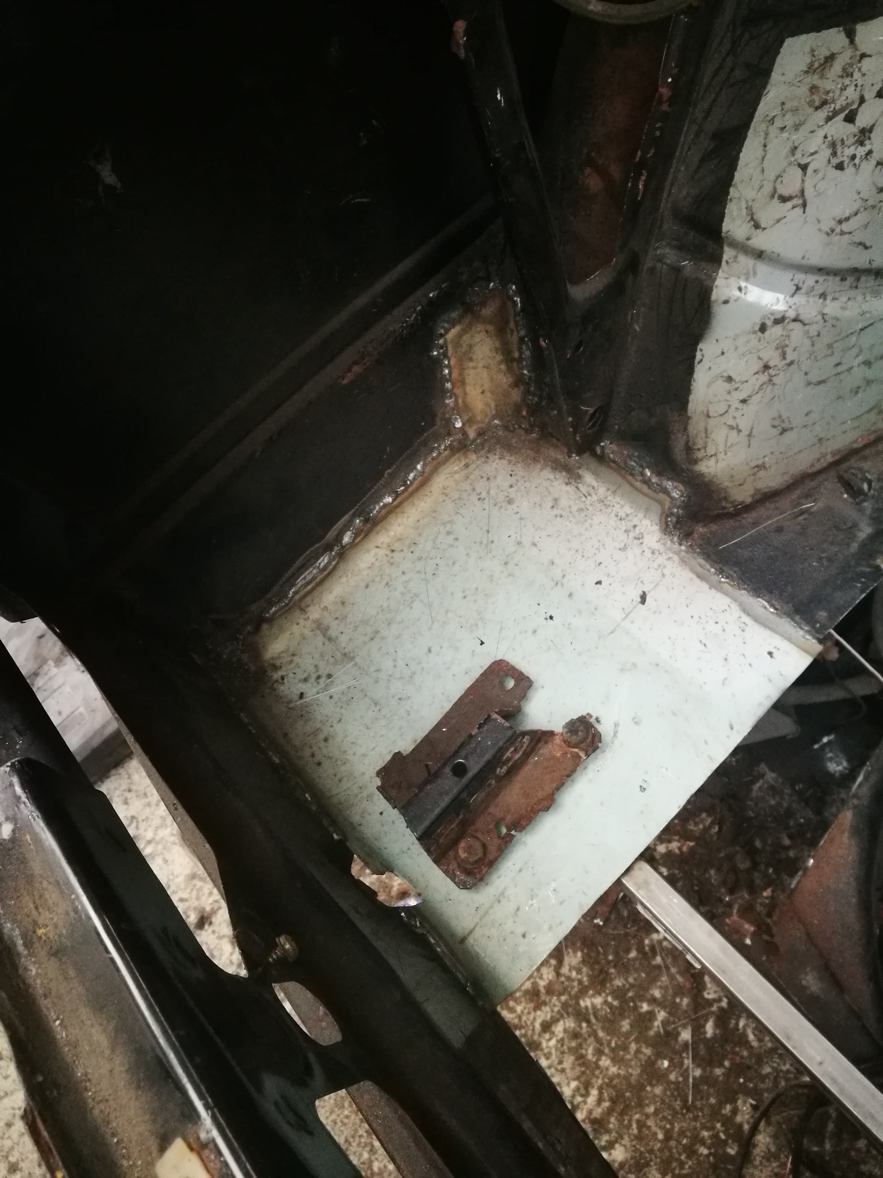

Evening chaps
The boot is basically done. Bar the ally Sheet.
Cut out the metal where the parcel shelf sits too .

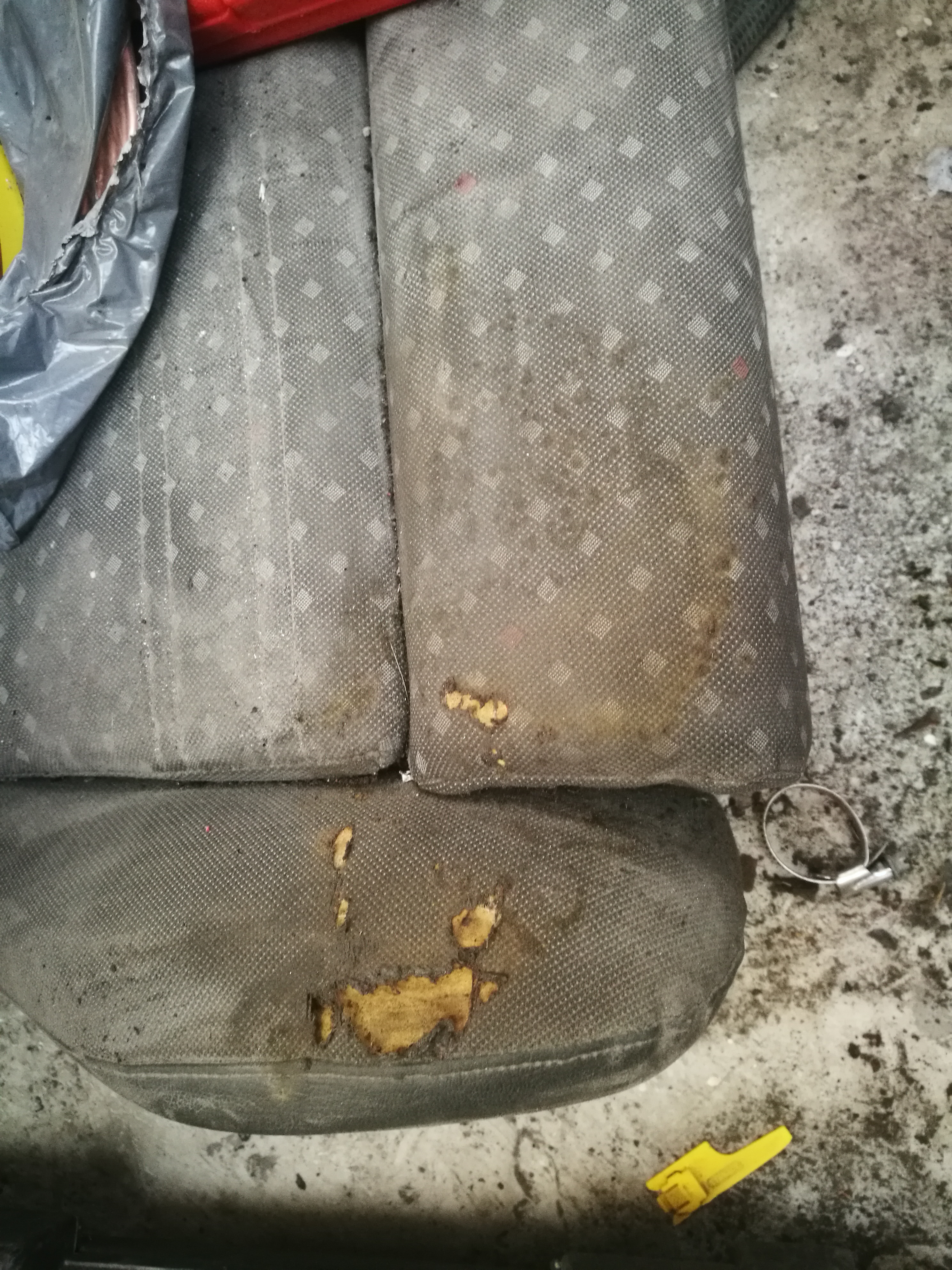

The only negative day was while welding in the boot corner . Splatter landed on some foam which was on the driver's seat next to the car :( so pissed off. Was going to sell them as I'll be fitting bucket seats .When i find some . Hey ho :roll:
bugger, that's a shame about the seats mate :( I do have a pair of very good race buckets though if you want a pair.....came from Ades' rally car, had them (still are in in fact) in the 16V sud that shrew now has...

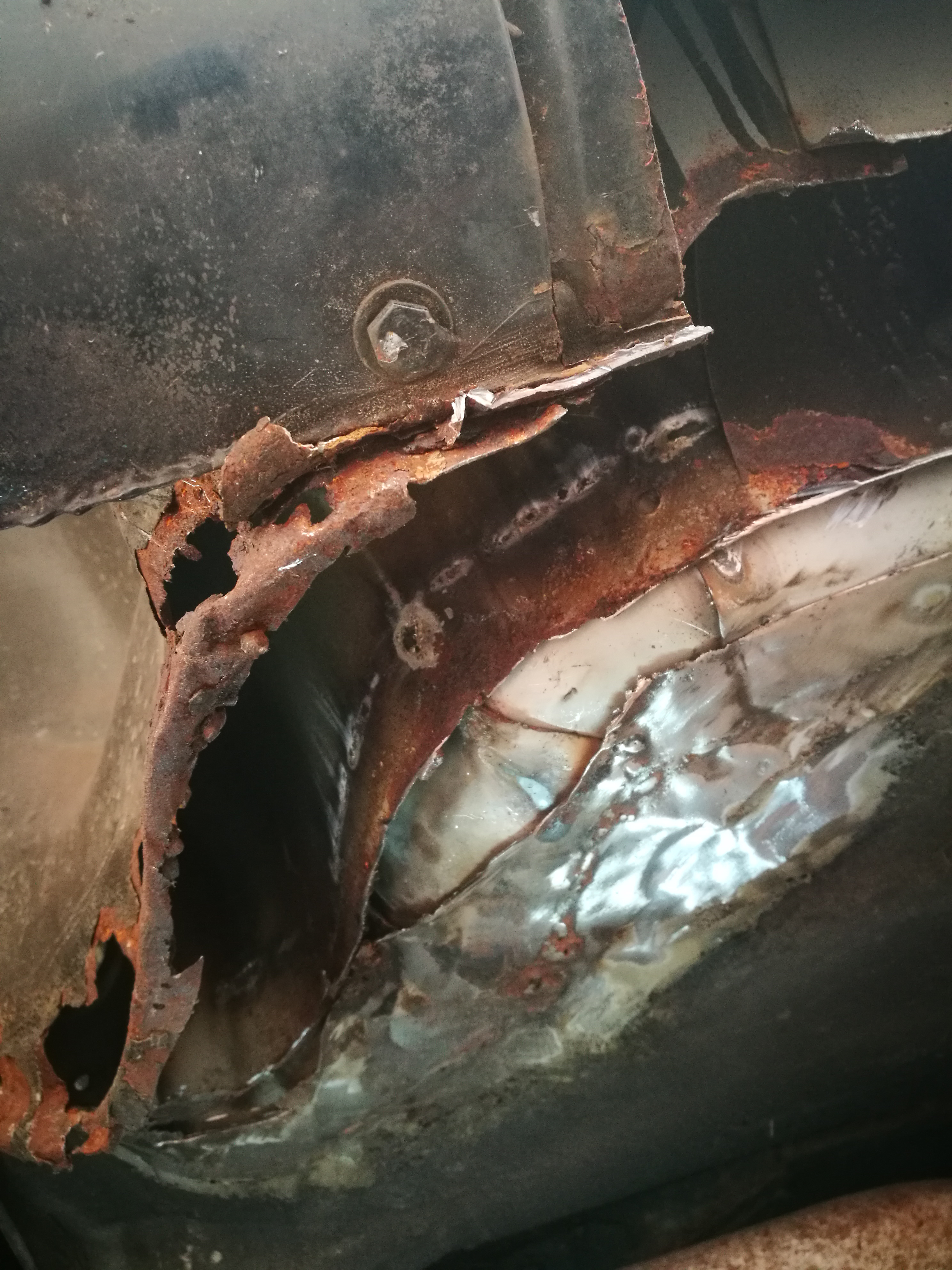

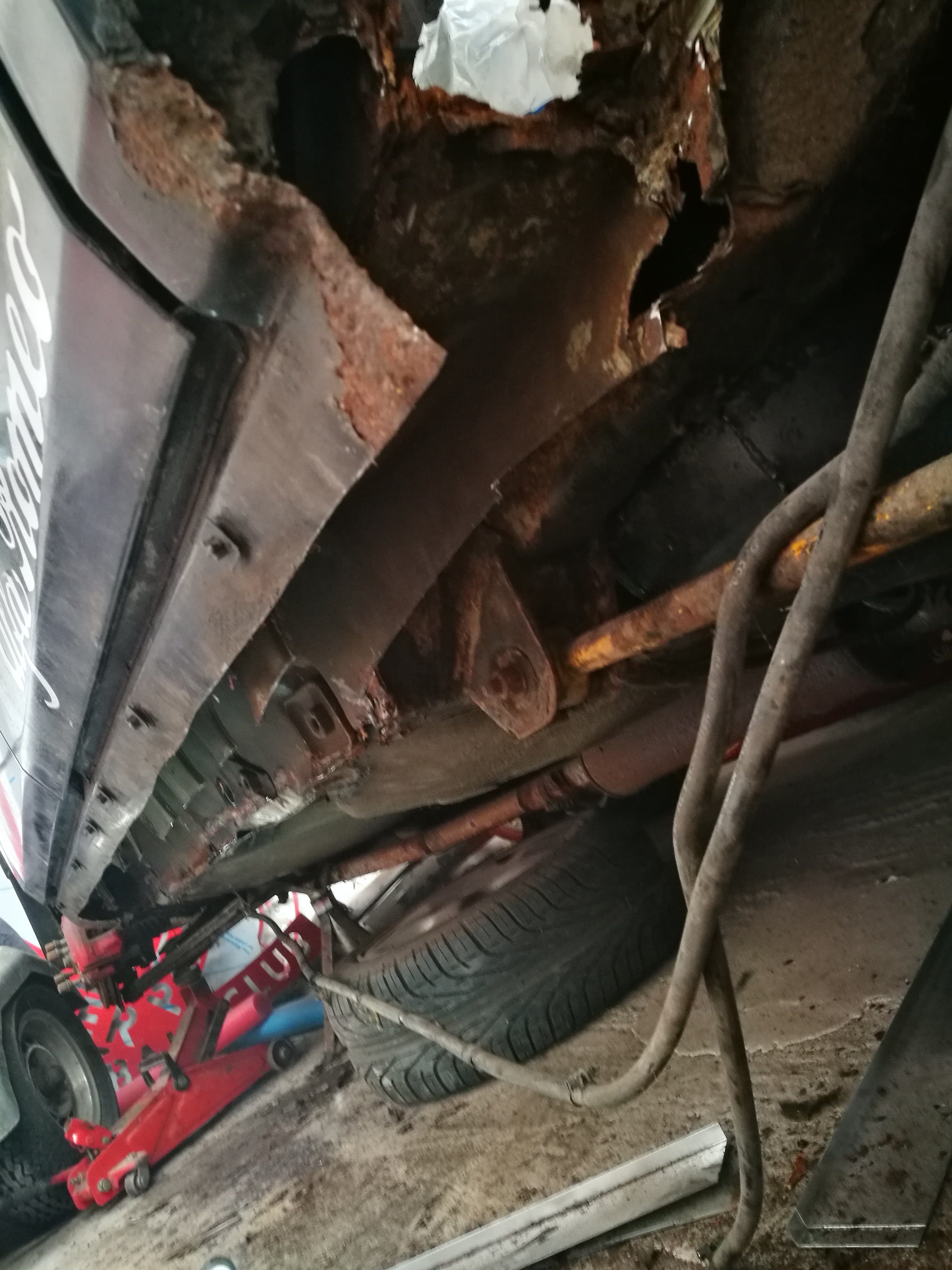

Saturday I cut out most of rust on the passenger side including the jacking points. This side is a bit worse than the other side .but there's not much in it :|
Need to just concentrate on the welding and ignore everything else it needs. But really want to build the 1.8 block I've got . But that's going to have to wait. All about the welding for now .
So today I got the welder out as I've been let down a job I was doing this week . Classic Daimler V12 for some bodywork.

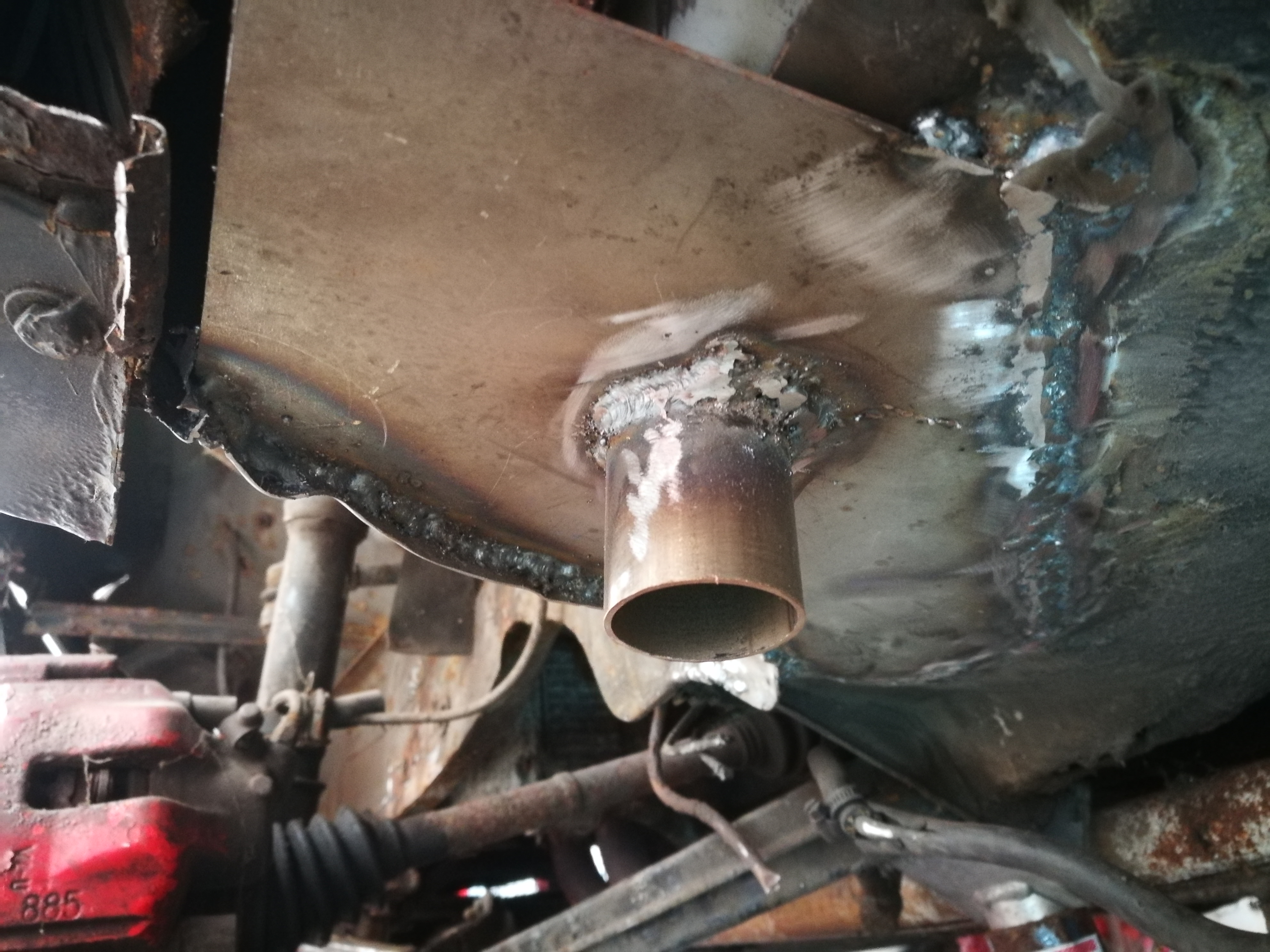

So the Alfa now has three jacking points. Nice and strong with 2mm steel . Plus welded up the inner arch too as your see in the pics . Tomorrow I'll hopefully get the rear jacking point and maybe the sill :shock:

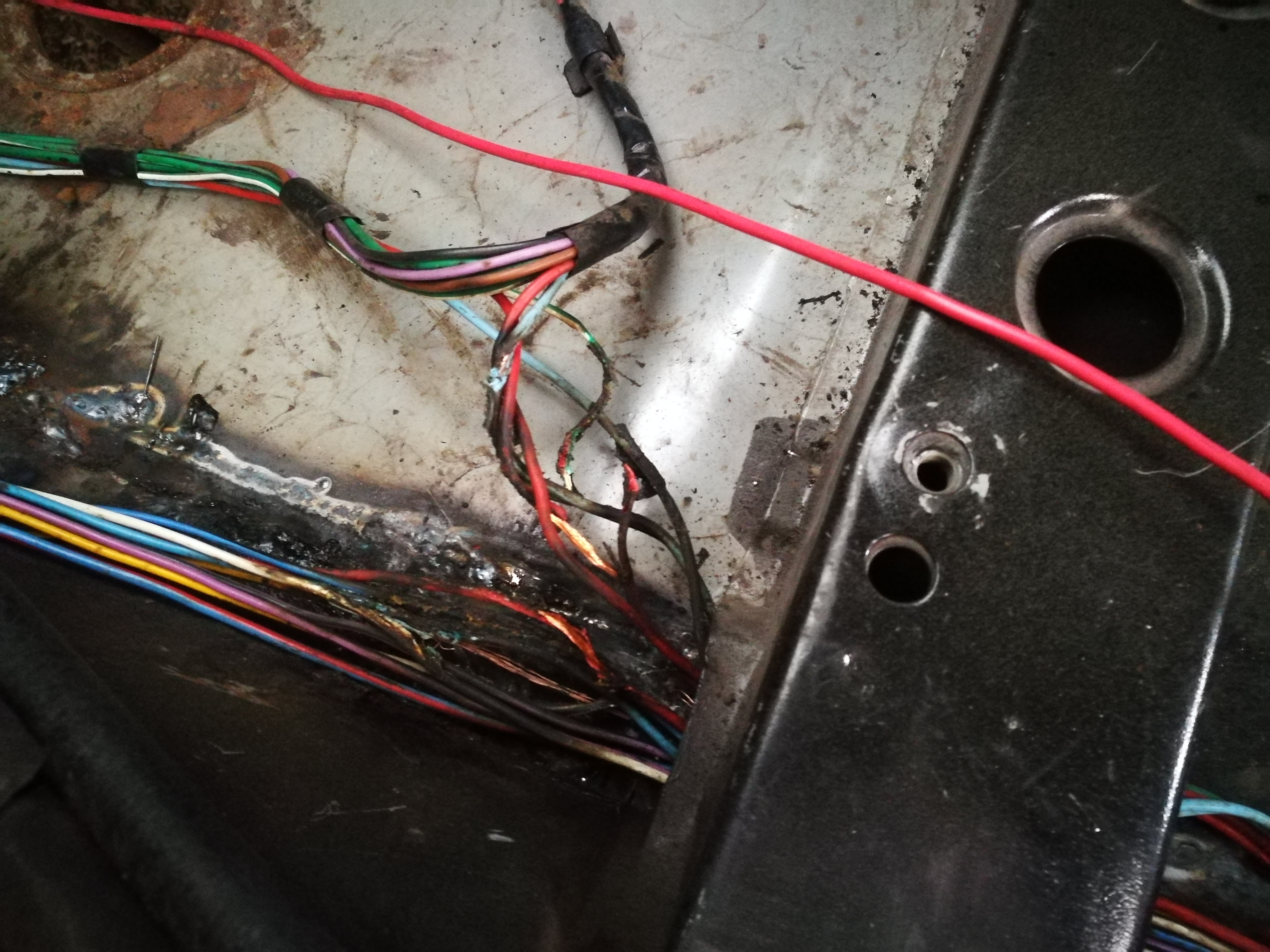

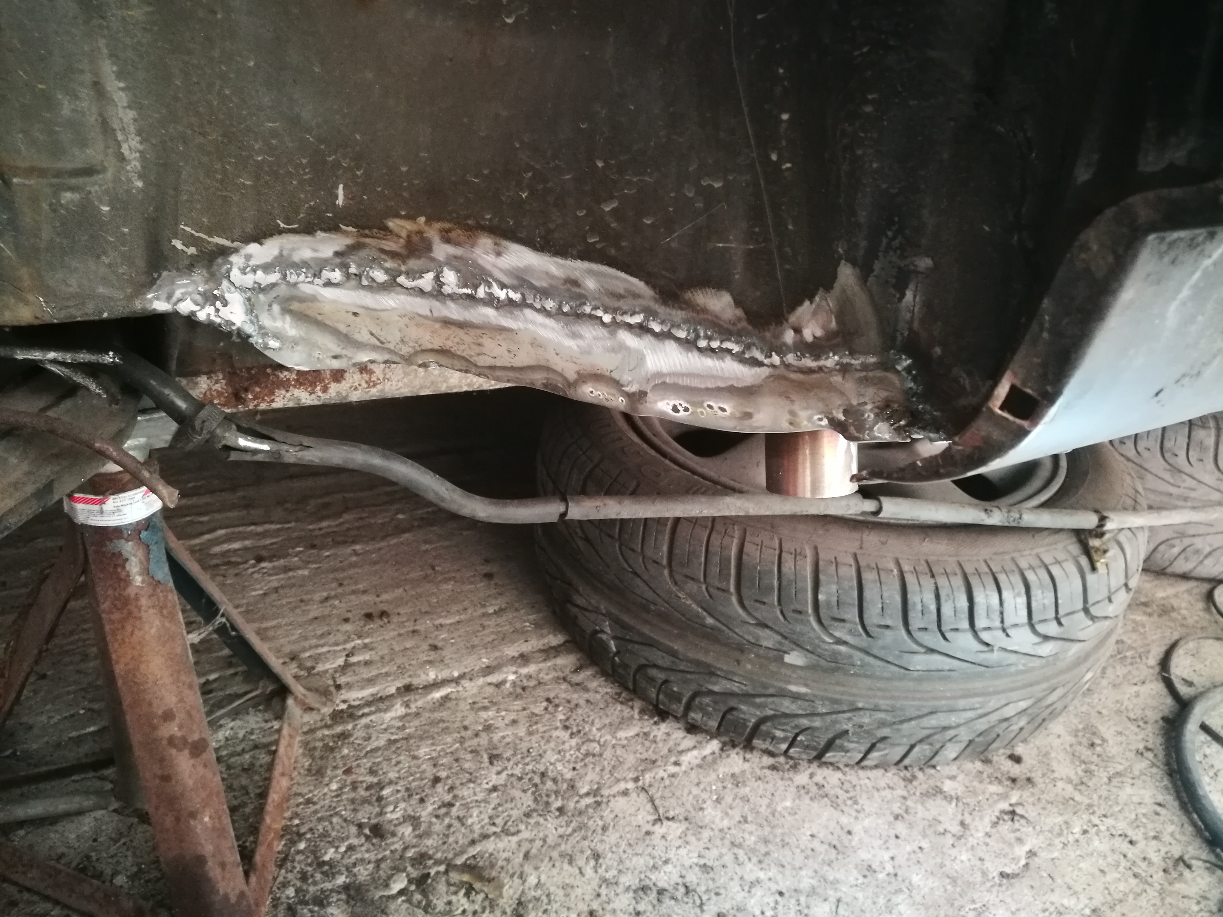

Rear jacking point done . Floor done .two thirds of the outer sill done . Plus got to weld a piece in rear inner arch too .Only negative was i melted part of the loom :evil: I'd put a piece of metal under the wires to protect them .but when I was hammering the floor into place ,the metal moved . So I'll have to cut in new cable.

Easily done JB.
Good job our old cars don't have big looms.
Good to see you're getting some time in on the 33. :D

Kegsti66 wrote:Easily done JB.
Yeah thank god it's not cambus :lol:
Could have finished the sill this evening,but I was loosing the will to live. Getting fed up welding on my back , and getting burned :lol: but at least the end is in site now :D
