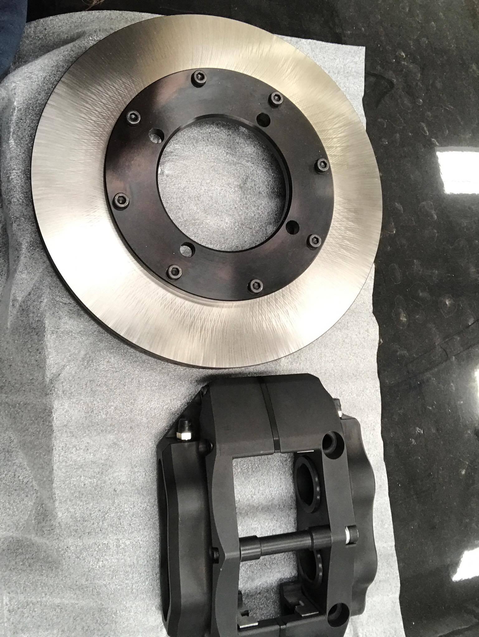

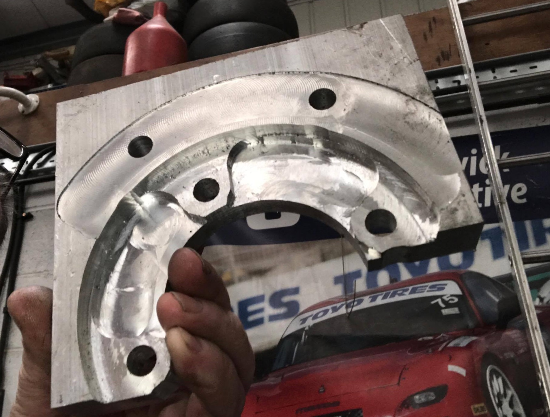

Believe it or not the car is coming together and I hope to have a decent update with pics soon. The hold up at the moment is with the HiSpec callipers but that will hopefully be resolved soon.
In the meantime here is the 4 pot calliper mount coming together for the inboard brakes.
Re: Alfasud racecar build
By my time scale your doing very well, and all the little details just absorb time. Keep us posted as most interested. :D

Brakes finally arrived. Things should move quickly from here (hopefully)

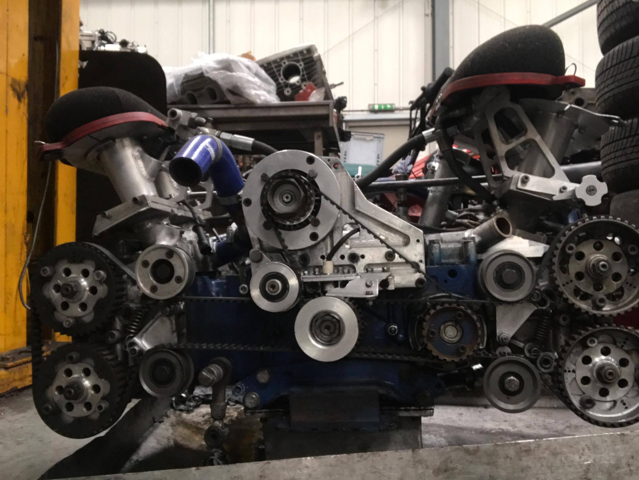

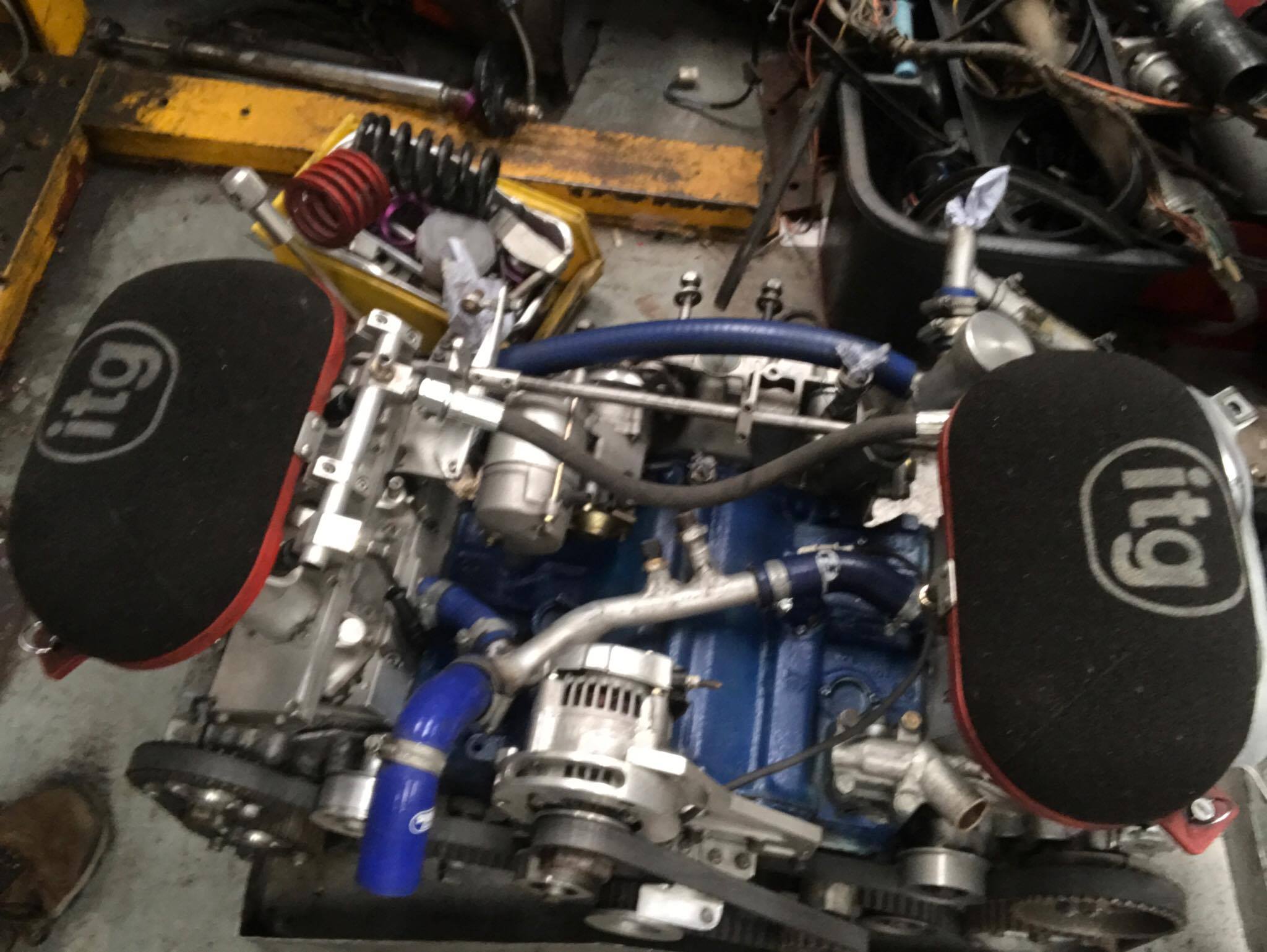

Engine ready to go in. 1910 cc 2?? BHP @ 8500 RPM. Steel crank and rods. Forged pistons. Custom fuel injection with slide throttles.
That's going to fly 8-) love it :D
That is one awesome car you are building.
Good luck with it all. :D

Posts: 801
That looks a pretty serious piece of kit.
Did you make the angled manifolds all up yourself?
garygecko
Posts: 126
Post by garygecko »
They came with the engine. It is all Lahoma Engineering (John Sismey) stuff.
Posts: 801
You can see theres a lot of bespoke stuff gone into it.
should be a helluva tool :twisted:

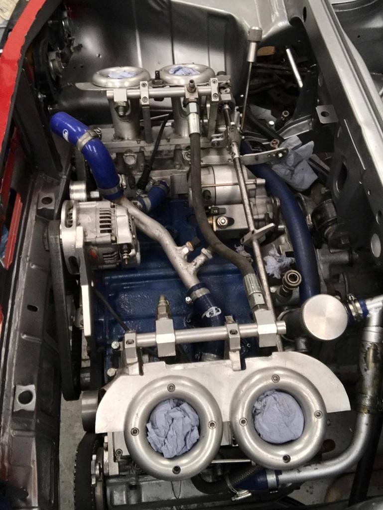

Engine and box now in.
Posts: 976
Post by Marlow Sud »
That is going to be seriously quick. All beautifully done. When you first take it out...............

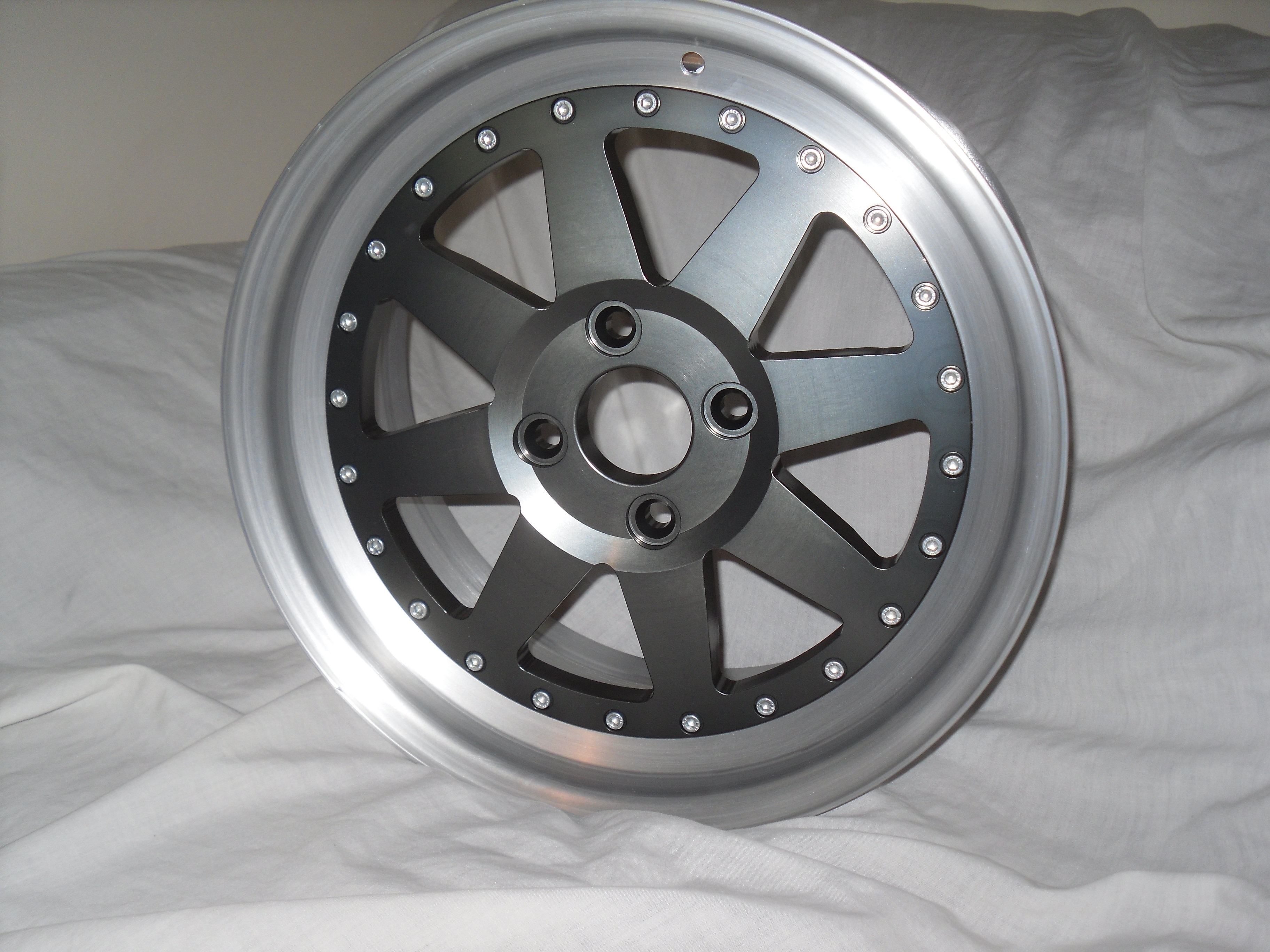

New split rims!
Very nice!
What width and offset are you going for?
garygecko
Posts: 126
Post by garygecko »
petrolhead wrote:Very nice!
15 x 7
Pos offset 38mm
Hub centre 58mm
PCD 98 x 4
