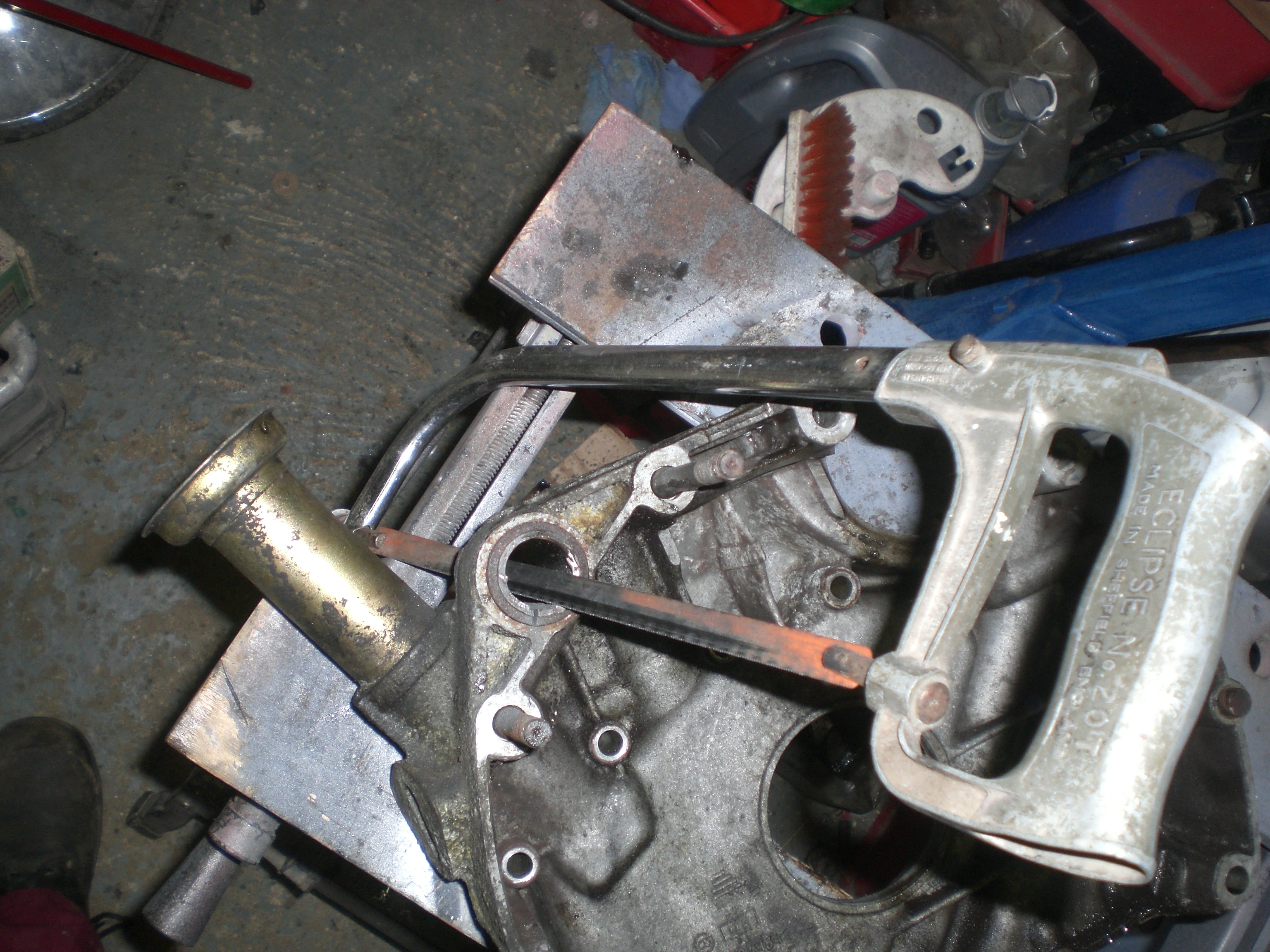

without the grease between the slave and the alloy housing corrosion soon sets in.
I've had to literally smash them out before.
this was one on my 33 that took a stab or two with the angle grinder then a hacksaw to split the casing of the slave.

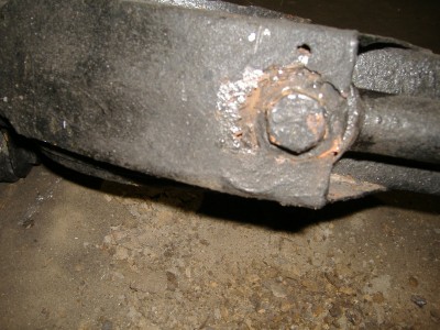

I'd always been in half a mind to replace the rear beam axle with a galvanised unit for longetivity so had allowed for this possibility in the rebuild.
Well, the rear suspension was dropped complete with springs and arms but leaving the dampers in situ. This is when it was noticed that both of the spring seats on the beam axle were in bad shape with a bit of cracking around their bases.
More worryingly was evidence of a botch job having taken place previously as a repair had been attempted using car body filler! Unbelievable but regrettably true. :x
So, for safety's sake the beam axle will indeed be replaced with a galvanised one after all, which I ordered today from John at Justsuds.
I can't understand the logic around this scary and unsafe botch job. One question; why? :shock: :roll:

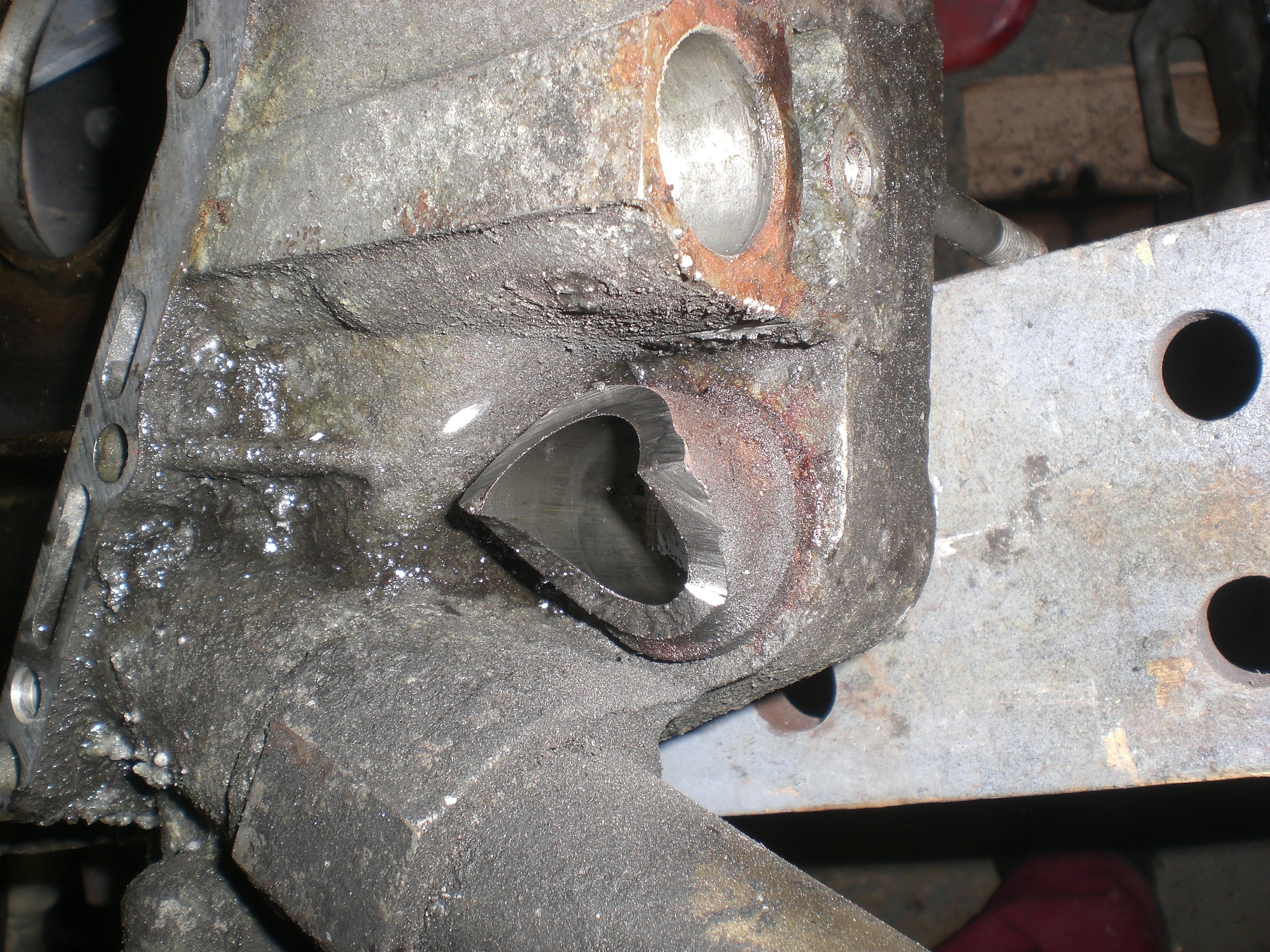

Rear beam axle dropped complete with springs and suspension arms but leaving the dampers in place.
Cracking to the base of spring seats on the beam axle. And yes, that white chunk you can see is a piece of the body filler used for a previous attempted botched repair. :o :x

With further inspection, it seems now that my decision to replace the rear axle was the correct one.
Metal fatigue and a partially seized bush had caused cracking around where the suspension arm connects to the beam.
Could have been nasty!
Alfamet
Posts: 441
Re: It begins...
Post by Alfamet »
I'm glad that the botched repair to the rear axle was spotted.
The spring and rear shock absorber could've gone through and come away from the axle at any time. It doesn't bear thinking about really.
The same goes for the suspension arm, which could easily have become detached while on the road.
Best to be philosophical. Rather I found this now than at 70mph on the motorway. The consequences could've been dire....
