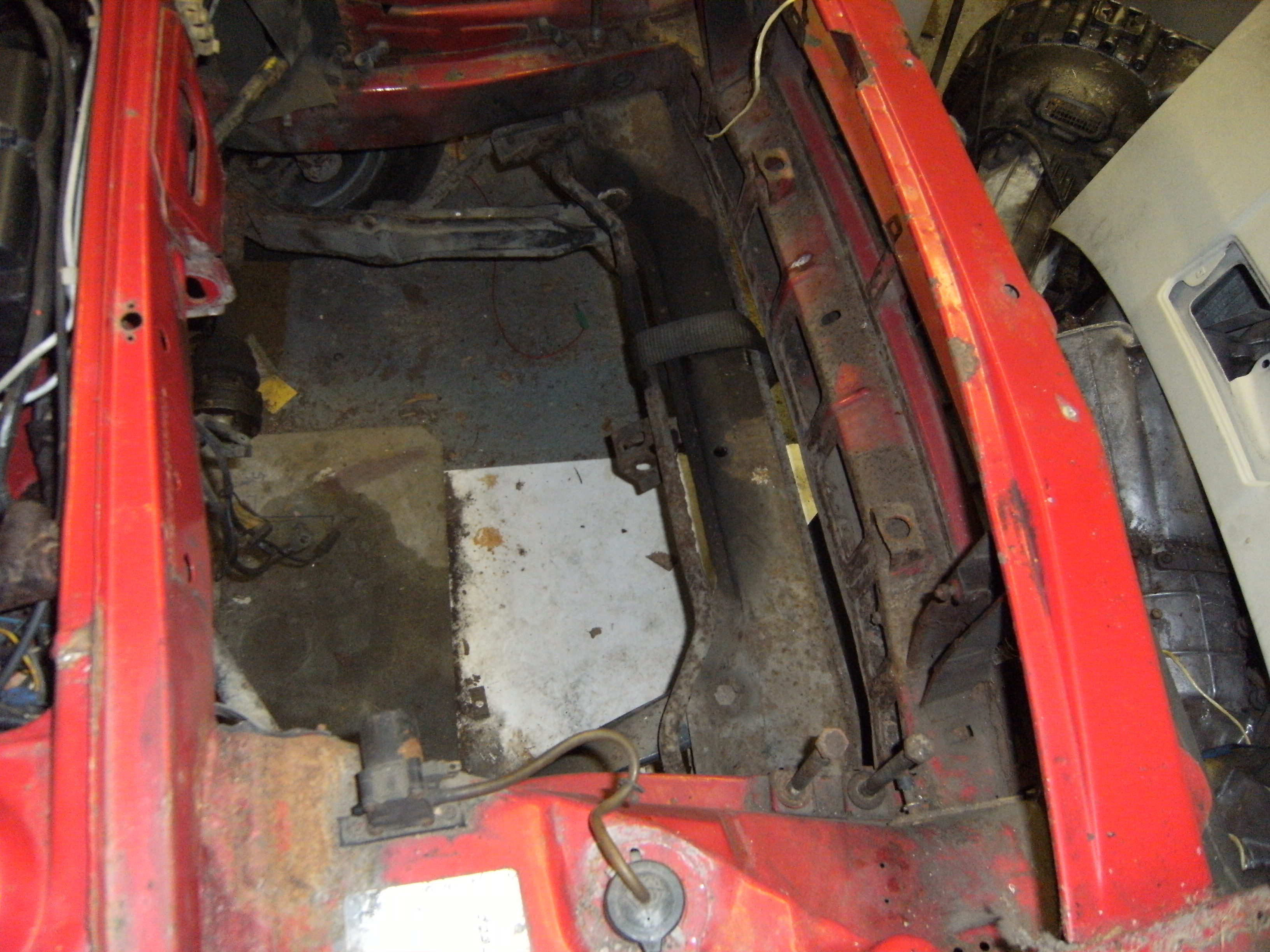

The front end is not too bad either - most of the bits are there but some brake pipes cut and fittings gone. The relays are gone as is the radiator but not too much rust and the turret tops are good!

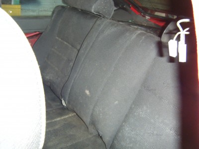

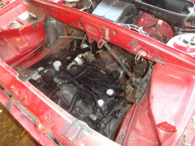

FINALLY ...I had a day to work on the 16V Sprint. After clearing all the stuff that had been put on and around the car I pushed it out into the sunshine. Then I got the gearbox off the 1500 engine that was in the Silver Sprint that became the 6C. After a clean up it went onto the 16V engine. However there is a spacer on the 16V starter motor and so I will need a longer bolt at some time in the future....
Then the front of the Sprint was jacked up, the front cross member and trailing arms taken off........and the motor eased under. After a lot of faffing and removal of the dipstick it was in the engine bay.
Gradually I jacked it up and wriggled the gearlever in place - then the top mounting bolt was tapped through the bulkhead fixing. The new 16V crossmember (Thanks again Chris) was loosely bolted in to support the front and the rear mounting rod on the gearbox extension bracket bolted under the bodyshell.

Re: SPRINT 16V Build
All in once piece now
You're gonna need to play with the wiring a bit though
Phil, isnt that engine with coil pack instead of dizzy if I remember correctly ?

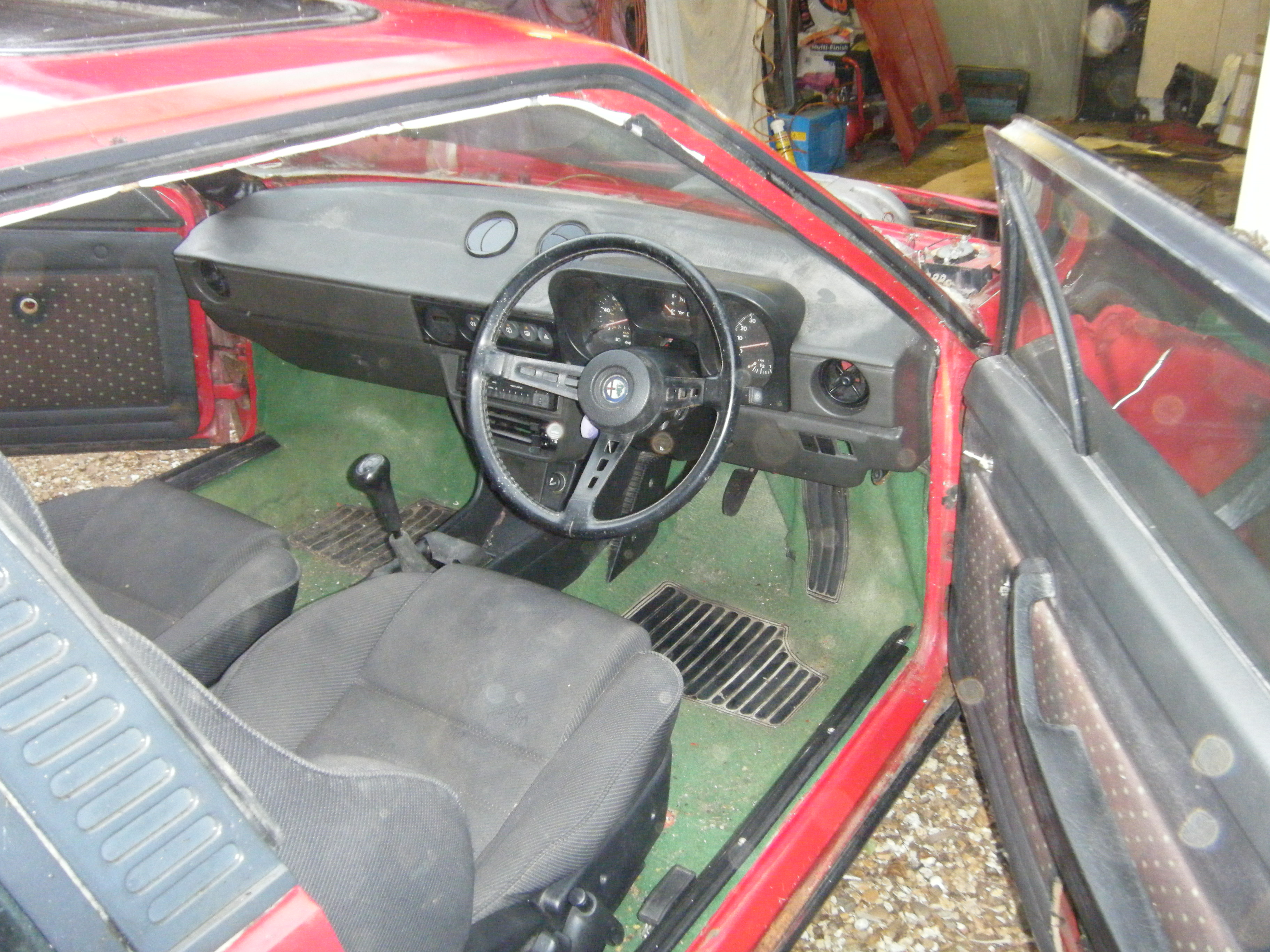

Anyway a bit more done getting the trailing arms off the old cross member and ready to put on the 16V cross member. Then I got the passenger seat and rear seats down from the shed and just popped them in place. They are 145/6 Alfa seats - slightly modified to fit in the Sprint.

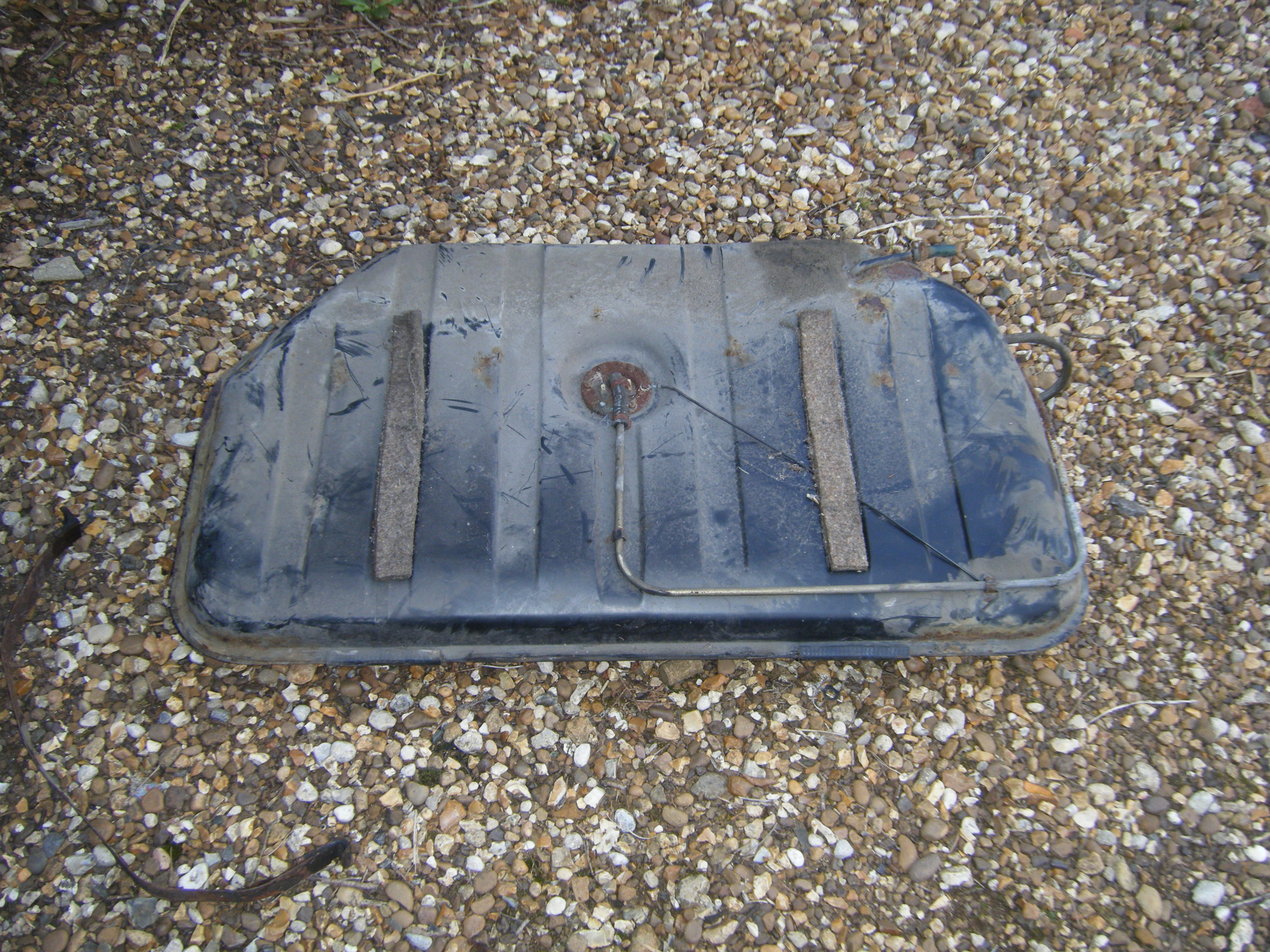

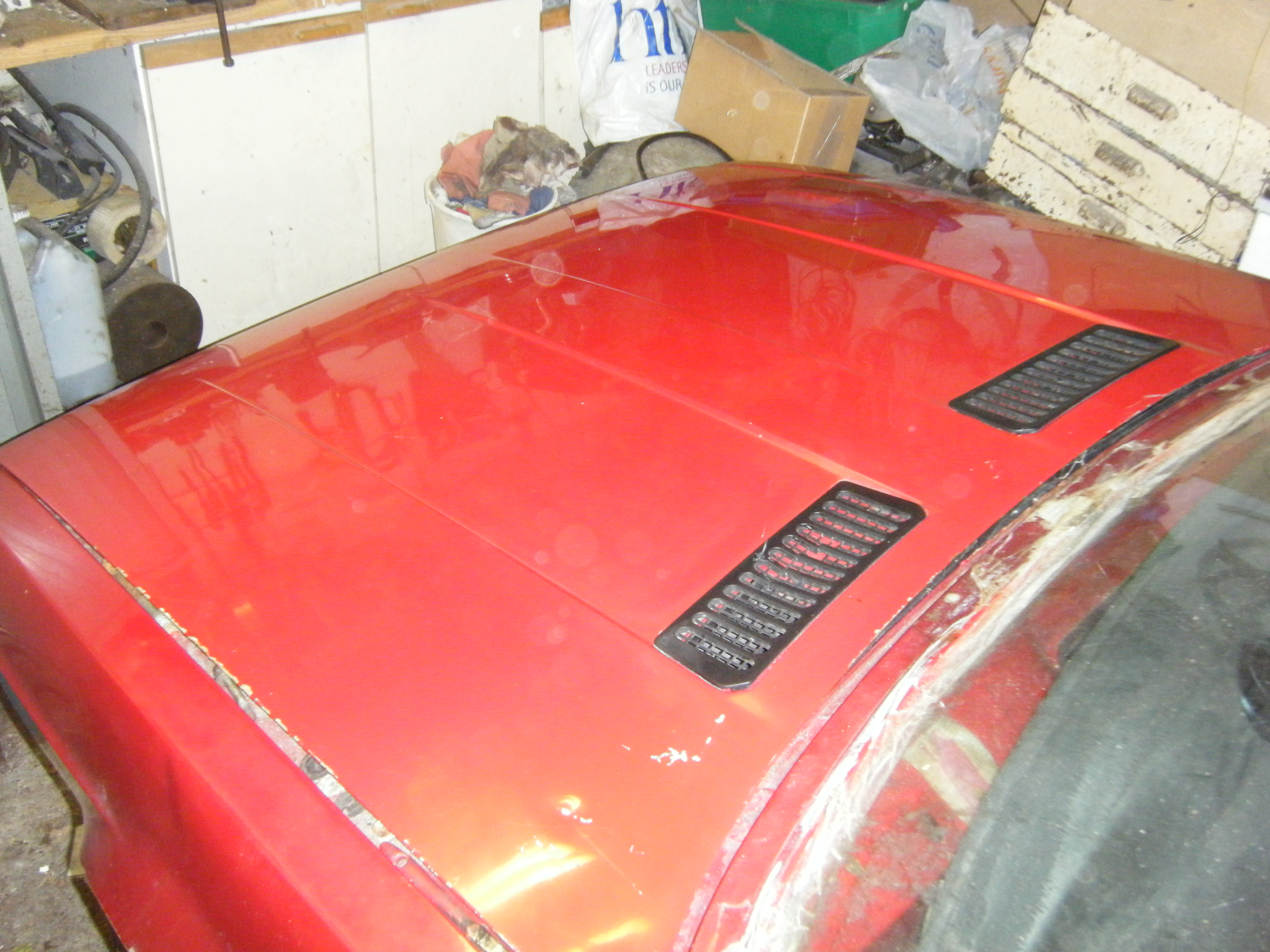

I finally had a bit of time for the Sprint so checked in my garden shed and found ......a nice Red bonnet and reasonable fuel tank complete with fuel filler pipe and straps!
So they were brought down to the garage and the bonnet put in place. I gave it a quick T Cut just to show the love!
This is the third bonnet as I bought the car with a black bonnet, then it had the grey primered one - now this.....
