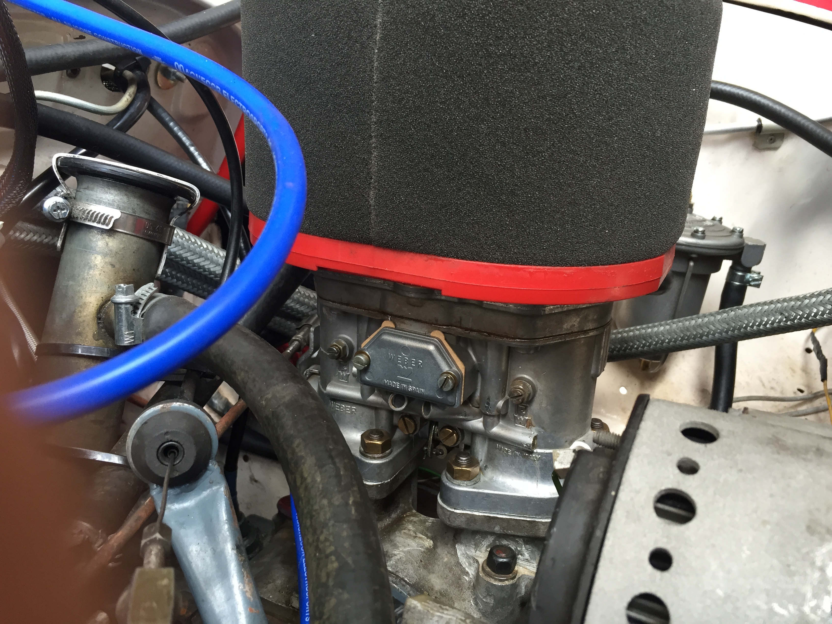

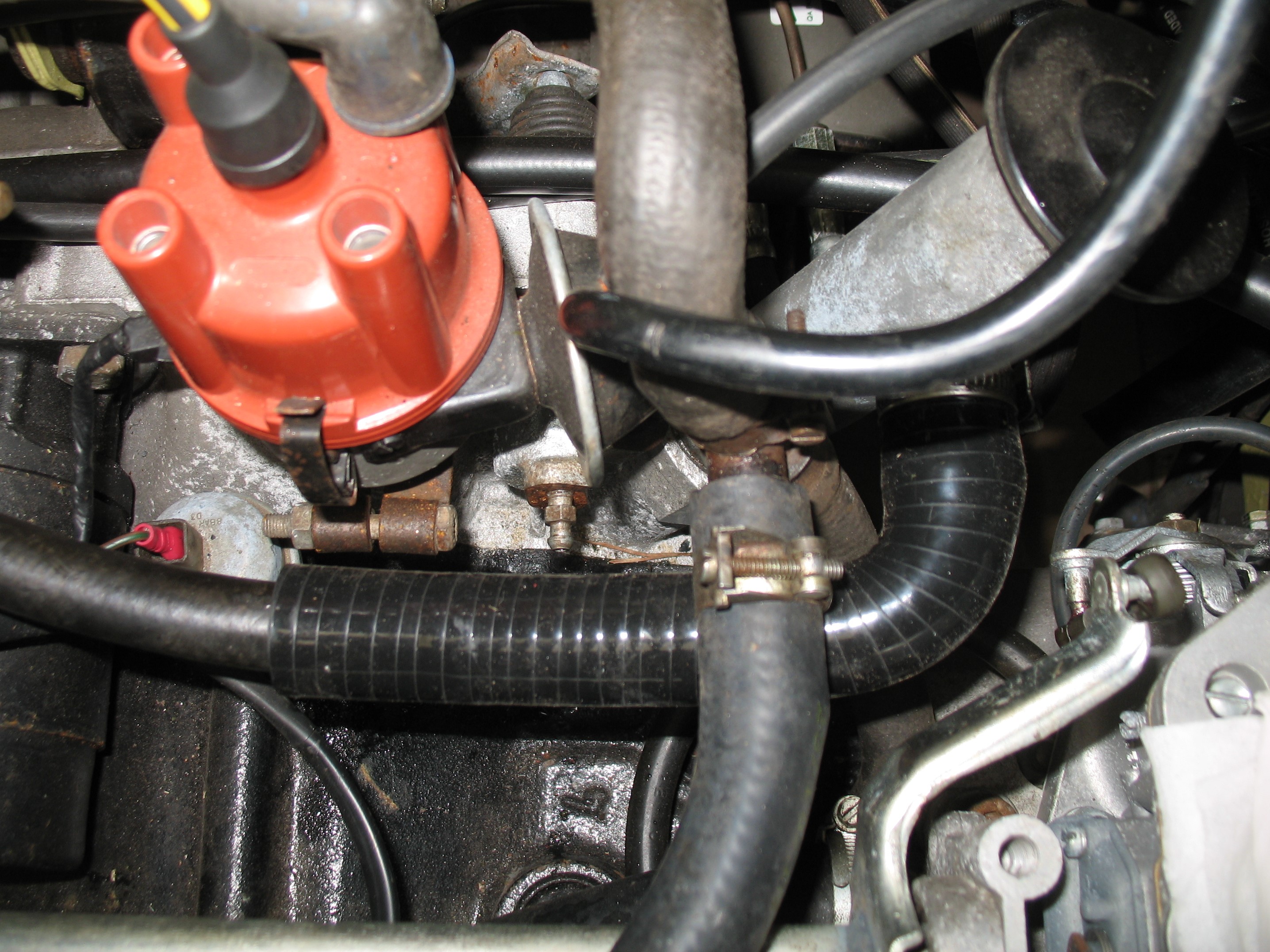

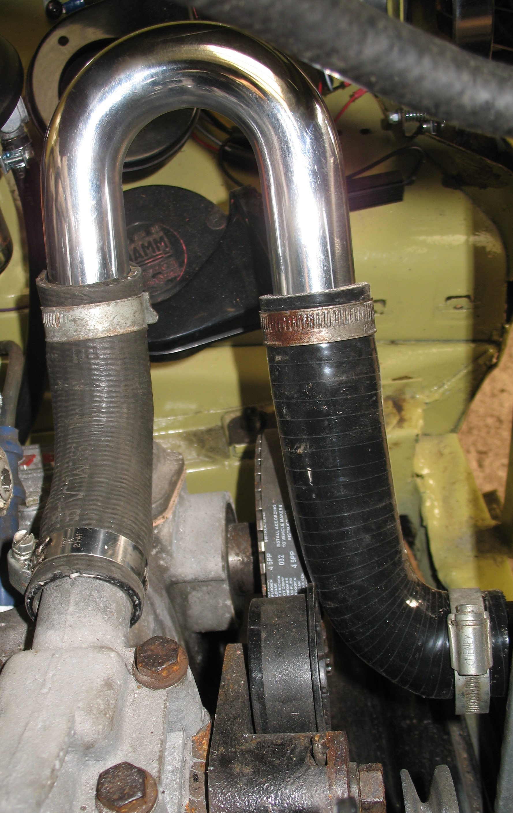

Well finally got my hose to the rad on, but it looks like a sledge hammer to crack a nut. Now getting to the point where I just want it to work so I can fire it up. You can see from this angle how close the hose is to the tensioner.

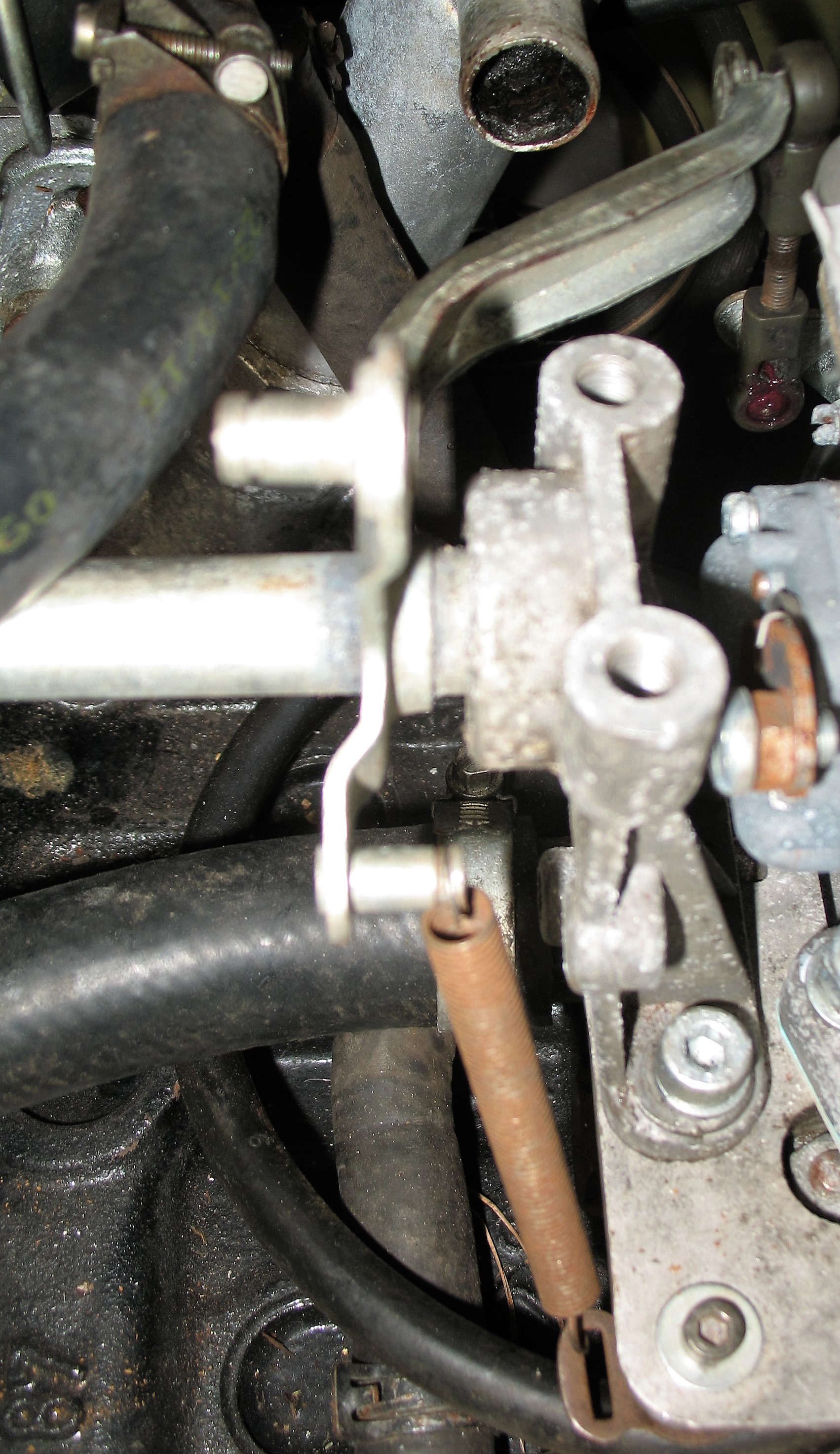

Two questions here chaps. How many springs do I need on the carbs as I do not want a sticky throttle, but this small one seems to be doing fine at the moment.
Should there be one on the pedal ?

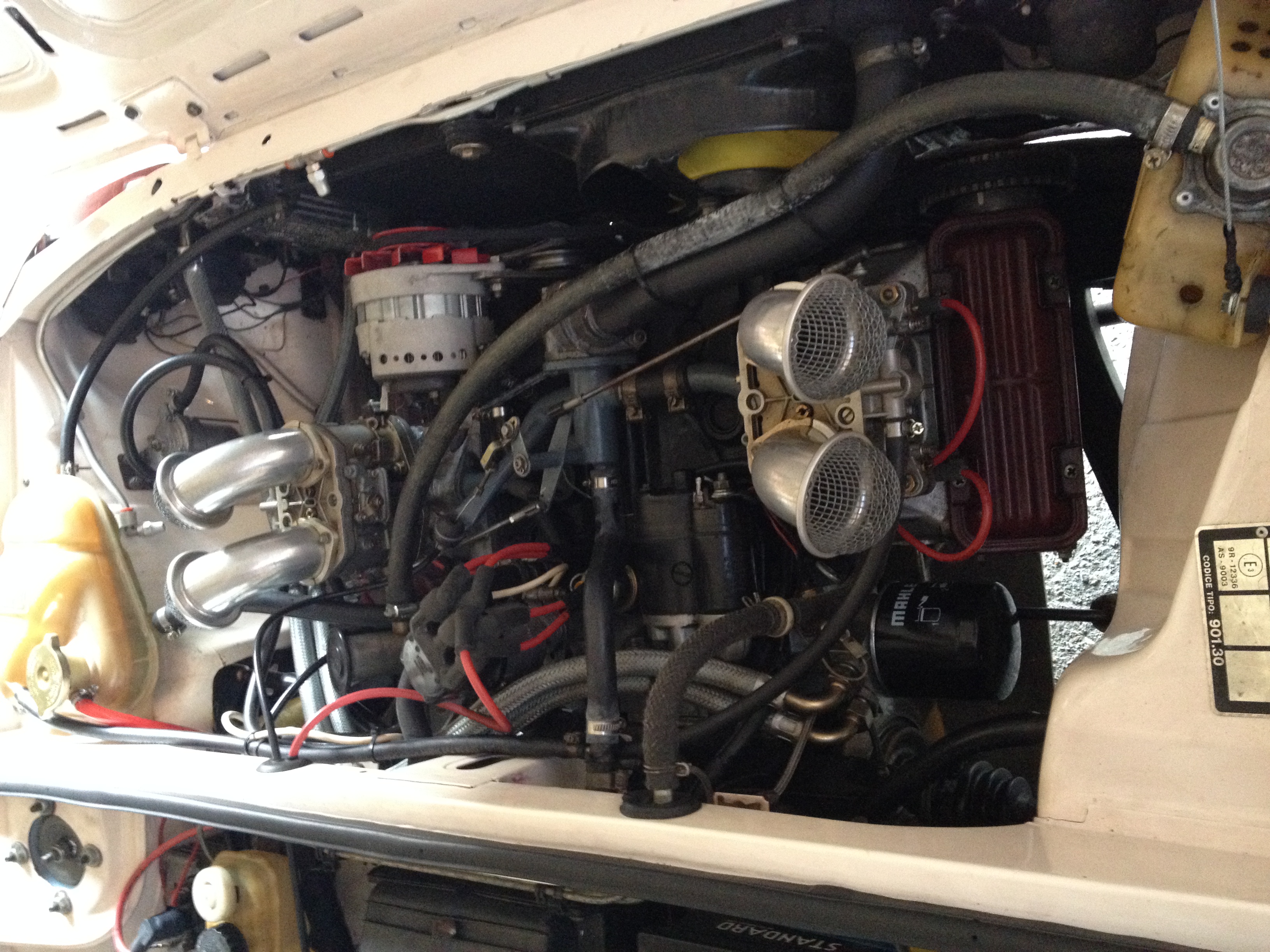

My breather pipe is routed across the front of the engine into a catch tank fixed to the offside inner wing.
The oil filler cap is strapped down because it can come off with considerable force when racing.
Hi Simon.
Thanks for posting those photo's, very interesting esp with your throttle linkage being so different. I like the way the hose follows the top rad hose and so keeps it well out of the way. Sensible.
Bell mouths look great. After years of having them on motor bikes they are pure nostalgia to me. :D

I used the std hose initially and plumbed that into some oil cooler hose which leads to a catch tank in the same place as Marlows.
The only difference is mine goes across the back of the engine bay and down the chassis brace leg rather than across the engine.
I would be concerned about the hose and pulley it seems very close. Could the rad hose be shortened to pull the hose away or what about a brace to do the same thing and give a bit of clearance?

Hi Chaps. Yes your both right it is a very close hose esp from that angle.
I was thinking about a thick wire guide to push it away but the later cover may be a better idea.
I do not think the hose will cut back further with out it not clamping properly , or am I wrong ?
If I cut the stub on the rad I lose the lip that helps hold it on.
Will keep looking at it whilst I rework the front skirt as not happy with some of the fit and the old fibreglass repairs.

Looking at the ginormous U tube set up you've got....
Would it be better to ditch your 33 rad, and fit a sud one?
Seem to remember you would need some sort of support at the bottom of a sud rad, but not difficult to do?
Dave
Sorry James , but I agree with Dave.
In standard form a sud can run on the warm side , and you have a hot motor in your car. Reduce any restriction to coolant flow as much as possible. I appreciate it is more work but it would be a shame to cook your motor. :)

John at just Suds was certain that the out let from the rad on the sud radiator was lower still and so the problem would be worse and the VW one that came with it is even worse.
I was looking at a custom one the other day just on the same principal that what I have is a poor set up and I do not want to wreck the engine.

The distance from the top of my sud rad, to the centre of the bottom hose is approx 170mm.
If you mount a sud rad, so the top is bolted under the slam panel as normal, a standard bottom hose should clear your cam wheel/ tensioner.

Like the route to the catch tank and will go and do some measuring later. Good idea indeed. Many thanks again. :D
Just measured it and the distance is 230mm :? so Sud rad should do it. You are correct Dave.
So aside from being a bit close it may well solve that problem.
Just have to find a good one now.

you can also see the bottom hose,sitting nicely over the cambelt cover!
Dave

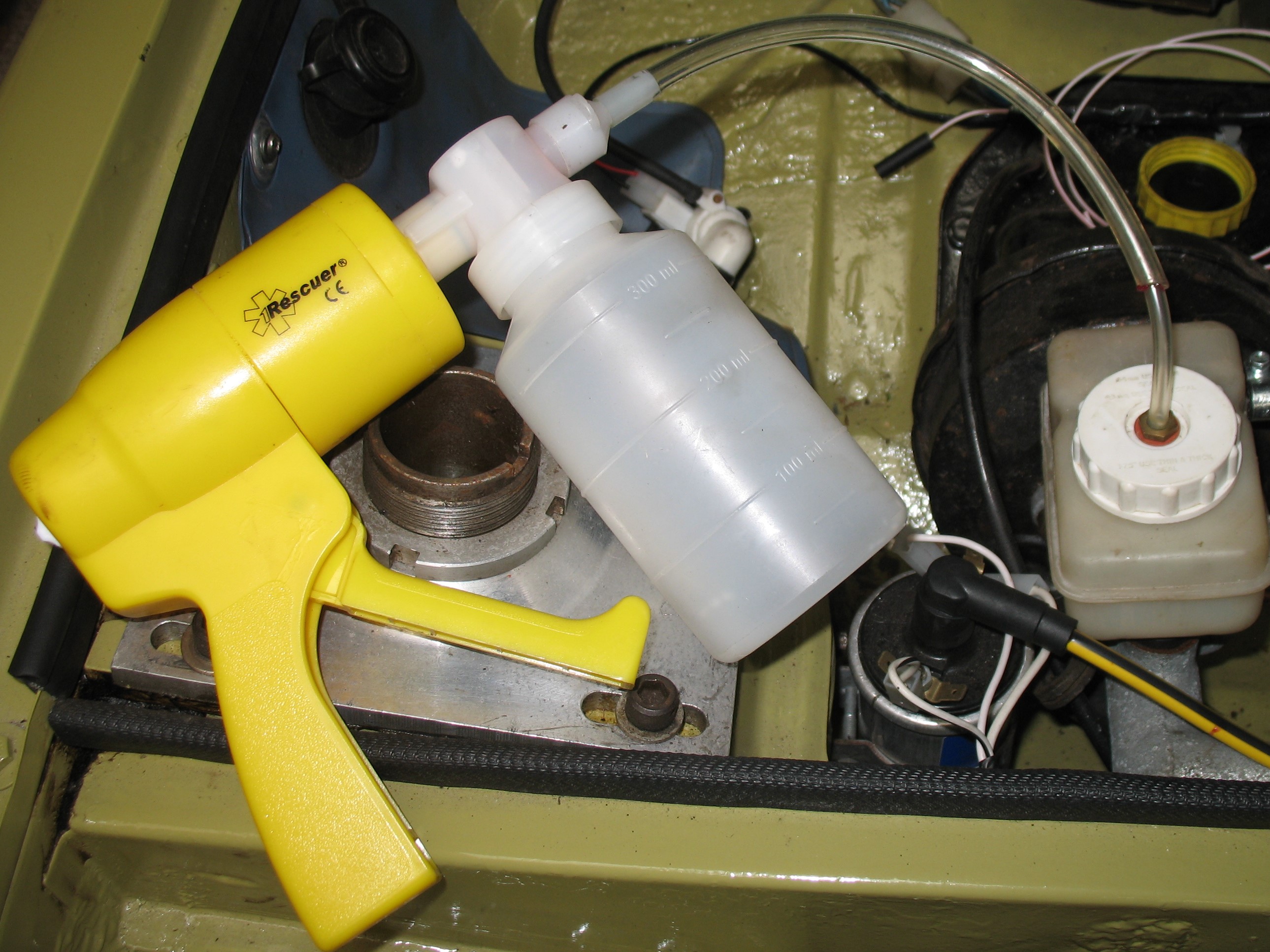

I had to find a way to bleed the back brakes which are mini ones and very awkward to my mind. Reading Laurens post on setting up I realised I had to do it gently to avoid mishaps so I devised the following.
The yellow device is a stomach or fluids pump ( not telling where that came from ;) ) The cap is off a Guyson easy bleed if I recall correctly and with some gentle vacuum pumping and a pipe/filled jar on the nipple at the rear brake is seems to have filled them. :D
Will know some more when I do the front calipers.
Also length of silicon hose I had bought late at night (doh) when I confused internal with external dia has finally come in handy. :lol:
