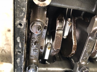

Competition time...What can you see ? (Kev isn’t allowed to play.....)
Re: Sprint racer
Ohhhhh. Snapped crank ? If you need one I’ve got a few
Re: Sprint racer
Thanks Lou, it happened at 7000rpm so it’s ‘everything else’ I’ll need that’s the biggest worry. Rod 1 has a slight twist, exhaust valves 3 and 4 bent from looking up the ports, front bearing housing collapsed. First web journal has scored the block casting slightly. No visible scoring on bores 1 and 3, 2 and 4 rods look ok to my poor eyesight as on full down stroke. However I was laid on the drive under axle stands So it might all be bent an oval when stripped.
I’ll have to think it over before doing any more. Just took the sump and manifolds off today.

Re: Sprint racer
I’ve got a few short motors so let me know what you need and I’ll help where possible are you 8V or 16v
Cranks snapping Across that web Was not uncommon . Was the crank std ? I balance and nitride all my race cranks now

Oh dear, as you feared Tim.
Hope the block is salvageable.
Are you going to do a strip down or swap for your spare engine?
Re: Sprint racer
Not sure yet on next steps .
Thanks Lou, it’s a 1500 8v. Original crank was balanced up, not sure about nitride, I doubt it. I’ve got another 1500 block, and I have a couple of 1700 8v old class f type spec engines. I’ve got 3 spare steel rods from a previous engine, not sure if I could mix/match to any that are salvageable ? Can’t remember if they are the same manufacturer or not. I also picked up a steel crank (after the Original engine build unfortunately) but it is slightly stroked, and not a straight 1500. The rules for most classic series don’t allow stroking. I think I have another std crank, I also have some very old big valve flat heads with twin lobe reprofiled cams, 10.9 lift I think......just remembered about those.
If the pistons and heads have survived it might be recoverable if I can use the spare rods, and spare block if needed. However I can’t remember what each block was re-bored to, I’d assume / hope both are +4.
I’ll put a cold towel on my head for a week or so and think it over.
