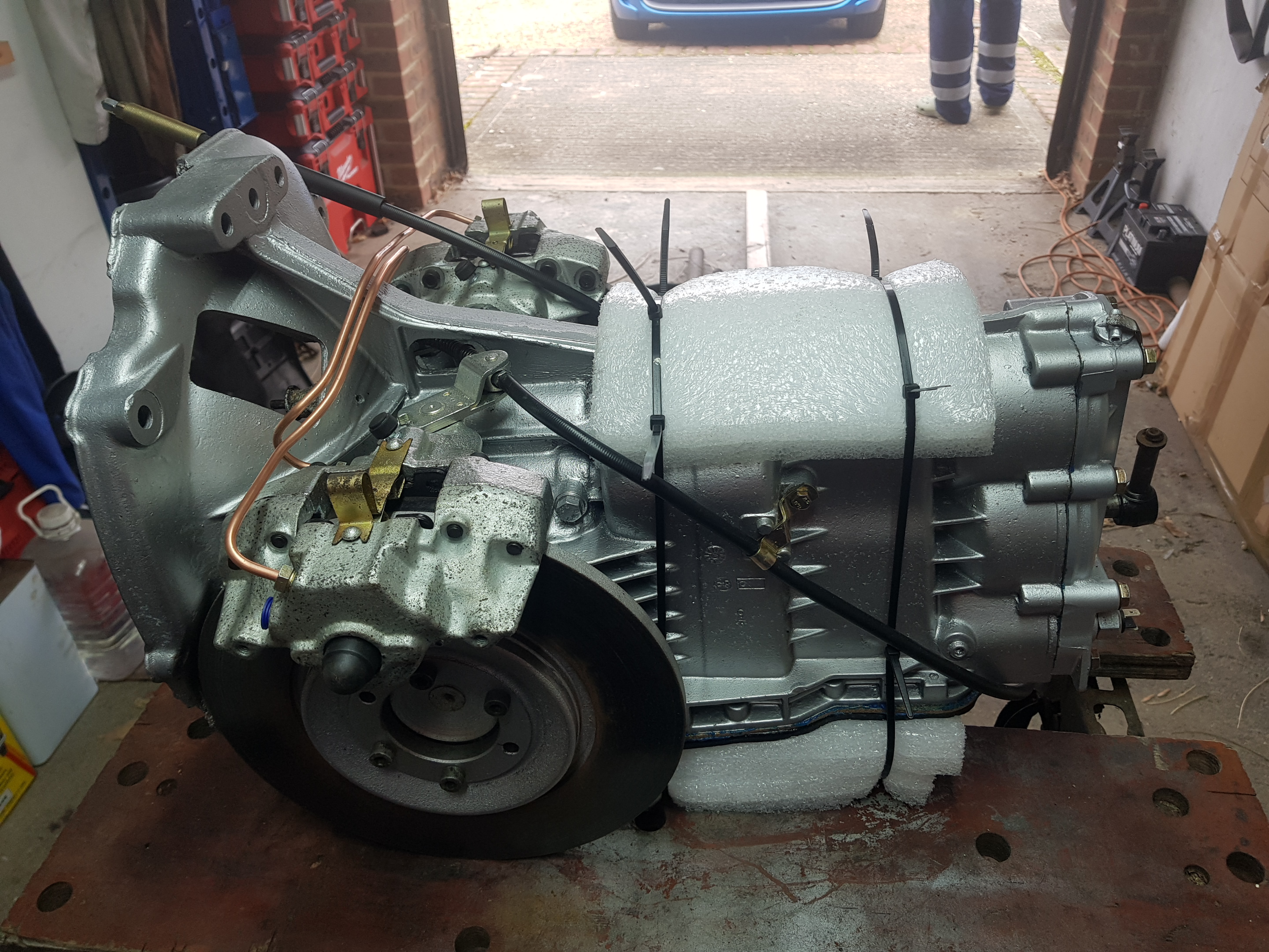

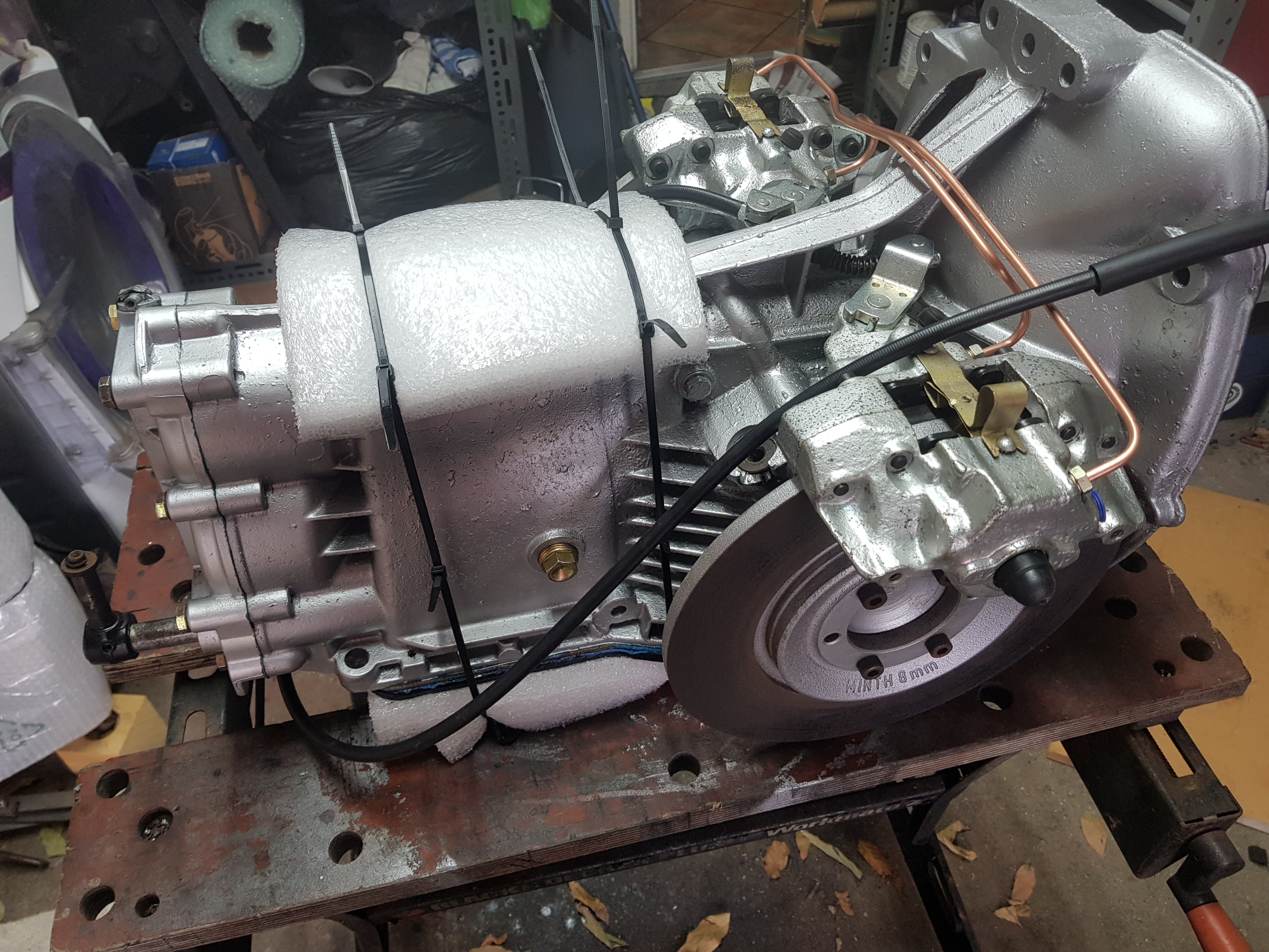

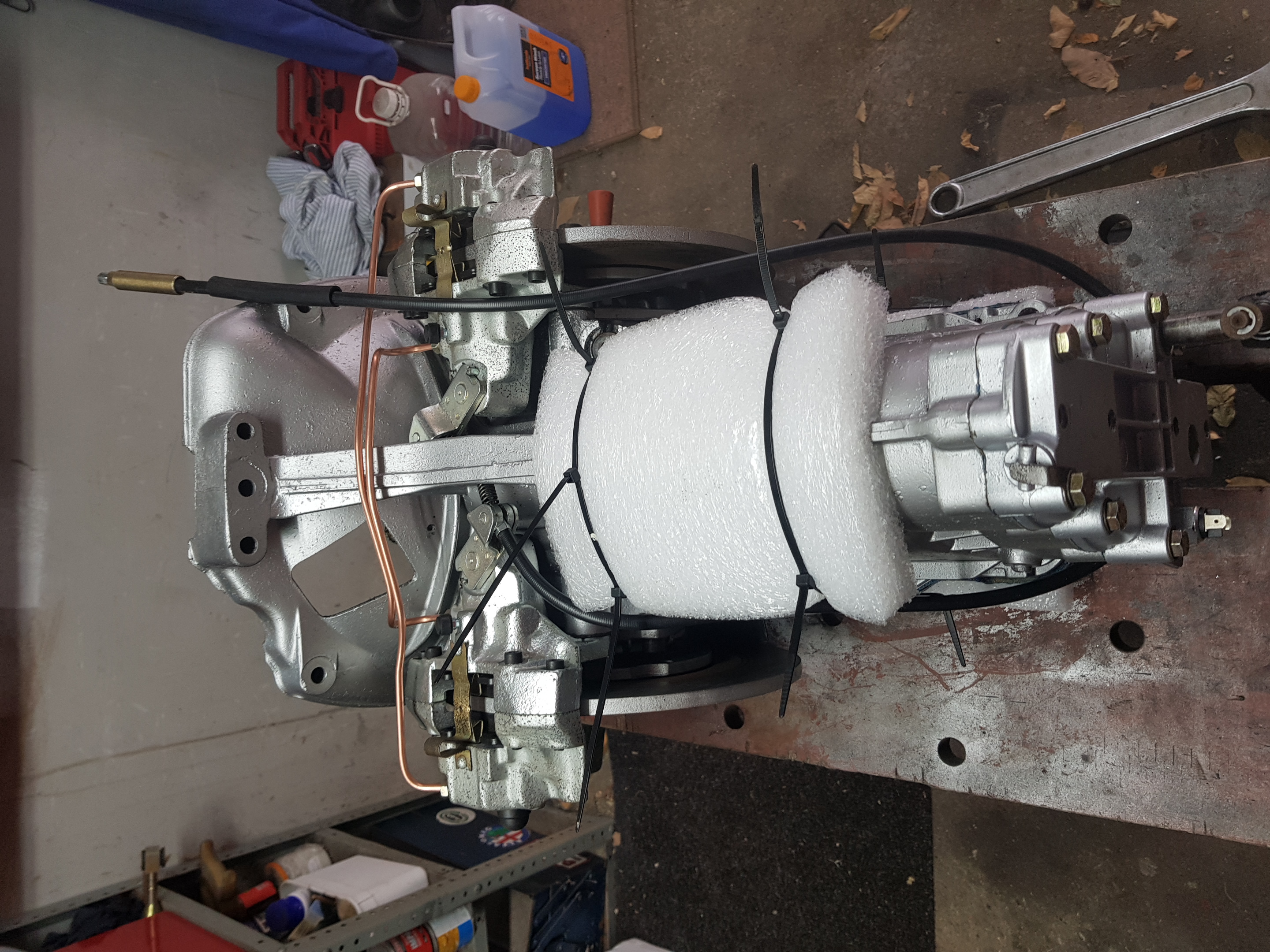

Hi folks,
Below are some photos of something you are all familiar with. Other than cosmetic improvement, the only repair work has been new quarter shaft seals & bearings, courtesy of Ian Brookfield, new selector shaft seal & new "sump" plate gasket. The box is on foam to avoid scratching the sump which took me hours to tidy up. I couldn't find clear plastic pipe of the right ID promptly, needing to get finished with my pipe flaring kit as my son was agitating for it.
The calipers are new, the discs are original & held on with temporary bolts so I could set the pad clearances. We all know about the handbrake cable challenge......my pet method is to squeeze the caliper levers together with a plastic jaw G clamp to give enough free cable length then secure the levers with a heavy duty cable tie which can be easily cut off after the box is installed & the handbrake connected.
The engine block is in a thick plastic bag in the back of my 159 until I clean up my garage so no pics of that yet. AMS have looked at the heads & condemned the valve guides. They are flat out so they want me to source them. Talking to others it seems AMS work to new manufacture specs, not in service limits. So my engine won't be far off new, but it is a slow process as they are very busy indeed.
