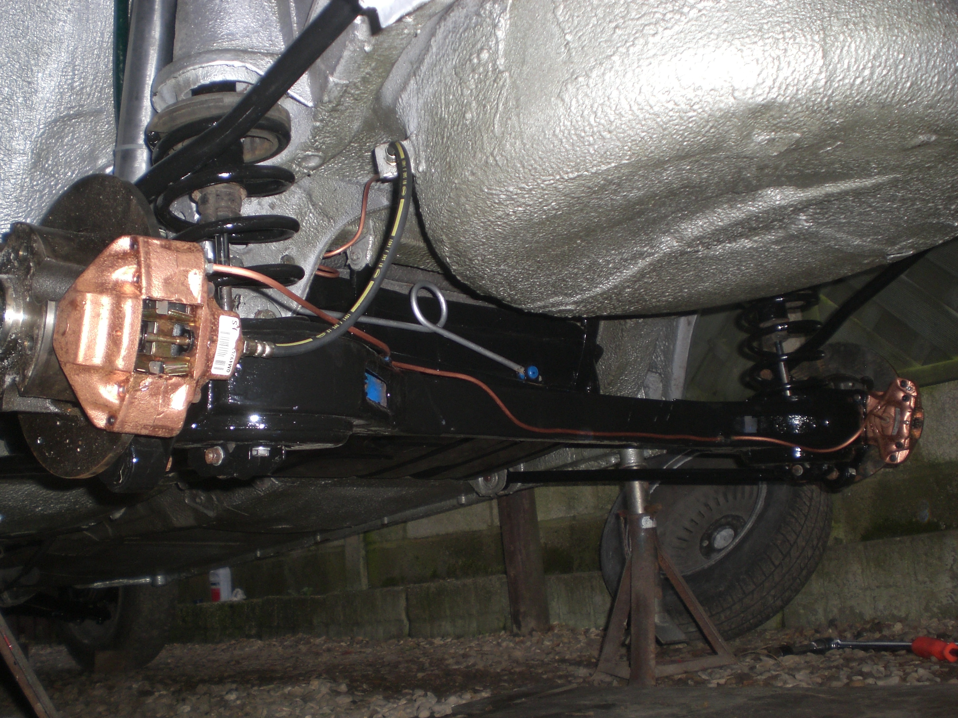

did a bit more this afternoon
made up all the brake lines and fitted those.
remembered in the course of that though that i hadn't fitted the rear calipers :roll: so they went on with the new pads.

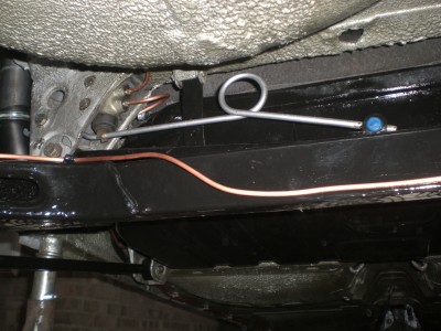

whilst under there i also fitted the rod and linkage for the brake compensator, once i'd figured out where it all went!
had to take some bits off and move things to make room but it's on now. never had one before so will be interested to see if it makes any odds??
new flexi hoses too, so should all work ok.....
Re: My S1 Sud Ti
Wow - it's looking spotless under there. Well done!
The compensator is supposed to change the brake bias when the car is heavily loaded - the rear axle compresses and actuates the valve. Normally though the car is driven lightly loaded, so the bias is shifted towards the front to stop the rear brakes locking up under heavy braking.
I think the valves tend to sieze up in this forward-biased state, so nobody really notices if they are working or not - if the car is heavily loaded and the bias is still towards the front, you would simply have slightly less efficient rear brakes...

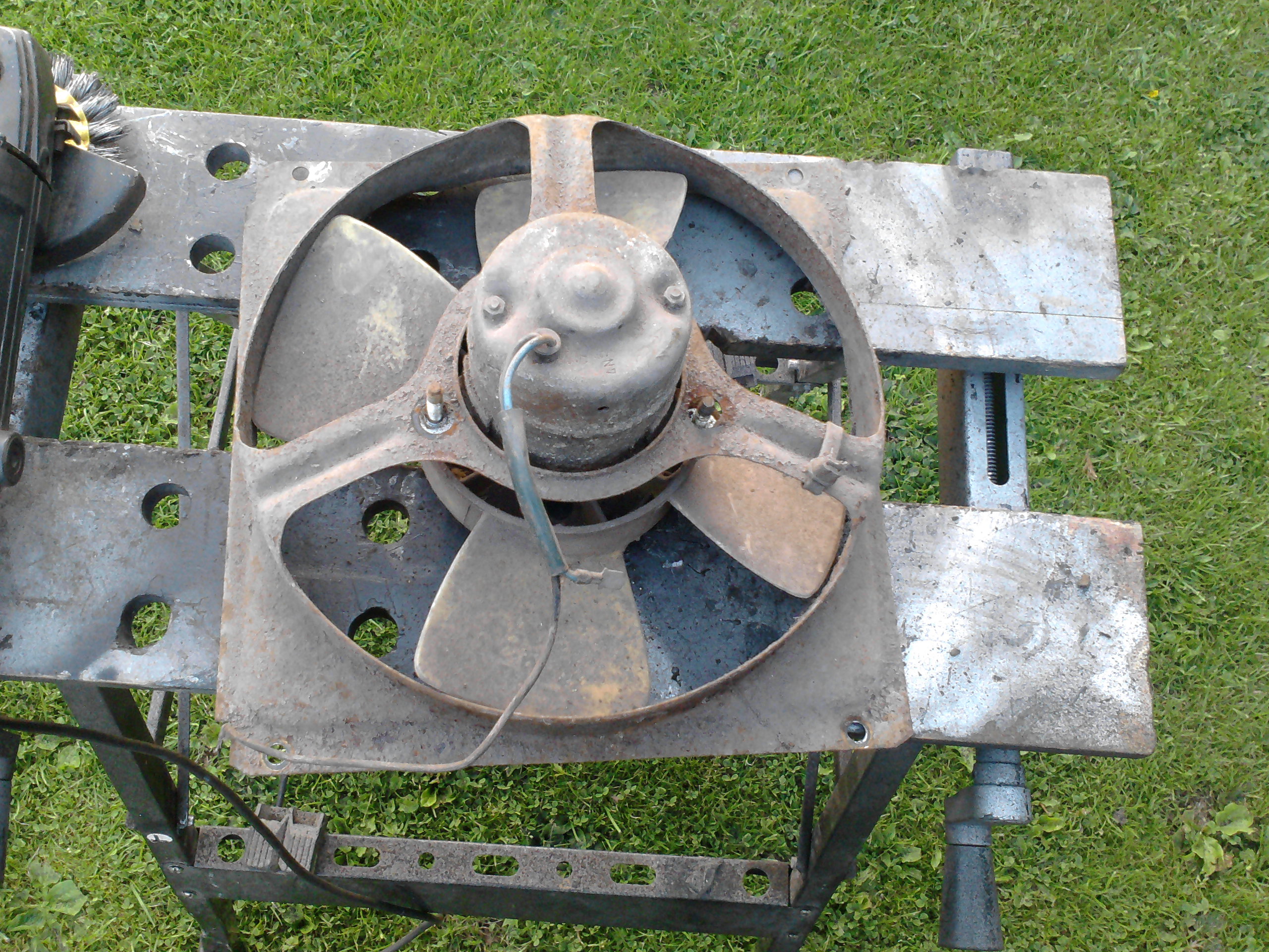

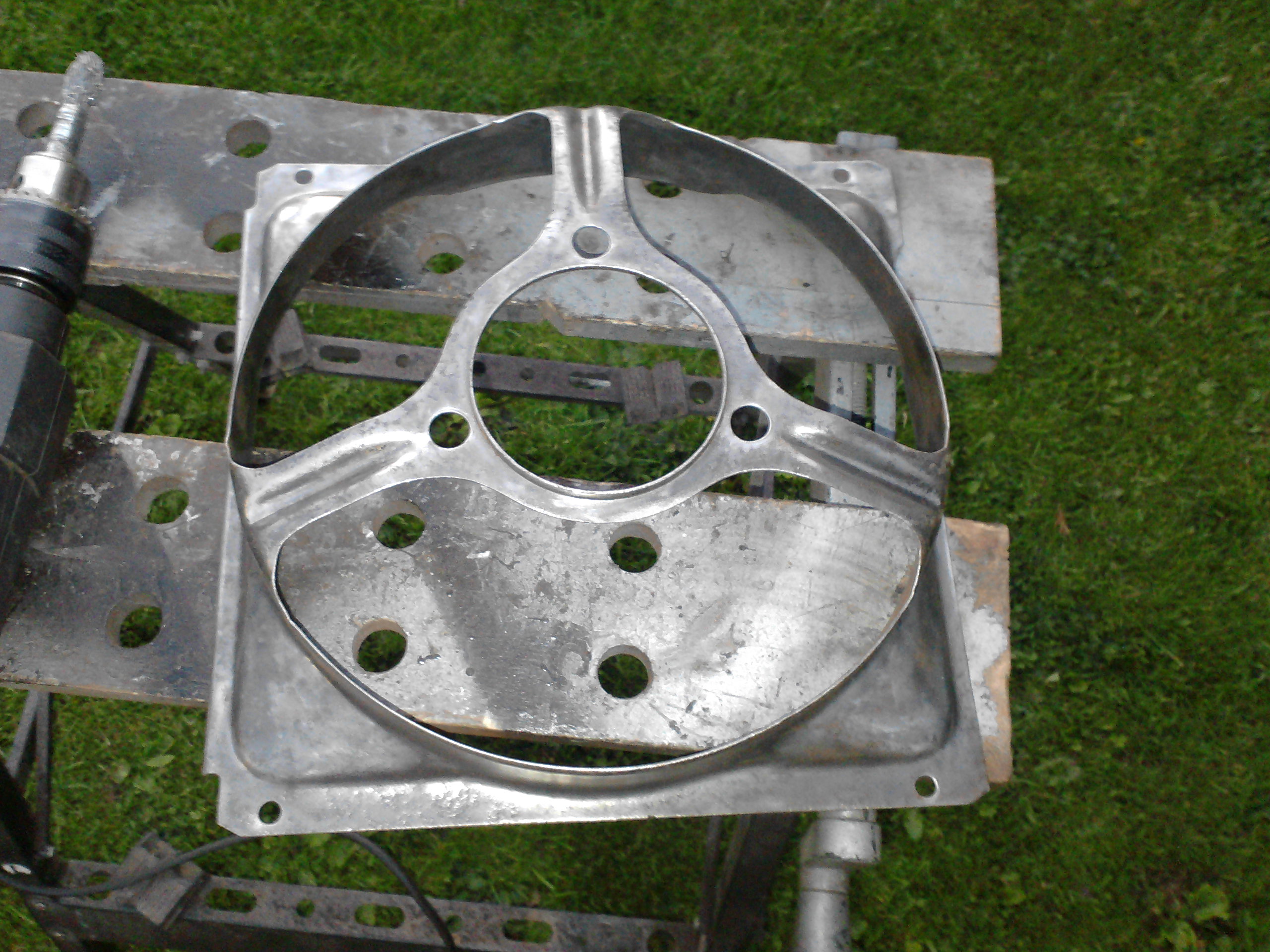

we also brought back the original radiator from the car, not for the rad itself although i guess it could be re-cored, but for the rad fan with the correct metal casing rather then the later plastic ones i have.
motor works which is nice, will strip it a bit more to give it some lube inside before a coat of paint.
blades are free from breaks so will clean up well.

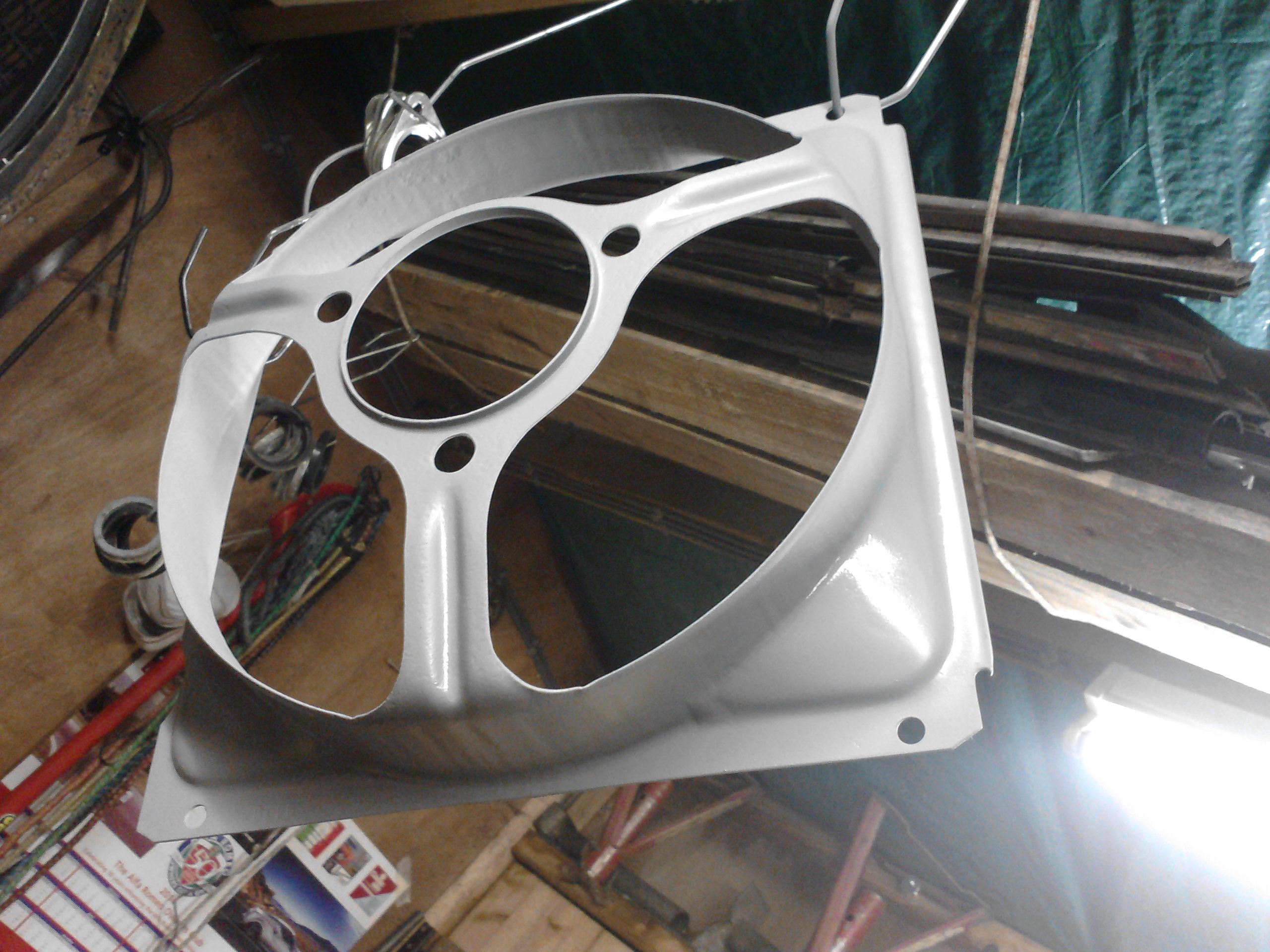

cowling was dusty and pretty rusty but thankfully only surface rust, no perforations. attacked it with the knotted wheel and a drill powered smaller wire bit for the tight sections.
a coat or 2 of etch primer went on then will leave it until tomorrow night for the solvents to evaporate properly.
bet the neighbours thought they'd escaped the evenigs of me in the back garden with a grinder going :D

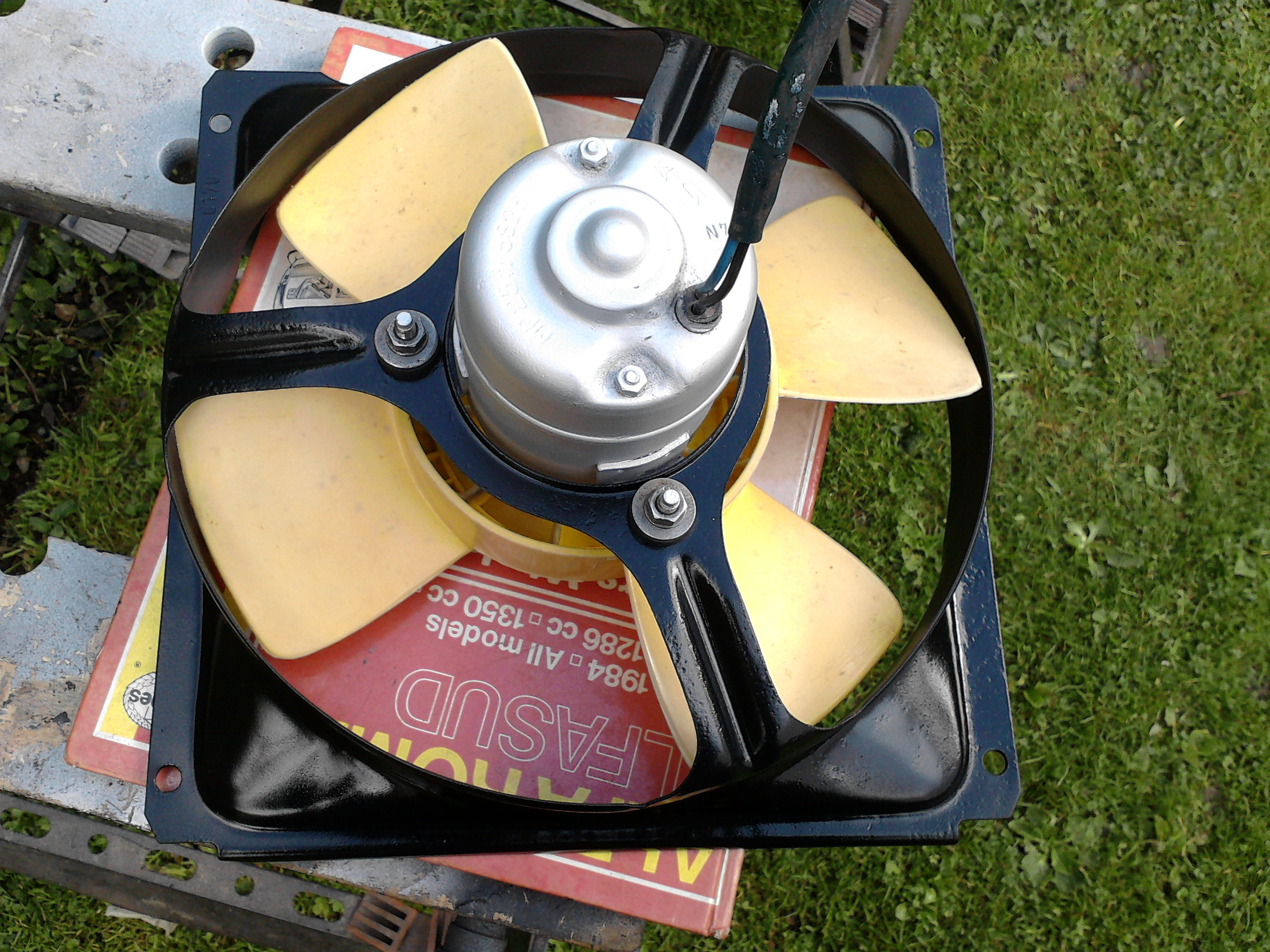

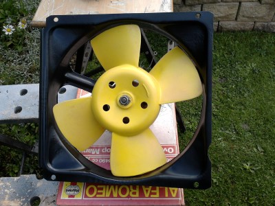

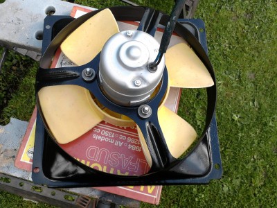

finished the ran fan off too. took an age to get the fan blades clean, years of grease and dust took some soaking to get clean.

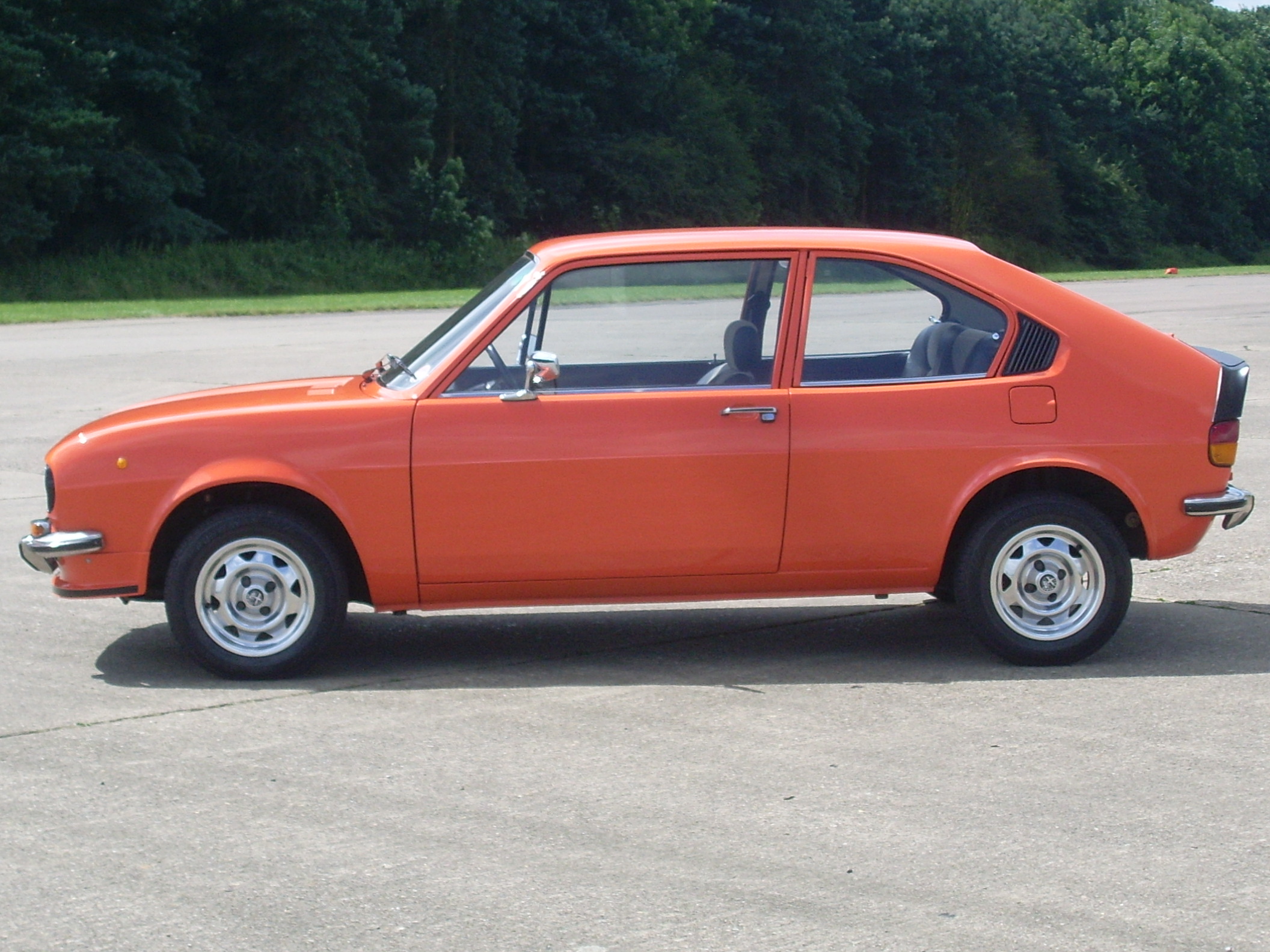

Mine was photo'd earlier this year and will be in Auto Italia soon.
This is how she came out.
Cheers.
Keith.
