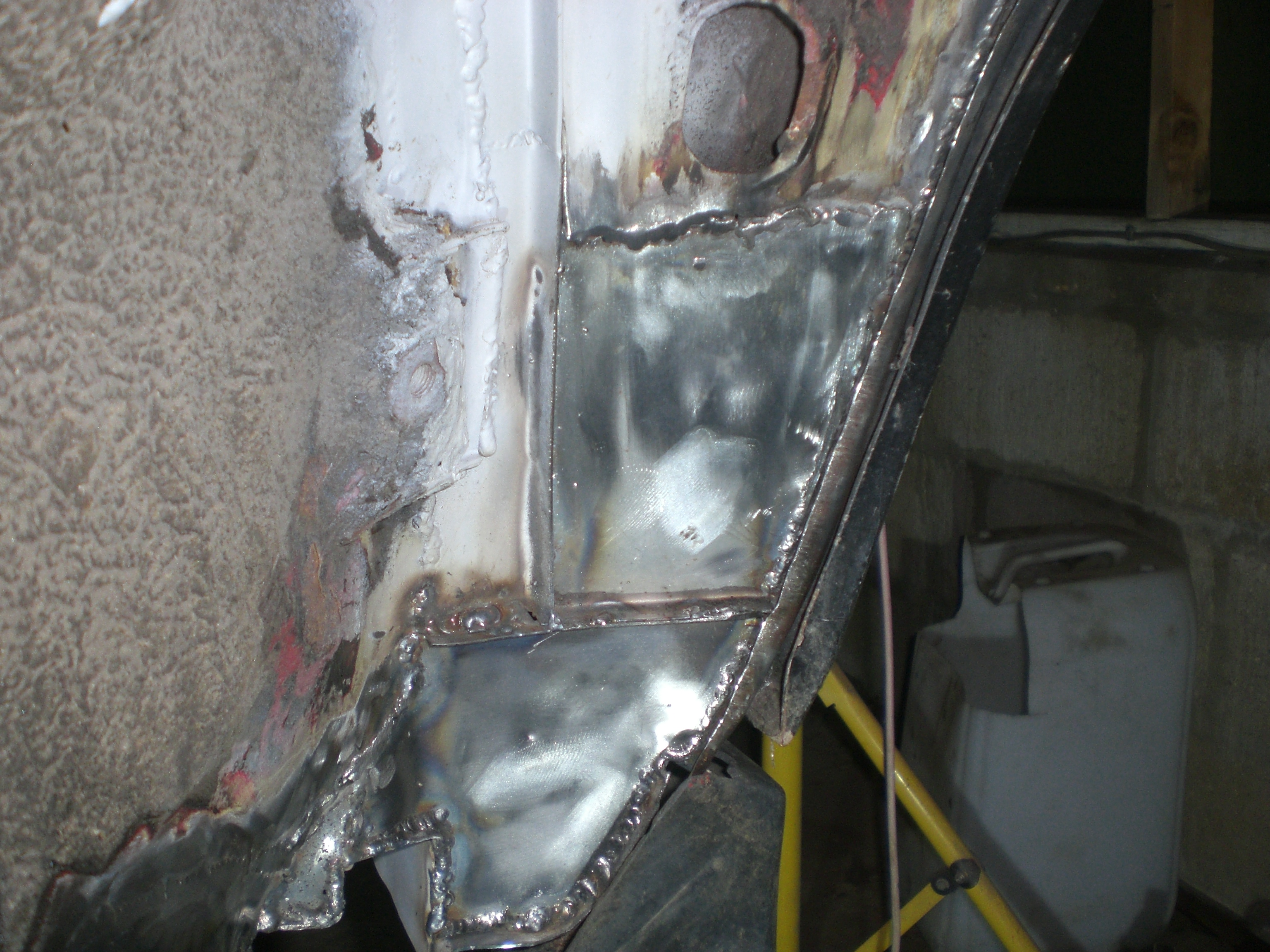

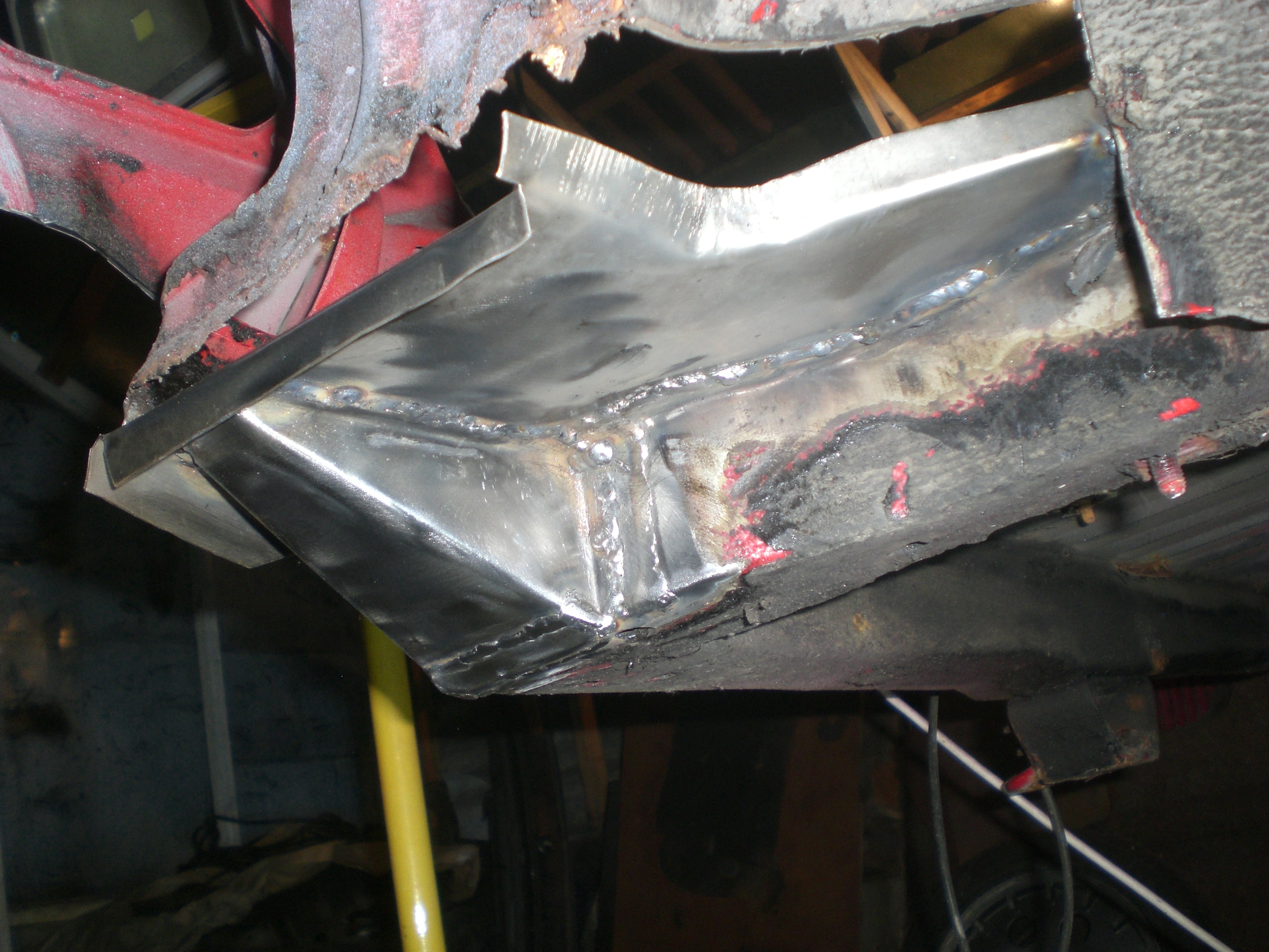

dug out my tilt frame and with a fresh load of angle and box section the plan was to build up some supports then get it on the tilter
on reflection it seemed wise to try and get a bit of strength into the easier to reach areas before attempting to lift the car from both ends. so the drivers side arch was the winner today.
there was quite a complex array of angles and differing sections that converge there, probably was it has rotted out so much as plenty of double seams for moisture to get into.
aim was to build it all back up as it should be, but that would require quite a few complex repair sections to be made up. then considered just plating over it all with some flat plate but didn't want to allow flexing, without the angled return sections it's not half as strong as it ought to be. tried to make one big repair section but that proved too time consuming. chopped out what rot there was then assessed the situation
quite a few sections made up to make it good and strong, including the important bits like around the seat belt anchorage!
all welded up and ground back
rest of the inner arch i'll do once the car is on it's side, passenger side to sort next time then up on the tilter it'll go

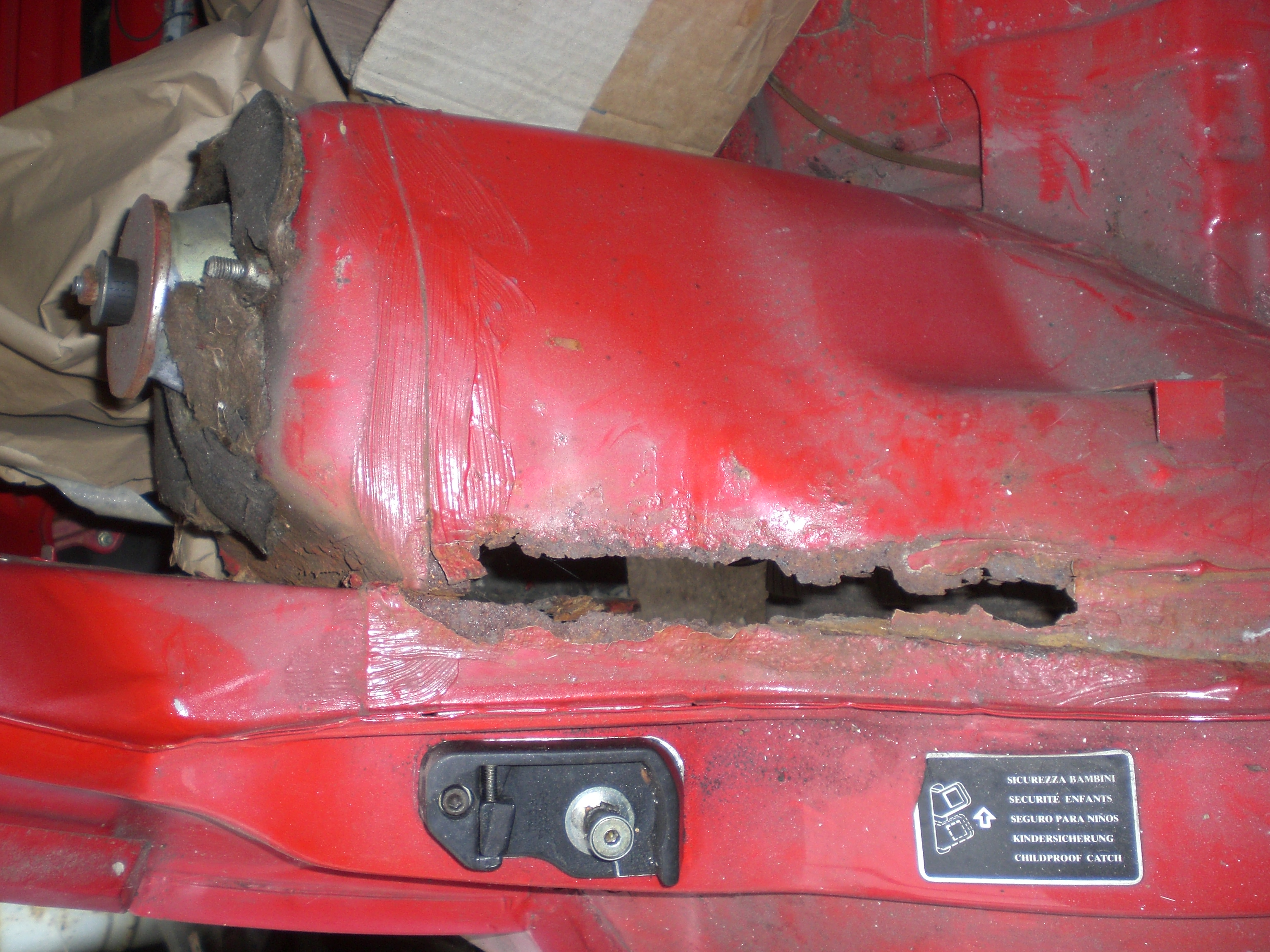

started out trying to make the whole length it one go but it twists and turns far more than the pictures show, would have taken hours to make something in one piece. worst part is getting going, once a piece is added and more bits gets made it starts to become clearer which direction to go in, I liken it to a big old flywheel that needs some starting but once going it carries momentum to keep at it..
started off with a small curved section plug welded to the door seal seam. the flange that sits under the wheel-arch sits mid point between the hole I cut, patch for attaching to the inner part laid here waiting to be attached and dollied into shape as it gets fitted

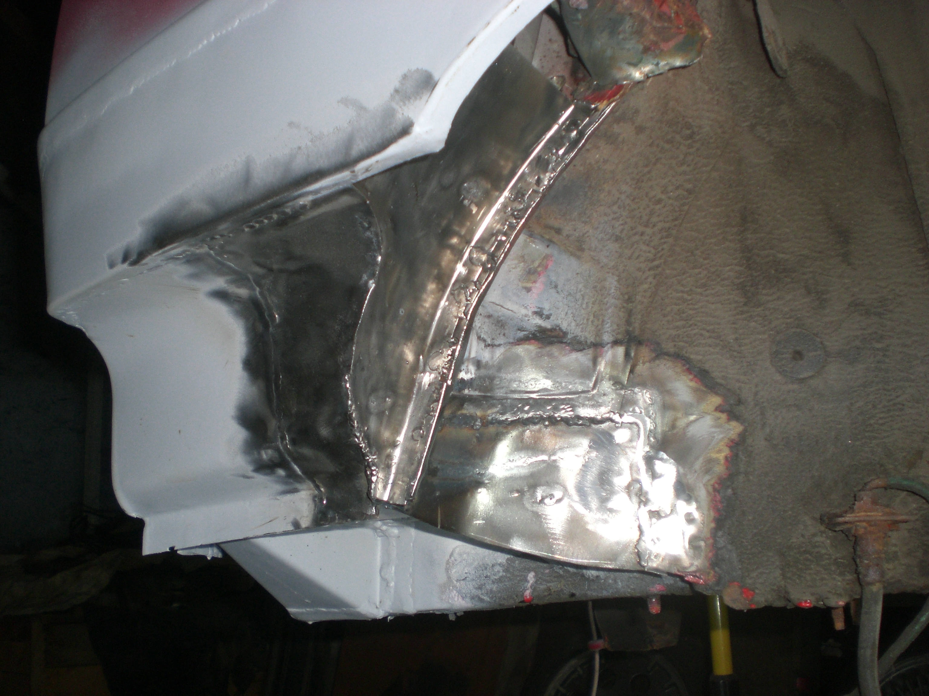

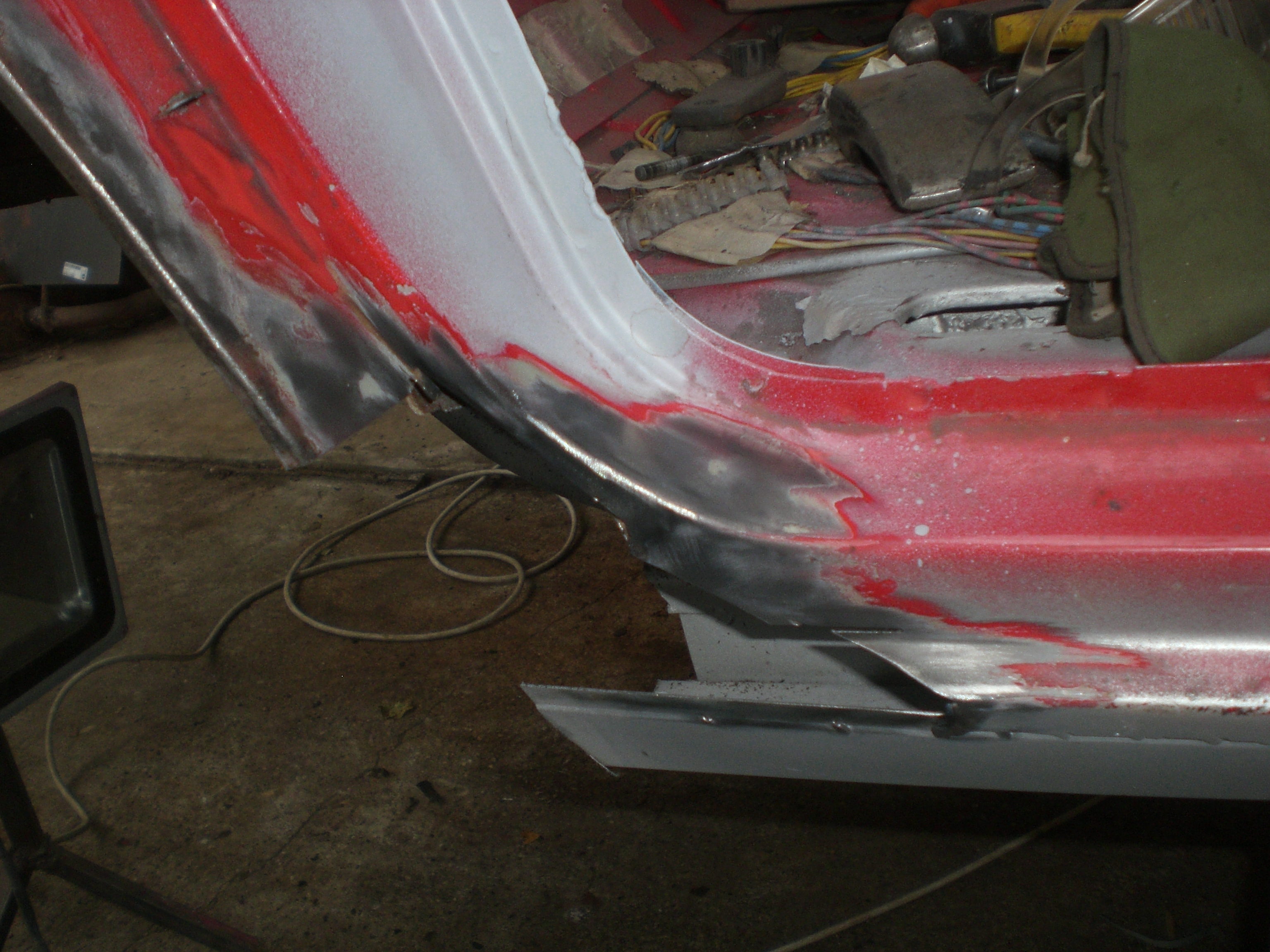

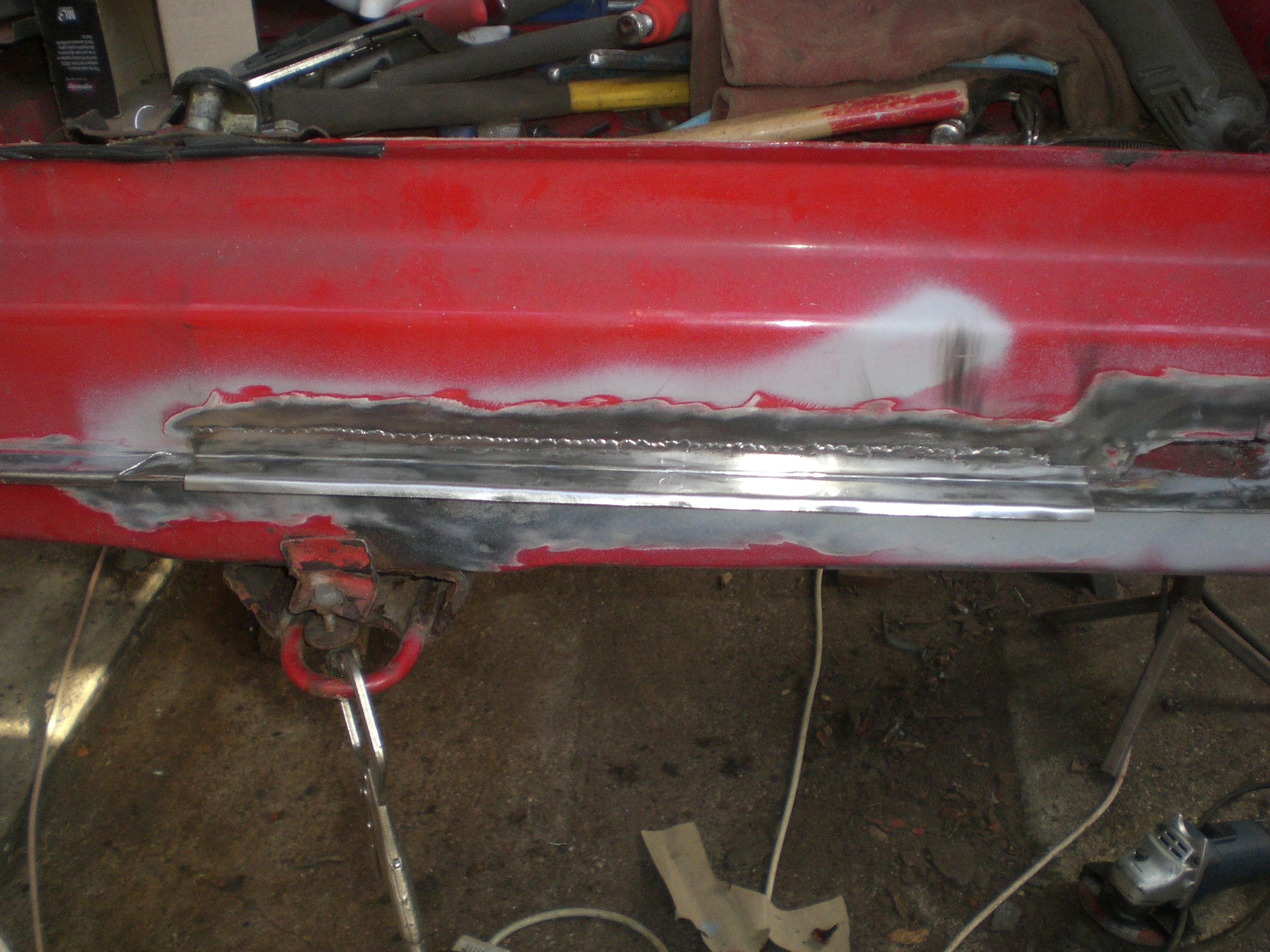

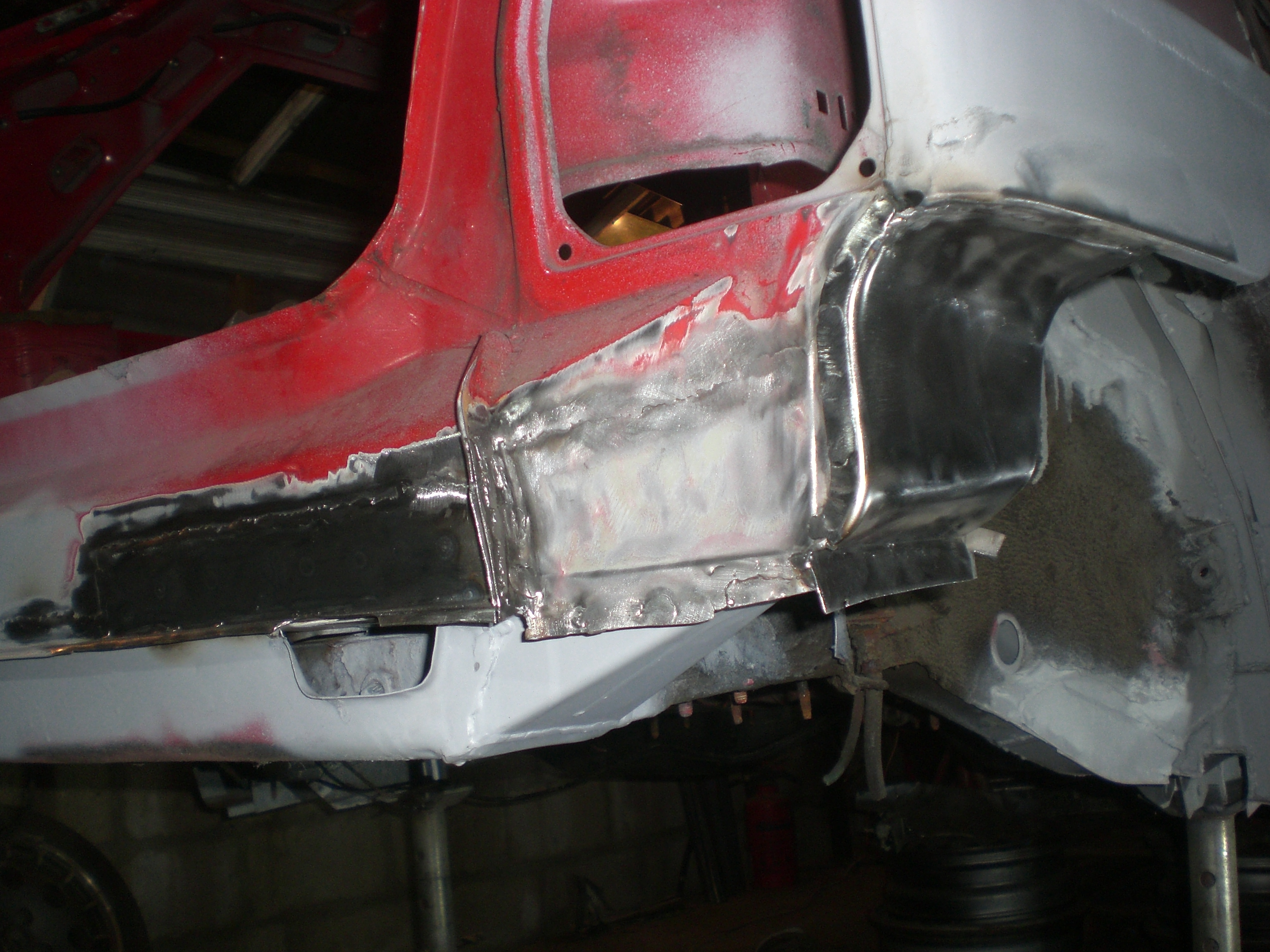

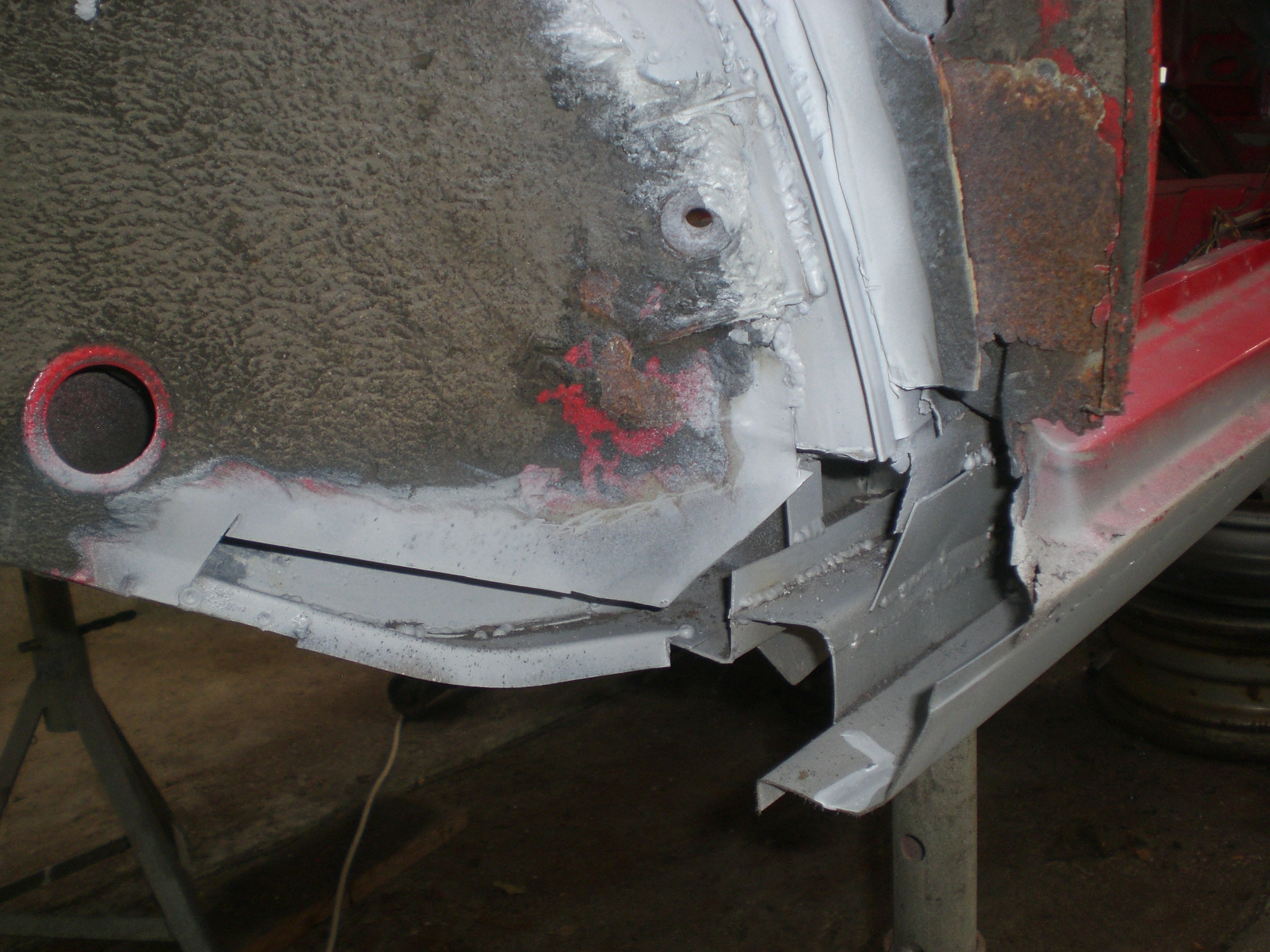

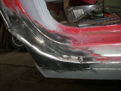

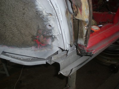

today the drivers rear arch needed finishing off, at least the forward section of it anyway, top side and rear i'll do when I can get the car upside down
the end of the sill needed capping in along with the inner face of the inner arch needs repairing and fastening to the new bits I put in last time. arch itself also looks a bit worse for wear
bottom of the arch where it meets the sill is also a bit rough
at least the rot hasn't travelled too far..
first bit made and welded in
then the piece linking to the new sill

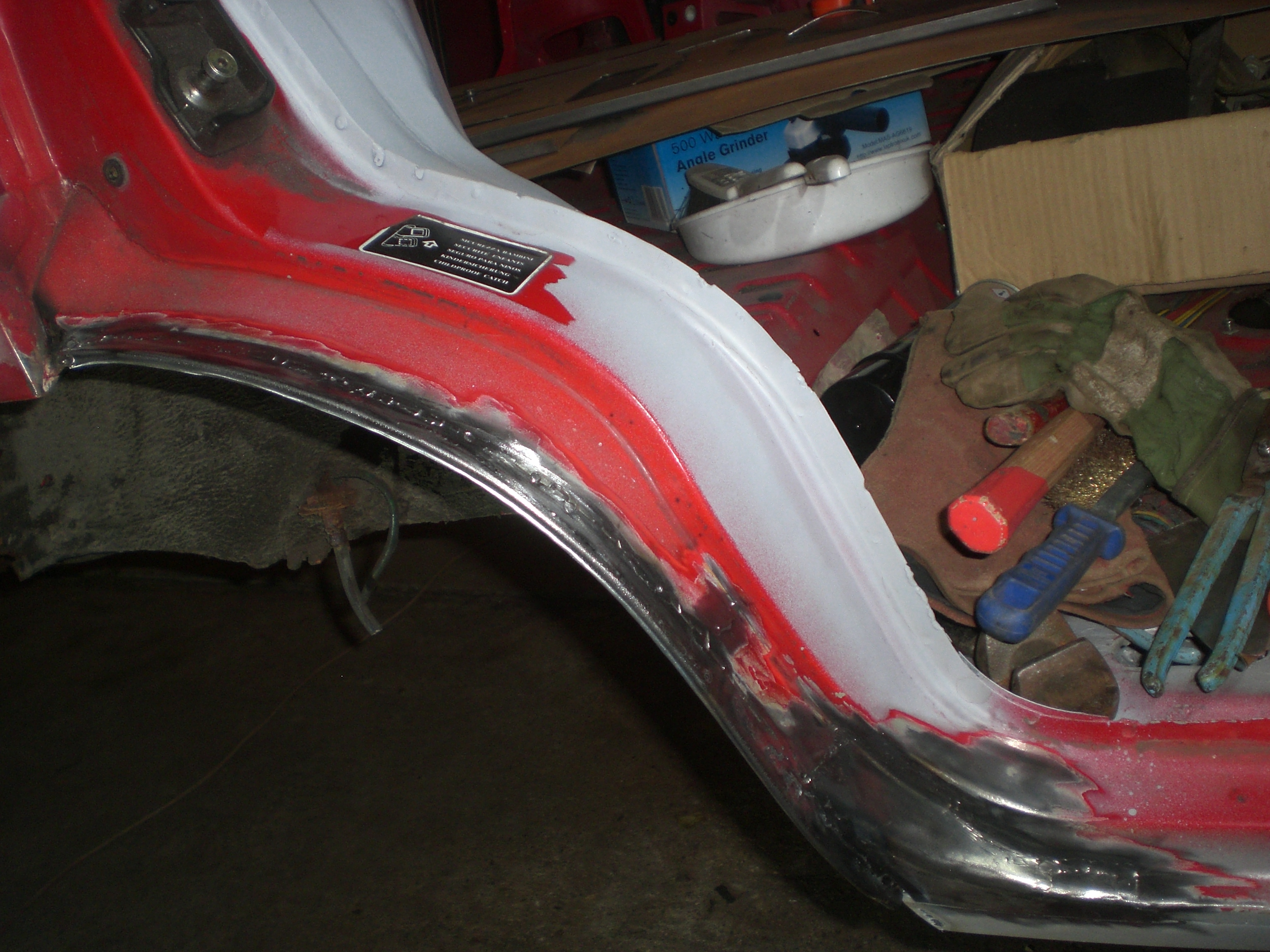

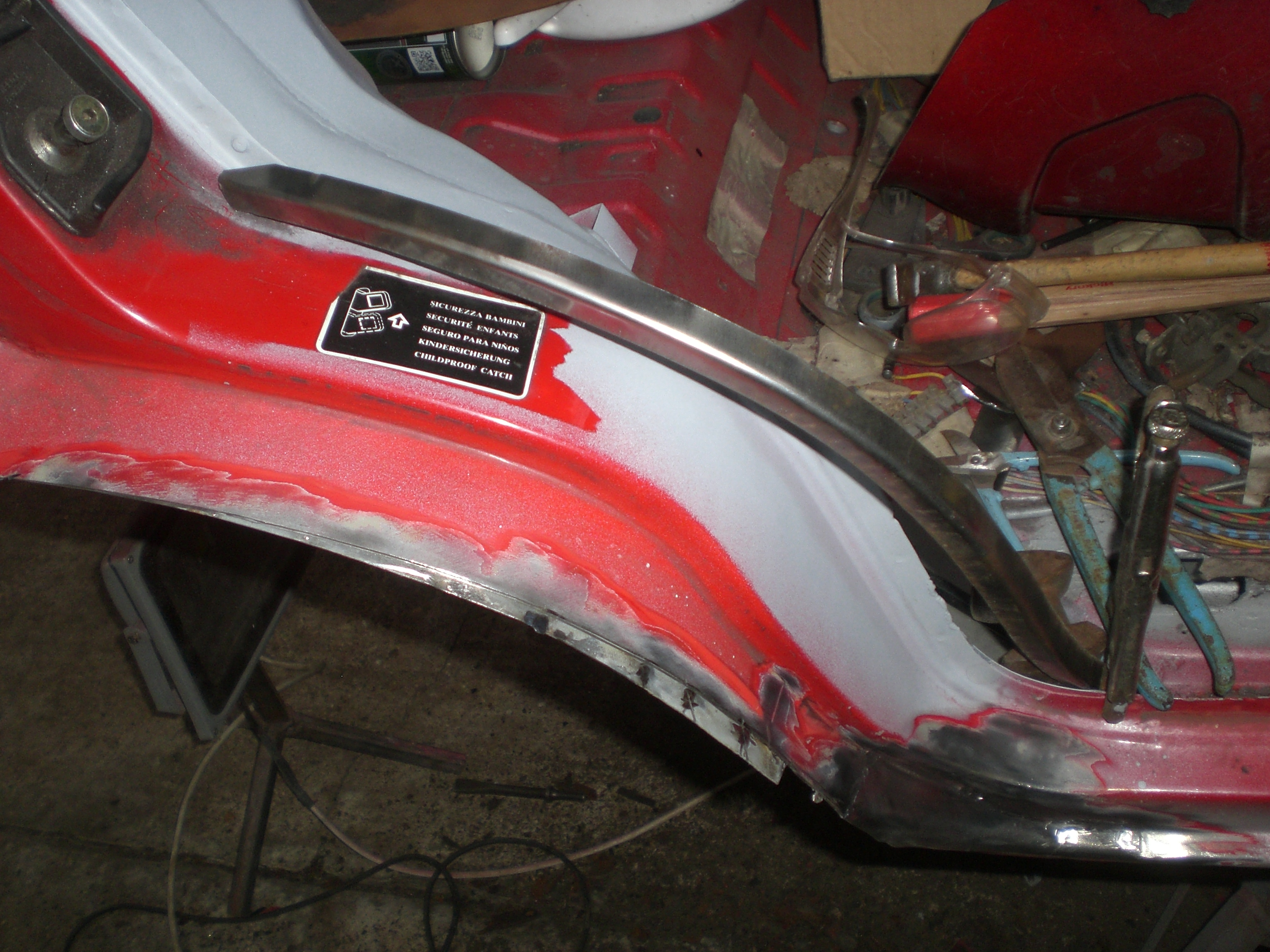

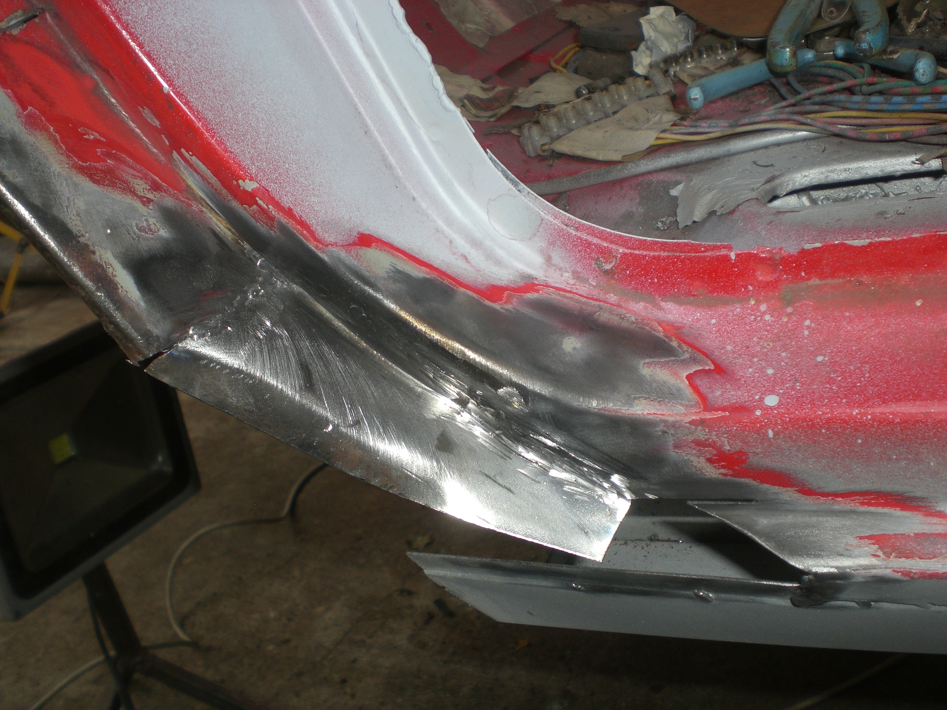

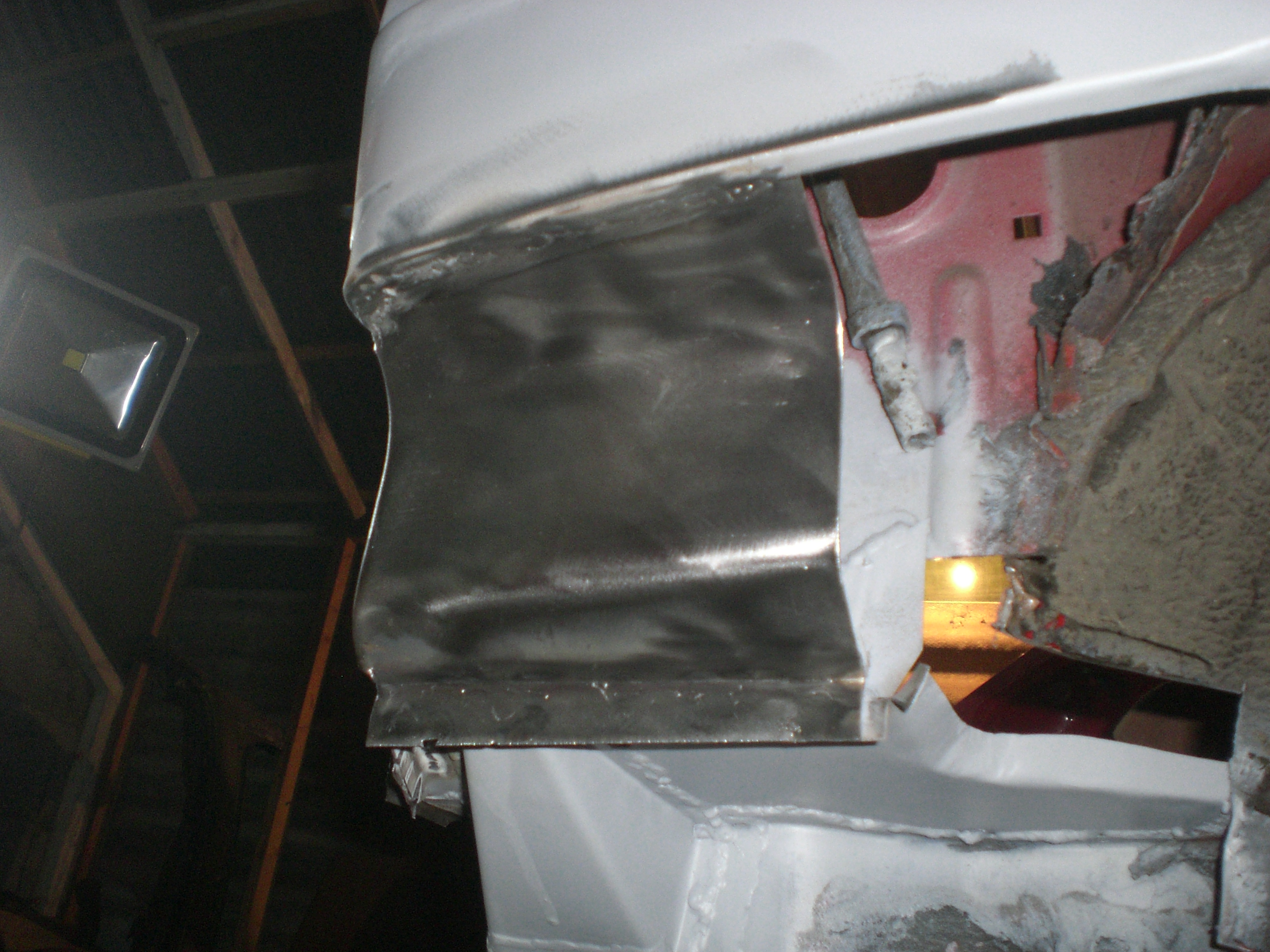

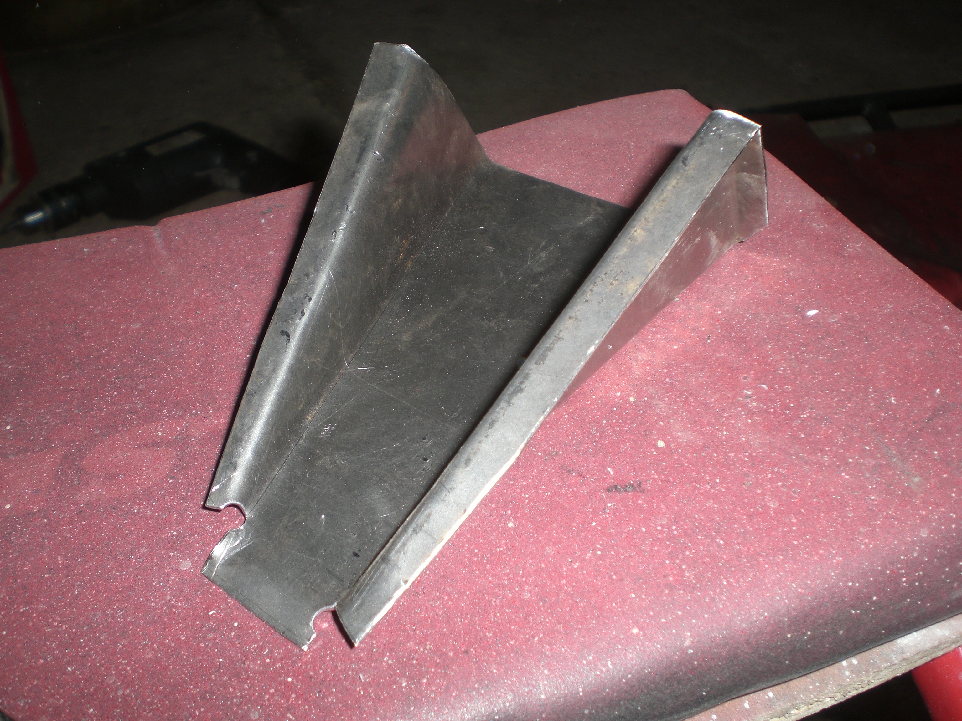

next job to chop off the rust arch edge and make a new one,
bottom of the inner arch was all capped in plus the inner section linked into the previous new lip
new arch all welded in, it is quite a narrow folded edge that goes back on itself, like a U turn
when the door is closed the arch sits inside the door edge return, quite the muck trap, always needs careful cleaning which is why they rust so well!
when the door is closed and the sill cover is on you can't see a thing of all the hard work!

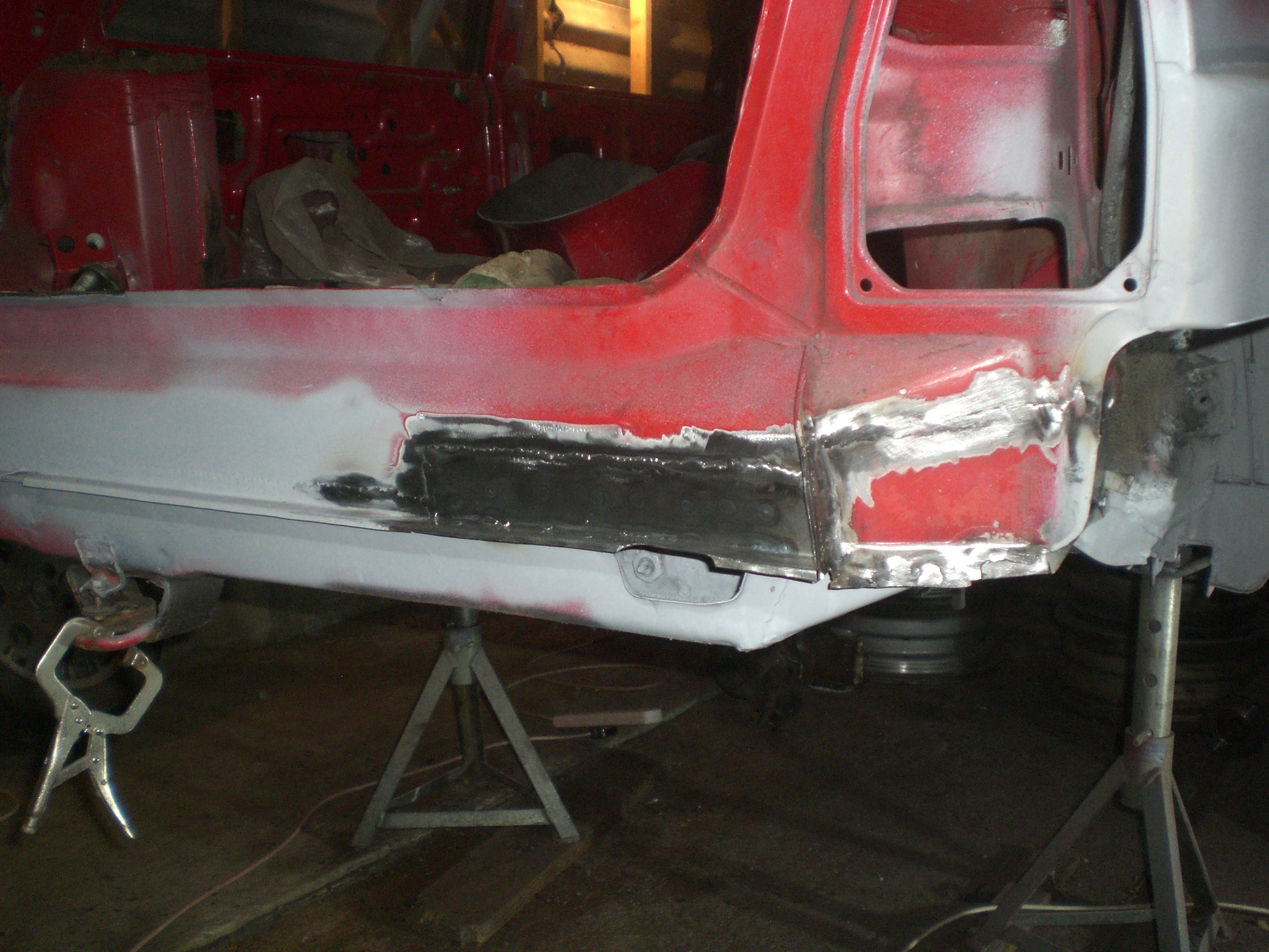

Other projects have again delayed progress on the Delta, despite having this week off work with the intentions of getting a few days on it I've only managed to get there today
So here goes a small update

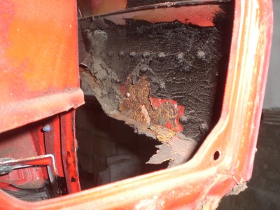

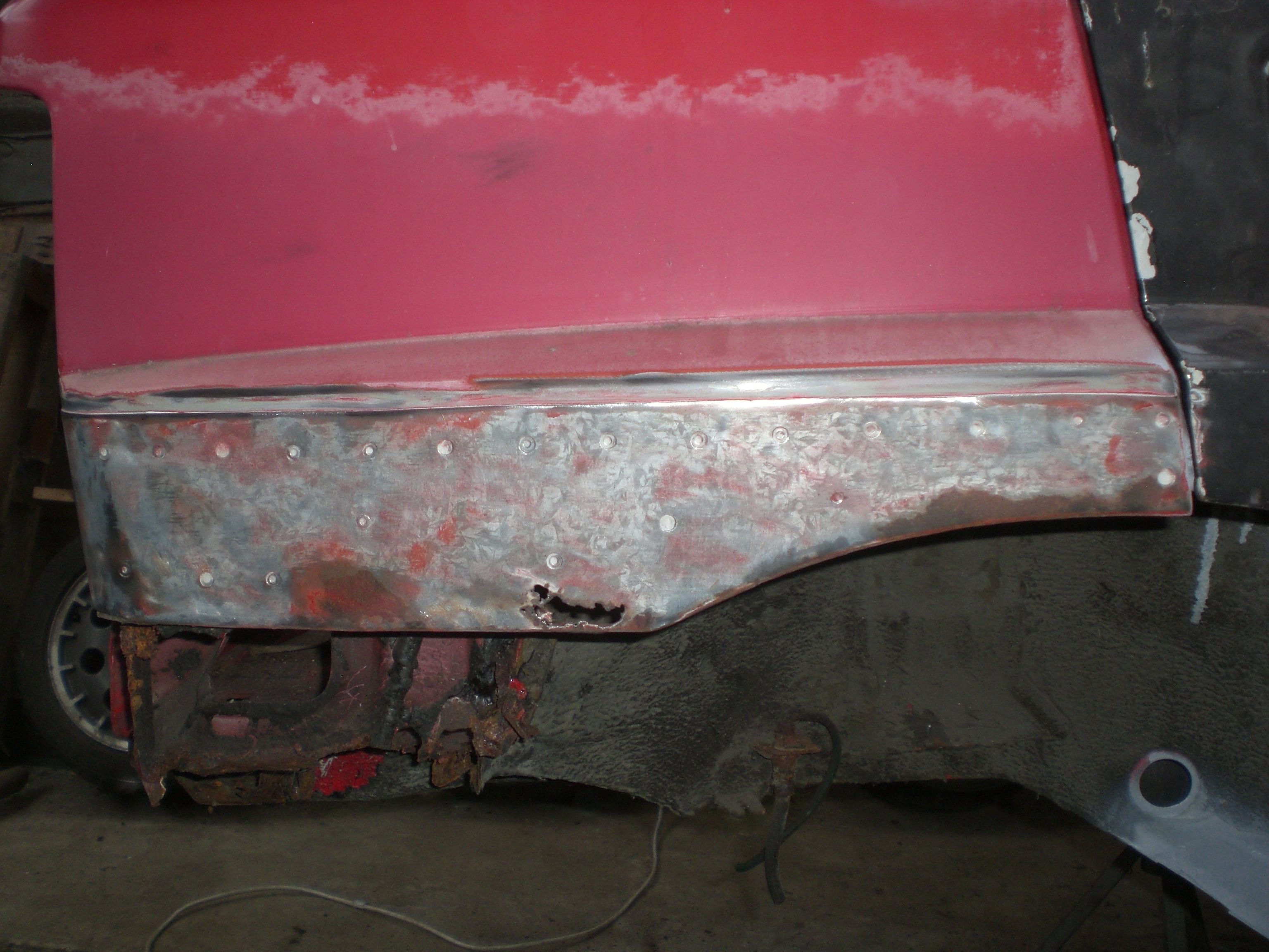

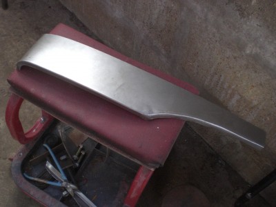

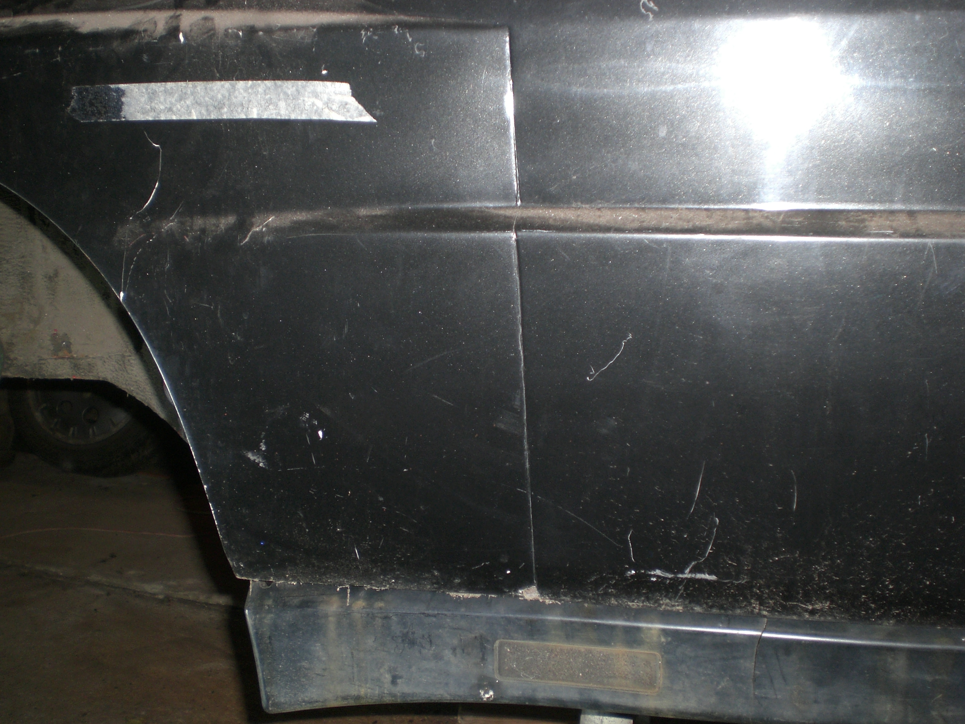

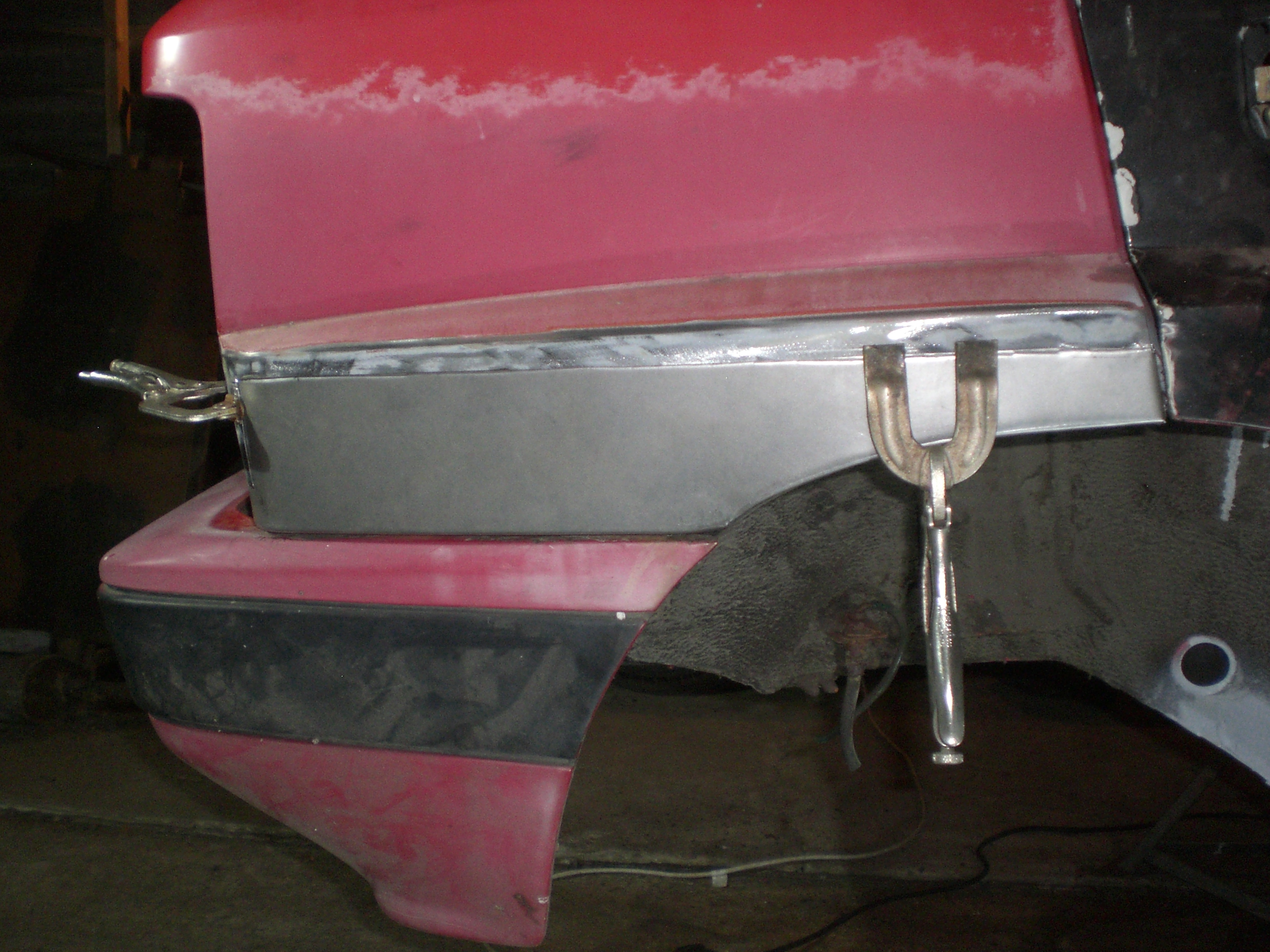

The rear extension arches that the integrale has had some rot in the bottom corners with the unusual sight of some pop rivets on the inner side, something wasn't quite like it left the factory!
Sanding off the paint from the outside revealed what has been done in the past, a repair section has been riveted over the top, a galvanised piece by the looks of it but that still didn't stop it rotting through both old and new pieces
You'll also notice the lip doesn't line up with the door edge, something that had got me thinking as the rest of the door lines are fine...

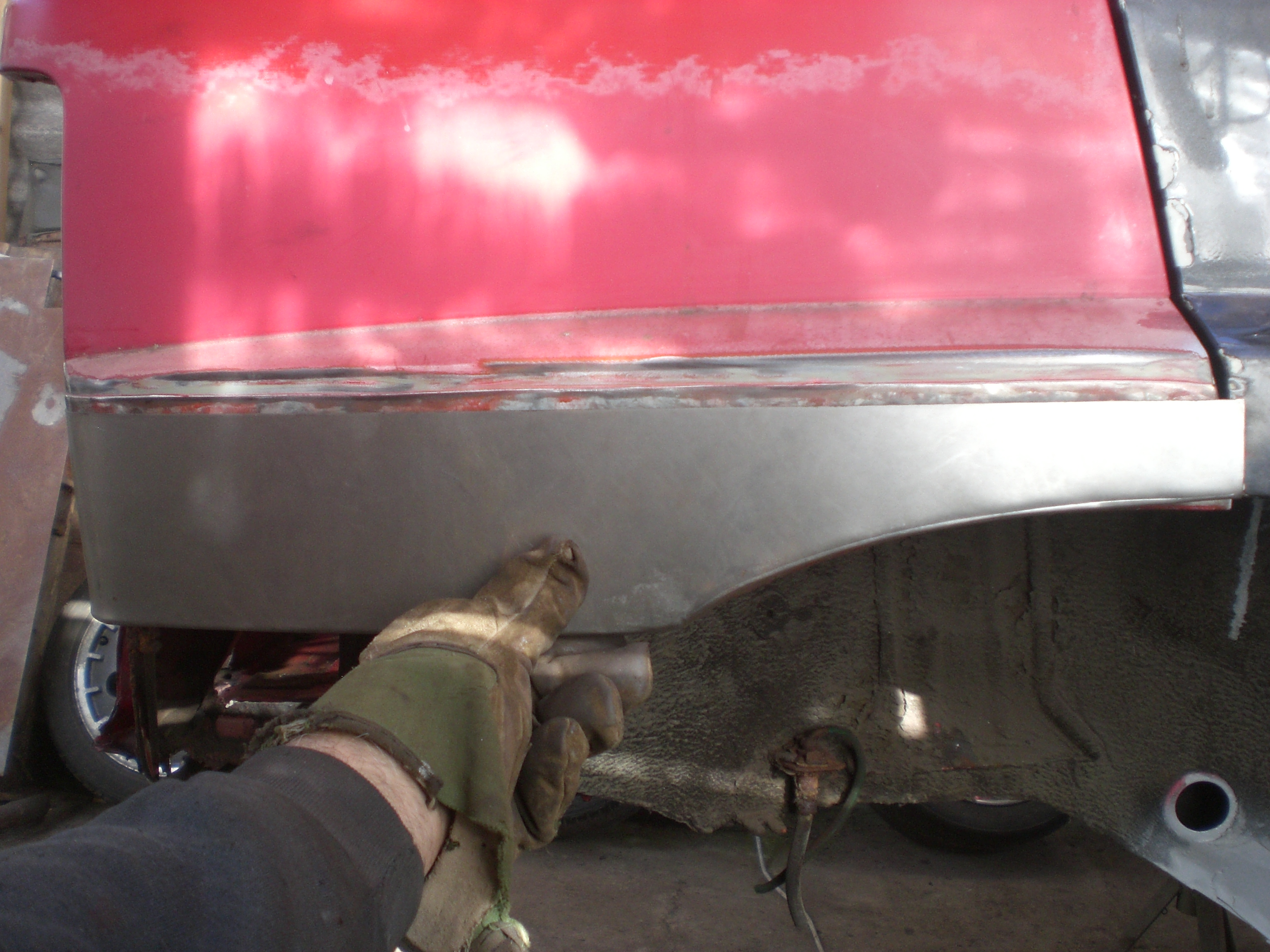

Only thing to do is to chop it all out and make a new arch section.

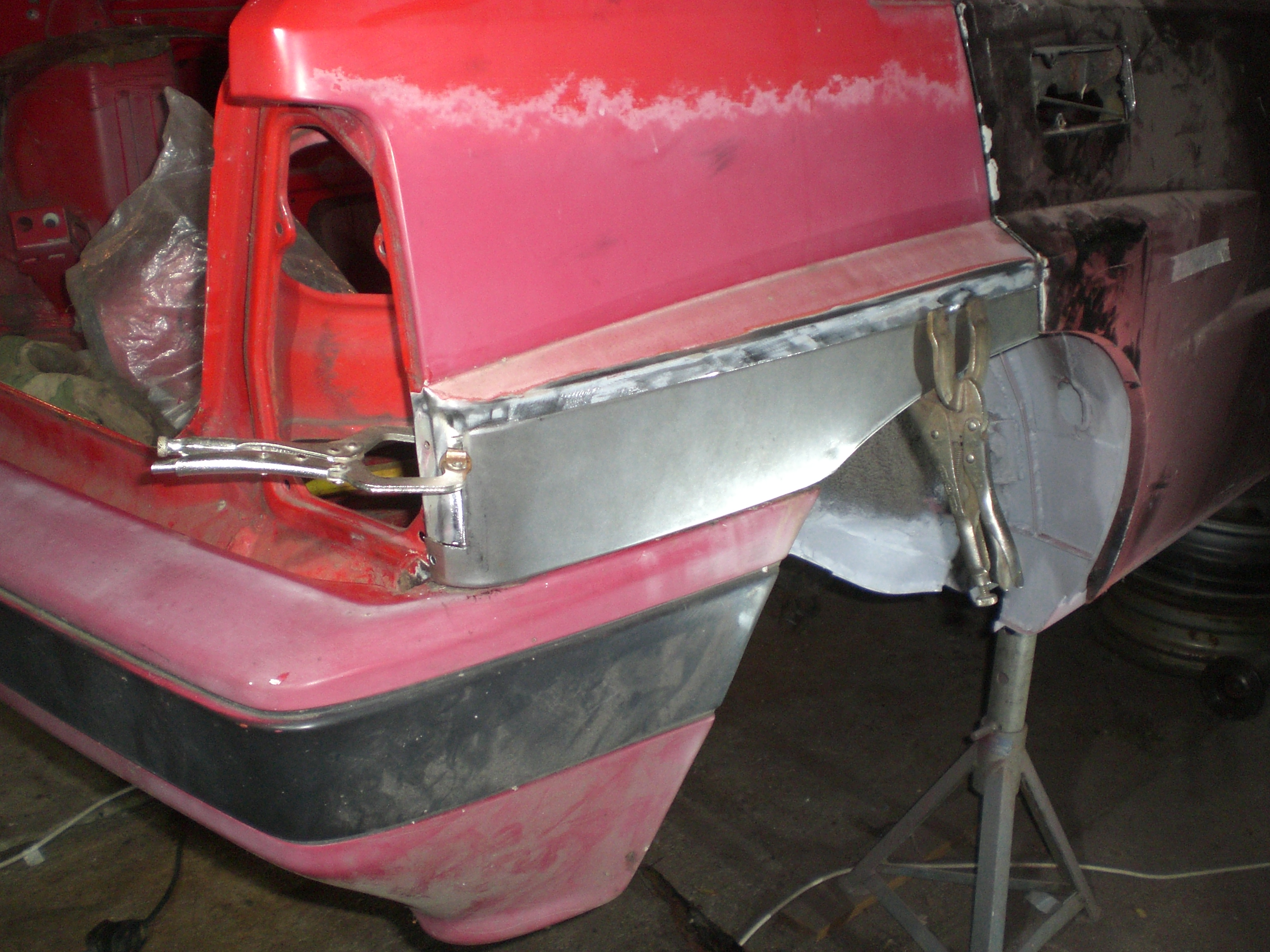

Held up to where it should go you can see how the previous repair section didn't meet the door properly along the bottom.
Bit more fettling to make a crisp joggled edge and reach for the welder......to be greeted by no gas
So all that effort and still didn't achieve a lot
Just a case of welding it in though next time, careful to check alignment with the bumper too
Of course there is still a huge amount of reconstruction to be done behind the outer arch including making somewhere to mount the side bumper guide, and making a side bumper guide!

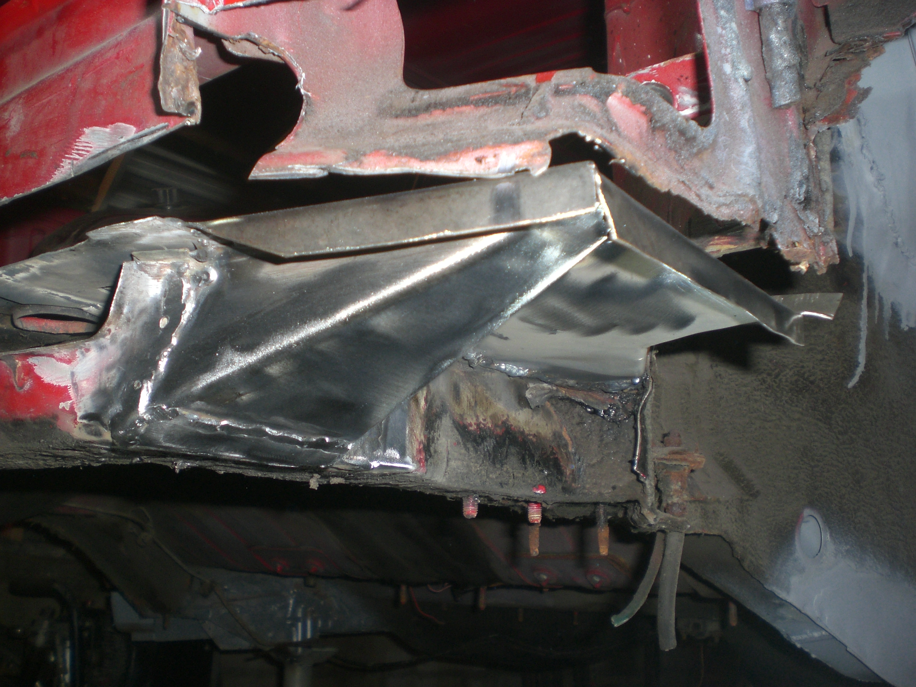

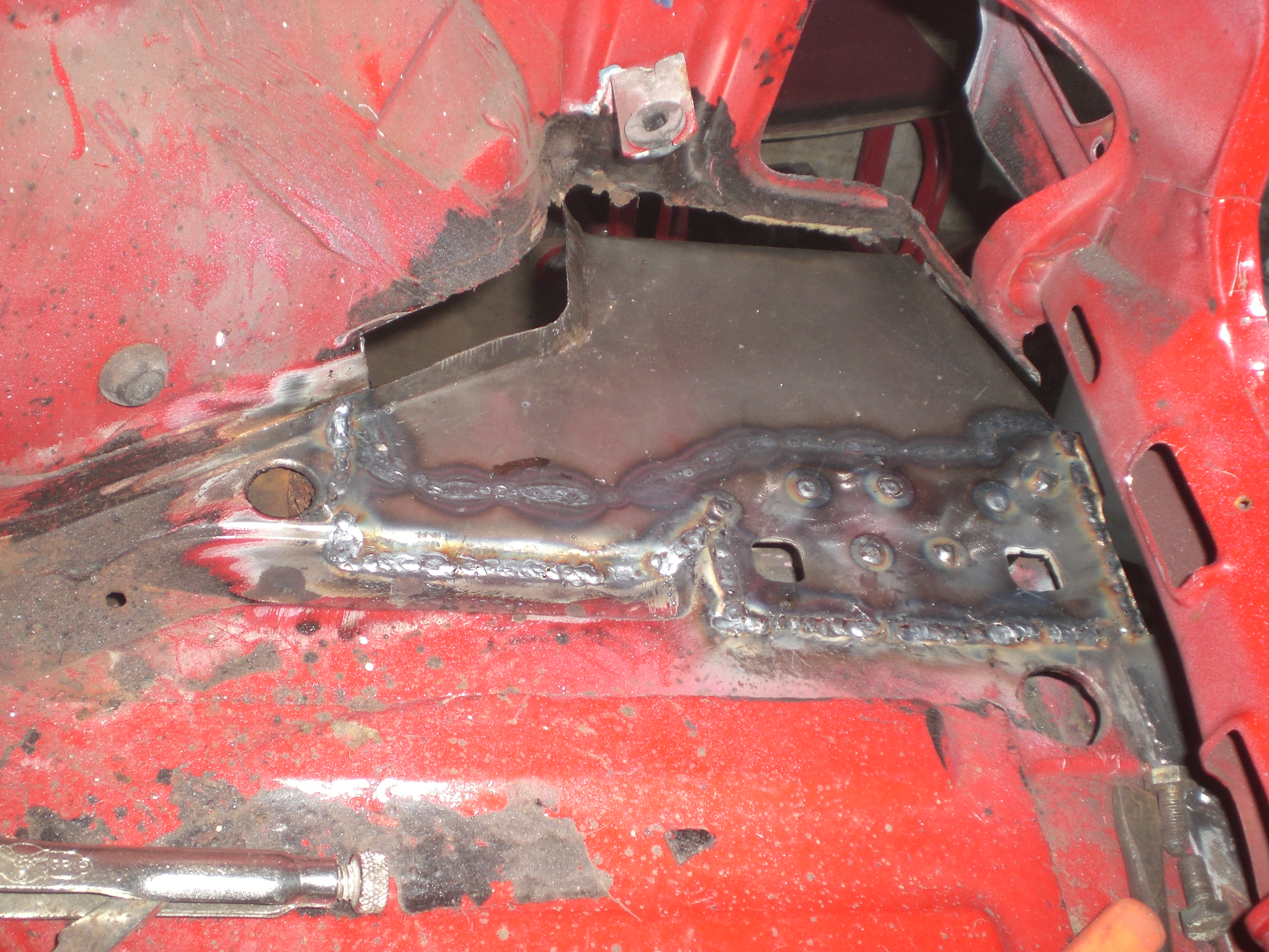

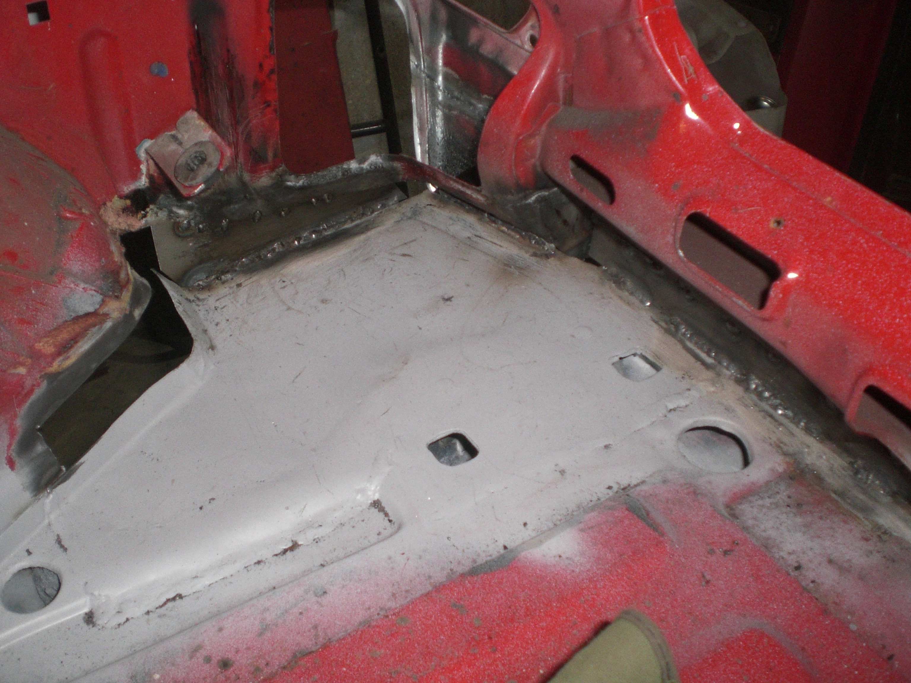

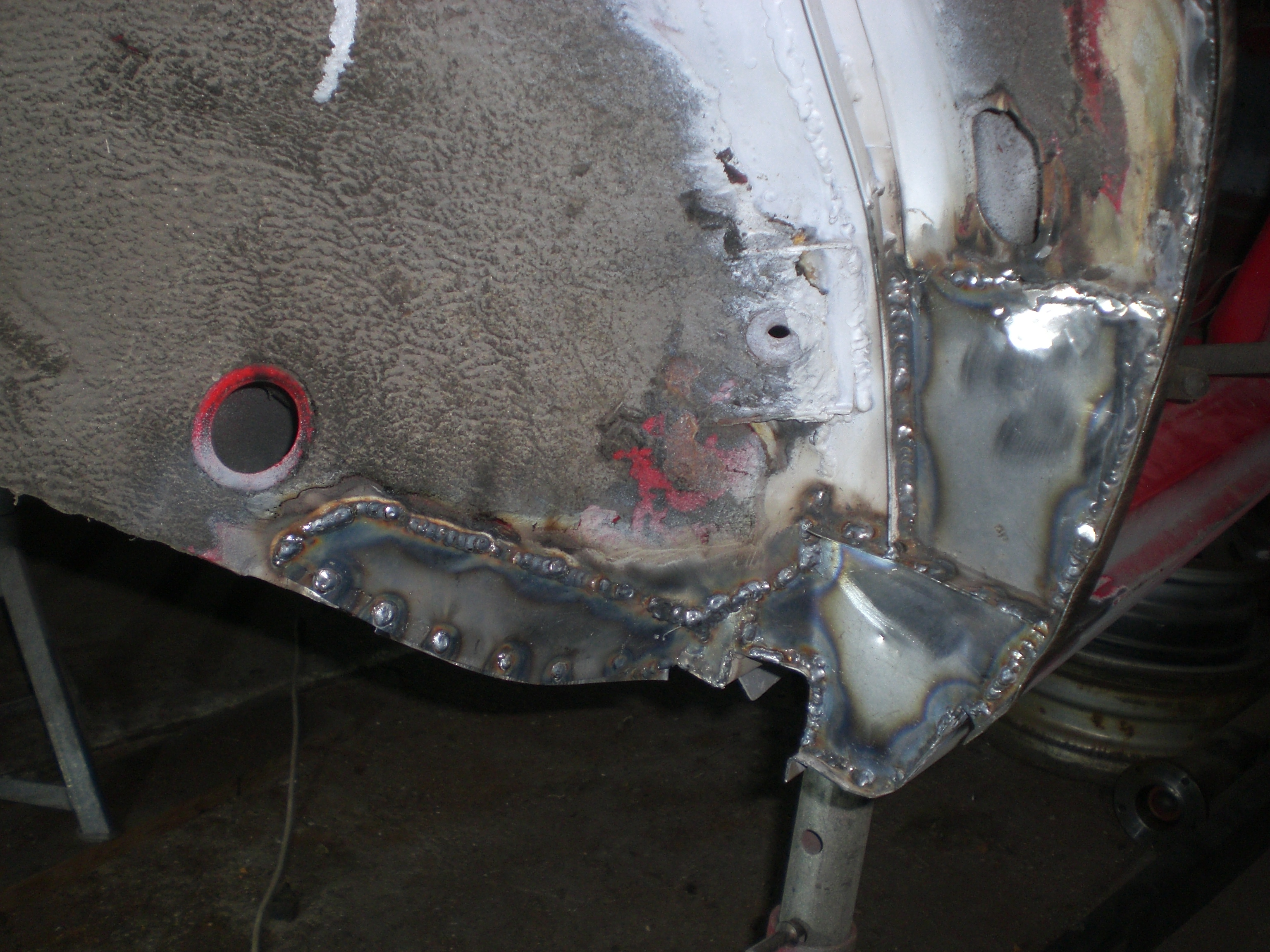

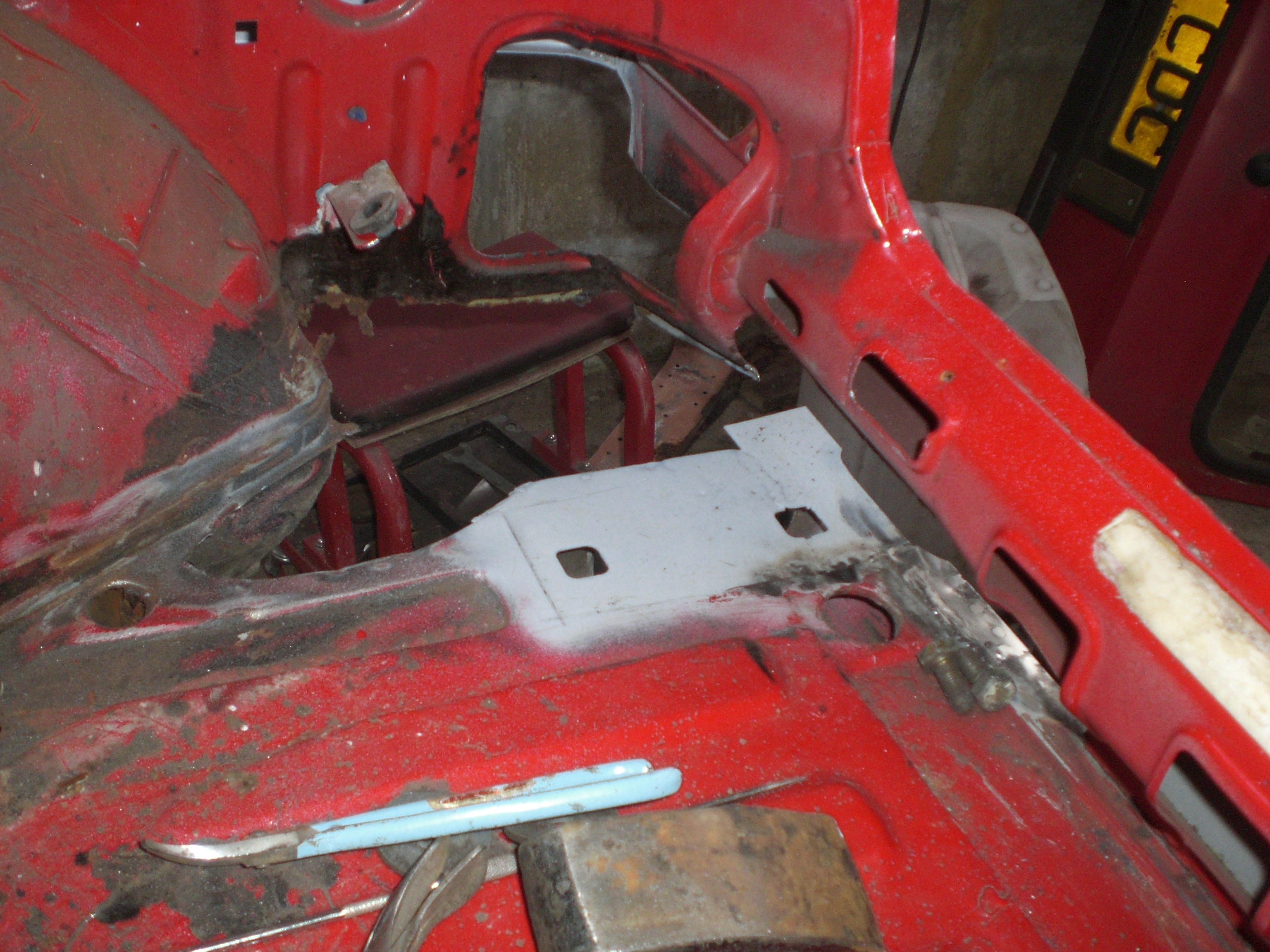

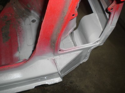

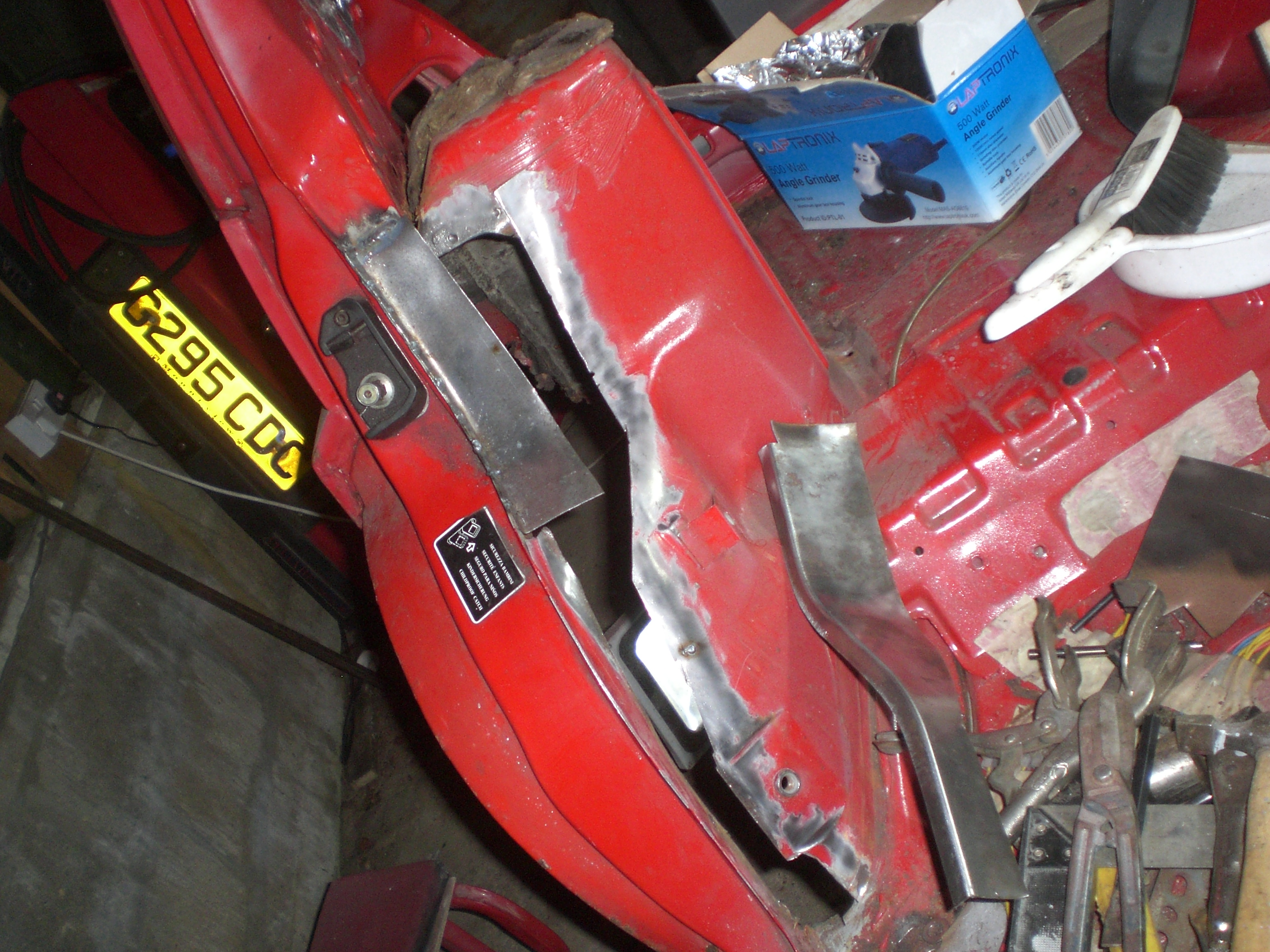

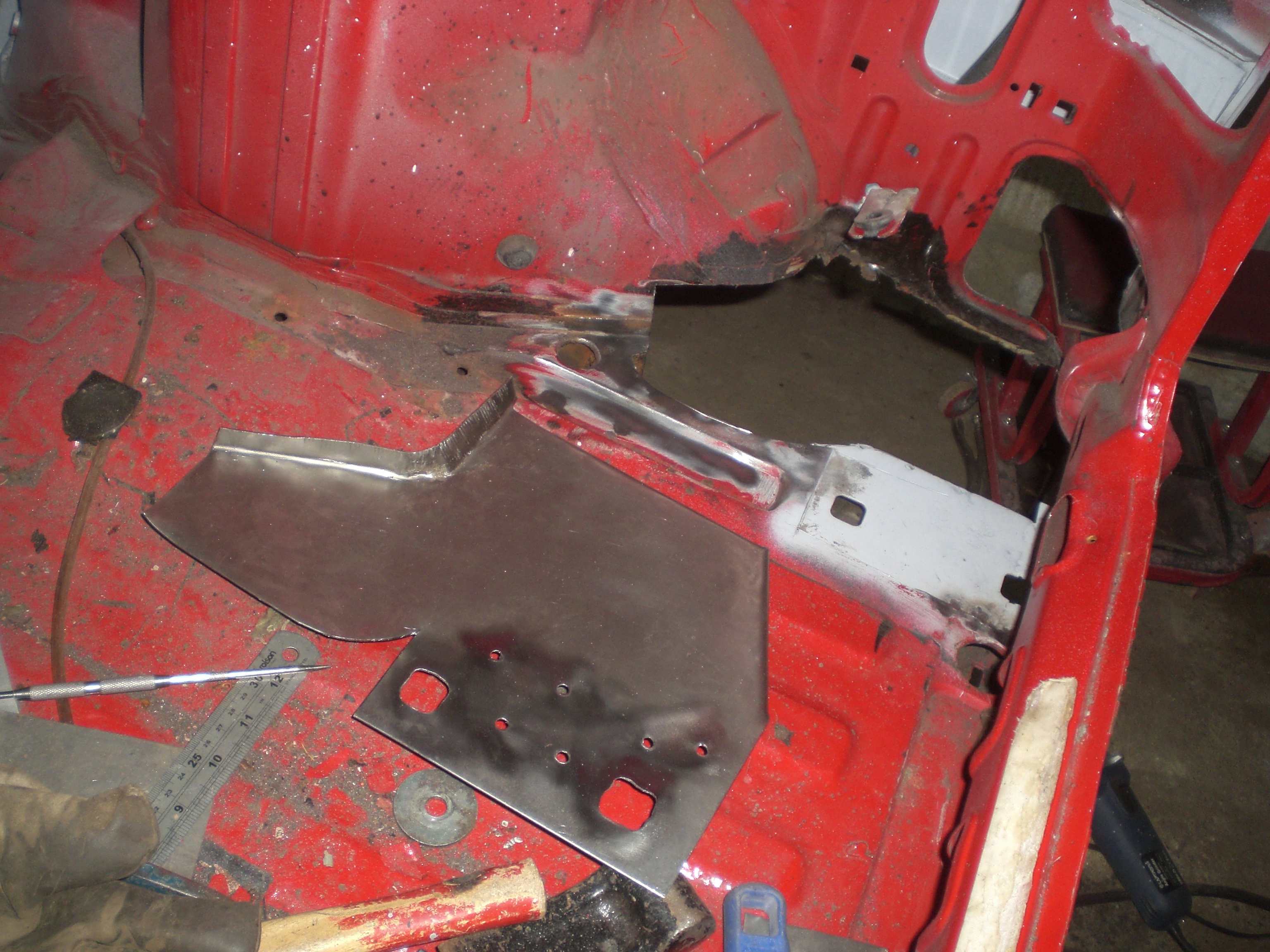

As much as I've tried to put it off the time came to chop out the boot floor grot, the outer seam got peeled back as it looked like there may be problems all along but thankfully only the top surface needs changing away from the outer ends.
Once the end of grot was found the bottom portion of the double skinned boot floor edge got repaired, still quite a space to be filling up!
A patch was made up to fill in the missing boot floor with the square holes for the bumper mount plus a few holes to allow plug welds to the lower section
All welded in and a good base now to build everything off
The chassis rail underneath got a small repair to make good a grotty bit then an outrigger got made up, would have been a lot easier to make in sections but neater results to be had by spending a little time.
This part helps to create strength in the floor corner and when the central arch is repaired back to it should make a solid base to fit the outer arch panel too, as well as a bumper mount
About it for today, all etched now to stop it rusting before next weeks visit, which at this time of year. Must say though I'm happy that the repairs are finally getting going, this is almost the last big job welding wise

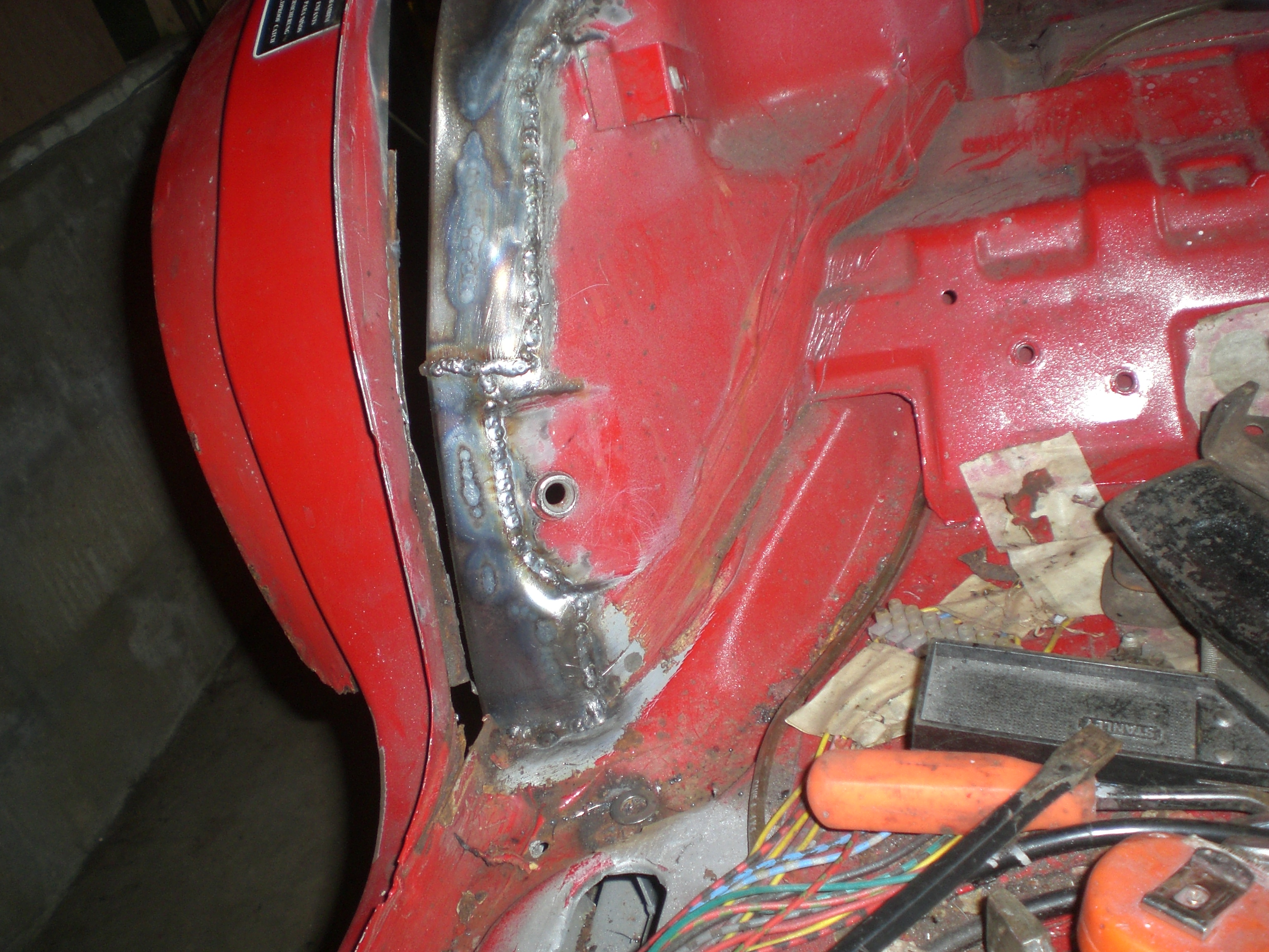

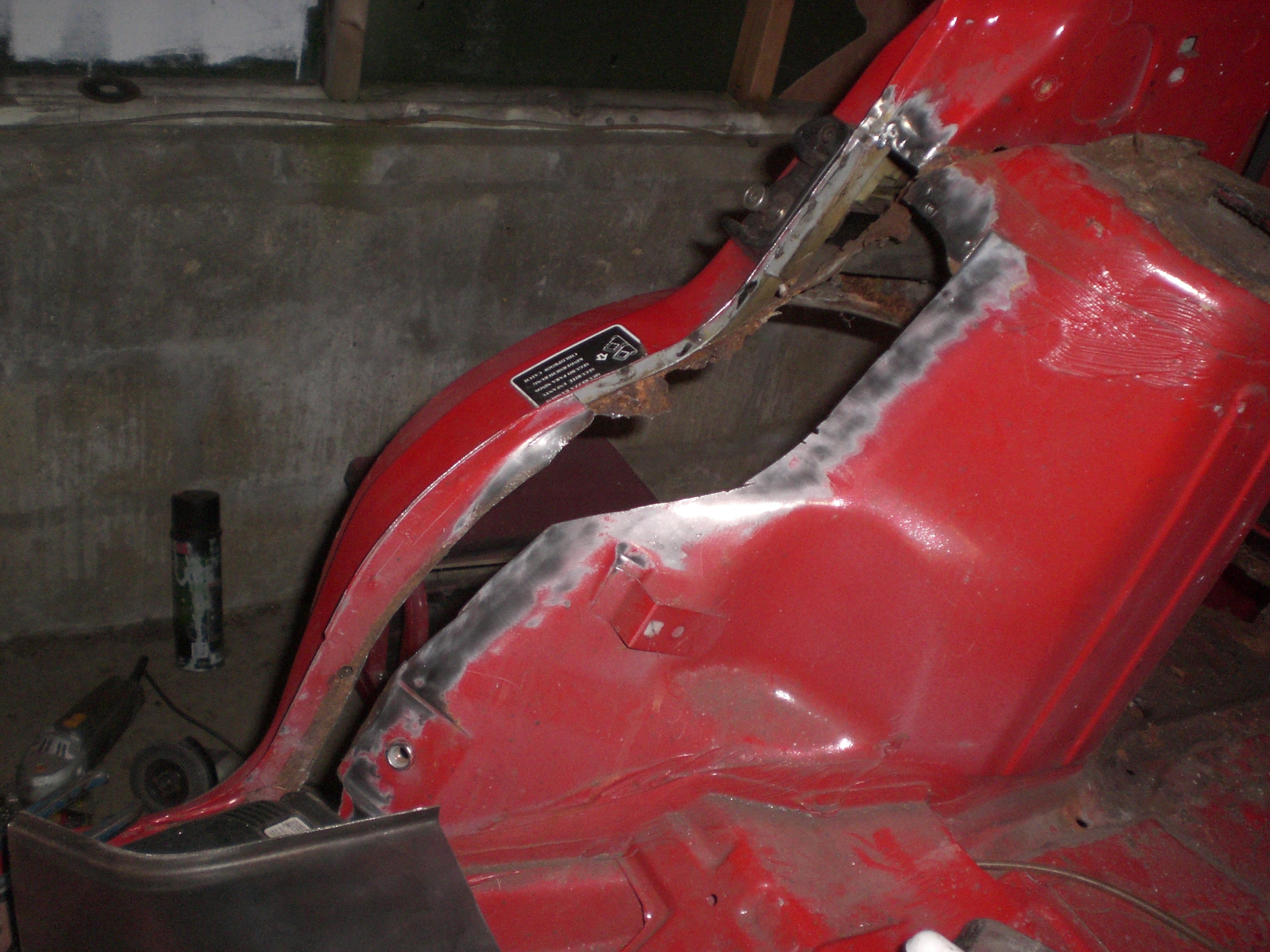

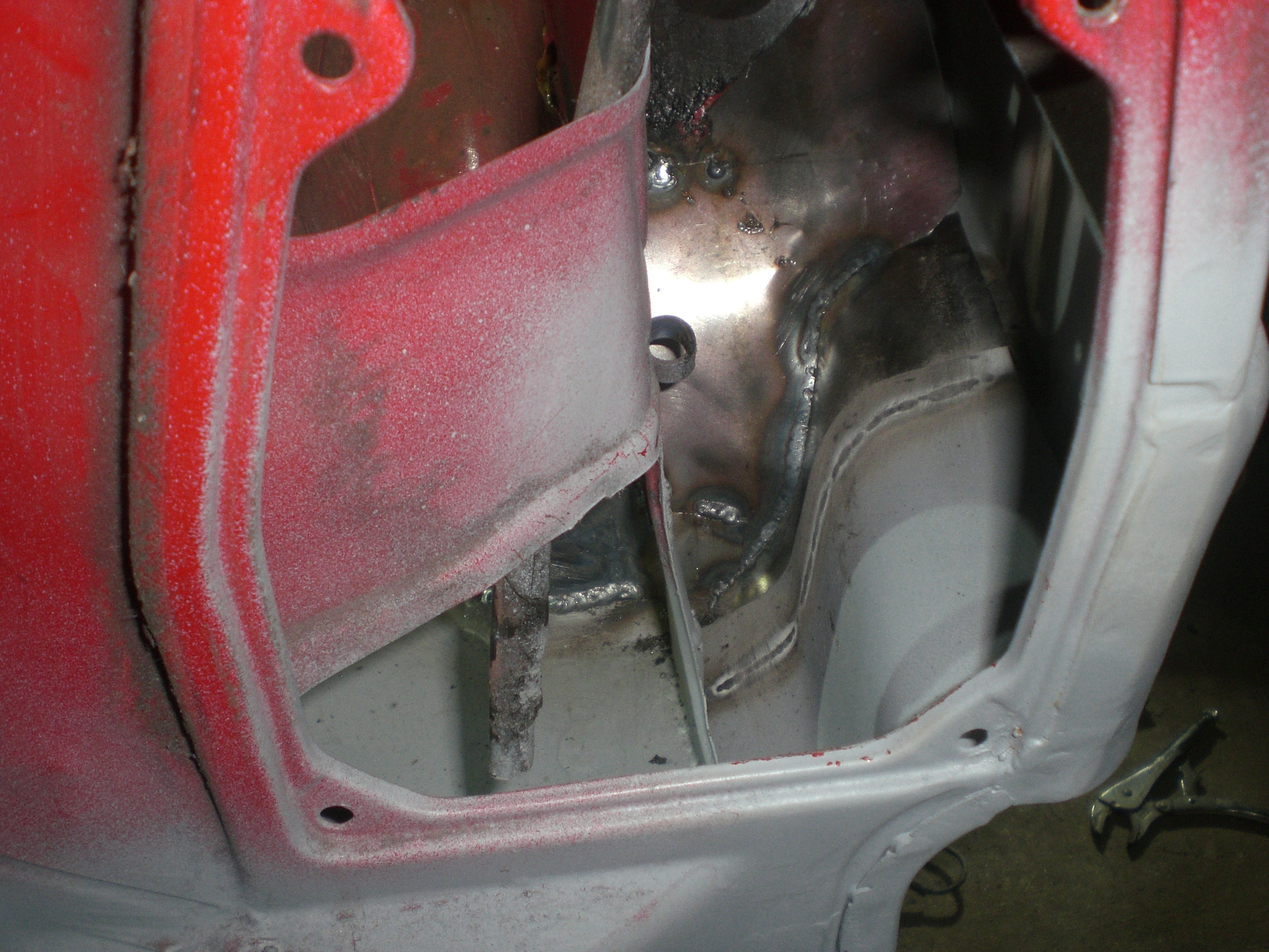

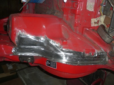

the reconstruction of the boot floor and inner arch continues..
started off repairing the rear panel seam edge at the central section
then the taller piece that goes over the bumper mount slot and joins the seam, which the allowed the inner repairs to be made and the outer panel to be welded back in place
next stage was to make the closing panel that would link the inner arch to the bottom edge of the outer arch I made last time, not as easy as it looks as had to line up in some different directions
bit of cleaning up and some etch primer on and that was my day done. little steps, but at least i'm making some progress, just need to get off my arse a bit more and stop having late starts and long dinnertimes

Drivers side rear arch behind the bumper section got finished off on Wednesday afternoon, luckily the integrale I had a good look at at Cadwell the other week meant I had a better idea of what it should be like, fresh air both sides didn't give many clues
I'll do further up inside the inner arch when I turn the car over, be much easier than trying to weld upside down.
Main thing though was to get this area done before it goes on the rollover frame as I'll use the bumper mounts into the floor for the jig, so getting the bumper mounts sorted now is necessary as the underside and arches I'll paint on the frame.
