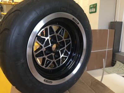

Hi guys,
Some things put a smile on your face beyond all importance.
My spare wheels came back from refurb today, cracking job. While being diamond cut they have managed to keep the wheel size and Speedline name.
Should look great on the car.

Re: 1974 Alfasud Trofeo
Very nice.....just need to keep off those nasty sausage kerbs
Lovely job done there Simon.
They look very smart.

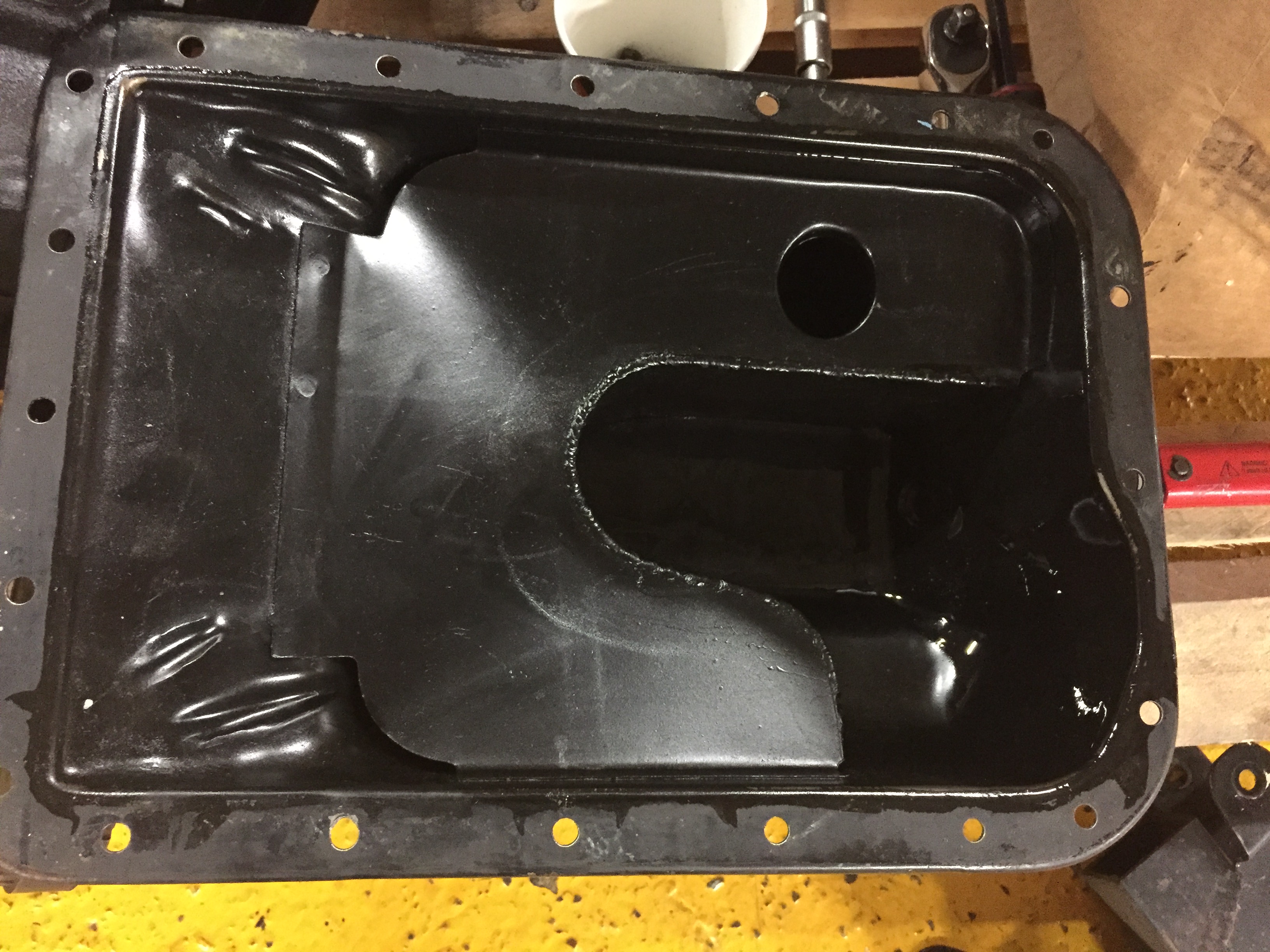

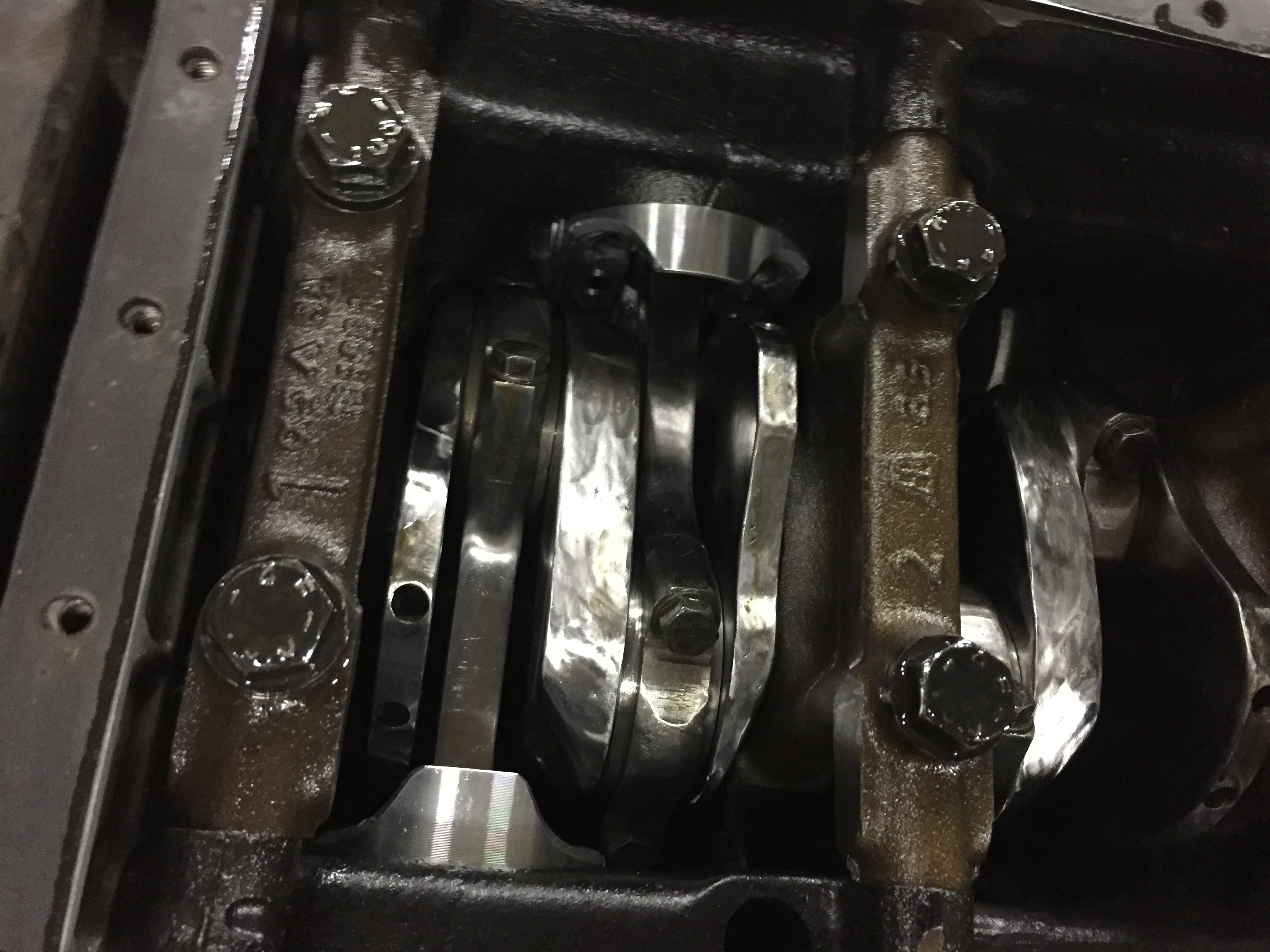

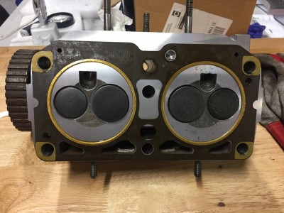

There was a spare engine with the Trofeo and I was not sure what it was.
I took the cylinder head off and it is 1512cc and it looks like it is high compression and has been gas flowed and polished but standard valves at 38/33mm?
Everything looks overhauled with new pistons, polished rods and polished crank plus a baffled sump.
Might be wise to fit some ARP big end bolts though.
Are the Pistons std and do the cams look reprofiled ? 1512cc is +4 I think.
I have a 1700 engine with 38mm valves, it gave more torque but a similar top end power to 40mm but that was mild tune not race.
My other 1500 engine is all std components, I think 40mm valves and reprofiled cams and that gave good top end power so you probably still have a powerful engine there.

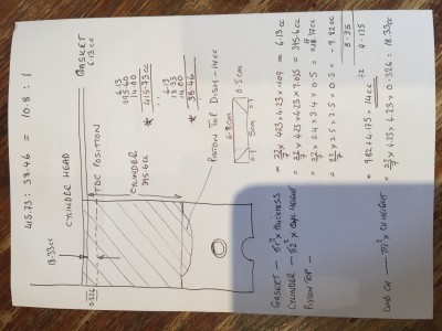

Hi Tim,
Thanks for the info. The pistons are stamped 84.6mm
I don't know what a re-profiled cam would look like? The valve lift is 9mm if that helps.
I have been trying to work out the compression ratio but I am getting awfully high figures. Back to the numbers to try again.
+6mm in that case, got my maths wrong!

- Posts: 976
Thanks Tim.
I read that bigger valves and more valve lift both increase the flow rate in the head linearly up to a limit of course.
My latest calculations come out with a compression ratio of 10.8 : 1 which I reckon is not far out.

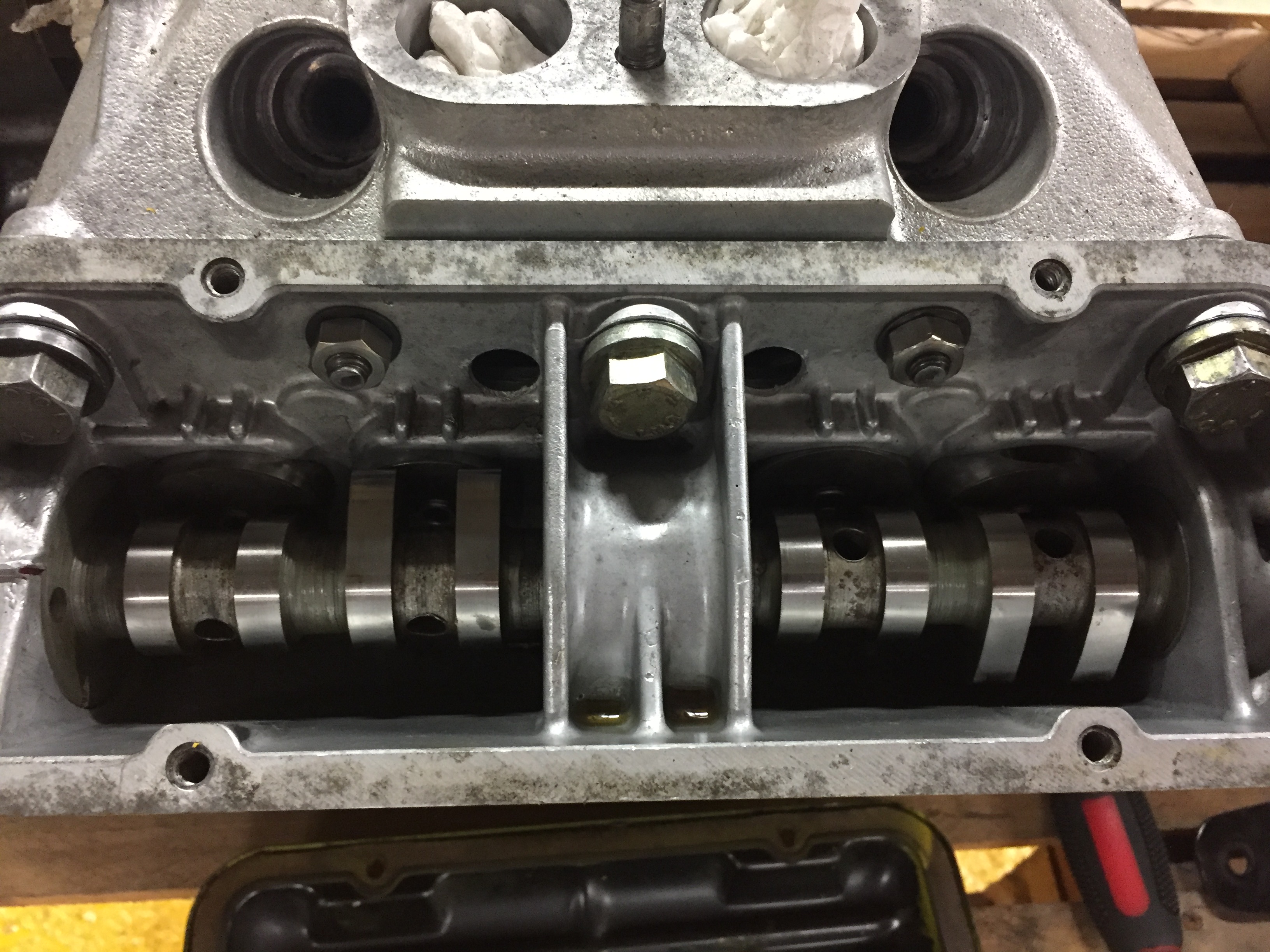

Those cams look proper high-lifty to me. Base circle diameter looks smaller than stock, so may be re-profiled lobes rather than a new forging.
