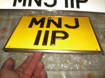

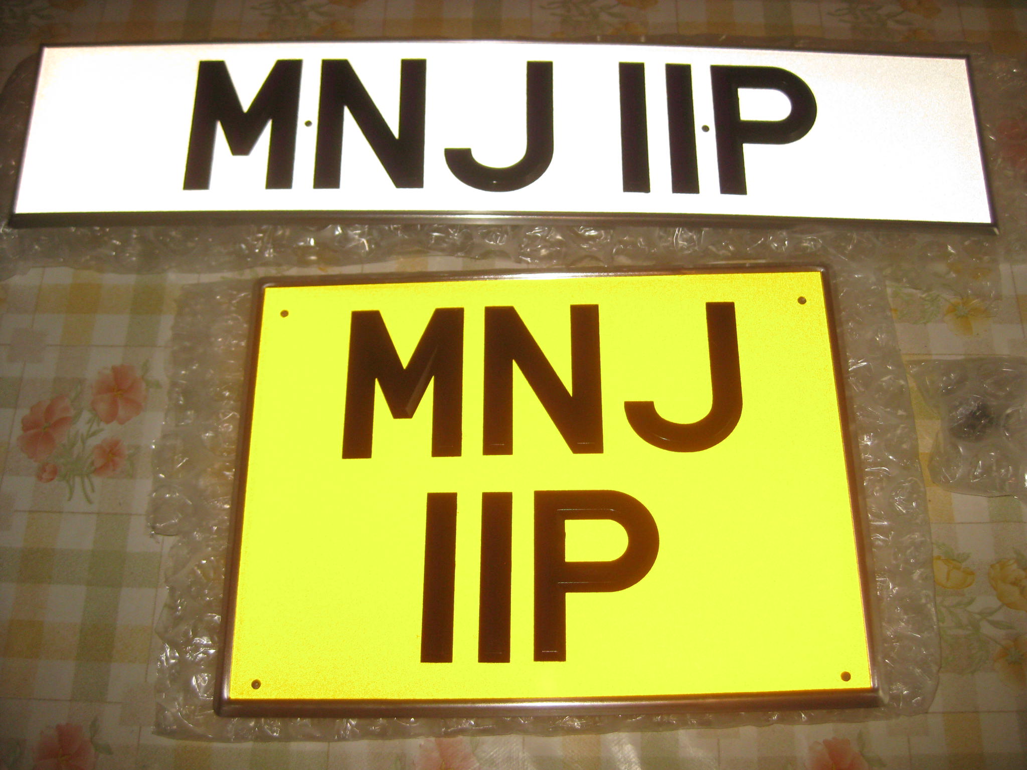

Just a heads up ref. no. plates
As we can probably all remember cars in the UK up to about 1979 when new had aluminium no. plates with raised plastic letters, then for about 2 or 3 years one piece pressed aluminium ones and then from about 1982/3 the type still used today, plastic laminate.
The ones on my car being a 1976 were the raised plastic letter type and the rear one was the original from new still with the supplying garage name on it (Anca Garage, Worthing) and front although original style had been replaced sometime back in the day although slightly different in design. The original plan was to restore these but on investigation the alloy was too badly corroded especially on the front one so I needed to have a rethink. Ebay turned up plastic ones and the boy racer german font ones in pressed alloy, no good for what I wanted so I found a company called 'Framptons'
http://www.pl8s.co.uk/index.html
Their raised riveted type were just what are needed for SI & SII cars (and older alfas etc.)
I ordered a pair over the phone, they asked for a scan of the car log book and passport
They arrived and look great, the alloy edges needed a bit of finishing off especially the square rear plate to remove burrs and pressing marks with wet & dry paper, steel wool & then some wet scotch but now look fab.
These come undrilled and the rear plate was slightly (1/4") taller than the original one so you need to be careful and accurate when drilling as the bottom hole positions are set really because of the boot lid handle. These are a lot more expensive than the plastic ones at £65 the pair but to me look a lot better and worth the extra.

A nice touch with the plates.
My car had the original dealer supplied plate still on the back, (front had been replaced at some point as it was bumped ) but that was a smooth laminate one.
Yours do look the part.

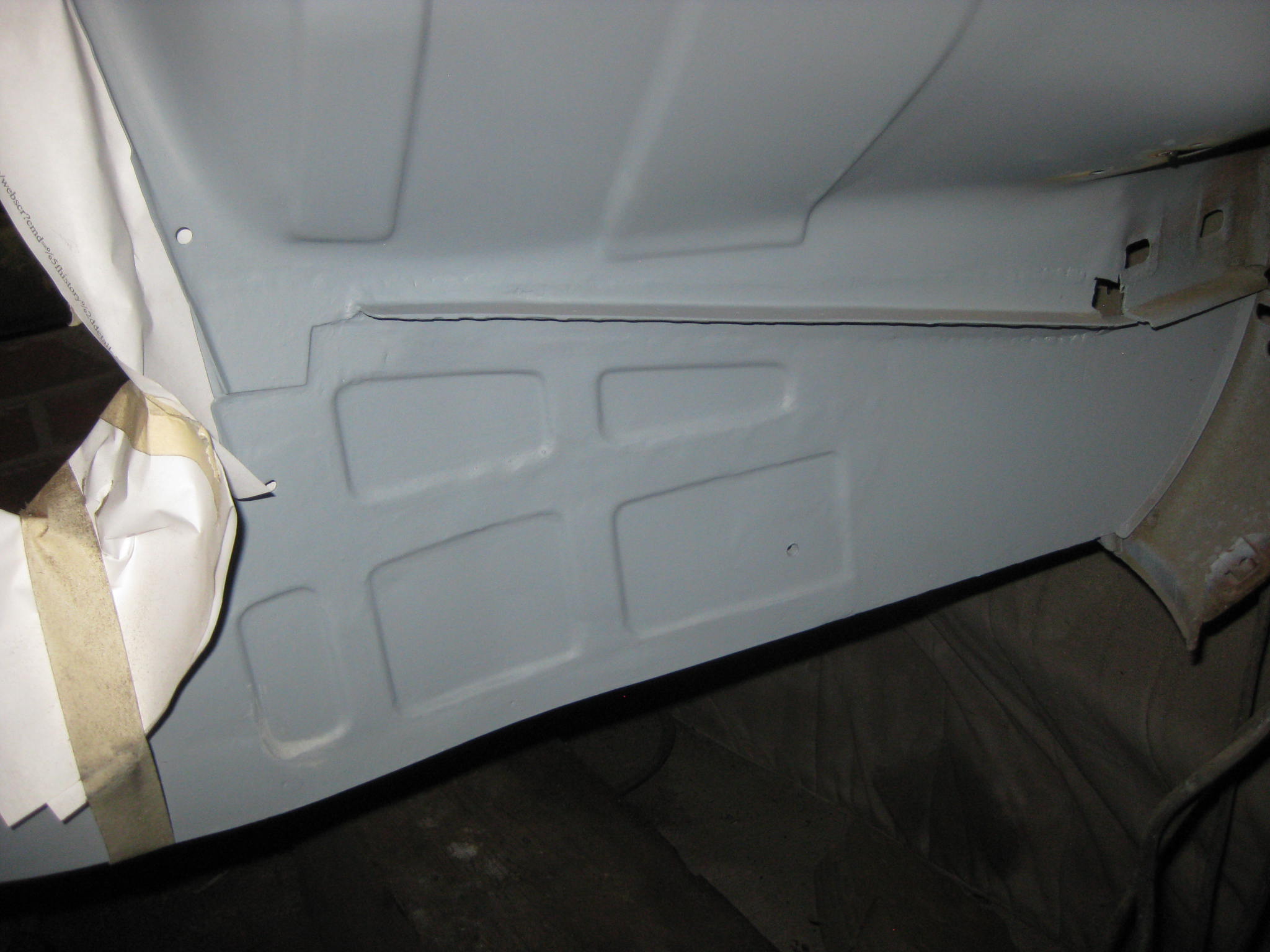

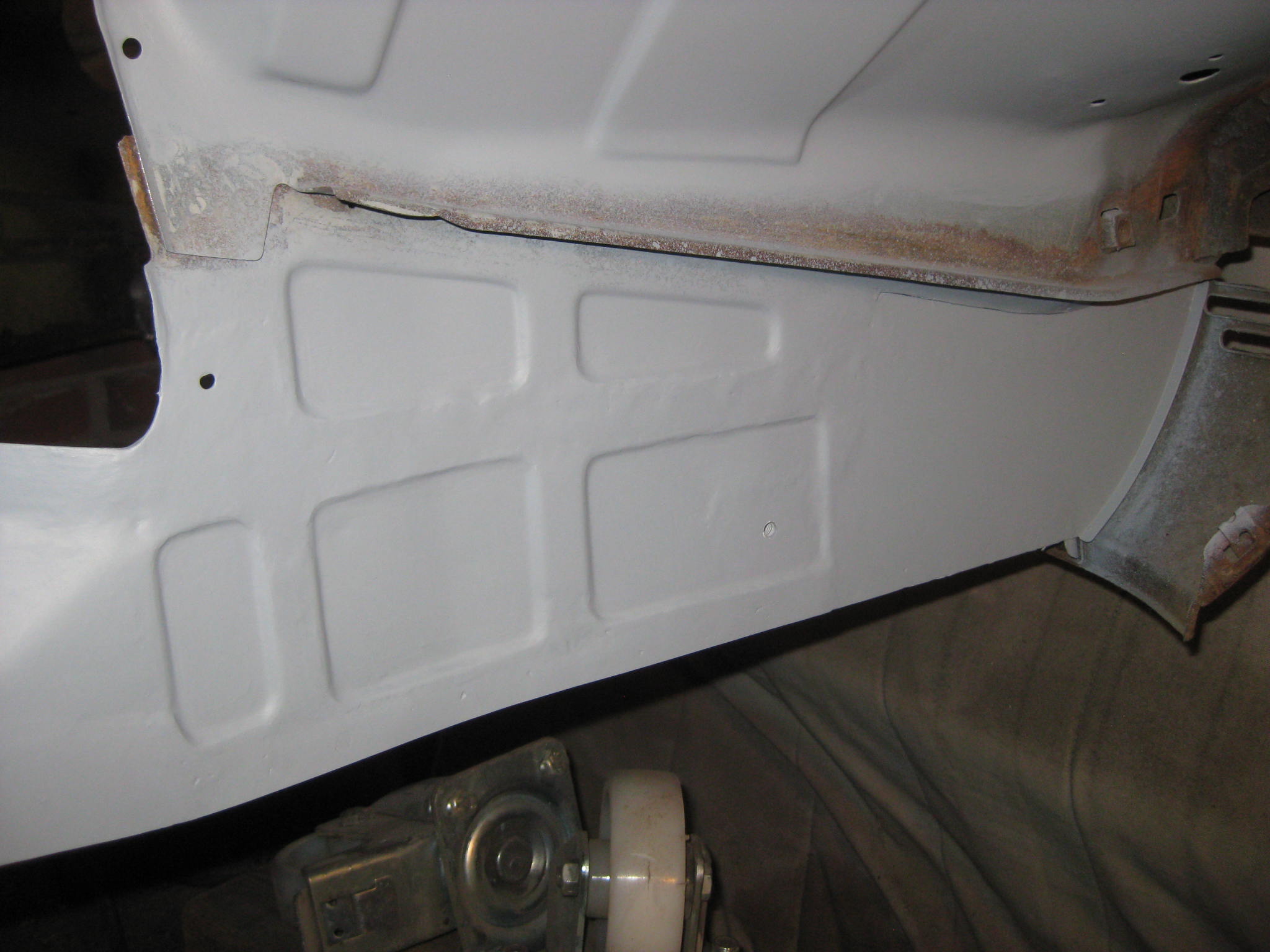

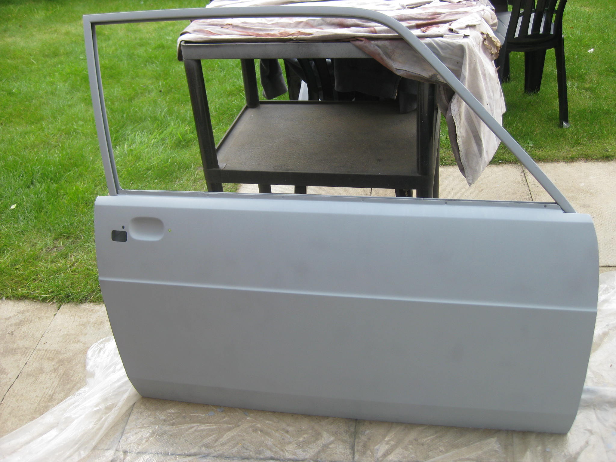

Thought I would run an update on progress.....

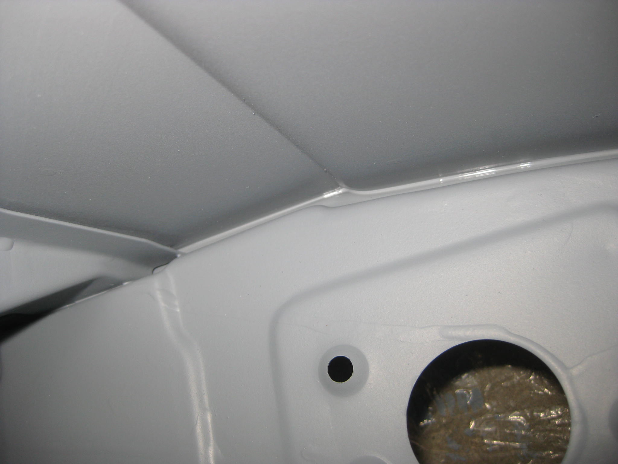

The door is now in etch primer.... I used a probe to spray it into the seams and turned the door over at different angles to make sure it ran everywhere
There are a few areas that still need repair but at least now it cannot rust

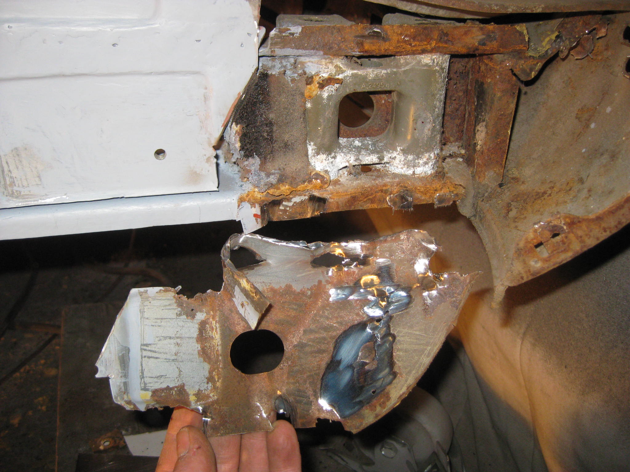

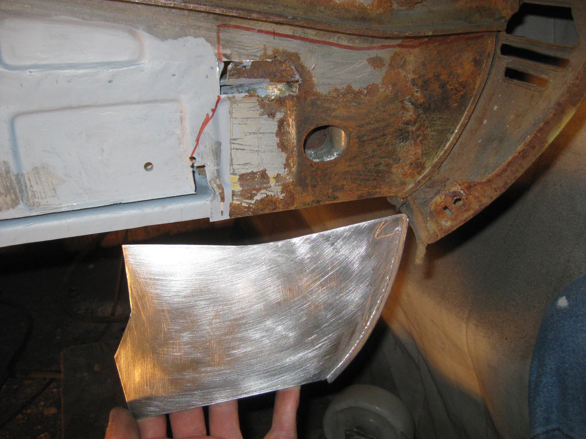

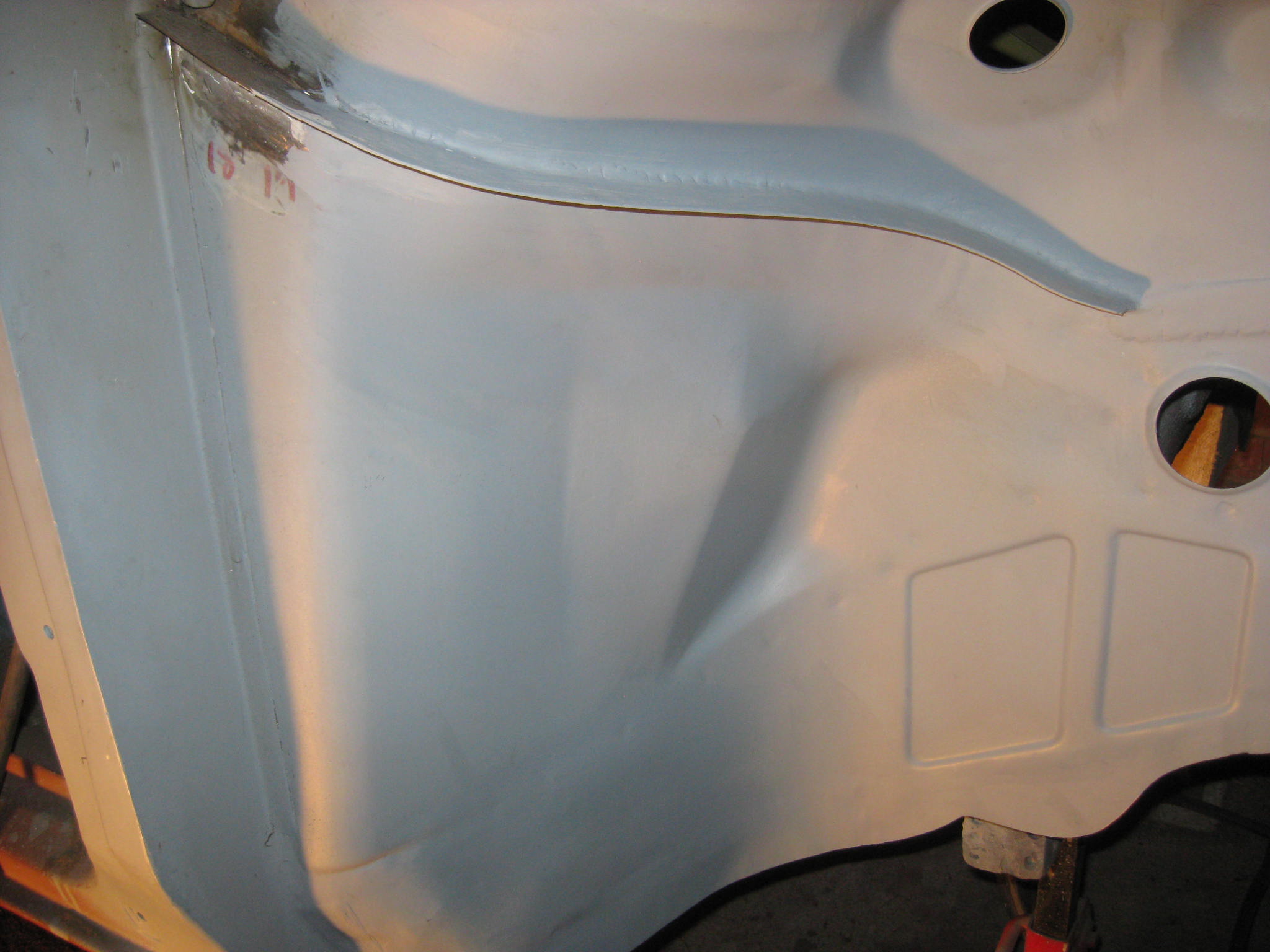

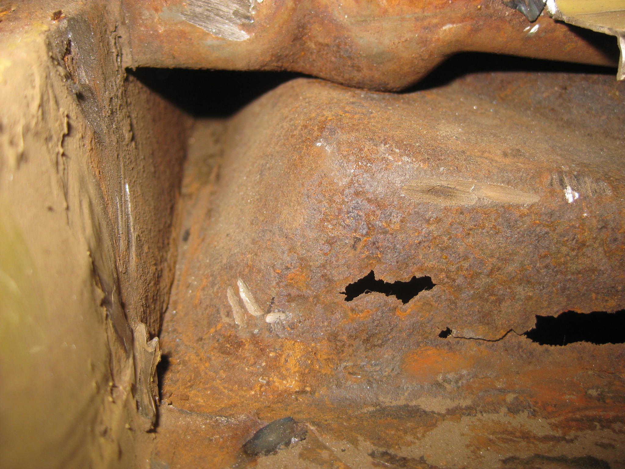

Now back to the O/S front inner wing area......

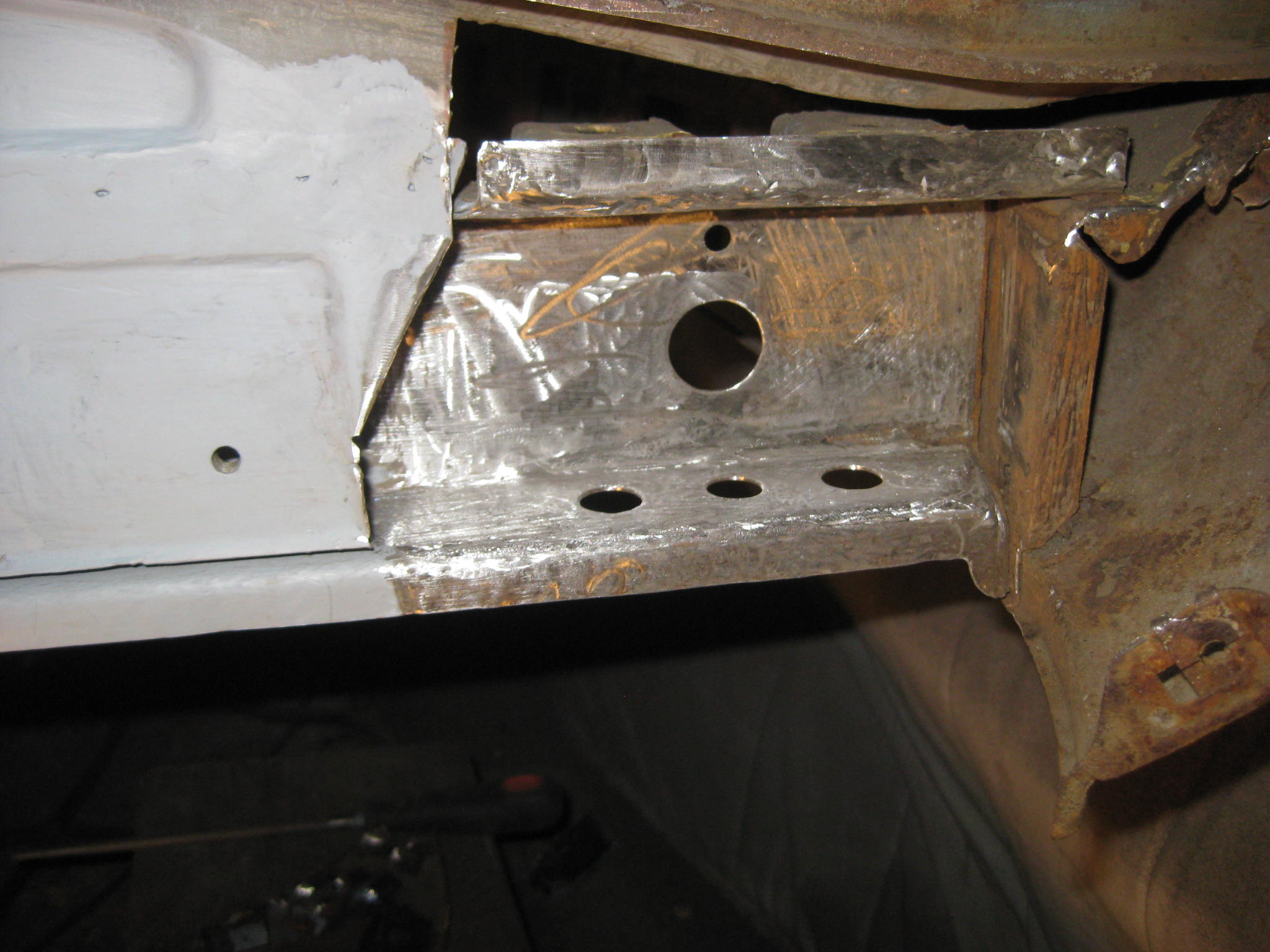

More rust in the seam between chassis leg and inner wing All corroded area cut away and new piece made up, tacked in place then seam welded & then welds carefully ground back

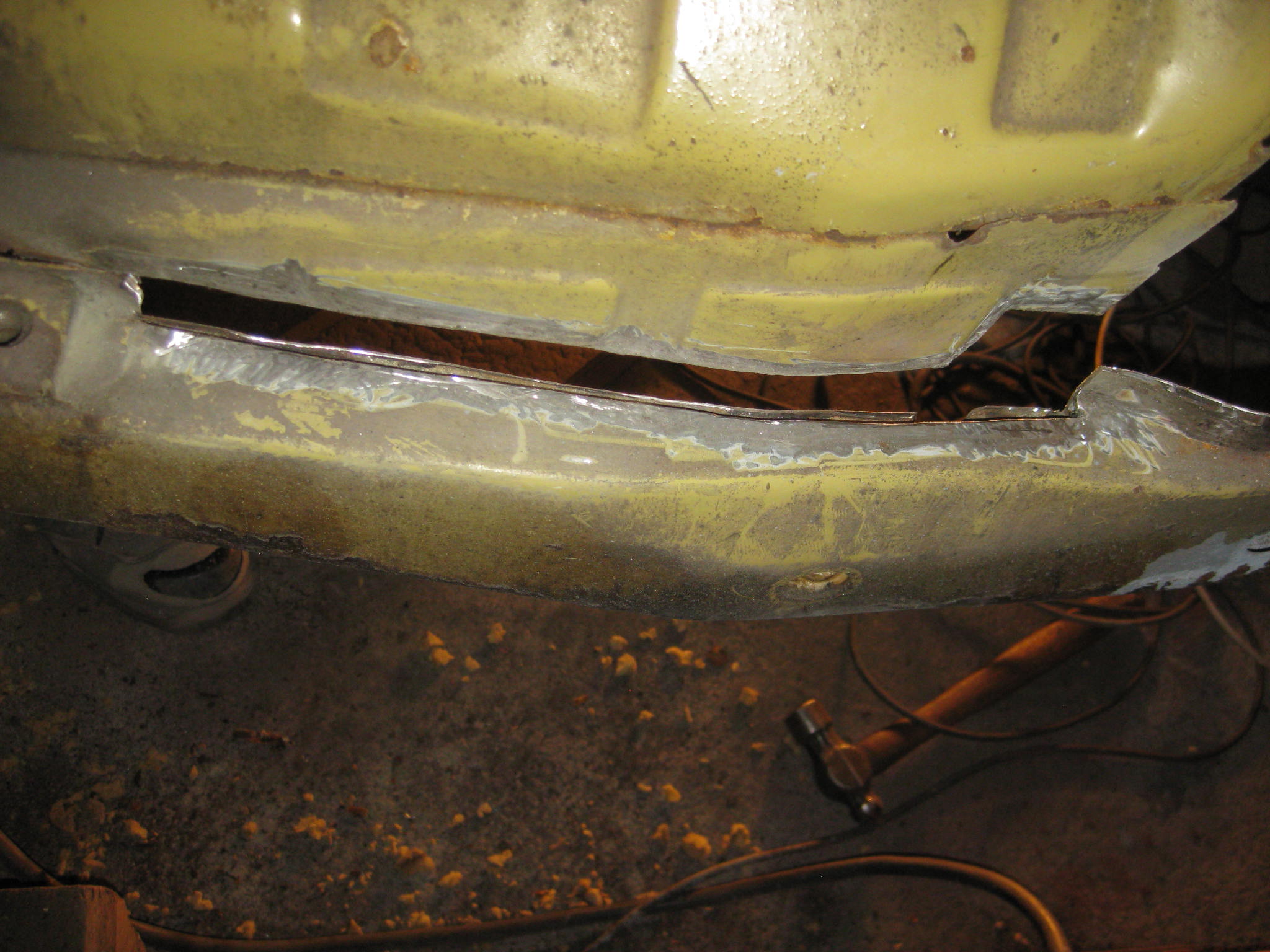

Rear 3 way seam all cut away and repaired

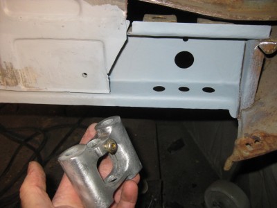

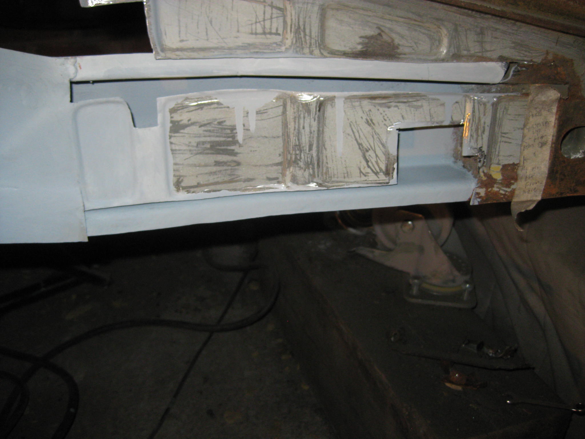

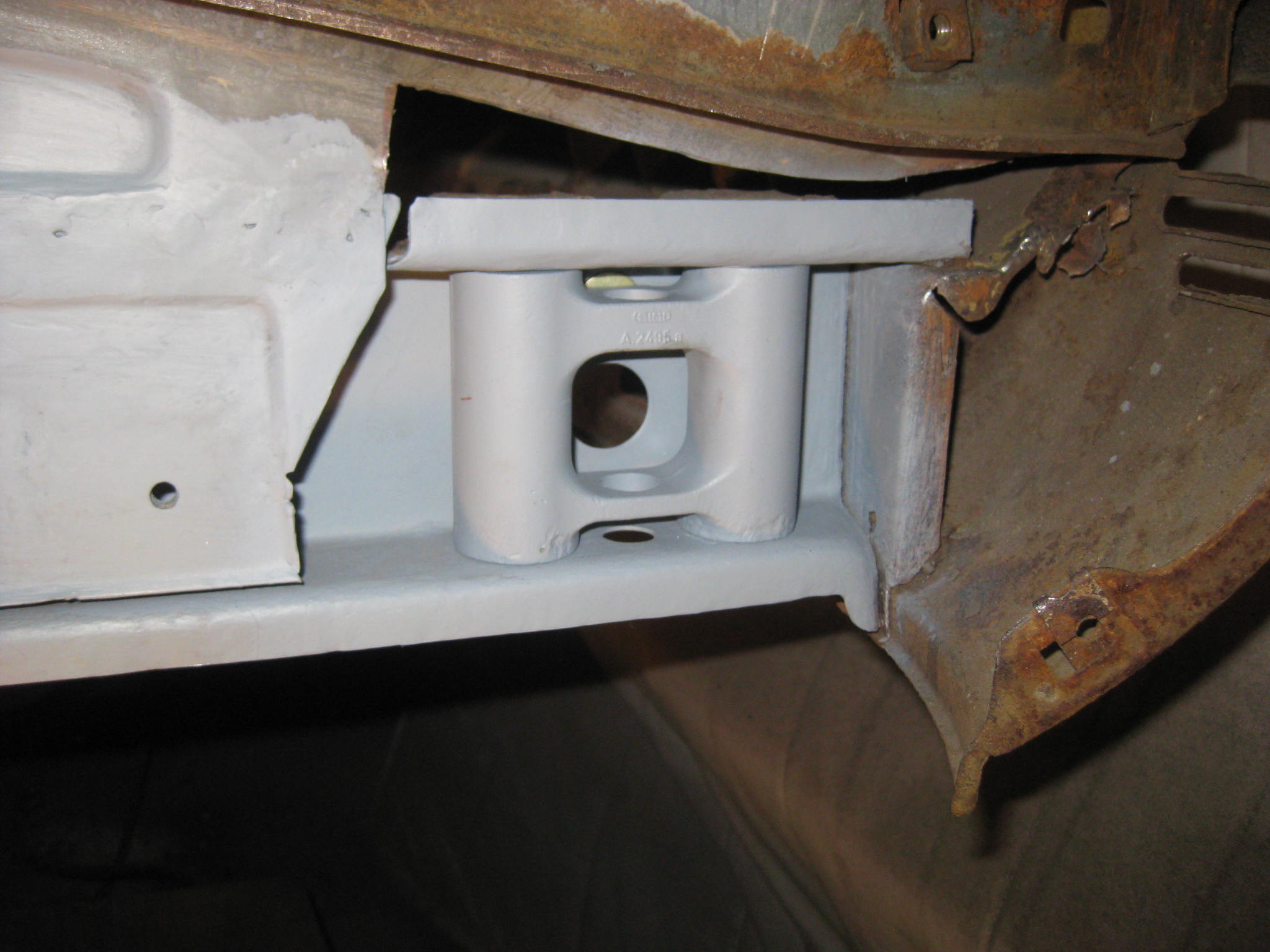

All the rusty area of the front section of the chassis leg cut away, foam removed, etch primer added even though some will burn off when new metal is added
I made up a new panel for the very front section and cut away the old badly rusted section
to reveal another mess

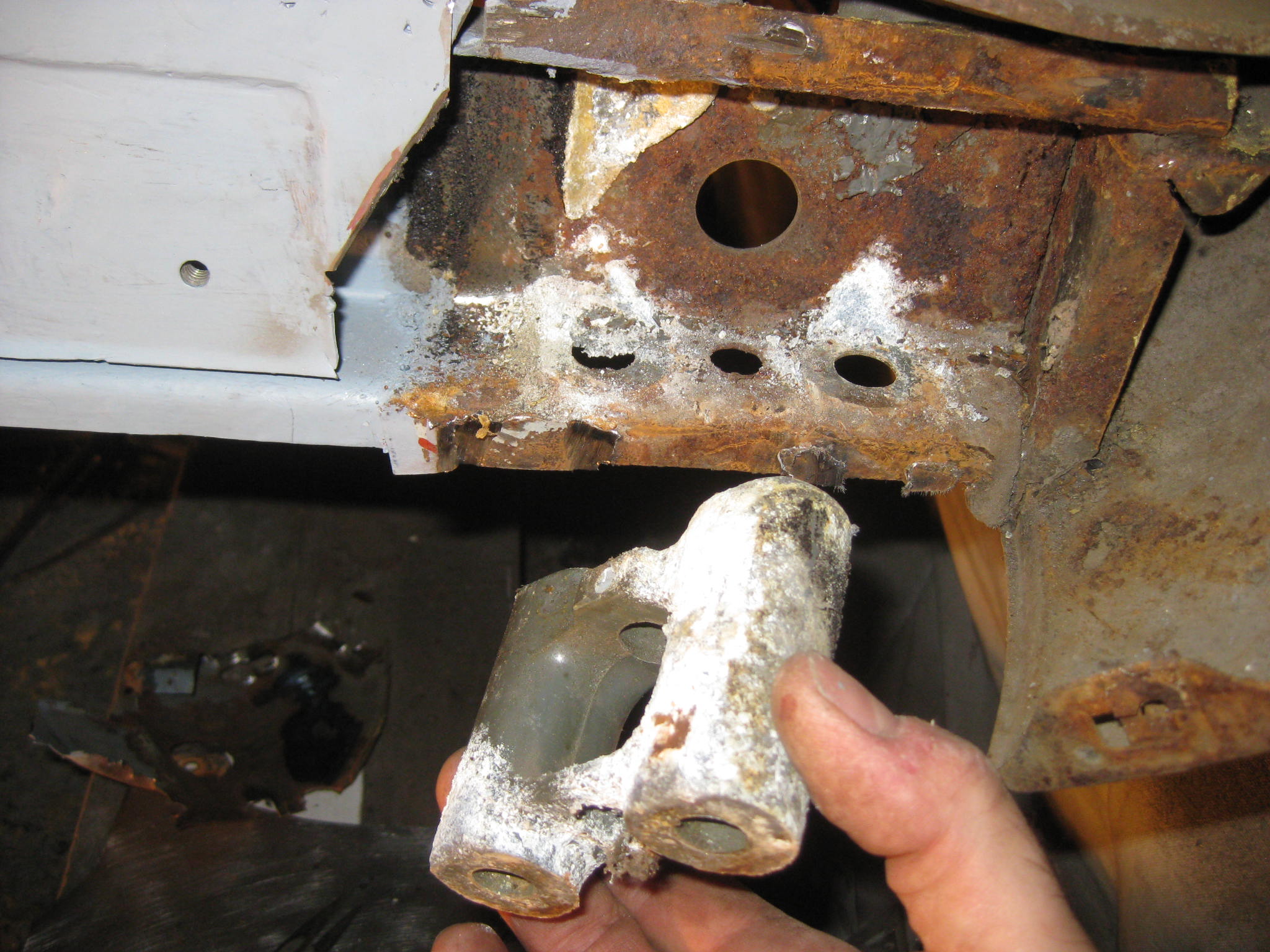

Front crossmember spacer and surrounding area was in a bad way
Luckily the spacer came out and inside of the chassis leg cleaned up as it was only surface rust lucily
vecchioalfa
- Posts: 433
The spacer cleaned up good in the end and more etch primer added

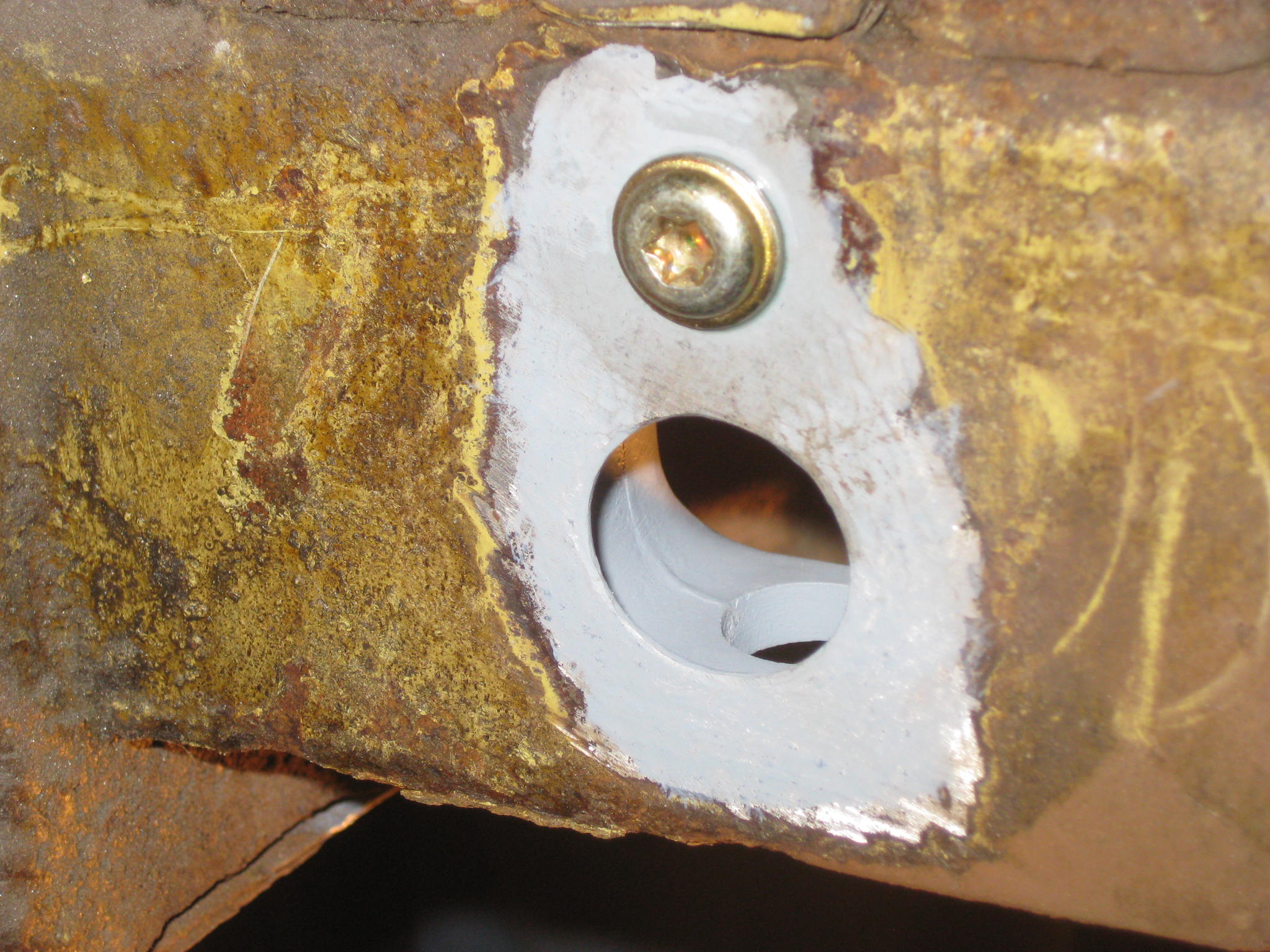

Originally held in place with a peened over alloy pin that had long since corroded away I decided on something a little different which should look good when painted
vecchioalfa
- Posts: 433

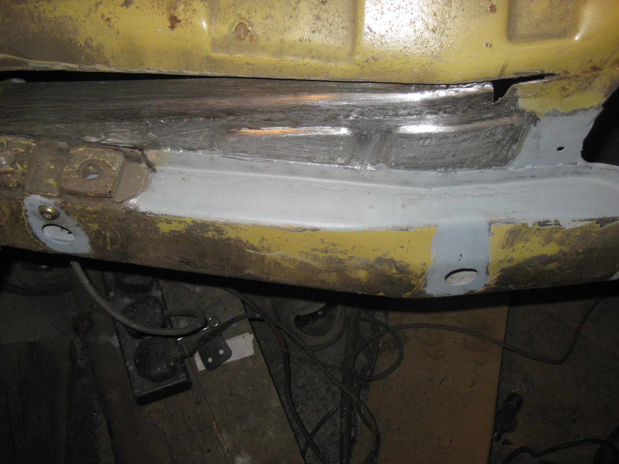

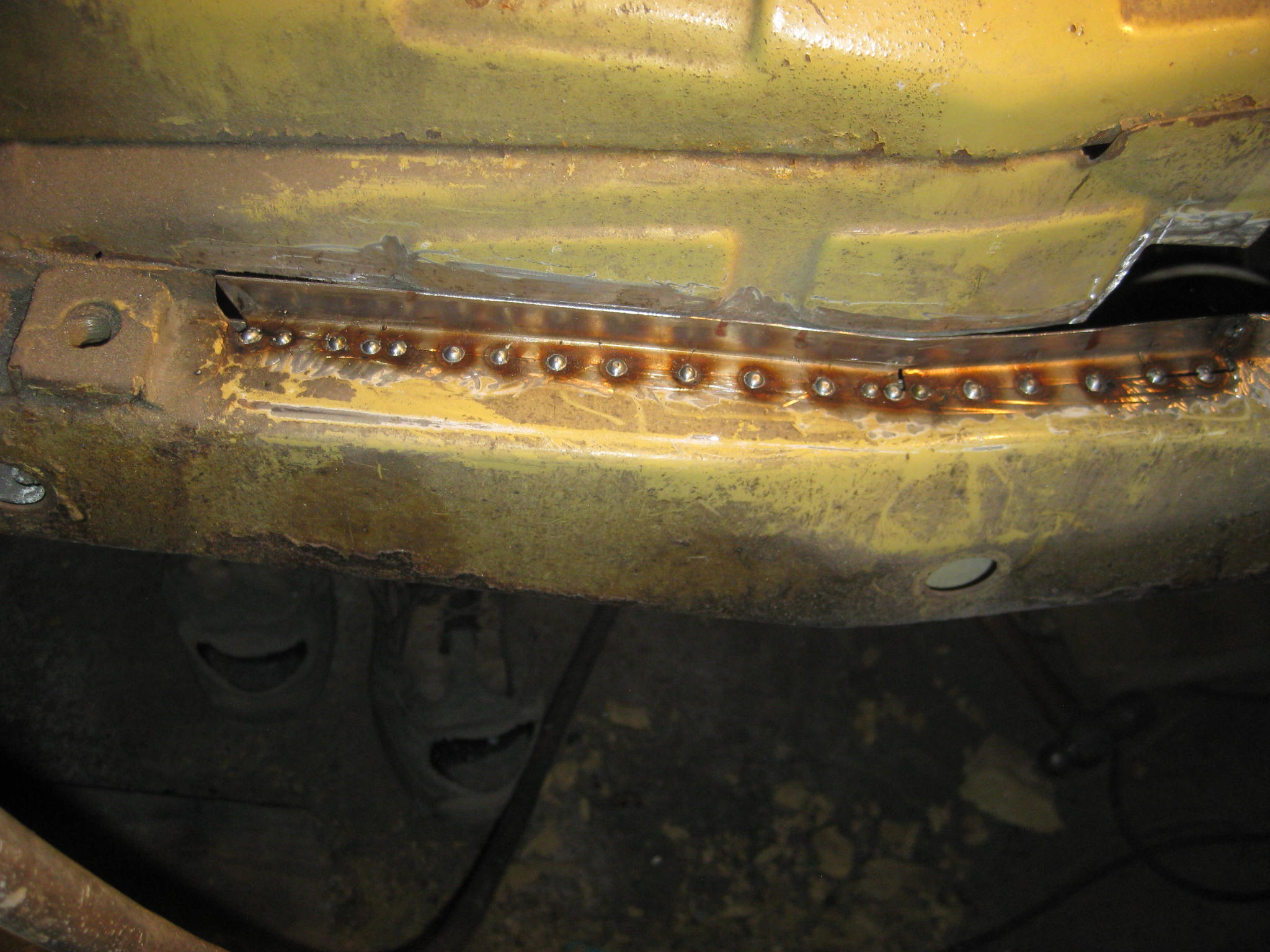

Captive nut added for the outer wing bracket & then work on the front seam started...
Repairs are looking great, I don't know how you and Kev find the time to get so much done between your regular posts.
Top work.
Top work.
vecchioalfa
- Posts: 433

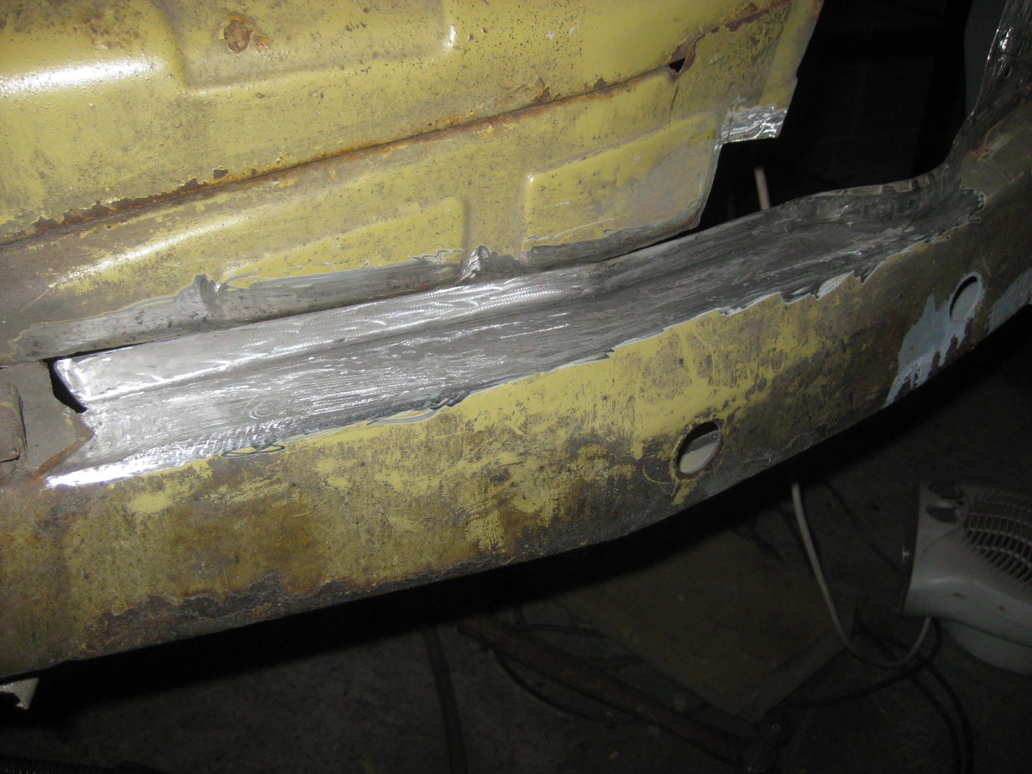

That bit is now done too...

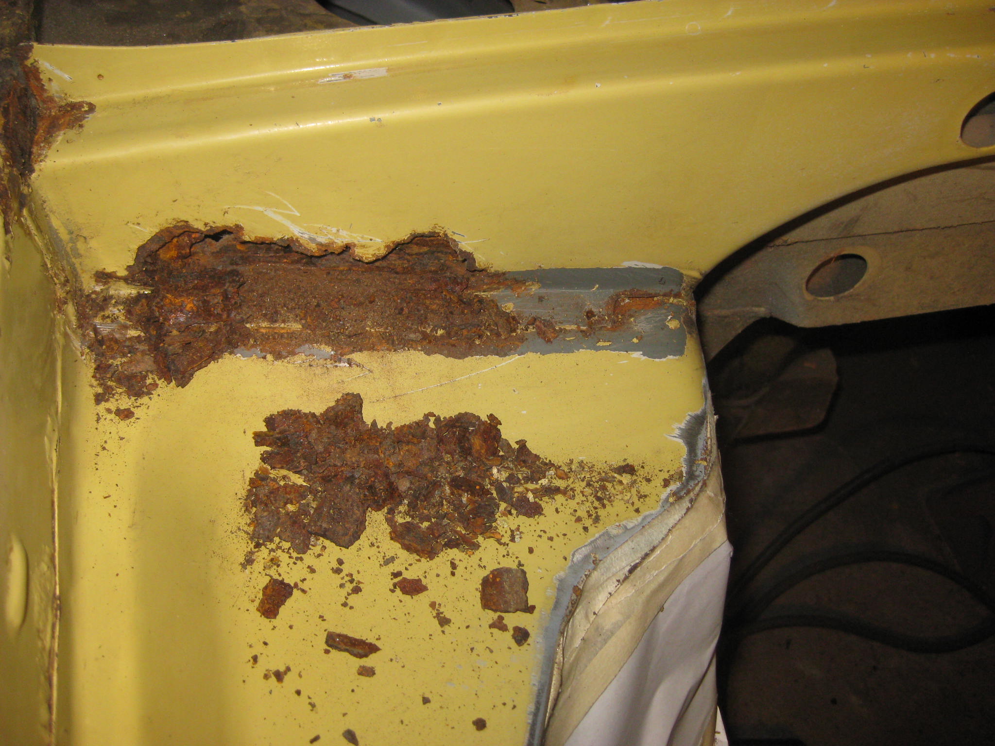

Its amazing how much rust these cars hide from view, it seems to me that if any corrosion is externally visable then expect major corrosion inside as these cars rust from the inside out for sure

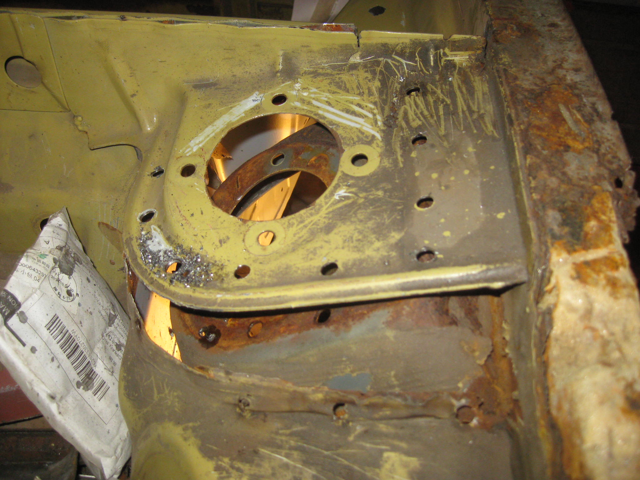

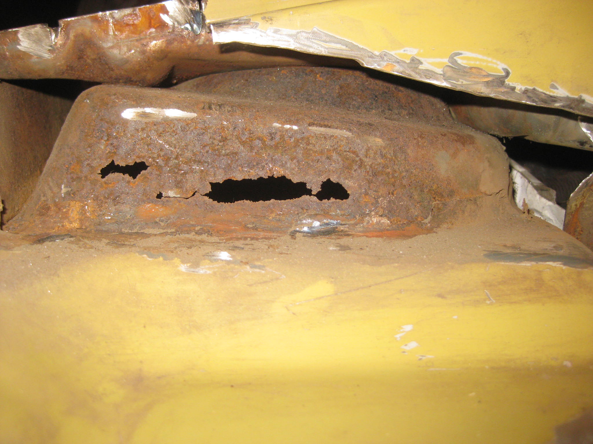

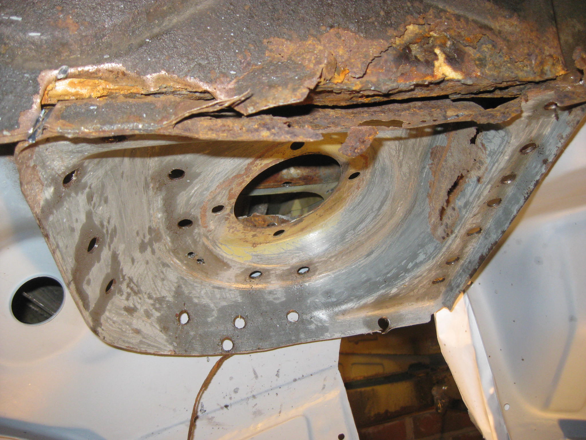

The strut tops on my car are a mess, when you can see corrosion like this, inside it will be bad.....
vecchioalfa
- Posts: 433

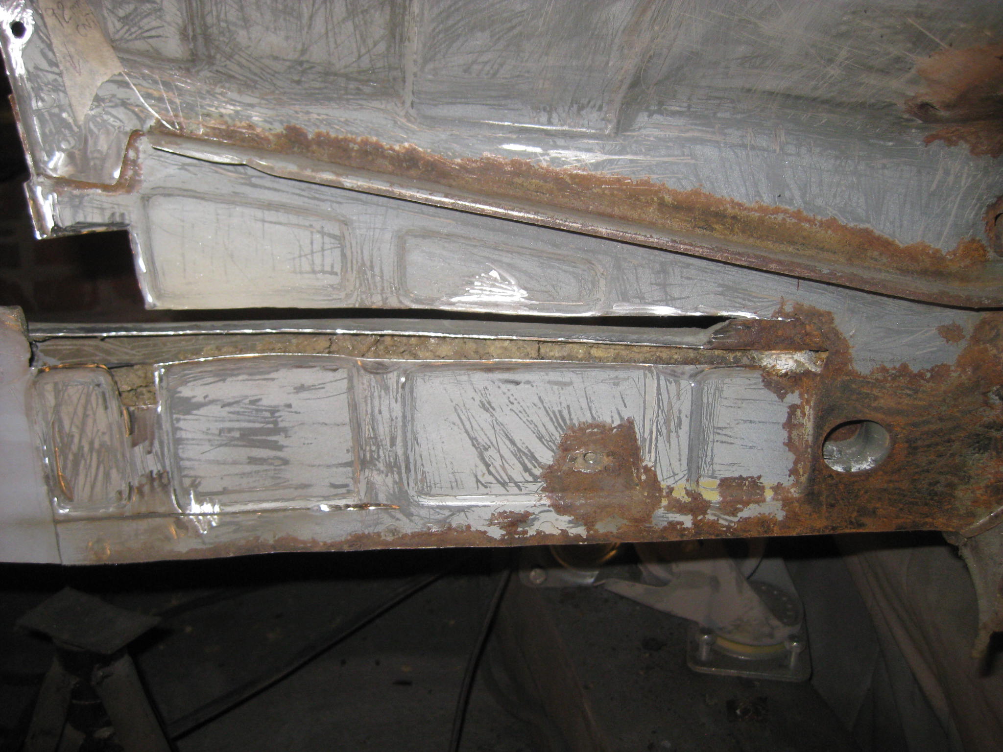

So I decided to drill through the spot welds holding the underside panel on and start again from scratch.......
vecchioalfa
- Posts: 433
............and its off

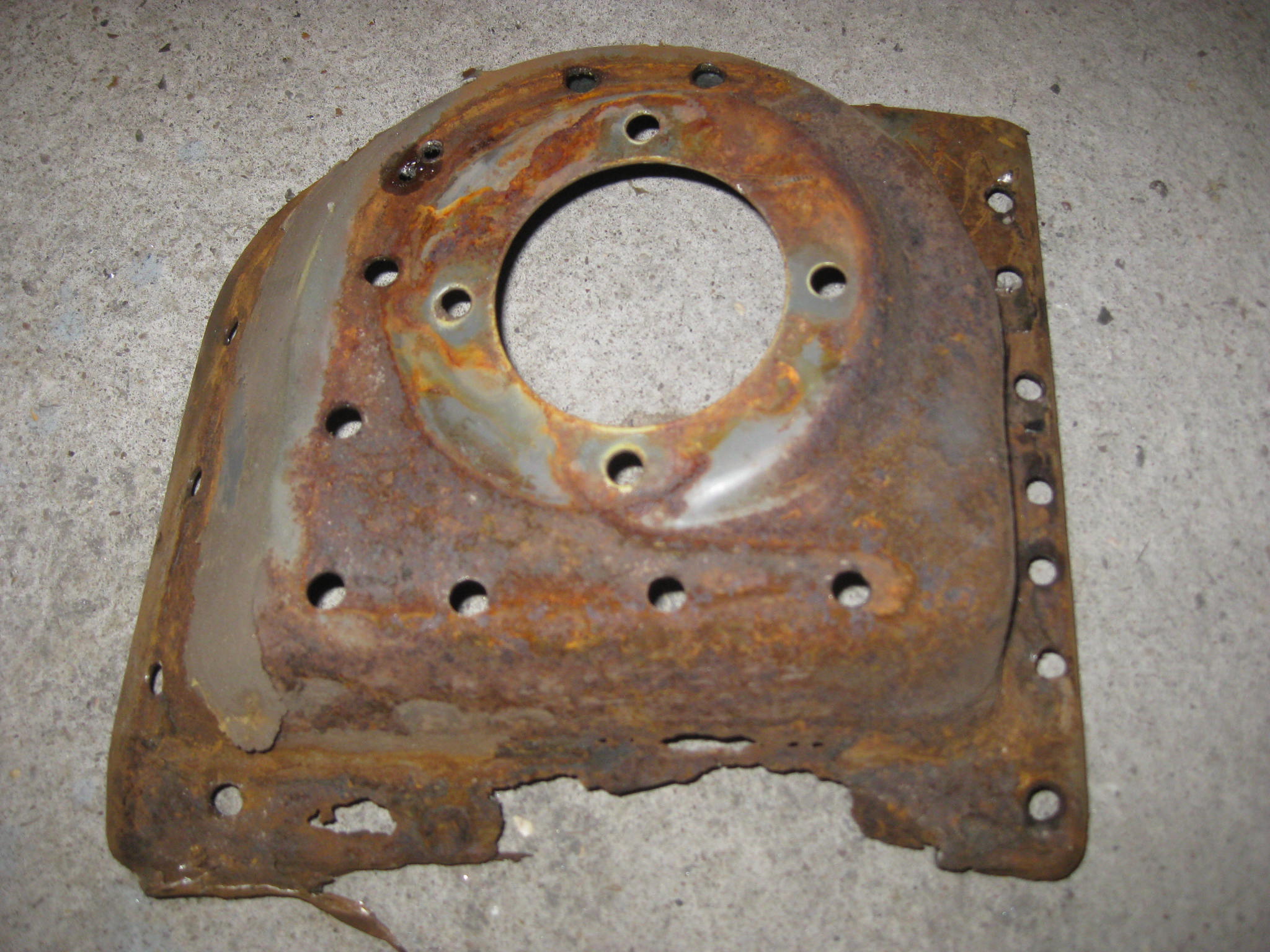

vecchioalfa
- Posts: 433

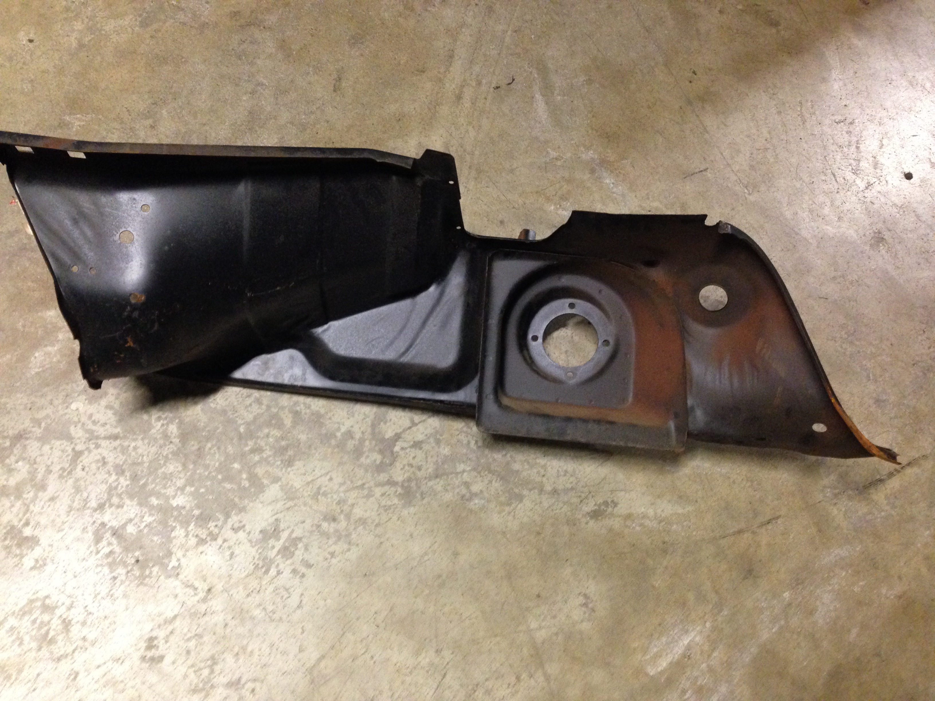

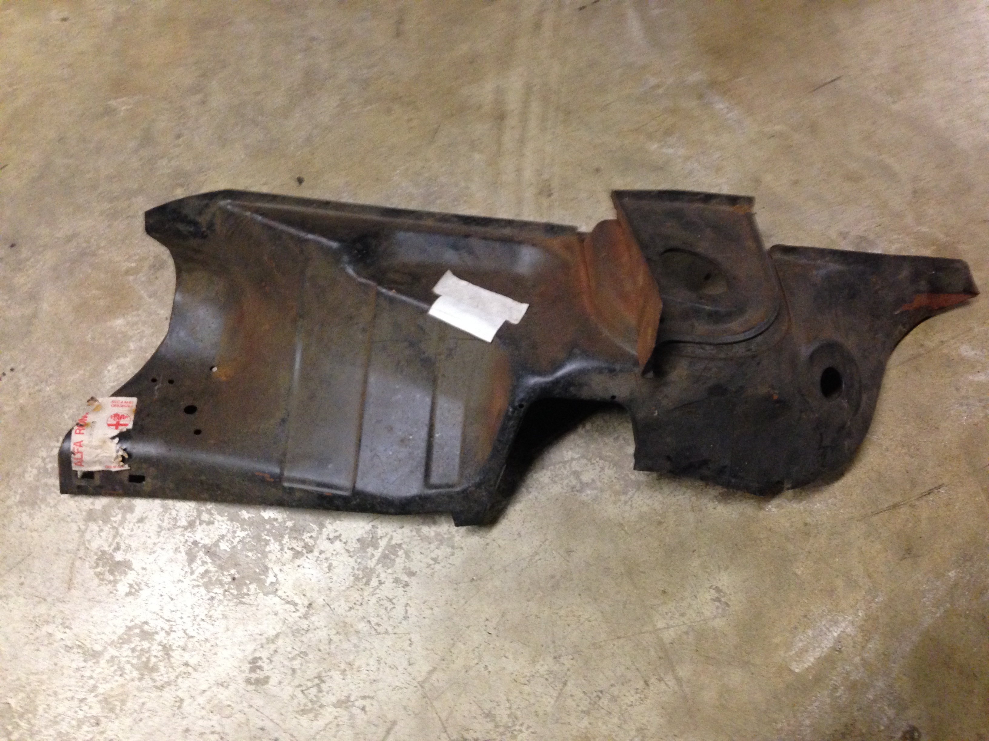

...... anyone got one of these kicking about.........
I found one on a new old stock panel but guess what...... it is for the other side
so if anyone has one (R/H Side) please let me know otherwise I will have to look at making a new one / repairing this one

Hello vecchio
I have this complete panel that it looks like I will not need now
Got some surface rust on it but I guess it could save you a lot of work
pm me if you are interested
