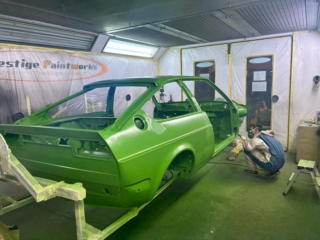

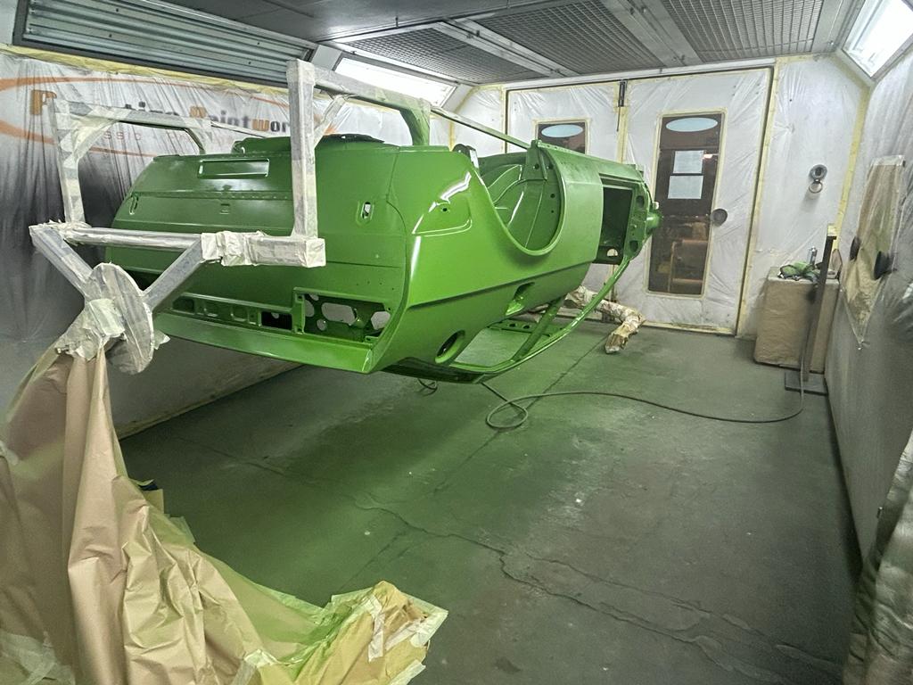

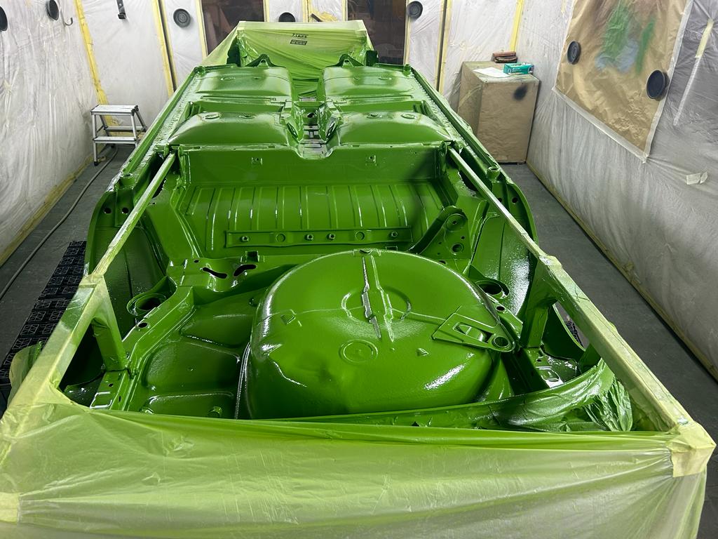

First pass through the paint booth.
Alfaoldgit
- Posts: 201
Re: SPRINT RESURRECTION
I hope you all like green.......

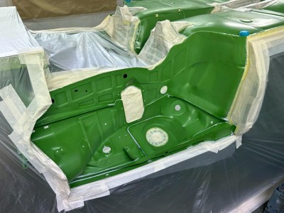

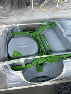

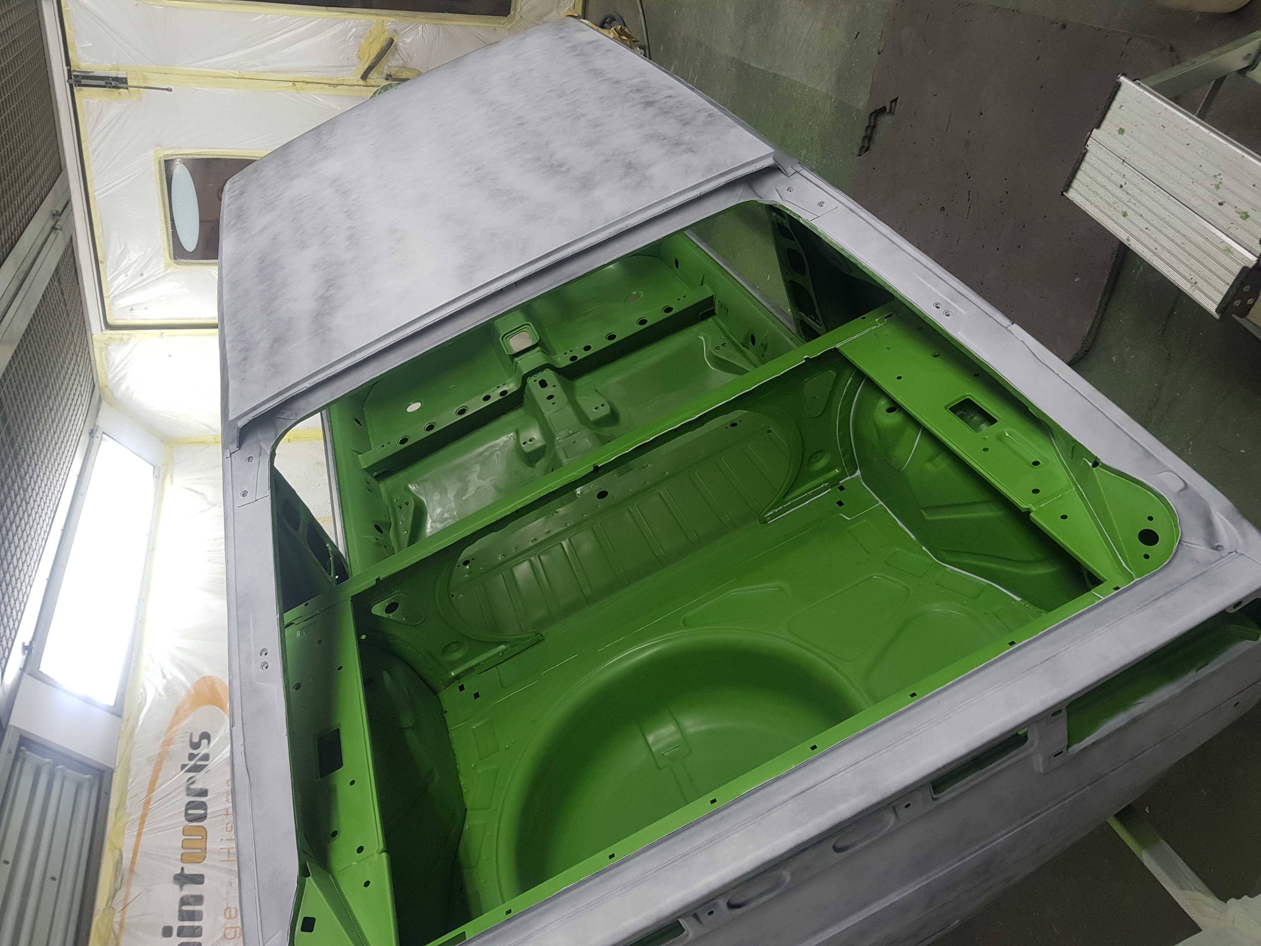

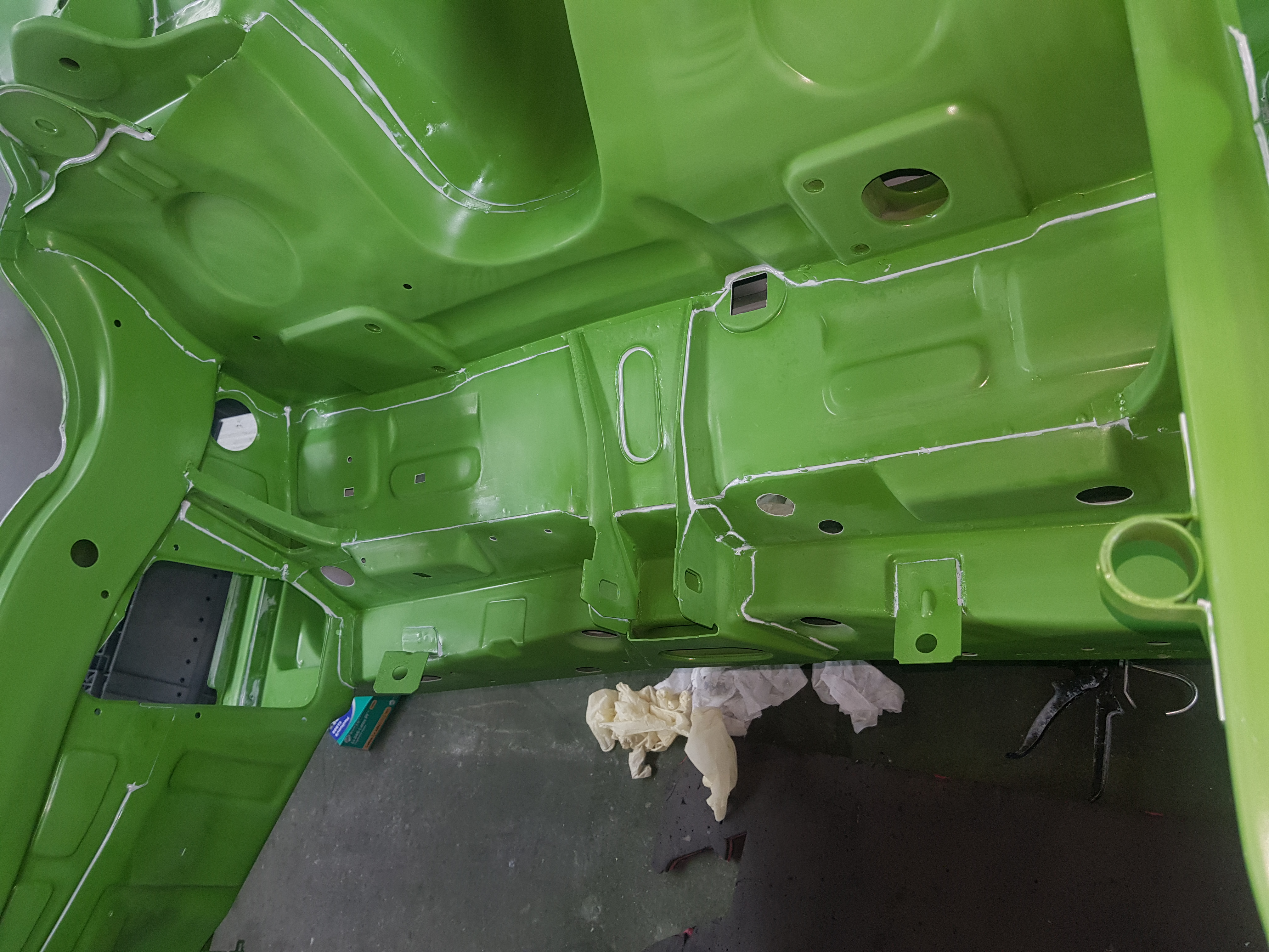

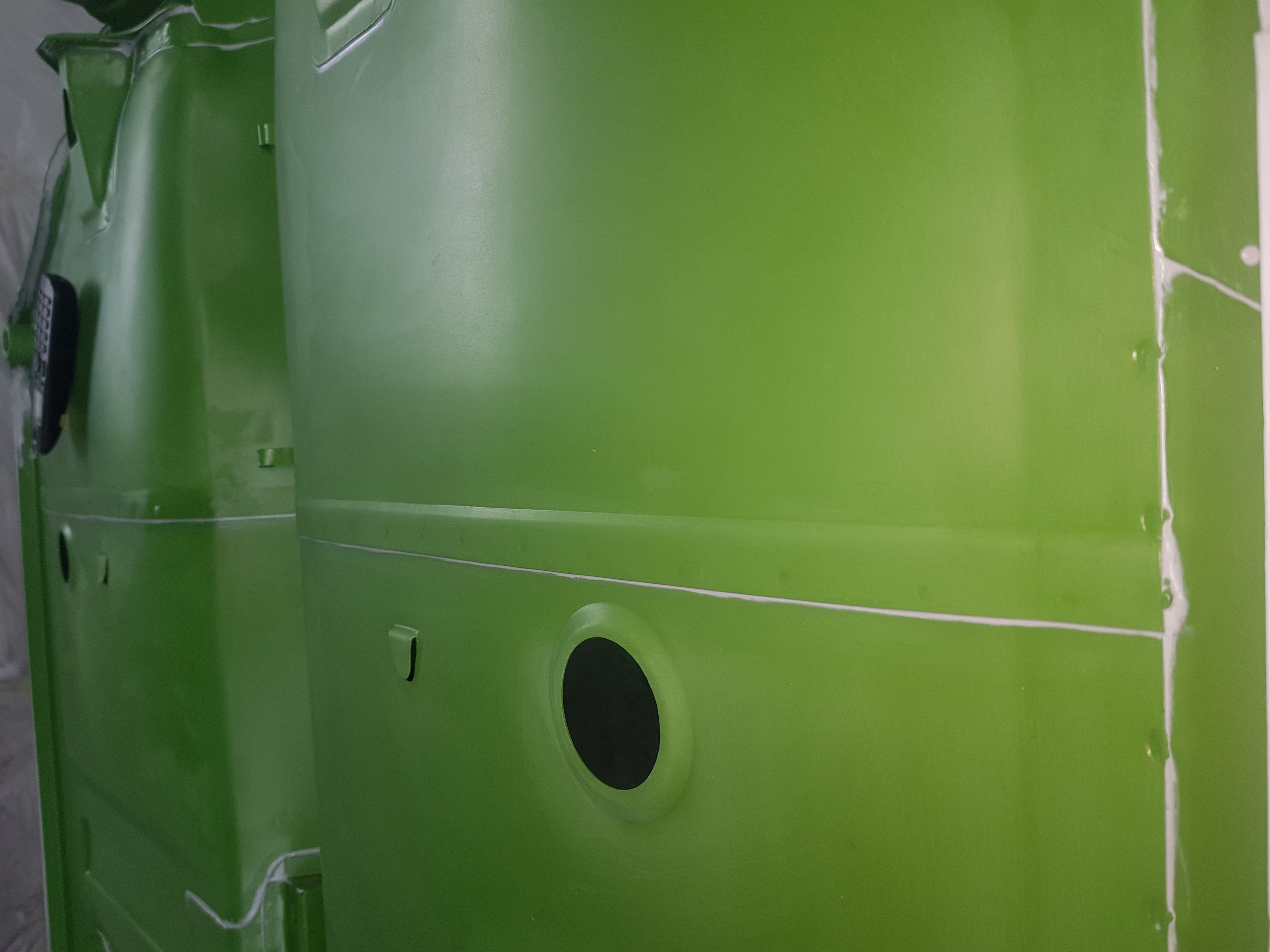

This picture shows the car inverted for seam sealing. The green paint is epoxy primer, the grey is high build primer/filler. As before the pics are rotated but open correctly when clicked. I'll leave you to work out what you are looking at.

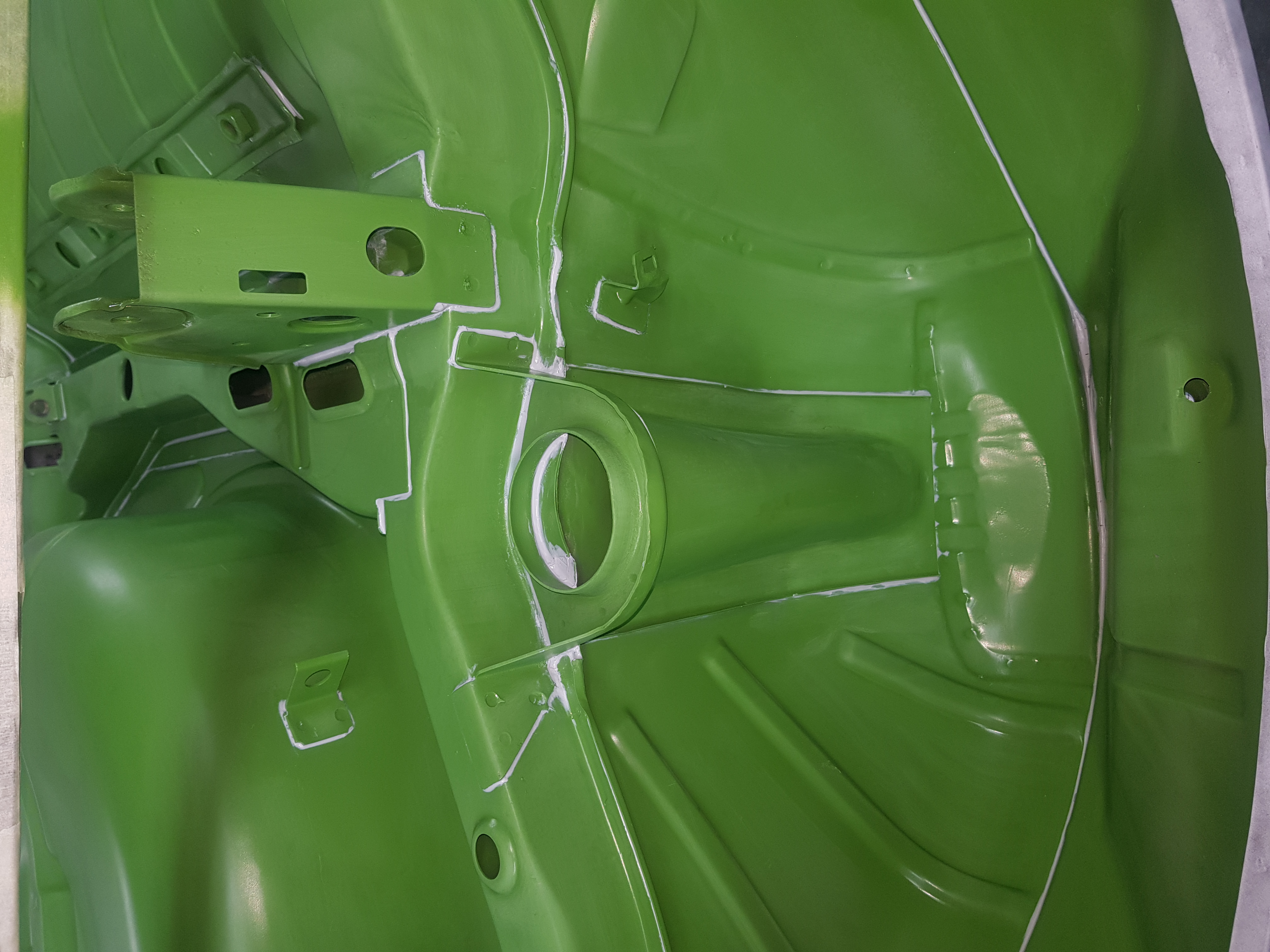

The next three pictures show seam sealer being applied to each seam. No slapping on with a brush, each seam is precisely sealed and then wiped smooth. When these pics were taken about 18 man hours had been spent doing this & they weren't finished.
Alfaoldgit
- Posts: 201
If you scroll back several pages you will find some serious repairs to the floor. As you can see in this picture, there is no evidence of repairs. The spot welded seam is a factory joint..
So what next? Finish off seam sealing, then epoxy stone chip in selected areas - the bodyshop dislikes hosing it all over the bottom of the car. Then its three further coats of paint followed by transfer to a dolly then onto a two post lift for the next stage.

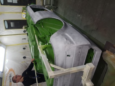

It's so pleasing to see some primer applied - it amplifies the quality and attention to detail of the fabrication work. The guys are now getting stuck into an E type bodyshell, they rust too. I must admit that the ever increasing spend on this project was starting to get to me, but when I walked into the paint booth and saw the primed shell I had an epiphany & everything Chris had been telling me since April about his no compromise approach fell into place. I'm going to end up with an absolutely stunning Sprint.
That's the eulogy done with, here's some more pictures of an upside down green car masked up for anti stone chip application.

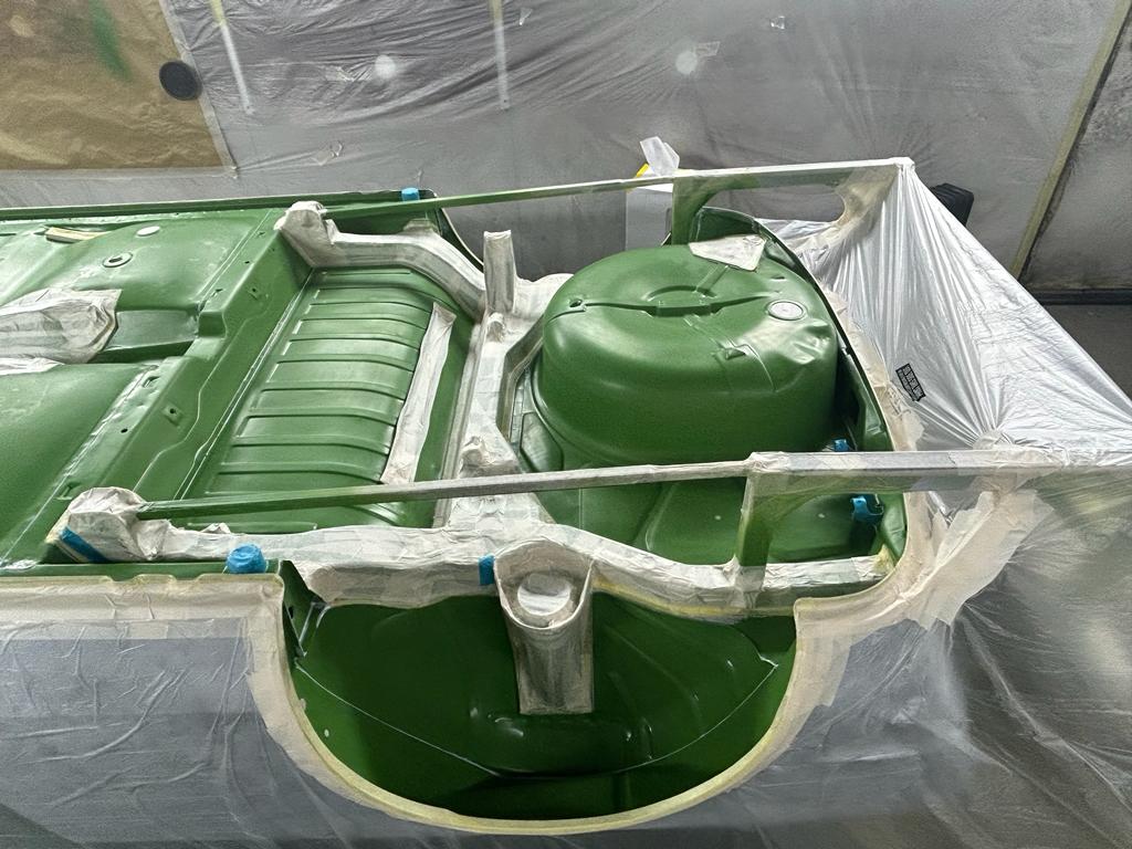

Now you see it (stone chip) Now you don't
Here is the final result on the underside

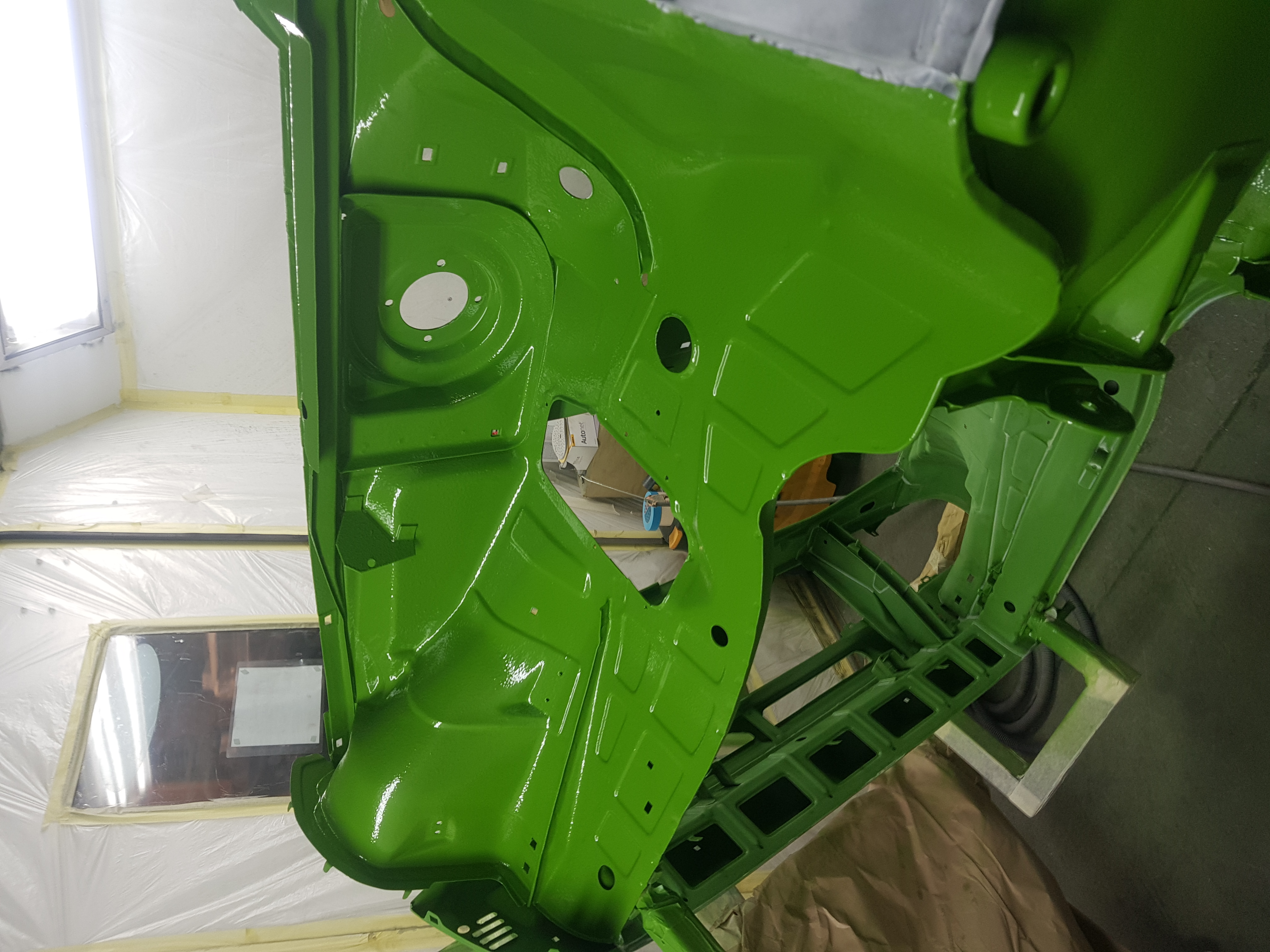

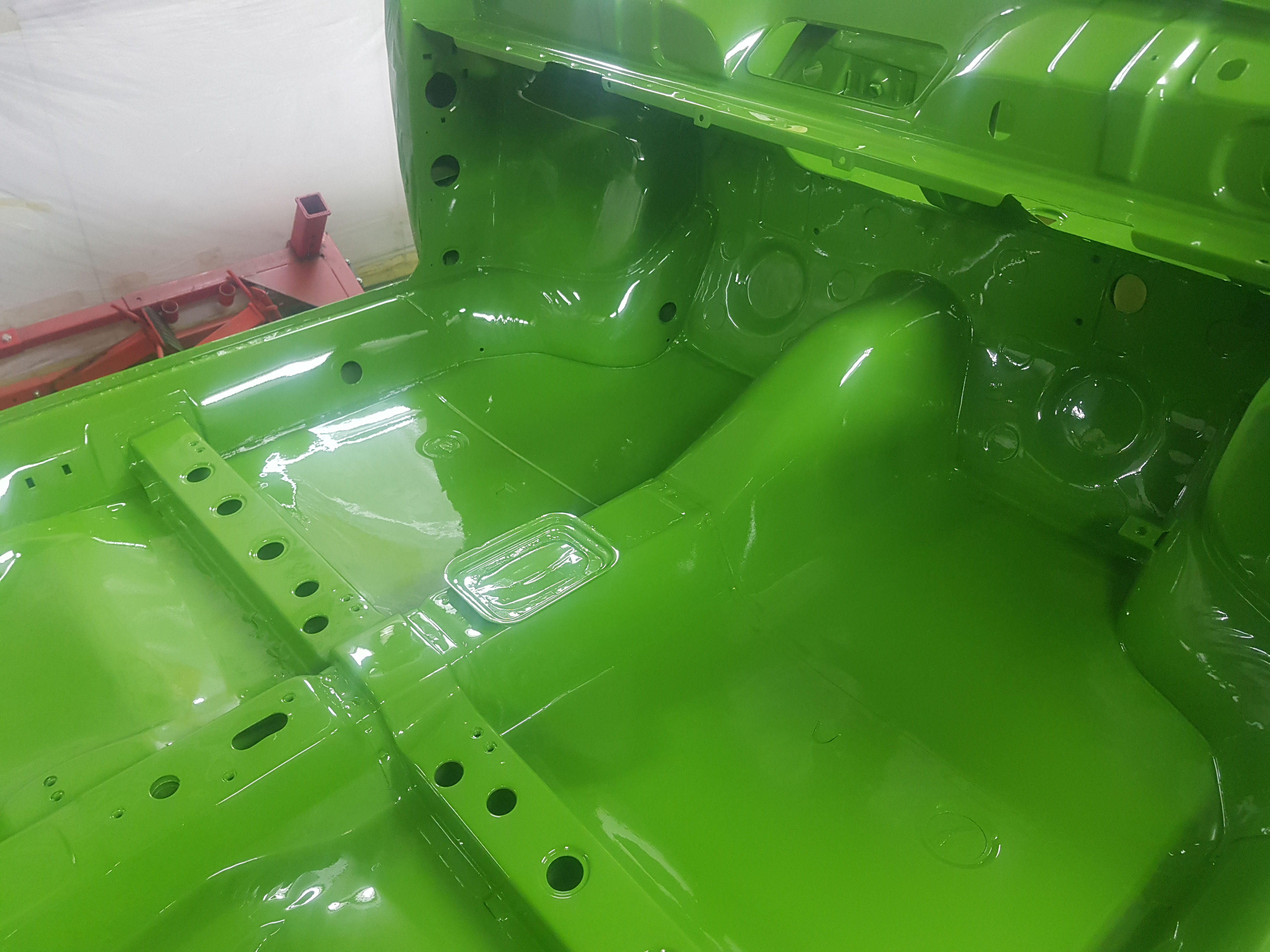

Pics 1&3 need to rotate (0 deg CW. In this picture the interior has been primed and seam sealed. The car is at 45 degrees for a reason........

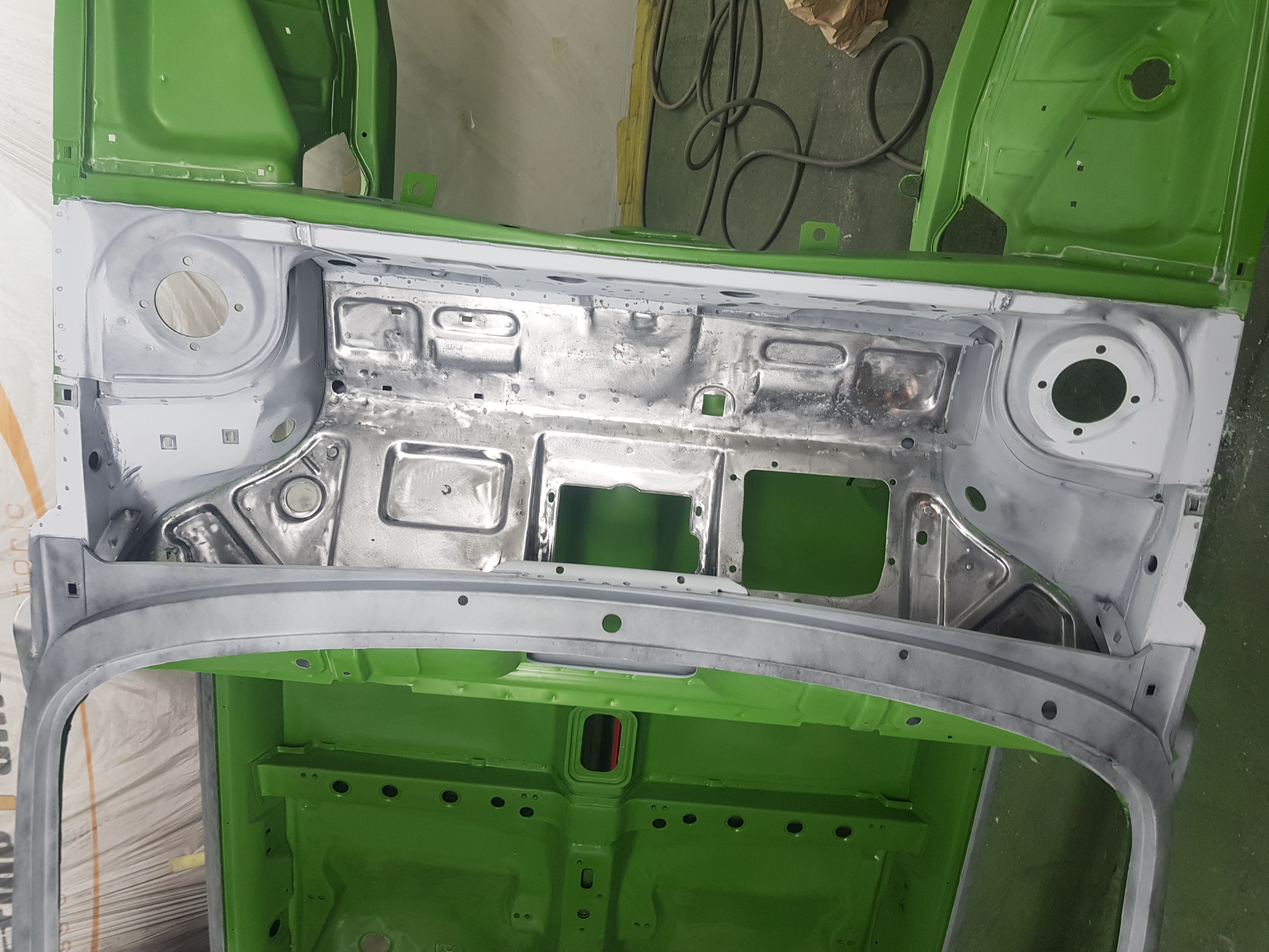

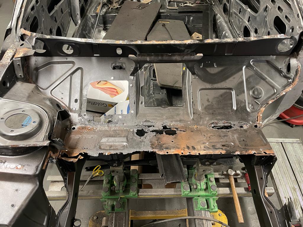

You'll recall the scuttle panel was in a pretty poor state and needed extensive repair
The body shop have decided that the appearance of the repairs is not to their standard, so the primer and seam sealer has been removed and the car rotated to improve access.

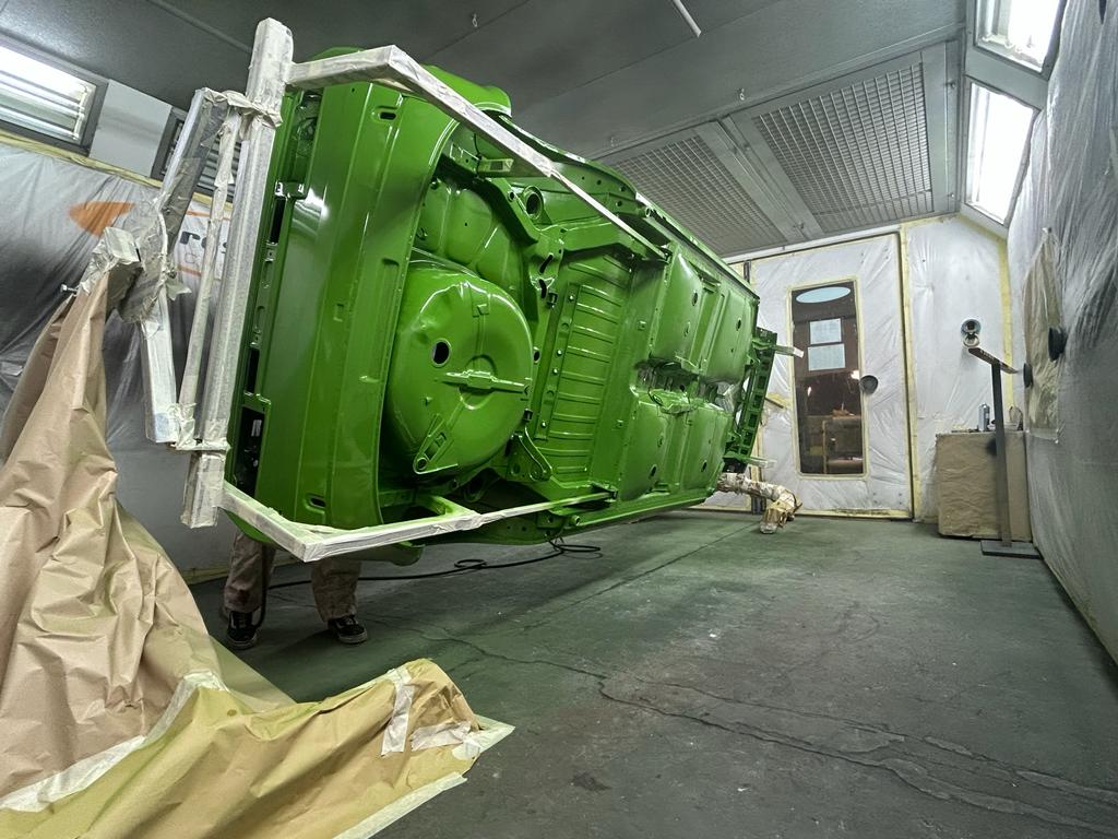

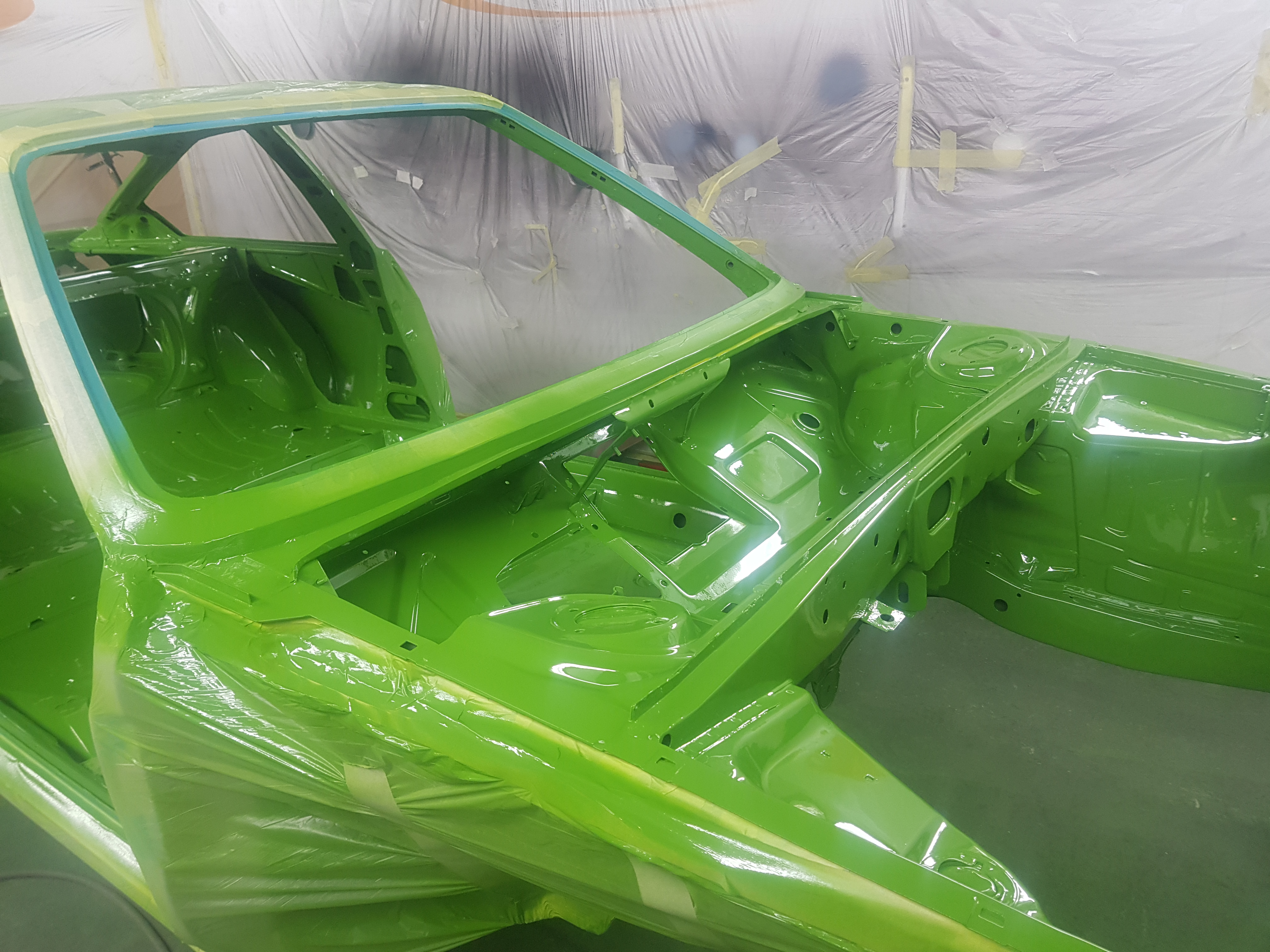

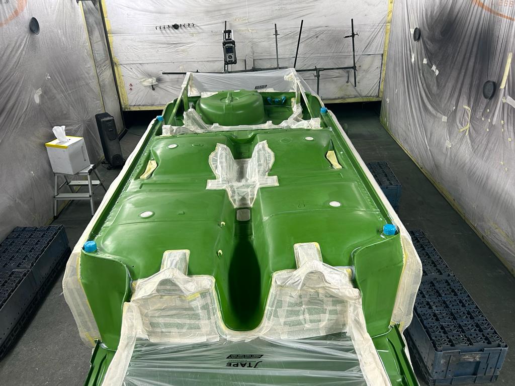

I'm expecting the view rate to fall away as you all get sick to death of seeing a Matese green Sprint

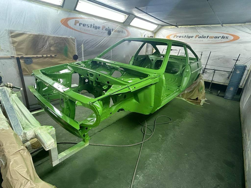

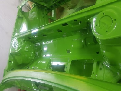

Painting is now complete on the underside, engine bay and cabin. The scuttle panel has been reworked & I think you'll agree it looks pretty good. Next step is to transfer the shell to a transport dolly and put it aside while the tailgate, doors and bonnet are prepped for priming. Top coat will be applied with them off the car to ensure a consistent finish over the whole of each panel, not just the outside skin.

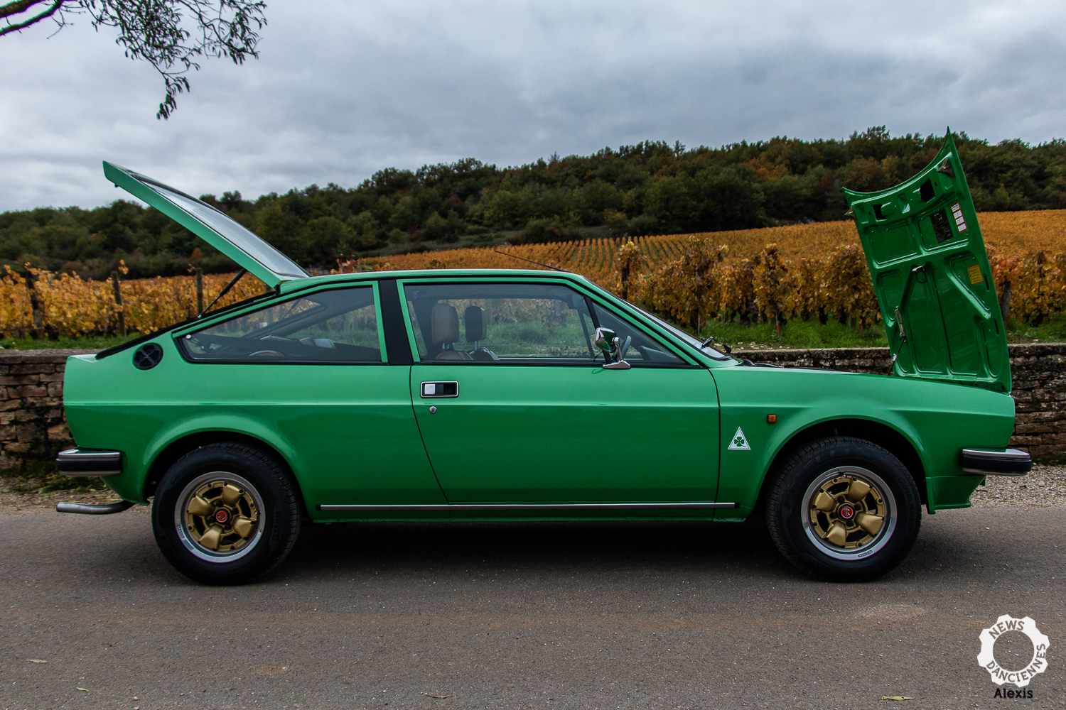

For contrast, not the best side by sides
I’d go green b post trim and chrome window trim if you have it !
