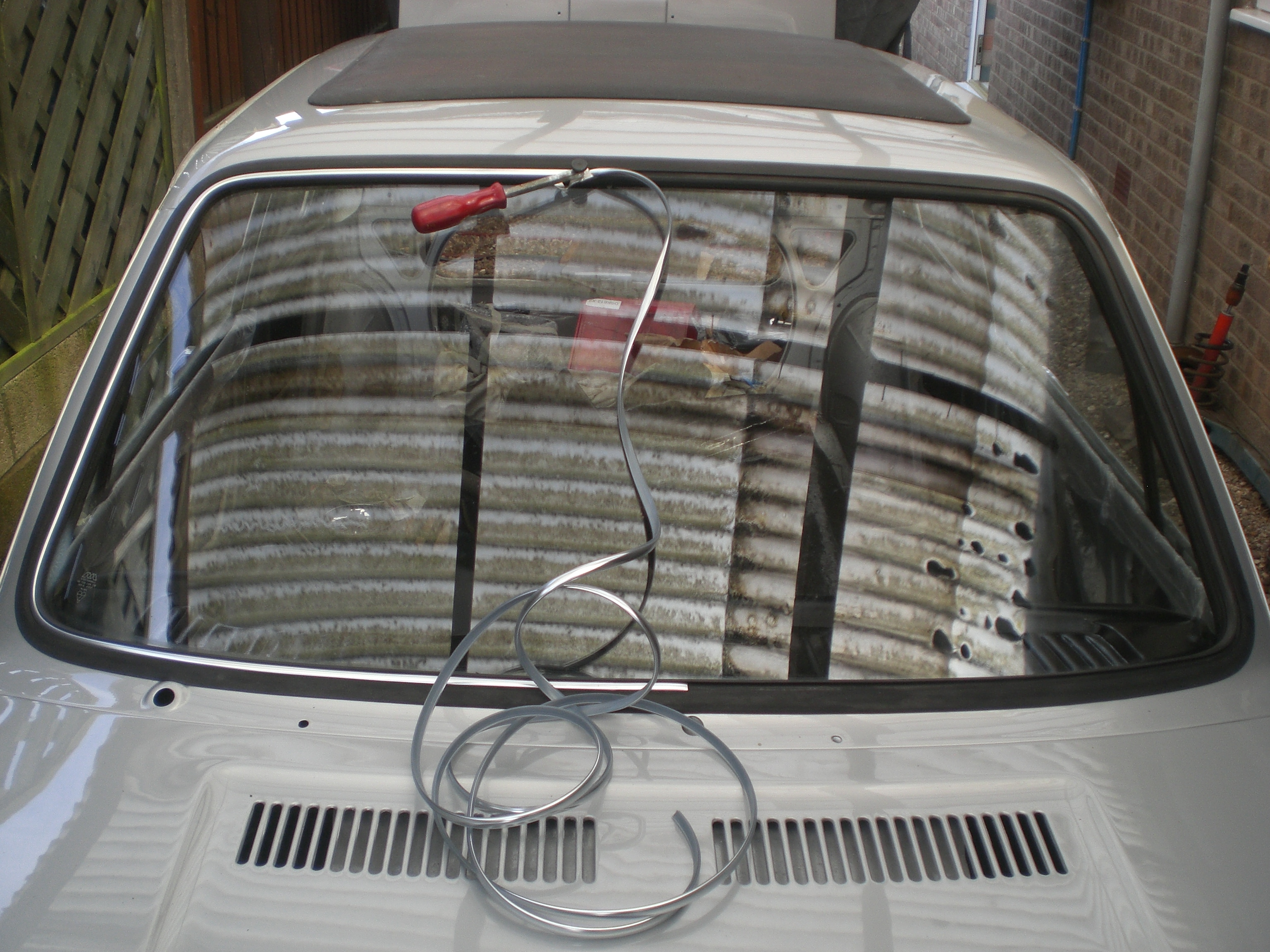

anyway, spent best part of 2 hours cleaning the windscreen seal in the week, years of people stuffing sealant into it to try and cure leaks took an age to clean off
so with that ready i cleaned the 'screen itself and with robs' help we fitted it in. fits just nice, so another confirmation that rubber seals will fit an S1 sud
still got to get the chrome (plastic) insert for the seal, woolies don't open weekends so will have to pay a little extra and get postie to do his job.

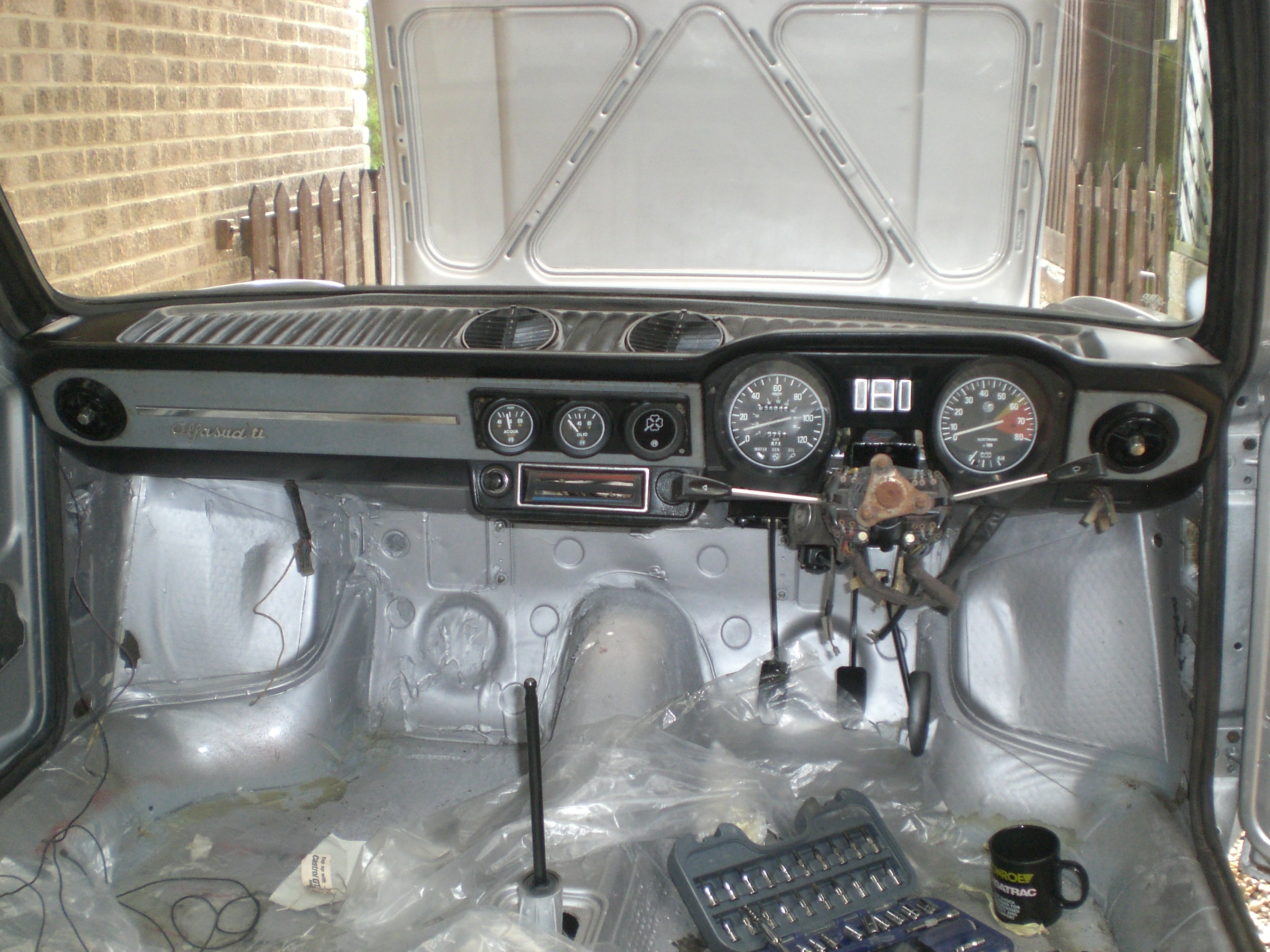

the wiring loom is in place and most stuff is connected so thought i'd fit the dash in place that rob cleaned the other day. will need to come out again once i've had the engine running so i know what mods or repairs the wiring loom will need, and to tidy it all up a bit.
just couldn't help seeing how well it looks.

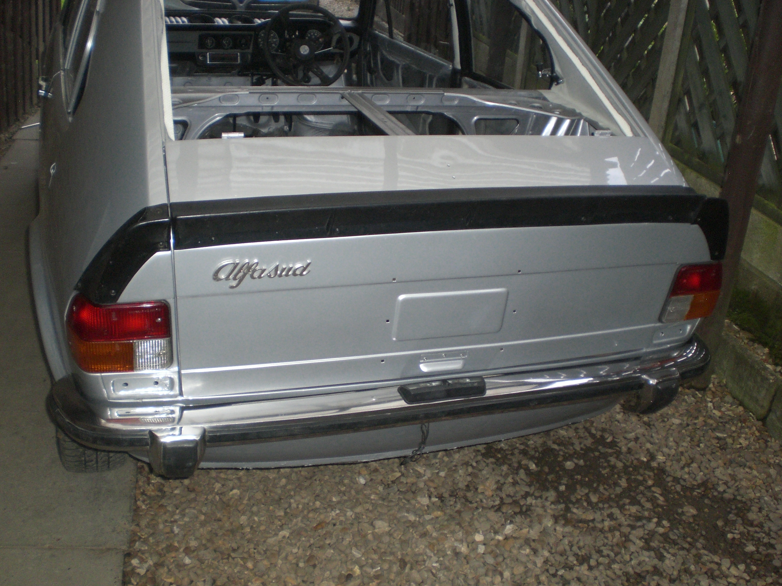

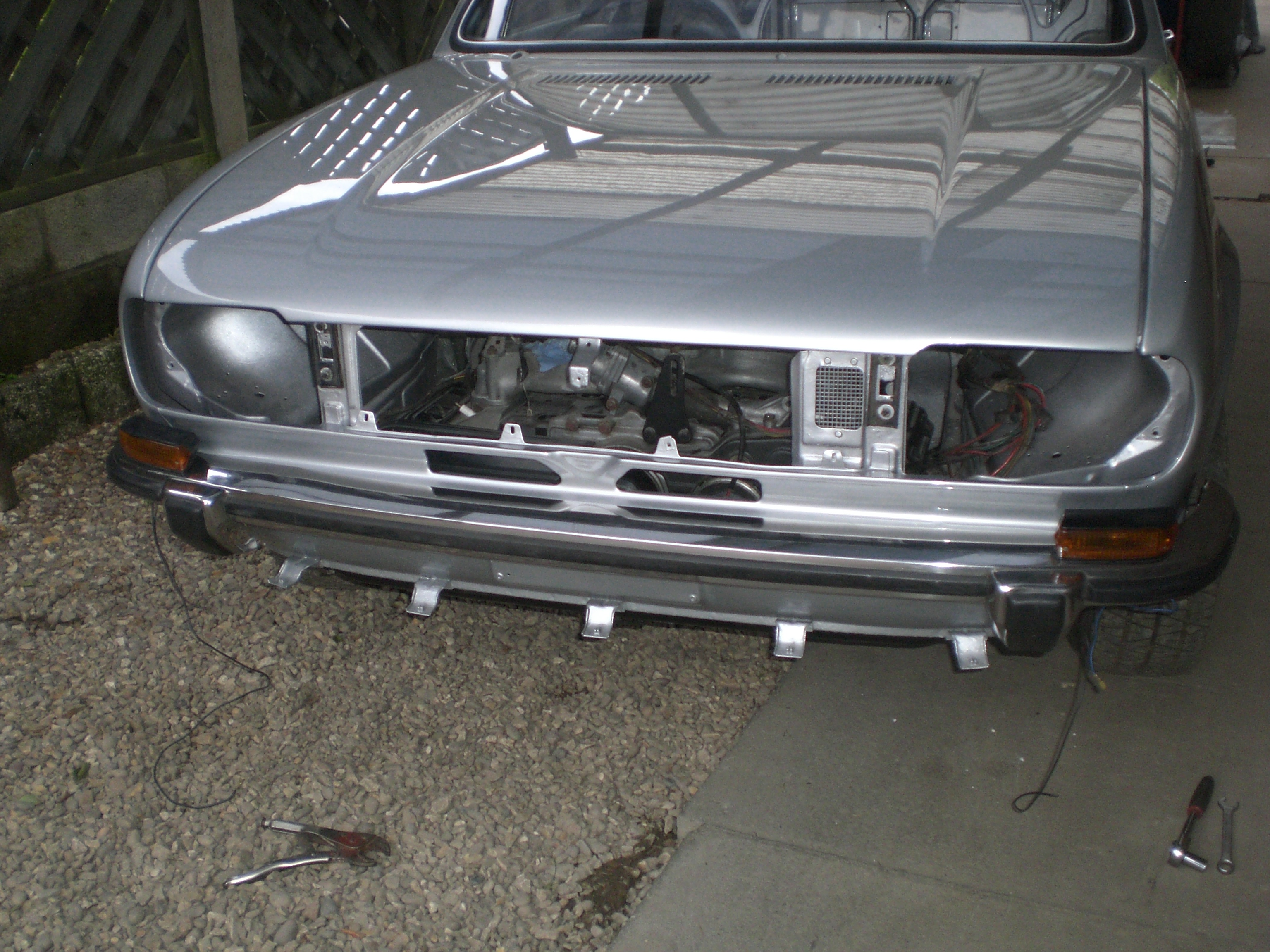

Re: My S1 Sud Ti
no update yesterday as i got a whole lot of nothing done.
started off with good intensions of putting some bits on the back end to at least fake some progress
bumper, eventually found a decent one but needed cleaning, forget it for now.
rear spolier set, found my "set" which turned out to have 2 right side corner pieces instead of a pair! forget that one.
found a decent pair of lights, but didn't want to fit those until the spoiler is on to help with fitting that, forget it again.
rear alfasud emblem could be fitted, but needed polishing and i'd given rob the last of my autosol to polish his schwinn bike a while back.....yep, forget that one too.
so had to do something
fitted the new bearings to my new rear discs and fitted them. something achieved at last
john popped around and after the day of near misses i'd had i didn't need much persuading to go for a ride to see the parts stash to look if we had another spoiler corner.
luckily enough we found a left side spoiler trim, needs a little repair but will do just fine.
we also dug out some more spares that will be needed soon, heater air scoop and a bundle of cables amongst them.
so tonight i thought i'd better make use of the autosol metal polish that the mrs had got today.
started off with one bumper, took some elbow grease to get the years of crud off but came up pretty well.
next one was the drivers door mirror which wasn't too bad but looked a bit dull, really pleased with how well it's come up
so while i was at it i did the other bumper. saves having it to look forward to doing tomorrow night
cleaned and painted the mounting irons so once that's baked off they can be fitted at the weekend. will give the indicators and rear number plate lampa good clean up too before they go on.
determined to do a few jobs this week in the evenings so i have no excuses this weekend to actually make some progress.........time will tell

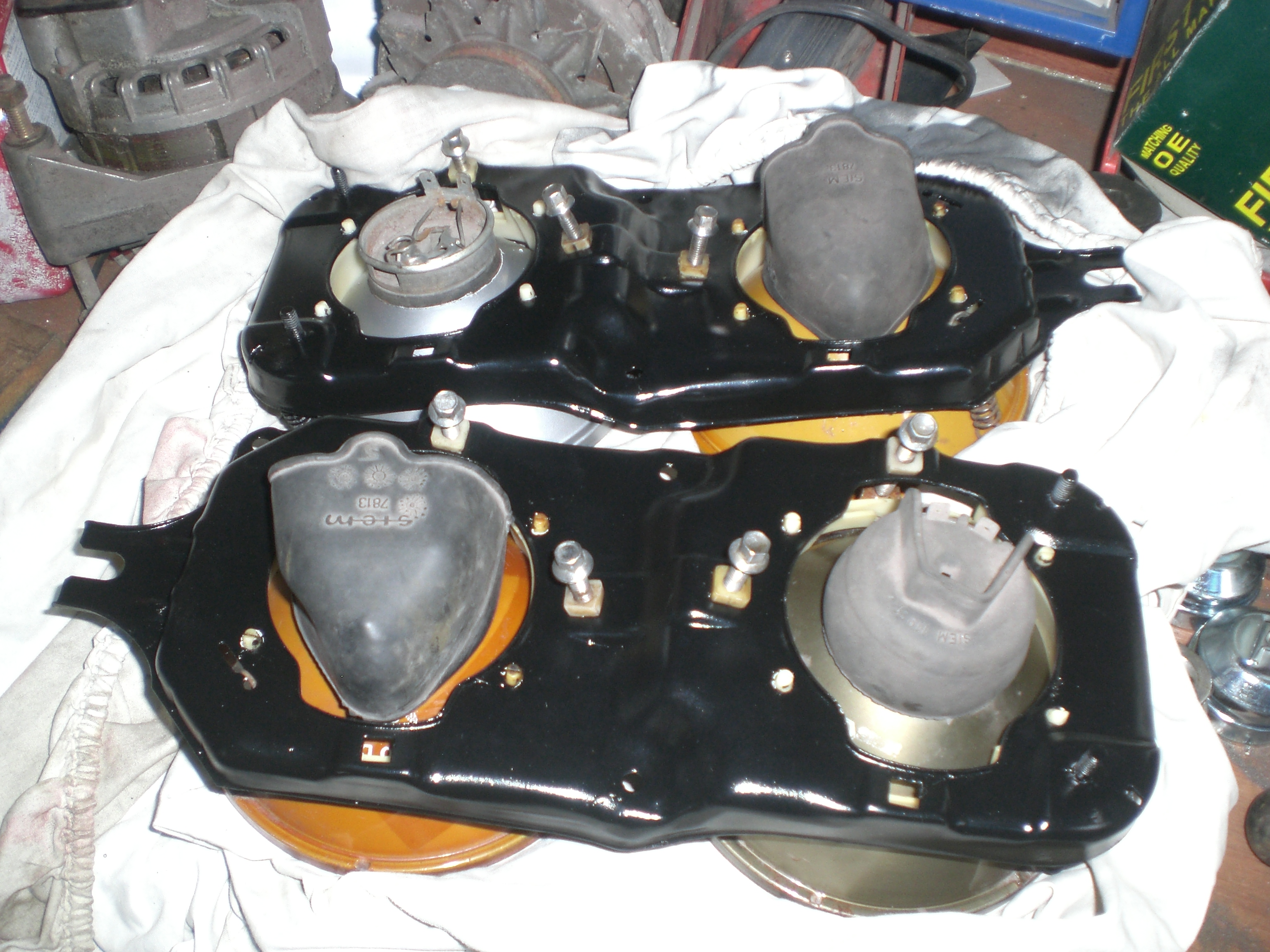

steady midweek progress continues....

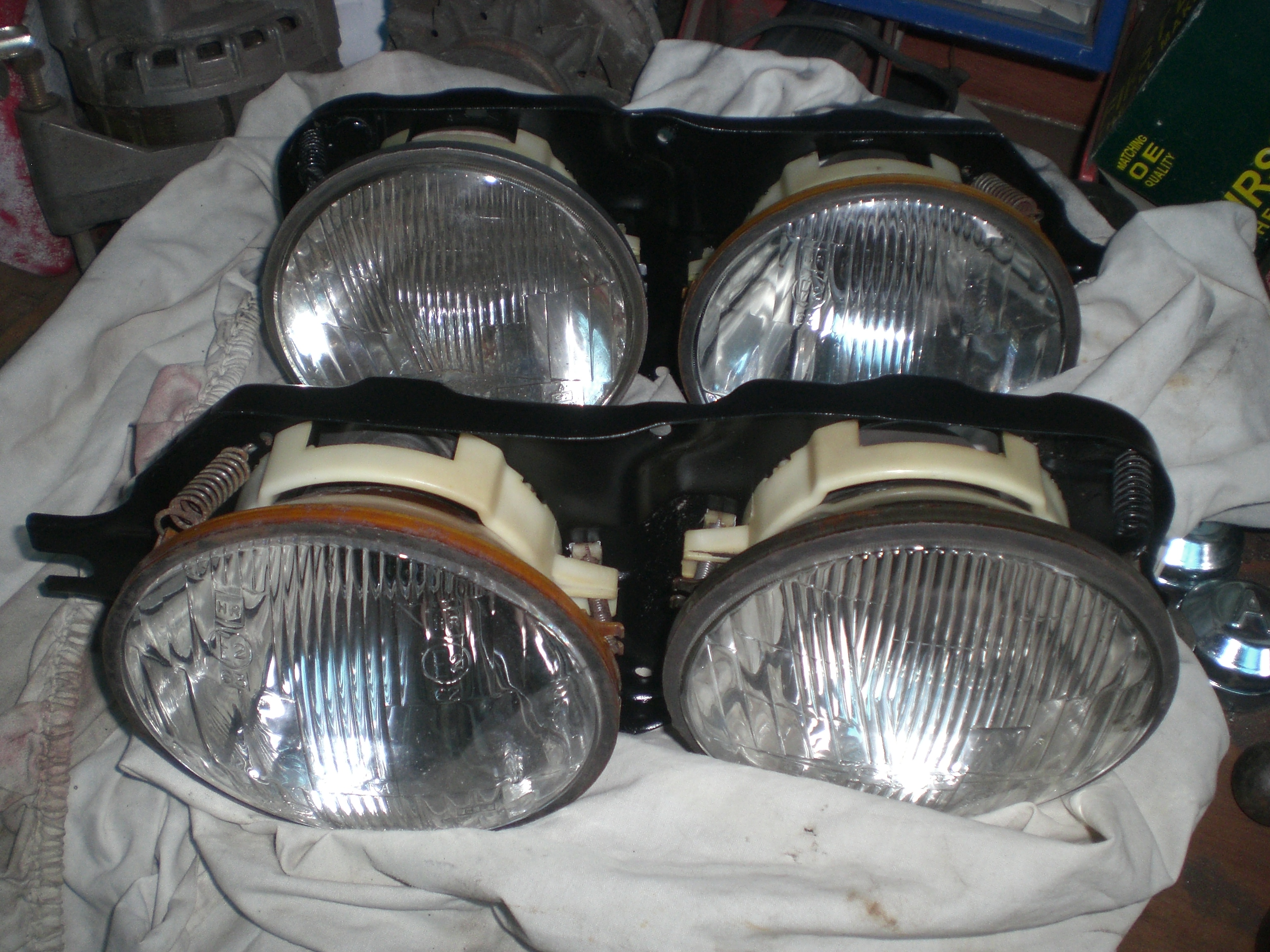

spent a couple of hours tonight stripping a pair of headlight backing panels, then stripping off a 2mm or so thick layer of underseal off them. good in a way though, saved them from rusting through! very messy job though.
etch primed them ready to paint tomorrow night.
the one light that i don't yet have a new one for also got a quick sand down, and etched.
windscreen chrome strip arrived today so that can go in at the weekend.
ticking along......
ticking along......

first job was to fit the windcsreen "chrome" (plastic) insert into the screen surround. went in really nicely with the little tool. corners went nice and smooth despite me wondering if they'd be easy or not.
really happy with the result of that little job, gave a bit of bling to the seal
next job was the fitting of the rear bumper with it's new rear number plate lamp that came with the car.
added an earth wire too so it doesn't rely on the bumper making an earth.
put a piece of neoprene between the body mounts too to stop any chafing, don't want the fresh paint chipping off!
next task was the rear spolier set. n/s corner piece freshly repaired, doesn't look too bad but will keep my eye out for a mint one.
used rubber O ring washers under each fitting to try and stop any water getting in.....
front bumper fitted with new indicator units, earth wire added like the rear number plate unit.
rear light units i'd already cleaned up, so they were fitted to add a bit of colour.
alfasud badge finished the afternoon off just nicely.

got a few more little jobs done.
built up the headight units yesterday, all now ready to go in the car. nice to know i will be able to adjust them easily once on the car

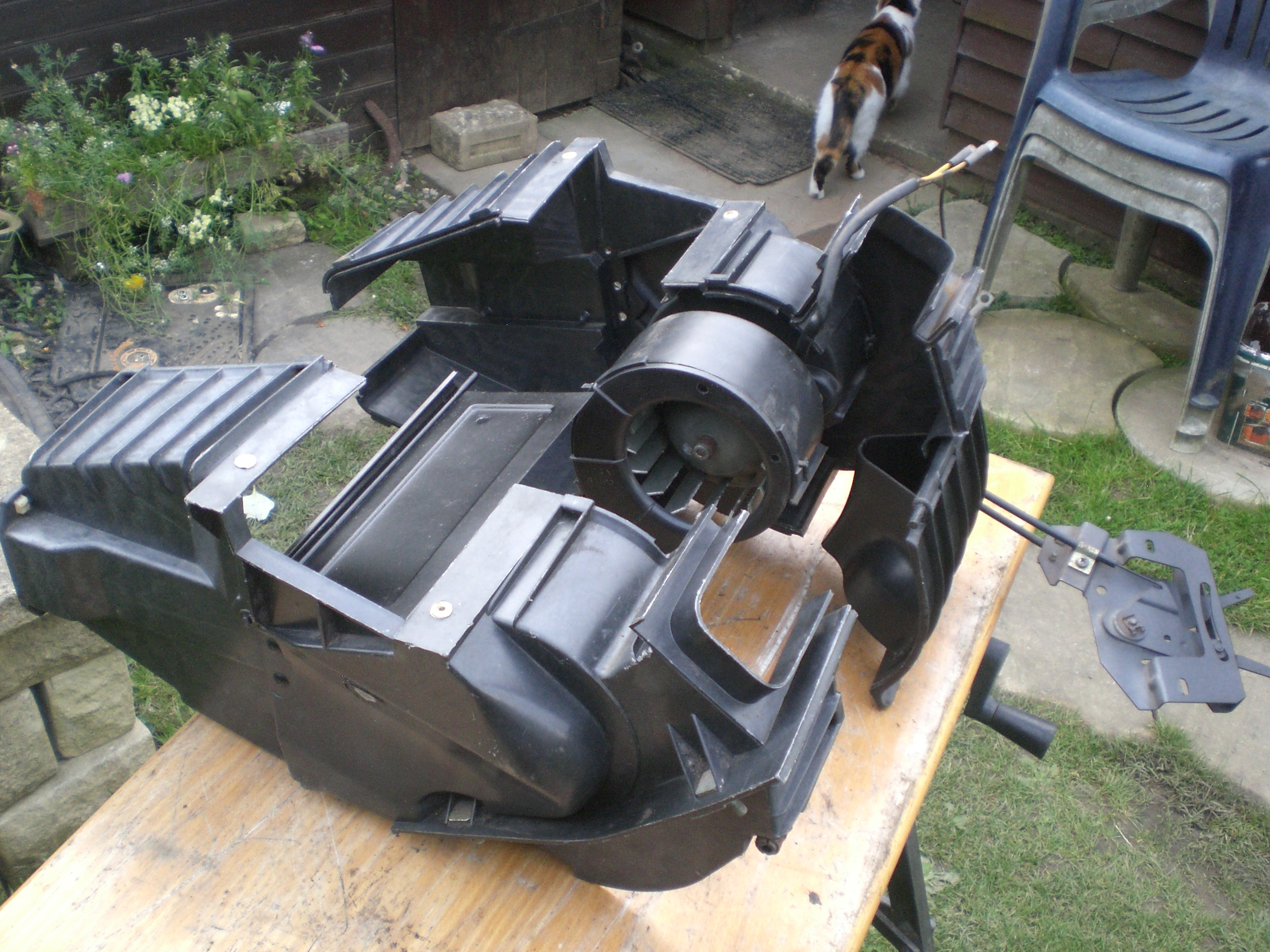

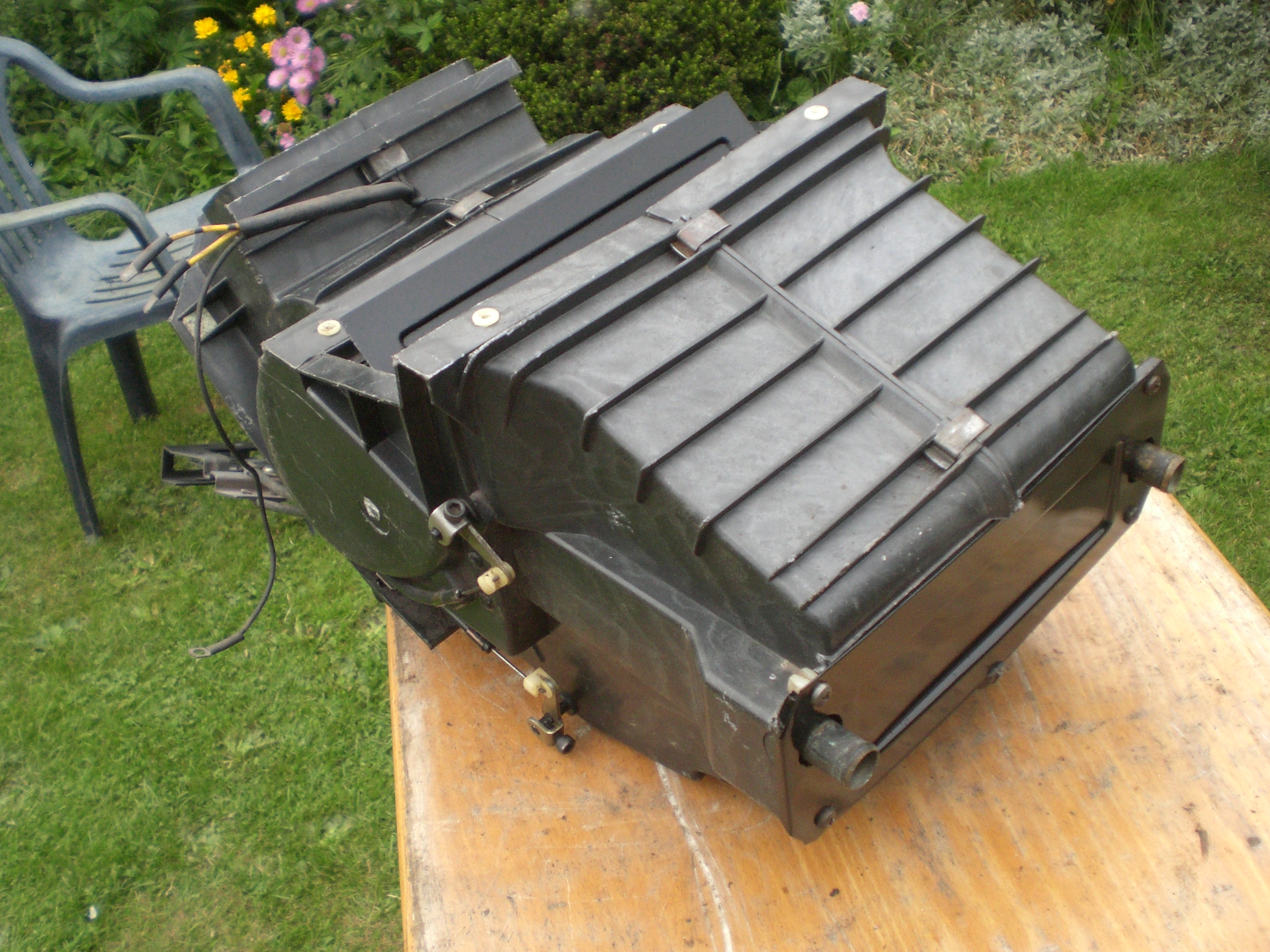

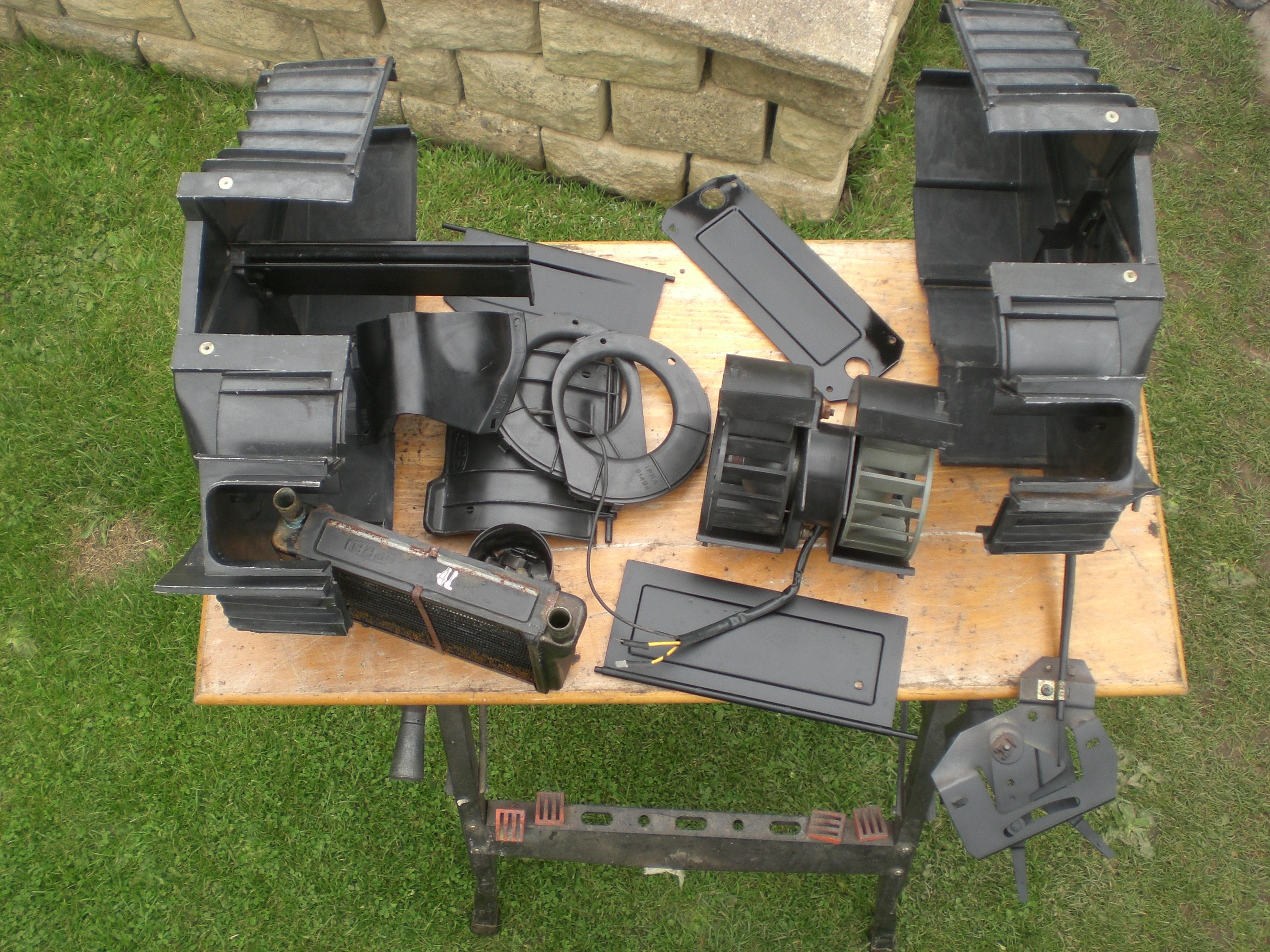

stripped the heater box apart yesterday too and cleaned a LOT of crud from the casing, years of use followed by even more years in storage had built up quite a layer of dust and debris.
if you've ever wondered what the inside of the heater box looks like here's some exploded views. my cat keeping an ever watchful eye on things
