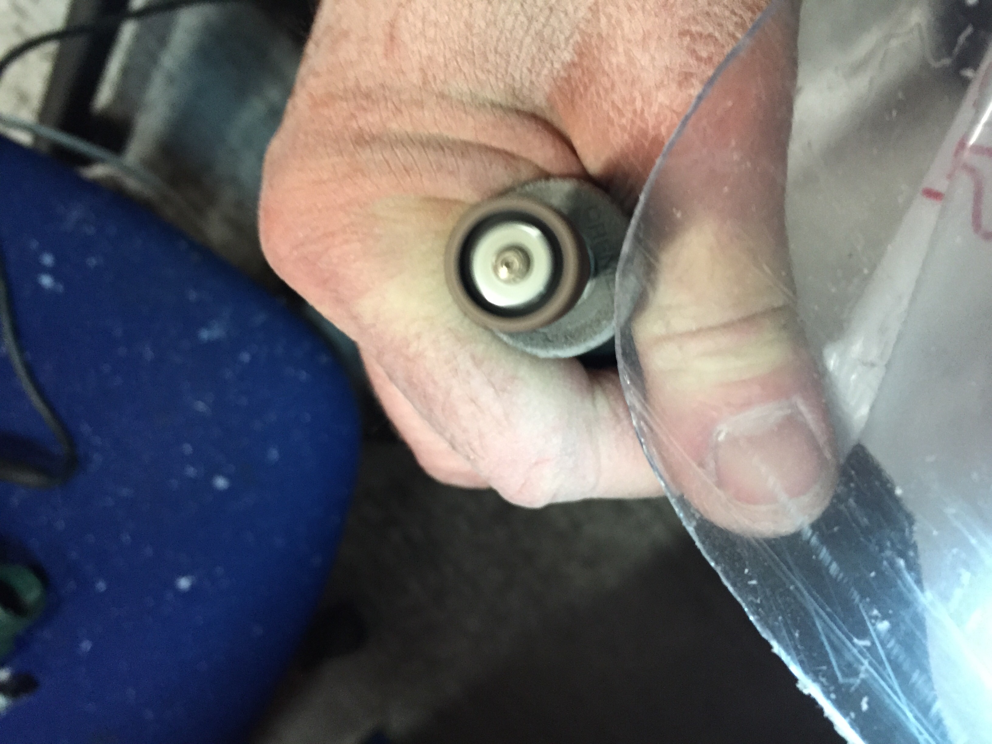

Window placed on the Lexan sheet and mark round it with a scriber.
Cut out the lexan window with a jigsaw and dress the corners with a dremel.
The lexan window is half the weight - so a loss of 4kg.
It's a 10min job to take the lexan window out now and fully reversible. Not water tight but the car is garaged apart from when racing.
