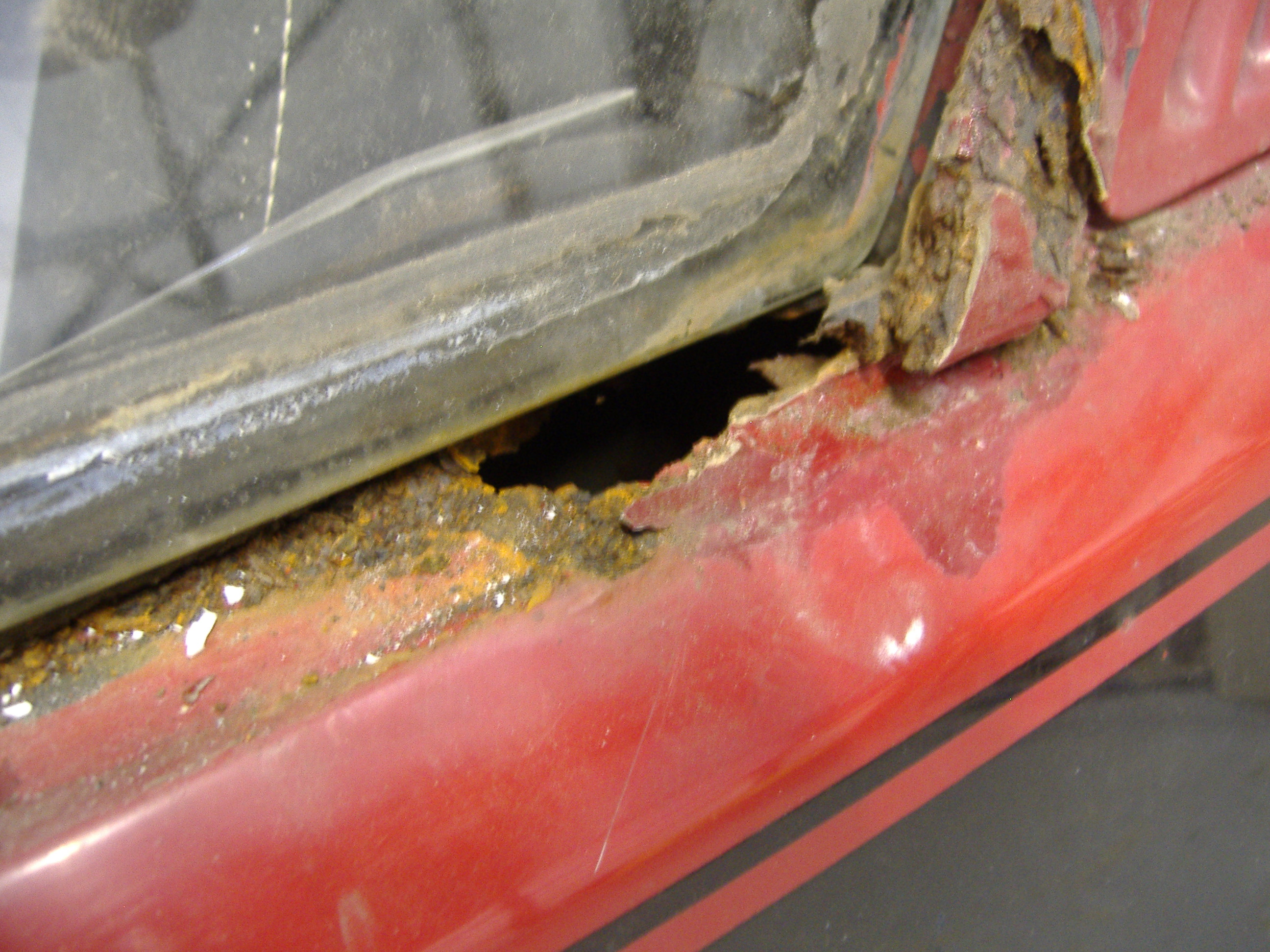

Nice use of the old door frame Kev.
I used one to repair my rotted out rear quarter window frames. It is good to be a womble . :P
Keep up the great work.

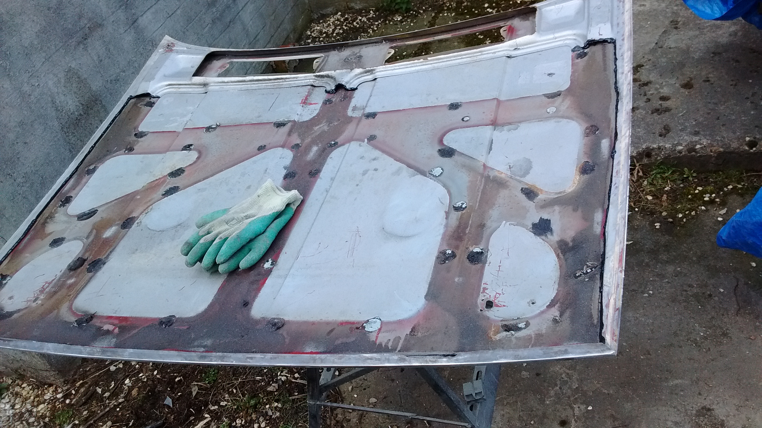

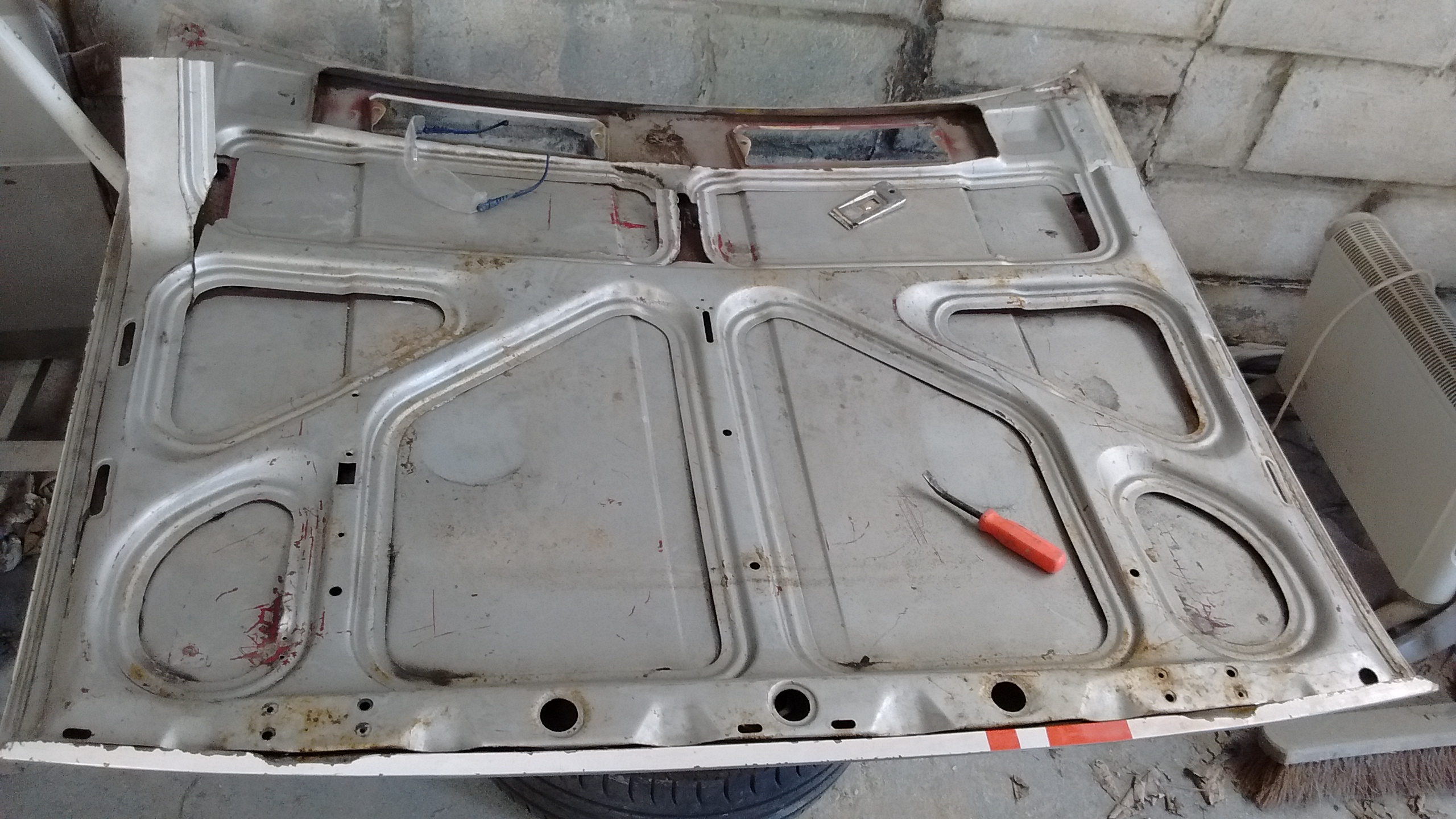

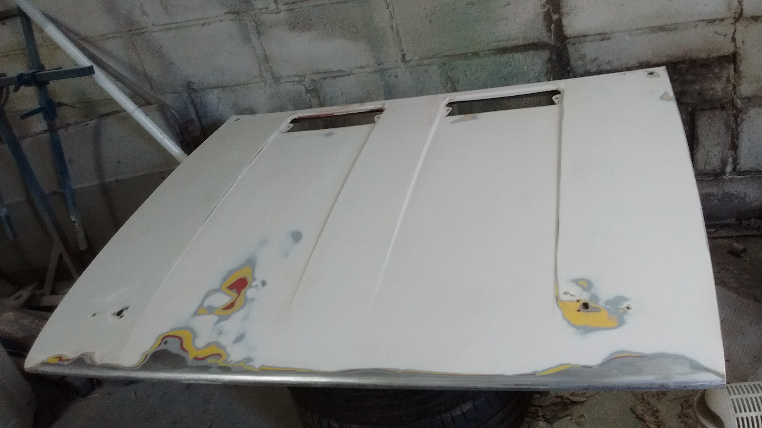

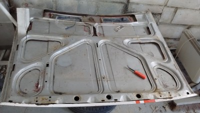

the bonnet tim wanted to remove the bracing from the underside to save a bit of weight, a nervy thing to do as I wondered for one how strong it'd be without the bracing and for another thing, how to get it all off without running through the skin!
angle grinder with a thin disc and it all peeled away fairly well in the end. bonnet is pretty floppy as I thought it might be but still good enough. as a precaution to getting cut finger ends when lifting it off I cleaned and flattened the edges then applied a bead of sealant, just the job

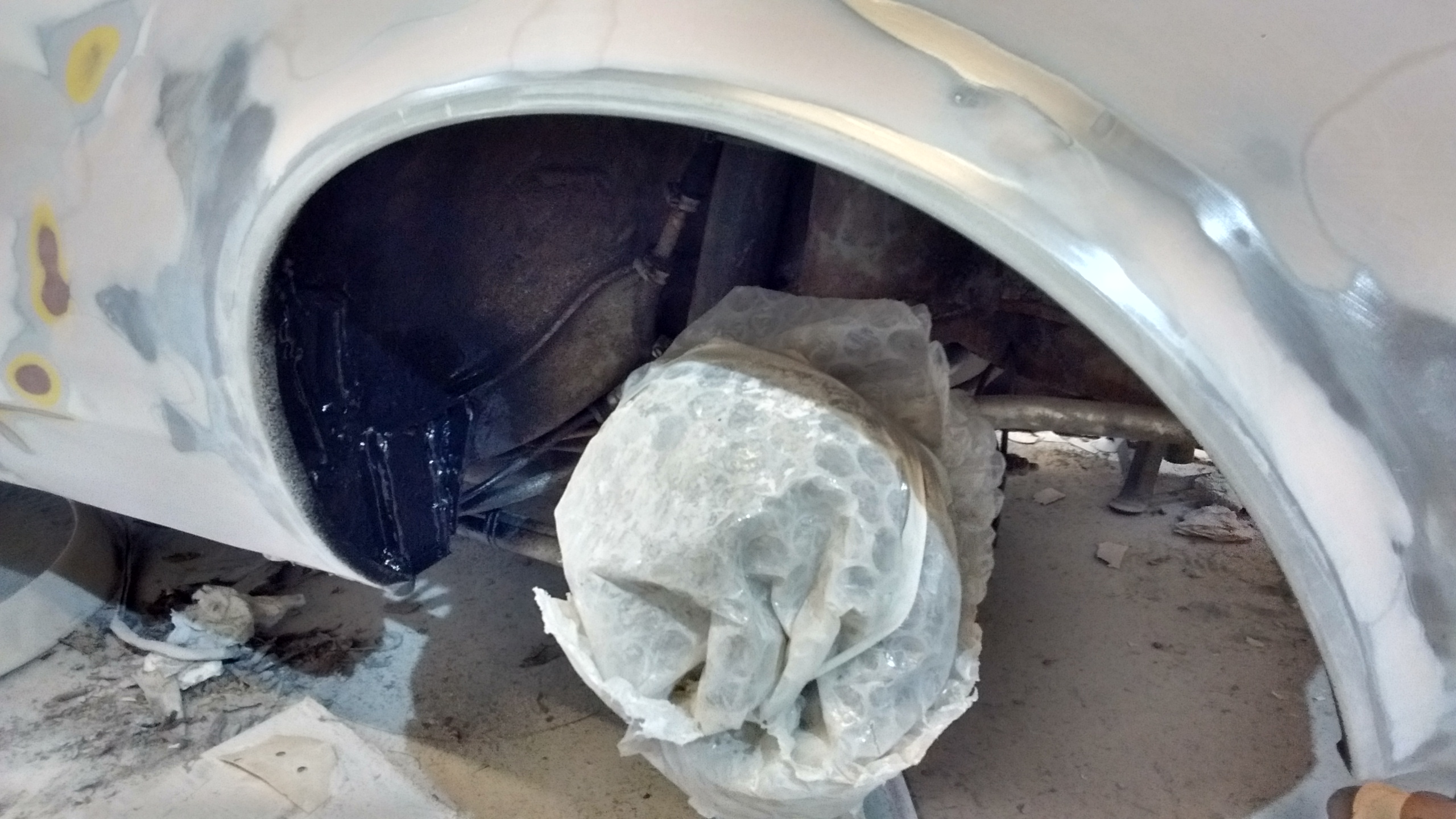

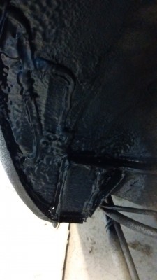

rear arches got a layer or two of stonegaurd to protect the welds and seams, watertight and over paintable if needed but ok as is to keep moisture out

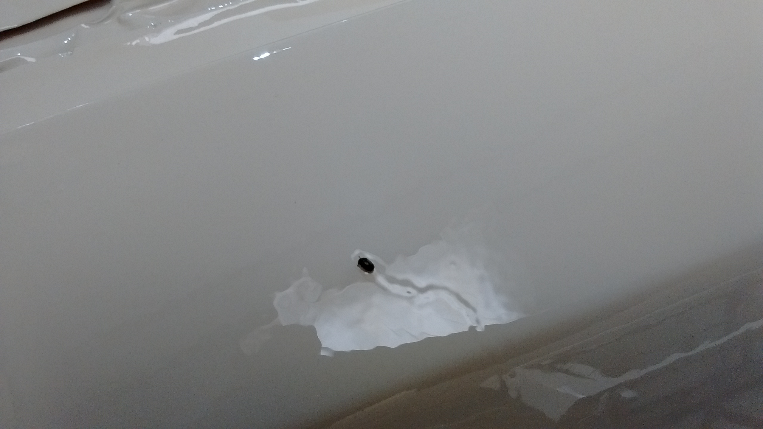

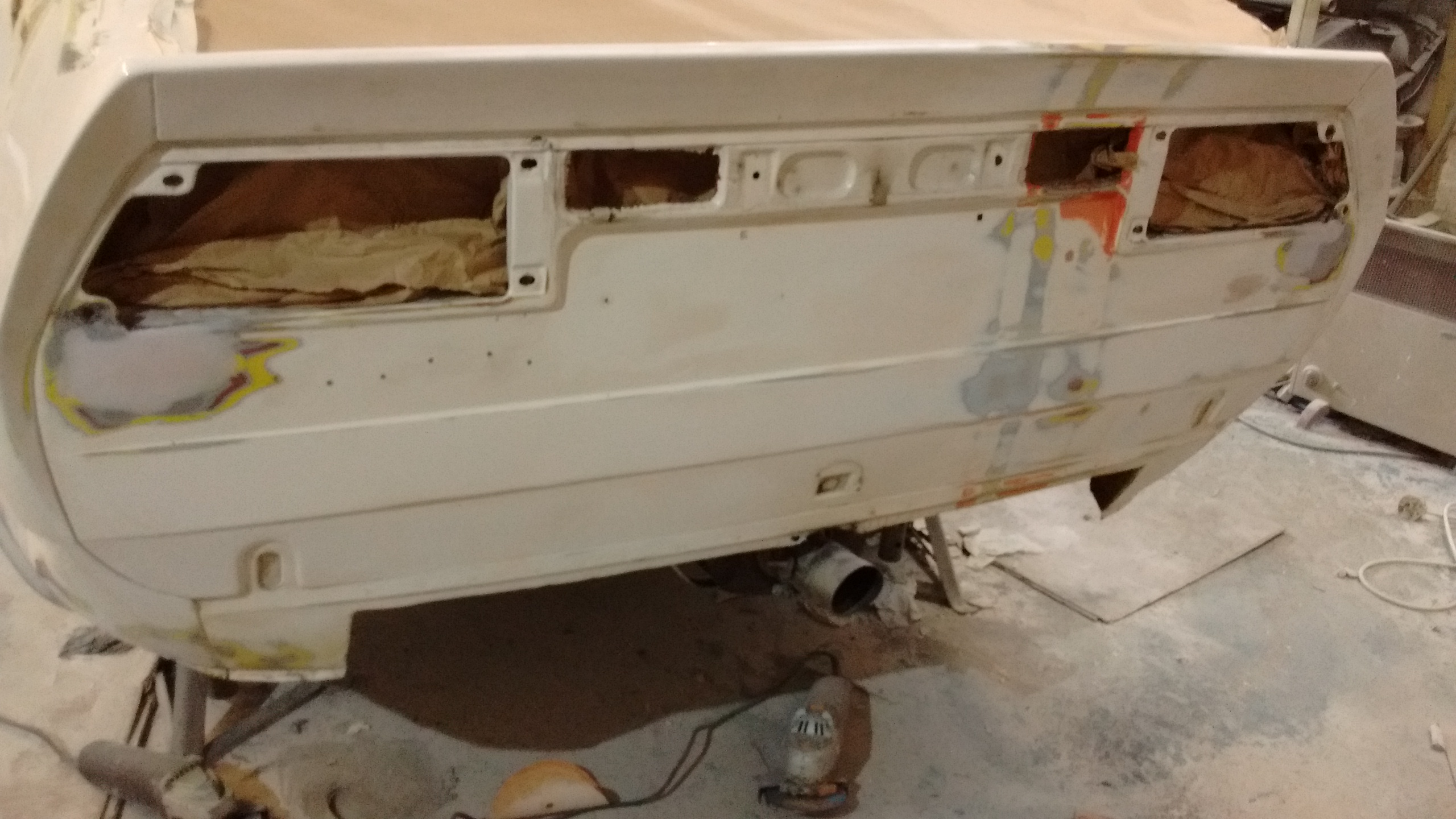

rear panel needed a repair under each light fitting, thought i'd done with the welder...should have known better!

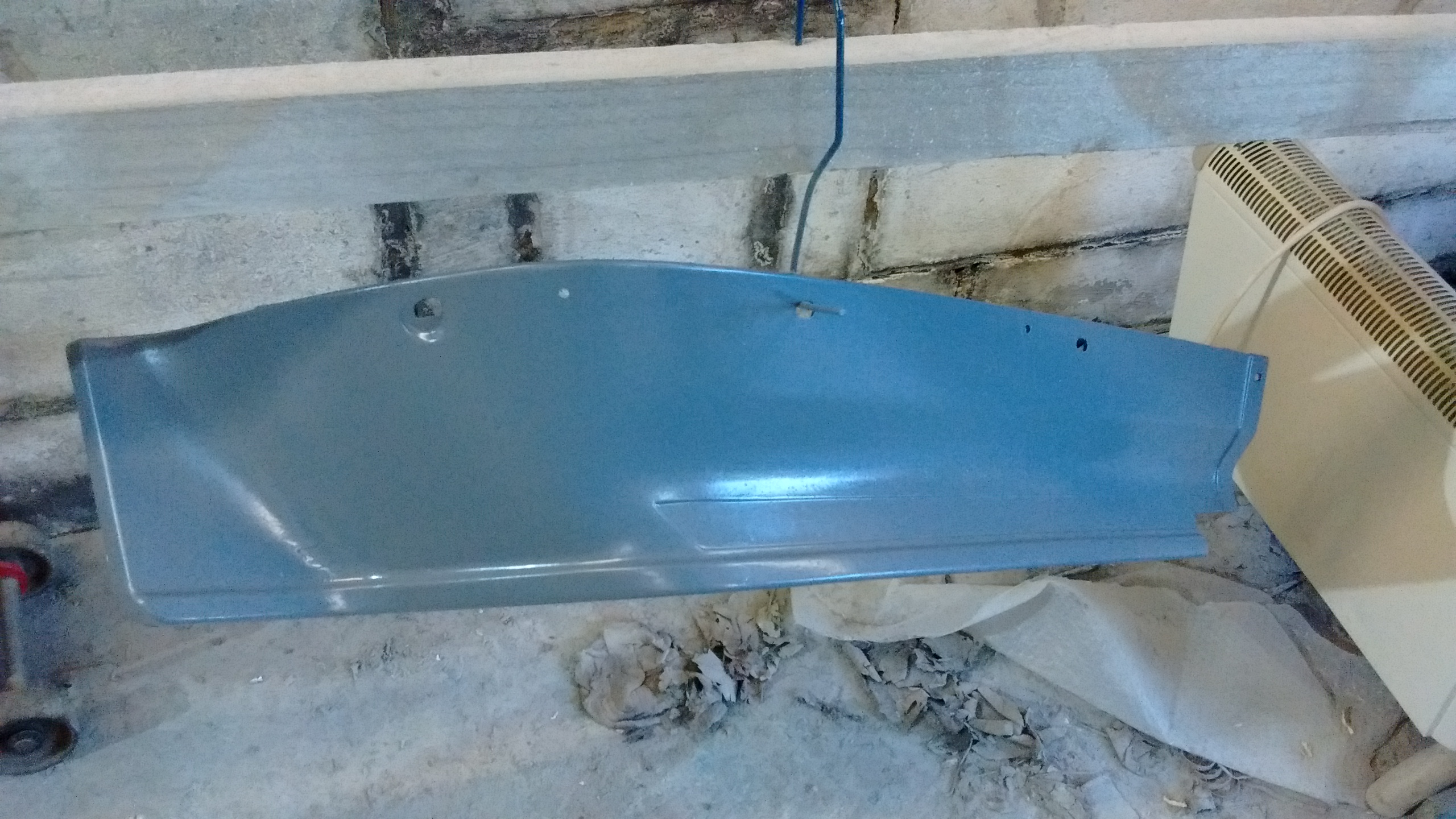

etch primed a few parts, front spoiler
rear arches

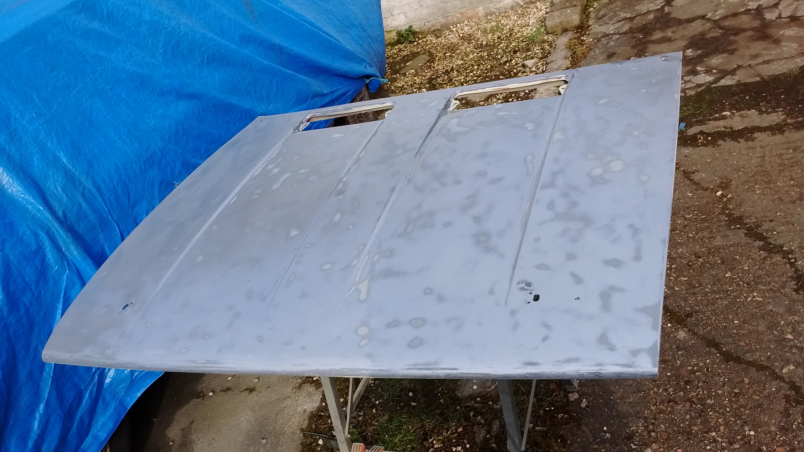

bonnet edge was taken back to bare because of a load of stone chips..
Re: Sprint racer
all bare/vulnerable areas have been etch primed now, tomorrow i'll sand the rest down and prime it all.

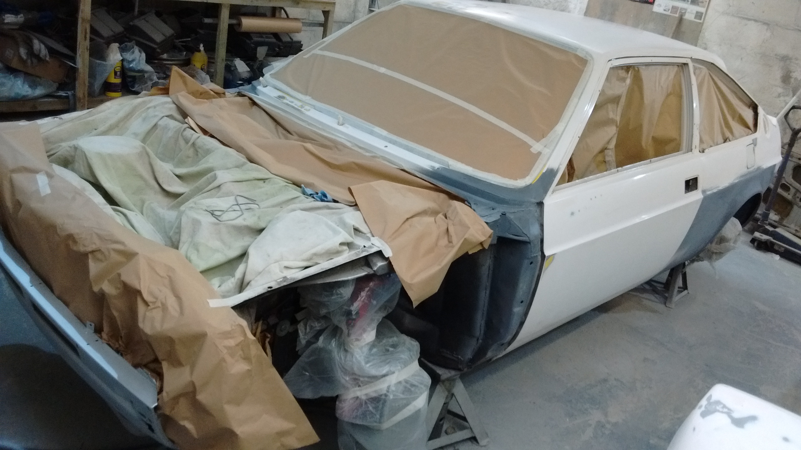

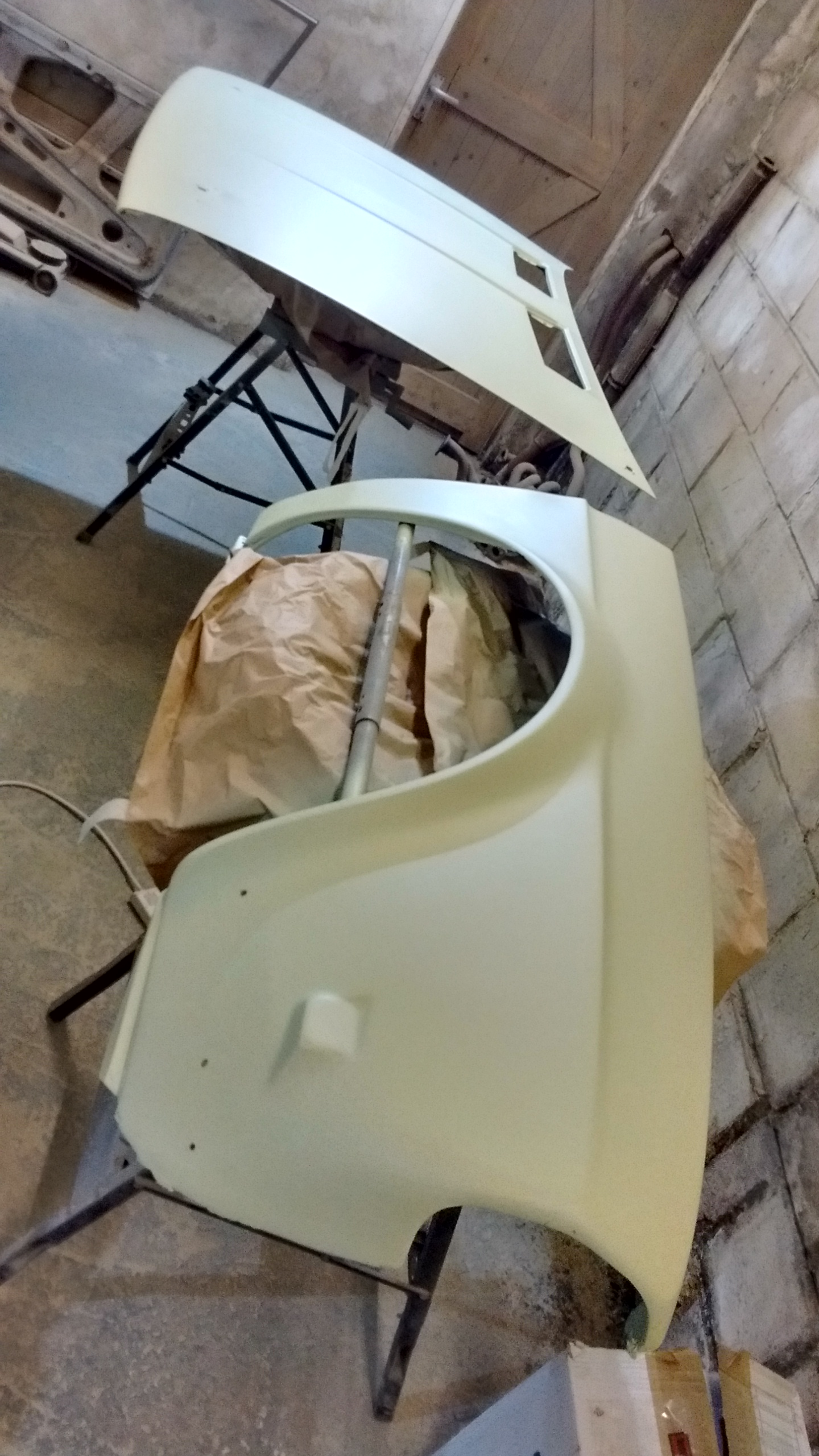

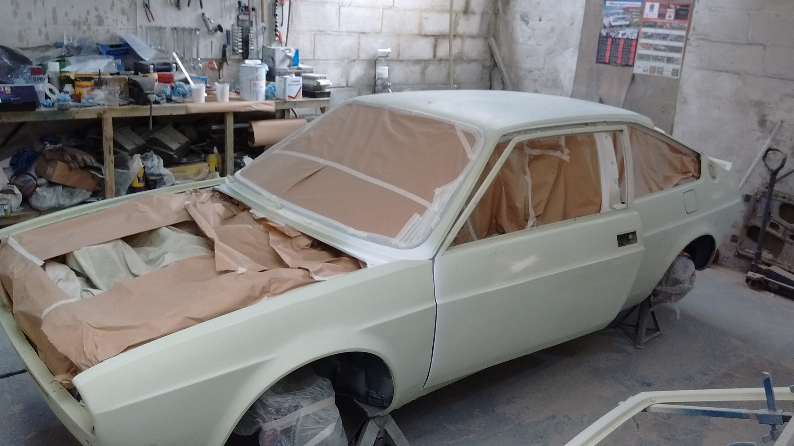

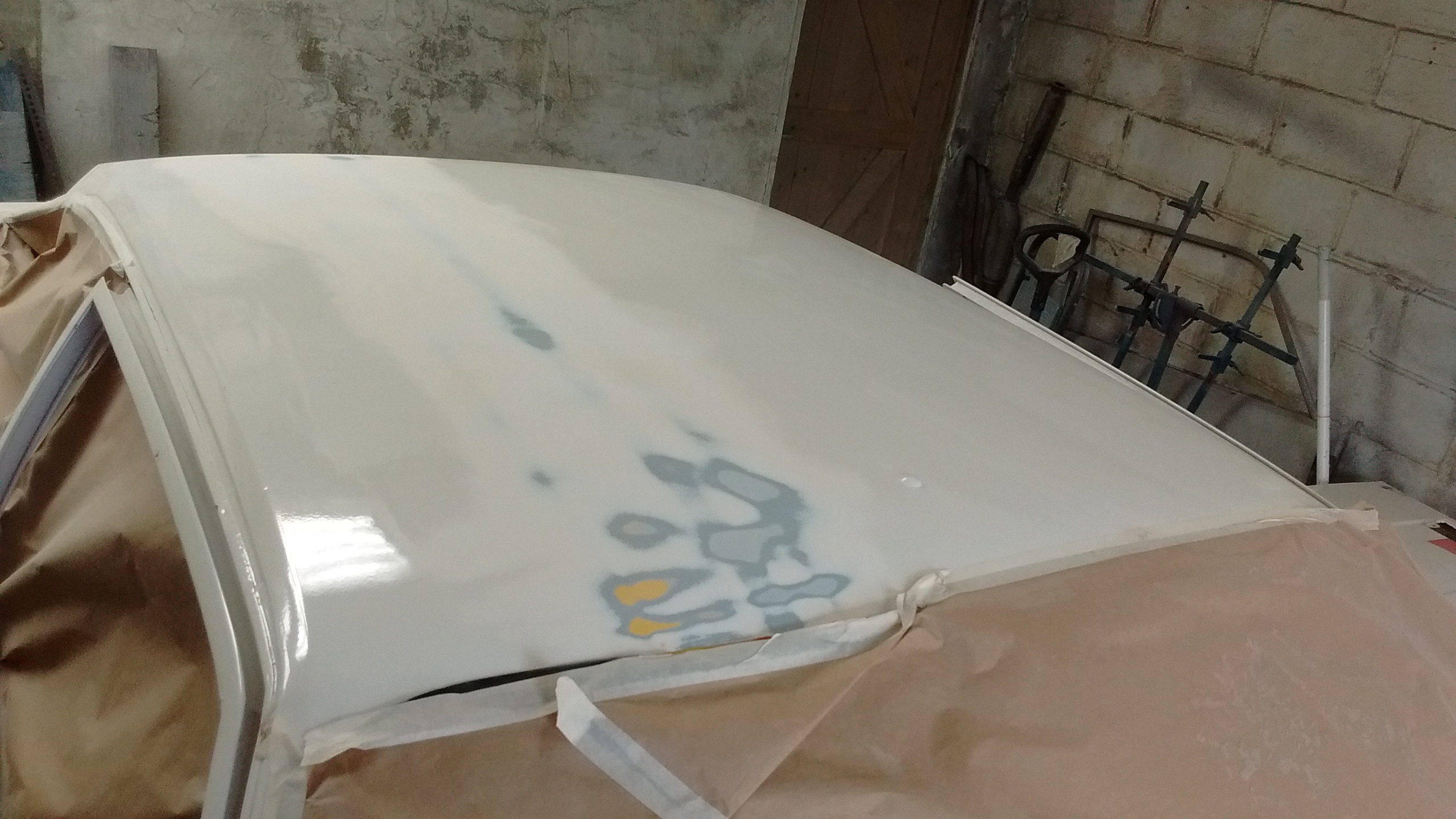

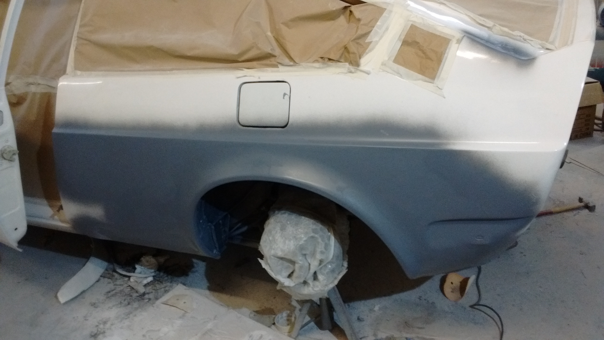

everywhere sanded down and cleaned up, wings, bonnet, hatch and front spoiler laid out so I can paint everything in one go which is handy, we put the car in offset to one side of the workspace which has worked out well
all old masking removed and new applied
workshop had a much needed tidy up which cleared a bit more space but more importantly the clean floor will stop dust flying in the air as you walk around, plus the air-line dragging lifts dust up too. i'll try the old pros' trick when topcoat goes on of dampening the floor....

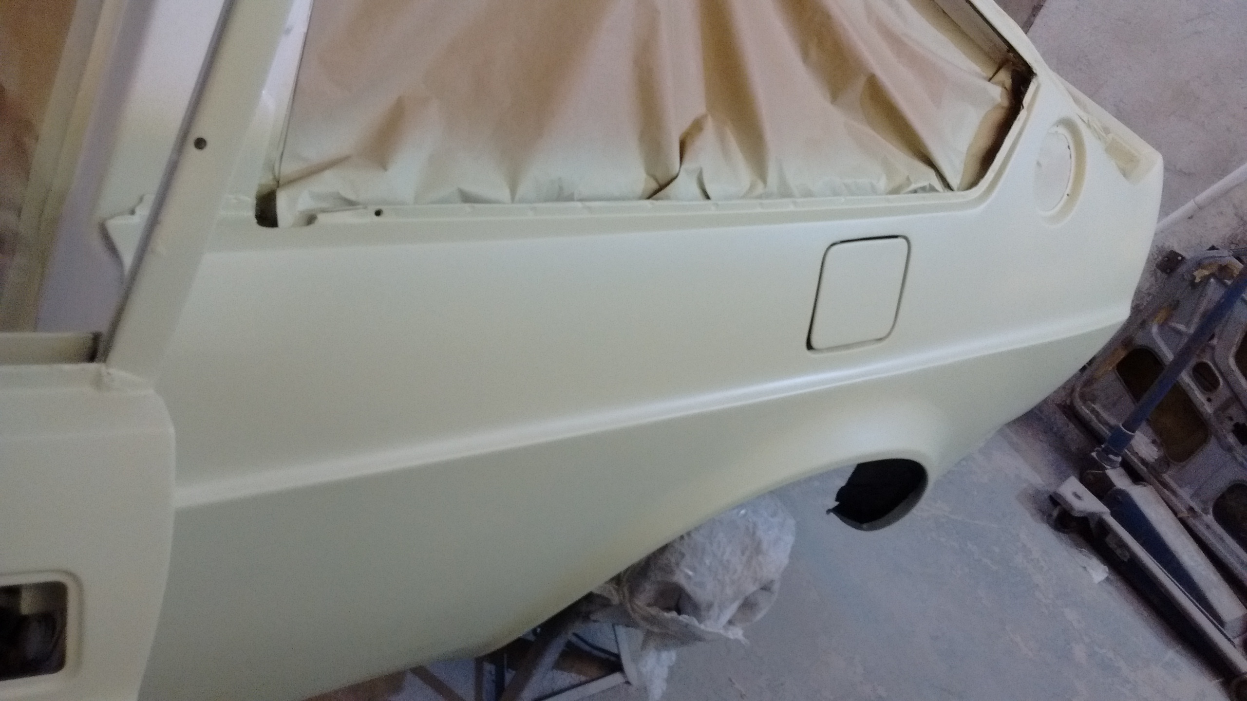

finally got around to putting the proper primer on
all went well apart from the bonnet and one wing, wing I think may be my own fault, trying to clean so many panels in one go, the bonnet has reacted where it had been painted before.
i'll strip both down tomorrow.
the screen surround i'll put some topcoat on then fit the wings before doing the rest, hopefully everything will go to plan tomorrow and sunday will be the big day to top the job off.

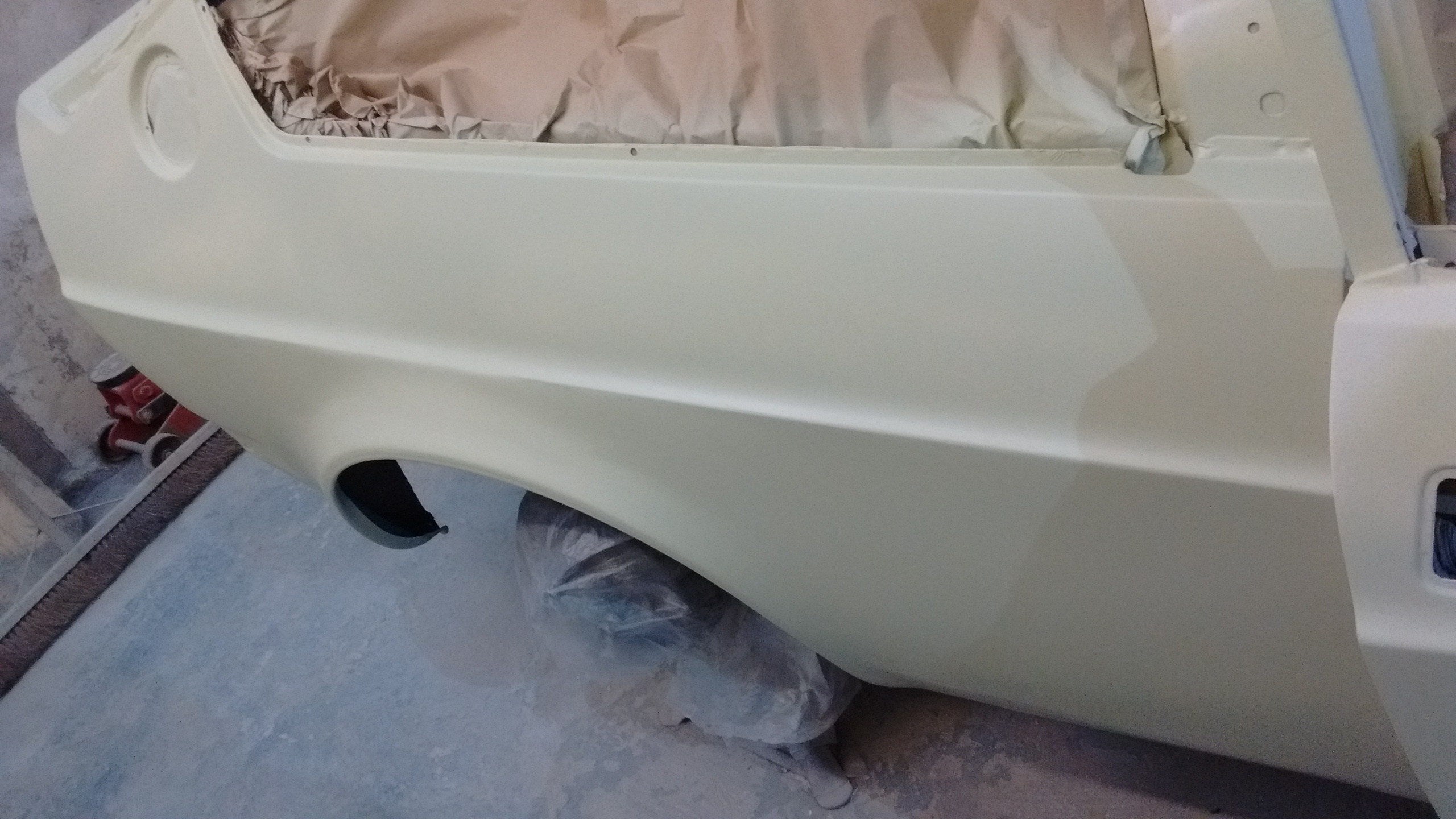

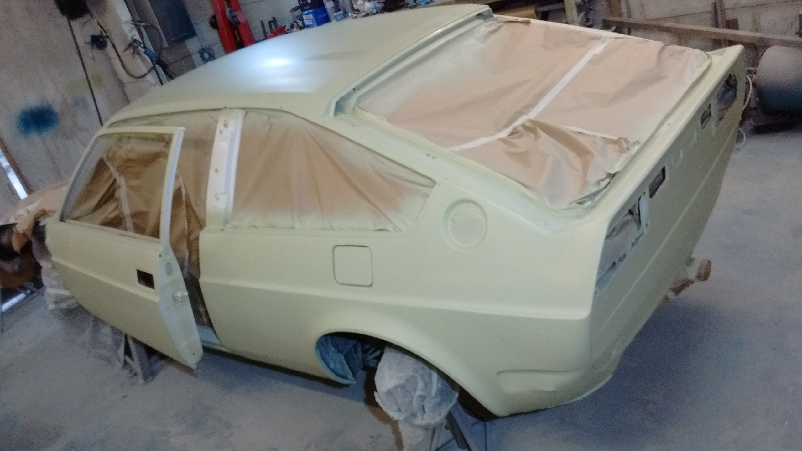

day was supposed to be a simple one, redo the bonnet and wing where the reaction had been, sand the primer down on the rest of the car, re-mask it all up, home early for tea
didn't quite pan out like that.
bonnet and wing reacted badly, not good.
i'd just sanded down the one side of the bonnet to prime it again as it was taking an age to sand back to bare with all the different layers, primer reacted along the feathered edge! nothing for it but to spend hours taking the whole thing back to metal, pain in the arse and hands!
the wing had reacted worse than before, consigned myself that it would have to wait until next week when i'd ask the paint rep for some kind of sealer with it being fibre-glass maybe causing the issues?
eventually got round to sanding the primer off the bodyshell which thankfully went very well, just a few spots to fill in with the stopper

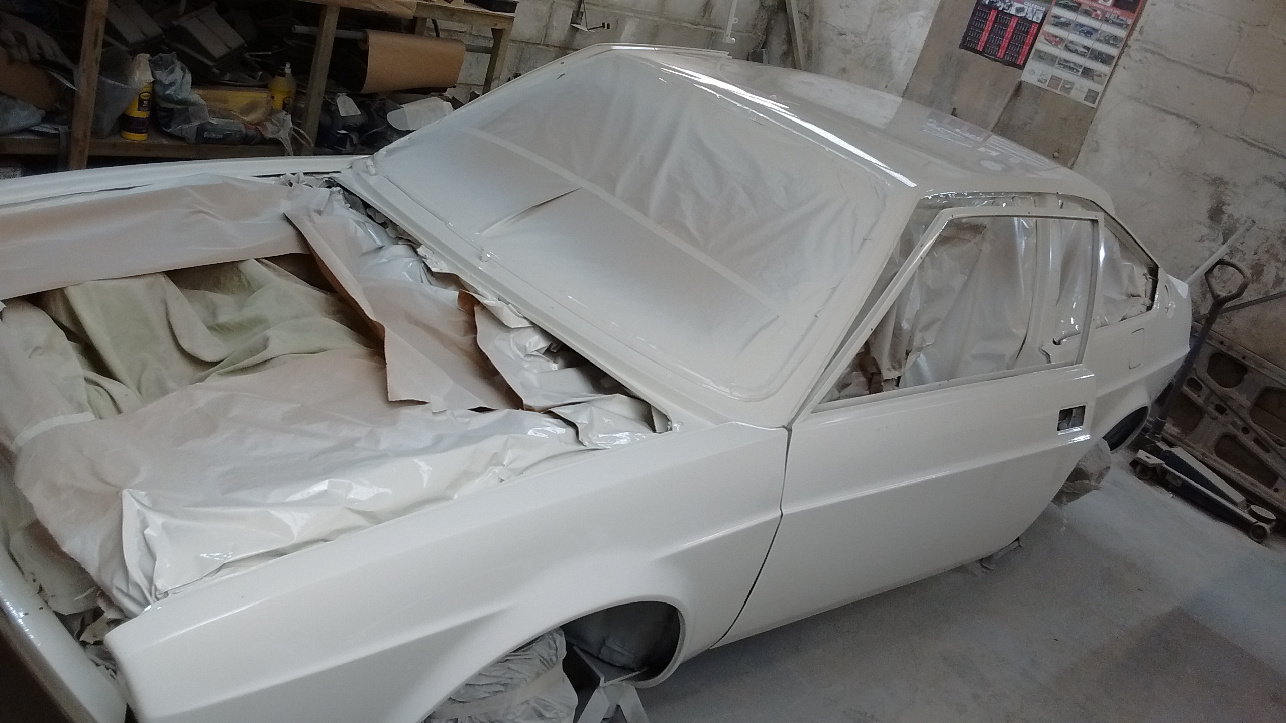

with the bonnet sitting outside in the sun it dried off enough for me to try priming it again, mixed a bit extra to do the rear window frames and maybe try the wing again, just for a laugh

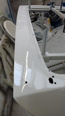

first thing going my way today, the wing turned out perfect! not a bit of an issue? beats me why it decided to play along at last but i'm not complaining!
as I was now actually regaining some momentum I got my new devillbis paintgun out and mixed up a bit of topcoat, to do the corners of the screens under where the wings will fit.

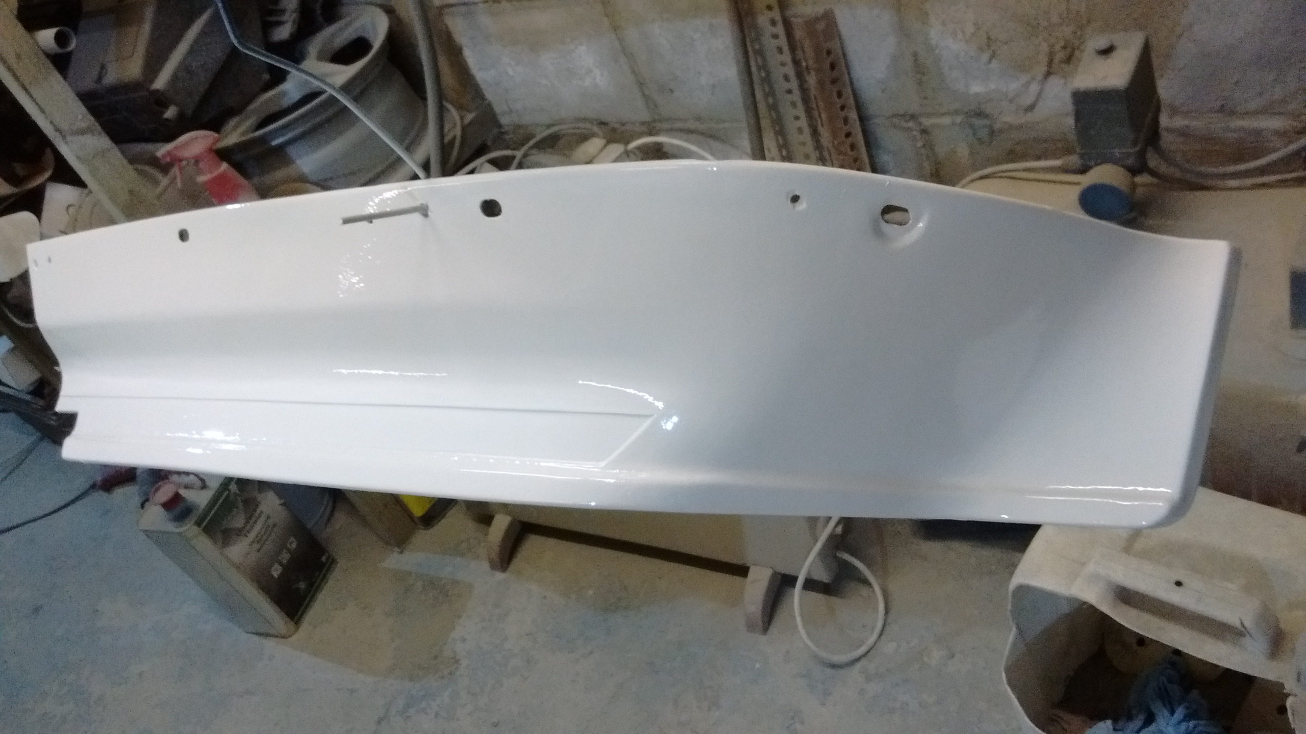

whilst at it I painted the front spoiler halves too, just to have something flat to judge the paintgun settings out. must say it has a much better flow pattern than the cheapo one I was using, £130 paintgun so not cheap in my book but apparently cheap by paintgun standards...

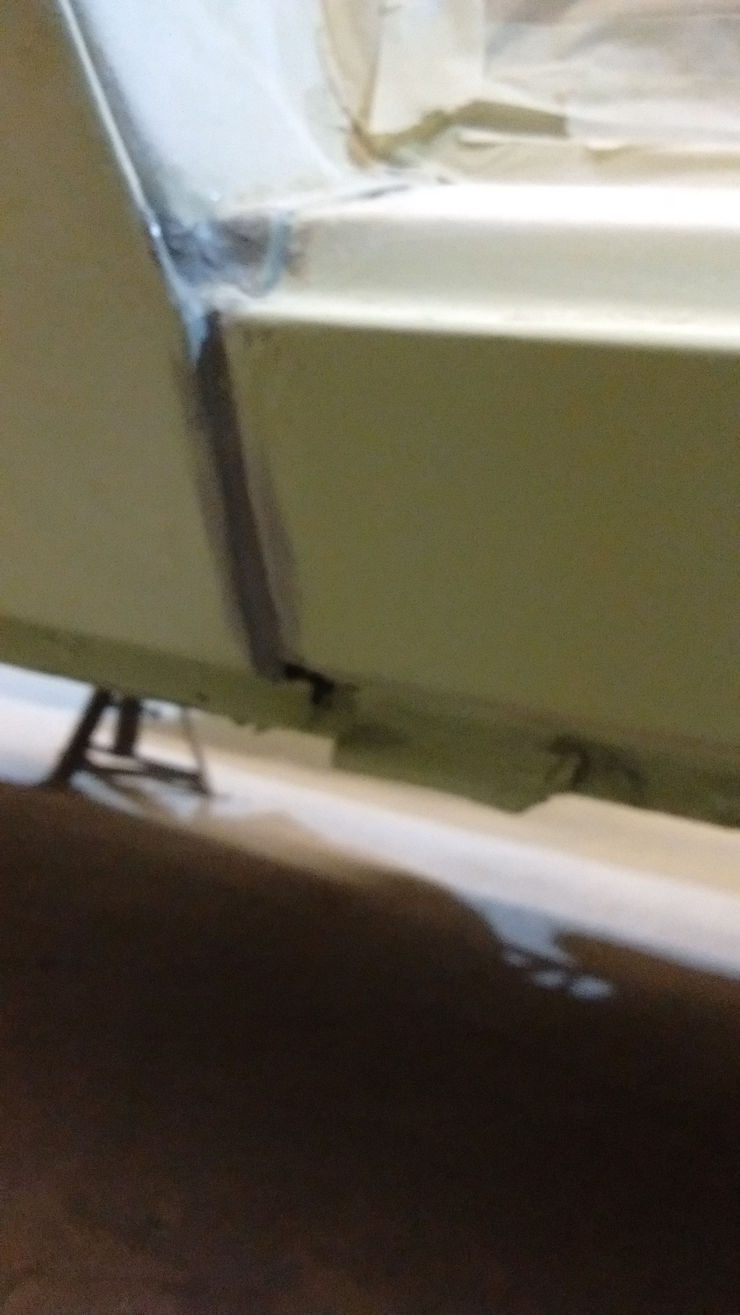

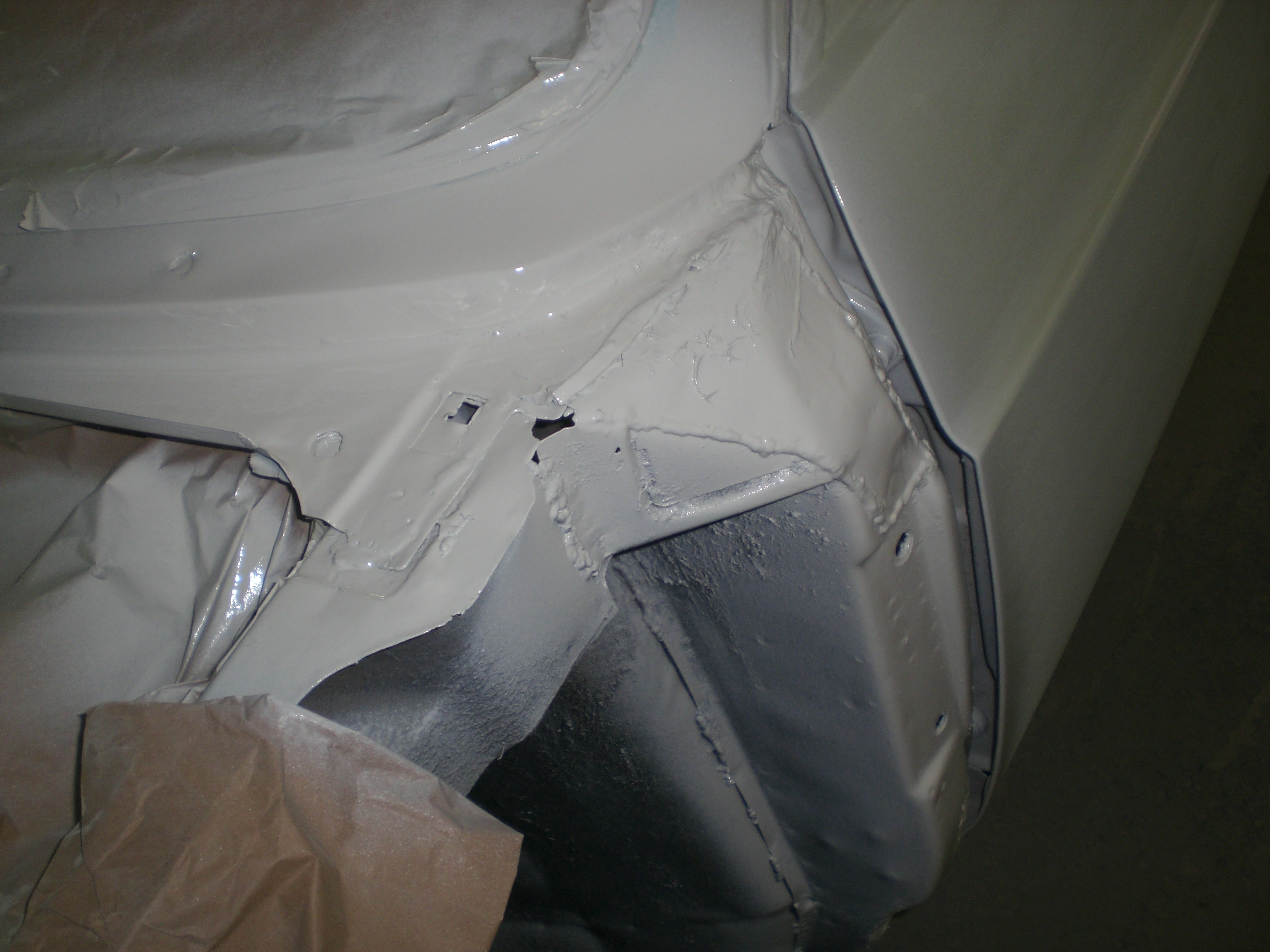

it seemed a bit odd to me the other day that the gap between the sill under the door and the bottom of the rear quarter is left open, all the rain dirt and water will just get blasted in there. so I decided to add a bead of seam sealer
all in all a long day, started off with loads of issues but by the end of it we're back on track to have some colour on it tomorrow.
didn't get it all masked up tonight like I was hoping but a full day tomorrow should see it looking brighter

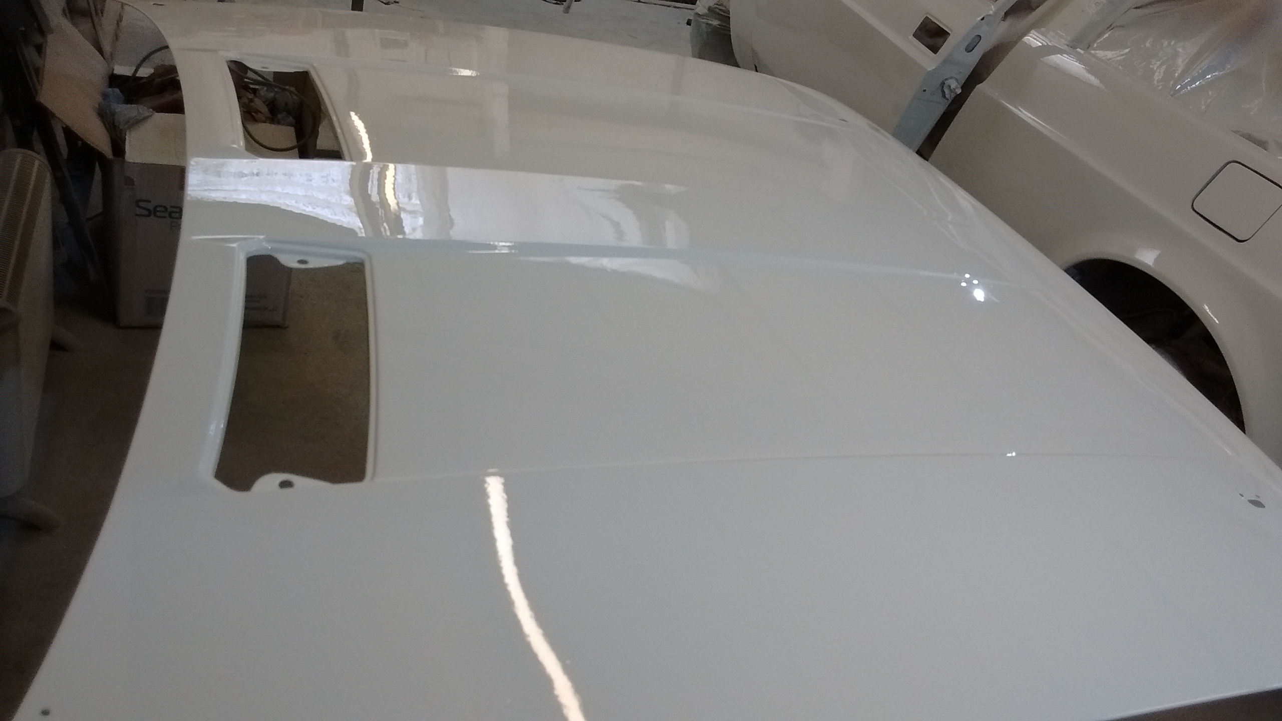

a bit to do today so no Sunday morning lay in for me...
wing & bonnet to sand off
wings to fit
car and workshop floor to clean down
take off all the masking paper....put new paper on
final clean down then ready for the paint

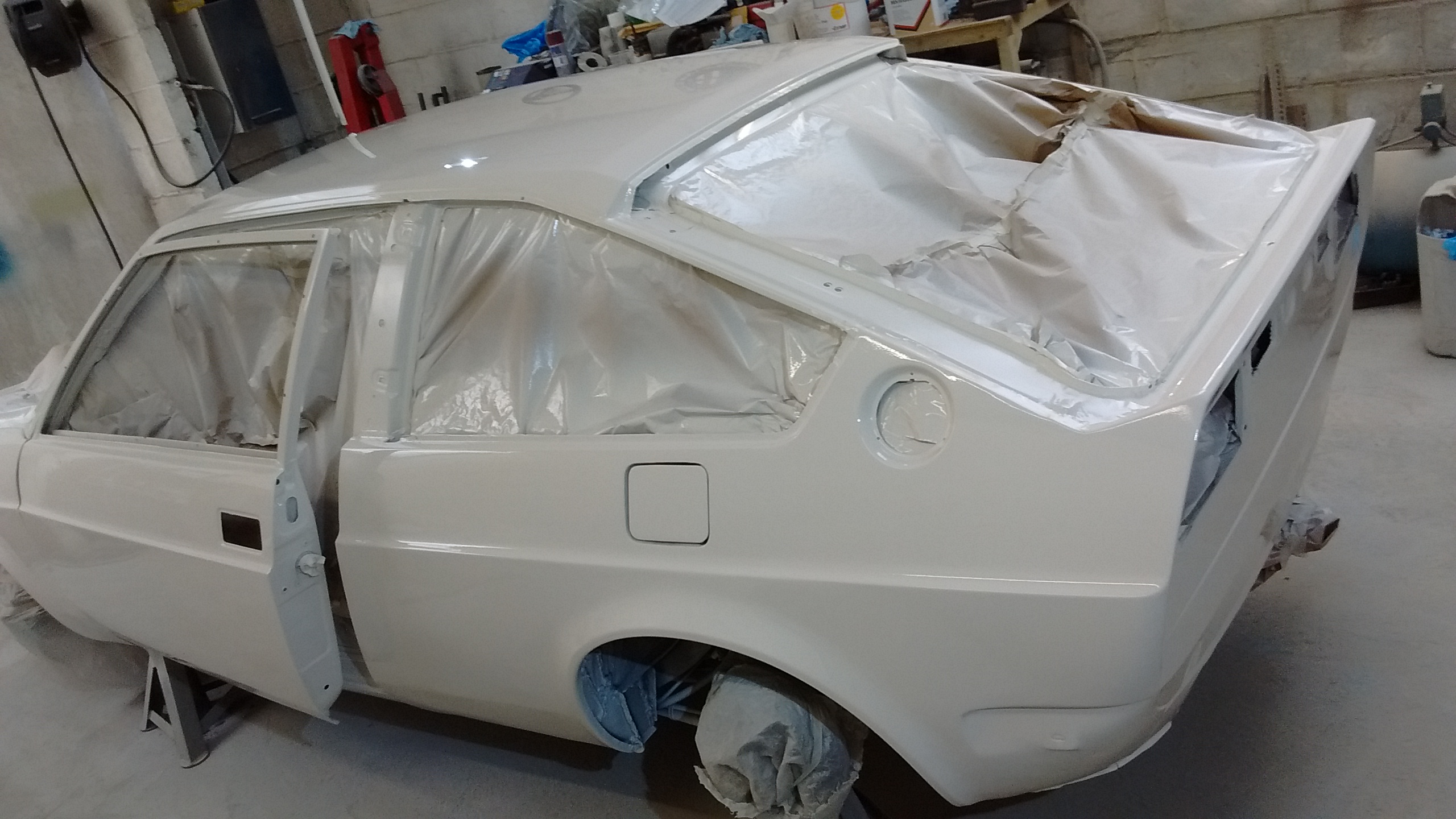

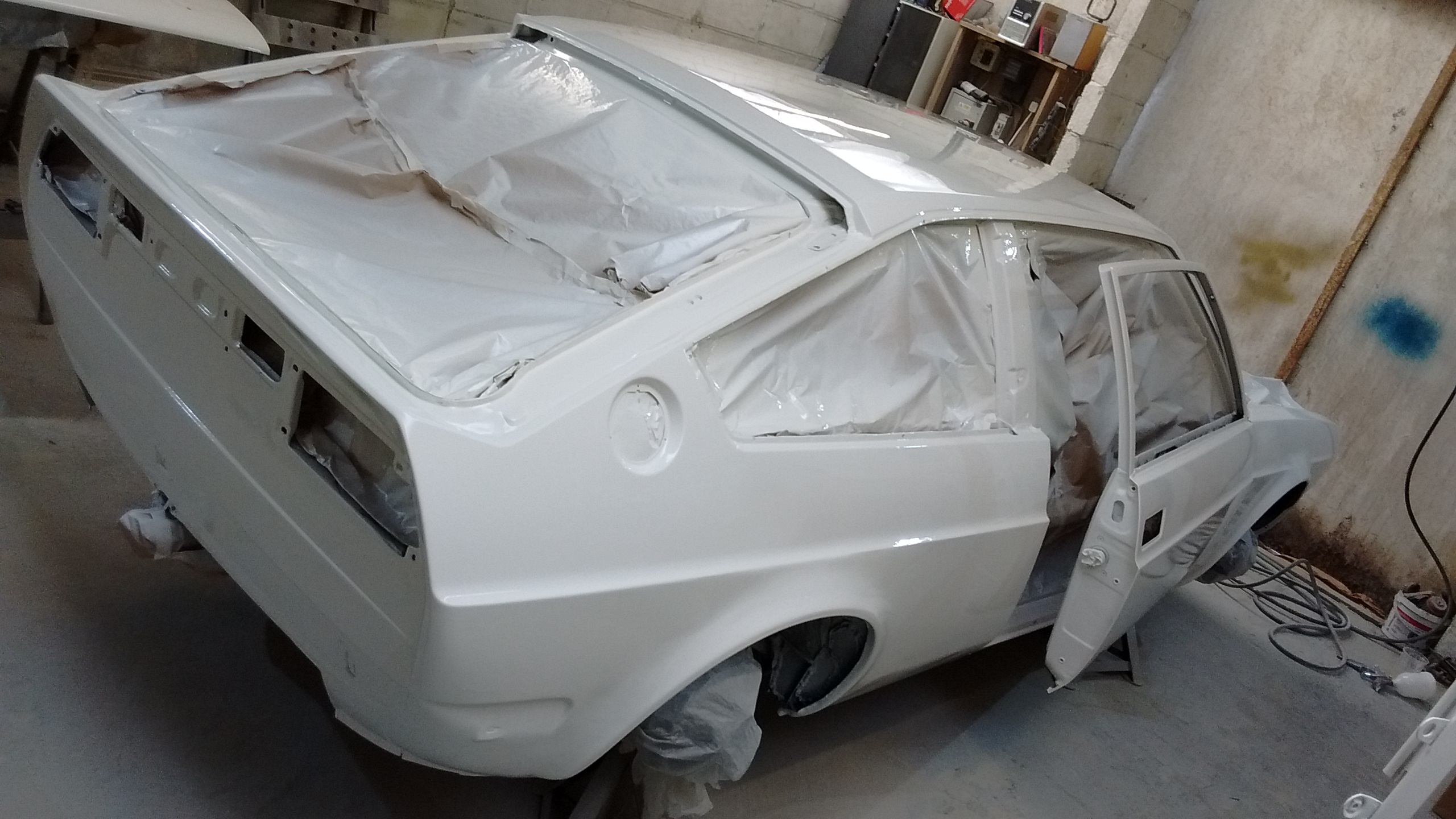

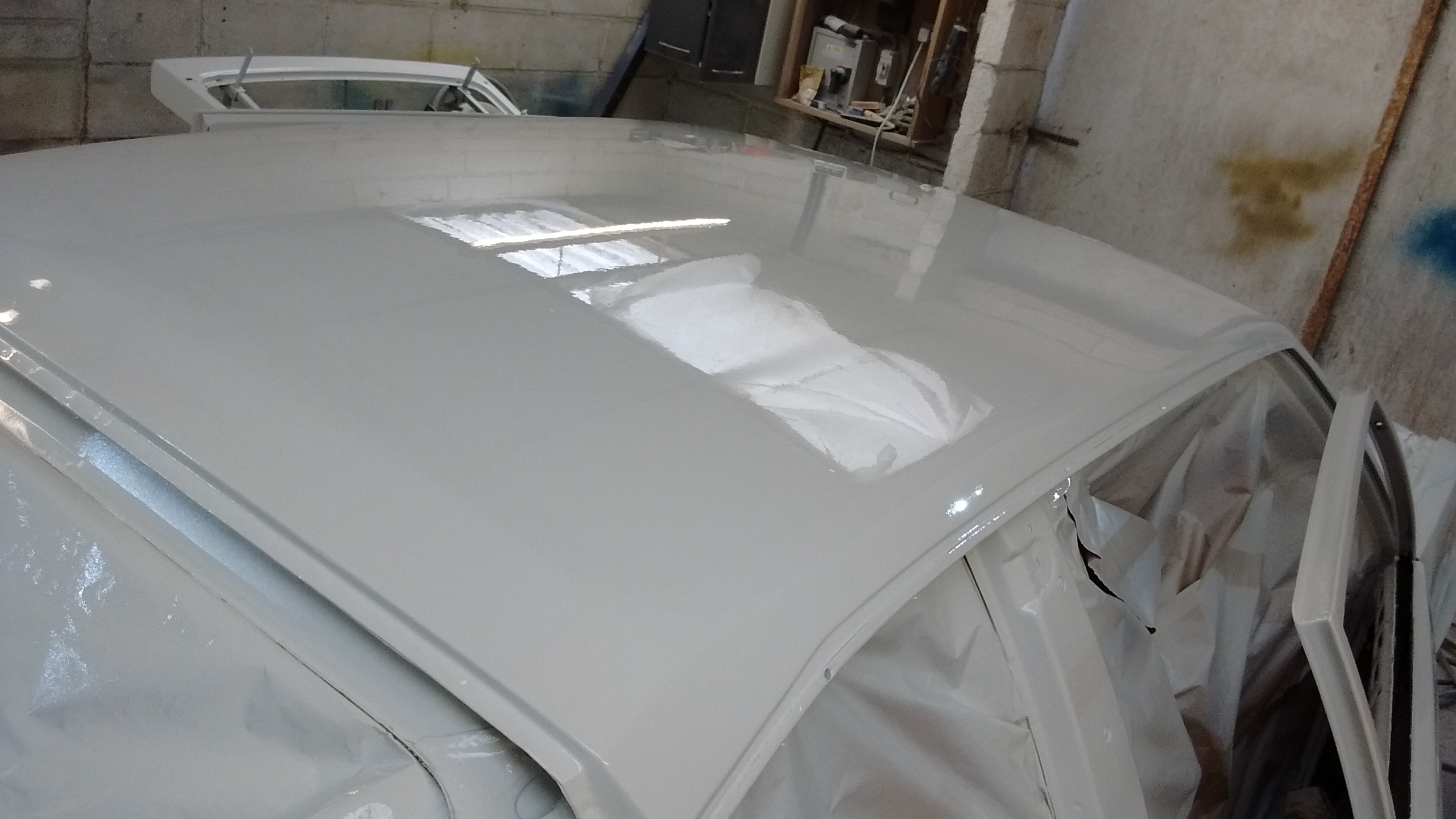

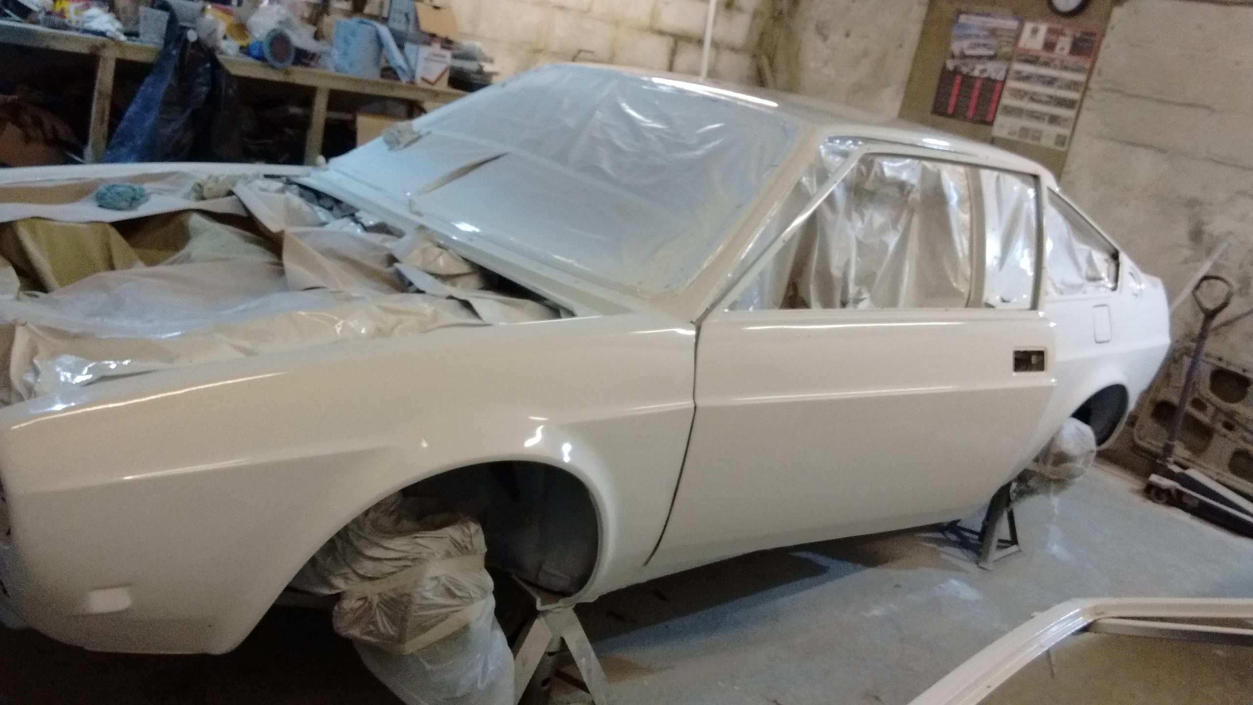

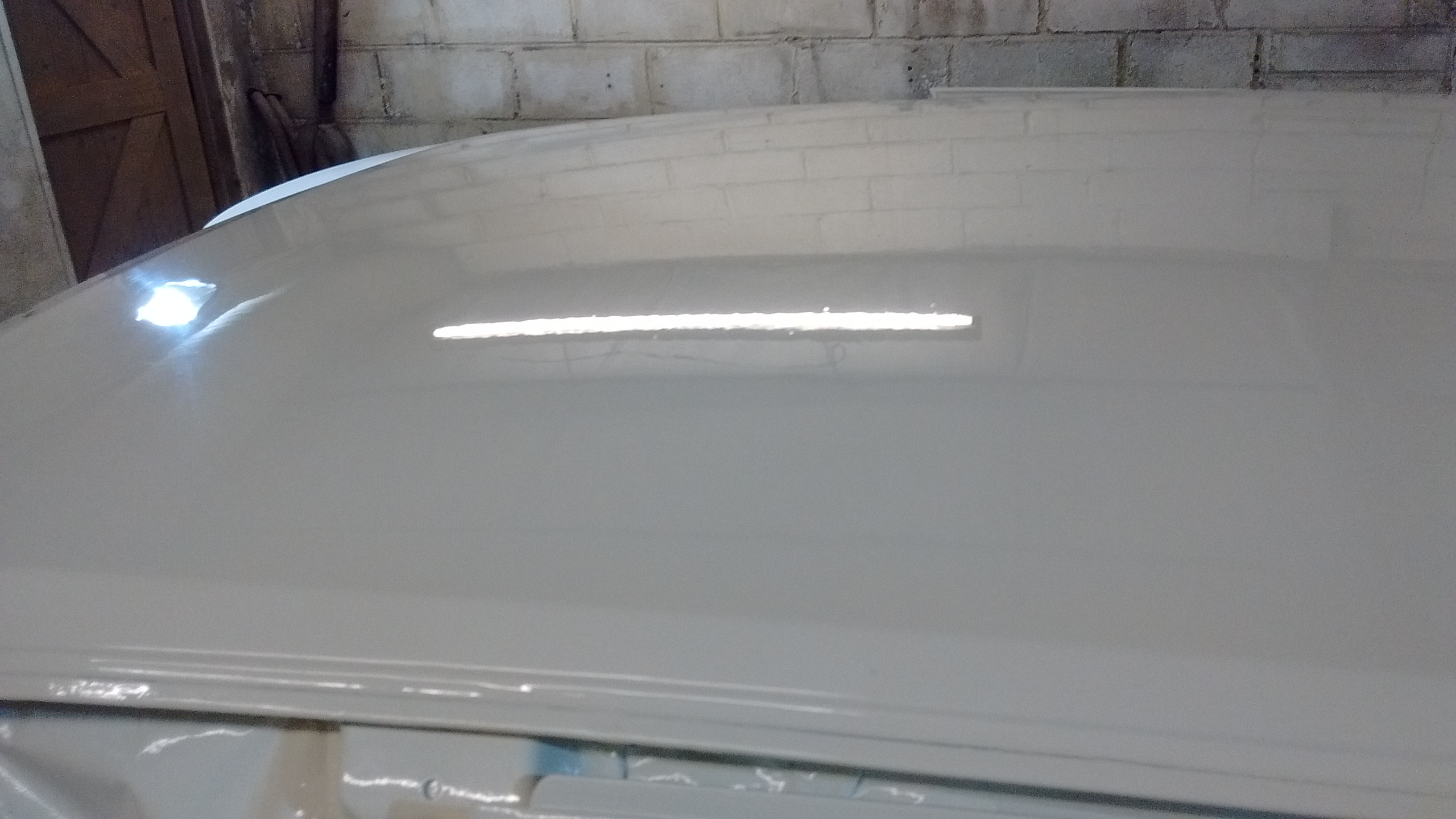

first coat is just a dry one to give the surface some grip, after that I did a further 3 coats. should have enough material to polish up nicely
rear hatch
roof
bonnet
suicidal beetle!
back to work tomorrow so it'll have a few days to rest before I start to clean it up and put it back together, 65 hours work put into it so far Sunday to Sunday, feels like longer!

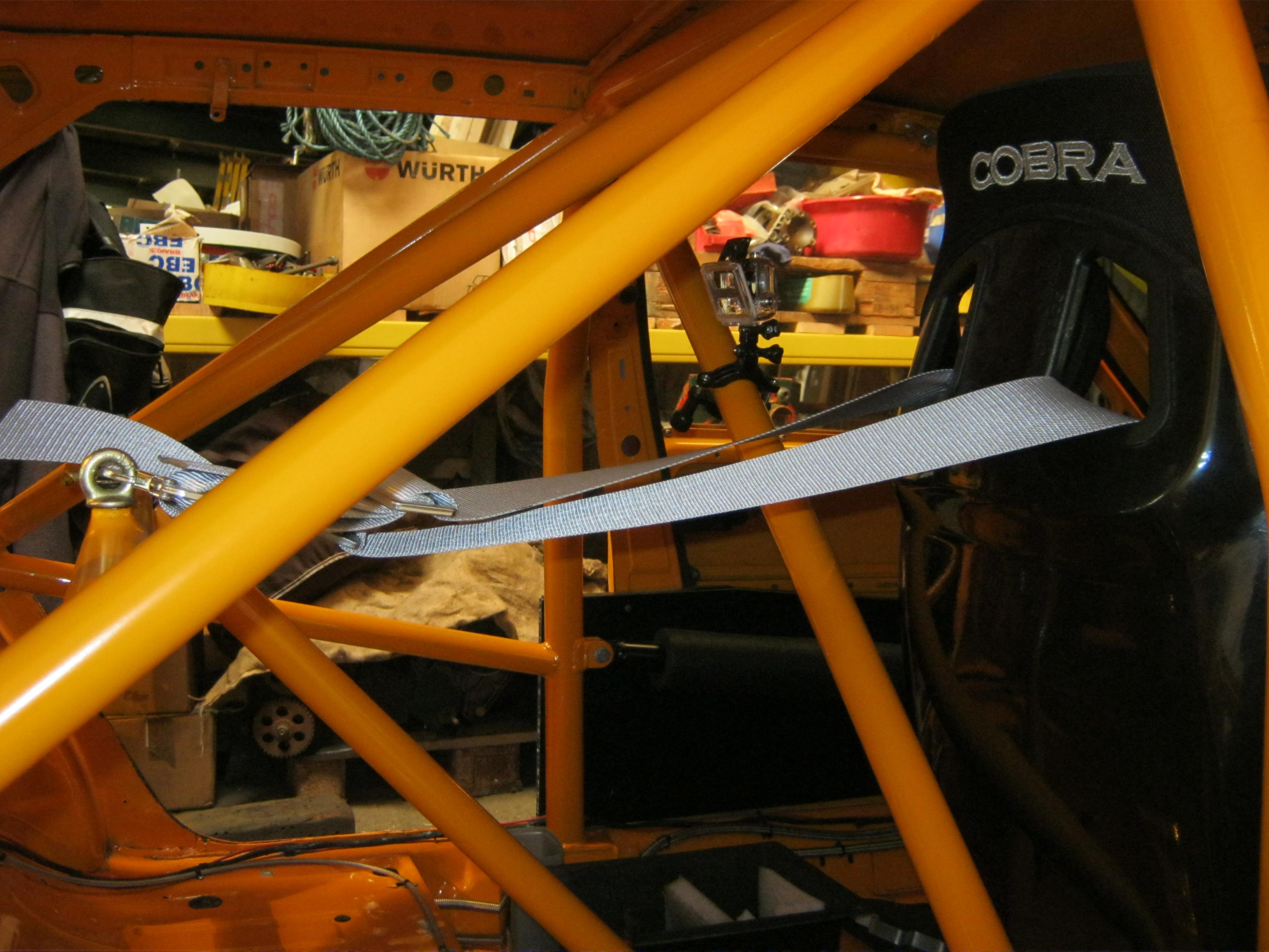

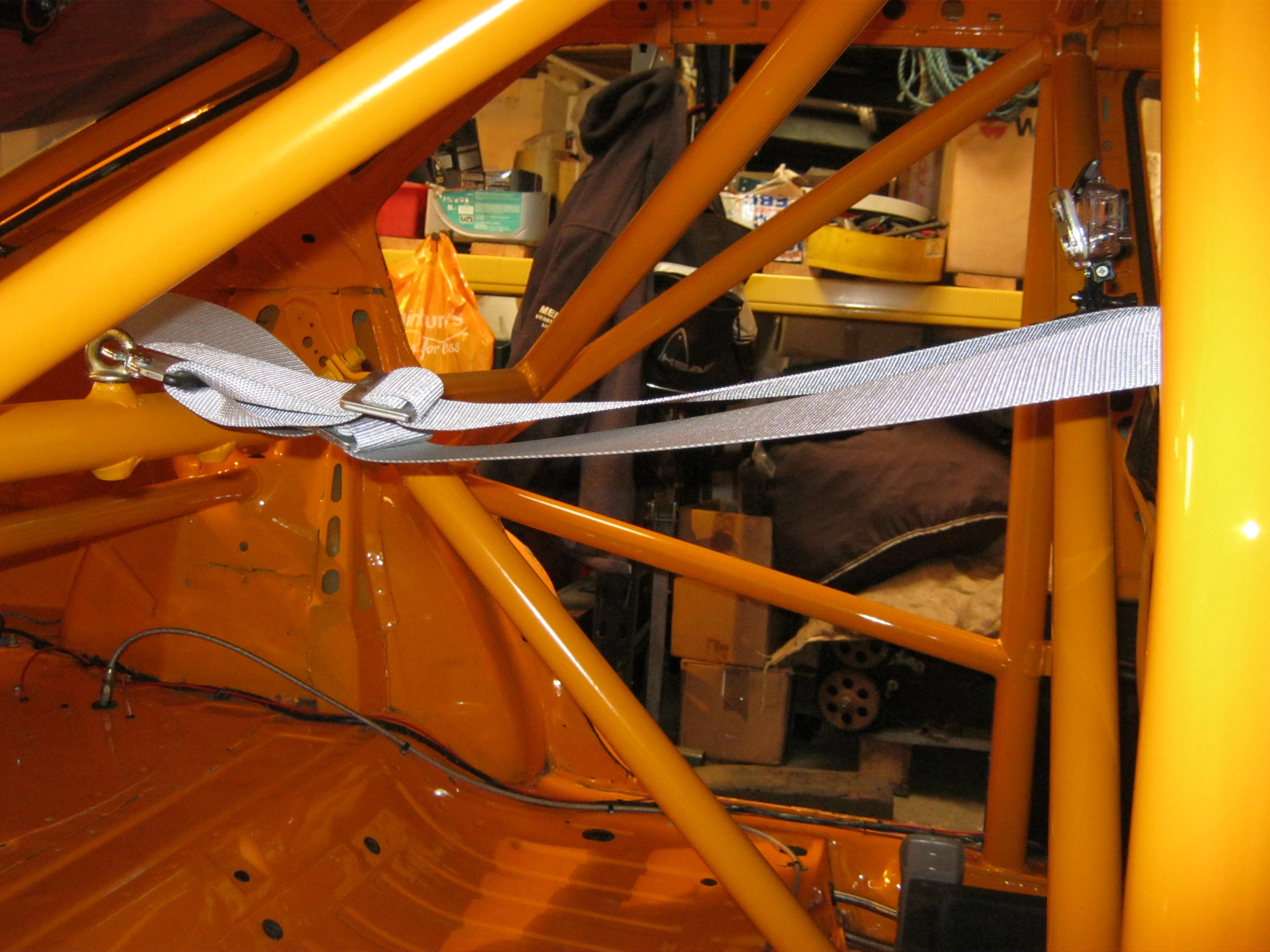

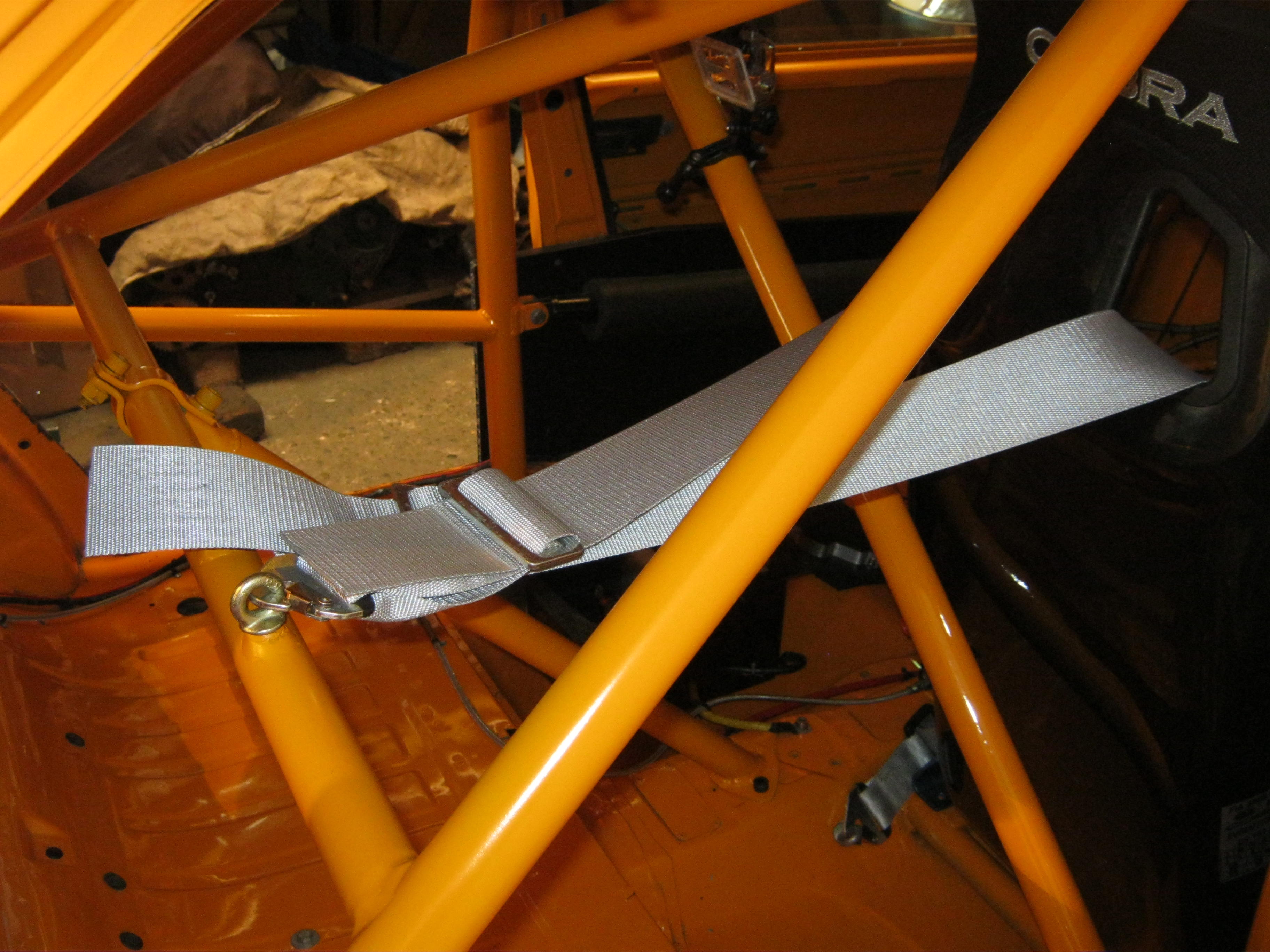

Just to jump back a few posts, to the extra cage bar now required for the harness restraint points, this is the bar i helped Tom add to the BLS 33 race car.
The key requirements, to position it in the best "middle ground" according to both the regs and restraint device specifications, was to have the straps exiting the seat at an angle of 20 degrees downward, and narrowing, at an angle i cant currently remember, but if the position of the bar has to be sited significantly far away from the seat, let the belts cross, therefore retaining the harness design angles.
This is what we came up with, and you'll also see an extra downward brace that Tom wanted to add to provide an extra footing, anchored at the rear of the tunnel.

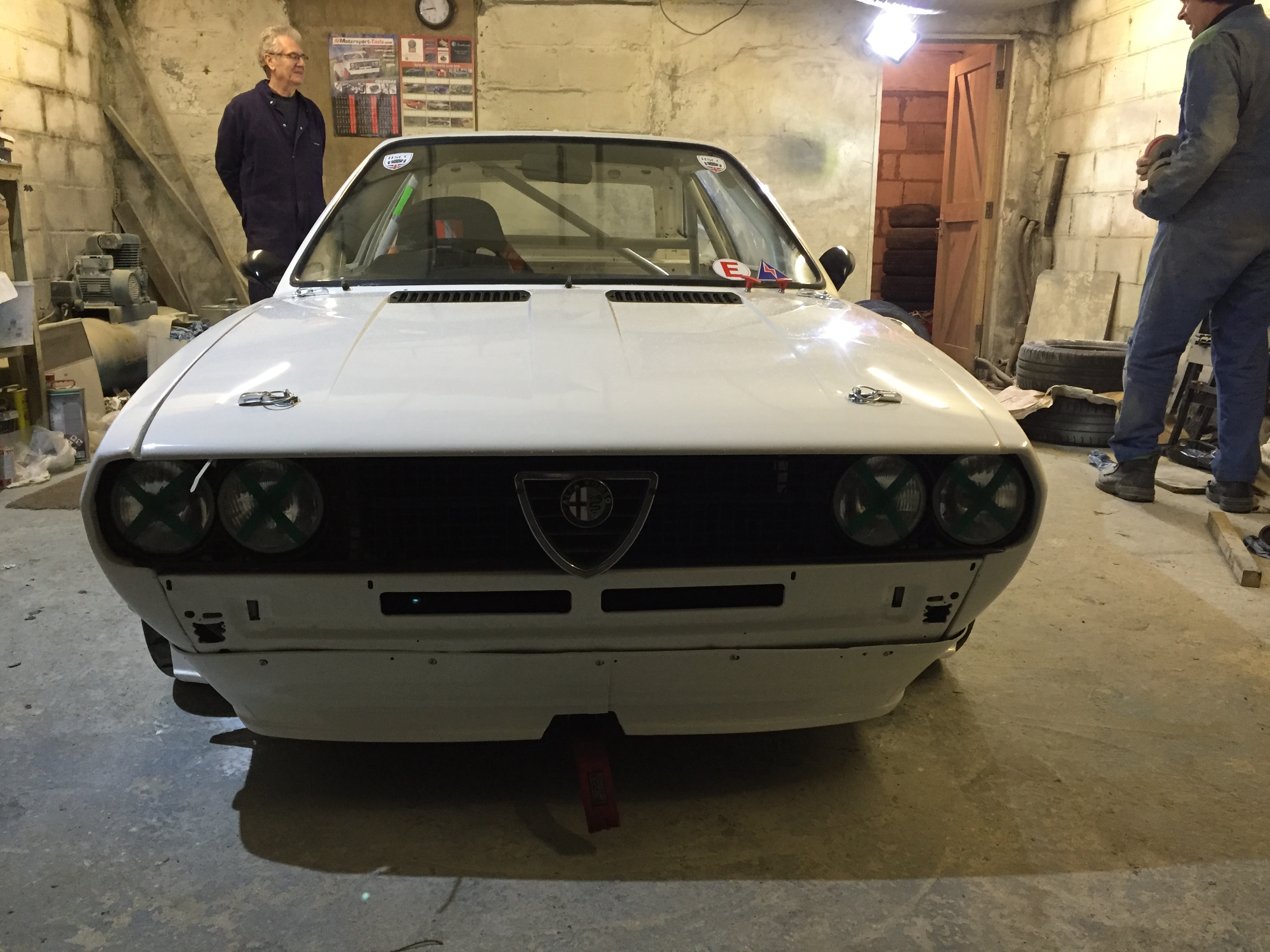

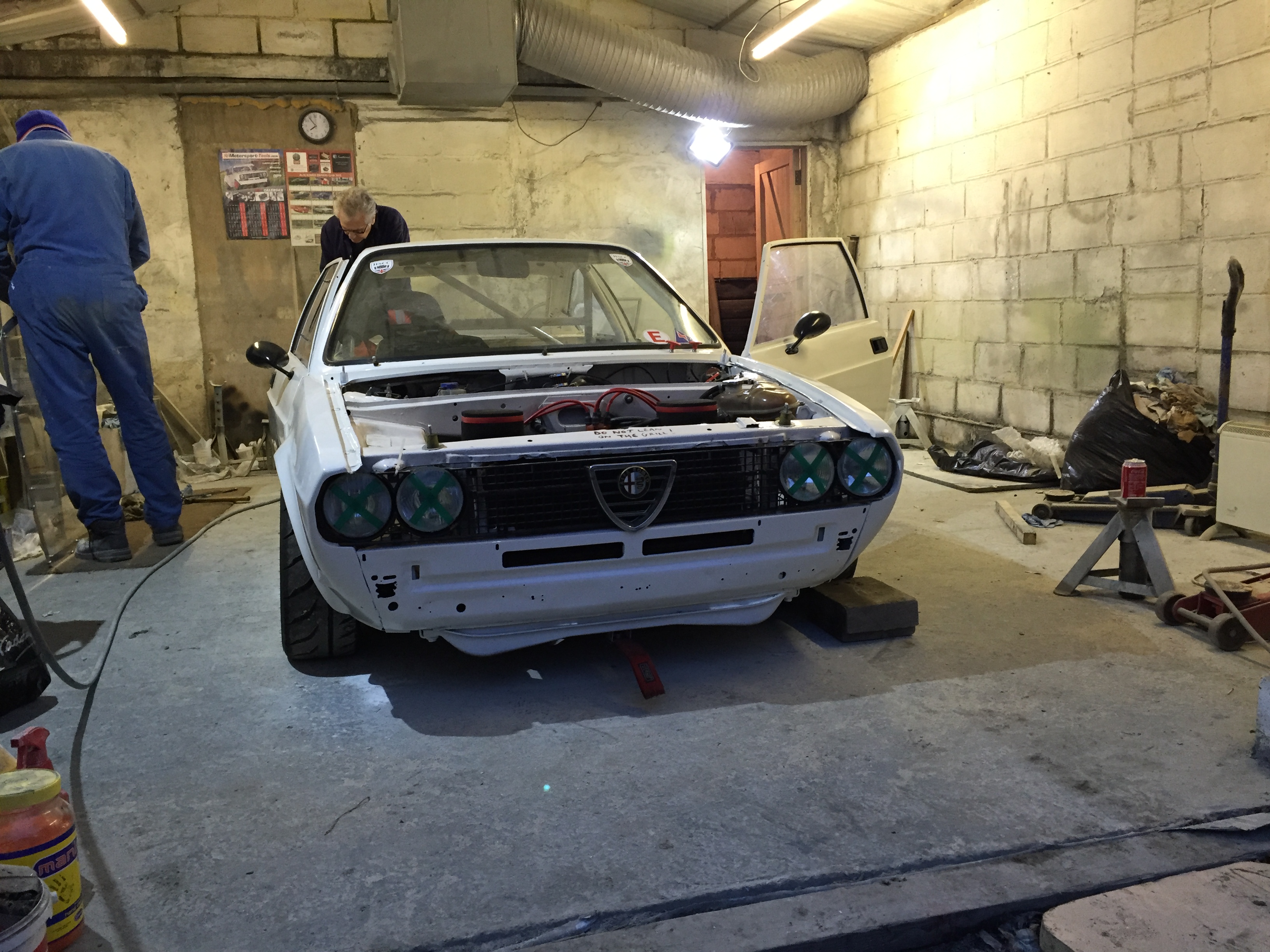

Busy afternoon, we met Kev just after 2pm and aimed to get the a home today.
Forgot how time consuming fitting all the trim and bits is, we got most done , Windows, doors, lights hatch , bonnet etc all back on .
It as dark when we loaded on the trailer and just as we pushed their outside it slashed down with rain on us :shock:
Anyhow, great job by Kev as usual, we didn't set out for concours, just tidy and shiney and the sprint looks significantly better with its new paint so a job well done.
A couple of pics
Getting there...
Ready to go home....
