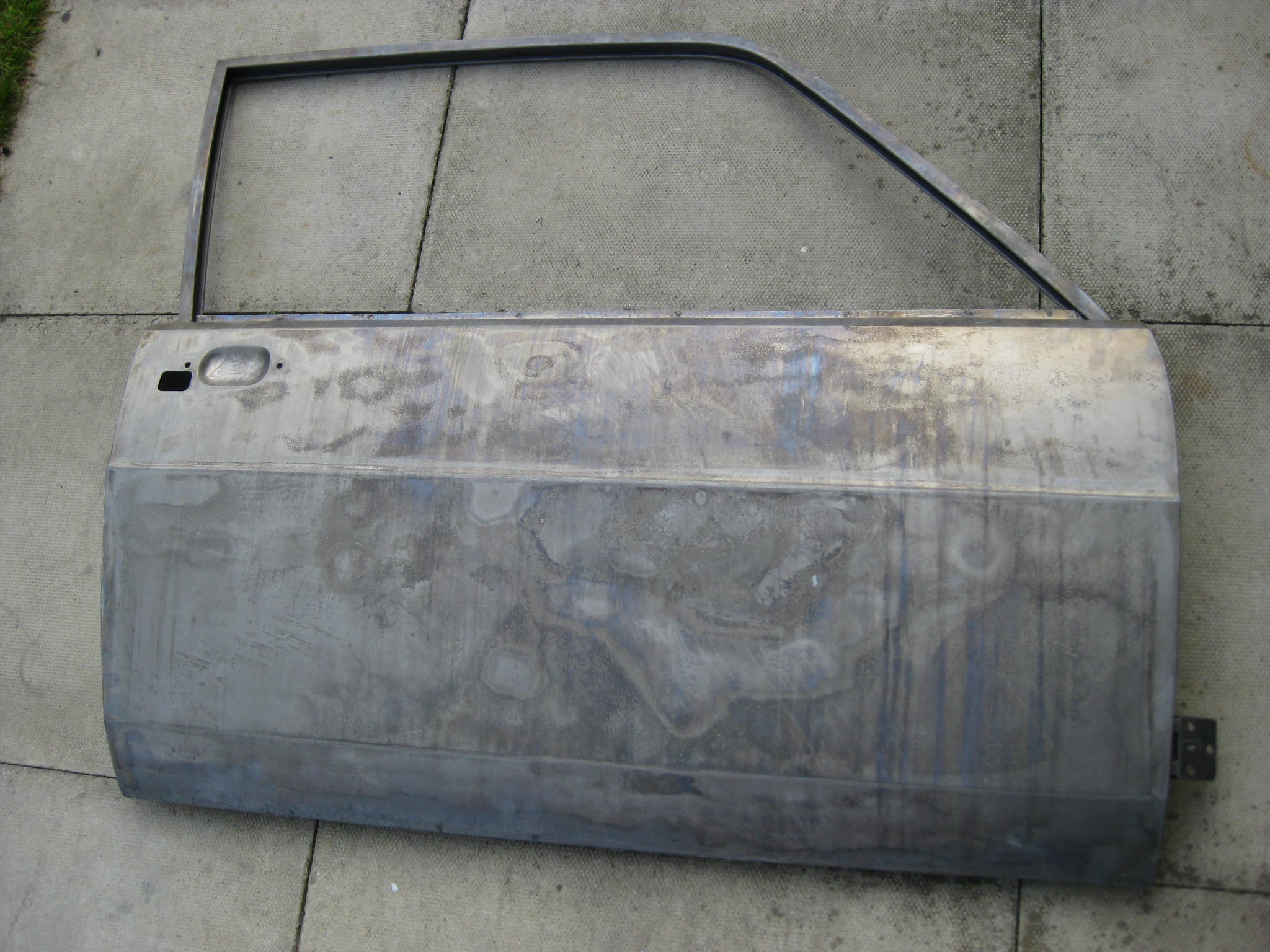

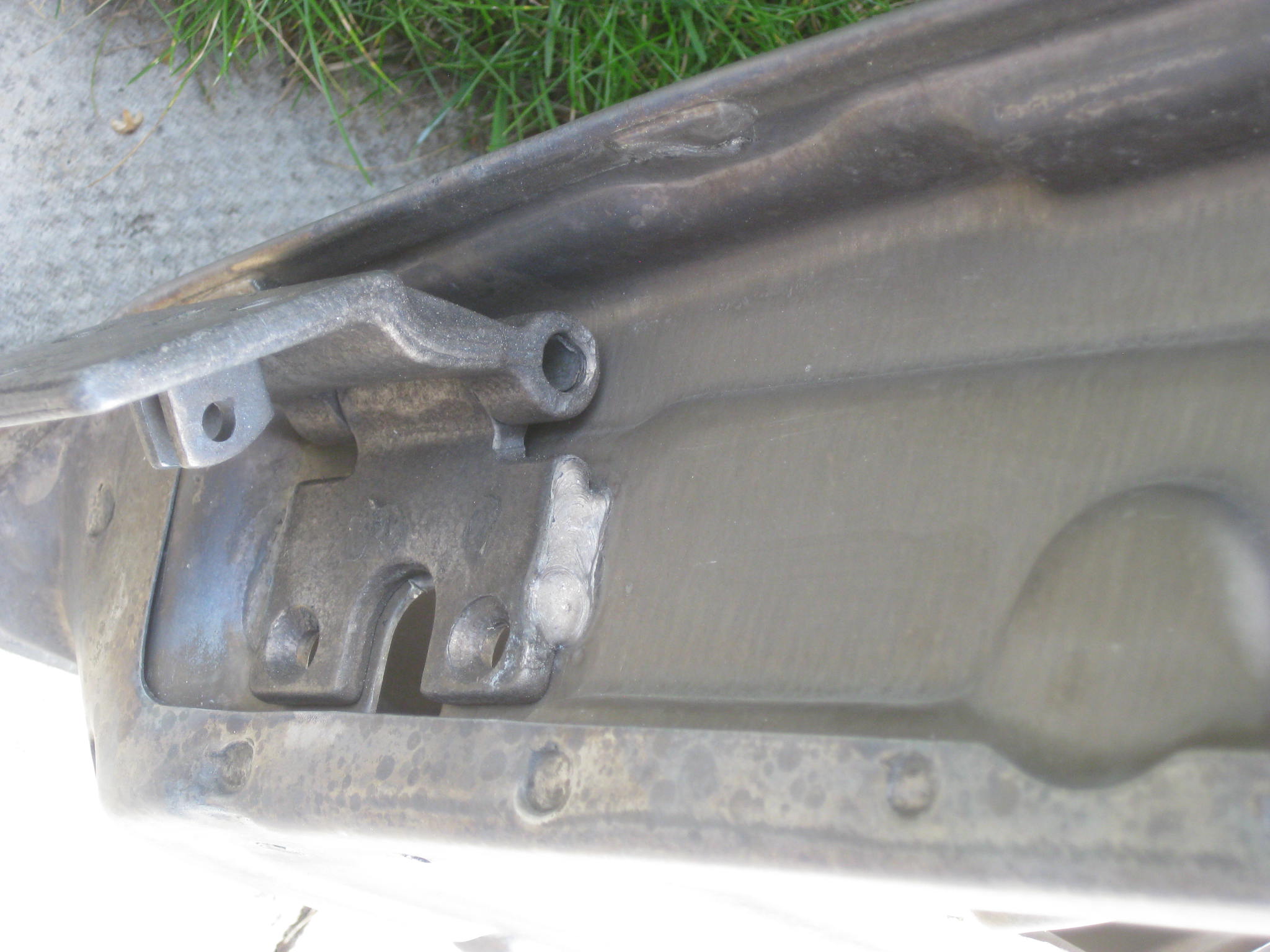

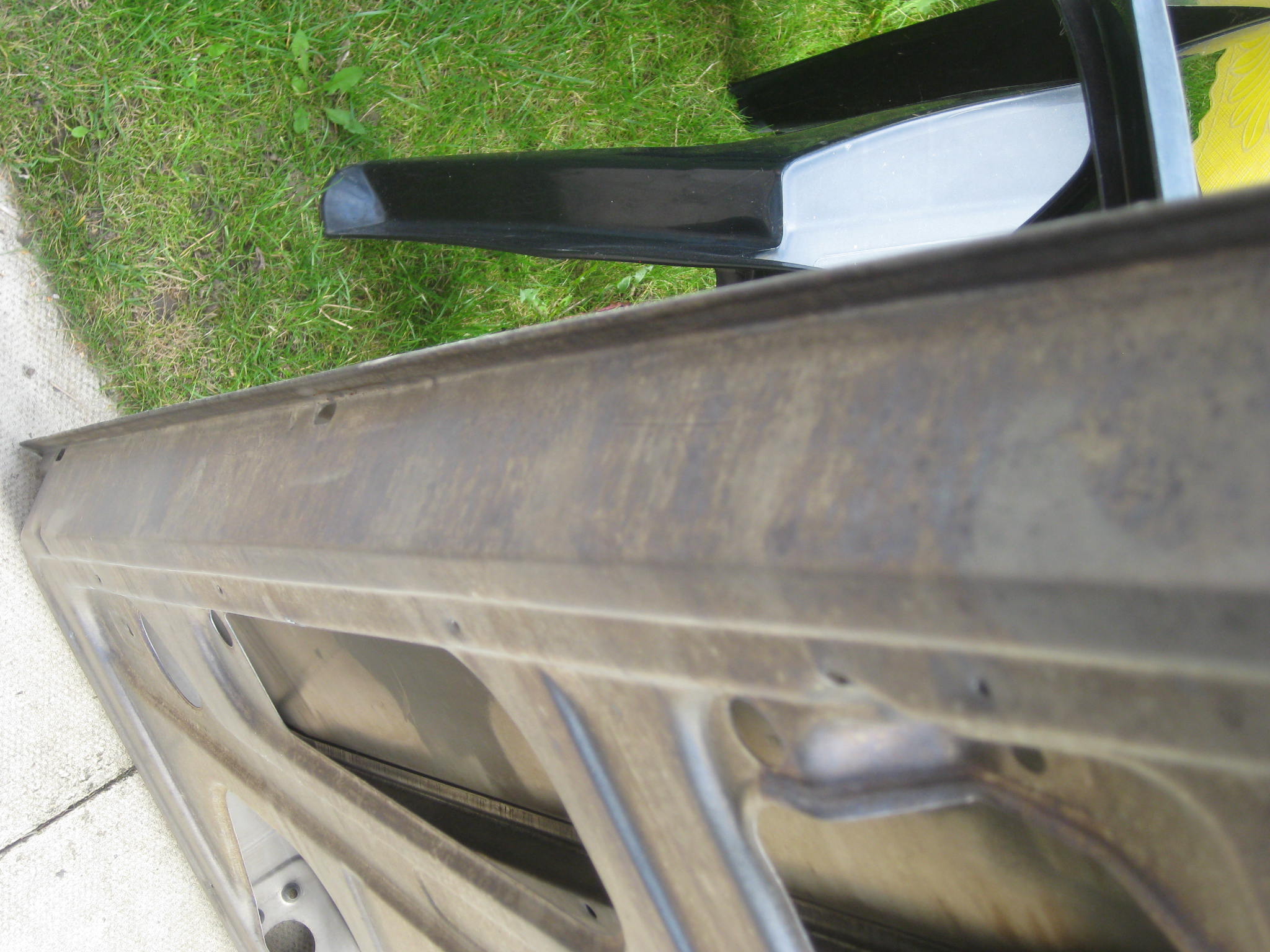

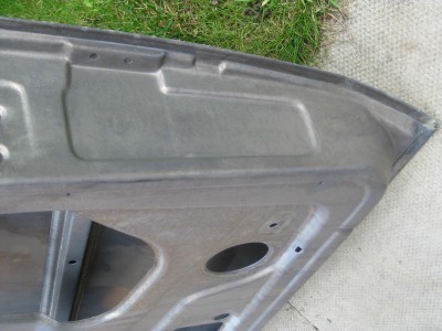

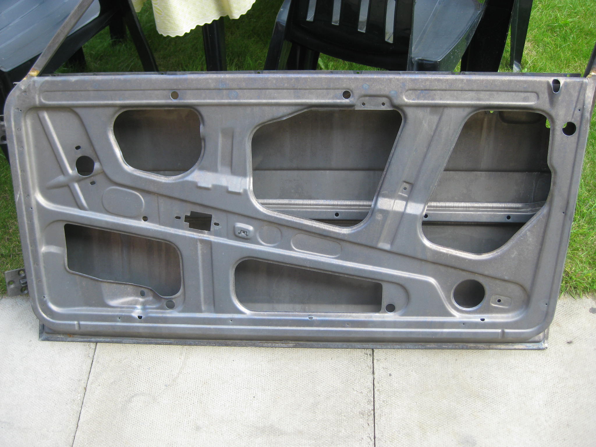

Got the door back from the strippers on Friday, looks great, all corrosion gone completely....
I was told to scotch it and use a 'gun cleaner' - presumably a good quality de-greaser?, the door has a pacifier coat on it currently which I need to get off before etching it, any body paint person on here that can tell me exactly what I need, maybe 3M or bodyline make something....
amazingly rust free door there mate
Very good result, .that looks like new.
Hi it's called panel wipe
I call my brother a similar name to panel wipe......
excellent door Adi,
was that Tim at pro strip done the biz for you?
personally, and because i know what processes Tim uses, i would use something like green scotch, with wash thinners, blow/air dry, then clean off with cloth and panel wipe, lots of it.
blow/air dry, and then etch prime to start the covering processing off.
all on a bright sunny afternoon of course, Doh! missed that opportunity it seems!

Cheers mateJohnboy wrote:Hi it's called panel wipe

Hi Shrew,petrolhead wrote:excellent door Adi,
It was Tims' right hand man with the grey hair that I dealt with although I spoke to Tim on the phone about it, it certainly needs a good clean and all doing on 1 day for sure, finding that 'good' day this week could be issue if done outside (which with space issues at the moment it will probably have to be!), its in the downstairs toilet at the moment

The door looks great, wish mine had been that good.
I agree with Shrew, about the prep process. Thorough de-grease and dry, and a thorough etch inside and out.
Most quality etches have rust inhibiting properties (so they tell us !!) so that helps with the protection.
Well done.
Well done.

Yes hoping to get on it soon, the missus is going to start moaning if every time so goes into the downstairs loo she is met with the sight of a sud door even though I have told her its in fantastic conditionKegsti66 wrote:The door looks great, wish mine had been that good.

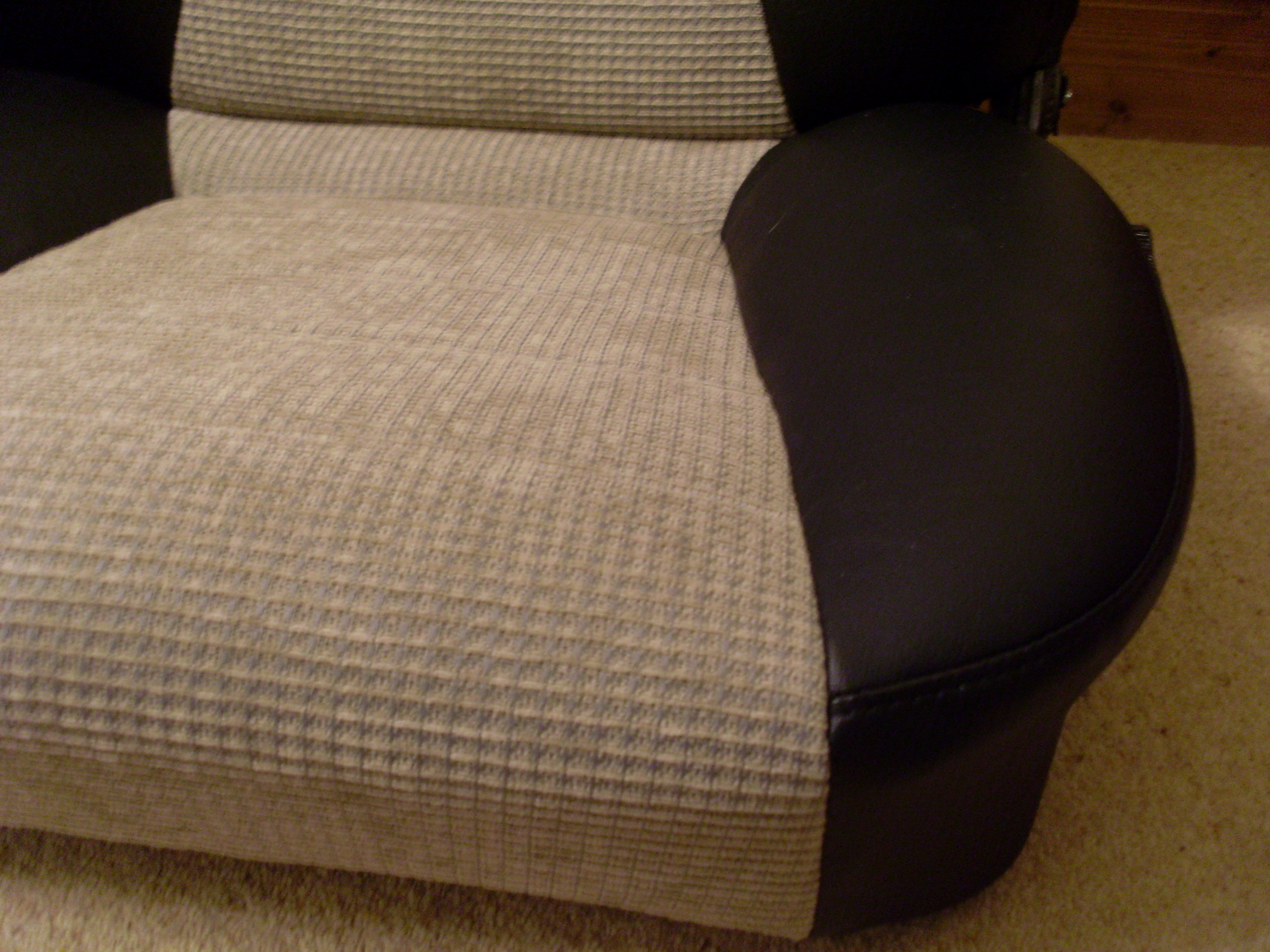

Sorry I didn't reply earlier. I lost what thread it was on.

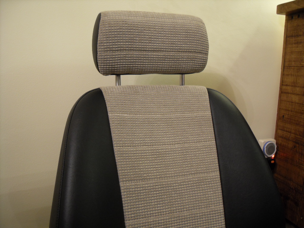

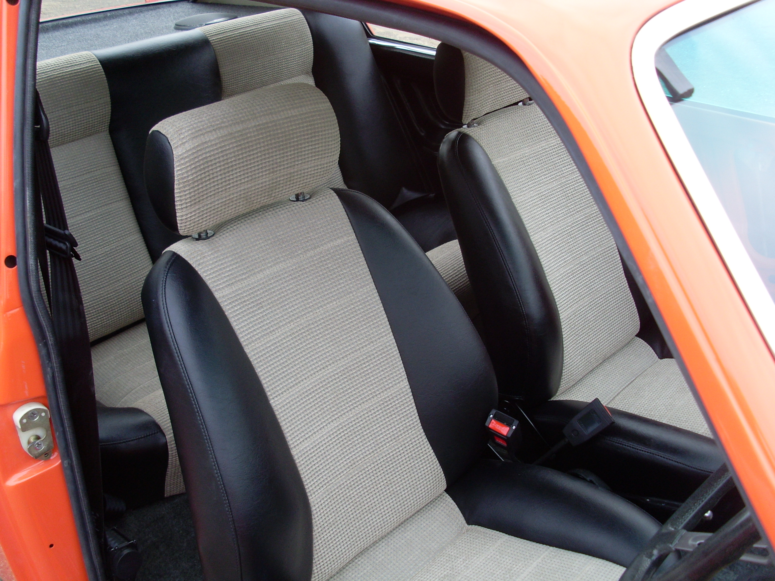

Yes, I had a second, better set of seats re-trimmed. I tried to find a fabric that was as close a match as I could. It isn't perfect, but I am pleased with the overall look.[img][img][img][img][/img][/img][/img][/img]
Beautiful regardless of cloth mate,
You can only do what you can do, if the original cloth or seats arent there, you can only do your best, and that looks a bloody good crack at it mate.
Lovely!

I have seen a couple of suds with 916 seats in them. Apparently you just need to modify the runners but they seem a well proportioned fit.
Glad you like the way mine came out, you'll see them next year at Kev's "Big Sud bash".
vecchioalfa
- Posts: 433
Those seats look tip top mate, that Ti I imported from OZ is a 1977 and the fabric looks almost Indentical to what you have on yours right now, when I get to the stage of needing mine done on my 1976 car I will get some more details off you about so I can try and get mine done as well the same

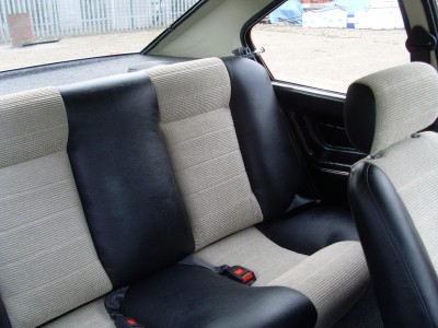

When you see my car you can give them a good look over. I was pleased with what Graham ,the trimmer I know, did. He also fitted my headlining.

..... I also need a new headliningKegsti66 wrote:No problem Adi,

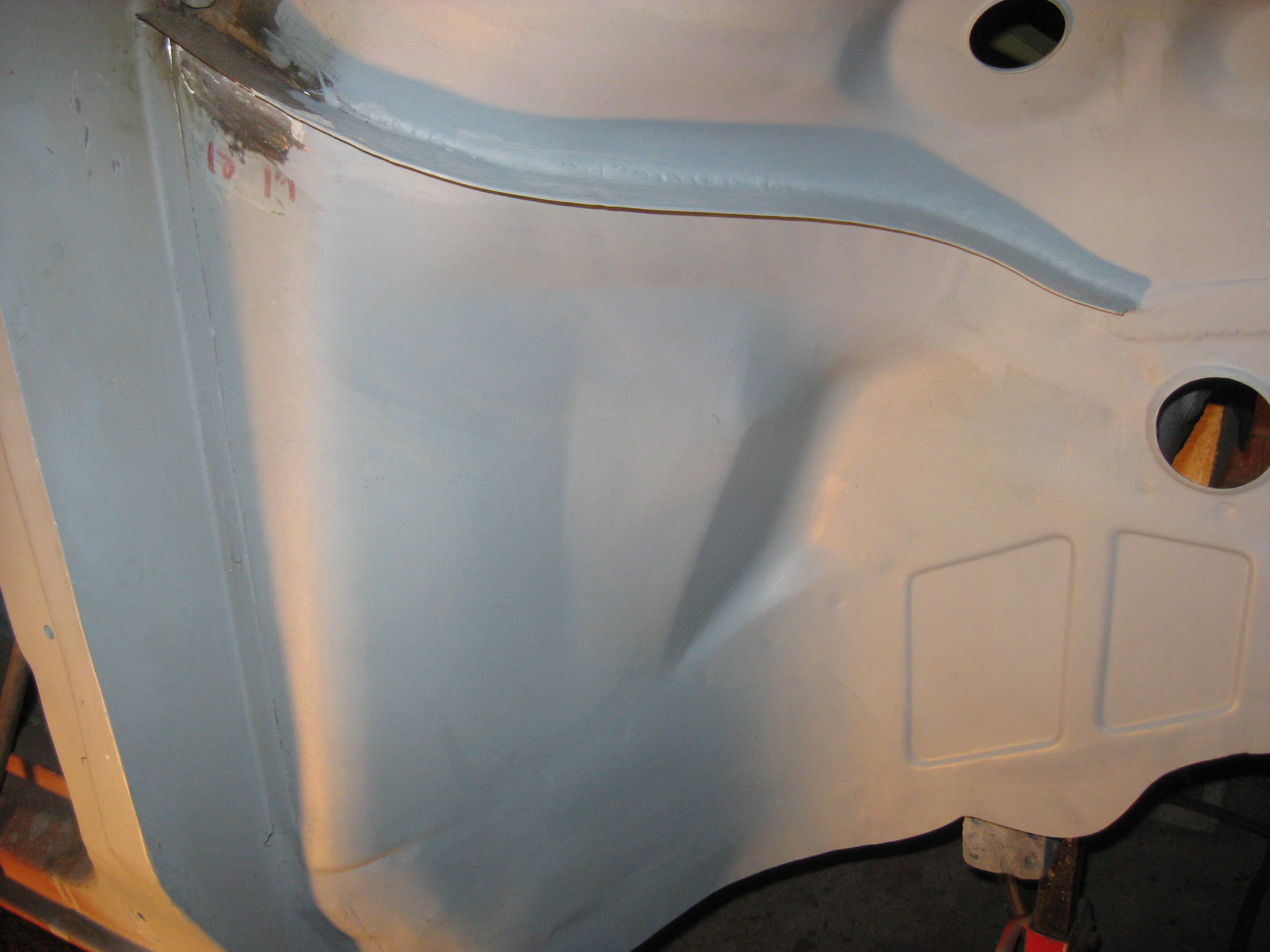

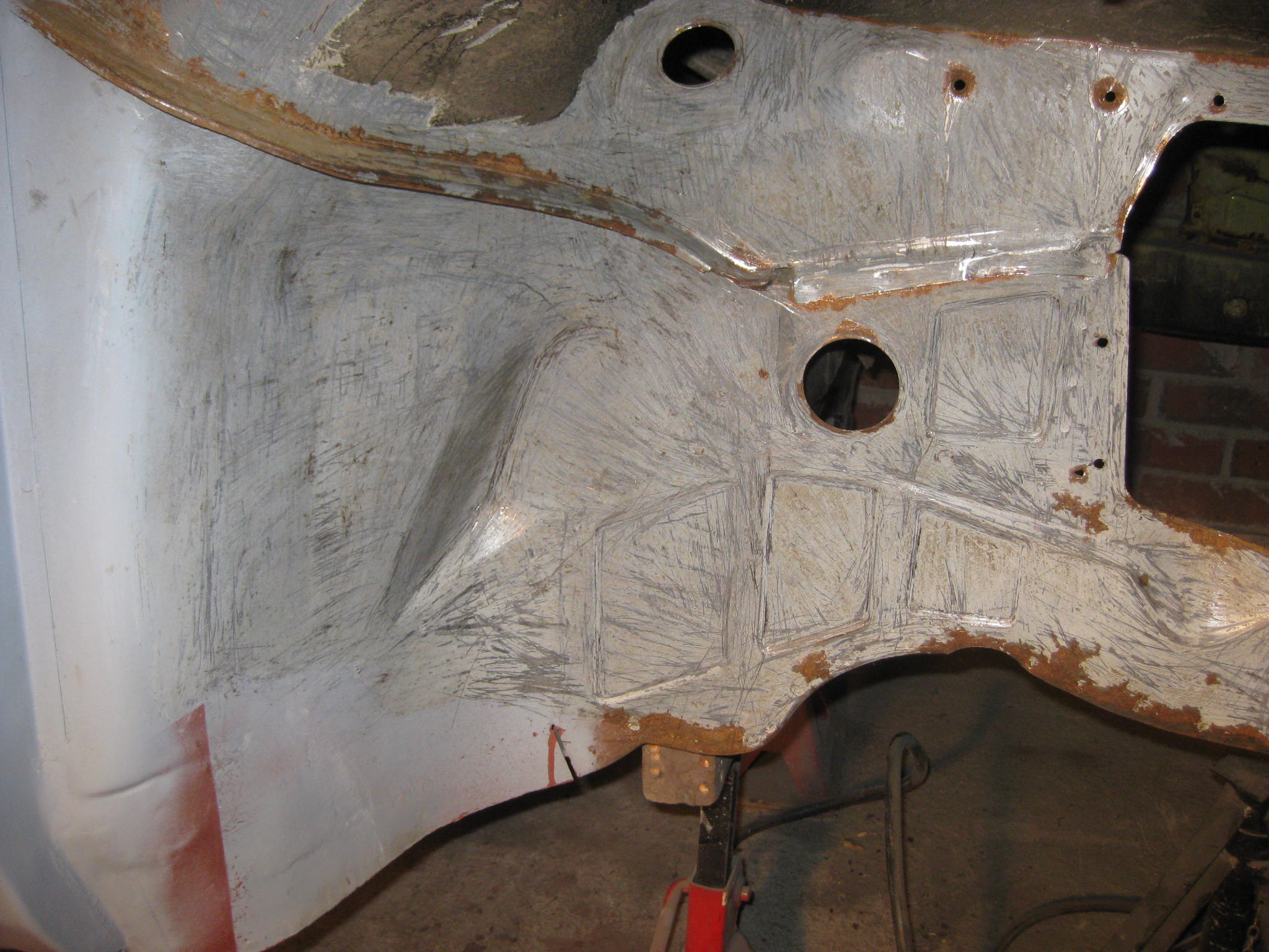

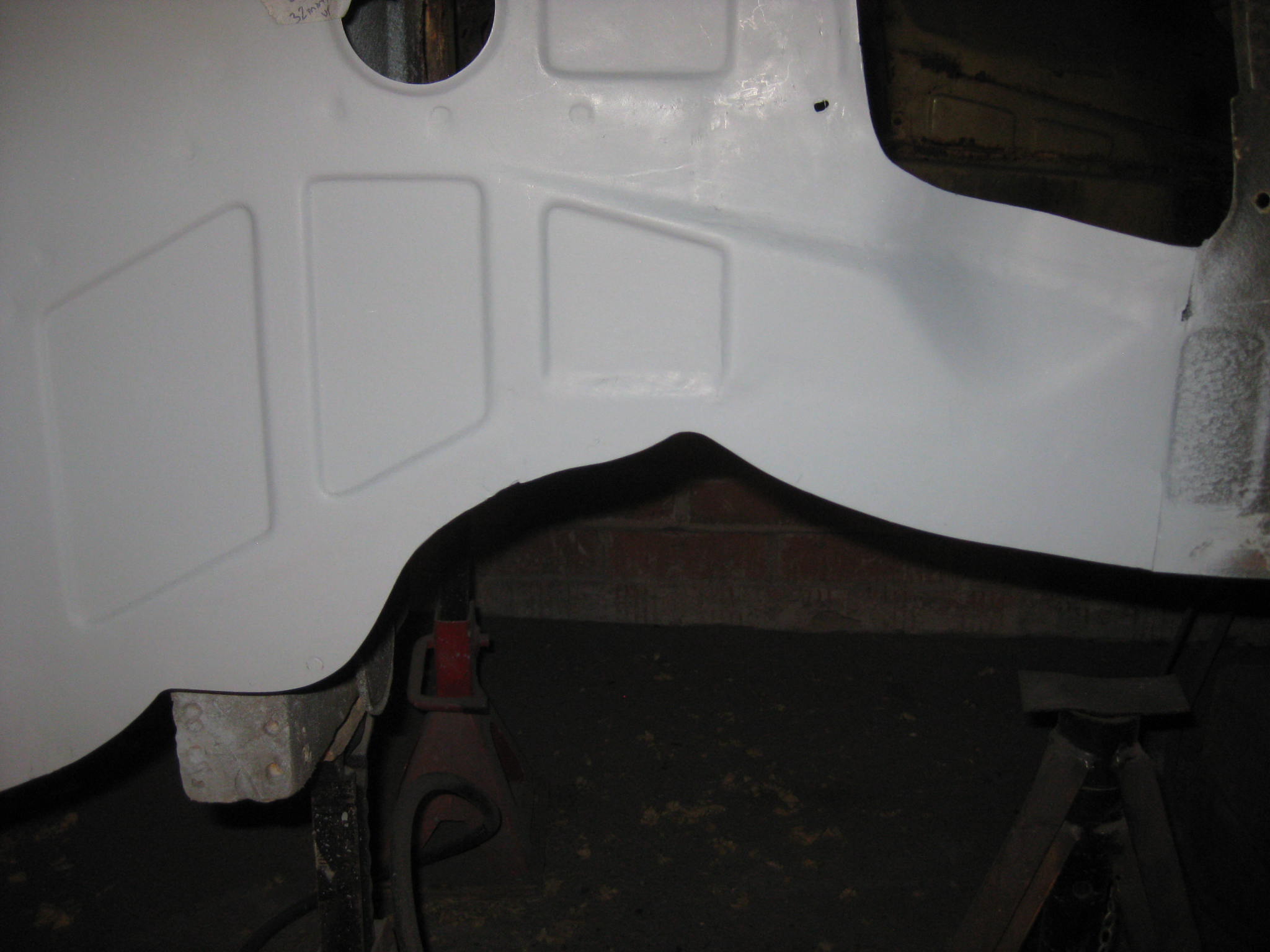

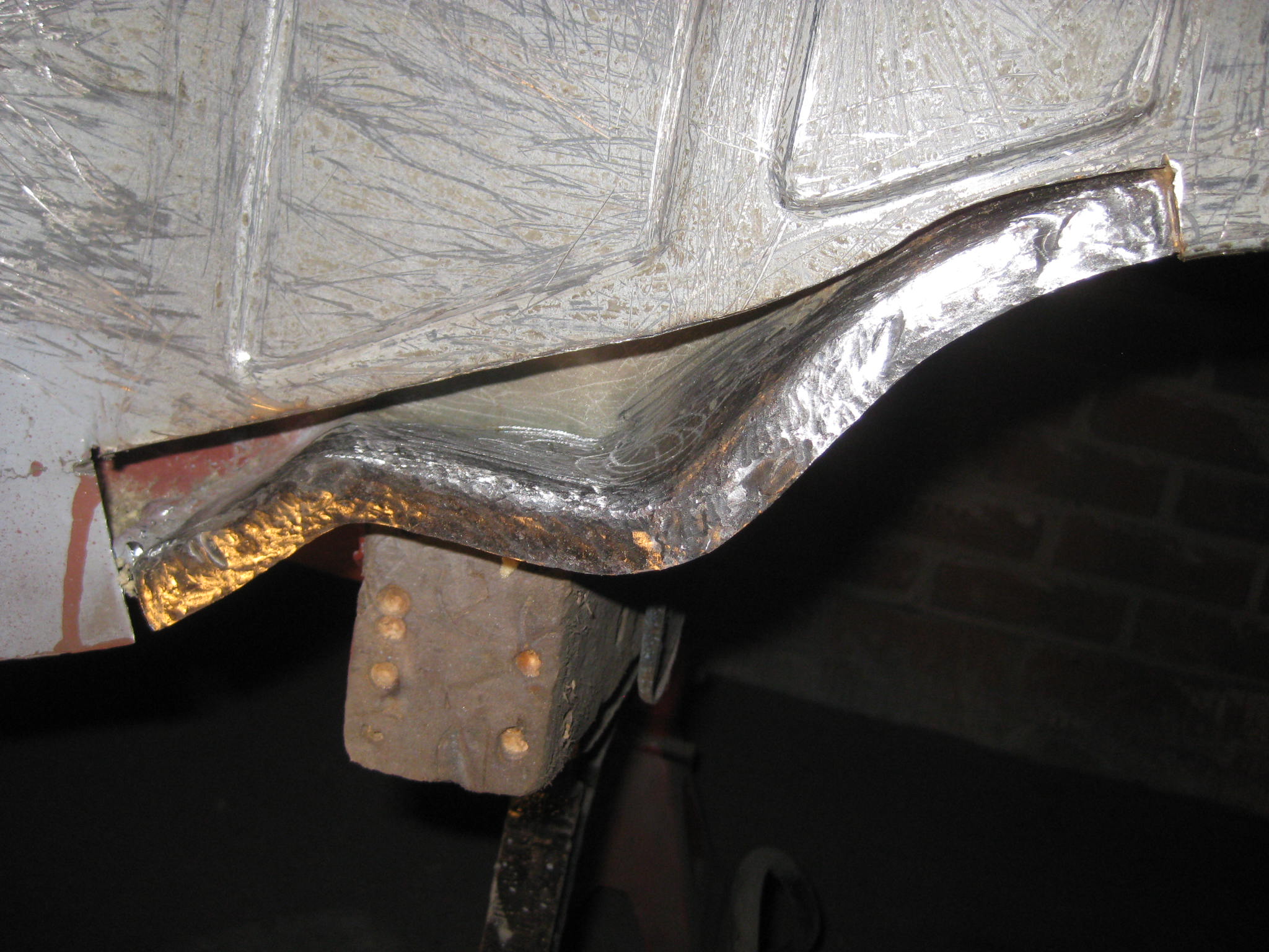

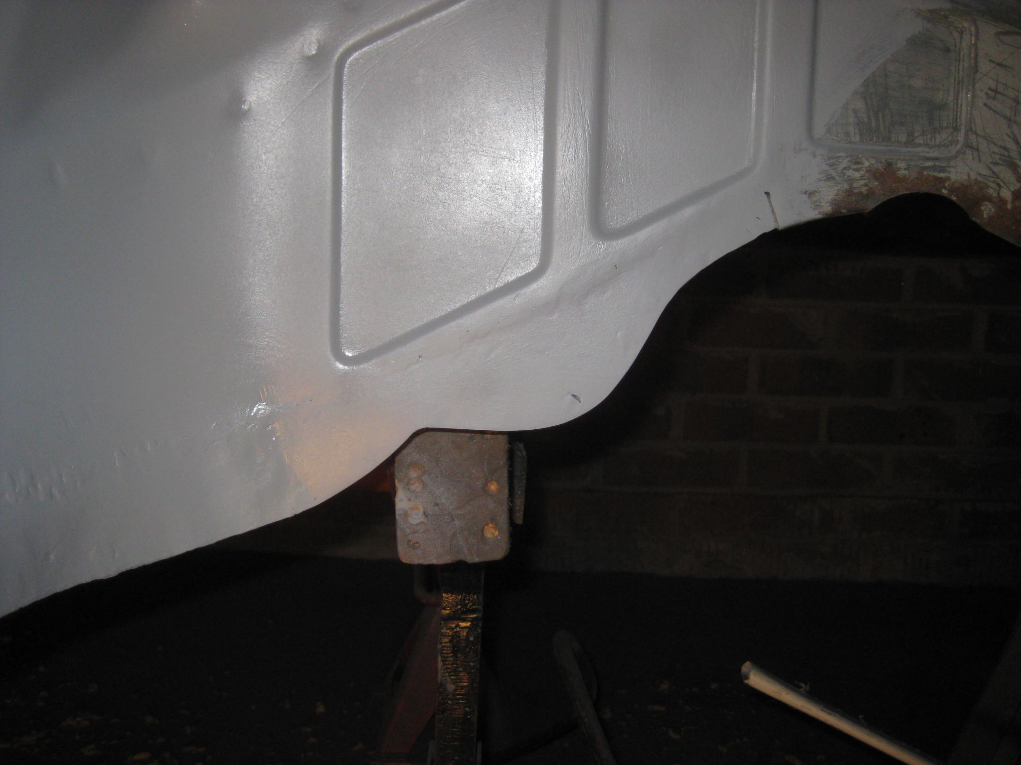

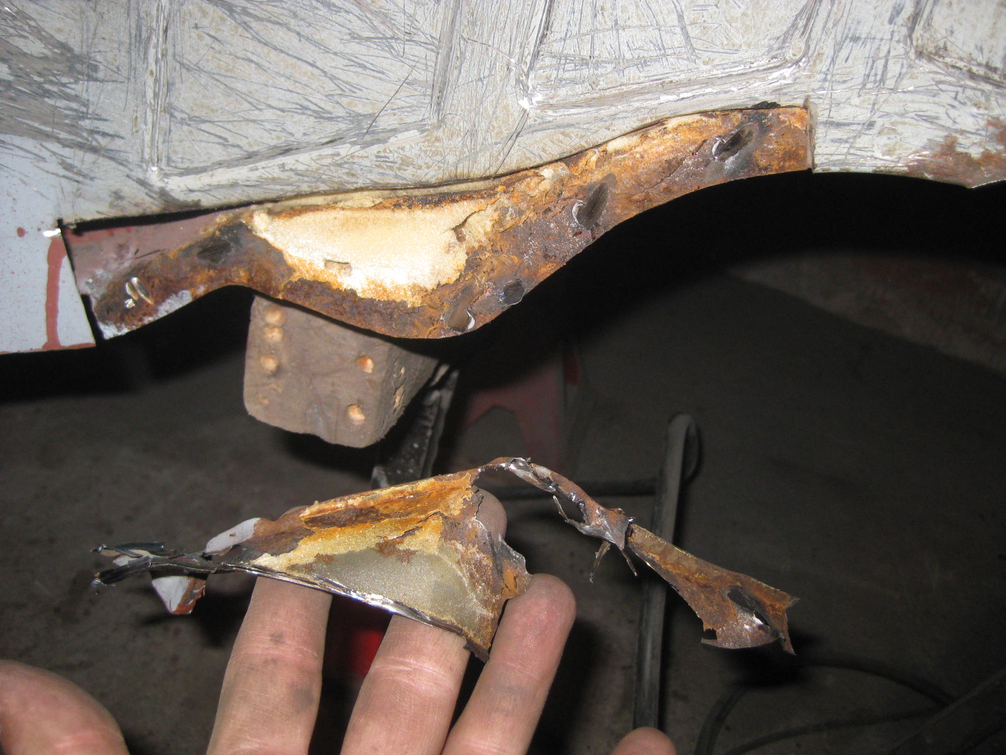

Anyway, back on with the old rust bucket..........
Continuation of the r/h inner wing area

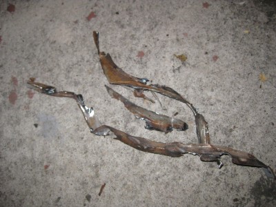

I stripped all that rubberised coating off the reveal some good, some not so good, as usual
No point just cleaning it up on the outside as look what's behind it.....
Luckily the chassis leg itself only had light surface on it which came off with the dremel tool ok
Loads of that foam removed as well....

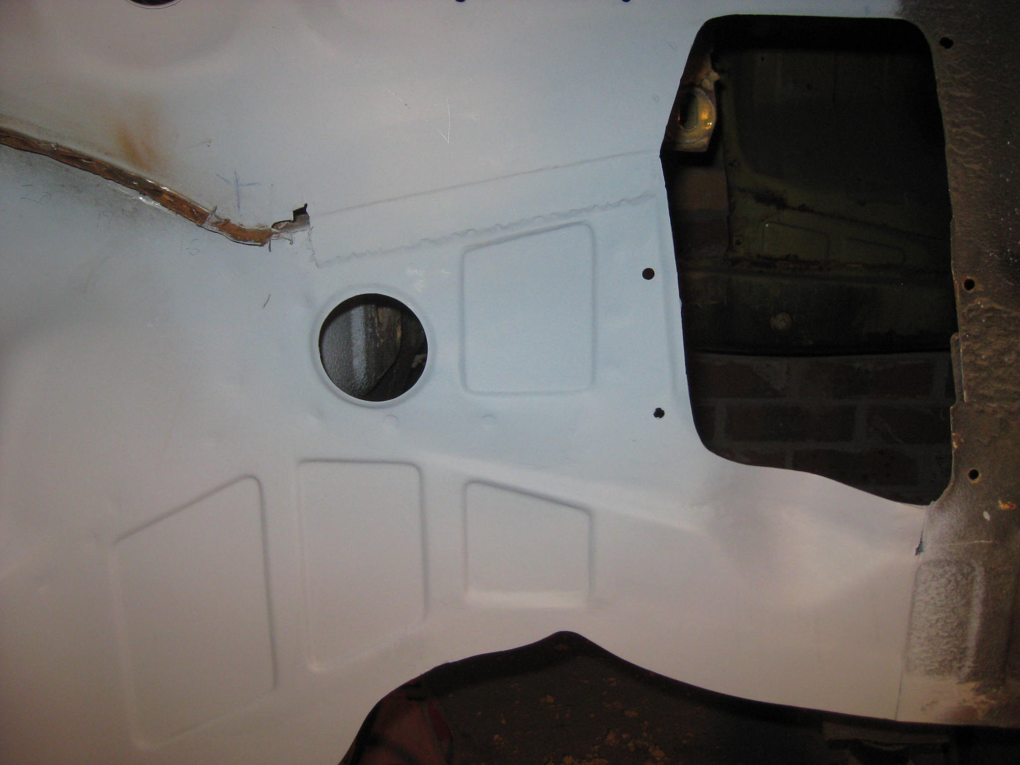

repair panel made up from a cardboard template and welded in place, welds carefully ground back and a bit of etch primer added

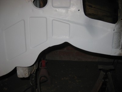

More repairs further along towards the front, cut out and repaired with new metal...
Wherever there is a panel join there is corrosion....

Another bit done....
vecchioalfa
- Posts: 433
.... and then this 3-way seam, all 3 sections needed cutting back and replacing, took ages, more cardboard templates
It is strange how different areas rot worse than others.

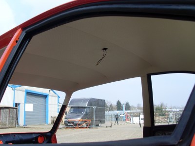

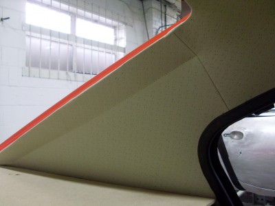

Here is my headlining.
Once again, great repairs. Do you plug weld the joints or have you a spot welder?
that headlining looks amazing, the area near the rear the C pillar top is tricky to get right.
can see me getting mine done properly by the proffesionals

Yes it looks amazing, good match of fabric as well
