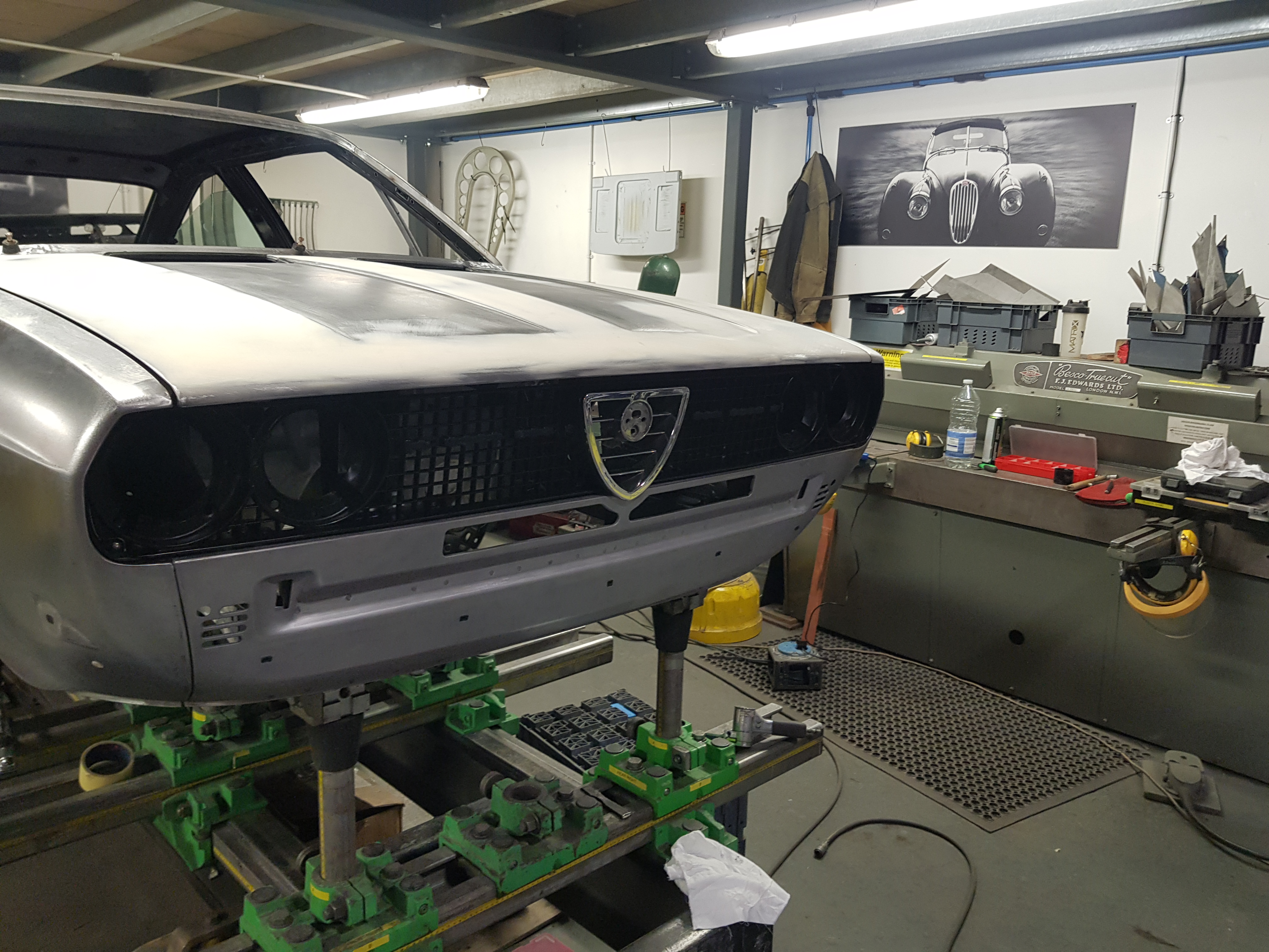

Some significant progress made, it now has a roof. Grille trial fit together with rear lights & badges. All glass & trim in process of being trial fitted. Interior trim to trial fit so that all self tapping screws can be replaced with machine screws into Rivnuts. Independent inspection is being carried out by one of the team who wasn't so closely involved with the main fabrication work. So far the bonnet hinges have been snagged as worn and the nearside rear quarter doesn't have a pressed in "landing" for the tailgate stop like the offside does. It will have..... The tailgate has lost strength, thought to be the dipping process disbonding the skins around the screen aperture. Will be clamped and spot welded. I have included a couple of interior shots, even the inside gets rubbed down & filled. As previous, pics appear right way up when clicked.

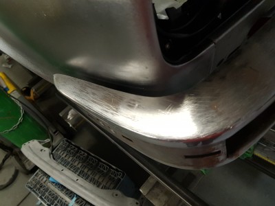

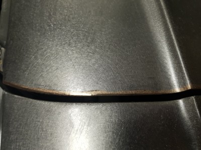

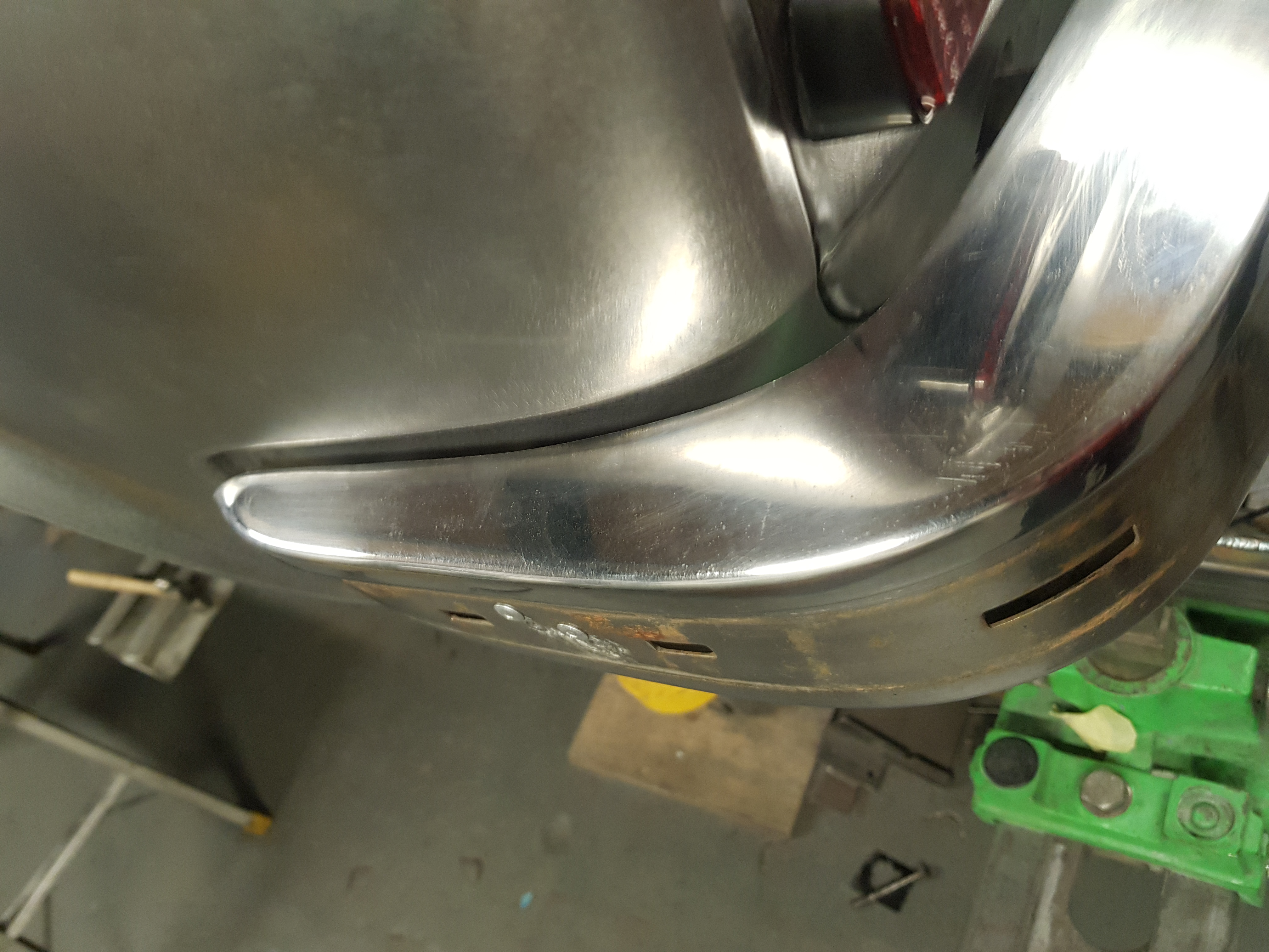

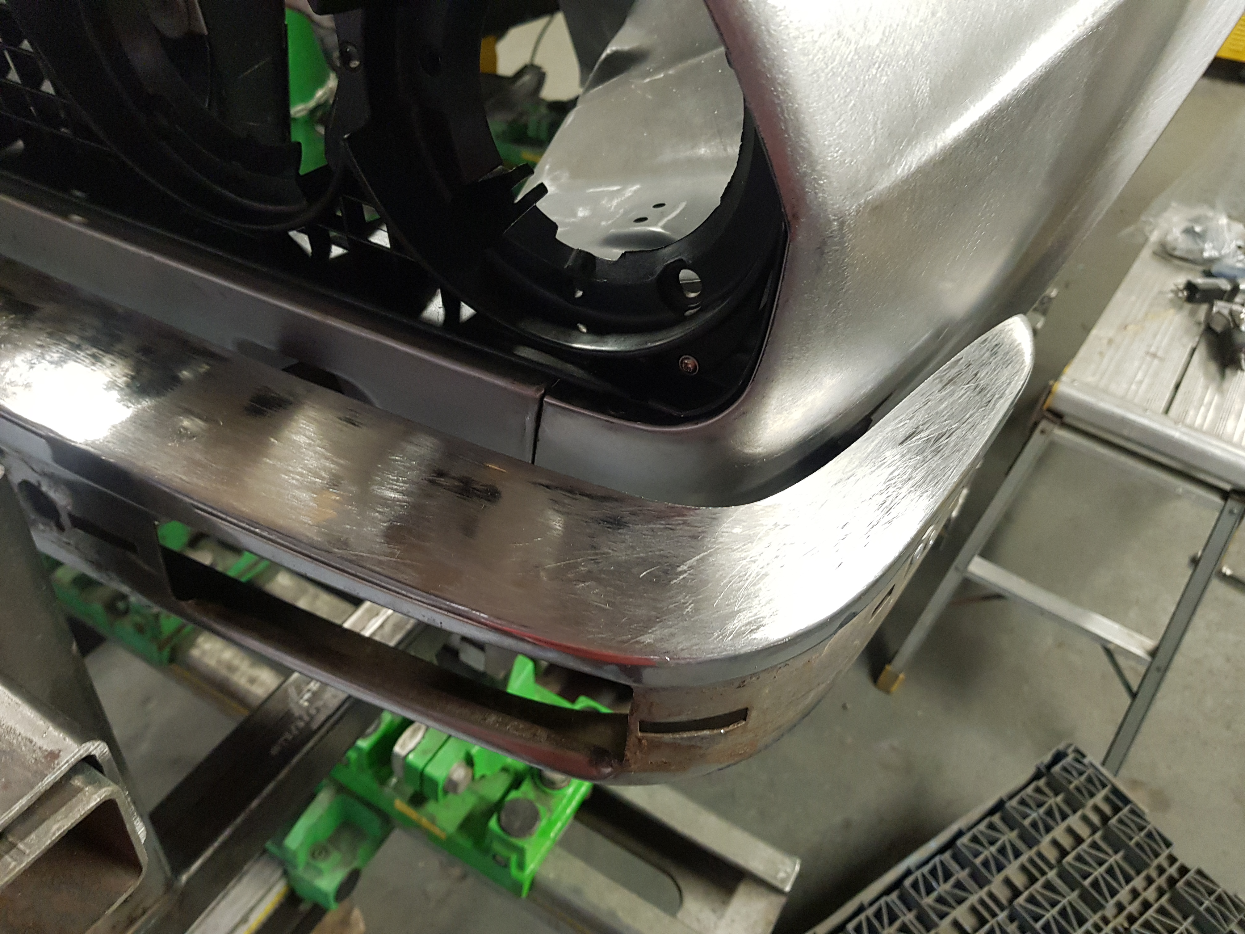

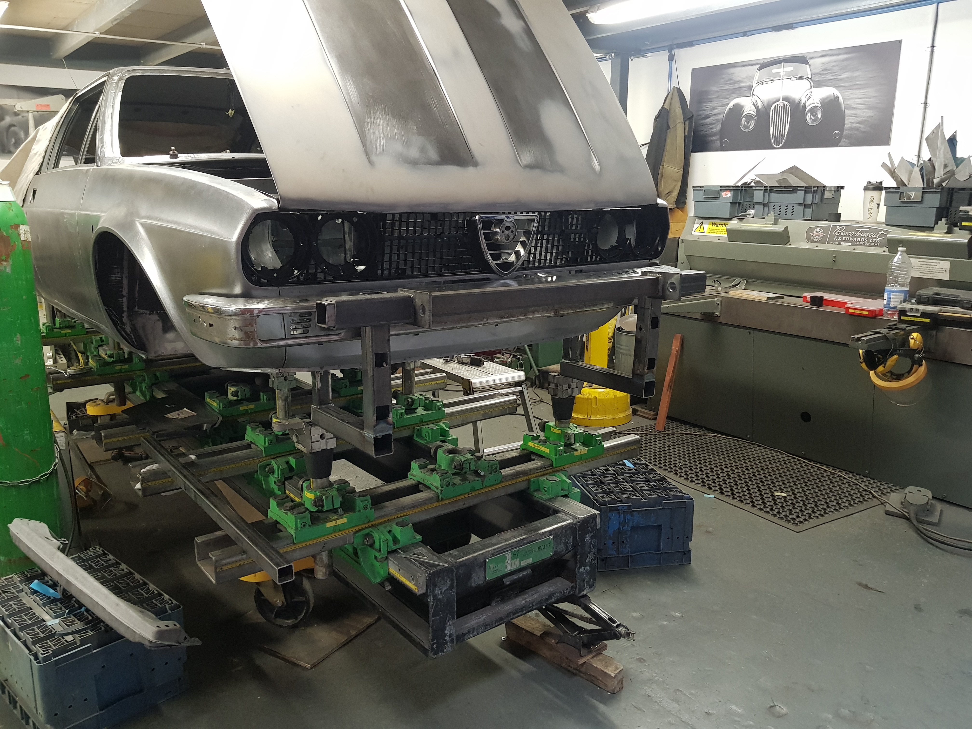

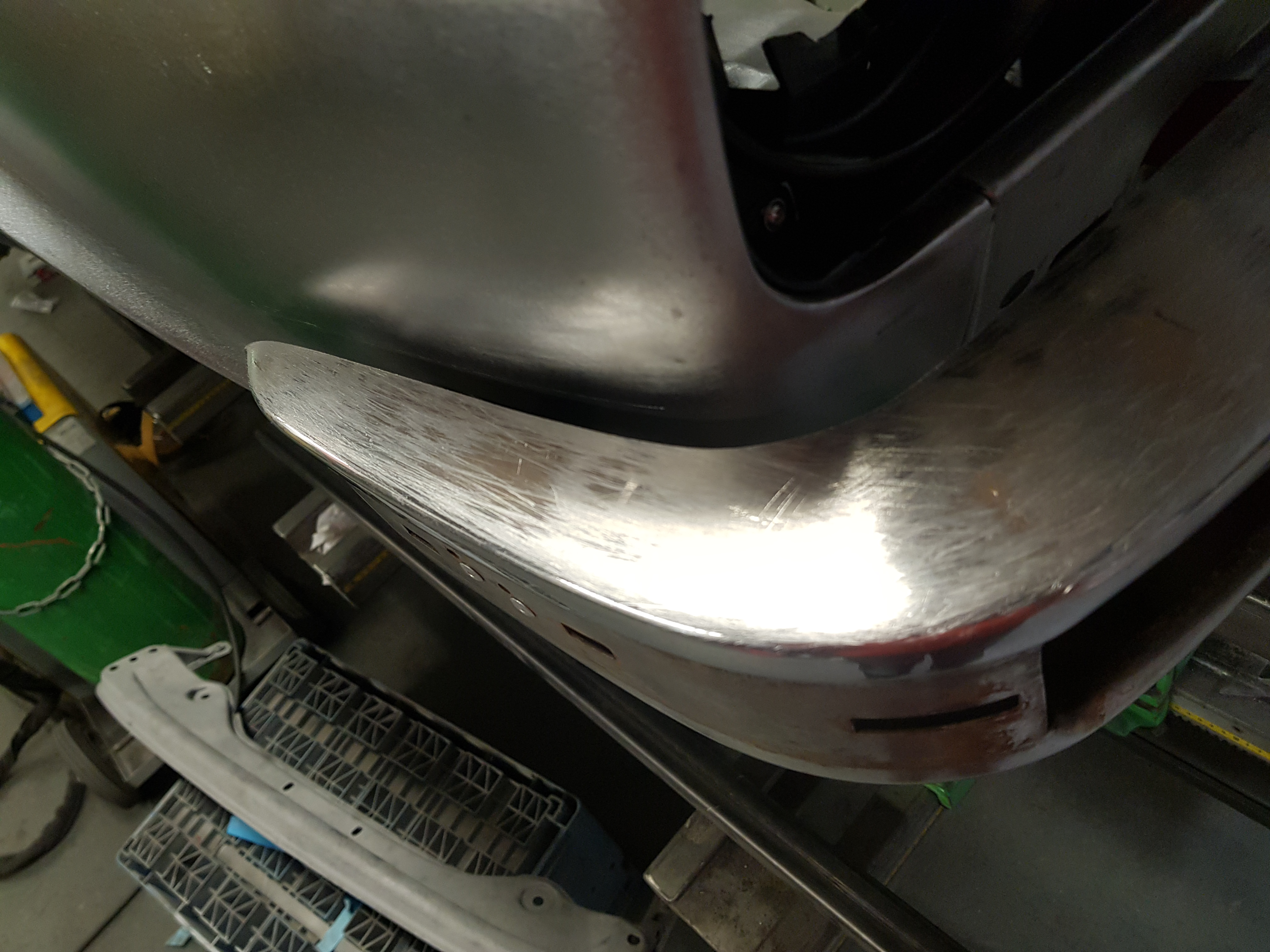

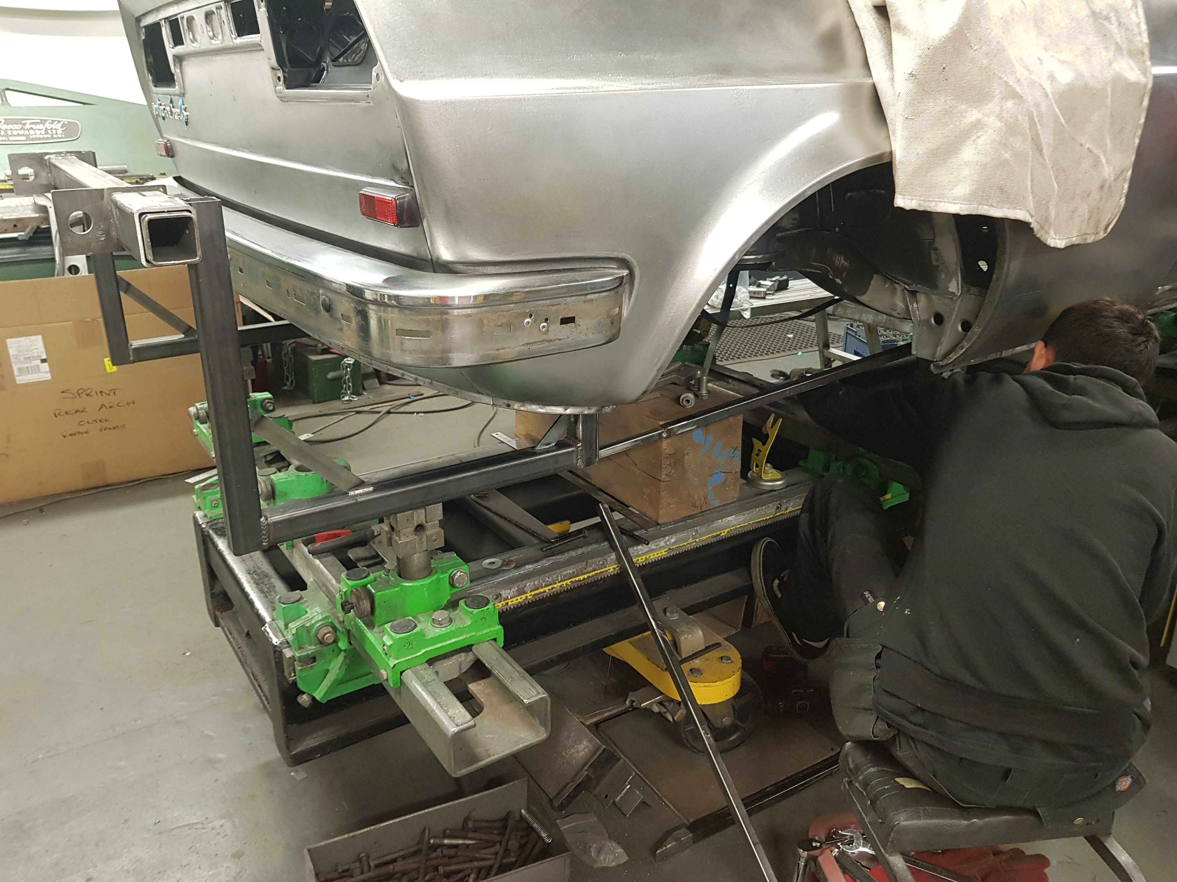

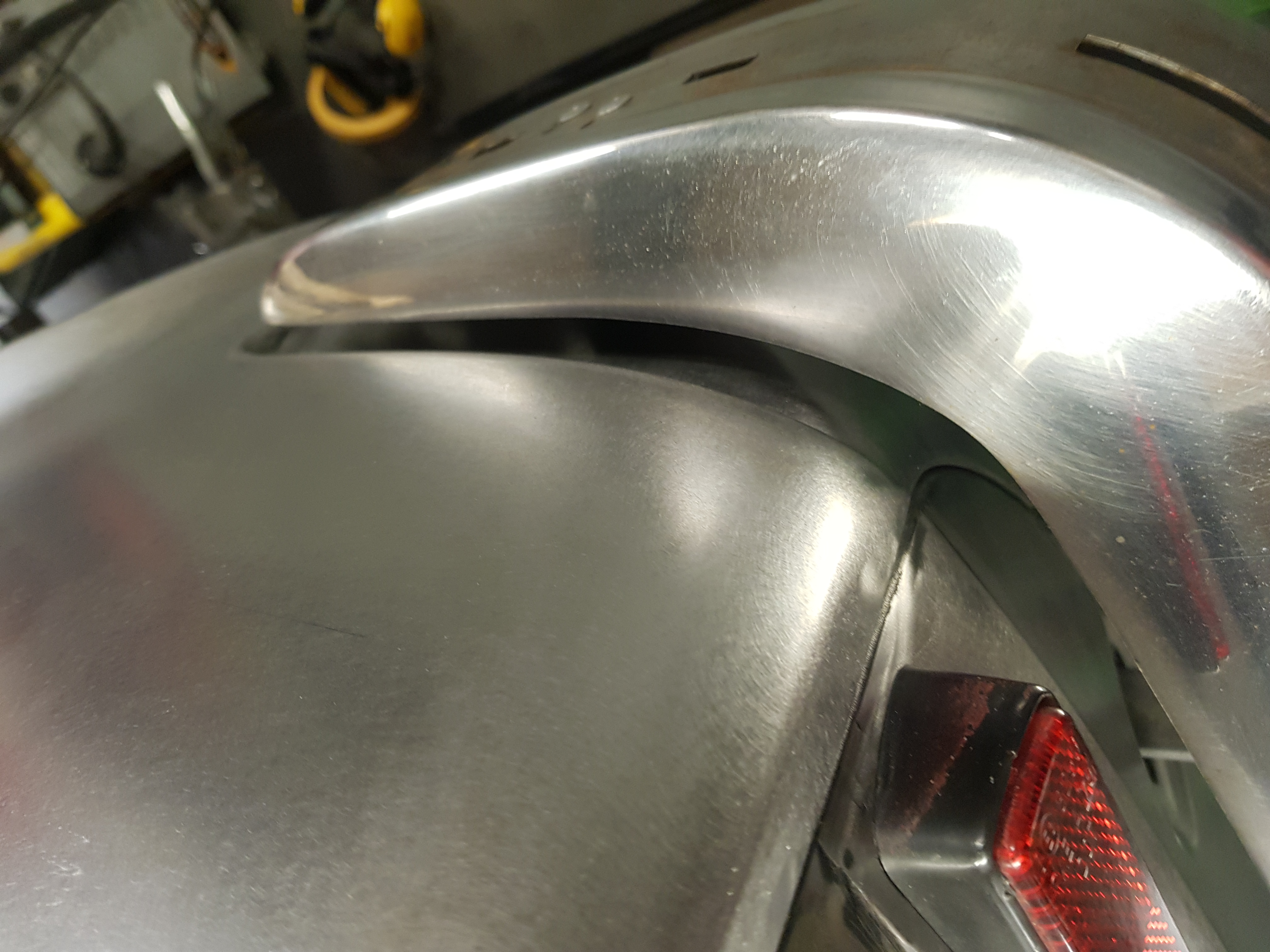

Here's this week's progress report.
The front & rear bumpers have been trial fitted. The dent to the front one has been straightened out & both bumpers have been re-profiled to accurately follow the bodywork contour. They will be re-plated in due course.
Rear bumper Front Here's a rotated

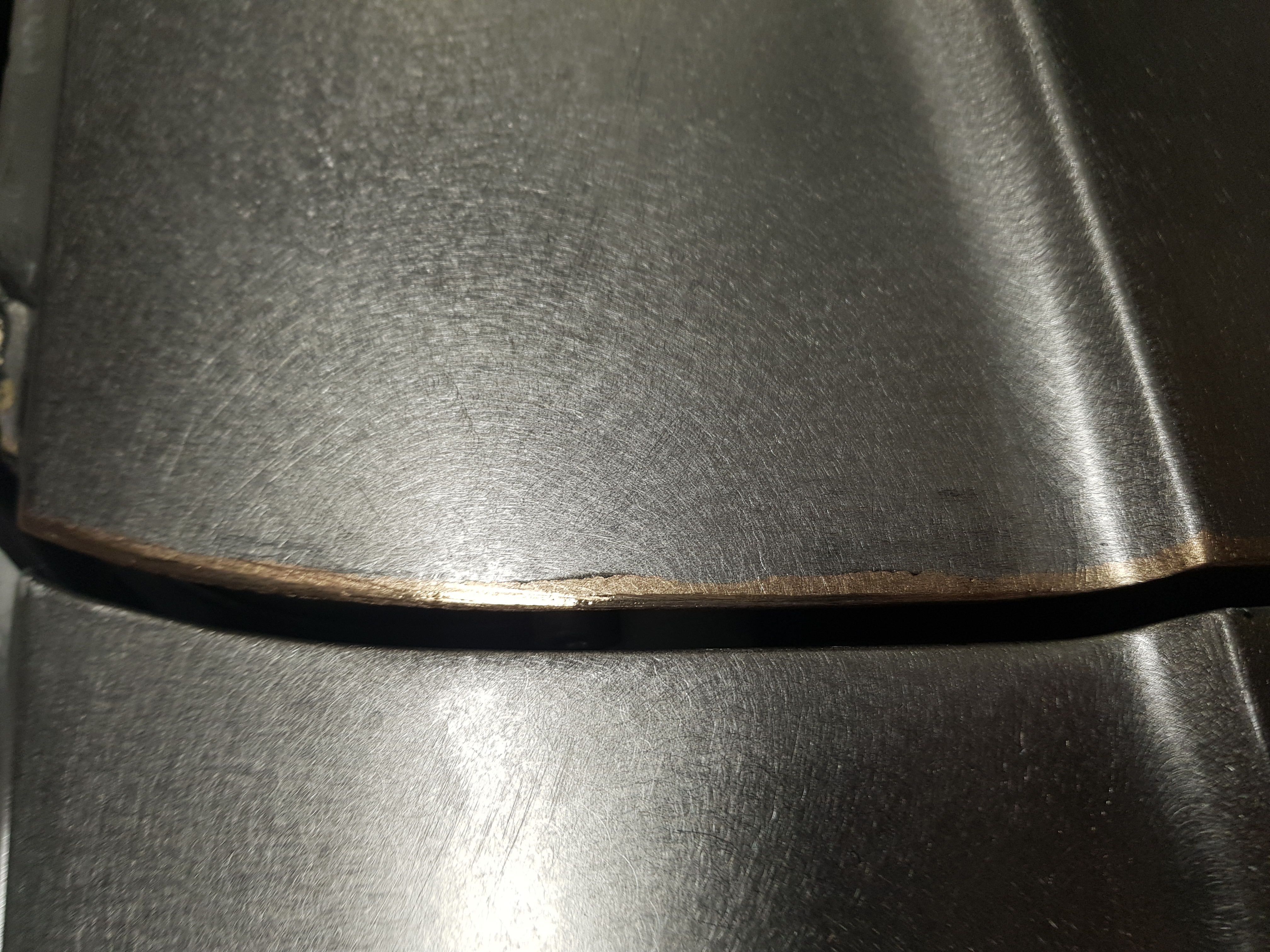

picture of the hinge line of the nearside door; as you can see there is a run of braze (or maybe it's TIG) down the leading edge. As we know, Naples didn’t produce the most accurate pressings in the world so this has been added to enable the shut line to be contoured to give a constant gap with the wing. Same process on the back edge of the door. On the offside, they had to shave some metal off.
And finally...........the team decided to add some bull bars to protect all their hard work.
Re: SPRINT RESURRECTION
AOG , great work, but just in case you were unsure, your bumpers are stainless steel, so just need preparing and polishing.
Alfaoldgit
- Posts: 196
Hi Kegsti,
Thanks for commenting.
I thought they were stainless too, in fact that's what I said to Chris when I dropped them off for fit check. He said, "ReallY? I don't think so..." he held up a magnet to them & it got all friendly. However, I'm aware that stainless steels in the 400 series can be magnetic
..............I think a whole new topic could be started on the magnetic (or not) properties of stainless steel, Kitchen sinks seem to be the non magnetic variety.
Either way, the bumpers have some significant scratching on them & seem to be quite soft. So they will get sent off to a specialist metal finishers for whatever process they deem appropriate.

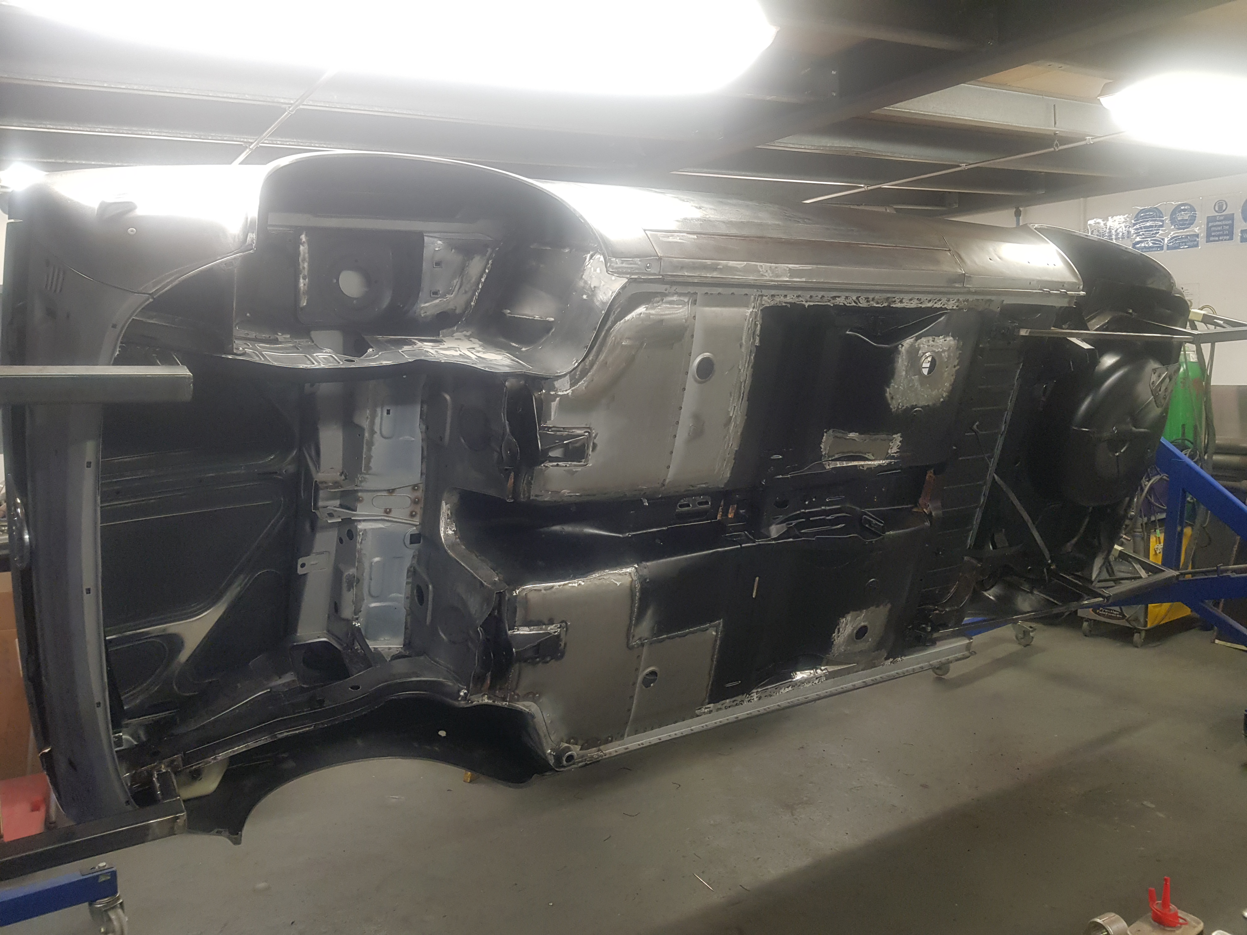

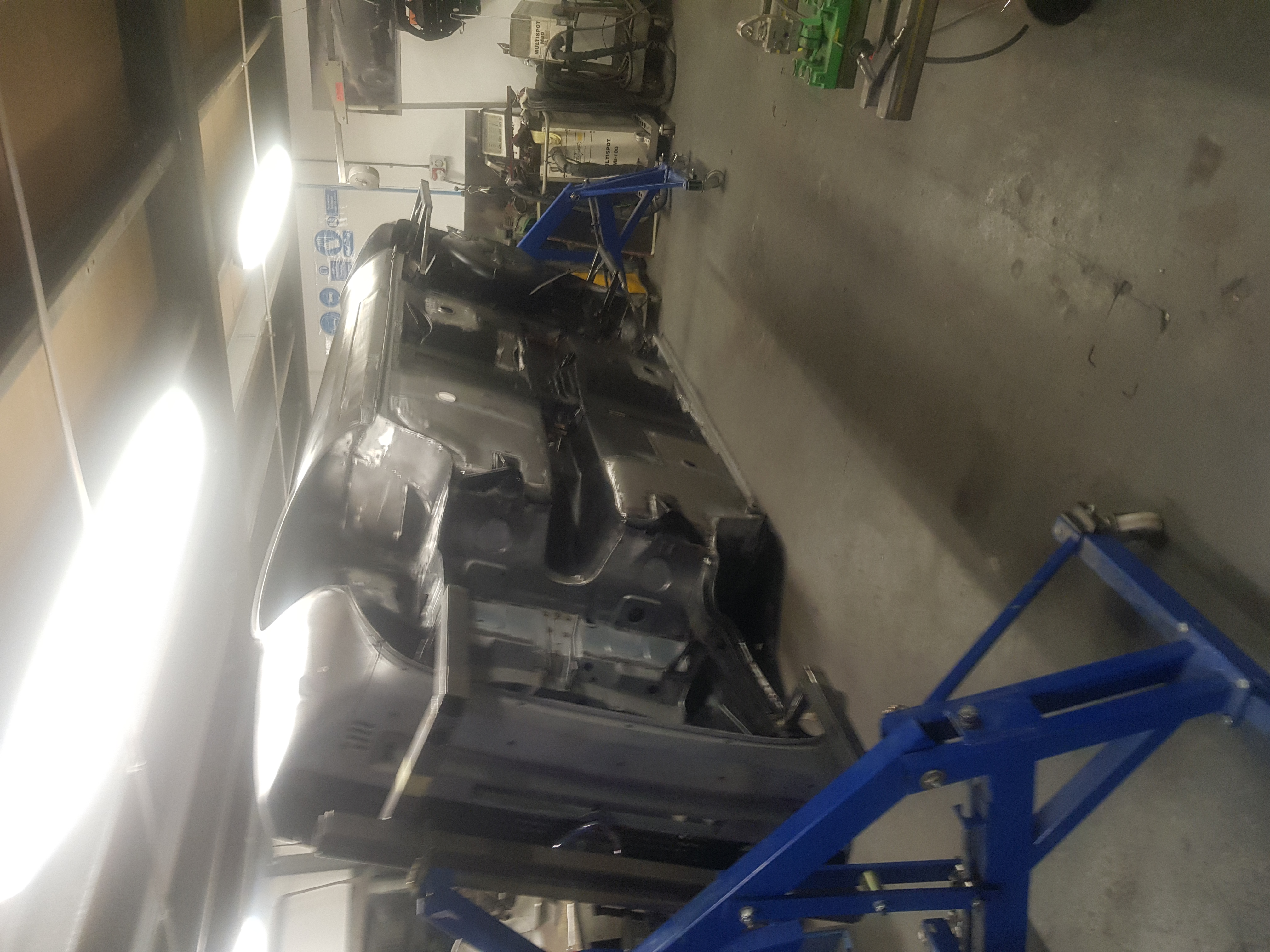

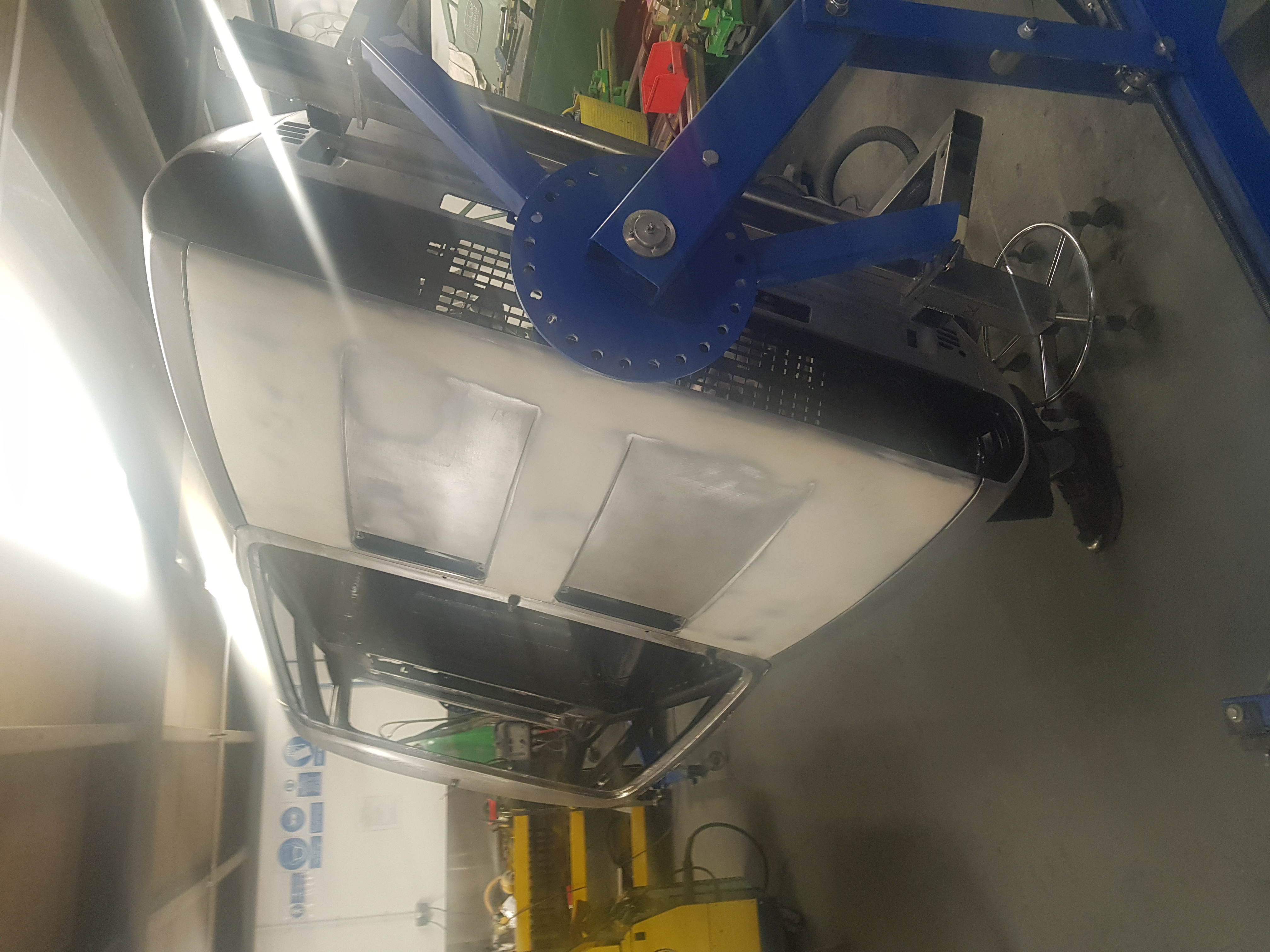

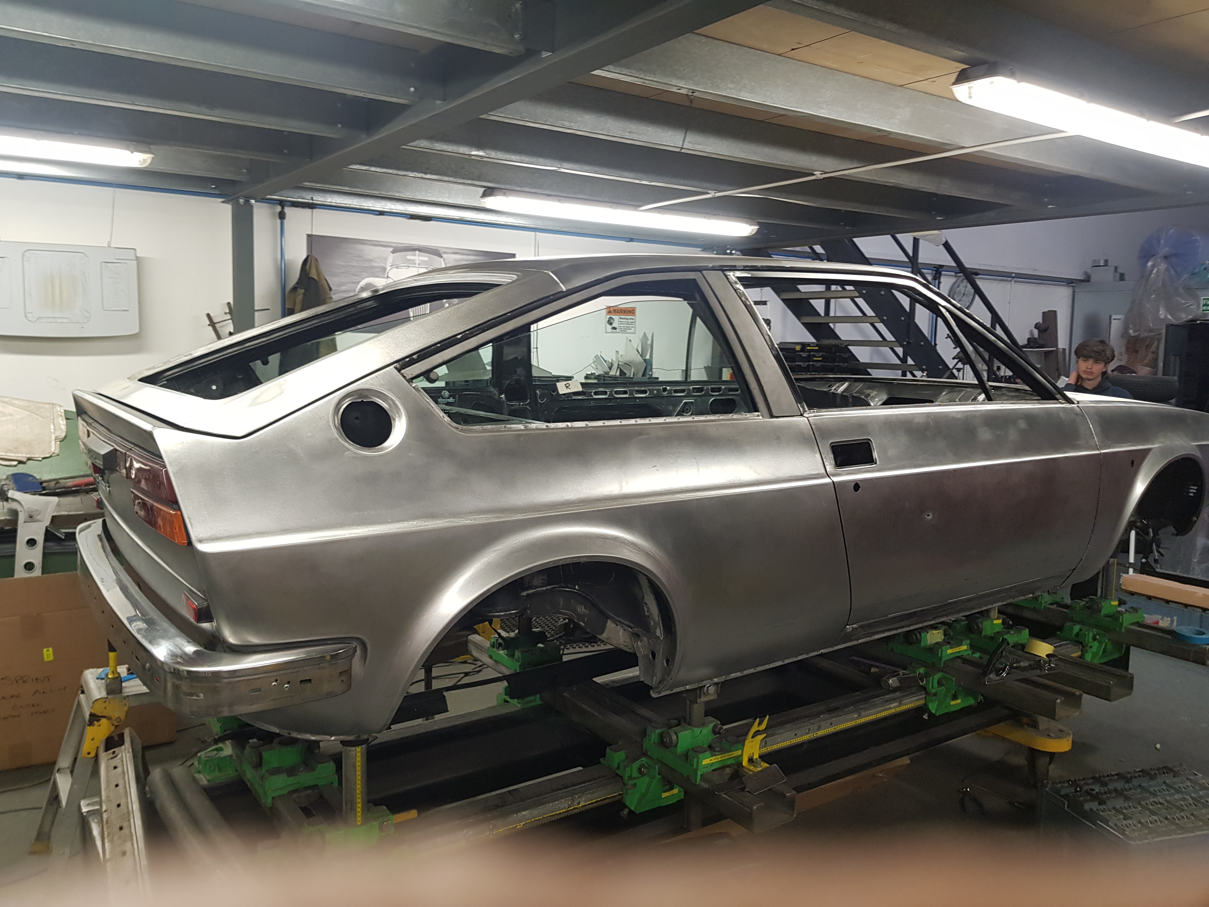

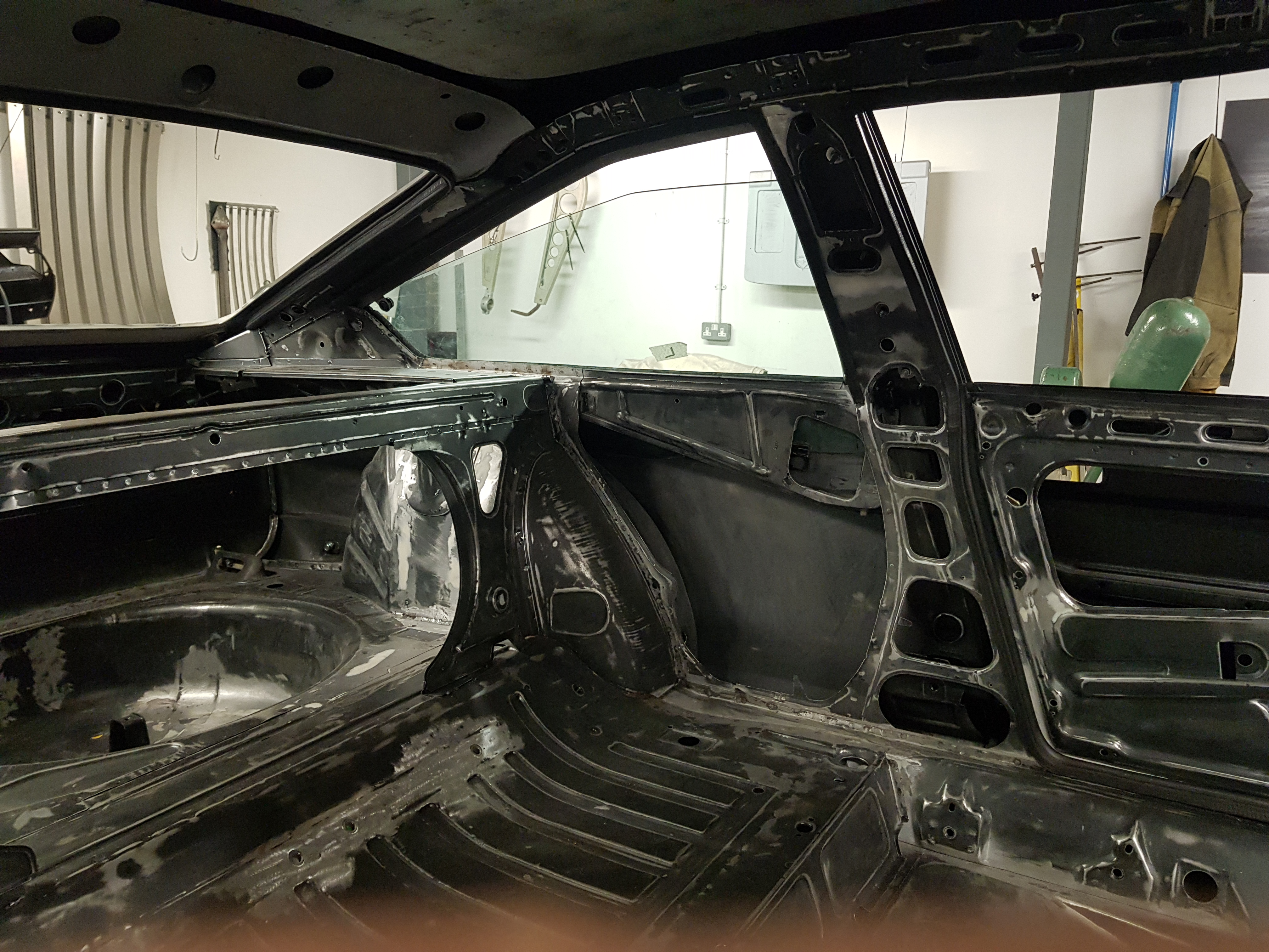

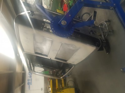

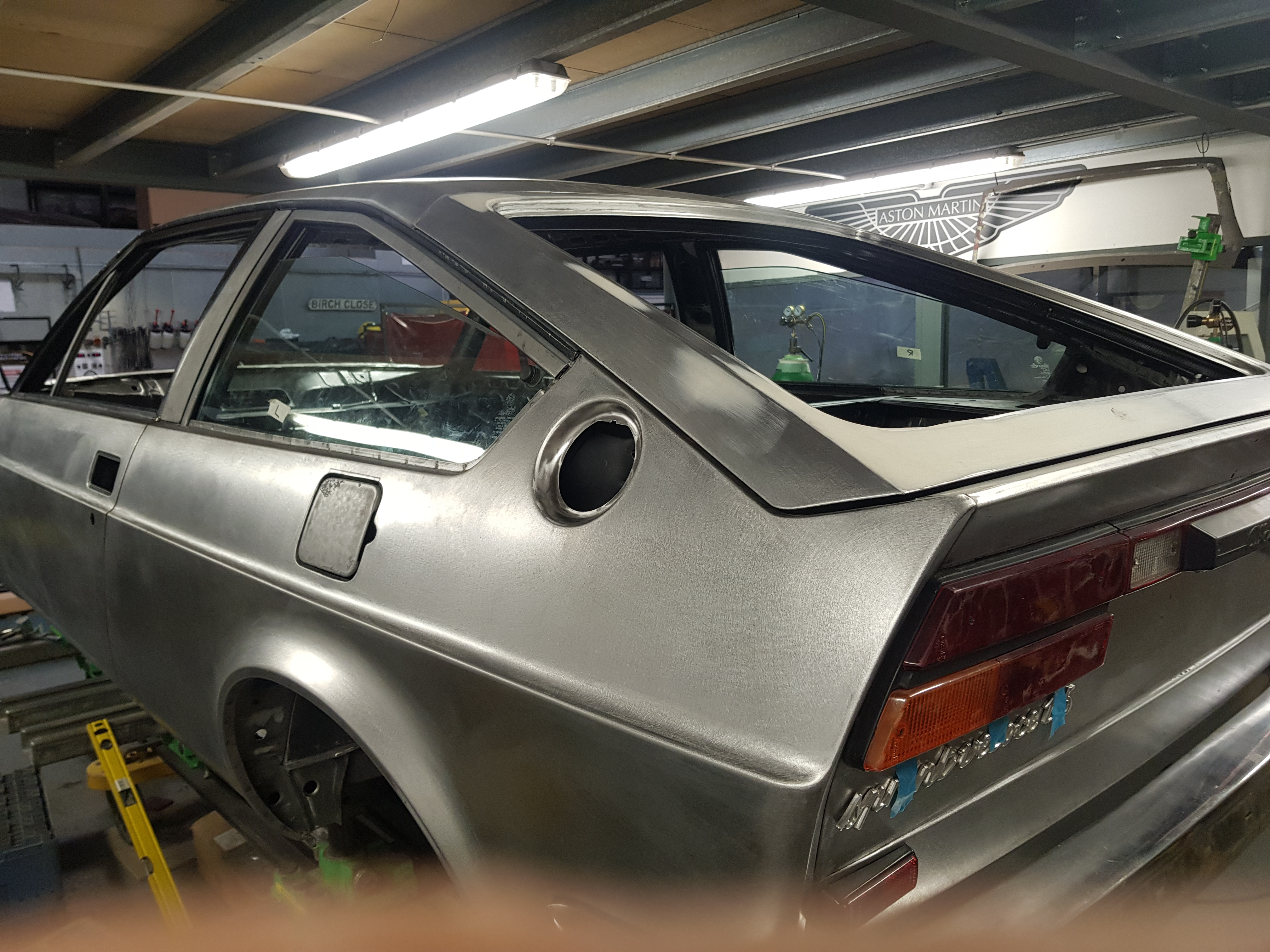

More pictures to salivate or yawn over! It was impossible to stop the ceiling lights flaring in the camera lens. First & thirds pics needs rotating 90deg CW

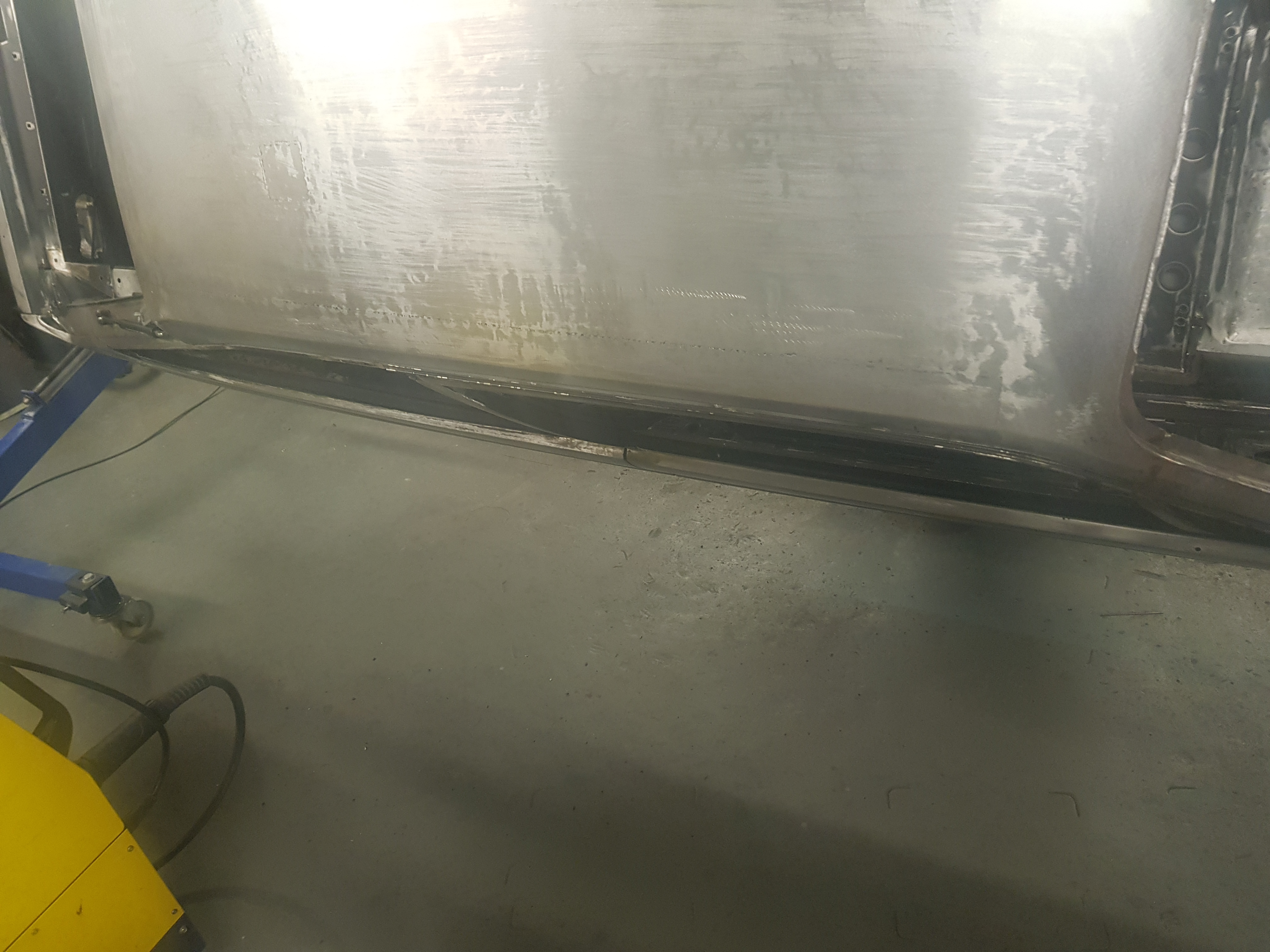

This pic attempts to show the large repair to the offside roof. You can just see the spot welds.....there's no distortion & the spot weld craters will be sorted out.

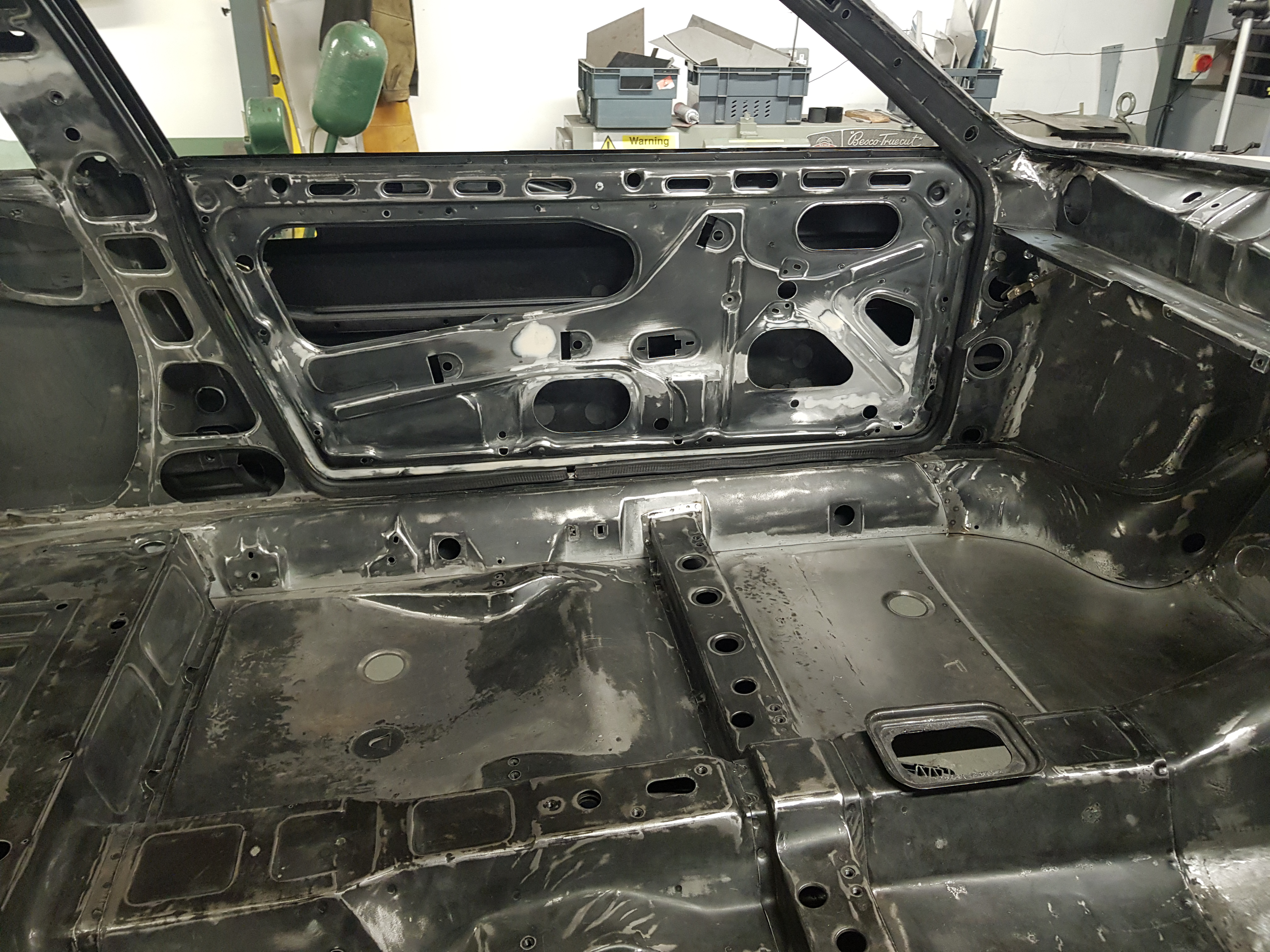

That fabrication work is fantastic, I know it may sound sad, but I love the floor pan especially.
Cracking job.
Cracking job.
Alfaoldgit
- Posts: 196
Hi Kegsti,
Yes the quality is amazing & no i don't think you are being sad. Another well known correspondent on this forum says its a piece of art, a sculpture, and that I should stop now and have it in my living room. My wife disagrees

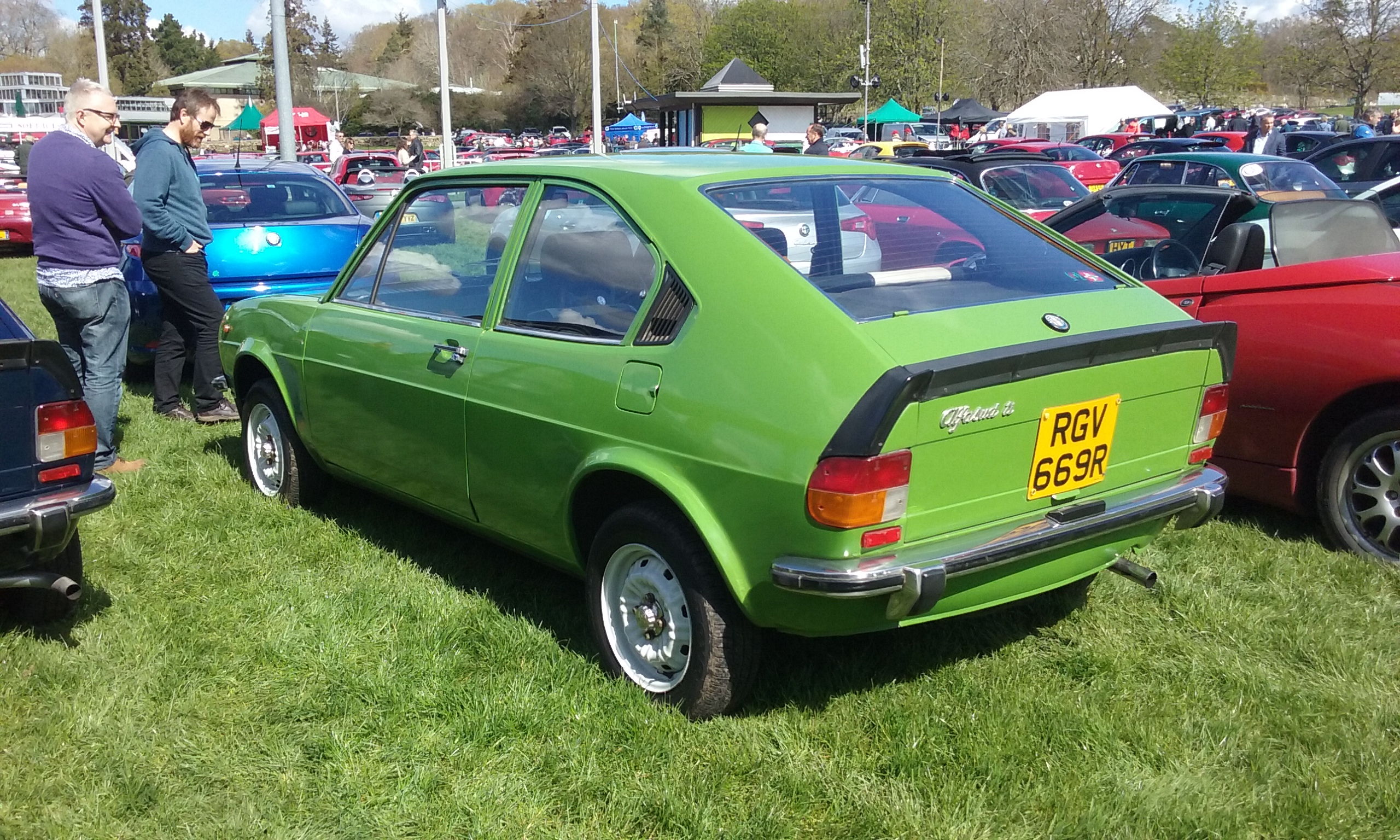

That does look almost metallic and darker than other pics, this Sud is matese I think?
https://www.flickr.com/photos/transaxle/15736759242/
My first sud ti was patch work metallic faito

Yes, that's Matese but it looks a little "bright". Every picture i look at it looks slightly different. I had a rattle can made up to the nearest available generic colour match (the proper original colour is only available in 2k or similar professional use paint), but it looks like Pea green. The body shop can create any of 40,000 colours on site so should be able to get it right!

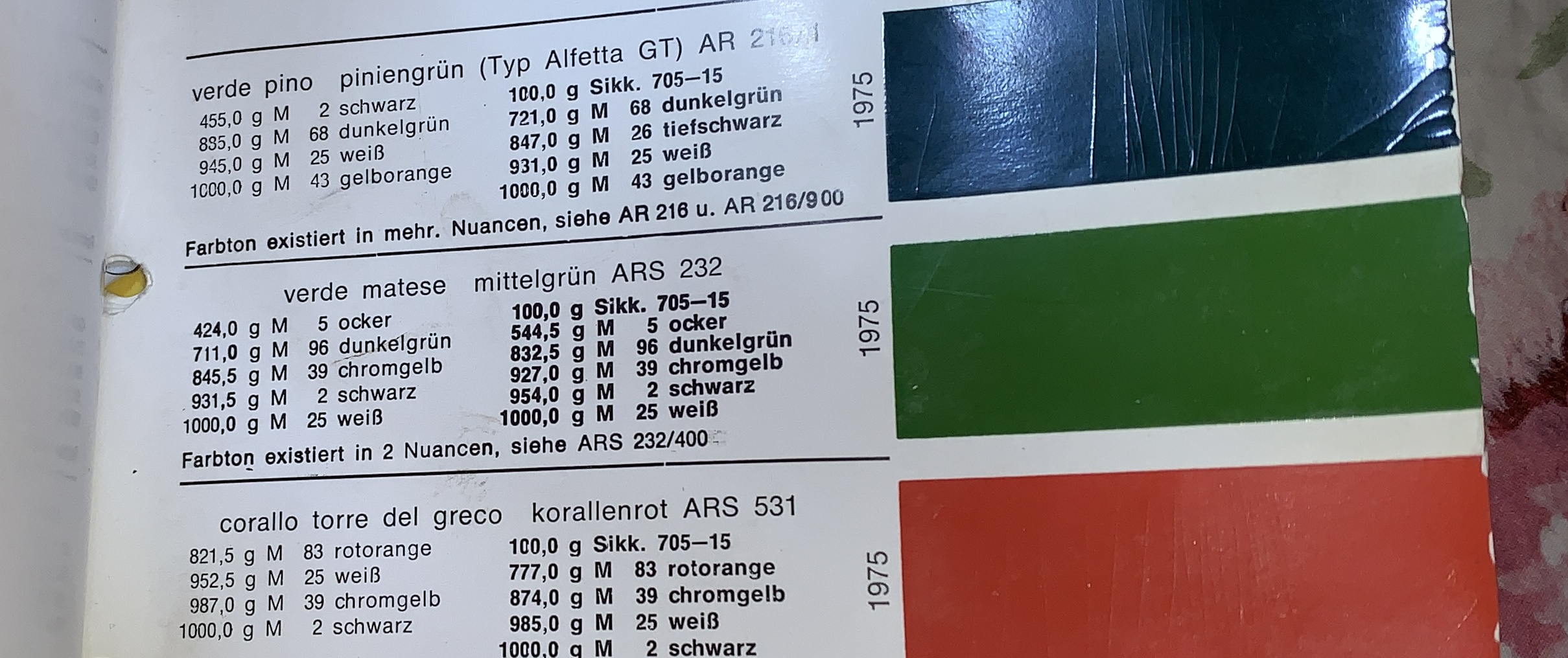

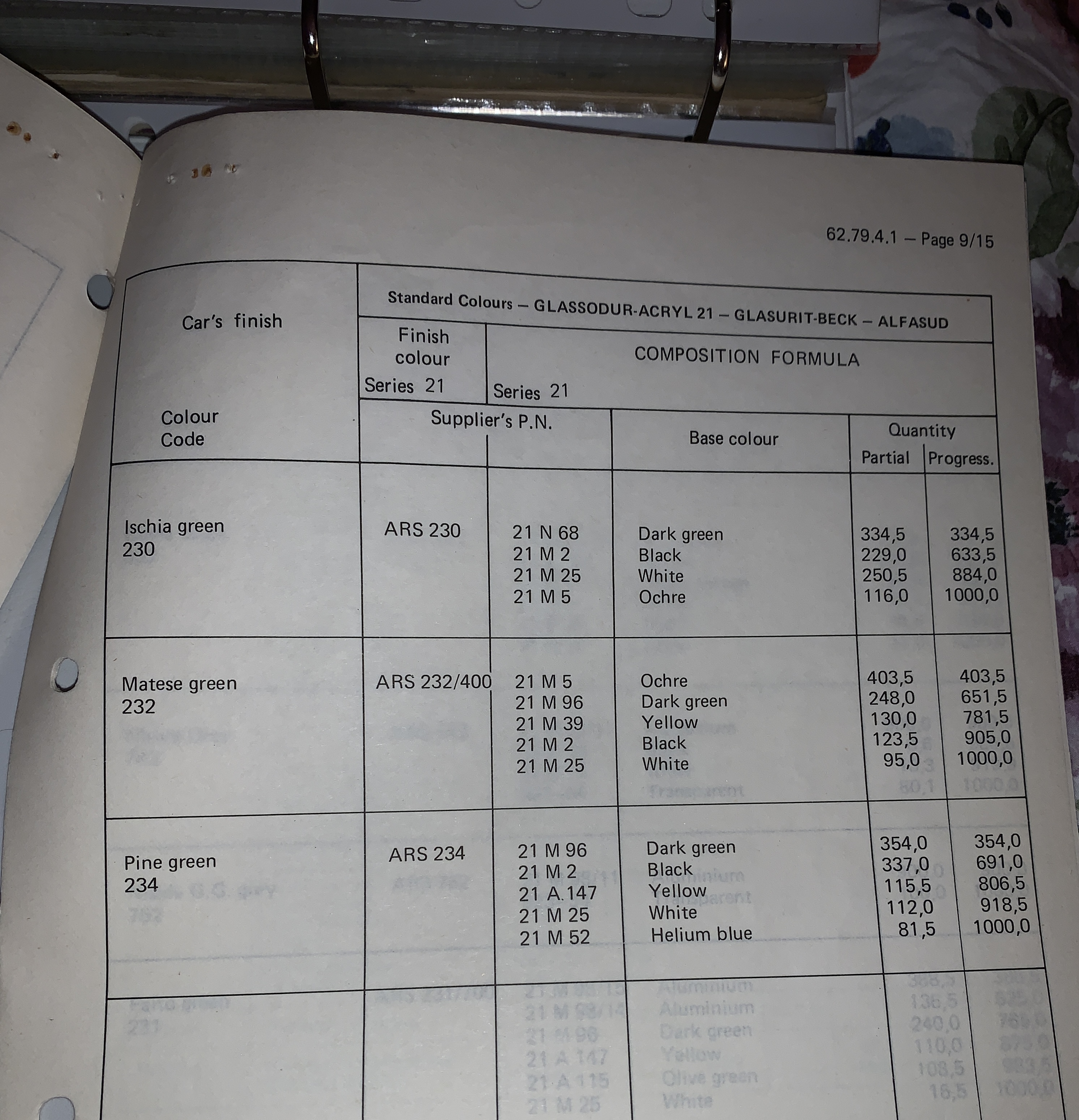

This is the Verde Matese swatch and colour composition from the archive I’ve got the same info in English. I’ll dig it out tomorrow

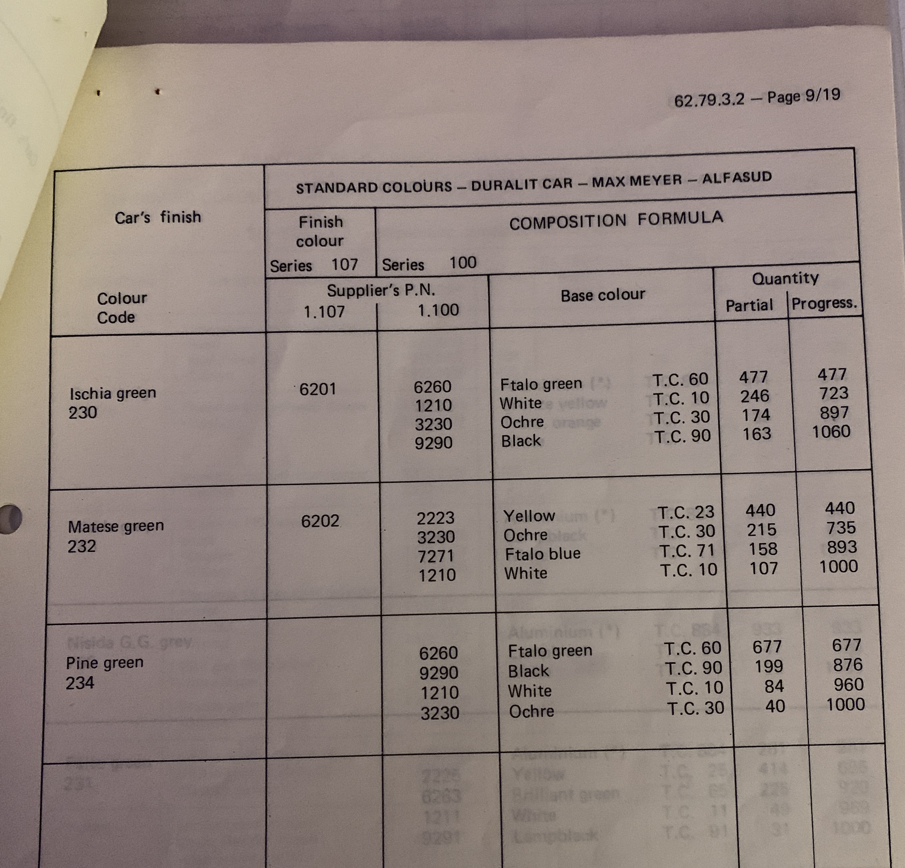

More paint details for Matese Green
Weirdly. The different paint vendors use different compositions to achieve the same shade. I’m sure Keith can shed light on the technicalities of paint wizardry
Max Meyer
Glasurit
These documents date from 1979
Max Meyer
Glasurit

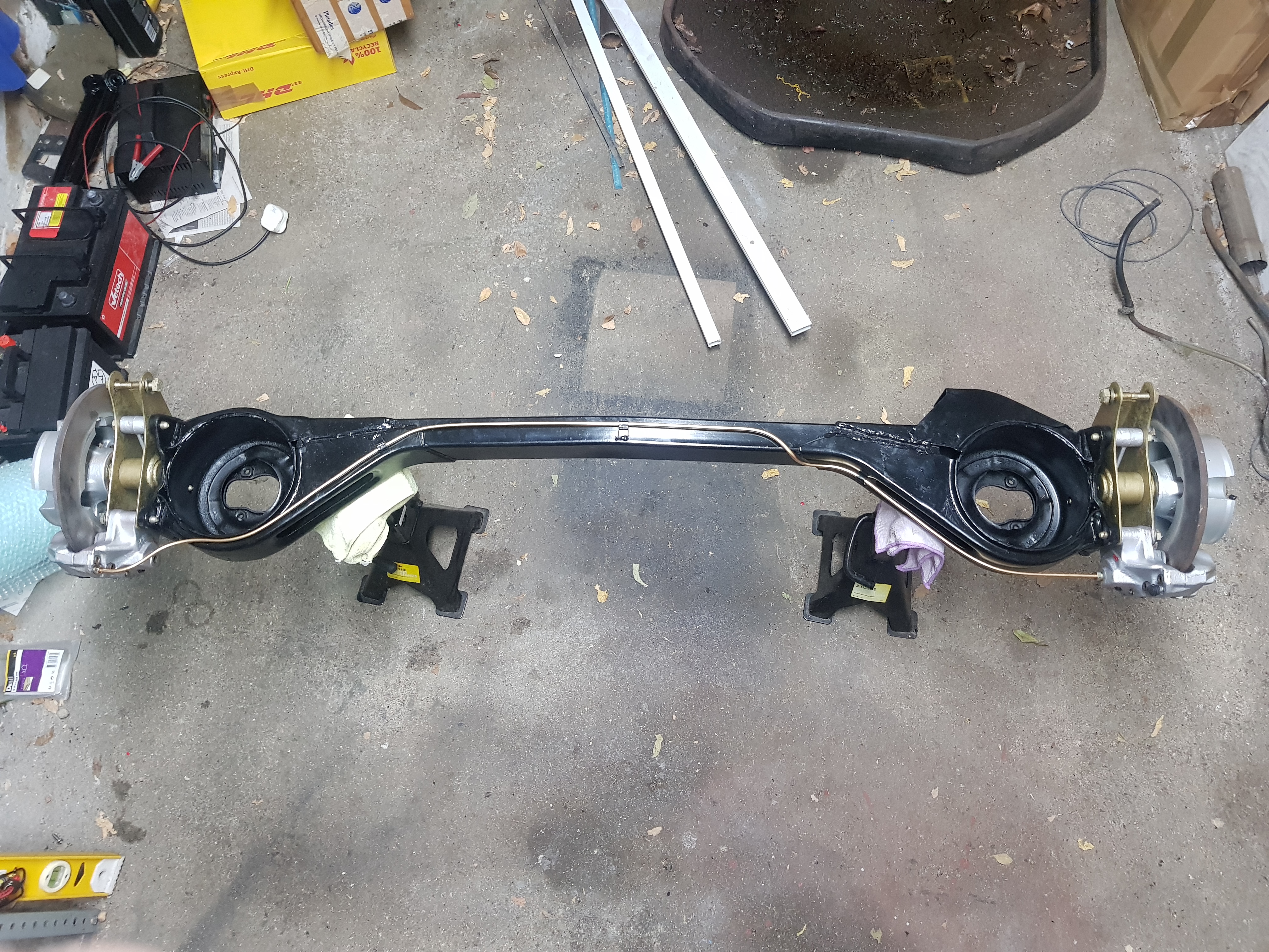

So much discussion over Verde Matese! Thanks for the colour info Lou. Meanwhile, despite being slowed down by Covid I have managed to rebuild the back axle and calipers hopefully to a standard comparable to the body shop.
i got lucky with the calipers - the pistons were well and truly stuck in their bores, the offside ones fully extended as someone had removed the pads.........A search on the web suggested using a grease gun to pump the pistons out. Amazingly, the flex pipe on my trusty Wanner gun screwed straight into the caliper ports & out came the pistons. Okay it wasn't quite that simple, but you get the idea. Some Brasso polished up the pistons, the bores were good apart from some cosmetic corrosion above the seals. Having been quoted £300 for overhaul of both calipers I was quite pleased that a seal kit and a can of silver lacquer came to just £30. The hub bearings were fine agter being cleaned out with white spirit & repacked. The discs were unworn apart from surface rust, I simply couldn't justify buying new (assuming i could find some) & let's be honest Sud rear brakes are more decorative than functional!
In case you're wondering, the axle brackets are yellow Zinc plated, even though they look as though they have been painted. I used a new plating outfit instead of my usual Folkestone based platers. They were quick & the cost was competitive but everything has come back rather dull so it's back to Folkestone for anything else.
Nice work on the axel, looking good.

LooLooSud33Spider wrote: ↑Wed Nov 02, 2022 10:27 pm More paint details for Matese Green
Max Meyer
Glasurit
Put simply Lou, the paint manufactures all use their own basics to make the mix of colours.
Problem is the pigments have changed so much over the decades, removal of lead in red basics etc, means the mixes are constantly being reformulated to suit the new basics. Metallic is no longer aluminium flakes it is mica so now you get the pearlescent "flip" which , nice as it is, it looks wrong on older cars . Even solid colours can suffer from sun bleaching. Blues often look lovely and deep till the sun hits it then it goes paler. It can be a real pain.
