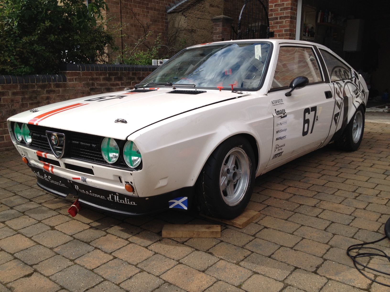

1500ti restoration. Ex racer
Hi Shrew. 8j it is then,  as its close to 9 overall front to back width.  Another thing learnt.
the way to measure a wheel width is on the inside edges of the wheel, where the tyre sits.

Anyway, 8j you say? And that looks about right and would be period accurate too, so i reckon you're right. So anything between 195 to 225 would fit and work width wise, so its down to what suits and fits in profile as next consideration i would say.
The tyres currently fitted appear quite a low profile for 13", but i suspect that may be down to a mixture of choice, and a desire to run very low final gearing?

I did search for a number or markings Kev but could not find anything.  Well, that will be not untill I have bought the wrong tyres
The tyres do seem to be rather low profile and I wondered if it was just down to getting the car as low as possible with it having the exhaust out of the way and allowing them to do so.
Many thanks for all the replies. looked at several of the tires and feel looking the part may have to come into it again.

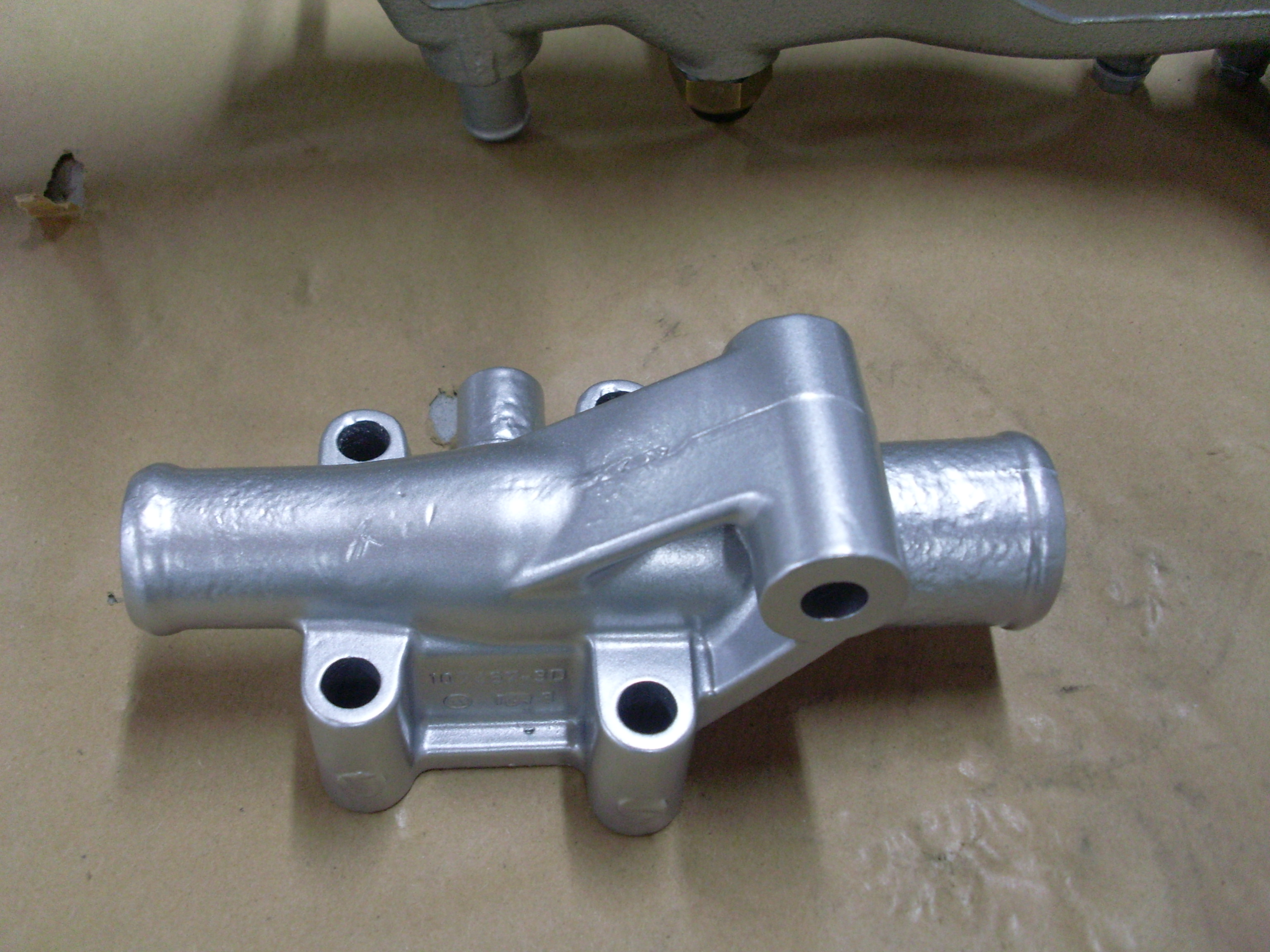

By the way do you have any idea what size bolts fit the casting that the hoses fit both sides on just before the thermostat. Odd bit that bolts on top of the engine at the front. Picture would help at this point
Do you mean this bit ?

M8 bolts, Kev not Keith
seem to feel that one is longer than the rest for some reason that I can't remember why?
as long as they are a good 15mm or so through the casing and not overly long as to bottom out they'll be fine. use a thin screwdriver or an old nail or something to gauge how much depth you have in the casting before fitting the mount

I thought they were m8 but one felt odd when tried. Shall clean them out, check I have the right bolt and go again.
I like that you had the photo. Great KEV ! Thanks.
