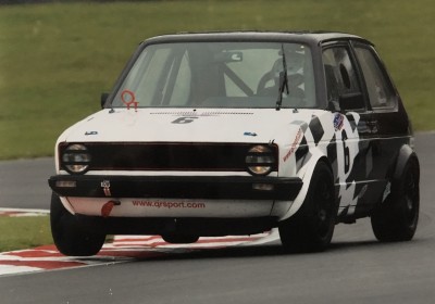

I met the previous owner of the Golf at Oulton Park. He kindly sent me some pictures of previous colour schemes:

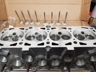

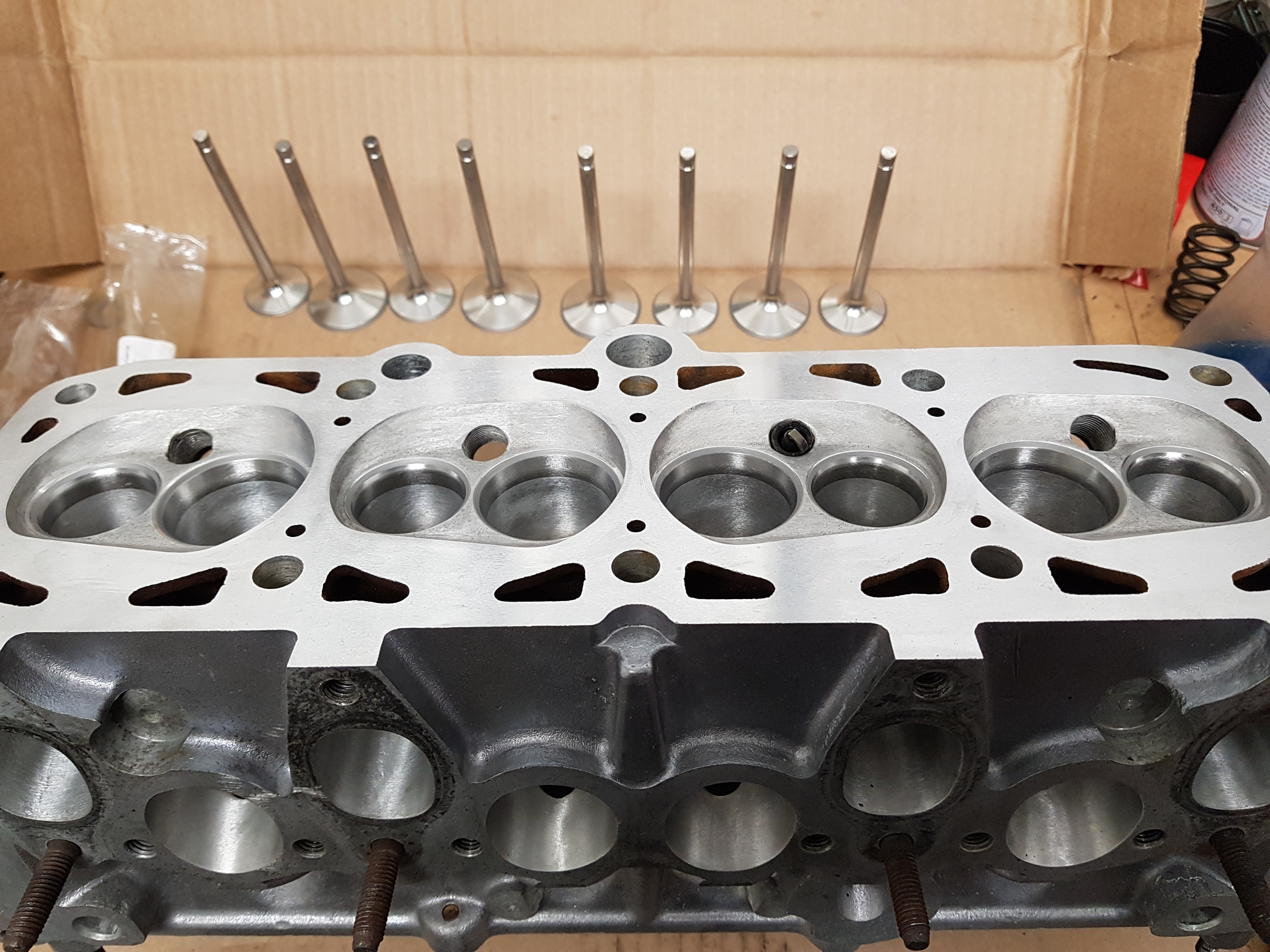

Re: Escort Hunter Killer
Still waiting on my new engine and gearbox.

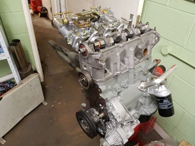

The camshaft got delivered today so the engine build will be finished this week. New manifold arrives on Monday so should be on the dyno next week. This is the head:

Looking good Simon, I bet you can not wait till you get it all back together.

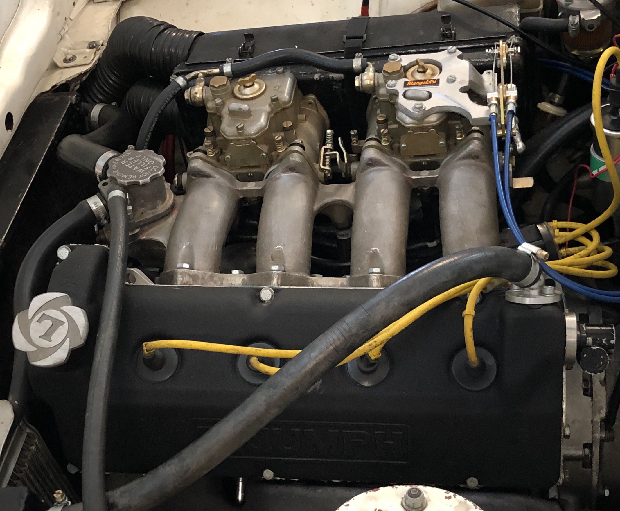

Hi Guys,
I am told:
1. The std crank vibrates at high rpm (8000) and can destroy the block. You need a newly designed crank with different balancing and a vibration damper.
2. The block needs a bracing skirt.
3. Rockers can break.
4. The clamping of the head with some angular studs is not good.
Otherwise it’s perfect!
Has the potential as a 16v for nearly 270hp/tonne at 7000rpm.

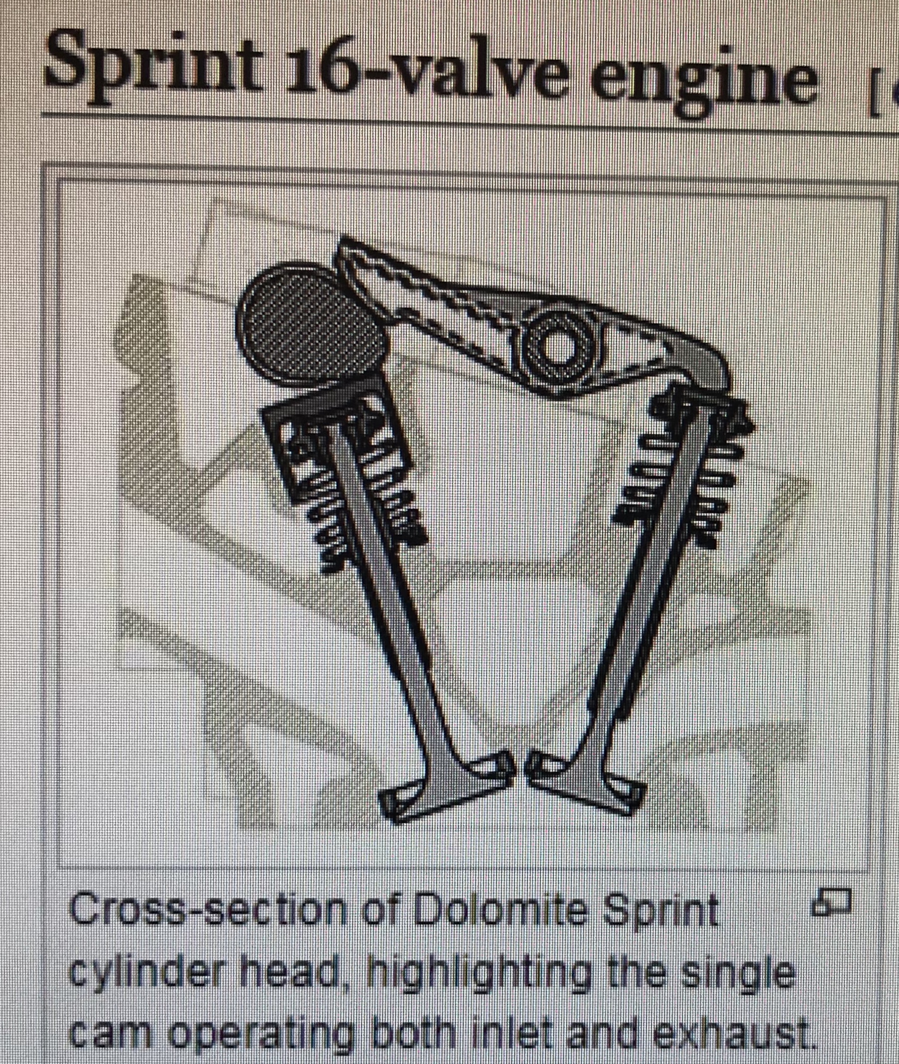

The single cam setup is interesting:
It’s a race car Tim and has been all it’s life:
I am told:

I see what you mean about the cam Simon, it all looks a bit frantic.

That’s some serious modifications to the dolly motor, the heads where always an issue, the studs didn’t help and there where revised versions from BL at the time. Along with a low flow water pump and silted radiators the heads warped easily. The quality of the casting was poor at best. The spark plug tubes leaked oil and the ‘innovative’ single cam design was alway a challenge when adjusting the valve clearances. The threads in the head stripped so easily I had a helicoil kit as part of my service tool set! Great these issue have been worked around but I’m not sure I’d like to have that much power going through the rear axle! Good luck with the new purchase!
- Posts: 976
Spot on Neg.
The head on this car is a Broadspeed one. Wills rings are used for head/gasket/block sealing.
I was told that the head studs/bolts have to be replaced with ARP quality.
The water pump is updated and modified.

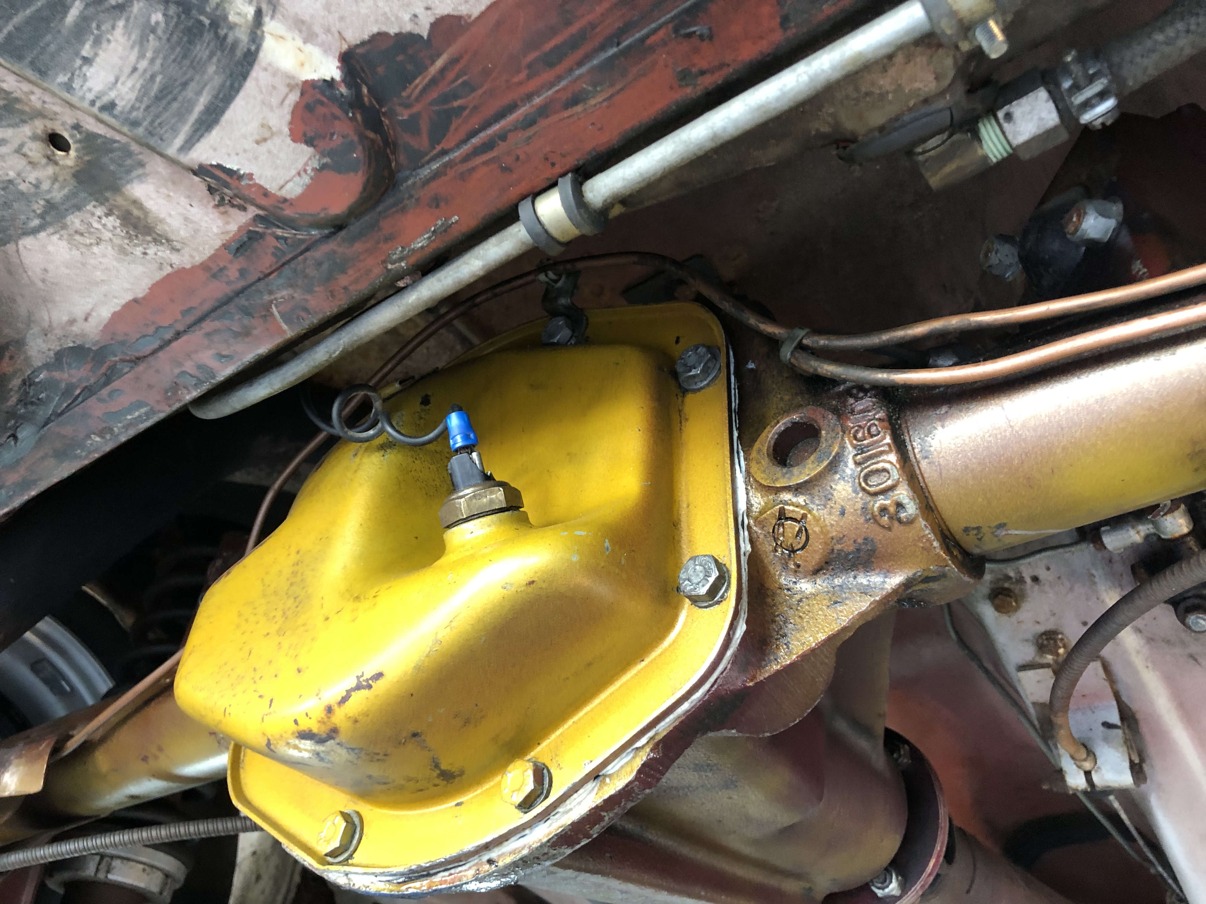

The spark plug tubes still leak oil unless sealed inside and having a billet cam made is recommended. The rear axle has a temperature sensor and LSD and the driveshafts are upgraded. The gearbox is upgraded close ratio and has needle roller bearings instead of plain bearings.

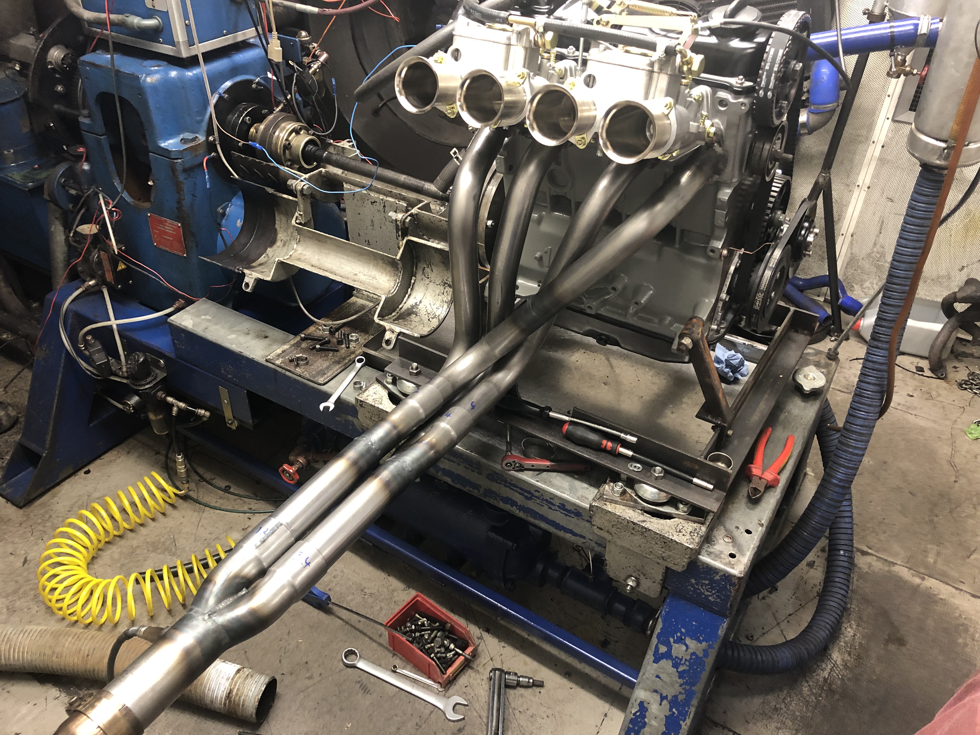

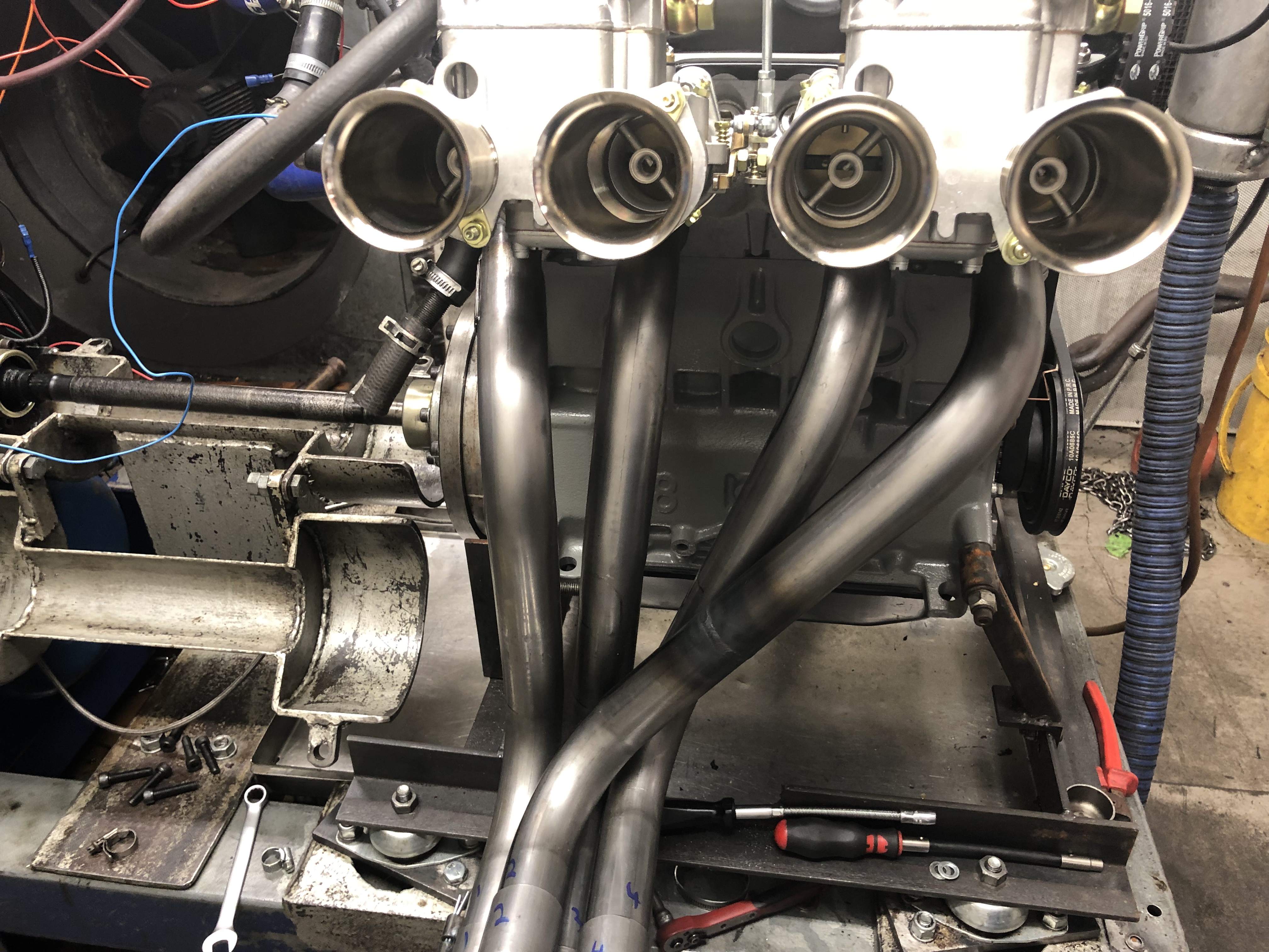

I am not racing today as my new engine is not ready. It should be on the dyno this week hopefully.

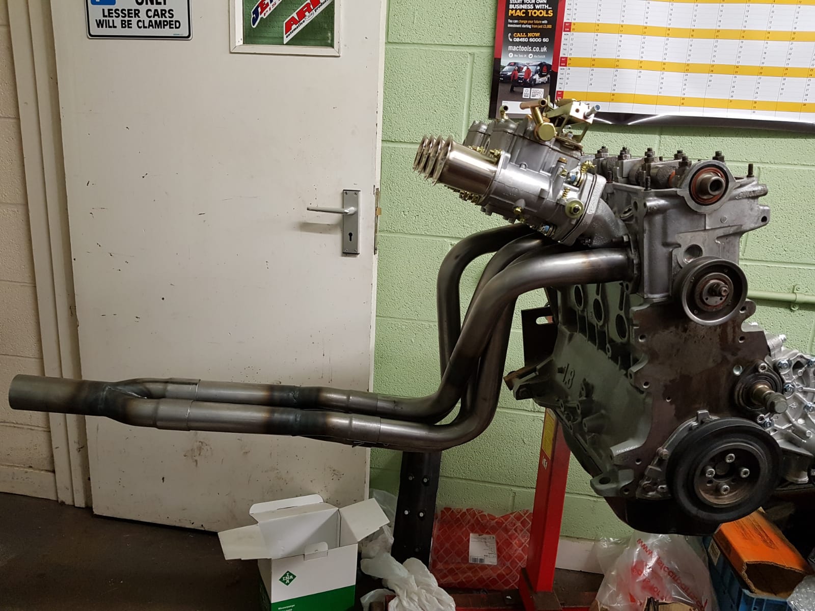

Looking good Simon, hope the testing goes well.
Re: Escort Hunter Killery
Nice down pipe , not far to go now by the looks off it.
The grids were a low at Silverstone across all groups, any reason why?
I’m hoping to enter the festival at Cadwell in September, but if it’s me against 12 200bhp cars then I might be lonely on track.
- Posts: 976
Thanks Keith. I will let you know what it produces.
I am told that the manifold only increases the top end power by a couple of HP but has a significant positive effect on mid range torque.
I think you should definitely do Caldwell Tim. It’s such a great track!
I can't get over how chunky the cam shaft is. It is obviously why it can rev so hard, it looks bullet proof.
Longer primaries = torque, shorter primaries = power.........or I think it’s that way.
All being well I’m at Cadwell 15th/16th June, the grid is at capacity already, so hopefully no late entries to kick me out.

Good point Keith. It must produce quite a bit of drag with all that surface area on the buckets but the engines built by JMR are built to be reliable and run for many seasons. They don’t use massively high revs - max about 8300. Ordinarily 7500.
