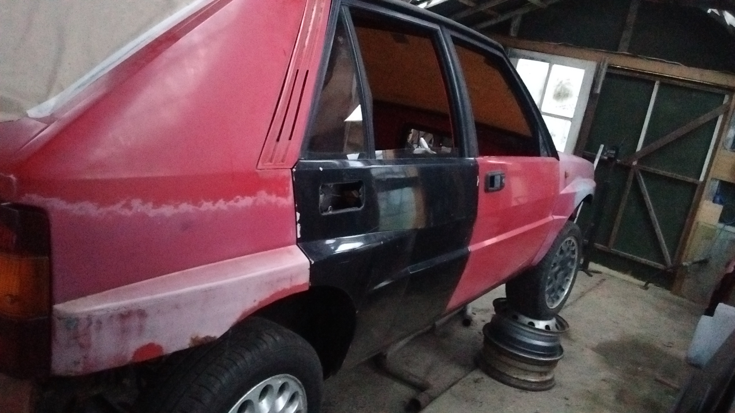

we built this little one for me to do the car in mate, raised the roof by an extra 2 foot to make some headroom.
I've done cars at jims' place before but as you say, it makes a huge mess. this one is set out on its own so i'm free to make as much dust and mess as I like :D
when it's done I can move it into the big shed to do the refitting. 8-)

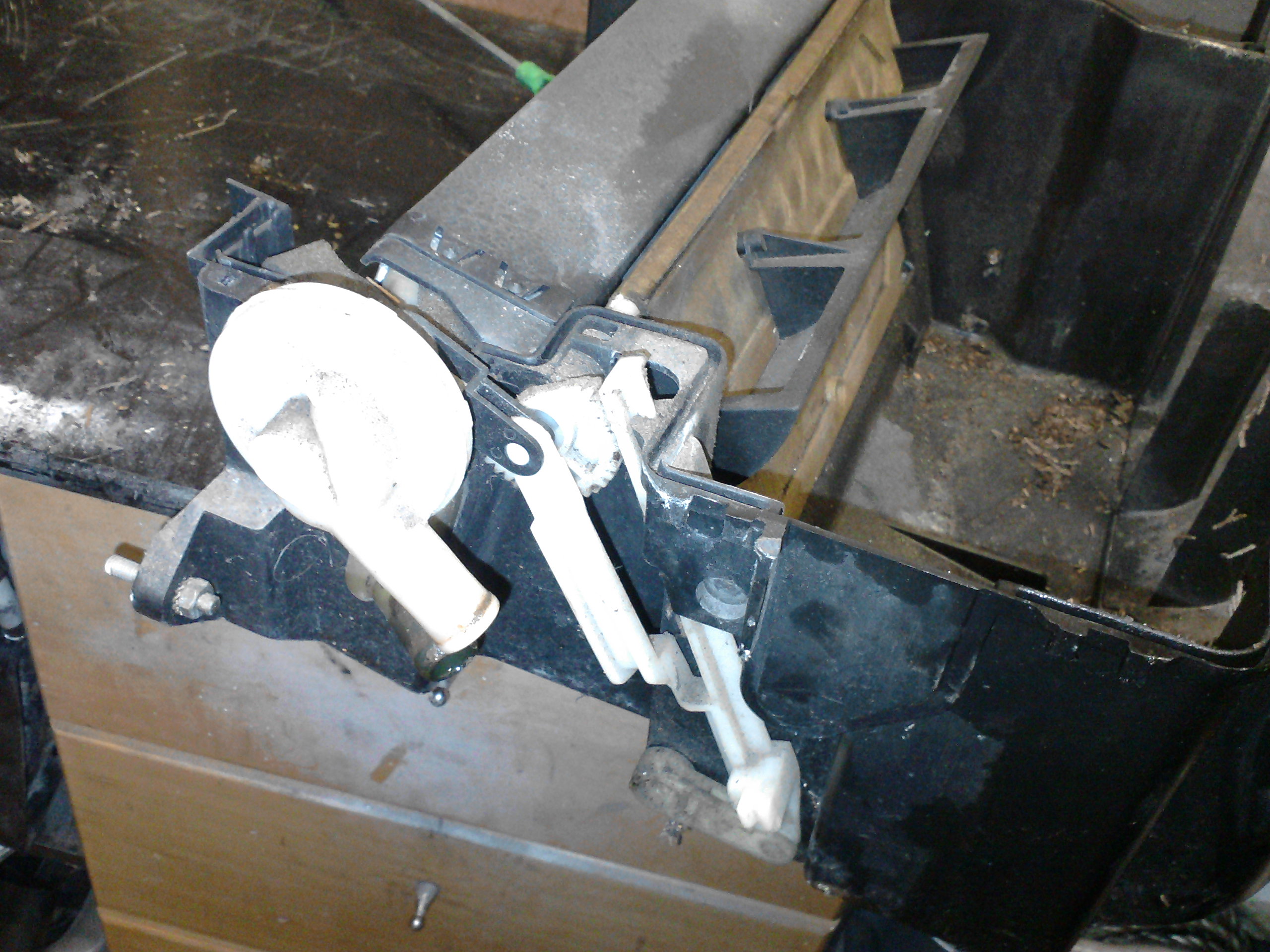

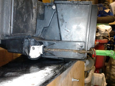

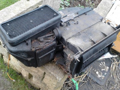

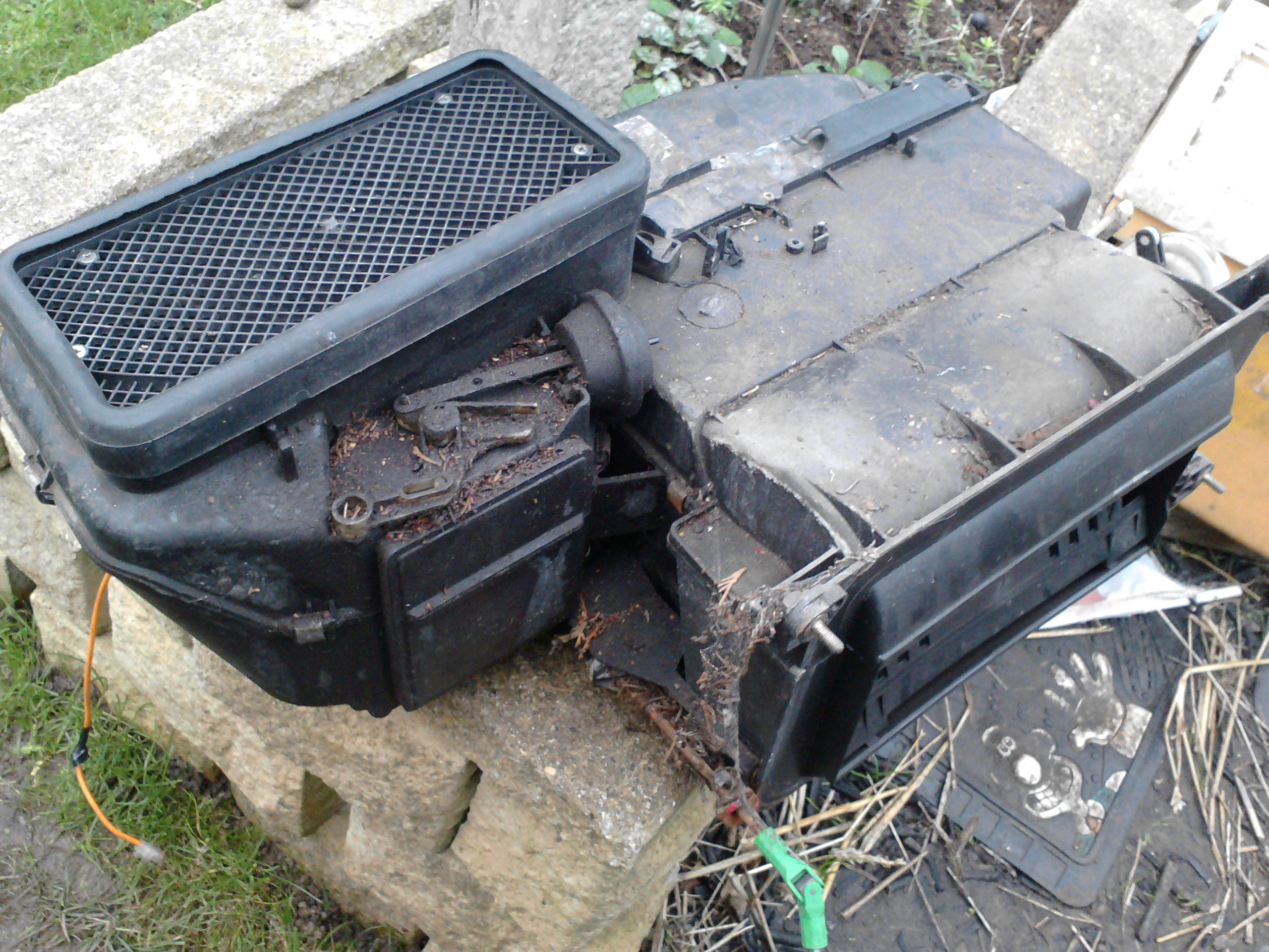

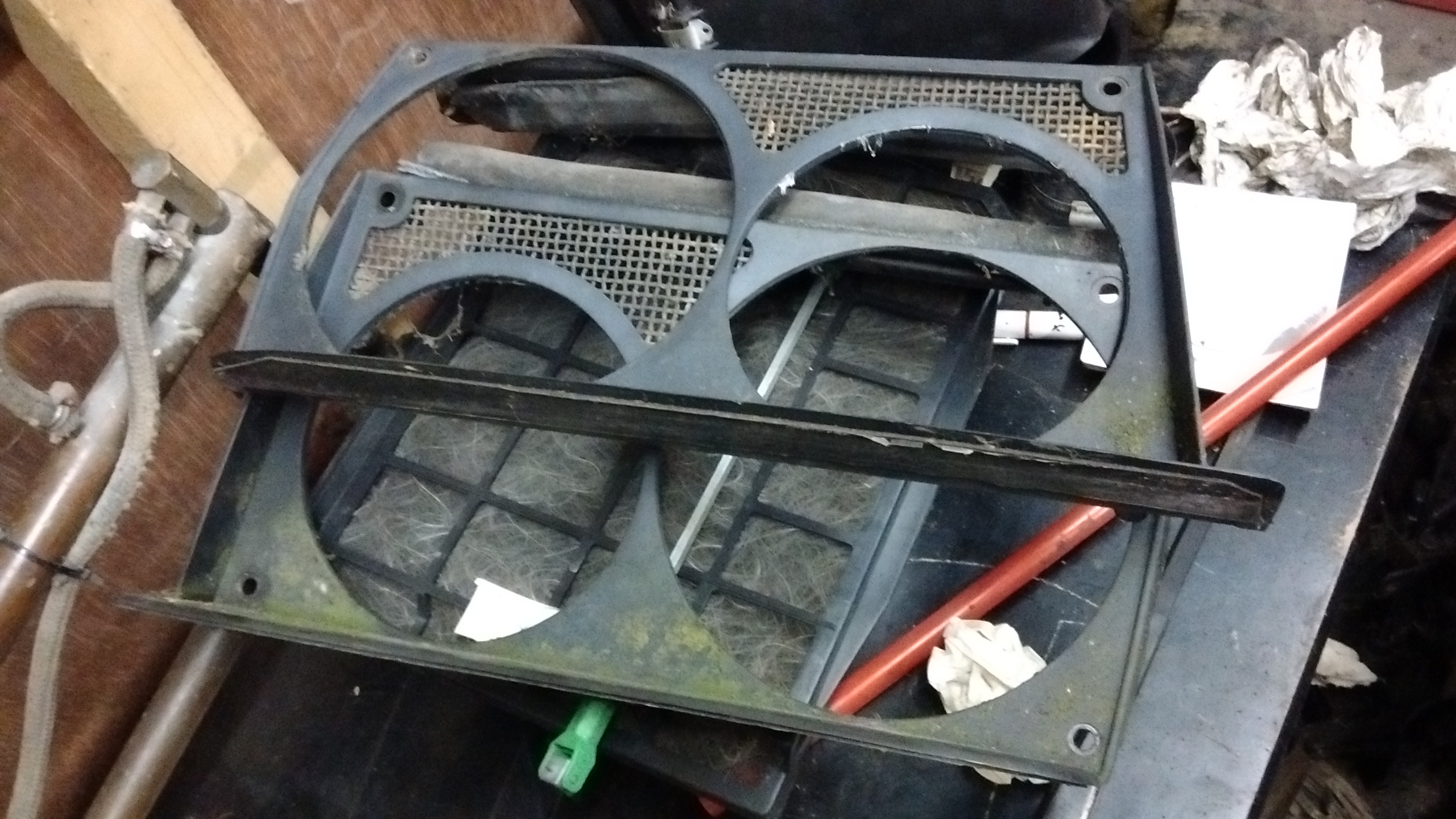

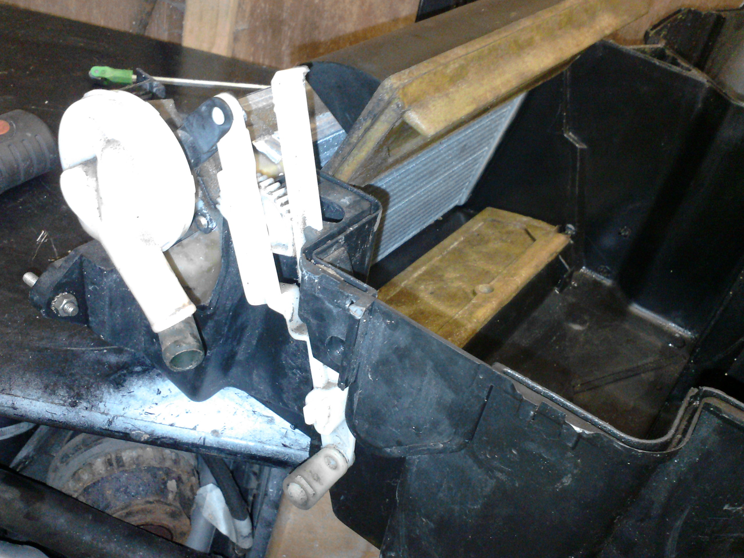

was gonna start stripping the engine down but then spotted the heater box which needs a refurb as a lot of it is seized and most is very grubby after 25+ years of use

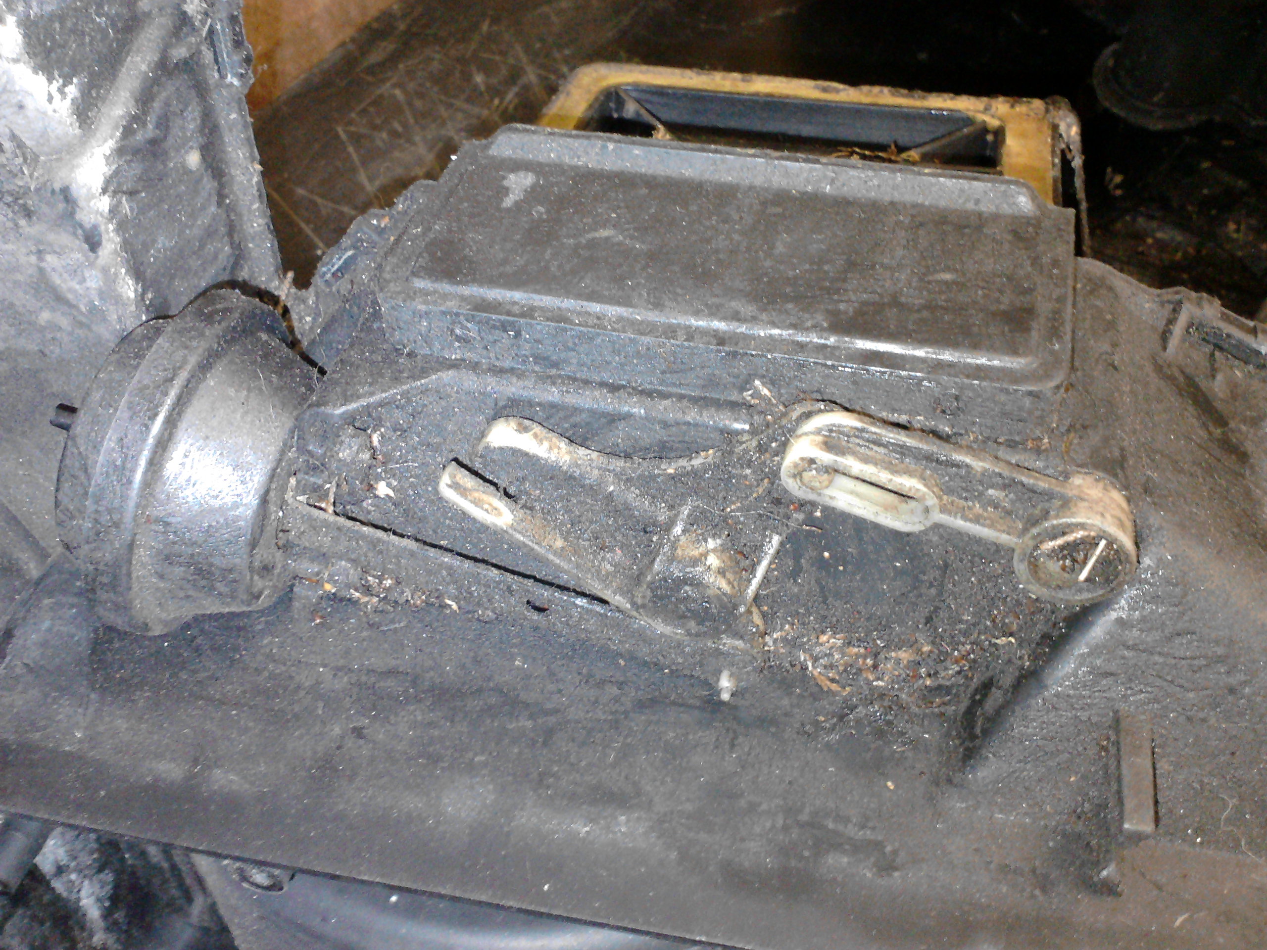

there is all sorts of linkages and levers, this little vacuum operated one looks a bit clogged!
the main heat control rod was rusted solid where it was trying to move at this set of bevel gears
it had resulted in a broken plastic turning vane as the control arms had probably been forced at some point. I extended one of the flaps to make the locating flap longer so it fitted into an unbroken section, smallest bit of welding i'll do on the car I guess :)
now it's all free moving it's quite an elaborate way of doing things.
the long rod with the UJ's on it turns the bevel gears, which moves the lower heat control flap. the opposite side of that flap is connected to a longer guide with another set of quadrant gears which operates the top heat control flap and also a tap on the heater matrix itself. so not only do the flaps alter the air-flow but the water to the matrix is blocked off. all in one movement!
this is them open....
and closed....
I've some more cleaning to do before it all goes back together plus some greasing to the moving parts. i'll also have to release the UJ section form the rusty rod as it needs to be separated to make refitting much easier as that part goes through the dash

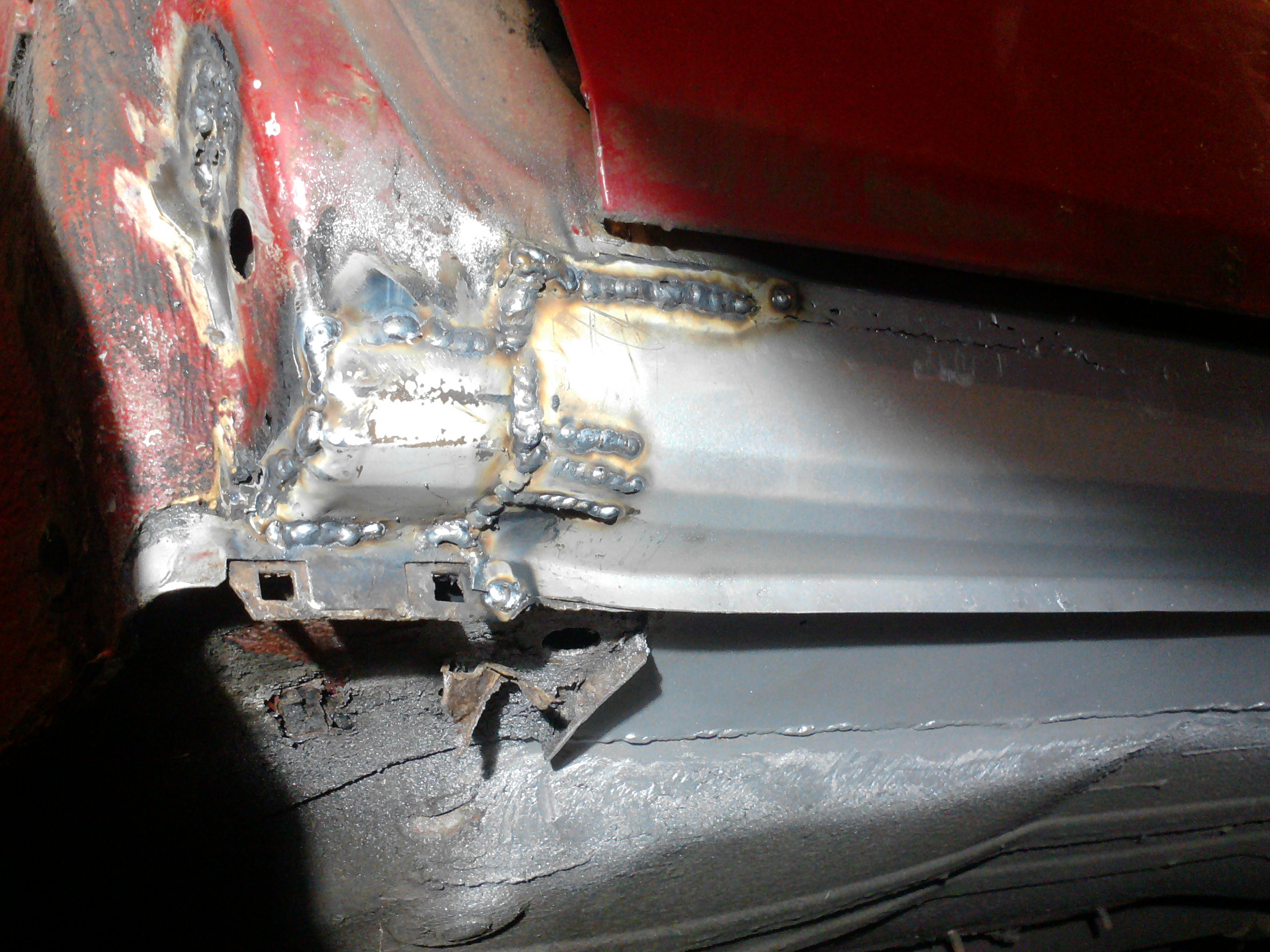

wing off revealed that the A pillar is remarkably good so that's a result. needs a small repair to the side profile near the strut top but the underside will need further repairs, but I knew about that so no big deal.

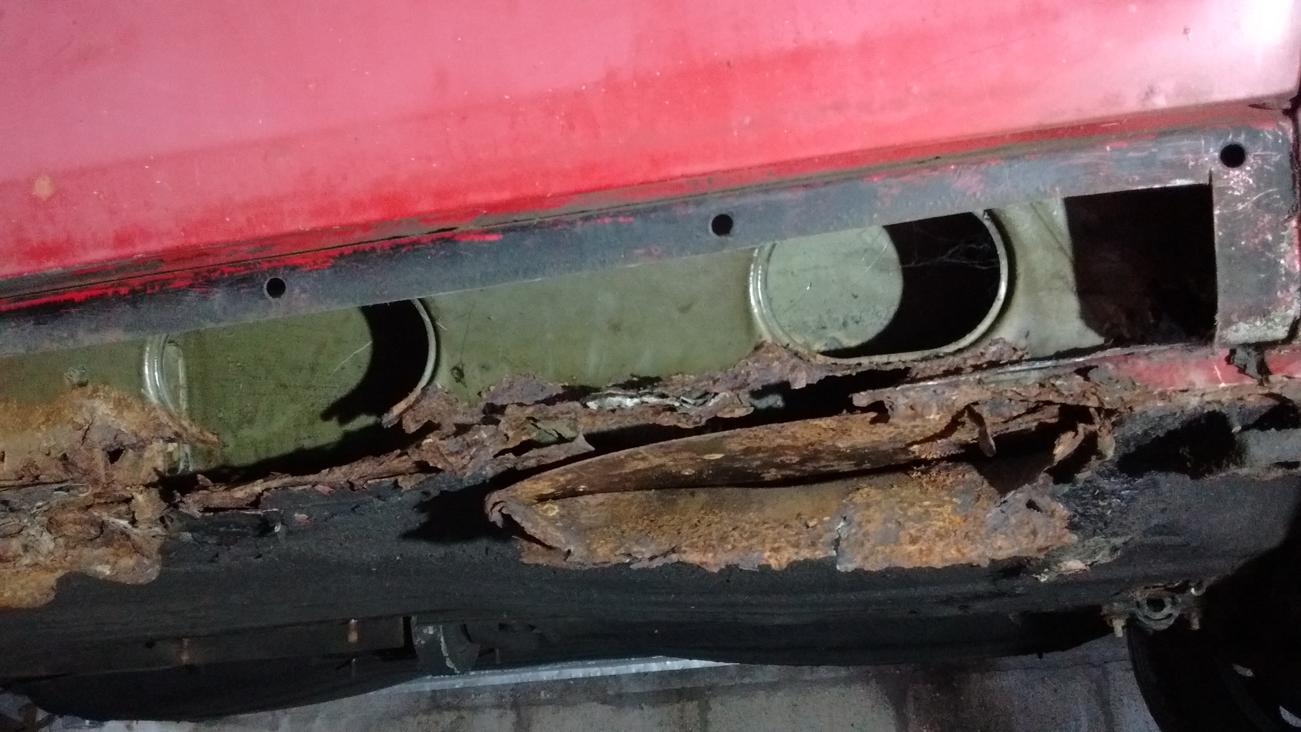

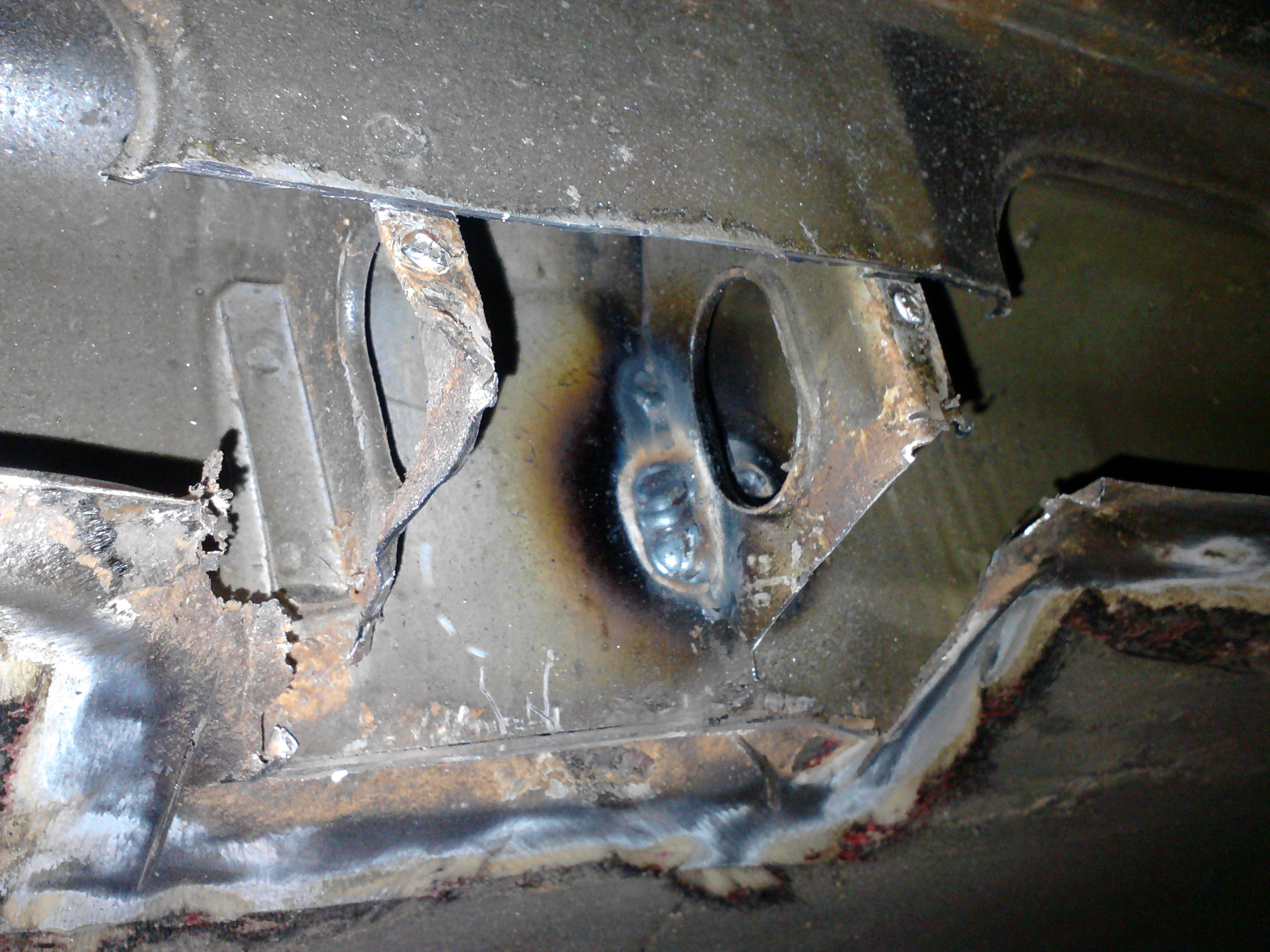

with the outer sill opened up the damage was clear, all the corrosion had allowed the central sill to be twisted and pushed up which just made more corrosion letting in the moisture. all looked as wavy as the north sea!
the first weld :)
there'll be a few more to come yet

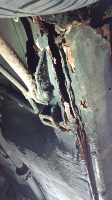

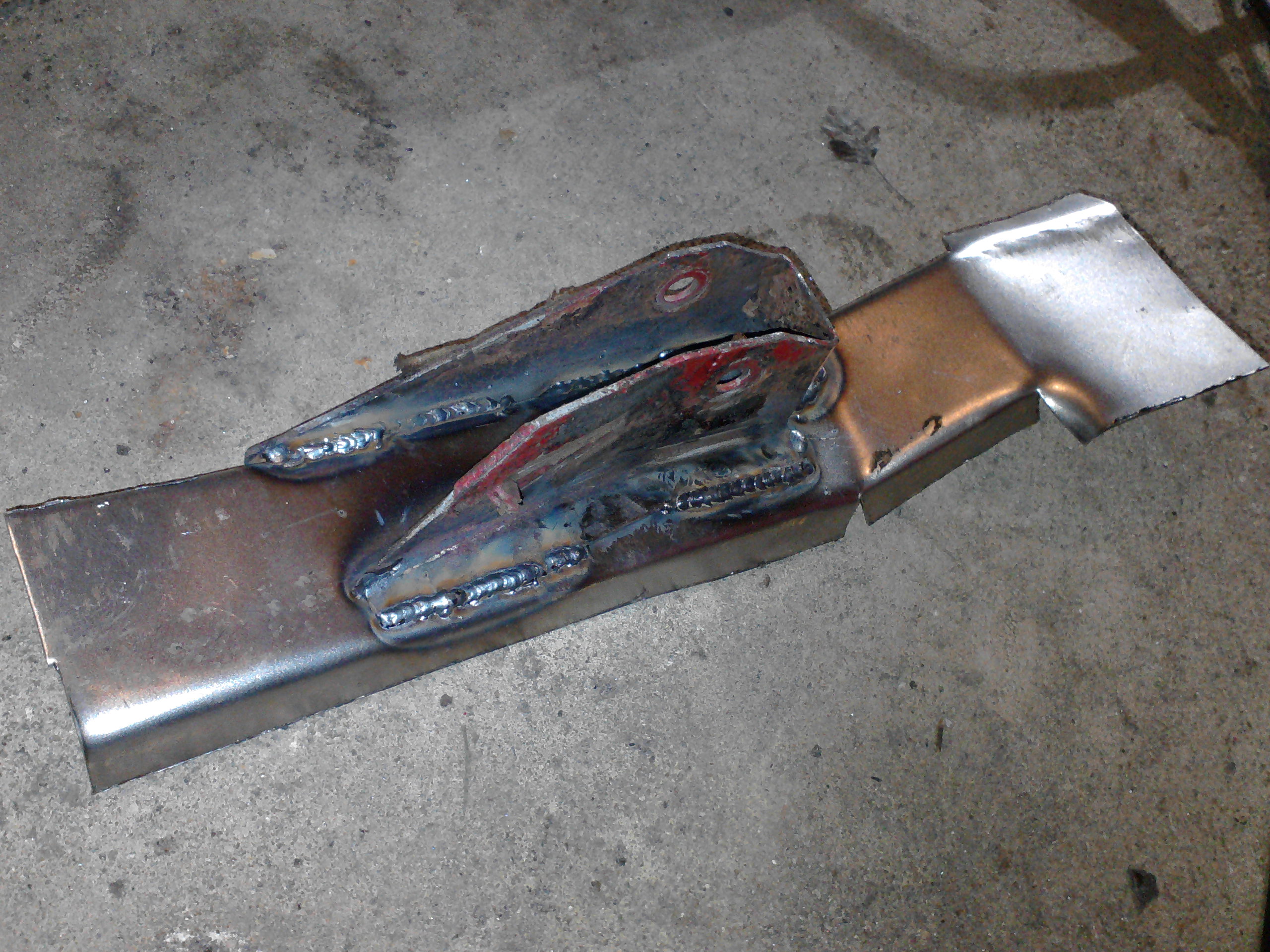

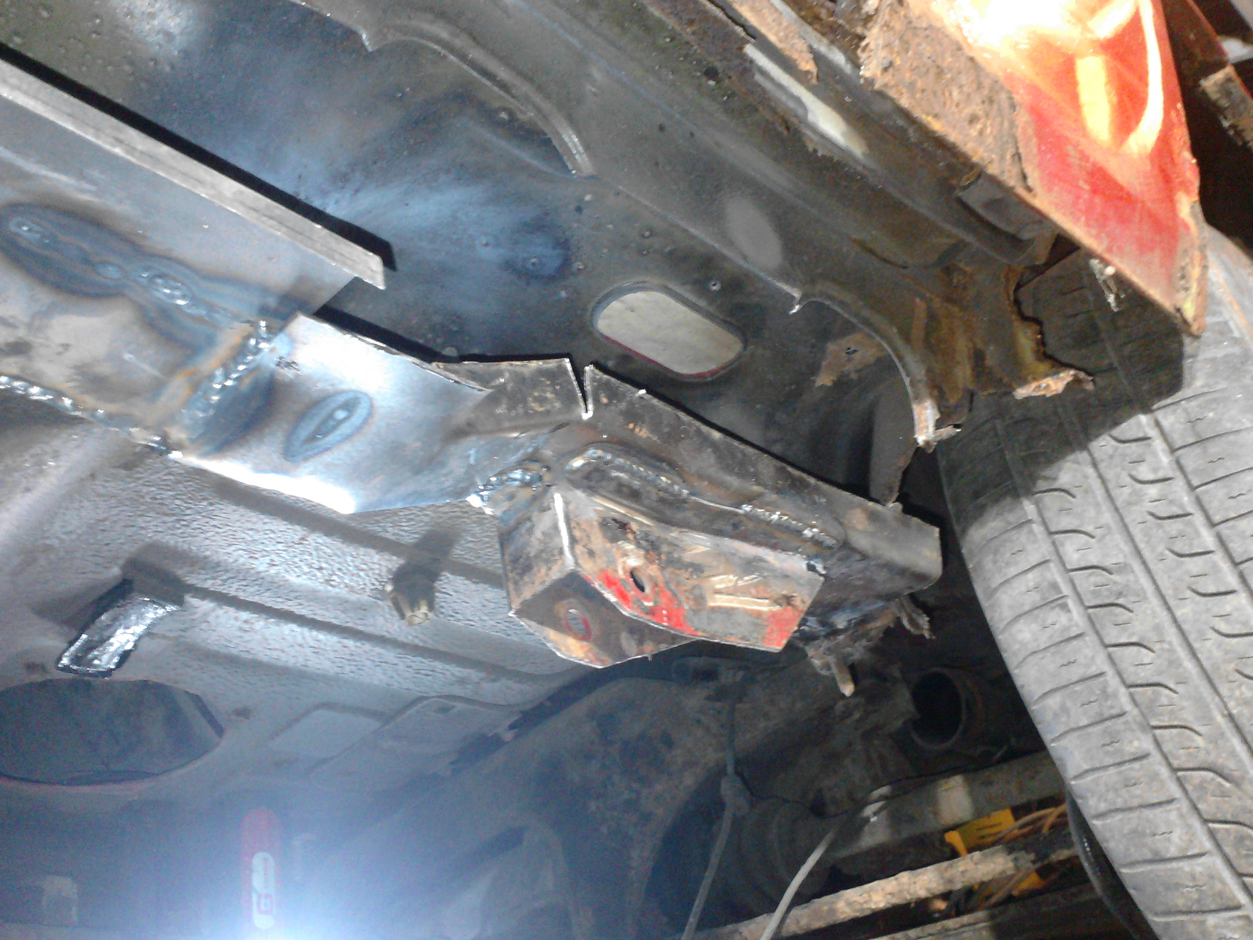

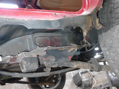

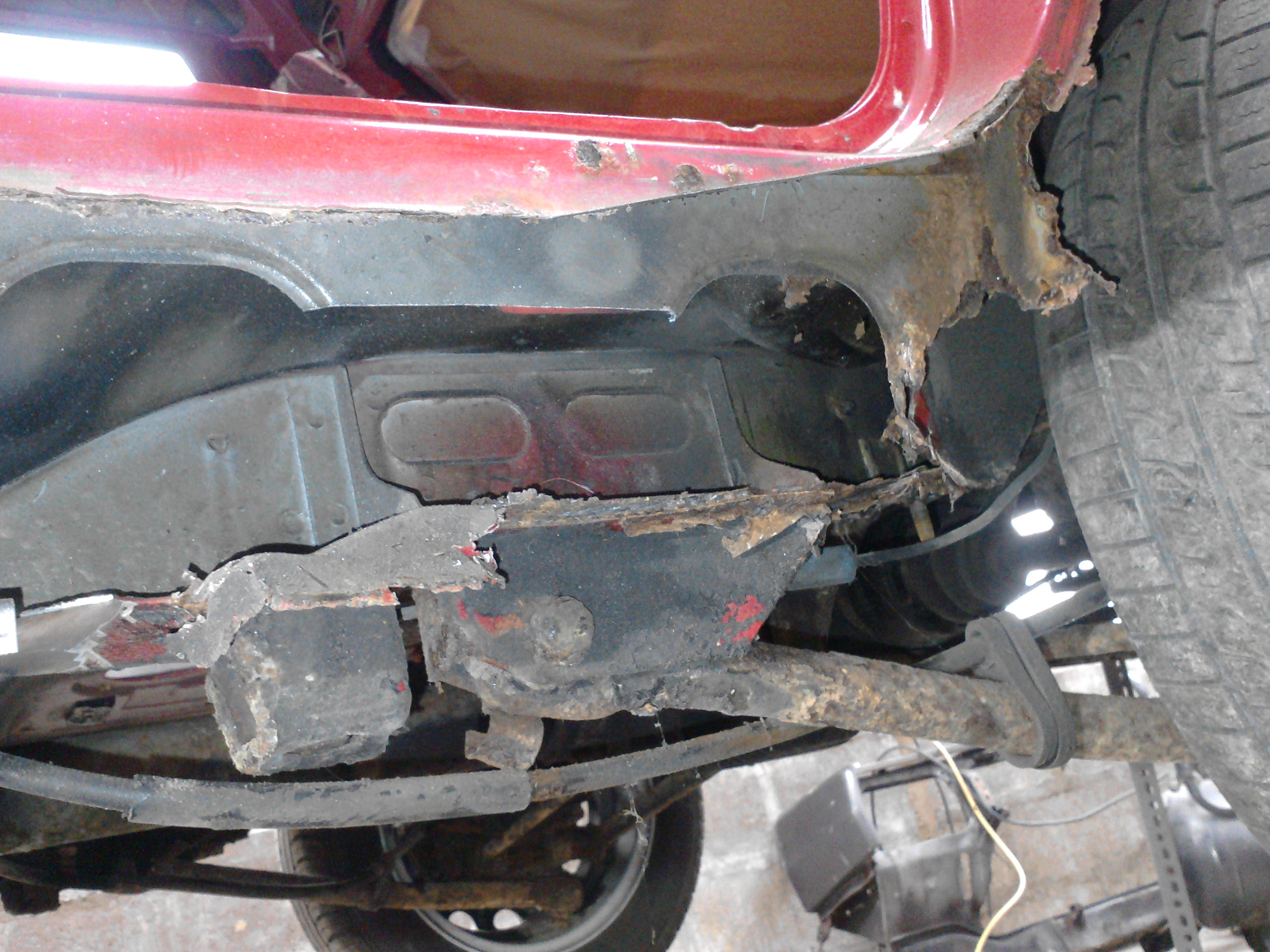

the rear end chassis section where the suspension tie rod mounts was in pretty poor shape, looked to be reasonably solid above it but up to it had all but disappeared.
on having a poke above it though some more rot was found so nothing for it but to chop out the whole mounting after carefully measuring where it went !
a repair plate was made up and the suspension mount got the remains of the chassis rail taken off it, then the 2 were joined together off the car so I could get some good welds to it
after making sure it was in the right place the plate got welded back to the car.
i'll brace it in a few extra places that it didn't originally have before boxing it all in

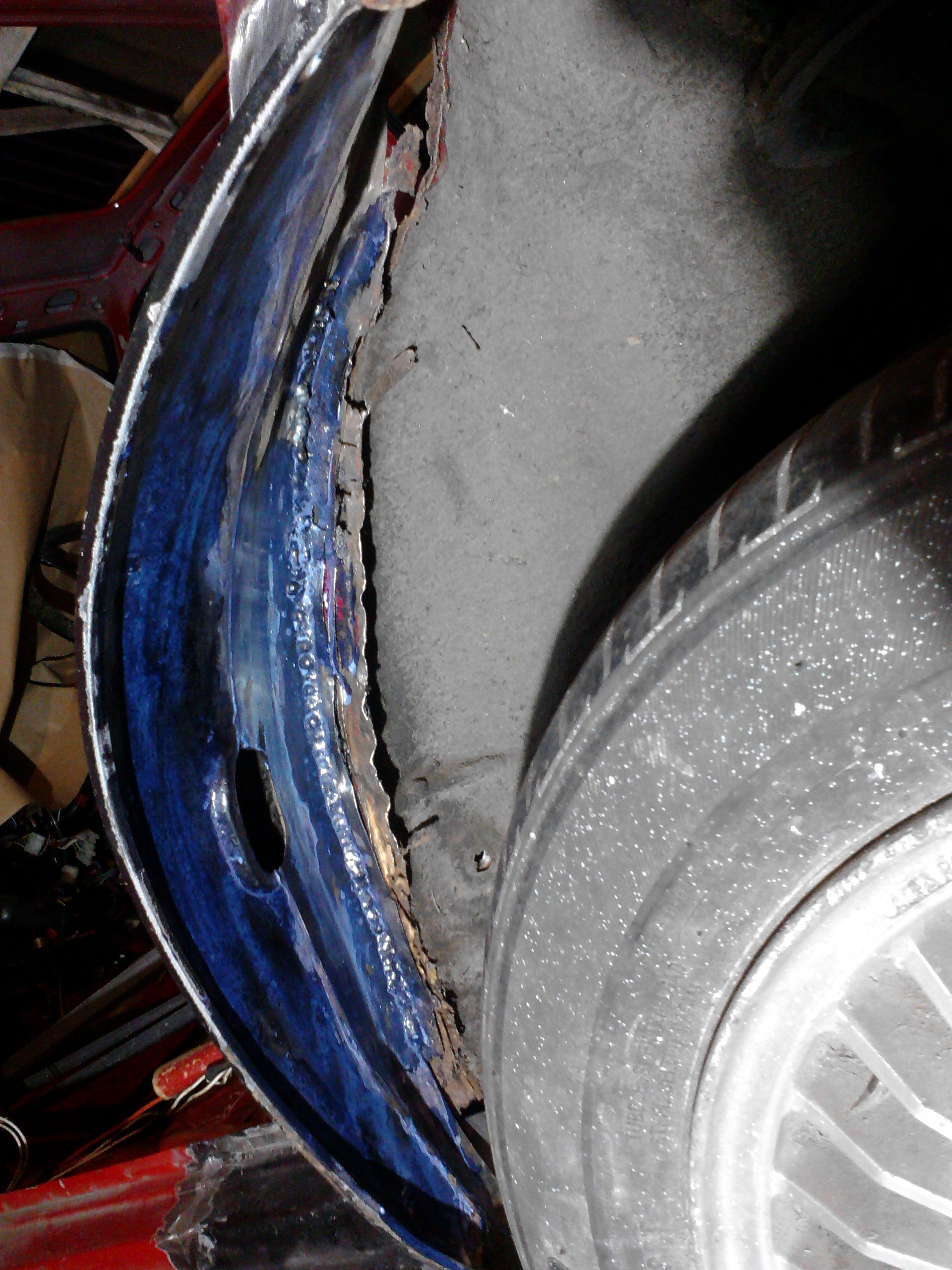

this is the corner where I've a new step/arch to fit so still a fair bit to do before the sill can go on

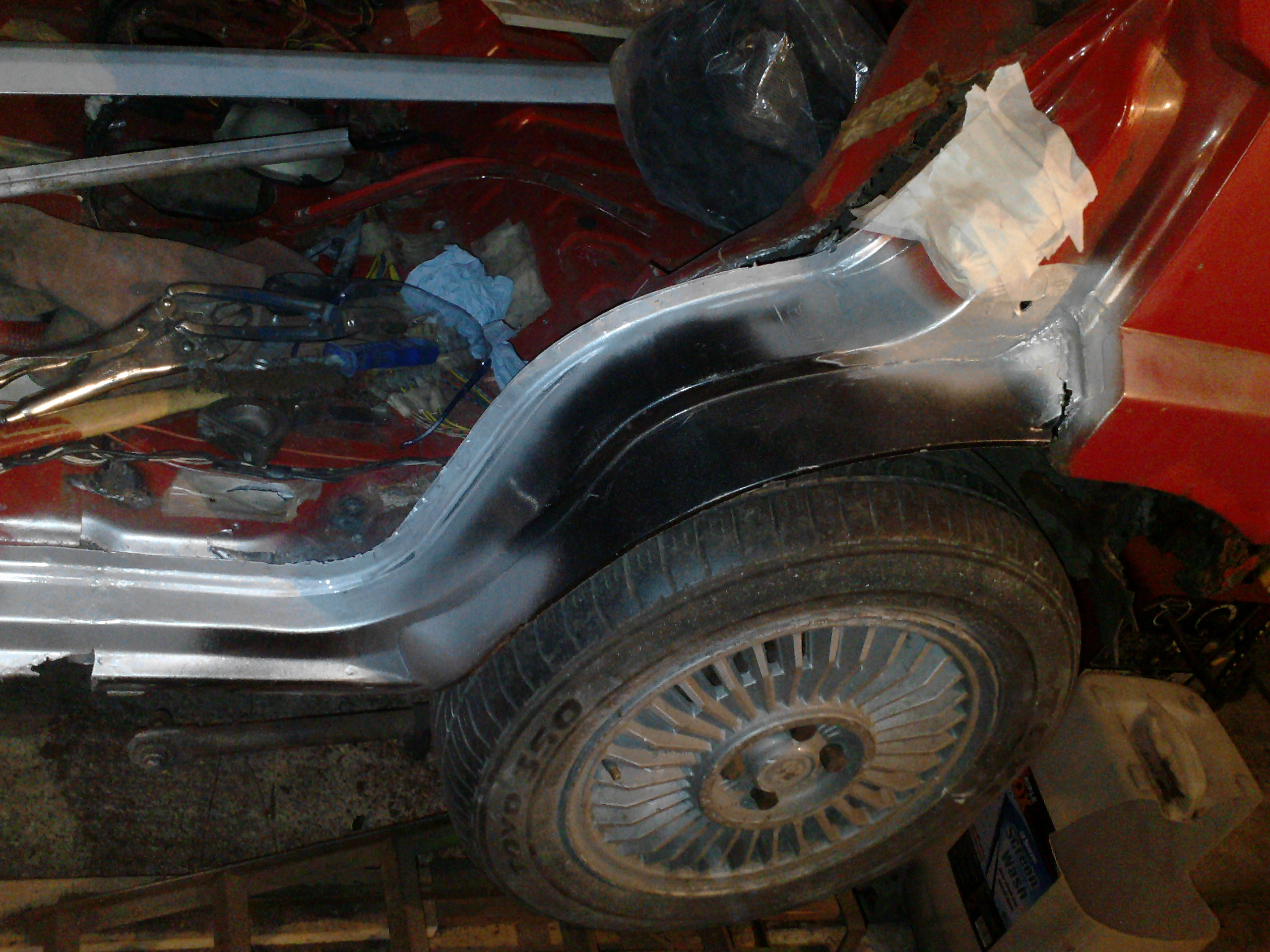

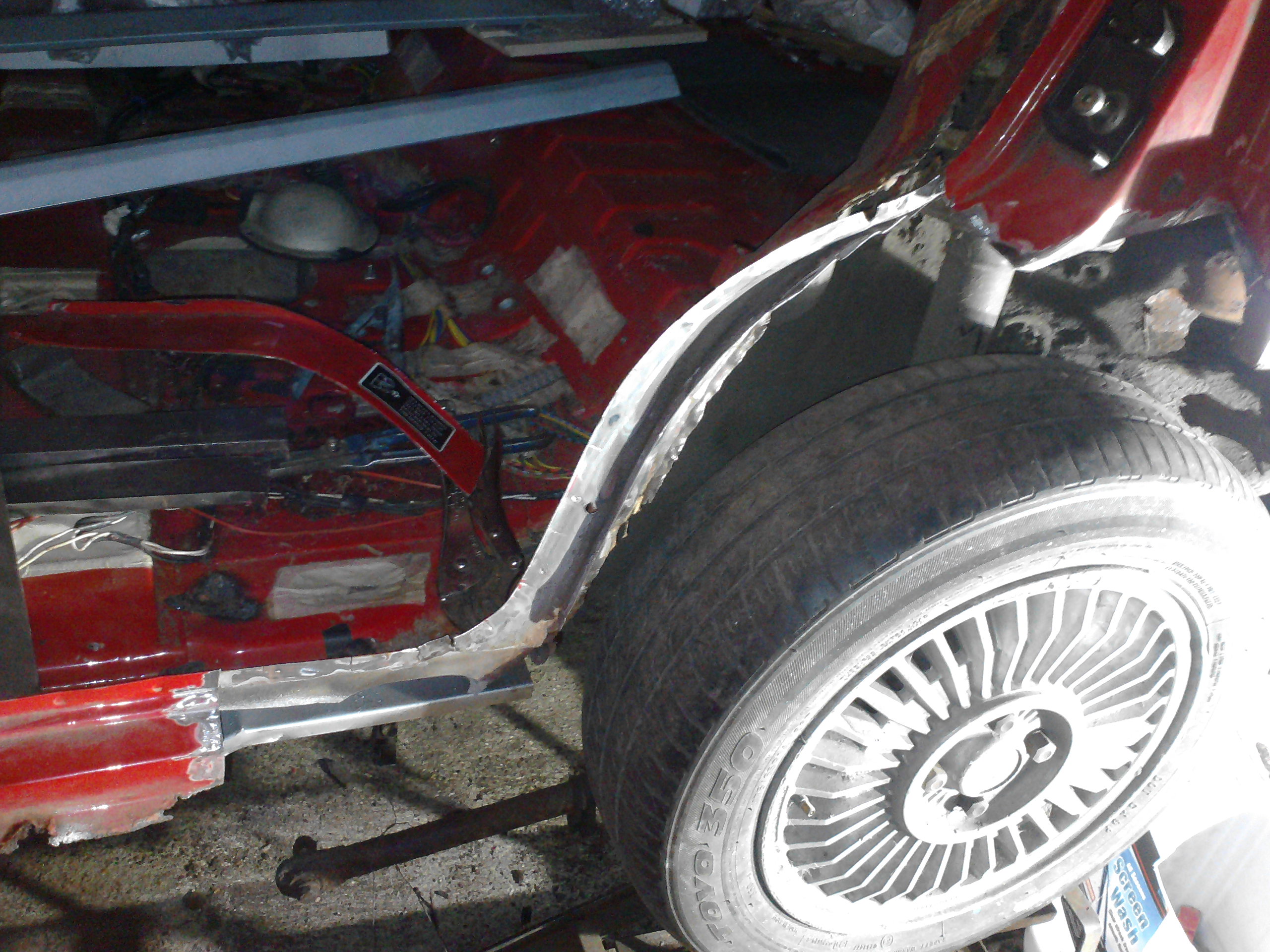

Christmas is over, there's only so much time you can dedicate to TV at this time of year, so went down to the car to have a few hours on the n/s rear arch that needed changing.

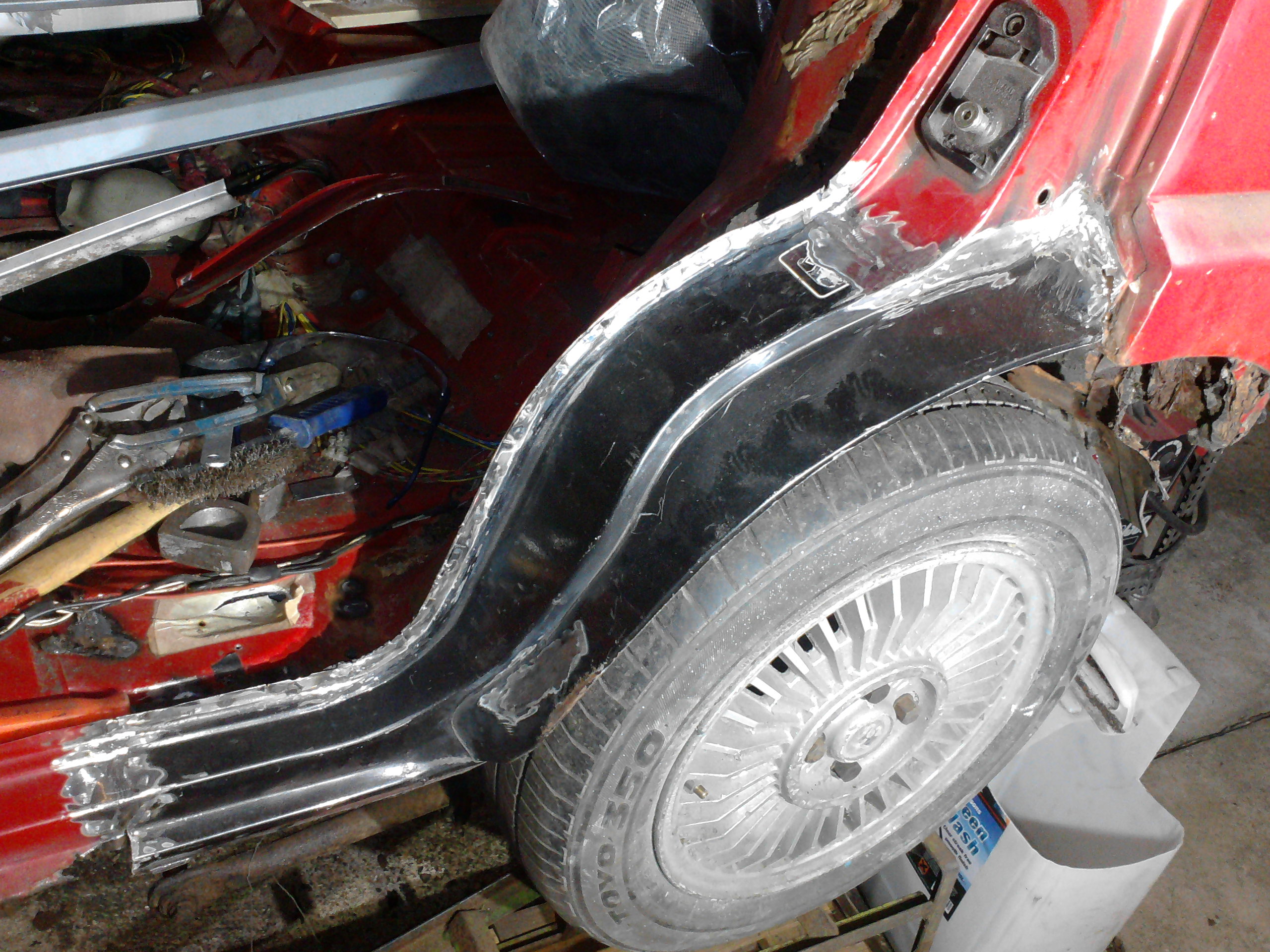

I'd got a decent used complete arch section to use so cut the original one out right back to the door seal flange and to the inner arch flange on the inside, which turns out is better than i'd thought and will be useable to some extent.
whilst the sill was open I repaired the central sill portion there above where i'd done the chassis repairs
after a bit of jiggling and chopping out in found a decent position keeping alignment decent all round.
the seal flange was spot welded in place, rest got the good old mig
the inner part lined up just nice against the original flange so that simply got seam welded
i'd already sanded it back to bare metal befiore fitting so the remaining pitted metal got a dose of rust inhibitor, soild metal still but won't hurt to have a little extra protection
once all welds were ground back it got a coat of zinc primer just to protect it whilst the work is ongoing.
pretty much ready now for the outer sill to go on and close that side in.

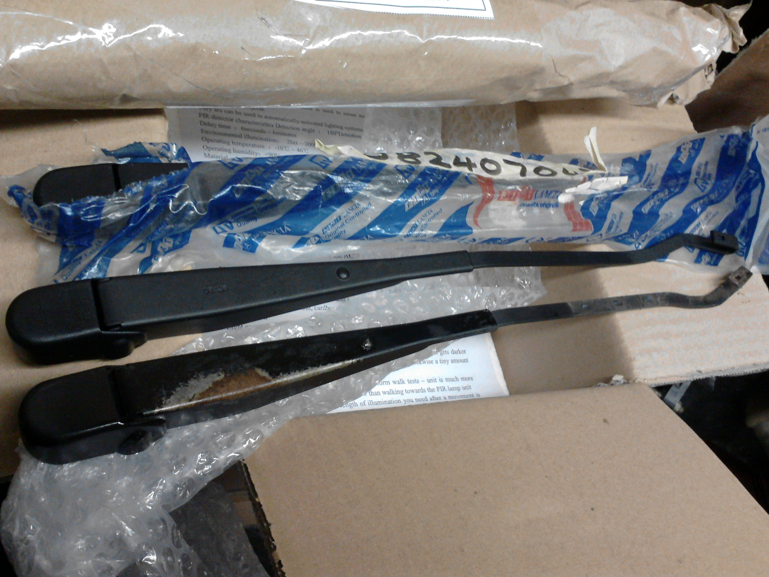

got myself a bargain in the post today.
as I mentioned a while back i'll be changing the wipers over to a proper RHD set-up by fitting a rust-free scuttle panel off an HF turbo
I have the wiper motor & linkages but the guy wanted what I considered a fortune for a pair of used wiper arms, about £40 I seem to remember.
i'll easily find some for a few quid I thought......
so after a month or two of asking everywhere that was breaking delta's I came to the conclusion that it wasn't gonna be easy, got me thinking i'd have to chop the original arms and weld them back round the right way (wrong configuration is easy to spot below on the old LHD ones).....said i'm tight :)
but last week up popped a new old stock, genuine lancia wiper arm for £6-95 + £3 P&P.........and he had 2 :D
clicked the buy it now sharpish, before they disappeared.
seller even refunded one of the postage rather than charge me twice, not all sellers do that nowadays on ebay, top man ;)
so a pair of brand new ones for under £20, and I won't have to sand & paint them, bargain!!

Now that's a result. Little fish are sweet as the saying goes.
What a result !! Nice one.
Don't you just love it when that happens. :)
turned out just great guys, love a bargain.

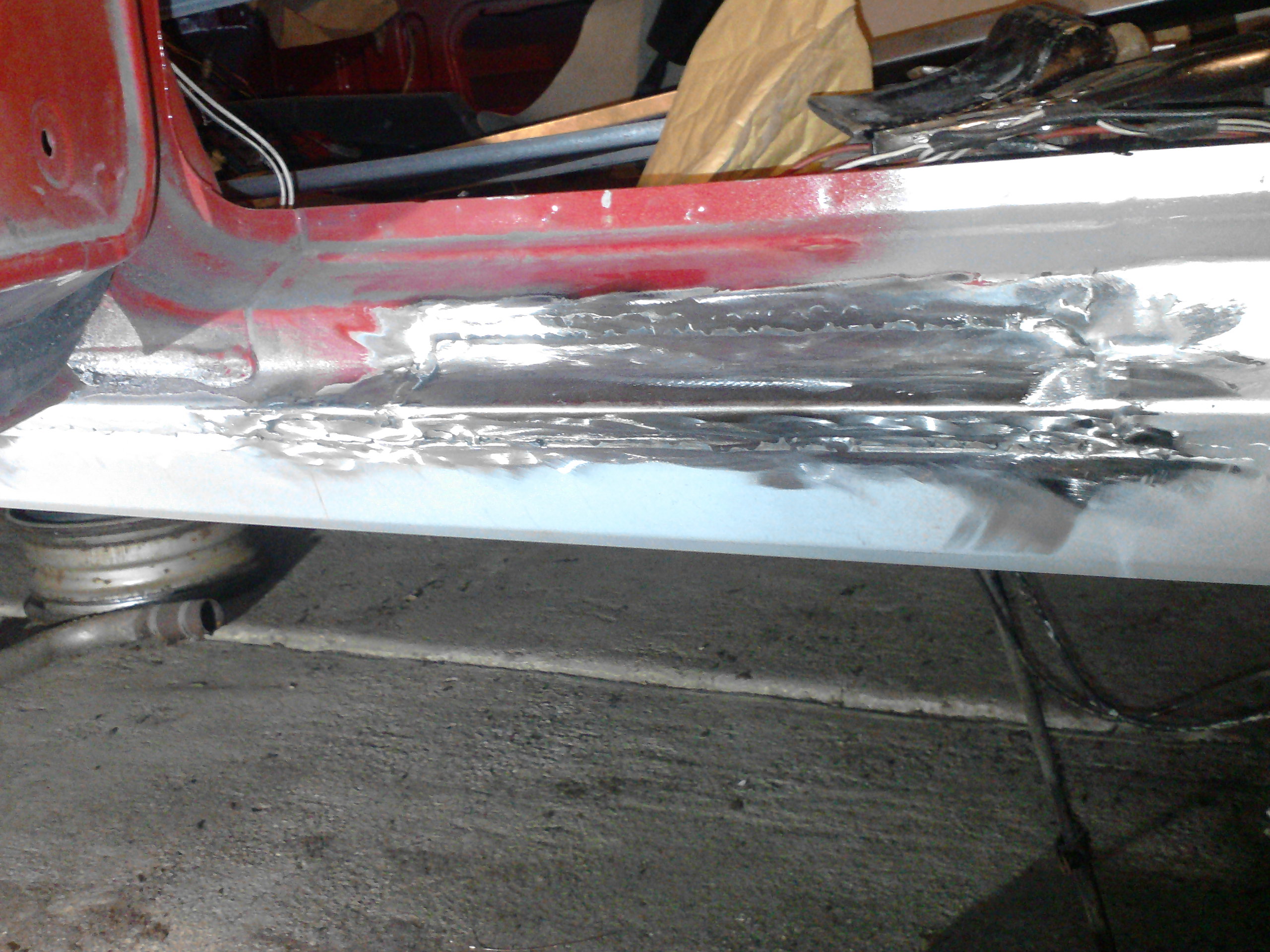

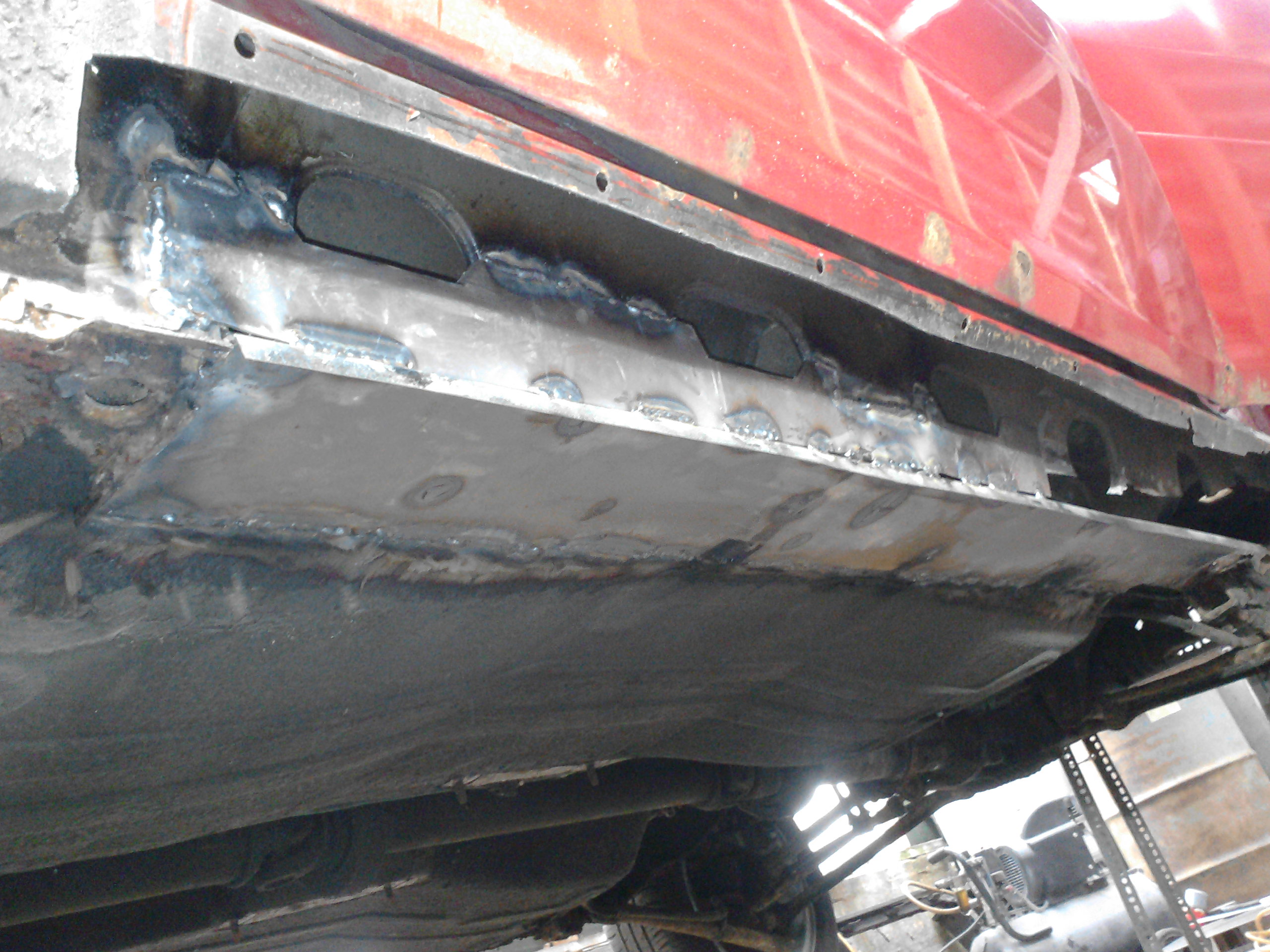

got the central section repaired on weds in the little time I had spare, plus tidied all the old metal off the jacking point and welded that in place.

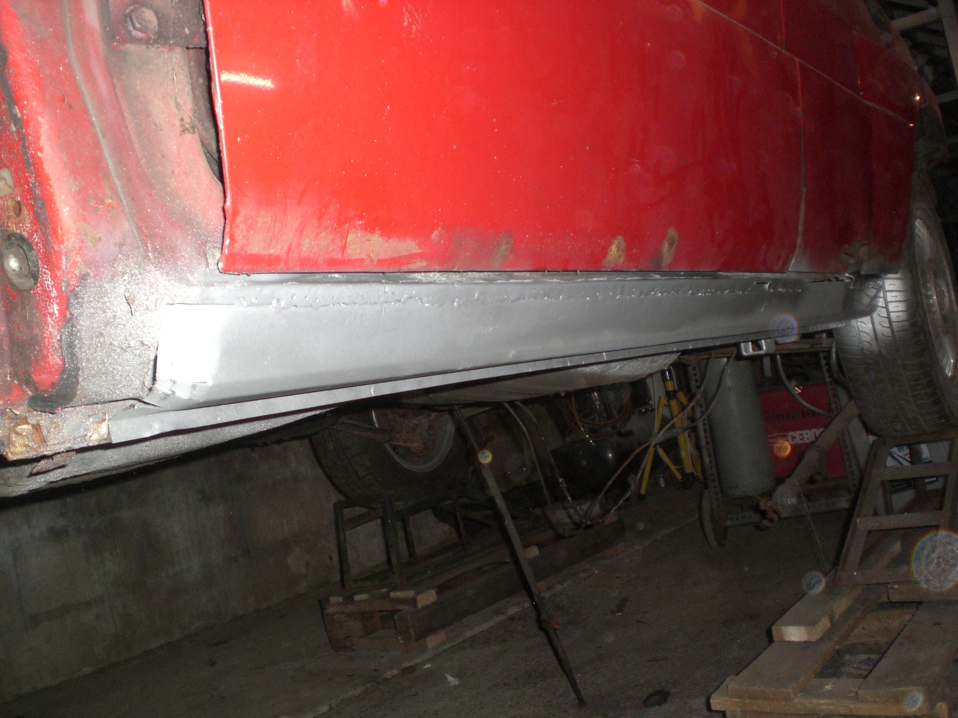

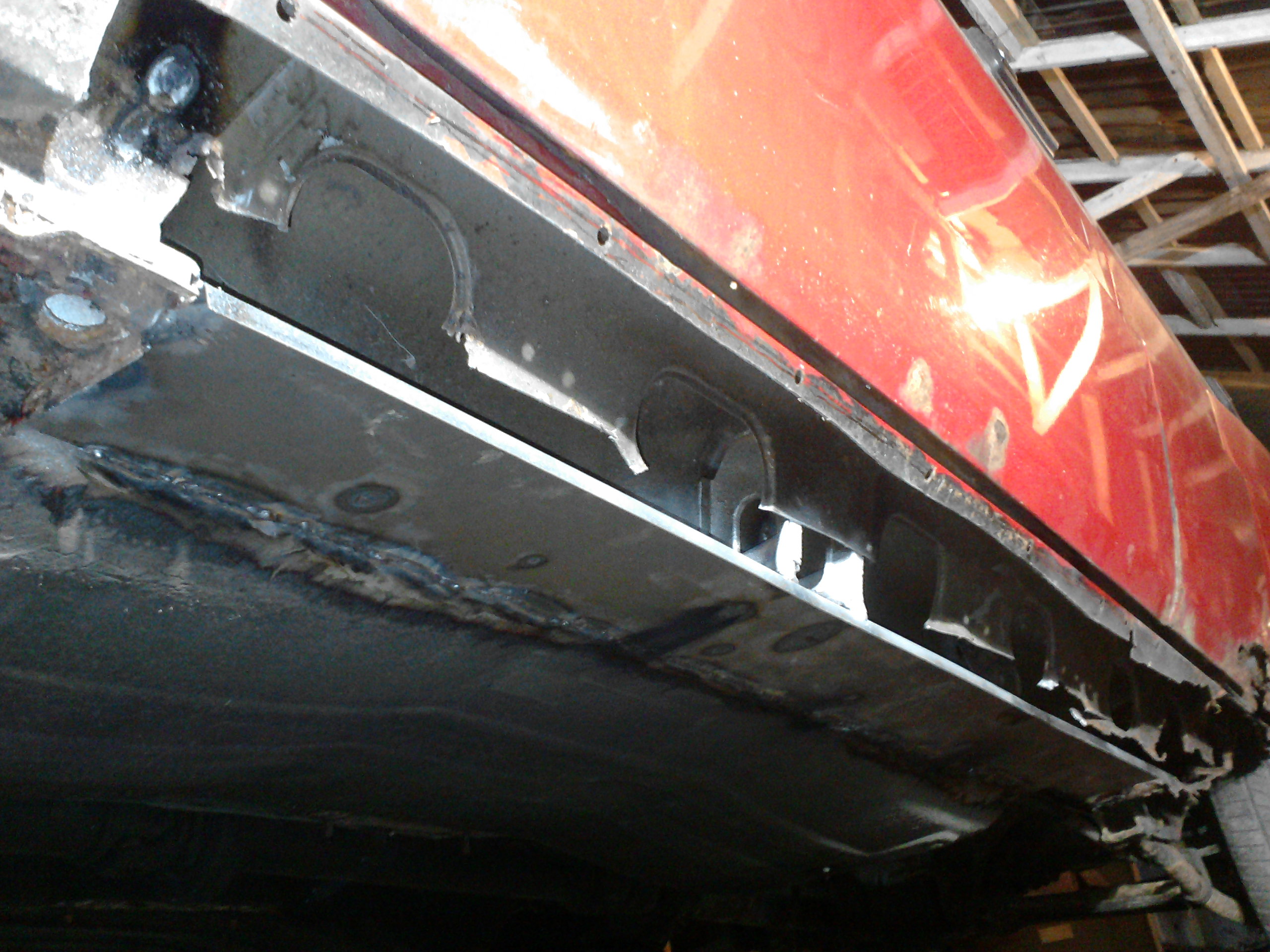

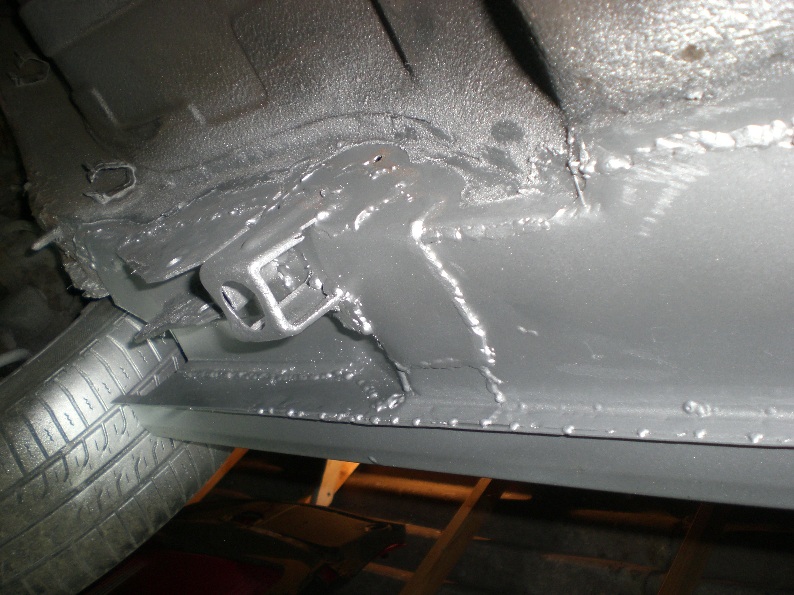

today I managed to finally get the outer sill fixed in place.
the top joint has a joggled finish on the new sill so that was fitted under the original sill which leaves a nice channel to weld into.

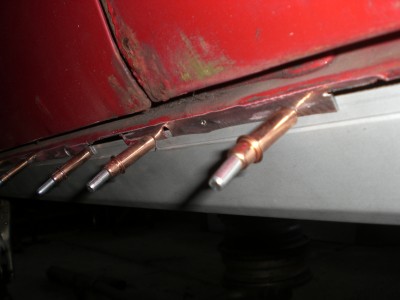

i'd been pointed to a better way of holding the 2 edges together using cleco fasteners. simply drill a hole through both panels then insert the cleco fitting using the special tool, which when you release it the 2 halves get pulled tightly together
bottom lip was spot welded all along it's edge with a few token tack welds behind where there was a little overlap behind.
rear section around the jacking point and suspension mount, once tidied and sealed it'll look better
a protective coating of etch primer will keep things ok until it's bodywork time
just got the front end to seal in but a bit more work around the wheel arch area too, then the back end needs capping in before going up into the strut tower....a bit of a start to the welding but loads more to do
with upcoming projects though i'll not get too much time on it, not as much as i'd hope to get but once spring comes i'll be able to do a few hours after work with it being close to home.....unless circumstances change....
Excellent progress Kev.
Suspension and jacking point you fabricated has come out really good.

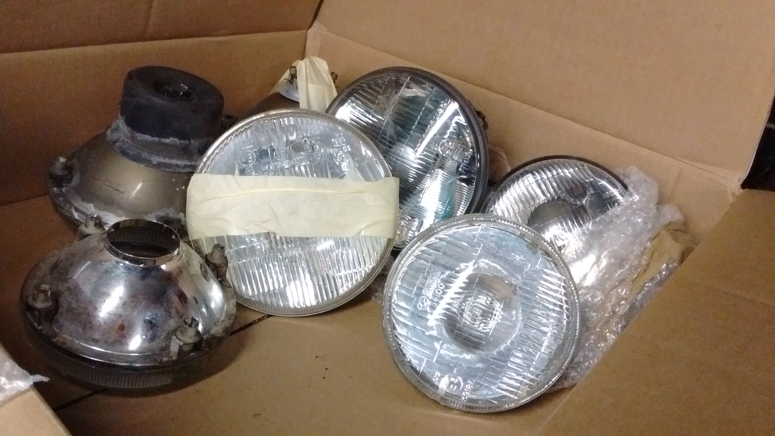

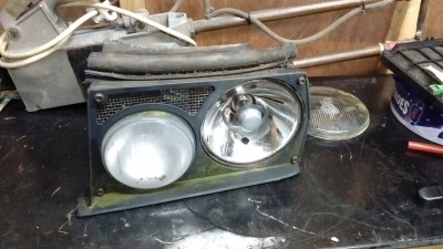

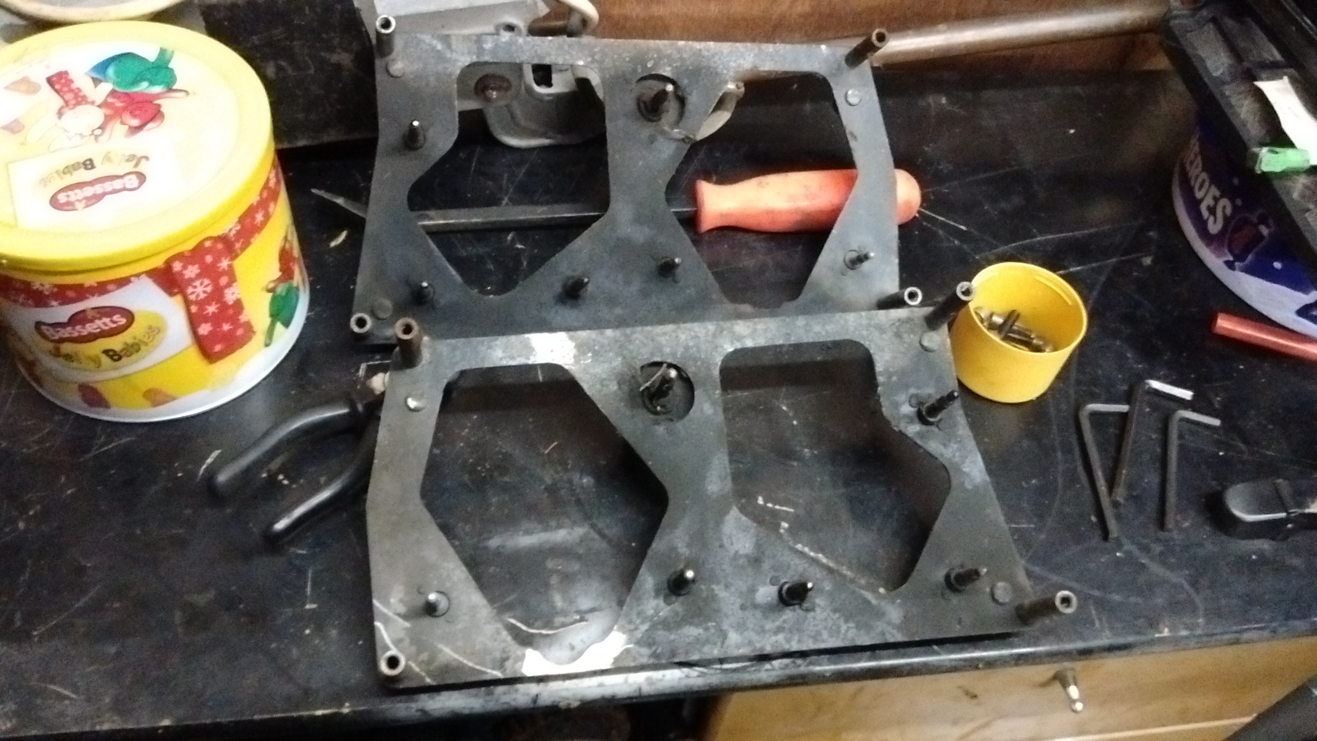

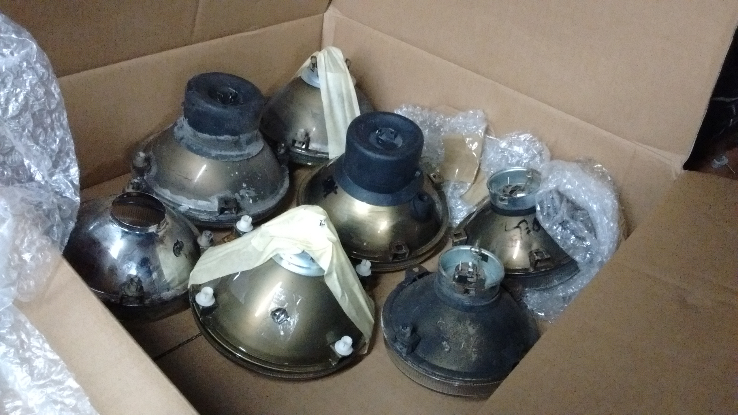

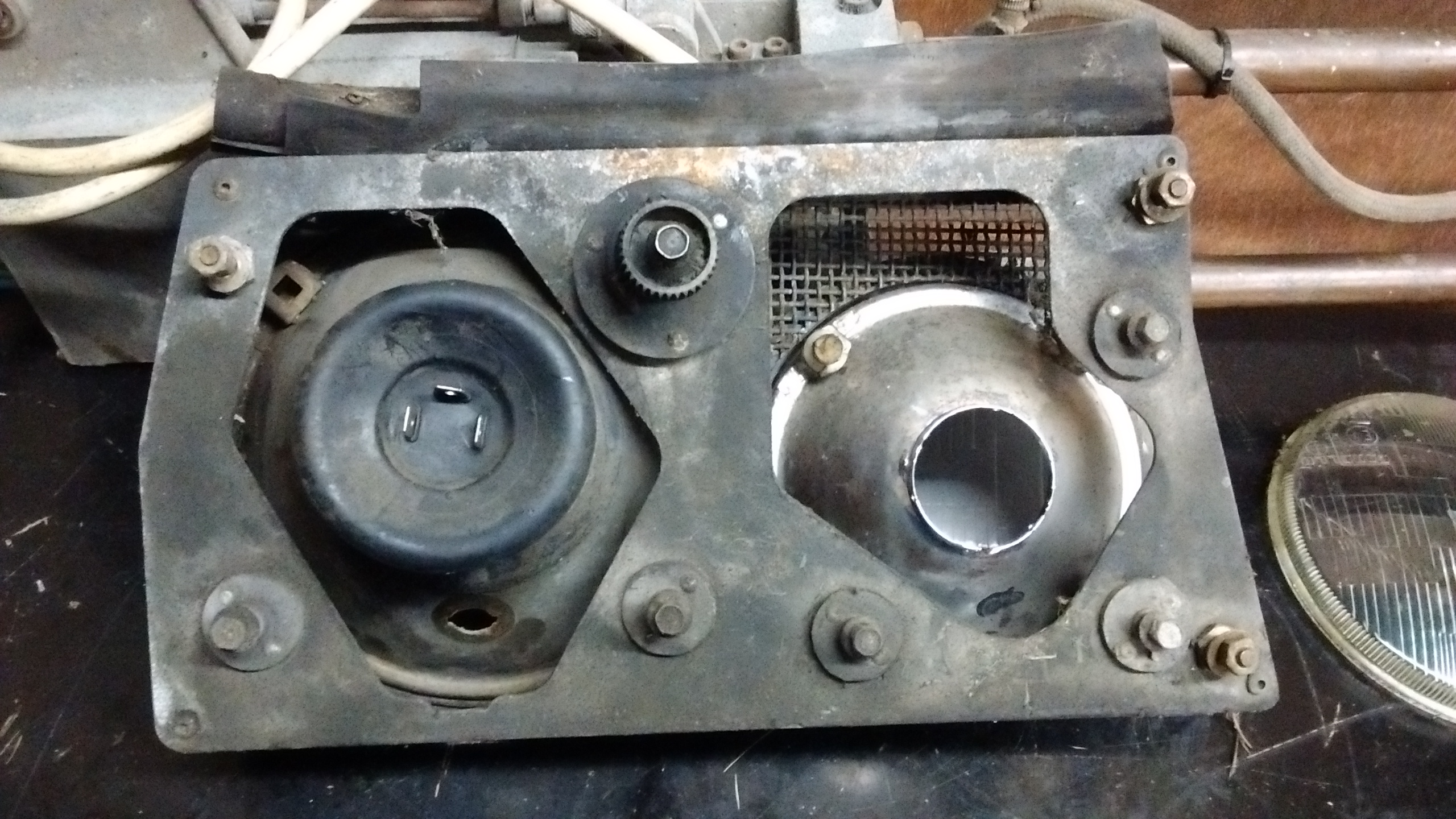

had an hour to kill tonight so with progress on the car looking like being slim to none over the next 3 months or so I set about taking the headlights apart, now I've got some new/very good headlights to complete the full set
at the moment there is a mixture of broken, even missing lenses and poor reflectors
the front covers came off easily enough, 4 allen key bolts per side and only 1 was remotely stiff so no issues yet

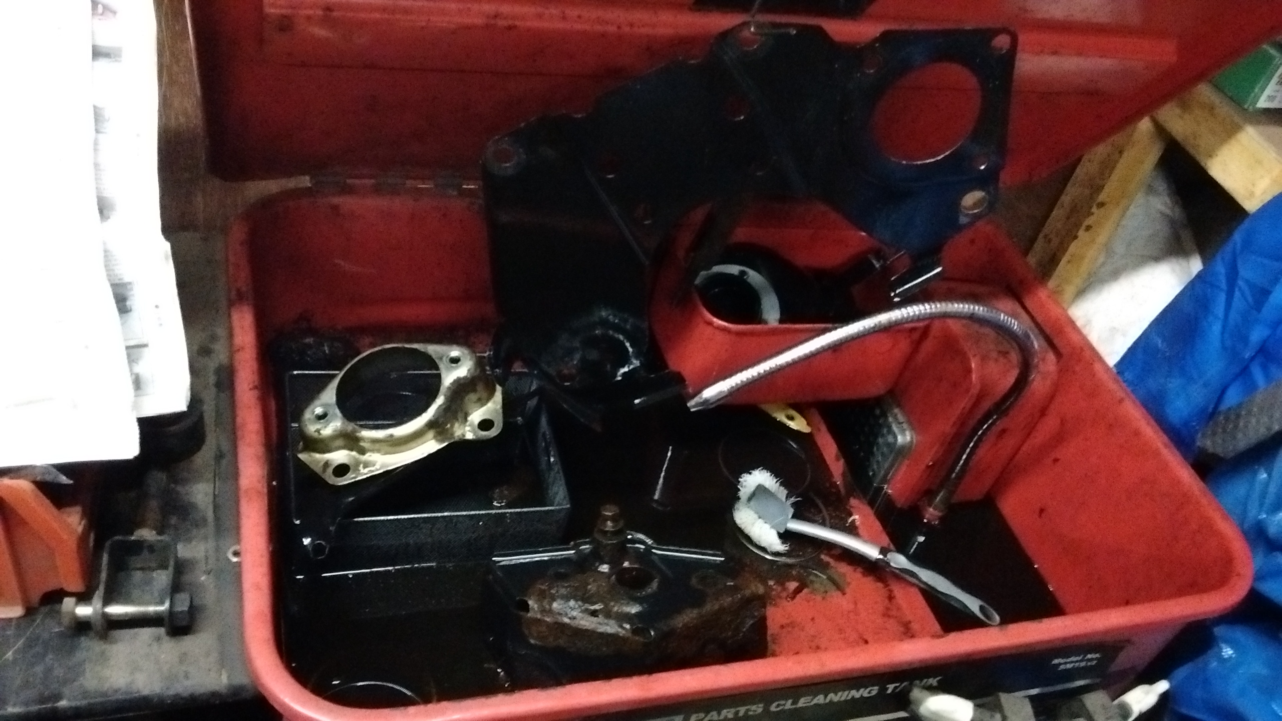

uncovered the parts washer which wasn't as buried as usual!
I use paraffin in mine, mainly because I'm too tight to buy the proper degreaser......well only because I'm too tight actually. it does a great job though and isn't harmful to any plastics or alloys so is equally at home cleaning pistons as these headlight backing plates with the plastic fittings

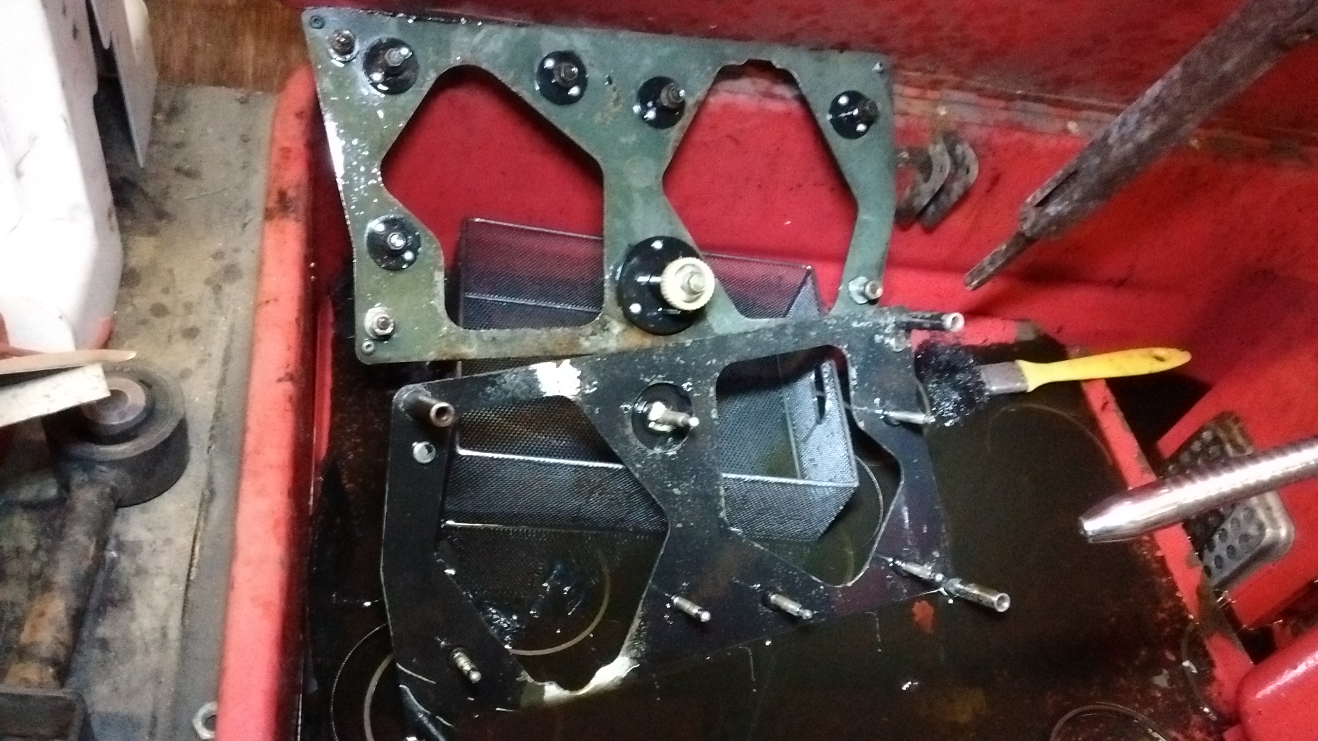

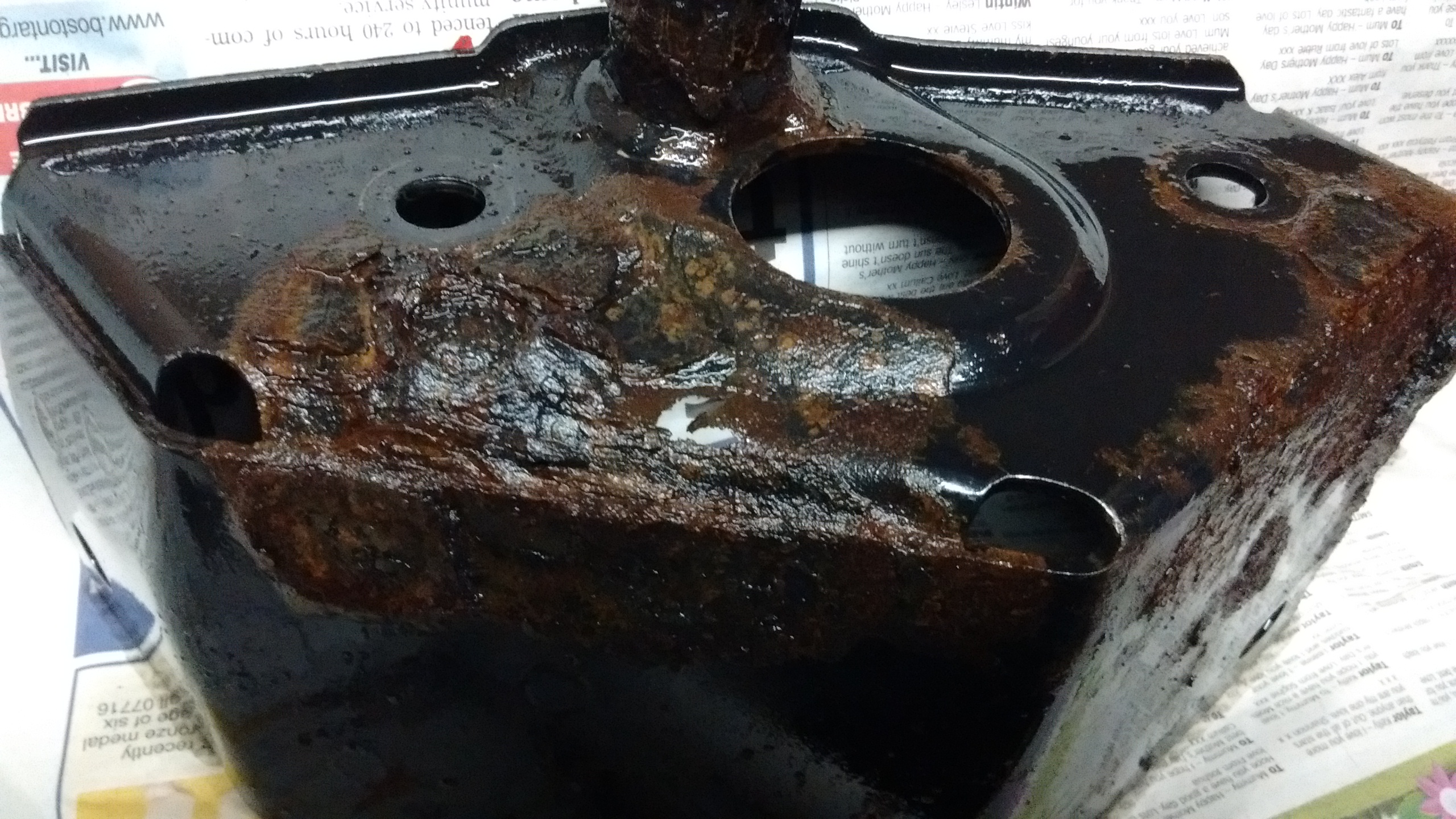

whilst at it I cleaned up a few gearbox and engine parts that had been lying around, mostly covered in years of grime
one engine mounting plate revealed that under the dust and filth it has actually rotted out! needs a bit cutting out and welding in, shouldn't be too much of an issue, lovely thick steel is a pleasure to weld
as I said, I've now got enough decent lights to make a good set. even managed to find one NOS item that was rejected for a loose glass which I'll bond back in sometime

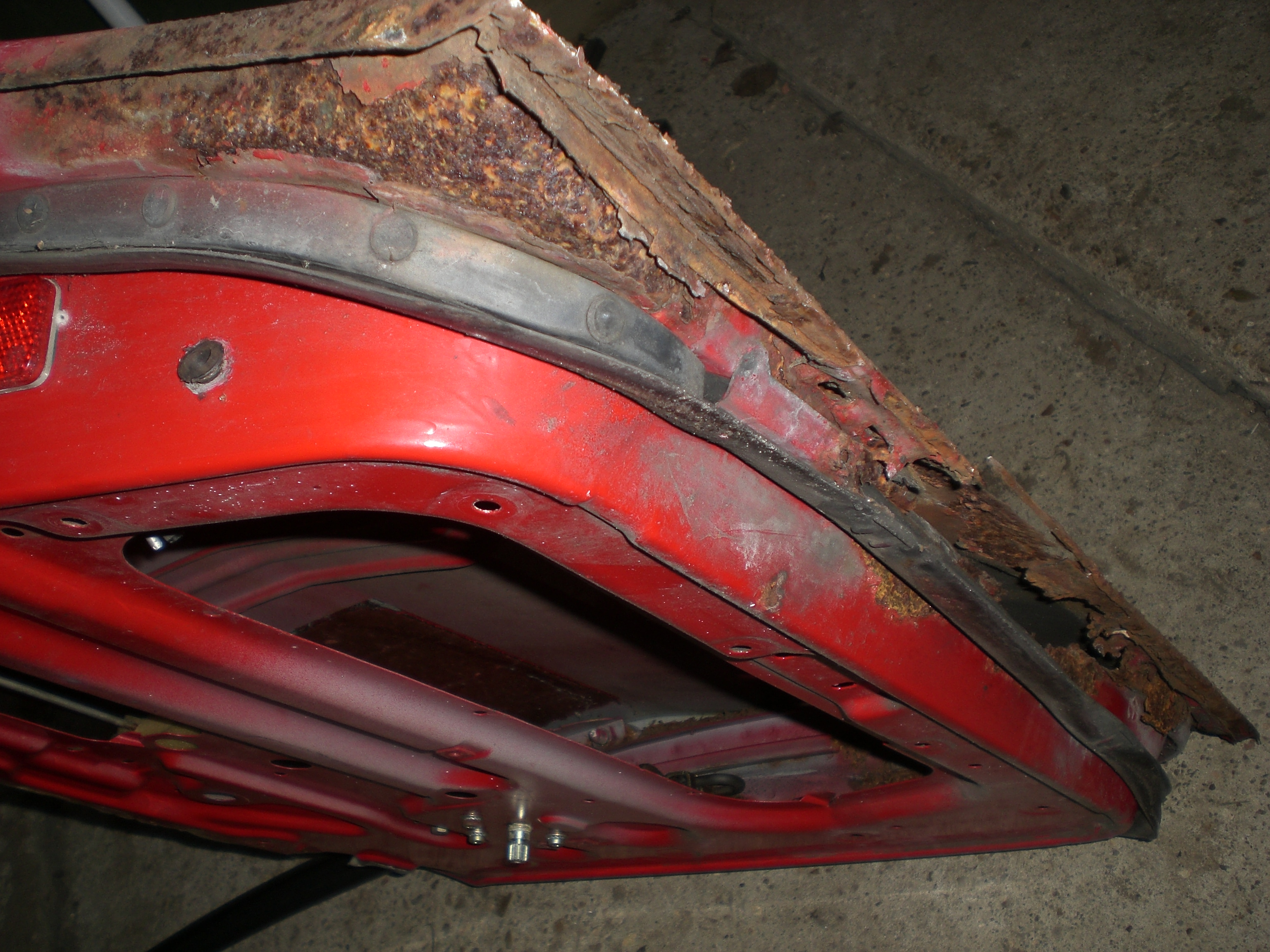

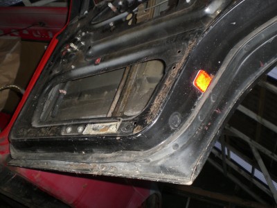

the underside of the black door is much better, hardly anything to do but the colour change
the old red one had a few holes on the outer skin and underside

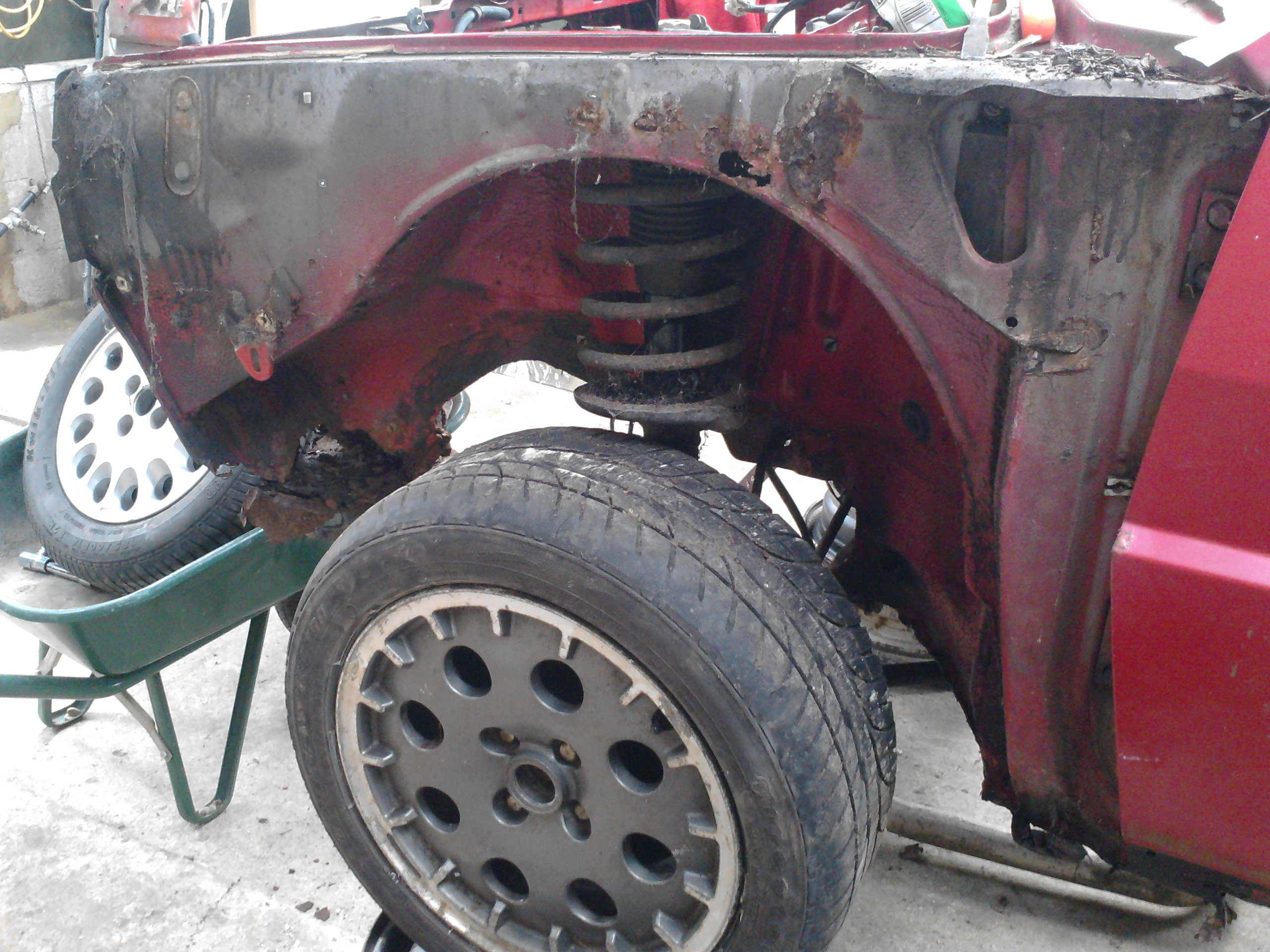

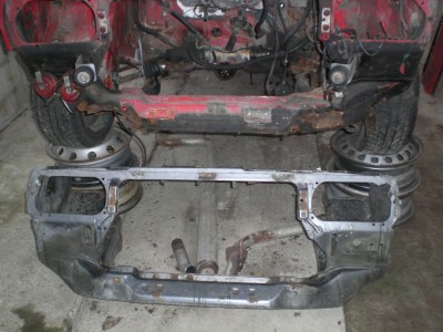

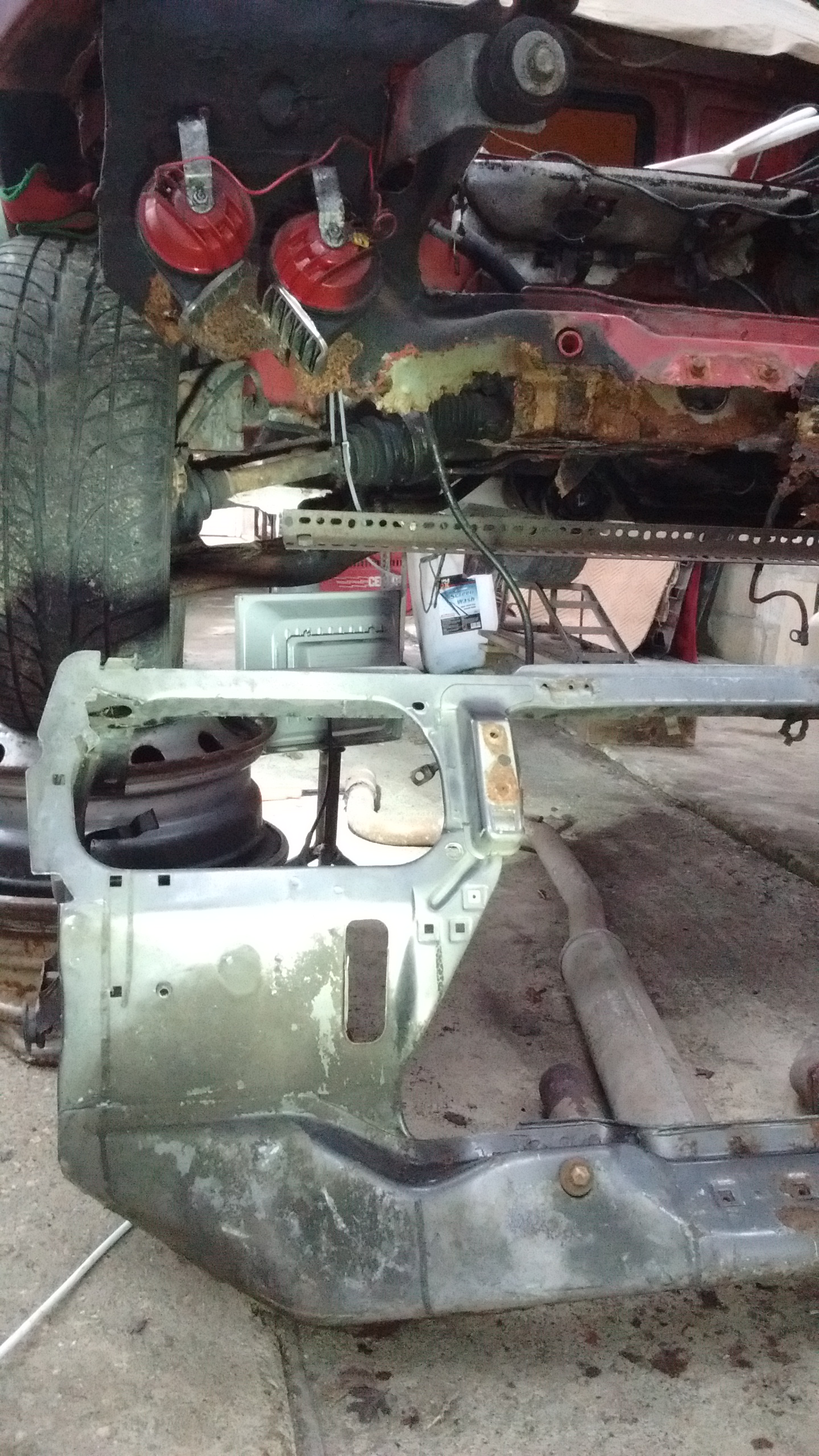

after not seeing the old girl for a few weeks I've well and truly got the itch again to get stuck in, shame that i'm gonna be too busy over the next couple of months to do much at all. at least by the time I get back to it the weather will have improved :D

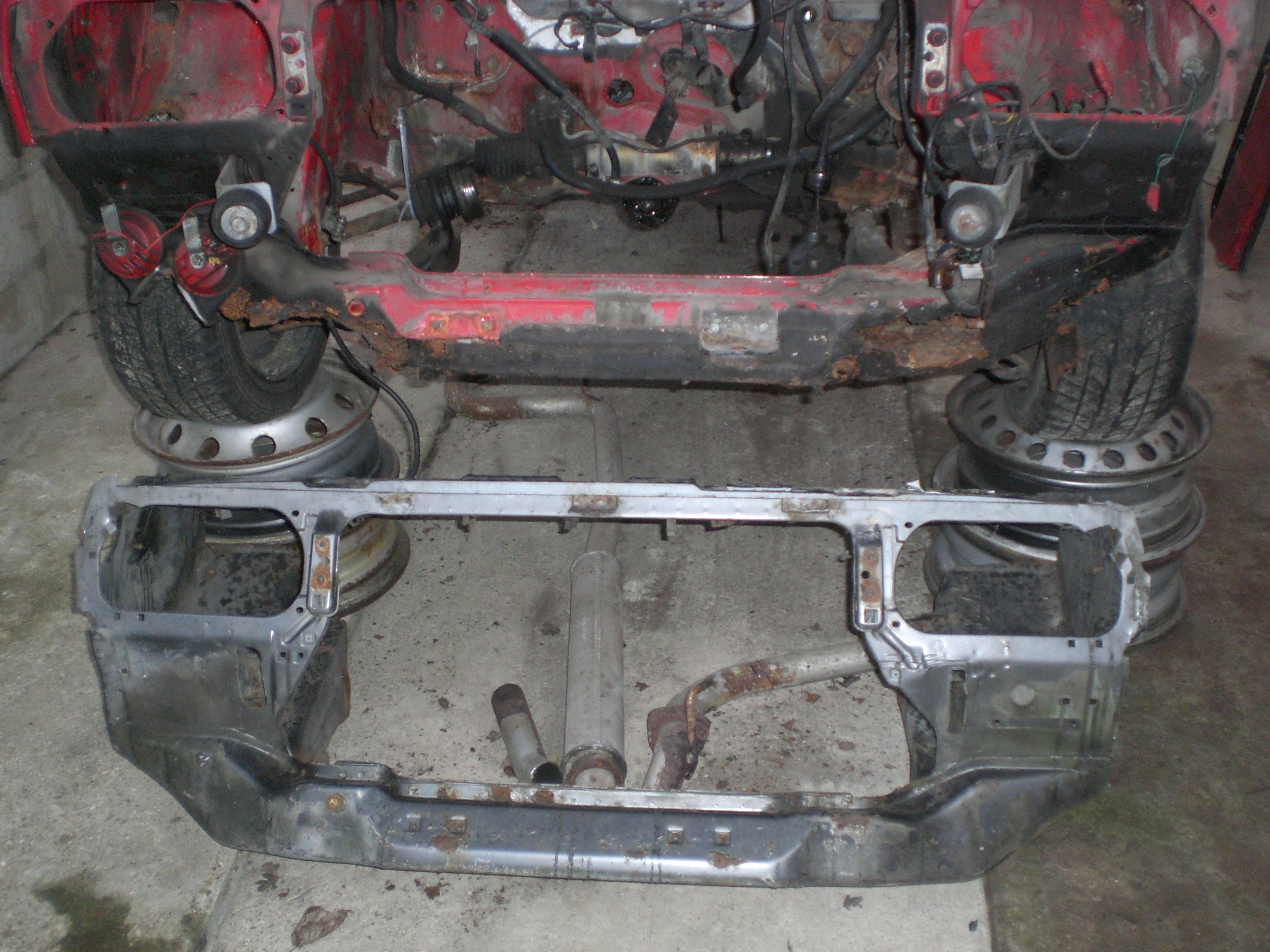

managed to get myself another front end this week, the one I got before was for an HF turbo not an integrale, there was quite a few differences that could have been overcome but it would have been a fair amount of work
I had tried everywhere to get a new one but none are available, this one popped up and I had to have it
as you can see, it is in much better condition than mine!
corners need small repairs where all deltas rot out but the rest is very solid, should make repairing the front end much simpler

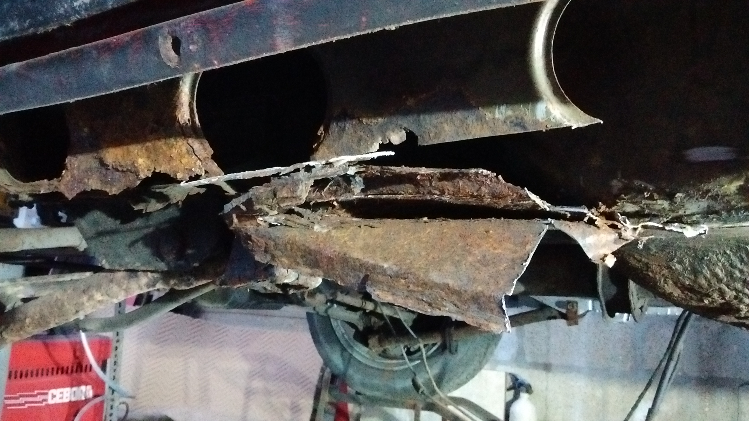

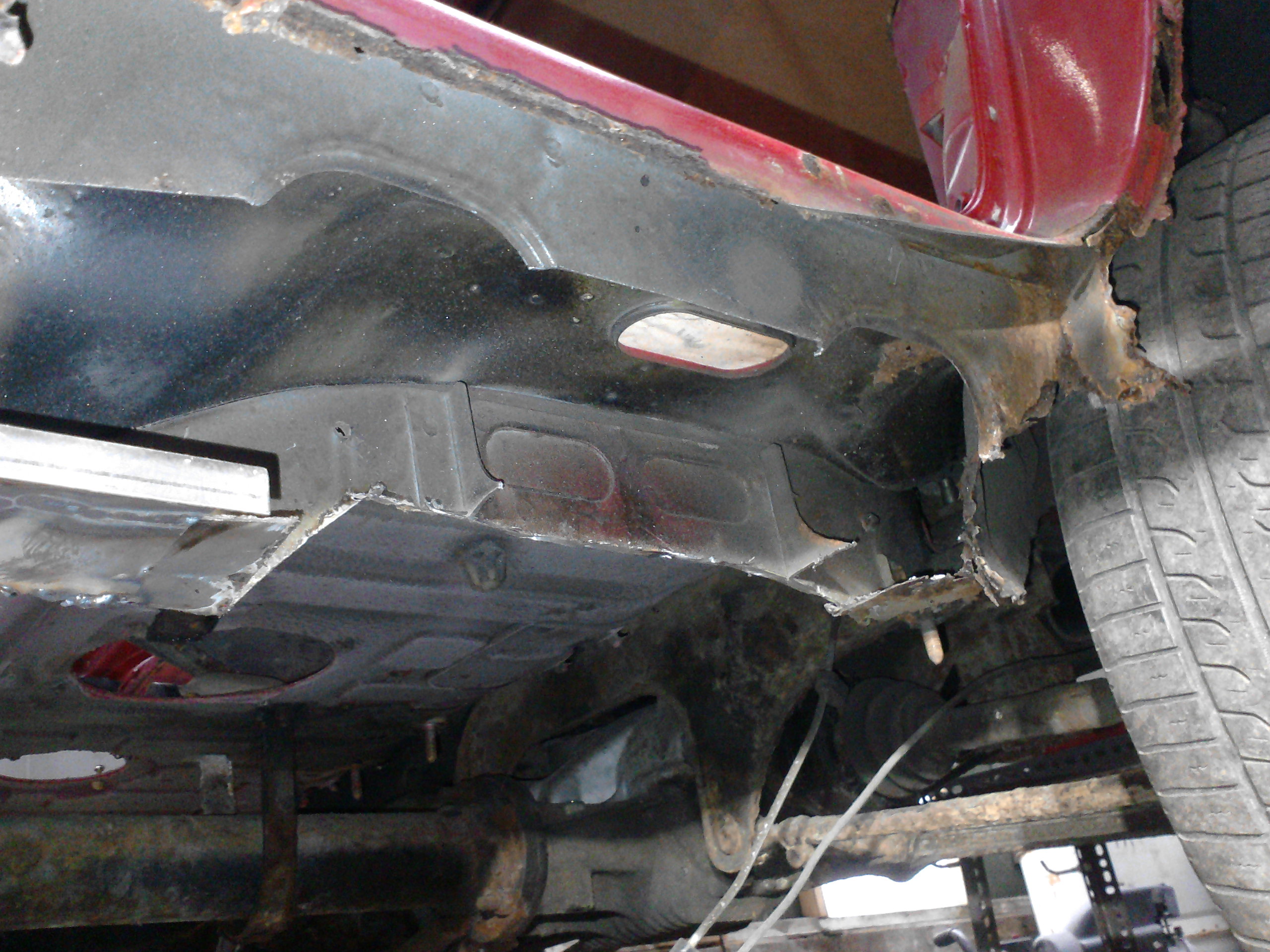

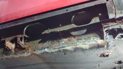

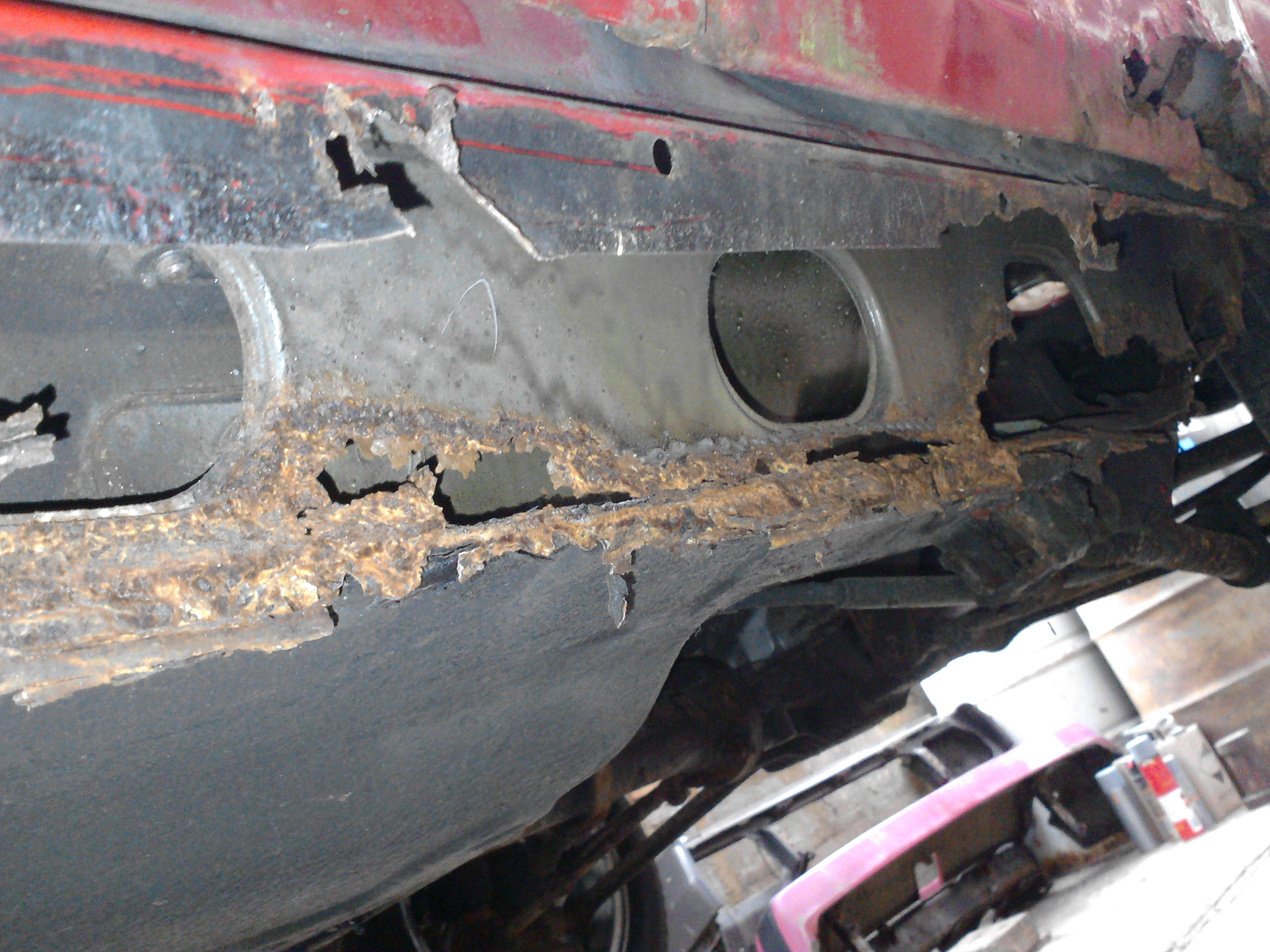

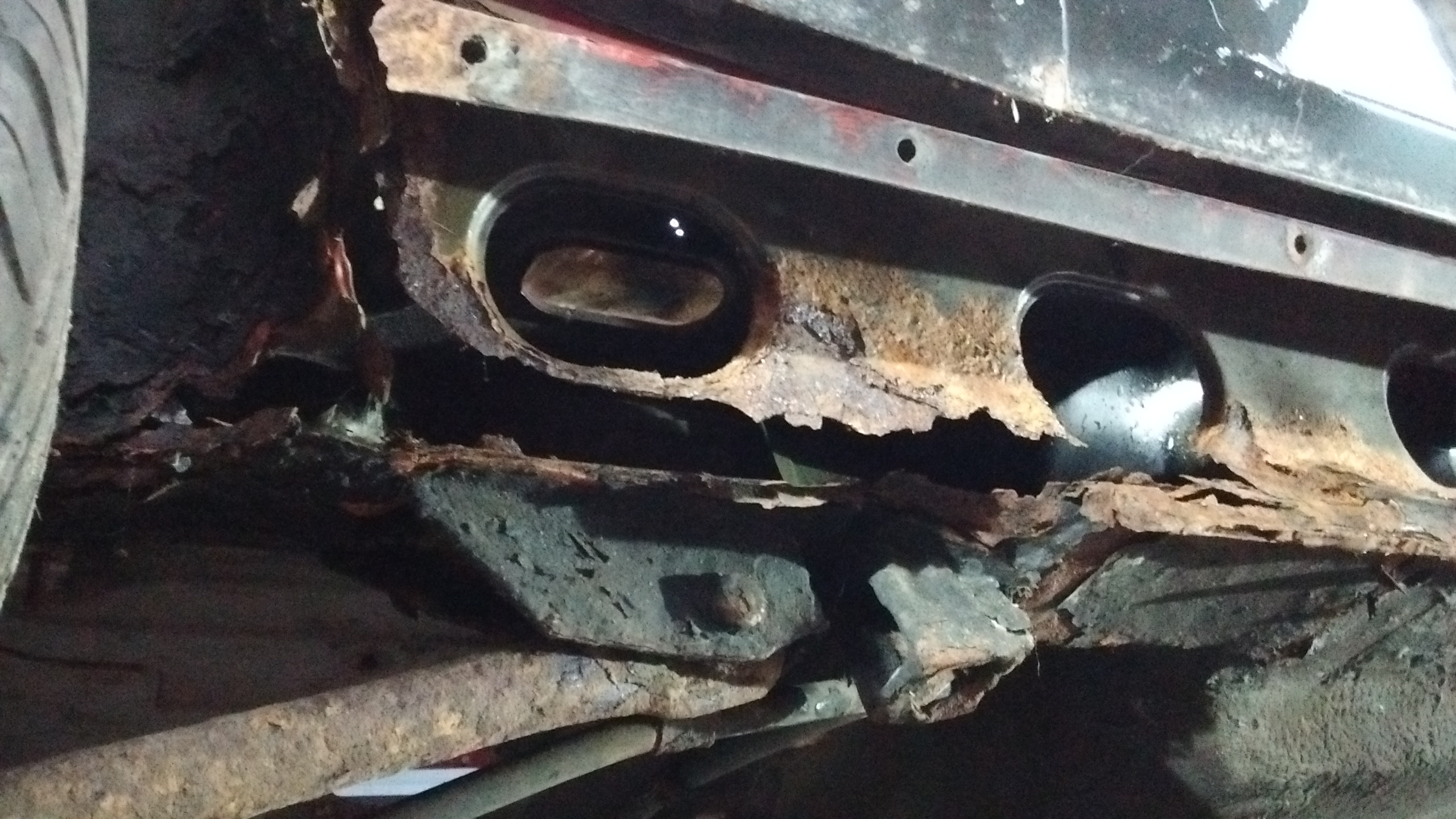

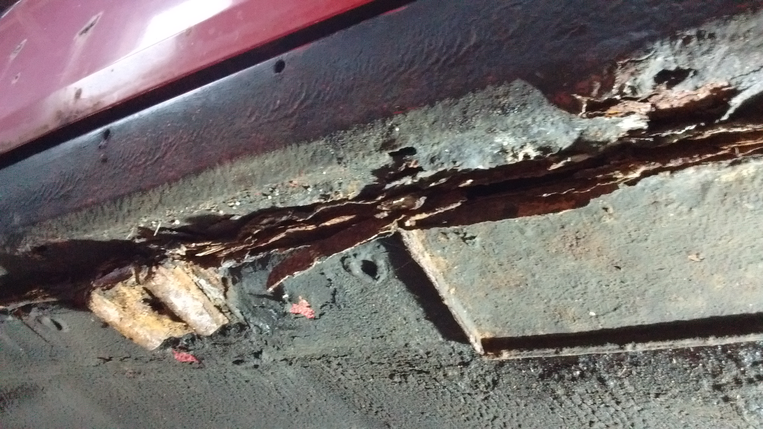

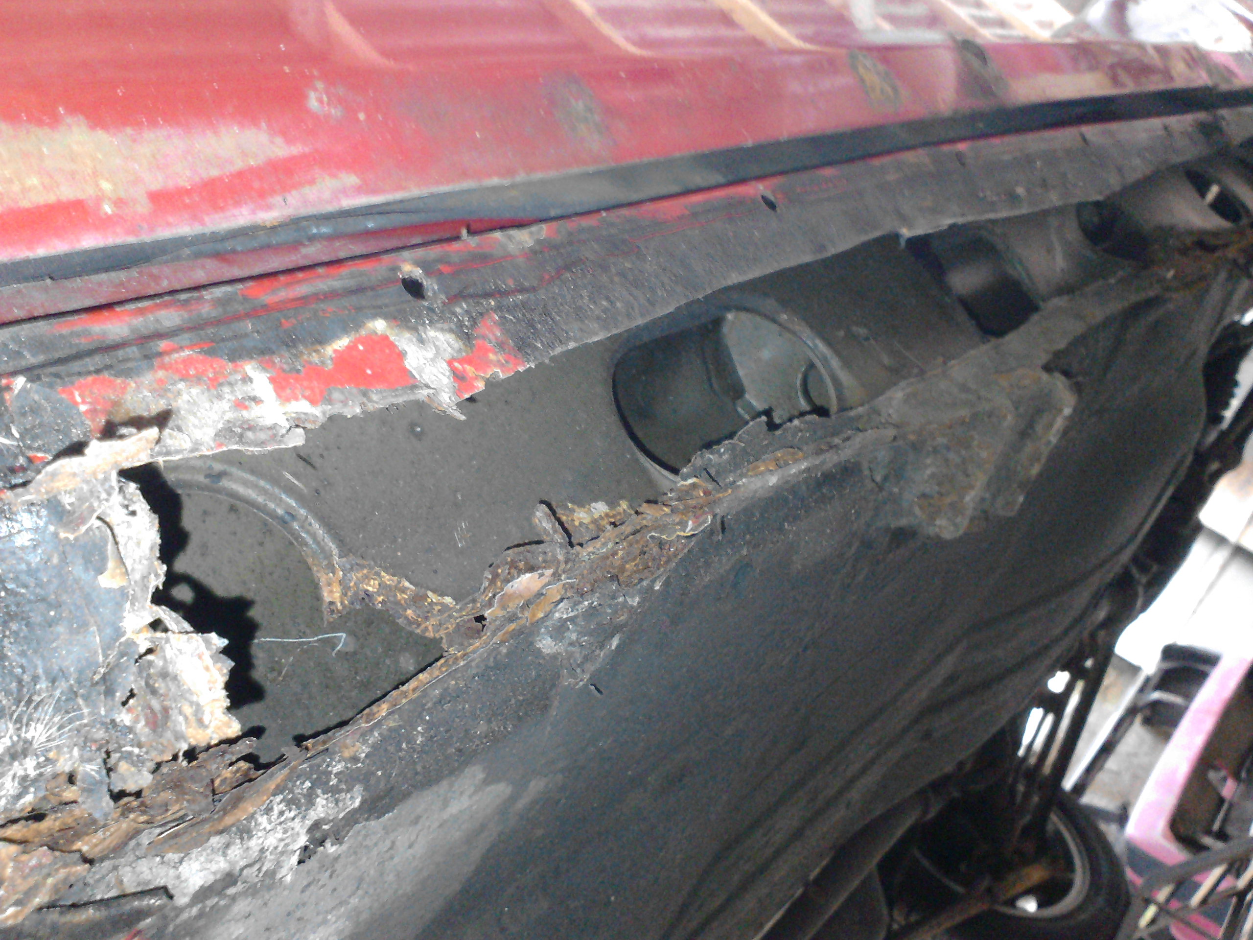

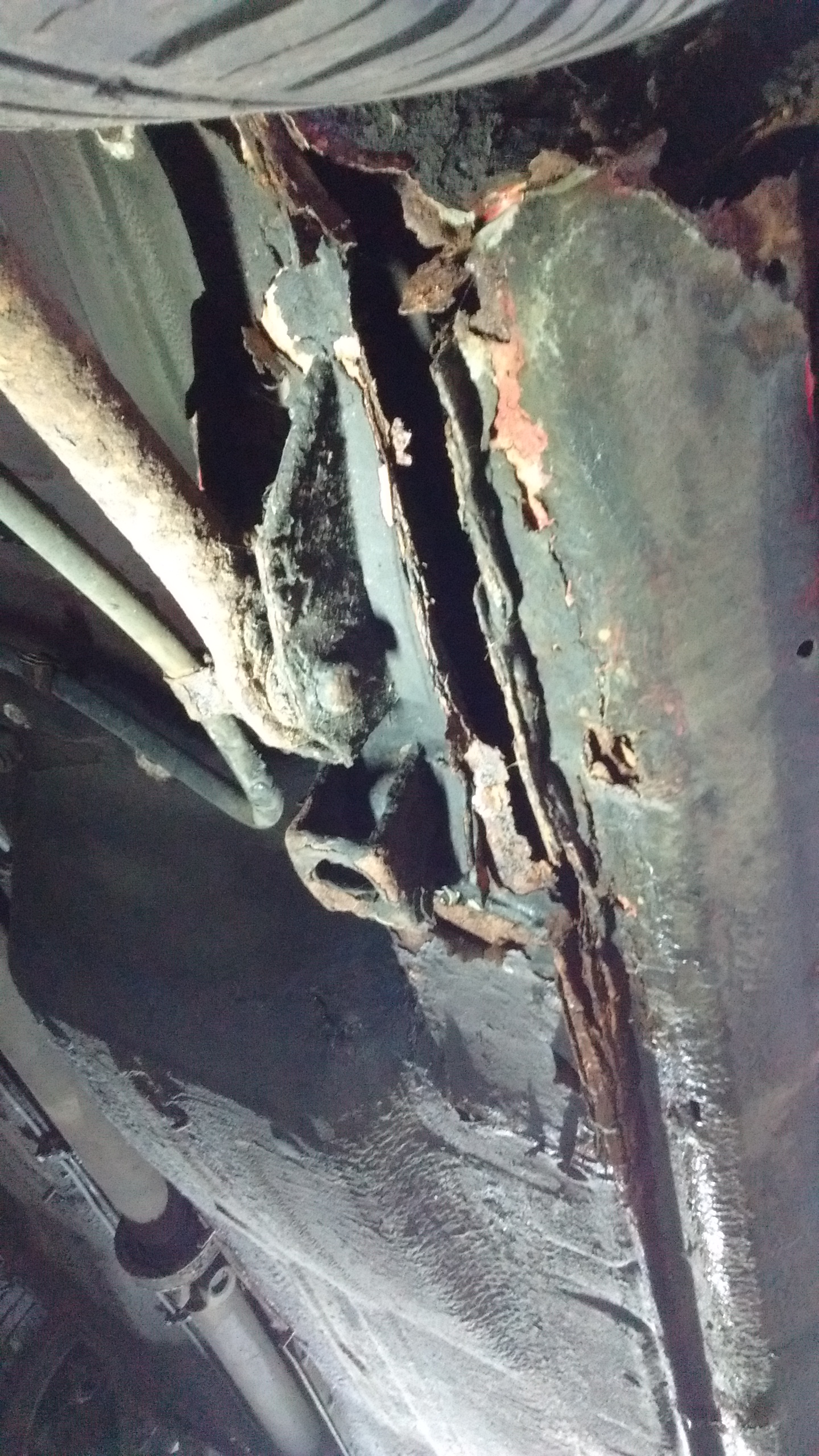

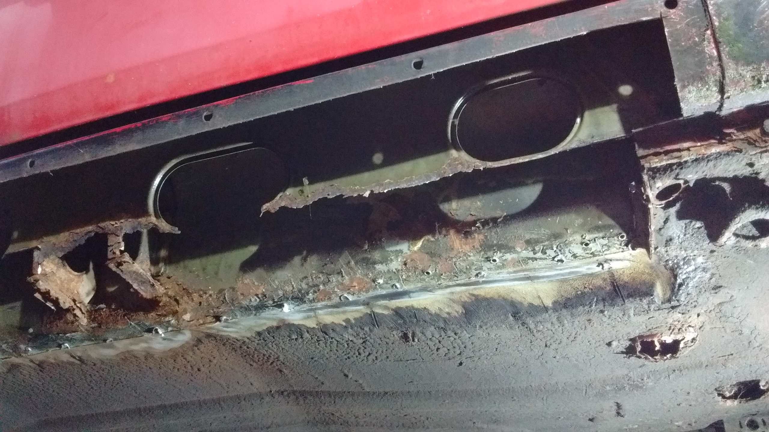

while I was down there and had a couple of hours spare I set to on the drivers side sill
pretty crusty with evidence of previous repairs and that the floor has been pushed up when trying to jack the car up
with the outer sill cut away the poor state of the central sill and floor section is plain to see, why the floor/sill edge had been going upwards instead of the whole car!
the rear section nearest the suspension arm mount had had a patch laid over a rusted section, probably a cheap fix to gain an mot at some point, rust between the layers an obvious sign that it was never a long term solution..
the section then got cut right back to the main floor section which thankfully appears solid, resisted the urge to get the welder struck up as I'd only have to carry on going once started....
next time I'm down there I'll clean things up properly and fit the floor to sill piece and repair the corrode central section. probably won't be until after Easter now though, busy period coming up
