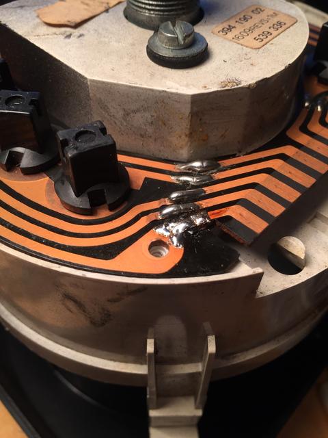

Oil and filter change for the Sprint today ahead of a possible (weather dependant) trip to the AROC Cotswold day on the 16th. Noticed the oil warning light wasn’t working, sender ok, dash out and bulb ok, hmmm. Years ago I’d repaired the PCB as it was cracked and broken on the left hand connector. Seems one of my solder bridge fixes had parted company with the PCB trace. Bridged it again but this time used a piece of solder braid to strengthen the repair, not pretty but the bulb now works!

I once resoldered a cracked PCB in a TV remote control after someone sat on it. I had to do the same sort of thing, stripped some tinned copper wire to make the bridge and then had to scrape off the protective varnish from each end of the track... Let's just say I won't be taking on any jobs like that in the future :lol:
