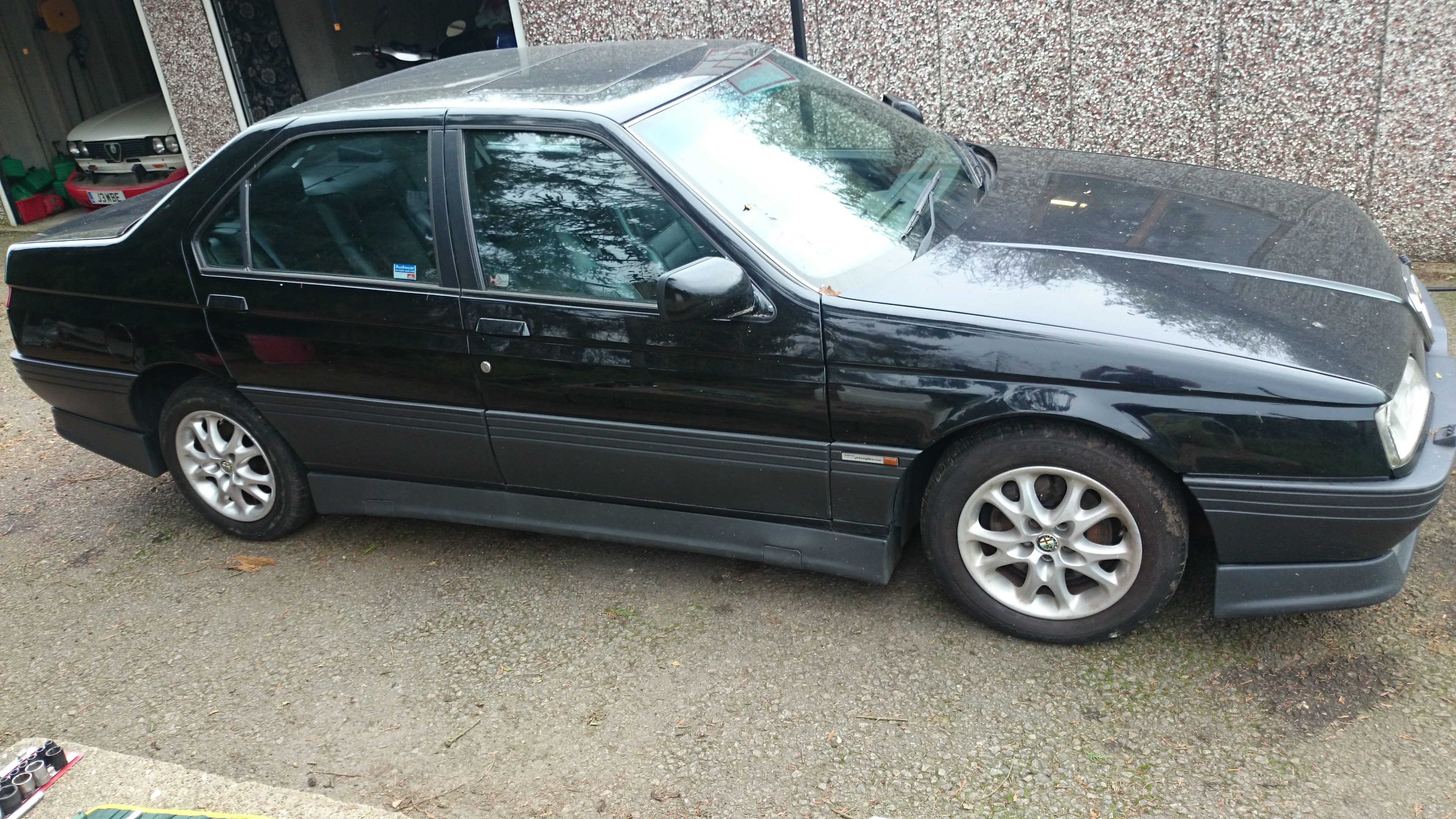

Now its not been on the road for some months, and she has been sitting on a temporary set of little 147 alloys whilst i sourced and refurbished my choice of wheels for her. Well i couldn't just have the OE Speedlines now could i? :roll:
So whilst in the wrong order, this is the period of Ugly!

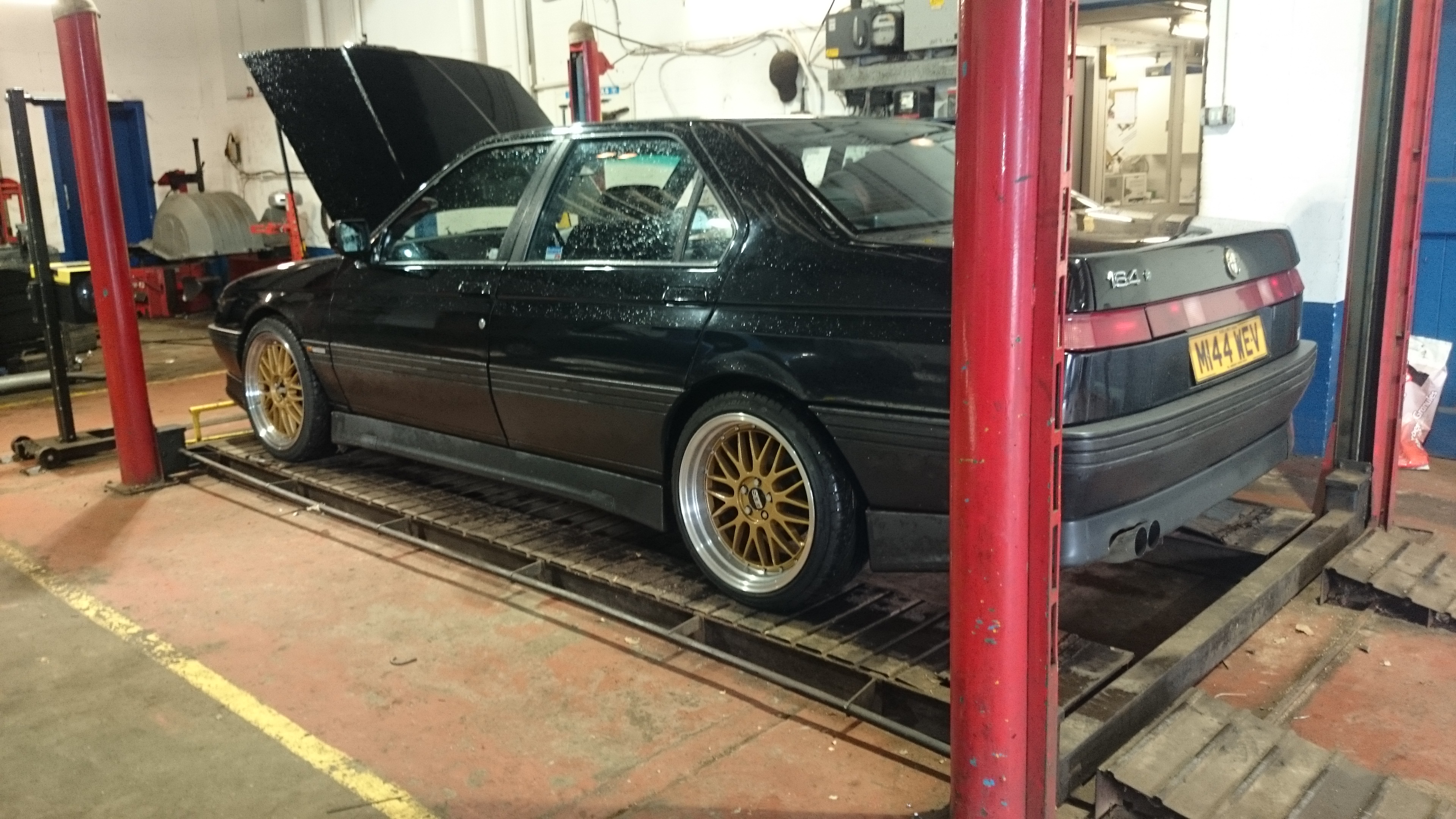

So, the new 18" x 8j and 9j wheel rims re-finished in a rich gold powder coat, new stainless studs, and polished dish, new tyres, i love them! Sitting a lot better with a small change to the springs, and she's off for a fresh MOT.
The biggest dissappointment i had thtoughout the MOT was the fact that the car arrived filthy, my wheels don't look new at all! Bugger! :|
A 100% clean bill of health, nothing but a spot of headlamp alignment to twiddle, probably down to the cars new ride height, so great news, mot'd, taxed, and back on the road with shiny new shoes to show off, Definitely, the GOOD period! :P
Wanting to put my usual stamp on the car, and having done wheels to date, exhaust had to be next, so on the ramp it went, and of course with the MOT emission test so encouraging (it really did pass as if it were never there!) that Cat had to find its flap, and get the hell off my car!
Stainless exhaust warbling and rasping on the ramps, she sounds gorgeous!
