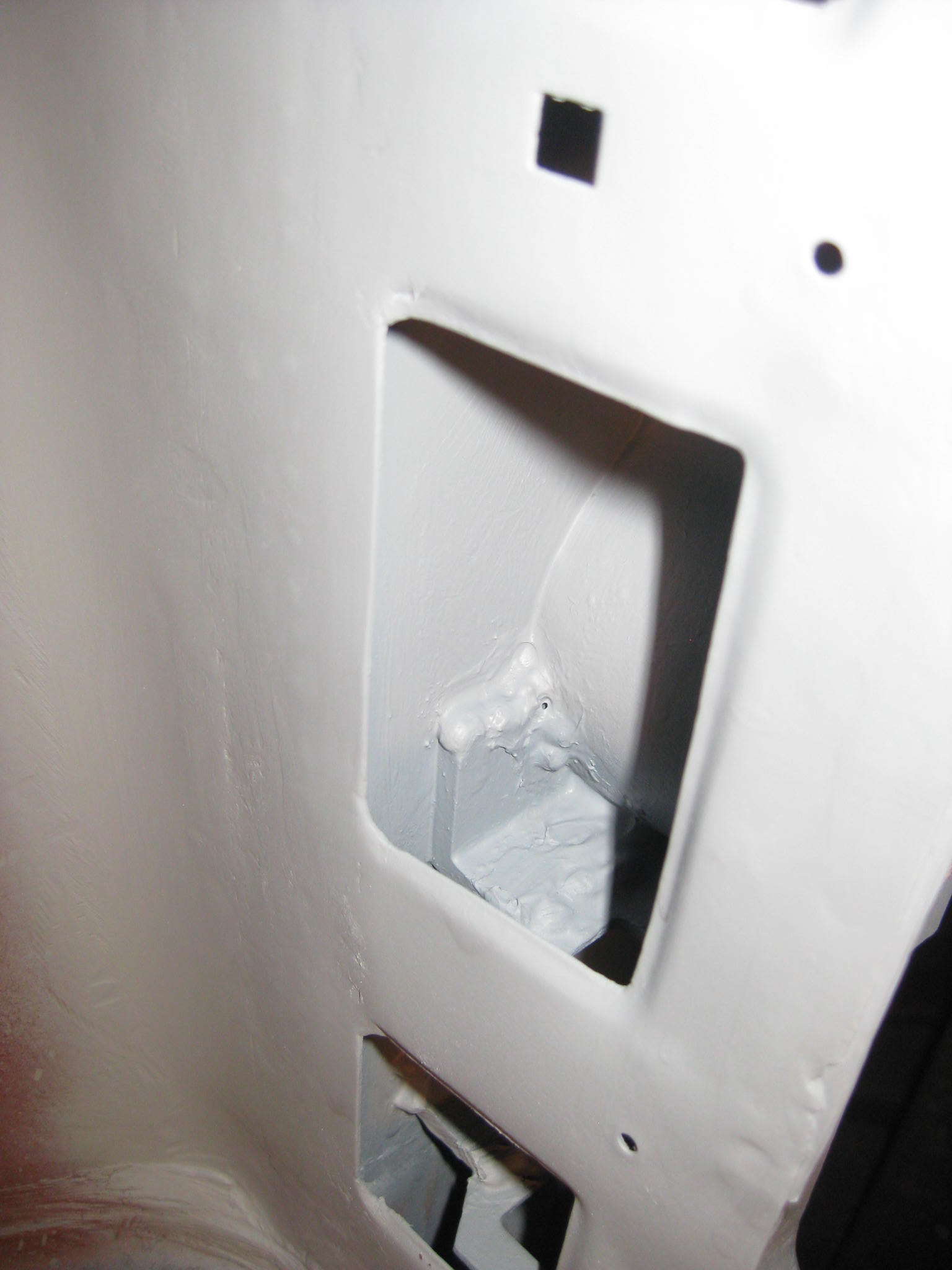

Etch prime, drill holes in the outer panel for spot welds and weld in place and down the front edge too, carefully grind all the welds back and add some more etch primer to the outside and spray some in from the top between the 2 layers of metal using a probe on the nozzle....

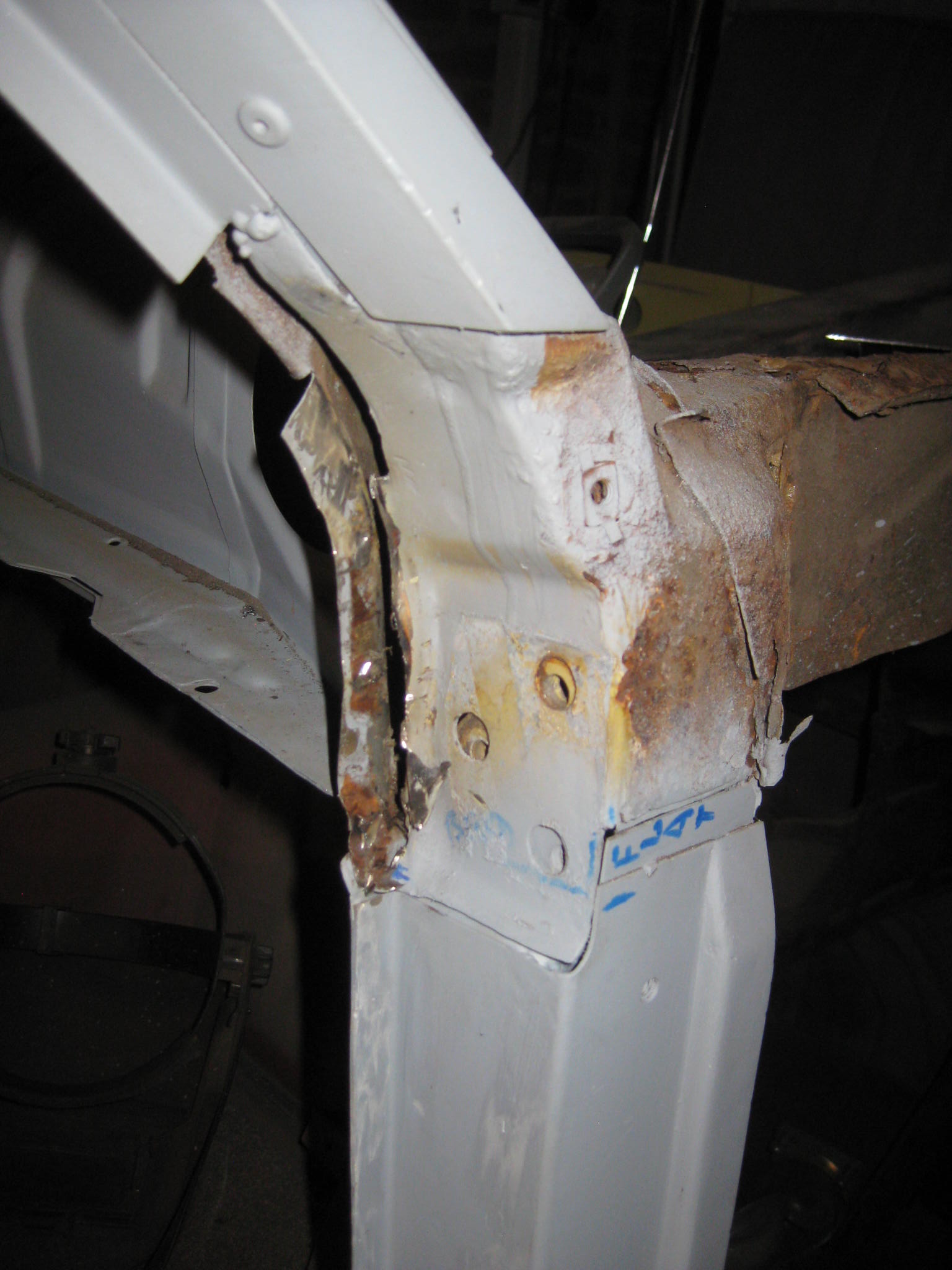

The bottom of the screen / top of the 'A' post are has multiple layers, one of the reasons it rusts so bad and it is all hidden from view only visible once you go looking
3 layers here, each one marked with a yellow dot
The problem is here that to rid the car of corrosion everything needs to be replace here and its difficult to work out the order to do it in and keep everything accurate and looking right

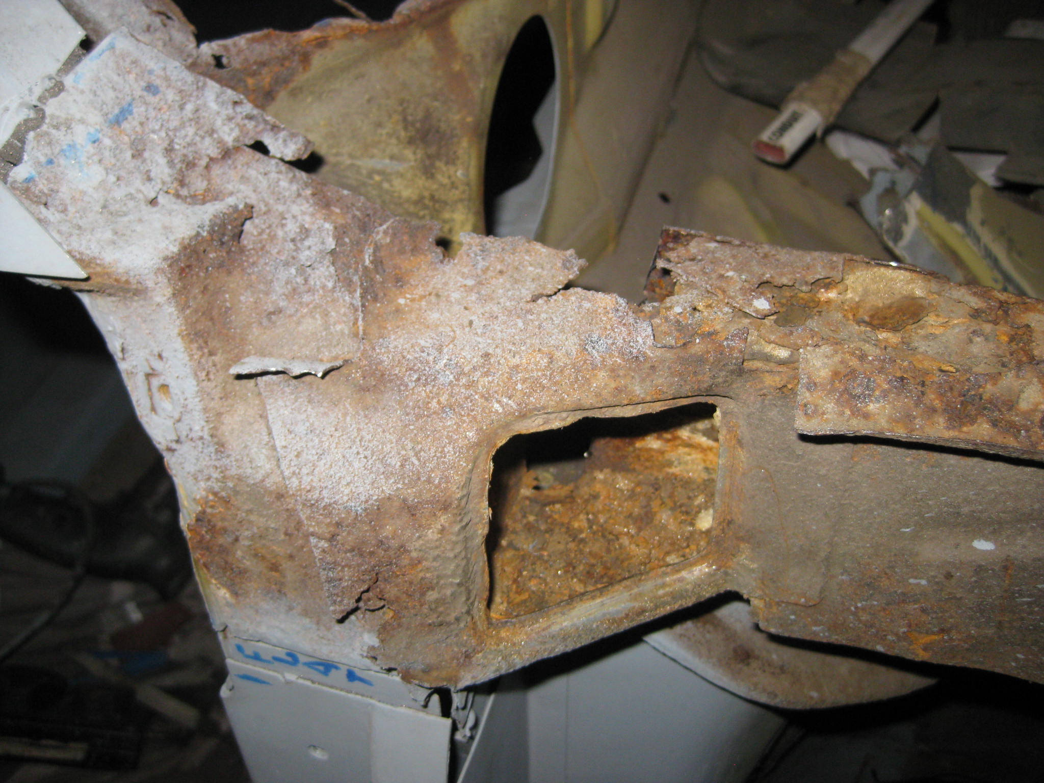

First job is to remove this bit....
Which reveals more corrosion, these early cars are only 0.7mm sheet and it is all rusted through so no option but to replace it all to do a proper job

As this area needs to completely cut away in stages I thought it would be a good idea to add a supporting piece to hold the bottom of the screen post in place so nothing can move....
Then I cut away the first part...
