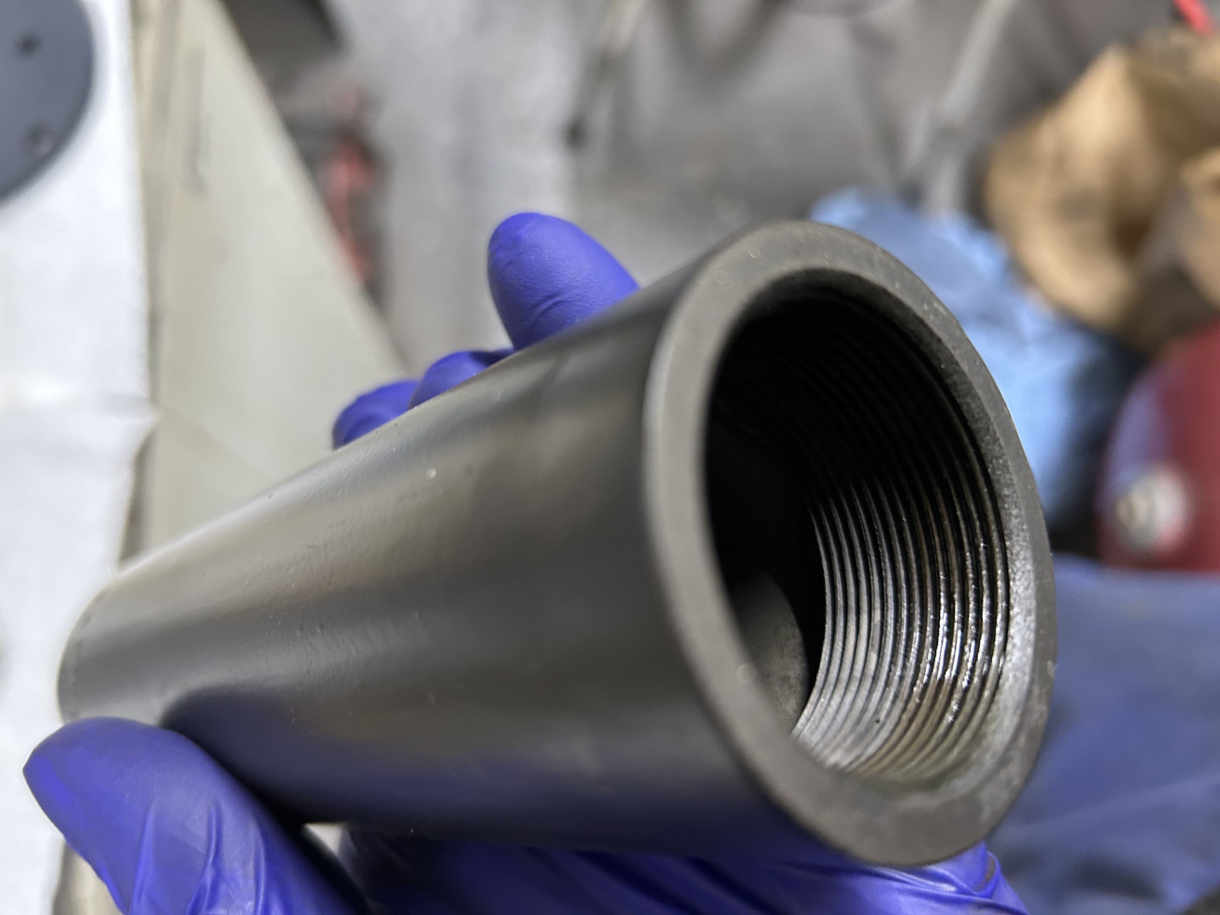

The thread size on the special tool A.3.0298 for removing the locking ring part No 60502703 is M40 x 1.5, this may be useful for anyone wanting to make their own puller.
Re: Alfa tool A.3.0298 for replacing gearbox hub seals

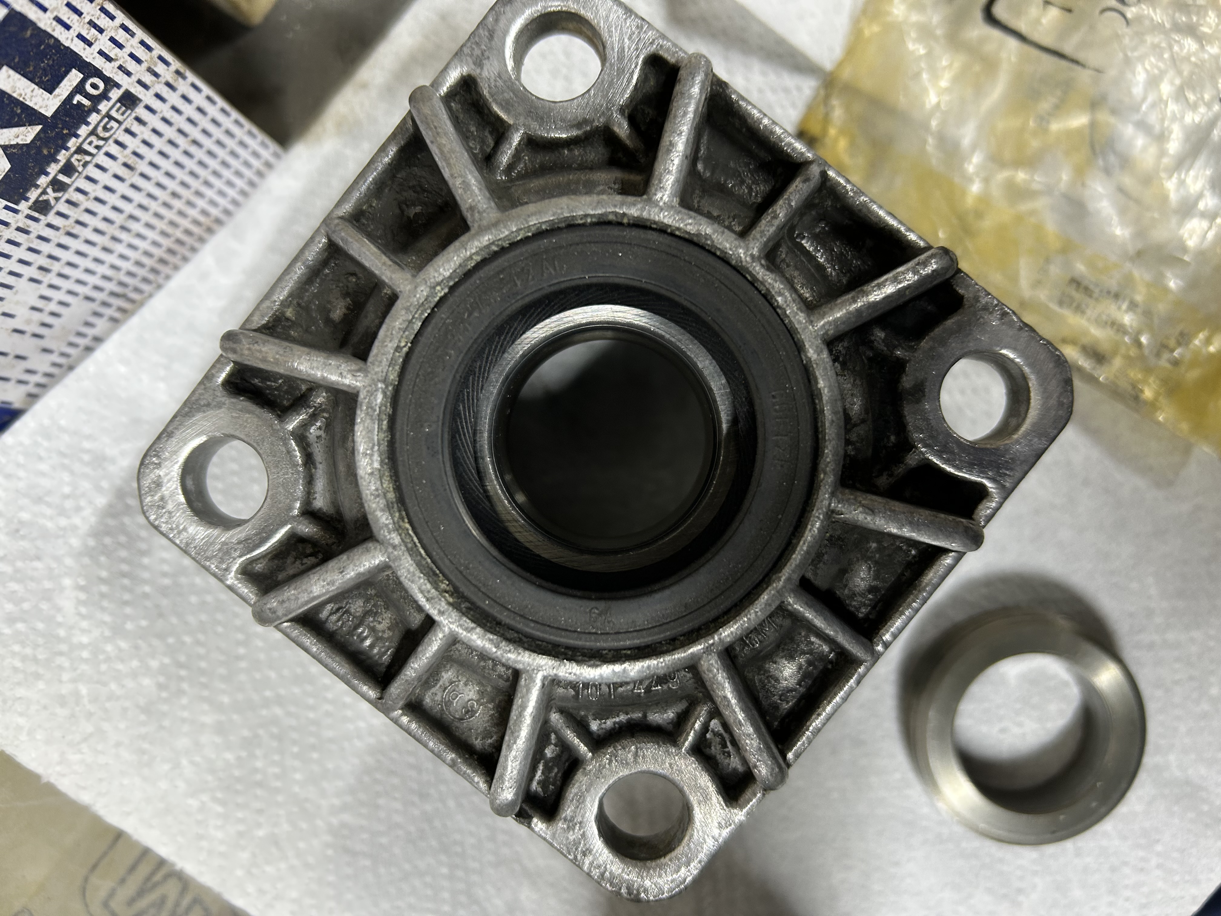

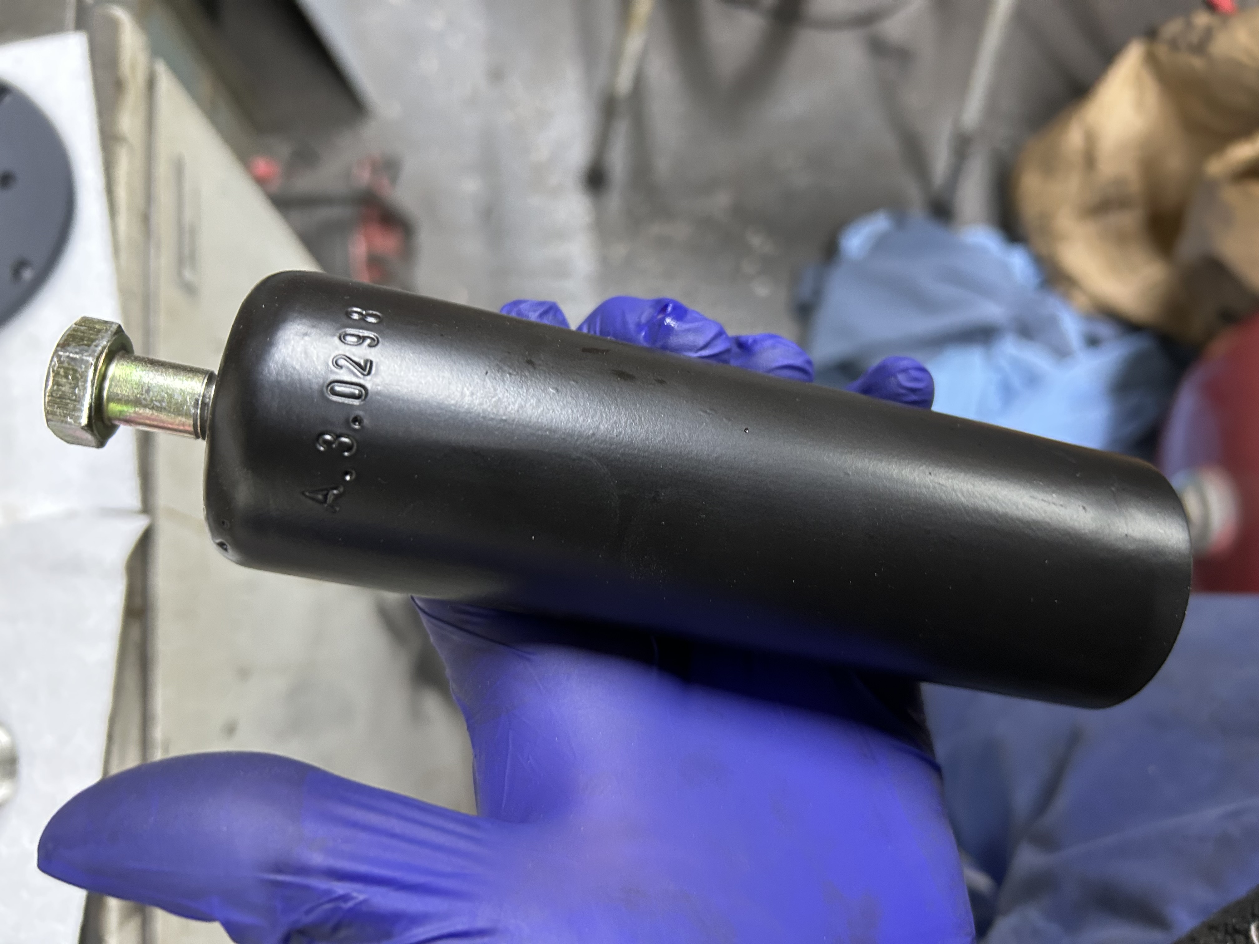

A little update on replacing the shaft seal on a spare gearbox.
I managed to make the tool for removing the locking ring, it was quite simple really. I used a piece of tube of the correct diameter, welded an M40 hub nut on one end and welded a threaded round section on the other end to take an M12 bolt.

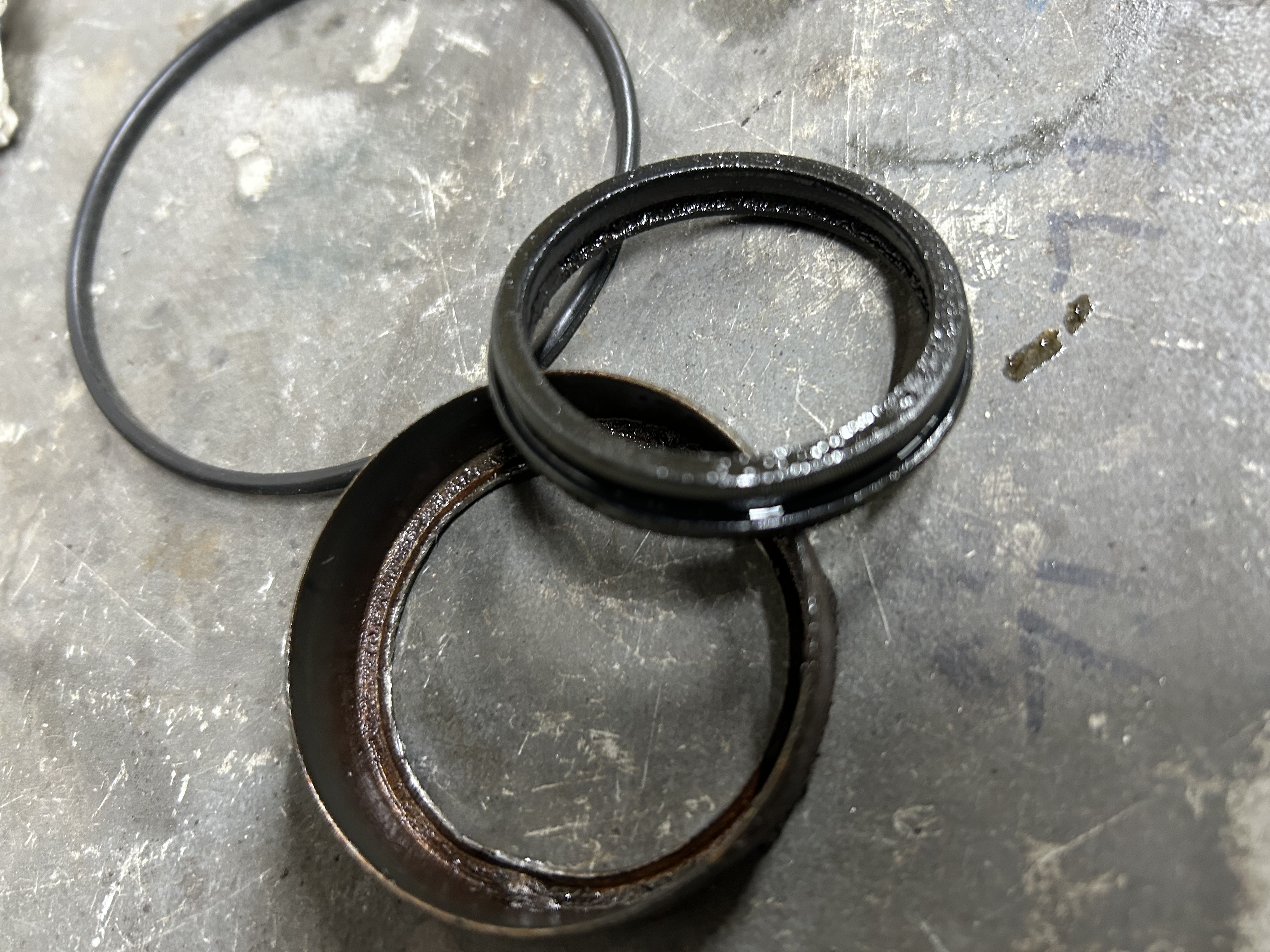

On removal you can see the state the seal was in, no wonder it was dripping oil.
