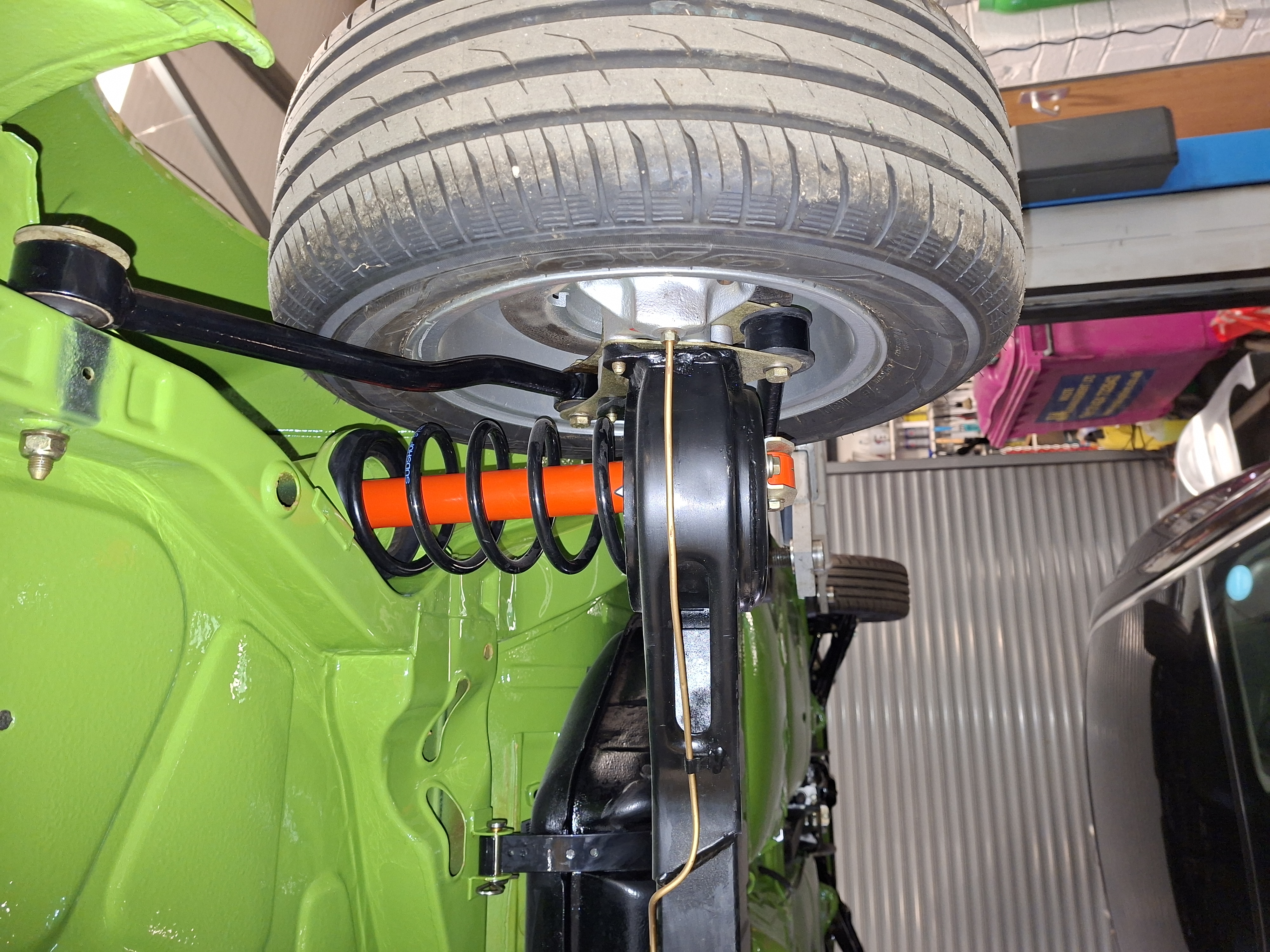

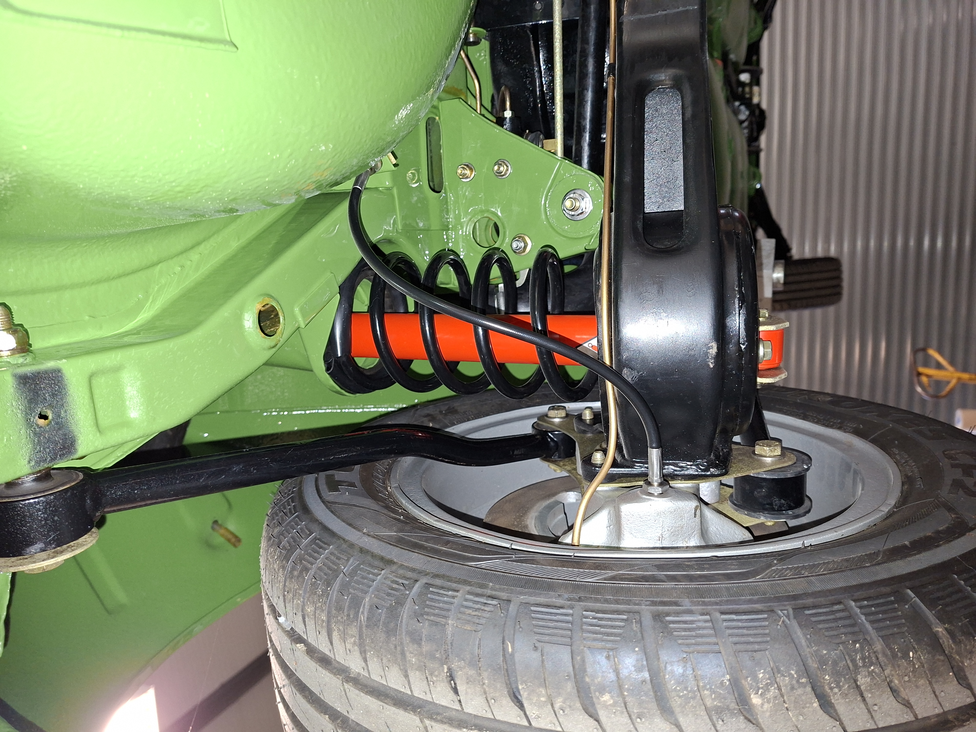

So I went over to Prestige with my son (RR tech). The Sprint was up on the 4 post lift. Comment was made about having to drop the brake discs to get at the bottom engine stud & nut (I can get at it with a thin wall 3/8 drive socket & long extension). Sprint was lowered to the floor & slowly rolled. Chris reached in and lifted the handbrake - no change. I couldn't understand it! I had set the brakes up so they wouldn't need messing with post engine gearbox refit. My son & I peered down at the brake caliper levers while Chris operated the handle.......yep the levers were moving to just over half travel, but still the car moved. The combined brain power of the three of us couldn't understand why no hand brake.
Meanwhile on the shelf behind us was a pair of driveshafts
that I had taken over with me

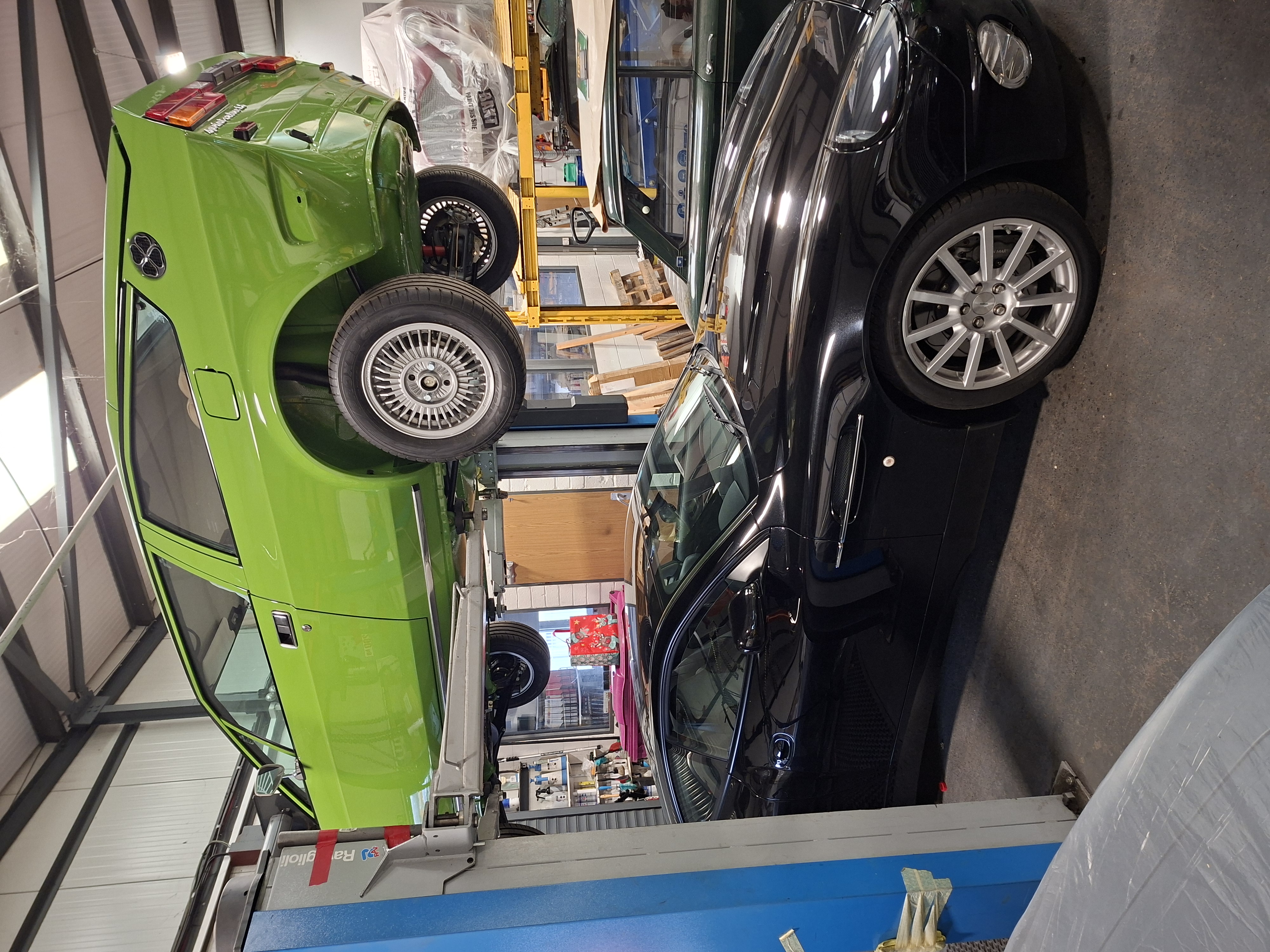

How many more pic of a green Sprint can you take? The seats got installed for Goodwood after all.......car seems to be riding a bit high at present.
Final pic taken at the shop prior to transport to Goodwood. I do have a pic of the car description on the stand at the front of the car......but it states the man hours & if you see them it will confirm I'm a lunatic.
