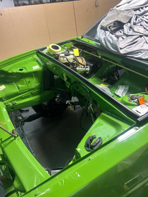

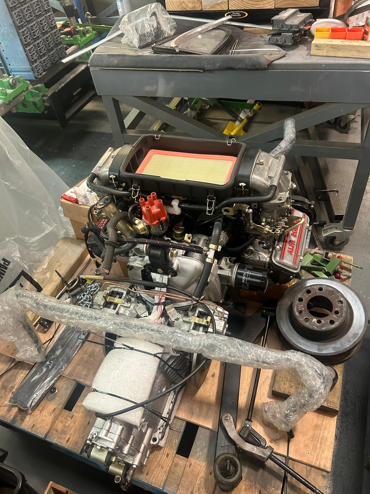

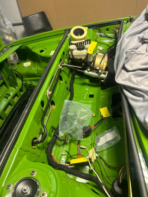

Engine & gearbox reunited. Wiring going in. The target is to have the car ready for display at Goodwood Revival, albeit incomplete & not moving under its own power. Inner CV joint covers away for plating. Seats back from trimmers at last.
WA0001.jpg[/attachment]
Re: SPRINT RESURRECTION
Looking good Chris !
I can see your reflection in the paintwork!
Wow !! that is looking stunning.
Beautiful attention to detail. Love it.

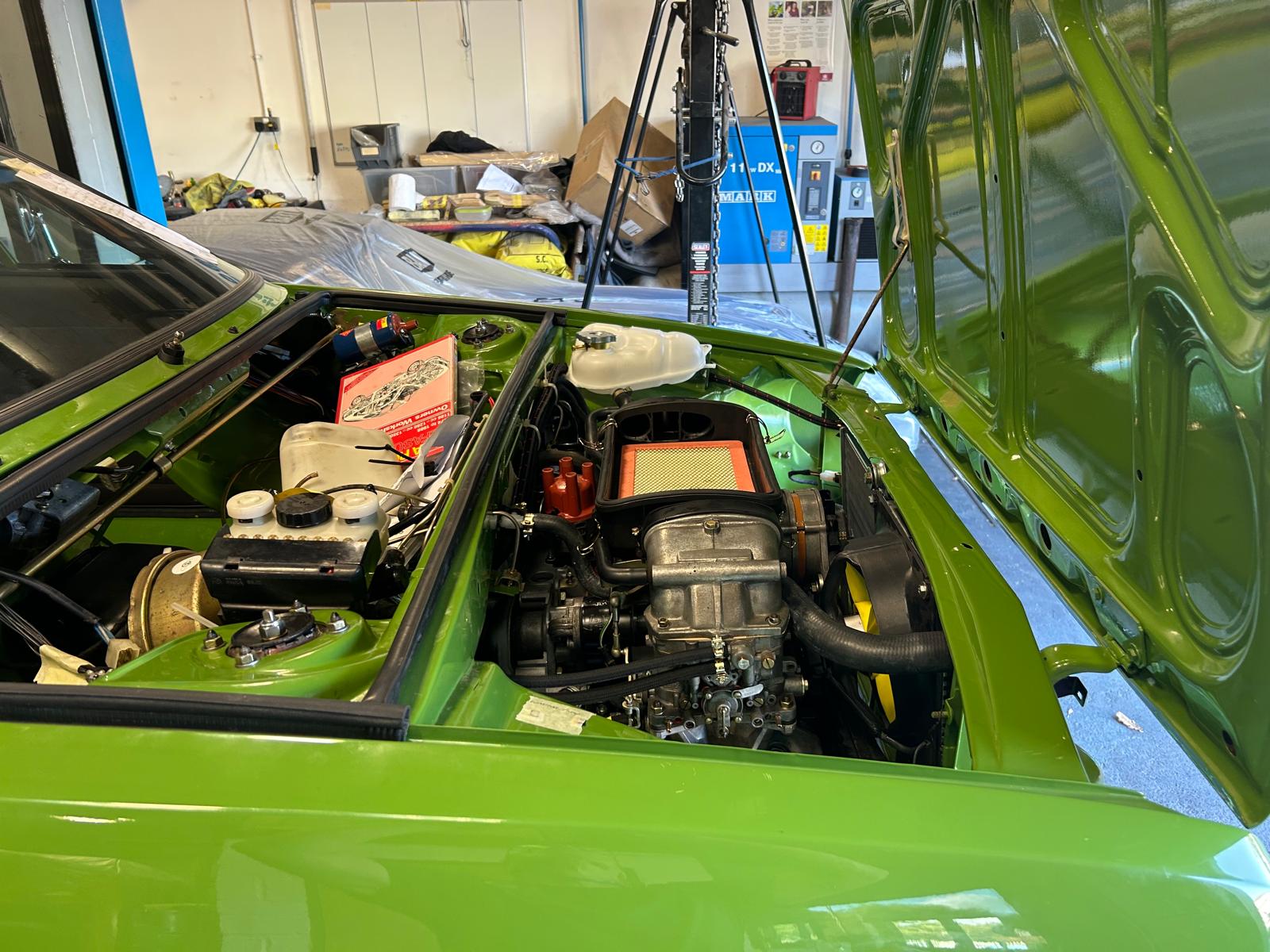

Cover those wings over when you are working on it!

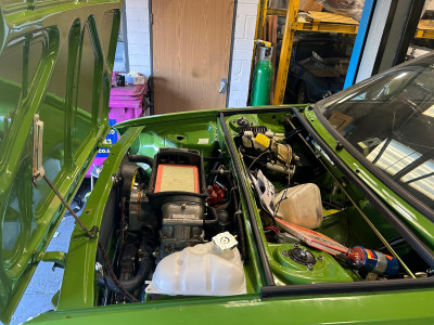

The Sprint is finally ready to venture out from Prestige Paintworks for the first time since May 2022. It'll be on their trade stand ar Goodwood Revival 12th to 14th September to show that there are cars other than super expensive ones that are worth restoring. I have a "looks like new" air filter box lid to take over tomorrow. There won't be time to install the seats unfortunately.
She is really coming together now.
Lovey.
Lovey.

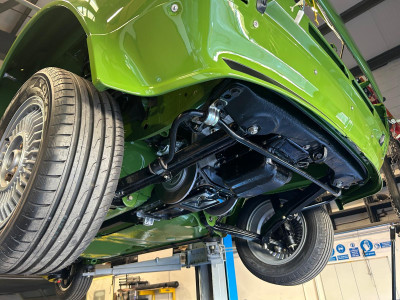

Eeek!!
So I went over to Prestige with my son (RR tech). The Sprint was up on the 4 post lift. Comment was made about having to drop the brake discs to get at the bottom engine stud & nut (I can get at it with a thin wall 3/8 drive socket & long extension). Sprint was lowered to the floor & slowly rolled. Chris reached in and lifted the handbrake - no change. I couldn't understand it! I had set the brakes up so they wouldn't need messing with post engine gearbox refit. My son & I peered down at the brake caliper levers while Chris operated the handle.......yep the levers were moving to just over half travel, but still the car moved. The combined brain power of the three of us couldn't understand why no hand brake.
Meanwhile on the shelf behind us was a pair of driveshafts
that I had taken over with me
I did notice the driveshafts were missing on the underside shot!
I was going to remind you, but thought that wasn't necessary!
