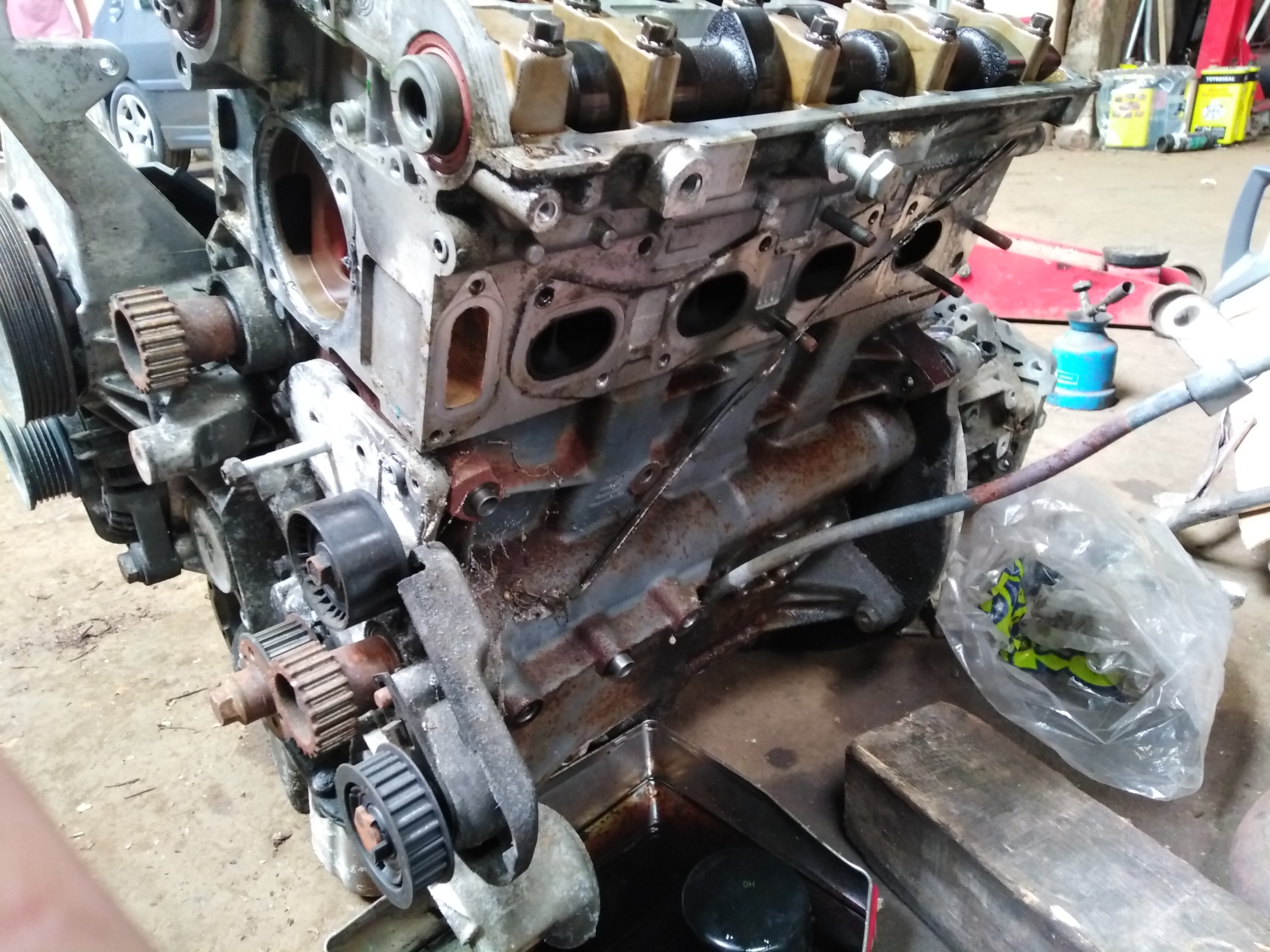

So with everything removed from the old engine that needs swapping you end up with this!

With winter around the corner and the plan to rebuild the original engine so it can go back in whilst laid up so it's ready for the spring I have stripped it down to have a look and see what was making all the racket.
The phrase "hammer in a cement mixer" was about right!
Numer 1 big end was very loose, not the bolts being loose, more that the shells had been worn away and turned in the con rod itself. One ended up on top of the other!
Re: GTV ts
Re: GTV ts
The shells mounting each other meant they had also gripped the crank at some point and have ground the con rod journal itself so not only is the crank knackered but the con rod is also done for.
Luckily I have a bottom end which I hope will have salvageable parts within.
Off work next week so should get a chance to access the situation.
Although I have a perfectly working engine in the car now I would like to rebuild the original motor so it should then last a long time..... Fingers crossed!
The other shells had also all but lost their bearing material, just a flaky surface left behind so was really in the death throws it seems despite, (or maybe because of?) the low mileage. Sometimes cars being stood does them no good.
