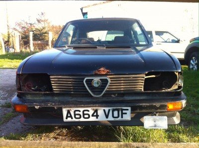

I have just found out I have 2 good near side sud ti headlights, rather than one of each side. Having seen a pair sell for 'lots' on eBay recently I'm tempted to look at other options as its not a road car.
So, does anyone have some pics of how to fit the BMW lights (I don't access the other site so can't search for the old threads on this).
Have any other options been used by anyone? Many 70's and 80's cars had similar sized lamps (ford Capri / escort fiat 131 etc.), there some kit car options on good old eBay perhaps also.
Thinking out loud, would the inners fit the outers?

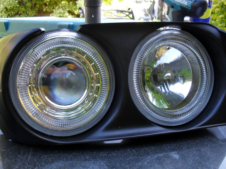

Headlights arrived, will post a few pics if anyone wants to see one (not fitted to car yet)
Very critical opinion is that they are good enough but not perfect. A bit of glue showing and a few nics in the metal lip/rim. The glass lense is not quite as curved as a Sud light but it's close enough
However for 47 quid for 4, I'm more than happy for what will be a track car, and they would be good enough fora road car as I think the plastic trim would hide most of the above.
Not yet figured out how to fit one, but I don't need an mot so 3 strong springs might be enough to hold it in.

Got my lights today, well packaged and with bulbs only thing is I'm going to have a look tomorrow about how to make them fit as back is different ie how they fit to headlight cases but I'm sure I can do it.

Not yet, we used 3 tie raps just to see how hey fitted generally, they look fine on the car but not fitted them with anything that will allow adjustment yet.
