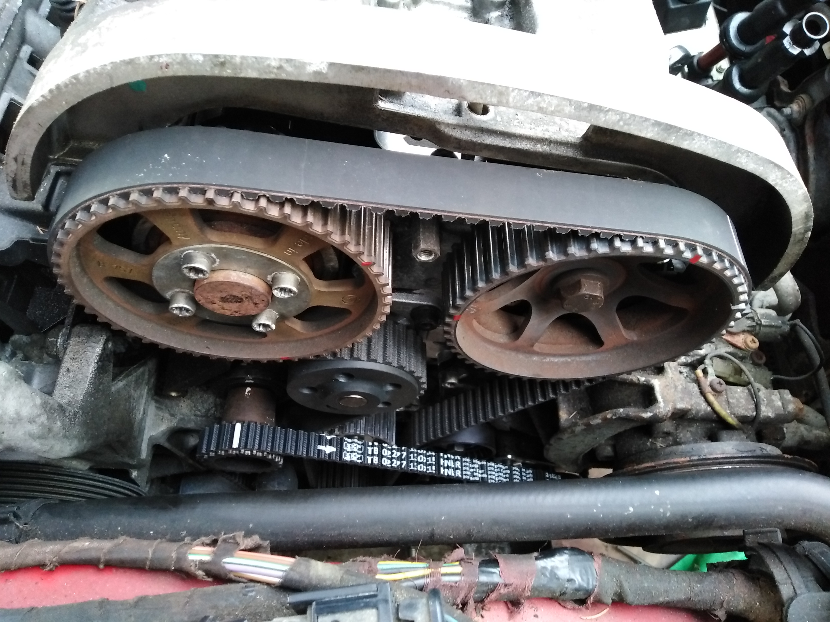

First job as ever is to sort the cambelt. It had actually been done not that many miles ago but near 5 years ago now, it's been stood for the last 3 years or thereabouts I recall.
Got a reasonable deal on a cambelt/balance belt kit, SKF brand so decent quality. Did the water pump too for good measure.
