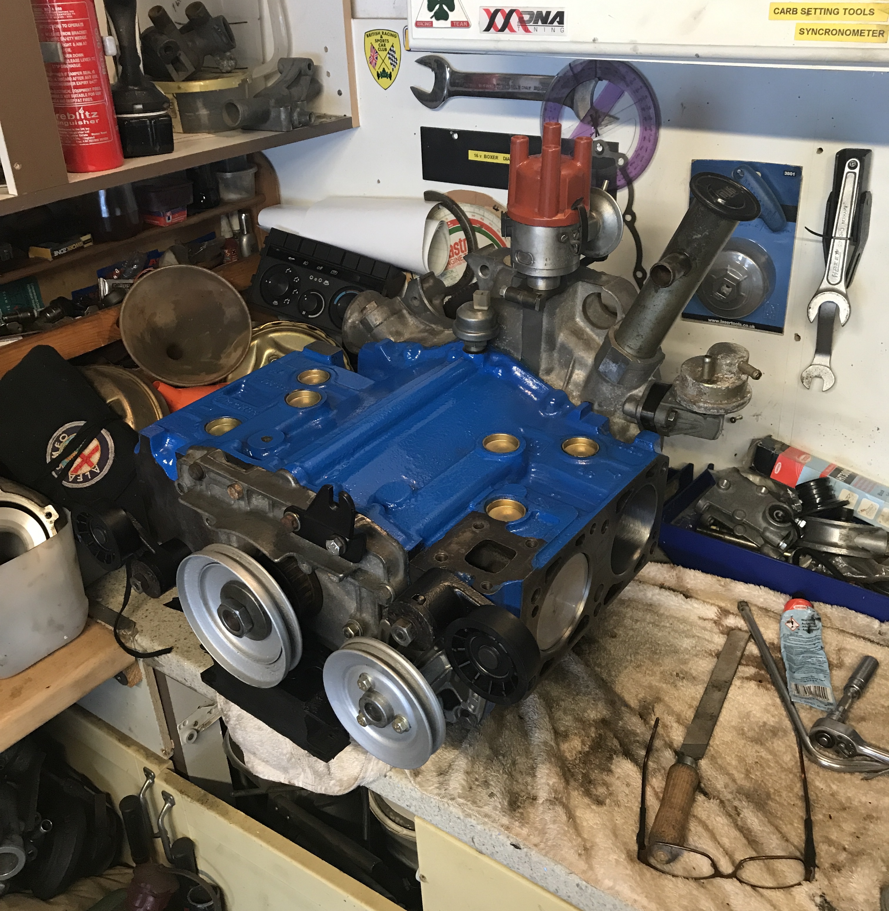

- Posts: 1757
Re: My 84 Sud Ti Project
Apart from a few small details the bottom end is now back together and ready for heads . Which I’ve yet to do
