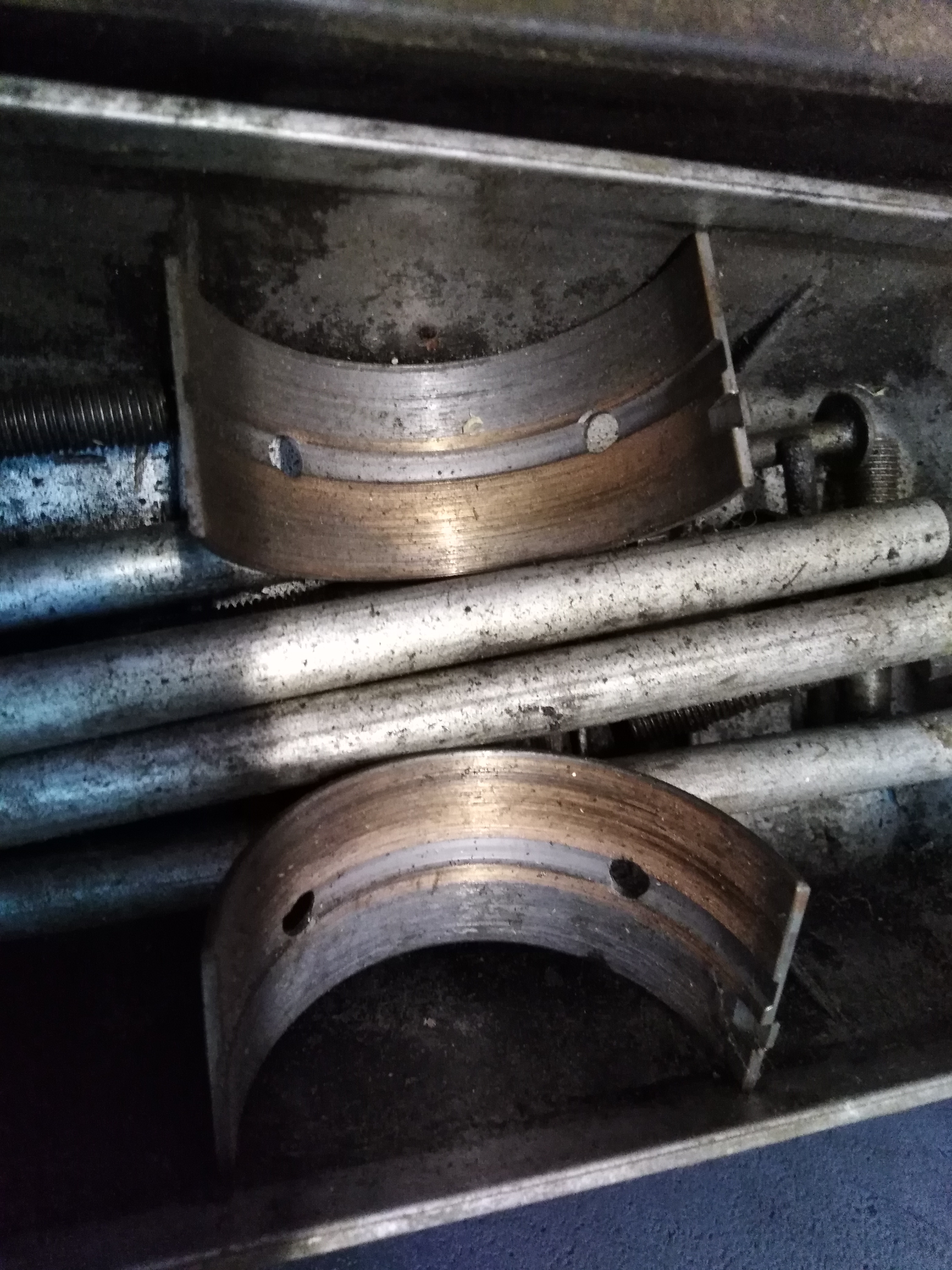

Cranks I have my doubts over whether they'd be useable.
Check the main shells, they've had some use.. Not sure if from this engine as its a real mish mash of bits, casing numbers don't match for both sides..

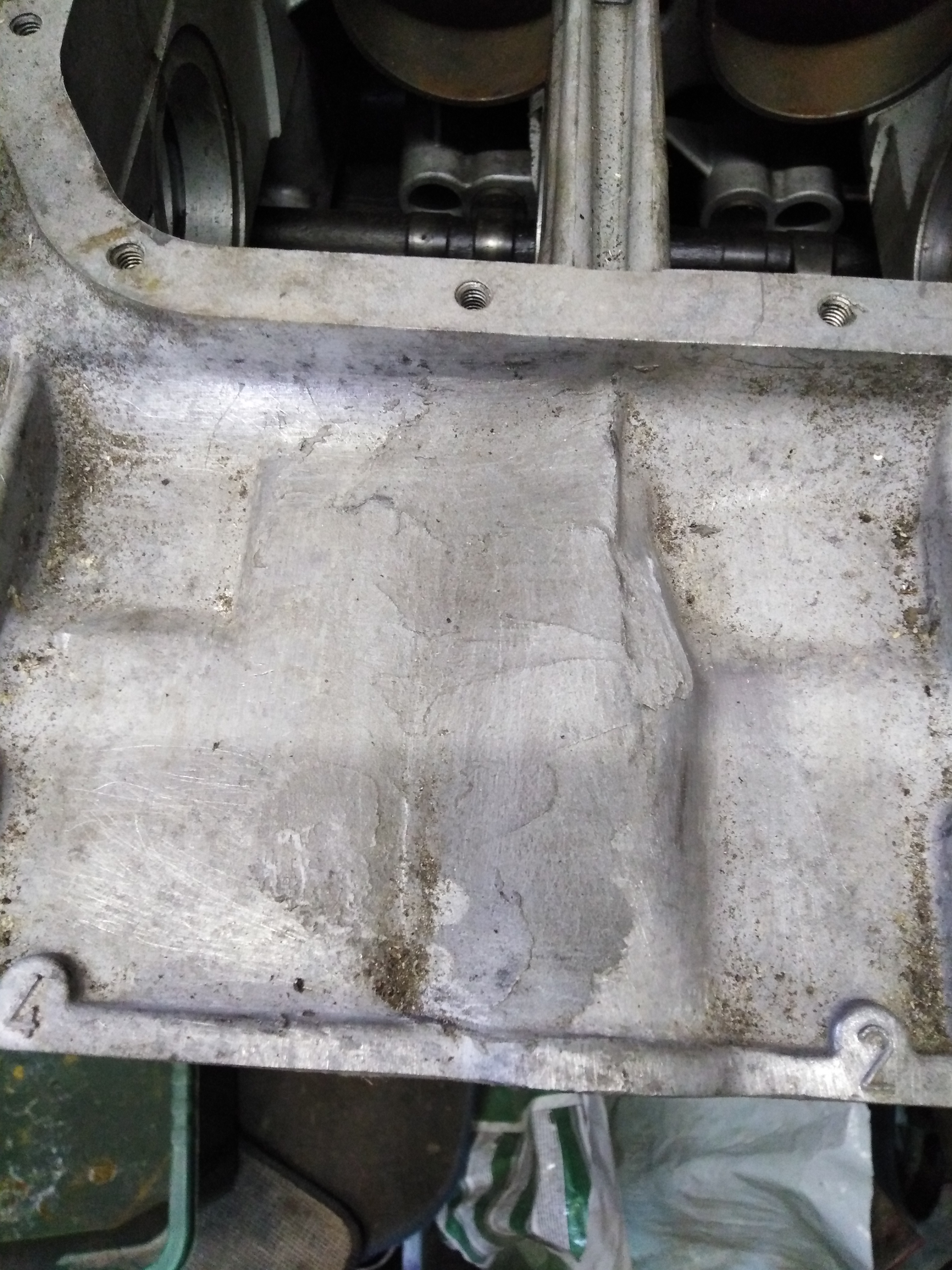

Only one camshaft, I do have 4 heads, all with different date stamps from between 1972 to 1975, its a 1964 car I think from memory..
Other bits obviously missing, inlet manifold, carb, water pump and thermostat housing, the top of the engine has a large access plate that stuff bolts to.... Missing...
The front should have a cover for the timing chain, missing. Rear crank housing for the oil seal, missing.
That's just with 5 minutes laying stuff out, not sure if all the cam followers are there, pushrods etc.
Then the internals will need a good clean as even if the outside looks clean and polished the inside is very furry..

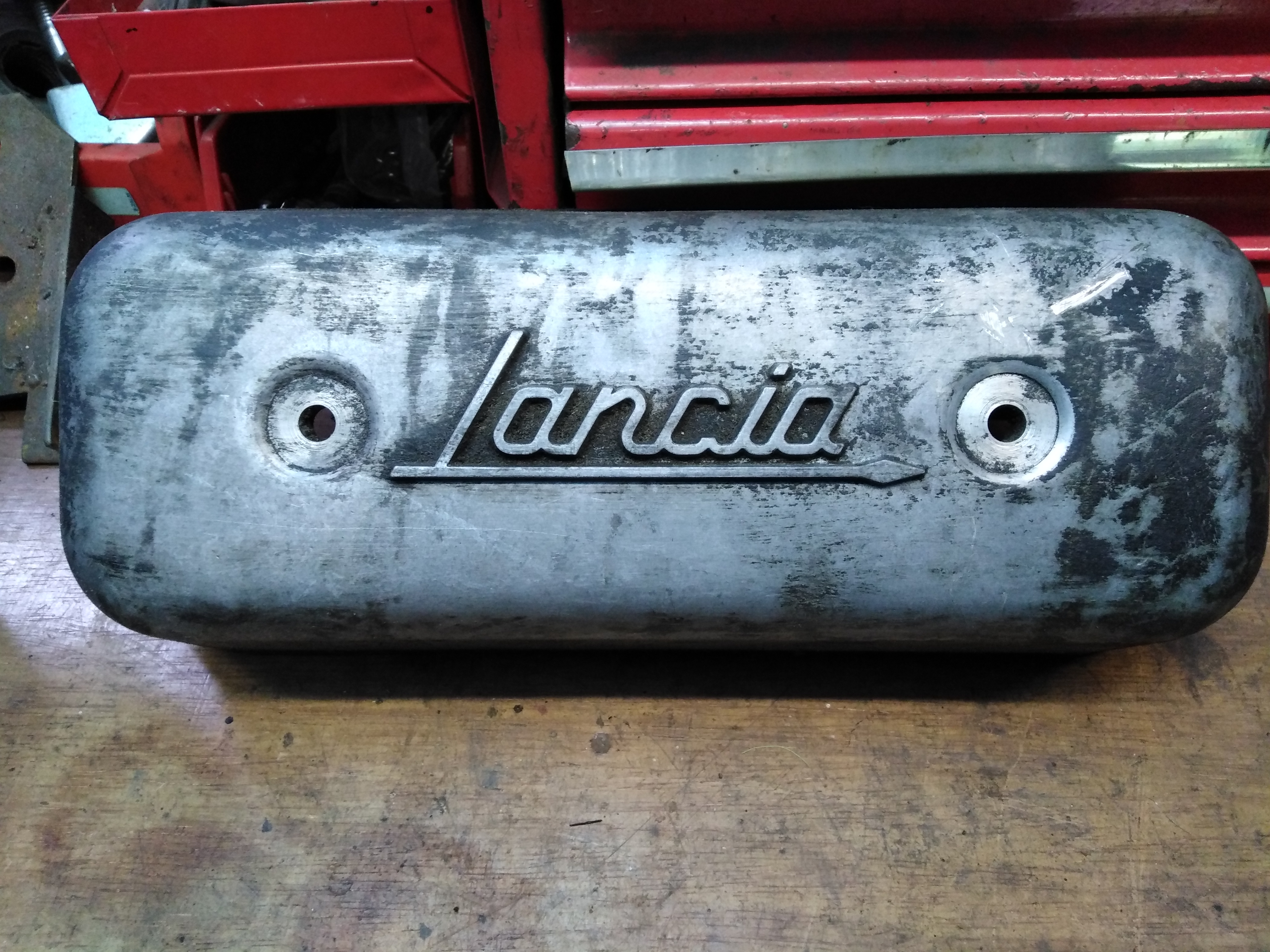

It would though make a really nice static display, or a coffee table. Especially if you put a small electric motor in it, perspex cover over the top opening to see the workings...
Could do one valve cover in perspex too to see the valves moving, polish the engine up nice.
The valve covers are crying out to be highly polished..
Posts: 1196
Re: Kev's workshop projects
Yes that Lancia logo with the bottom of the`L' going across under the name and ending in a arrow head is so
traditional in calligraphy. A good polish will make it all the better. Valve set up looks very single cylinder motorbike like.

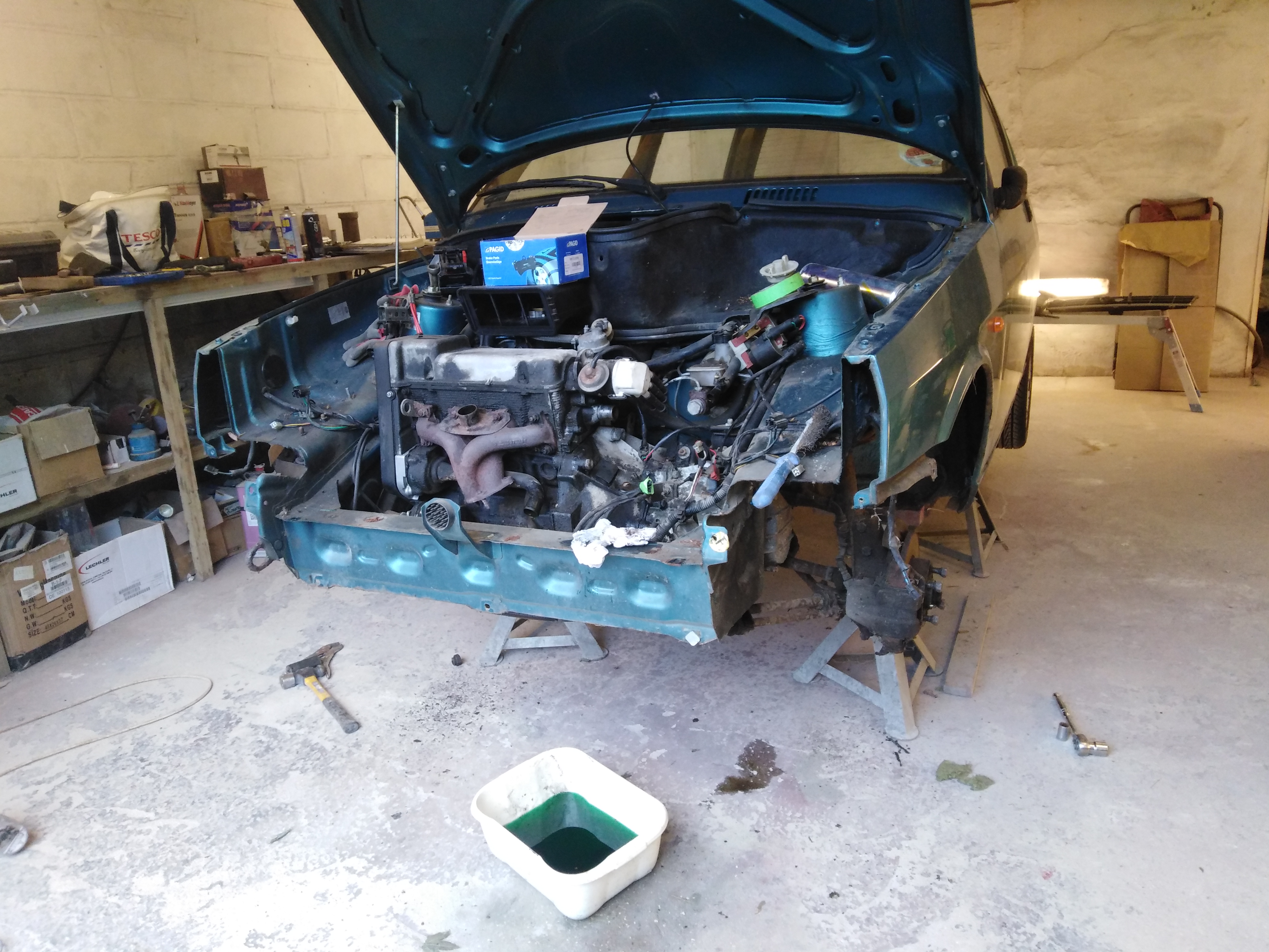

Anyways, task was to get the engine and gearbox out before allowing myself to knock off for dinner.. Nice to have something to aim for :lol:
Enough out of the engine bay for now, may decide to strip it all out when it's painting time and do the engine bay even though I hadn't planned to..
