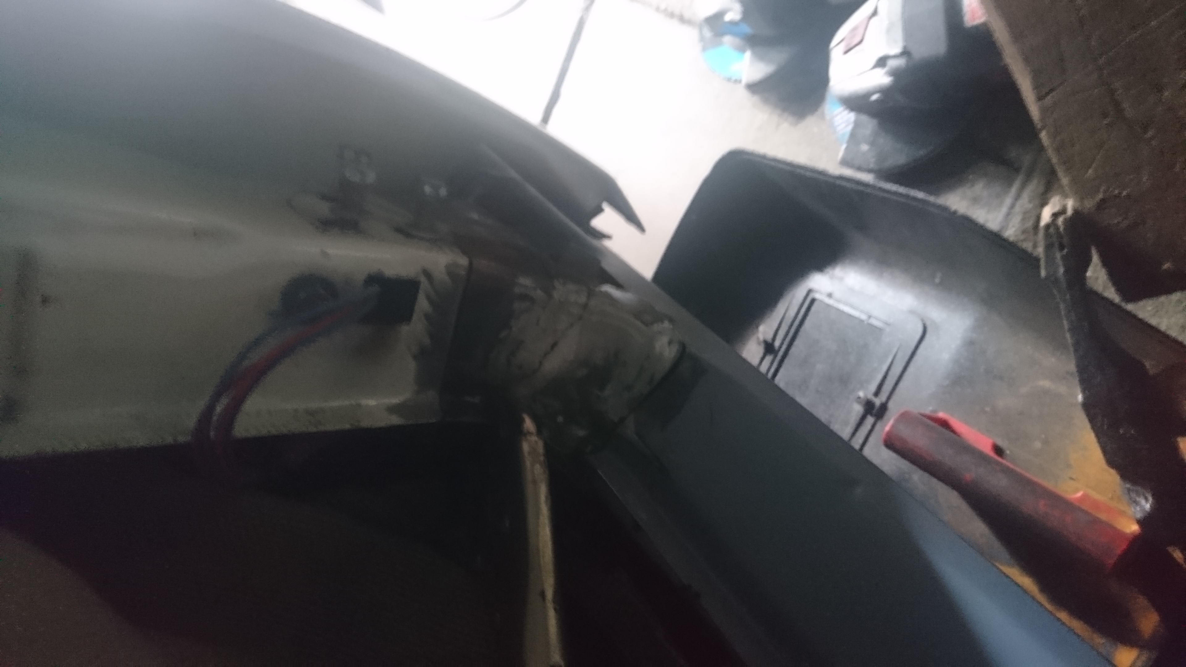

Finally got to the end of the sill. Had to fabricated an end panel as there wasn't one to be seen.

Well had some time on furlough so back to it. After finishing the sill I started digging in the rear wheel well only to find the chassis leg had really bad rust. I decide to try and do the repair properly and ordered a new chassis leg from Greece. I managed to get my order in before Christmas to beat the brexit charges and post only for it to get stuck in Italy for about a month due to covid. So I'm all ready to go. I chop the leg out and put the new leg up to find the suspension mounting points are all different! Gutted so it's time for plan 2 cut a leg out of the scrap shell on the garden. Thank god for spot weld drills.

Sud leg going in

After seeing so few 33s at the last two show I've been too I have started welding again.
Alfastrut
Posts: 510
Location: Derbyshire
Re: 33 sills
Post by Alfastrut »
Been repairing the boot corner

On to the other side

Sill looks better this side surprisingly! They didn't feel the need for the inner sill metal though last time it was done.
