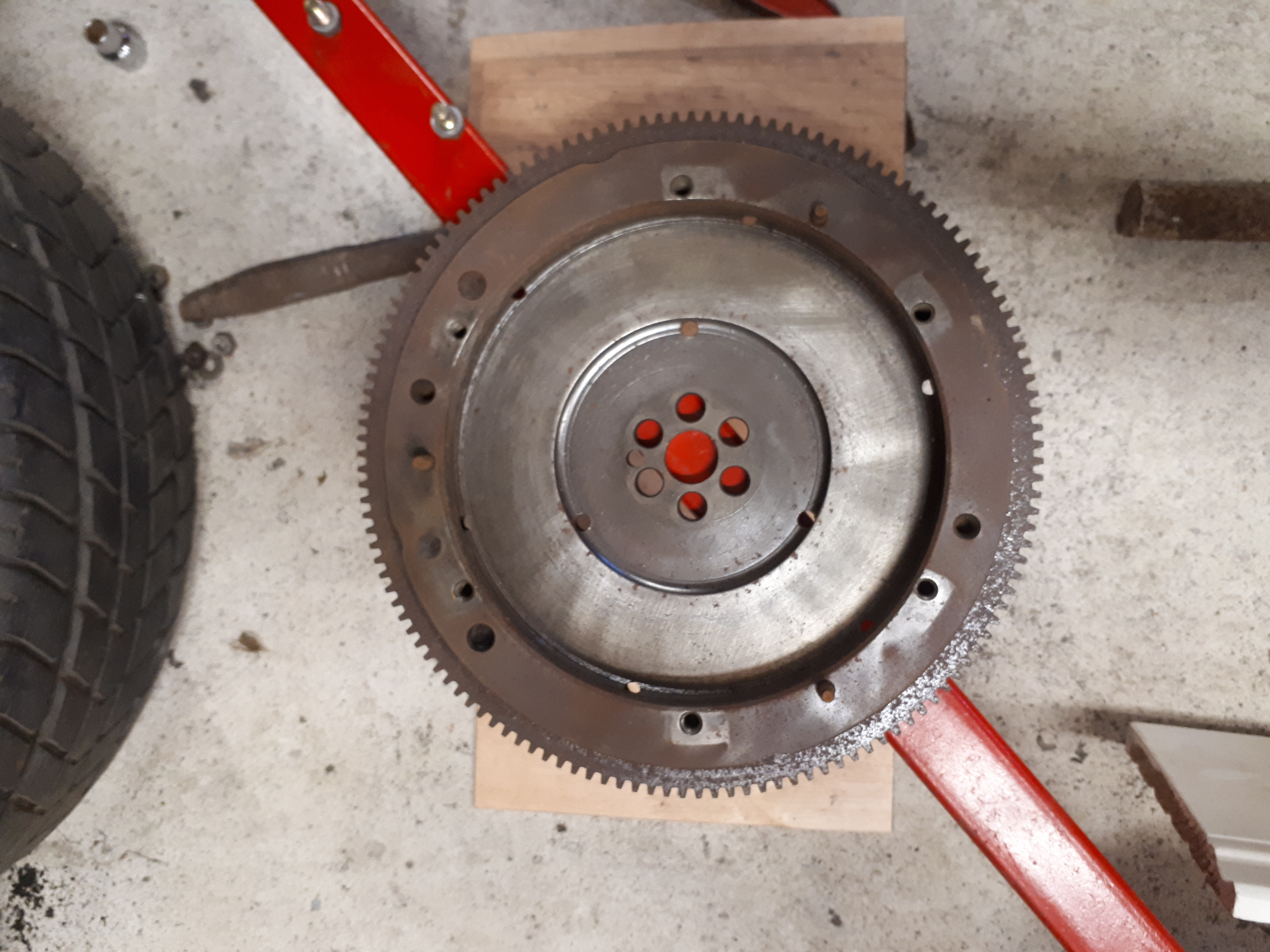

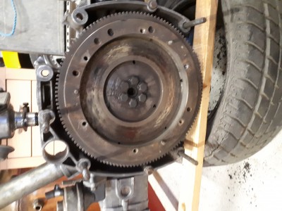

With regards to fly wheele it seem to be different on the engine from John to the one on the engine I want to swap from. With cupped holes on the face of it in different areas and not the same spacing. So was unsure that I could swap it over as a result.

As discussed with you some pictures of flywheels attached. Have a look and let me know what you think :?: .
Cathal.
Flywheel on engine..
Other flywheel..
Other flywheel..
Re: Sprint engine questions
Hi Cathal
They look completely normal 8v items The fuel injected and 16v engine flywheels were a lot different as they have a phonic ring (looks a bit like 2 ring gears). This is for the TDC pick up / sender. You can fit them to a non IE engine but as The Ring gear is in a different plane you need to space the starter out about an inch an half ish.
