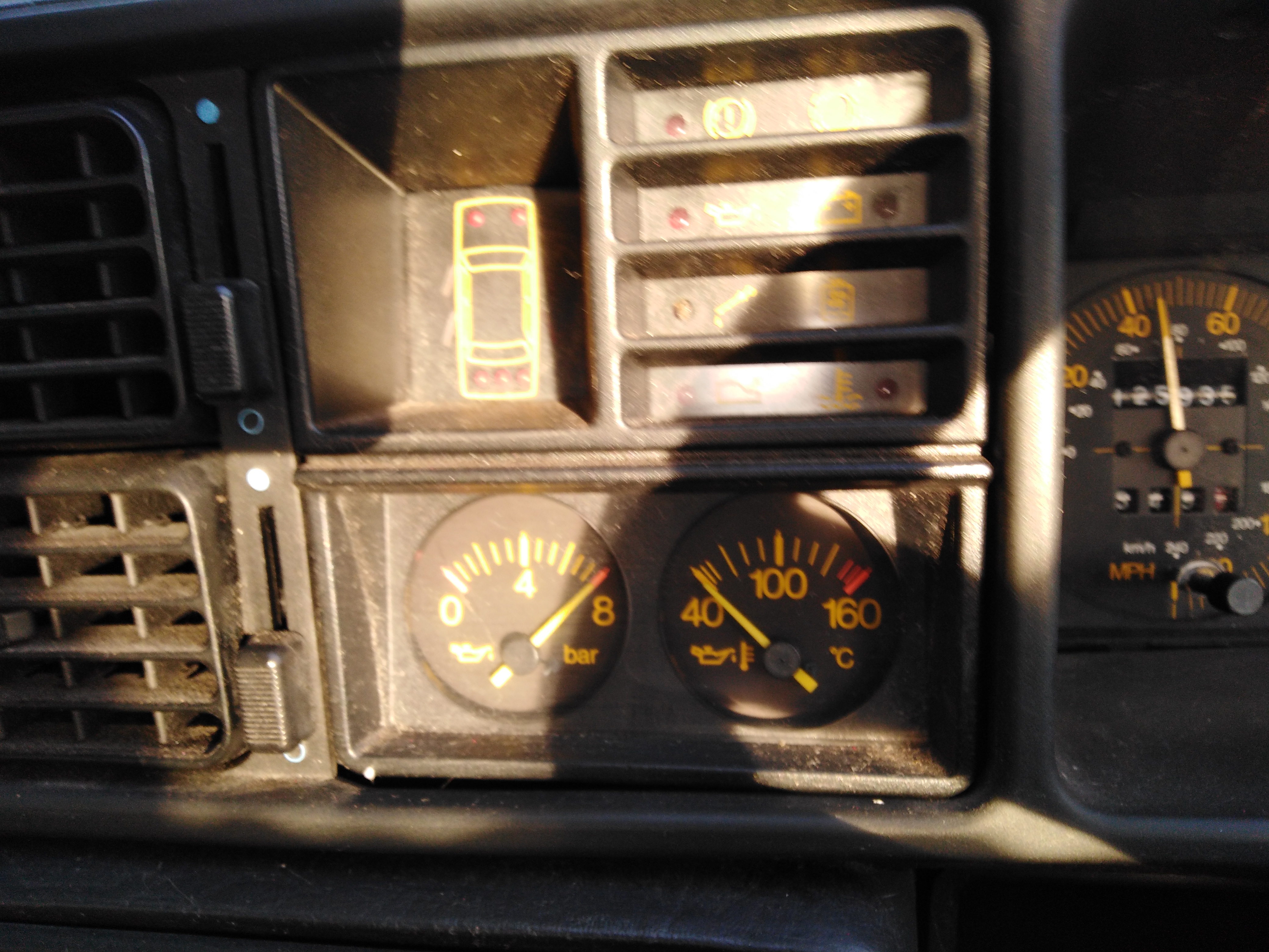

Only get a reading of 1bar, or less at a warm idle.
cruising with warm engine and around 2.5k only around 2.5b
Only ever seen 4 bar on cold start up but drops fairly soon.
I have got 10w40 Shell oil in, did wonder about using some 20w50 but I don't think the gains would be what it would need to near double the figures.
I at first thought it was just an inaccurate gauge, but at idle the low pressure warning lamp flickers, which is from a different sender.
I've got a new pump coming tomorrow as I want it to be a long lasting solution rather than use a thicker oil grade, been up to the car tonight to drain the fluids ready to start it on Wednesday.

OK, an update.
The change was reasonably straightforward if a little involved.
Loads of parts needing taking off.
The oil pick-up pipe needs to come off the pump base, it bolts inside the sump. You can't reach the bolts just by taking the lower sump pan off as it doesn't extend fully across the blocks' width as there's a cut-out for the exhaust to run, so the upper sump needs to come off.
This can be done without taking the gearbox off, you do though have to take the transfer 'box off as it hides the sump bolts. That too means the alternator and starter motor needed to come off, I took the whole drivers side front suspension off to help with access too.
Cambelt & balance belt need to come off as they sit over the oil pump.
All back together today and the start up pressure was 6bar, vast improvement straight away.
Took it for a 30 mile run and the cruising 60mph oil pressure is just over 4bar with oil around 80 degs. Big improvement as was only 2.5b at best before at same speeds, same oil put back in remember.
Still not happy though as the tick-over pressure is still only around 1bar.
Gonna try some 20w50 next so see if it perks up the tick-over pressure. Happy that the pressure is normal now at cruising speeds though.

Went up to the unit tonight to do the oil & filter change for the Gulf 20W50.
Seems like it's another step improvement!
OK this is with a fairly cool engine but I've never seen 8b pressure before....
Obviously once a bit of heat got into things it dropped to a more reasonable level, 5b+ at around 70mph, good thing is that even when bumbling around in top at 40mph it's still showing around 3bar+ pressure, even after the new pump it was dropping slightly below 3bar at those speeds so the 20W50 does indeed seem to be another step on.
I'll maybe try some Valvolene 10W60 but very happy with the results from the Gulf oil.
