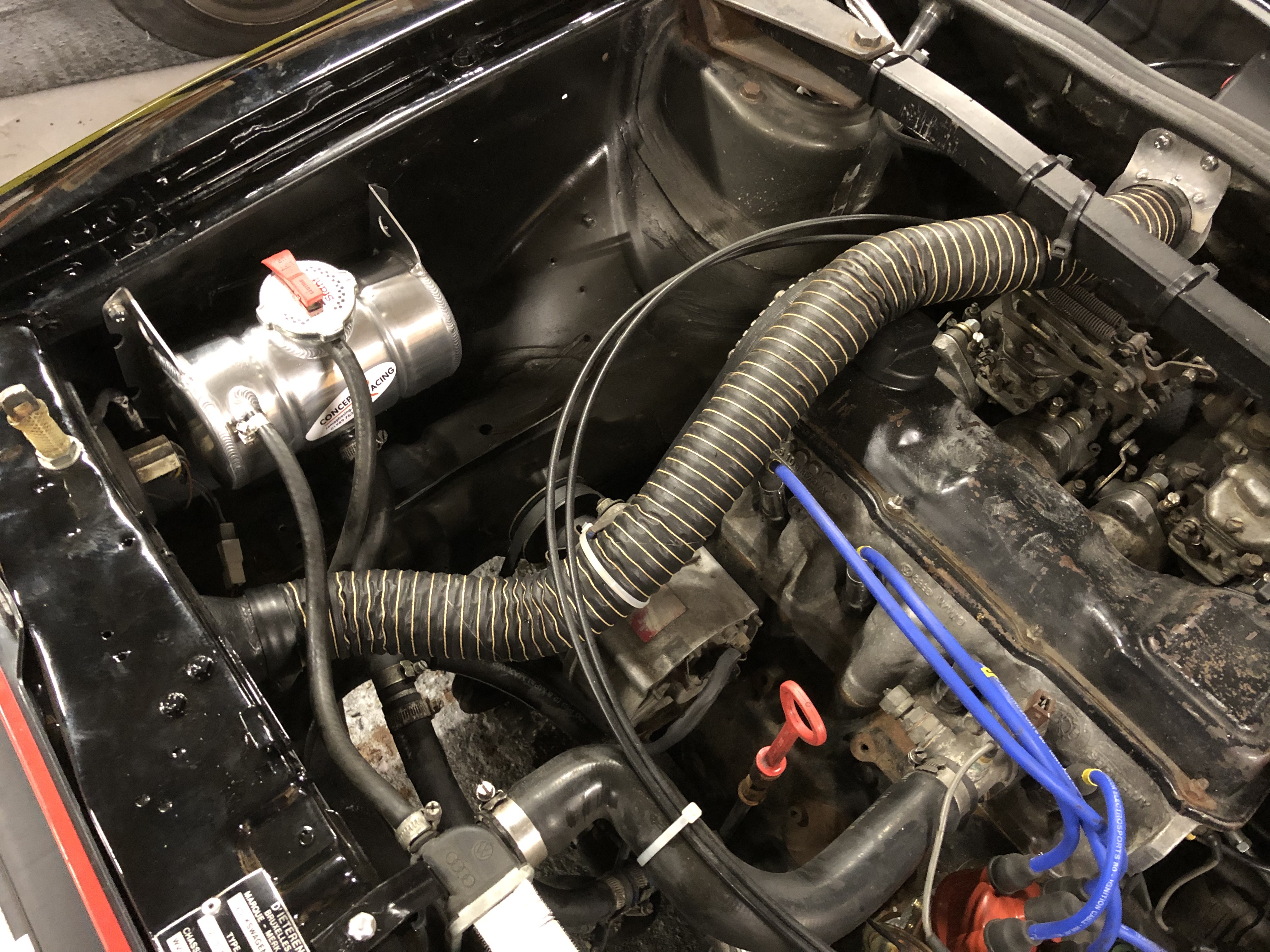

My header tank fouls my brake master cylinders as follows:
I took the opportunity today of replacing it with a nice alloy Concept Racing one:
Re: Escort Hunter Killer
That header tank Simon, looks a bit low?
For it to work it needs to be higher than the rad and more importantly, the head so that air comes to the tank and not sit in the parts you don't want air..

Posts: 976
Post by Marlow Sud »
It’s a fair point Kev.
I will check it out to ensure it is higher than the top of the rad and the cylinder head cooling passages.
Last thing you want is an air lock in the head mate!

Posts: 976
The header tank is now high enough Kev.
