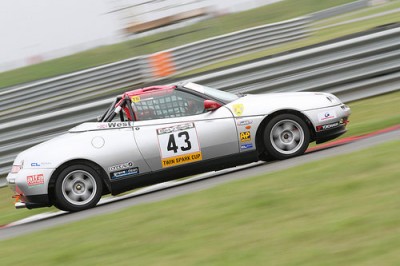

Hi guys. Heres the other car I'm currently building for the track. Almost finished on the suspension and brakes .cage next recommendations welcome . Sadly Mods are very limited in the TS cup . Question is it possible to remover at least permanently bypass the code key system (yellow box) ?.

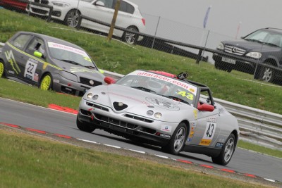

]Finally got the spider finished and track ready . Went to Snetterton a couple of weeks ago . Initial impressions are good its got decent pace. I had a problem with it constantly jumping out of gear as a result i had to race the whole weekend steering one handed and holding it in gear with my left hand. As such we treated the event as a test session .
Considering I'd never even driven the car in the road and had no idea if it had any problems im happy with the way it went. Anyway I've got the gearbox out now to replace the clutch and Found the problem . The linkage pivot thats mounted on the Rack had seized solid and the rubber bush was acting like a spring and pulling the lever out of gear. Thankfully it was A simple fix .
