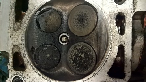

As a famous Scandinavian once said "Itsa broke!"
Completed stage 1on 3 cylinders having caught the car in front.
On inspection found a melted electrode on no.3 plug with some ceramic missing.
Got no compression on that cylinder either.
End of play.
To be continued.
Re: Alfa 33 1400 16V Rallycar
Ouch adie
bugger :(
Posts: 774
Engine isnowout and 1,3 cylinder head off.
Weird.
One exhAust valve has got its "ears " missing. Hopefully pic to follow.
It's been suggested that problem has been caused by preignition?
Car has been running fine all other valves in that head look fine.
Both pistons look fine. Got a good spark out of all leads. Plug was melted on the electrode.
Fuelwas same as normal Tesco 99.
Could an injector be failing? But if it is why only one valve affected.
Answers on a postcard or on here if it's easier.
We need to figure it out to ensure i dontbugger it up properly next time
Clock is ticking to get to Rockingham :cry:
Here's the pic Ade sent me.
Does look like a detonation/weak mixture issue but then I'm no expert. Do you have any spare injectors mate to swap as a belt and braces job? I have some too should you need...
Thanks for posing pic Kev.
Took the head to the guy who does my machining yesterday and he said he thought it looked more like pre-ignition than detonation. Apparently they look different??? His oppo who is the Don from Aldon will be in today and we will see what his thoughts are.
if I am stuck for anything I will give you all a shout.
if there were any bits then we assume they went out the exhaust because both the bore and piston look fine.
The investigation continues....
Be thankful that the bits went down the pipe mate, I once had the Astra drop onto 3 cylinders around North Somercotes on a Rally and being stubburn not wanting to drop too much time I continued to the stage end hoping it'd be a duff plug or something simple.
Turned out to be a head off the inlet valve snapped off then the piston shoved it into the head face :(
Posts: 774
I think we have been lucky you are right Kev.
Still trying to figure what's fai!ed first. Has the spark plug broke and jammed the valve open a bit of is it a problem with fuelling overheating valve and plug.
Weird how it's just one valve and the plug that's gone.

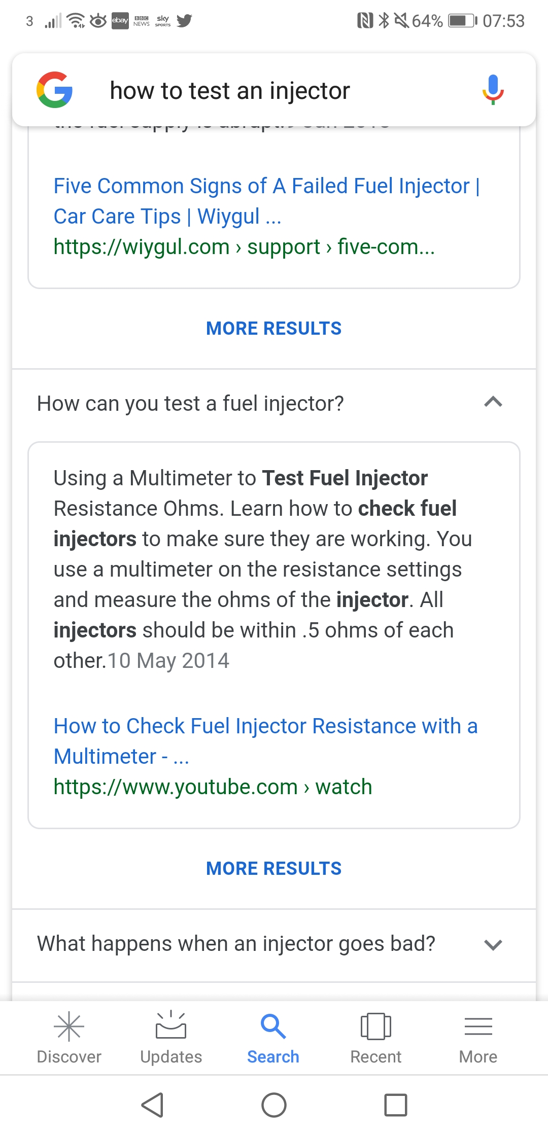

Morning this maybe of some help to you adie ?
Posts: 774
Thanks johnboy that'll be useful.

Mystery deepens. Injectors have all checked out as ok :roll:
