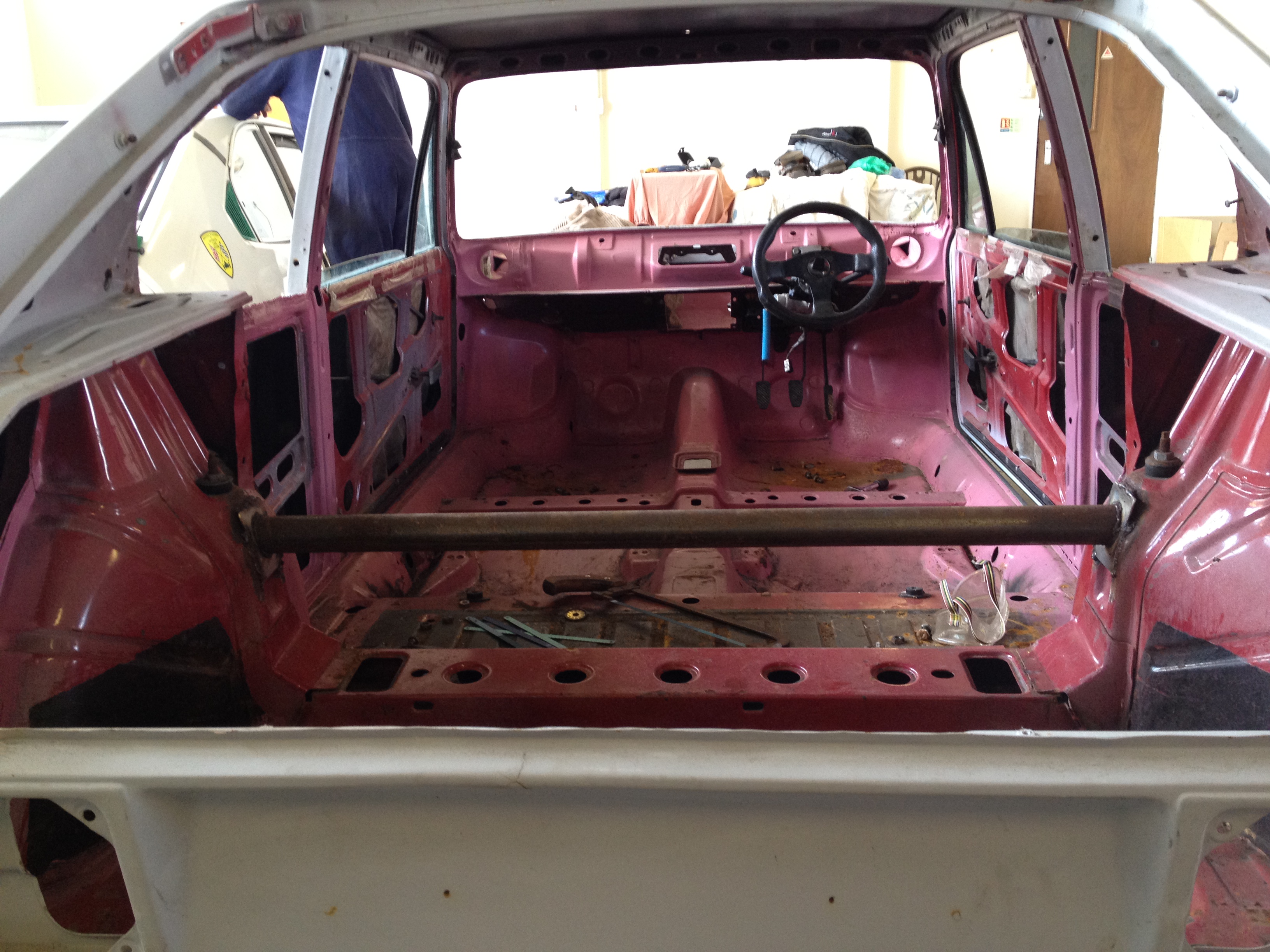

Nothing like that is easy, but it should be possible. The body panels are uniform both sides, cut out needed for the pedal box and servo but the shape is there ready in the metal.
Weld the other side and move the battery.
Wiring loom might be the hardest part to to re-route.
Look at thes pics and you can see that the bare shell is uniform left to right.

Ok, so looks like a pro job. Good that it's possible though, I really do not want to part with it. Who would you send it to for the conversion?
