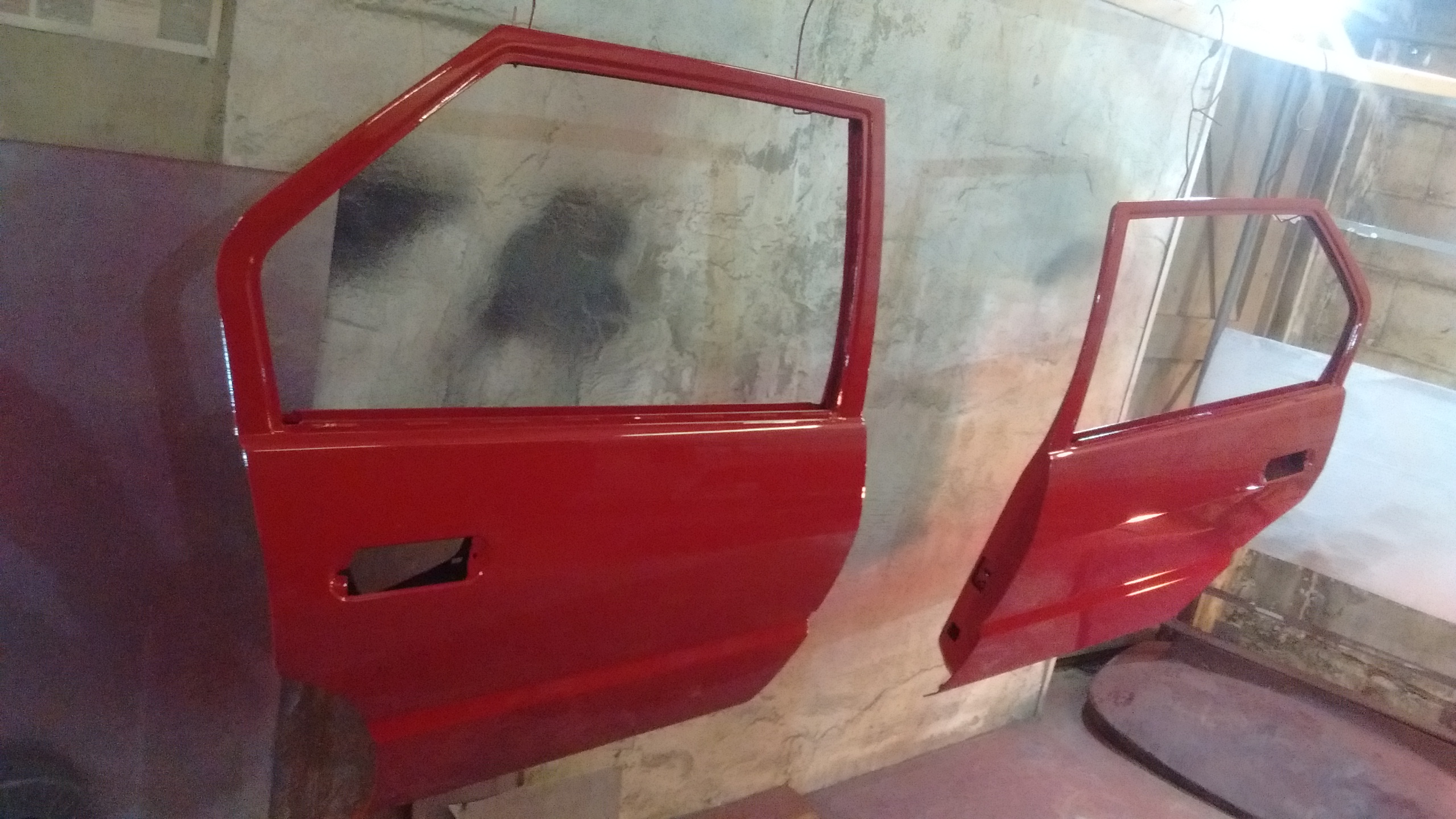

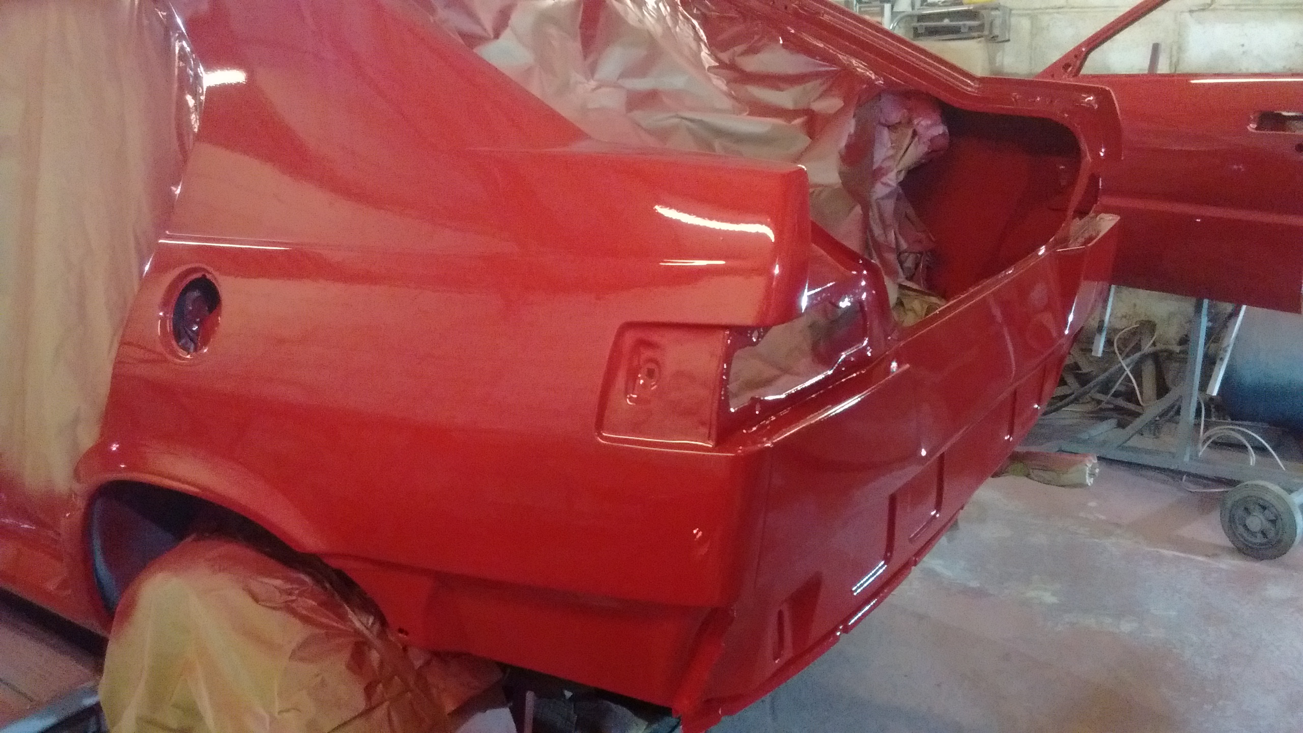

another long day but well worth it.
started off early doors and sanded off the rest of repaired roof section plus a few bits like the door shuts, Pauls' help was a great bonus.
then we had some tidying to do! what a mess :)
car re-masked, de-greased and wiped down then everything repositioned just so, hardly an inch to spare in the unit

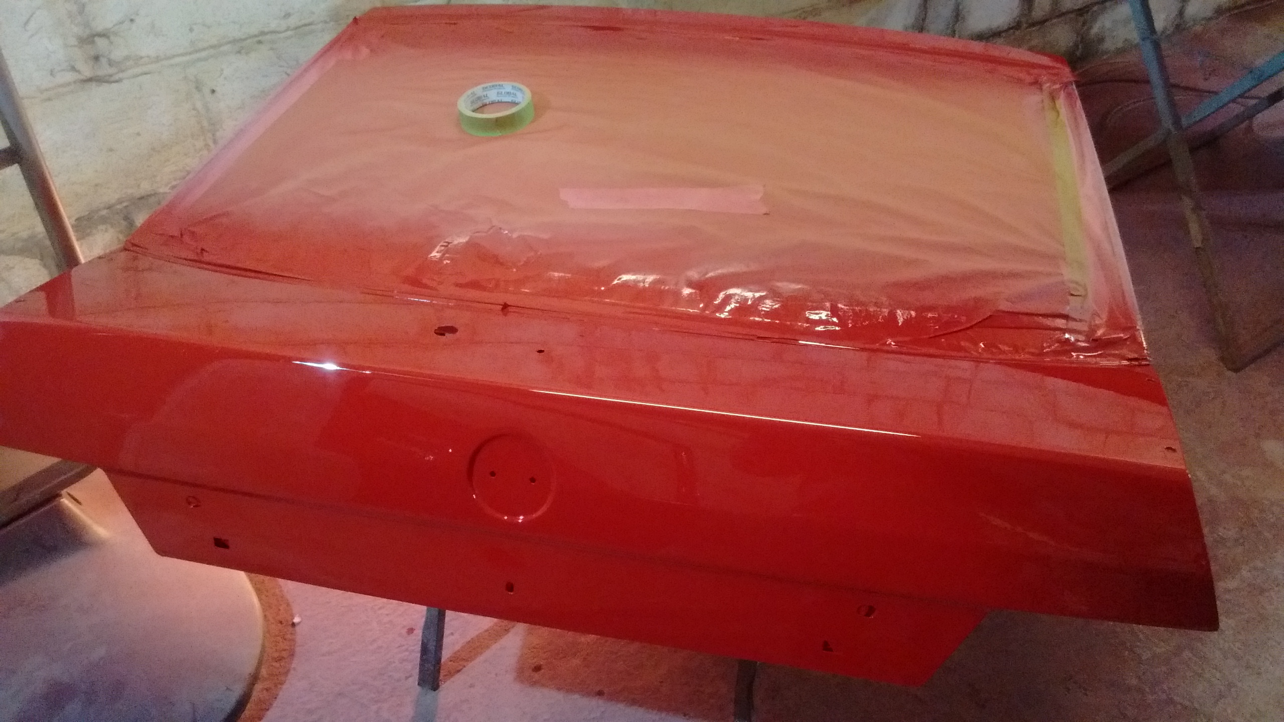

rear hatch was a bit tricky as the underside has far more bare metal on show than I'd thought so with the inner window frame painted we flipped it over so I could paint the outside, couldn't have done that on my own, an extra pair of hands today made all the difference
anyway, this is the finished result....

Must be a rebranded etch ?
The car looks great . Nice finish chap 8-) what gun is your weapon of choice. I'm a devilbiss man, gti and Sri pro for small jobs . The 33 is going to look great when it's finished :D

The car looks great mate. How do you extract the over spray as it looks clean .

the unit was previously used by a shot blast guy who installed a ruddy great extractor fan and handily left it there :) in my little unit it sucks the air out pretty well, do have to plan where & when I make the order to spray though but clears the air within a few mins

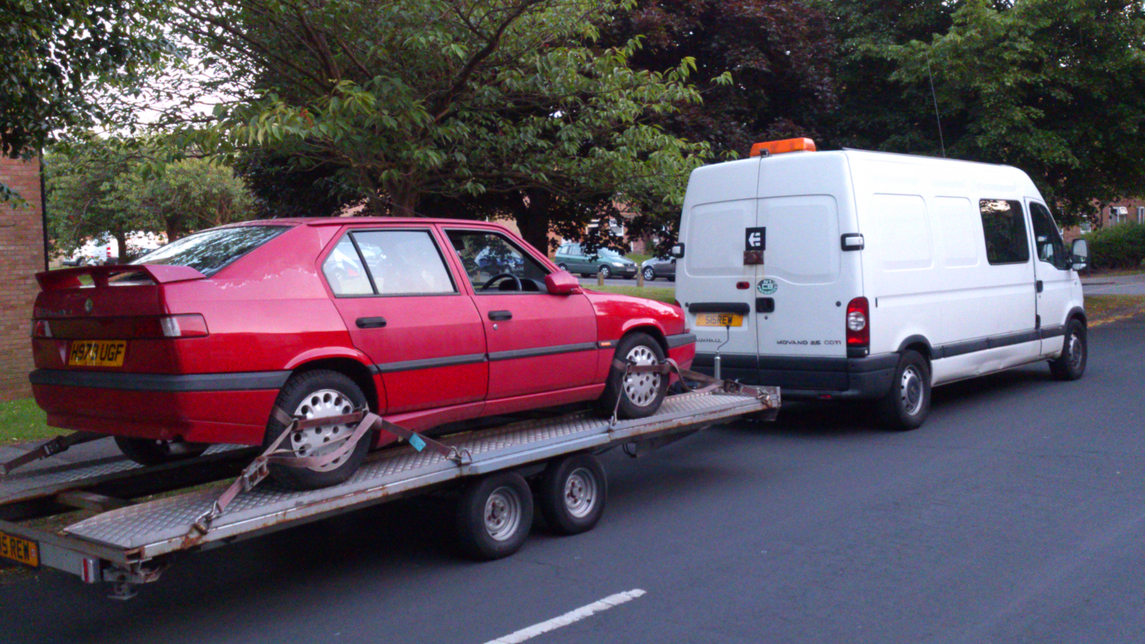

and now would look a great time to reflect on its humble beginnings too,
its come a long way Paul since i unearthed your car from a lengthy garage sleep!
Re: And the side skirts are off...
yes, rosso 130
it is the same as VJM was
amazing difference between now and then mate, poor old girl has had some work since that picture, but she's well worth it. a more solid 33 would be hard to find

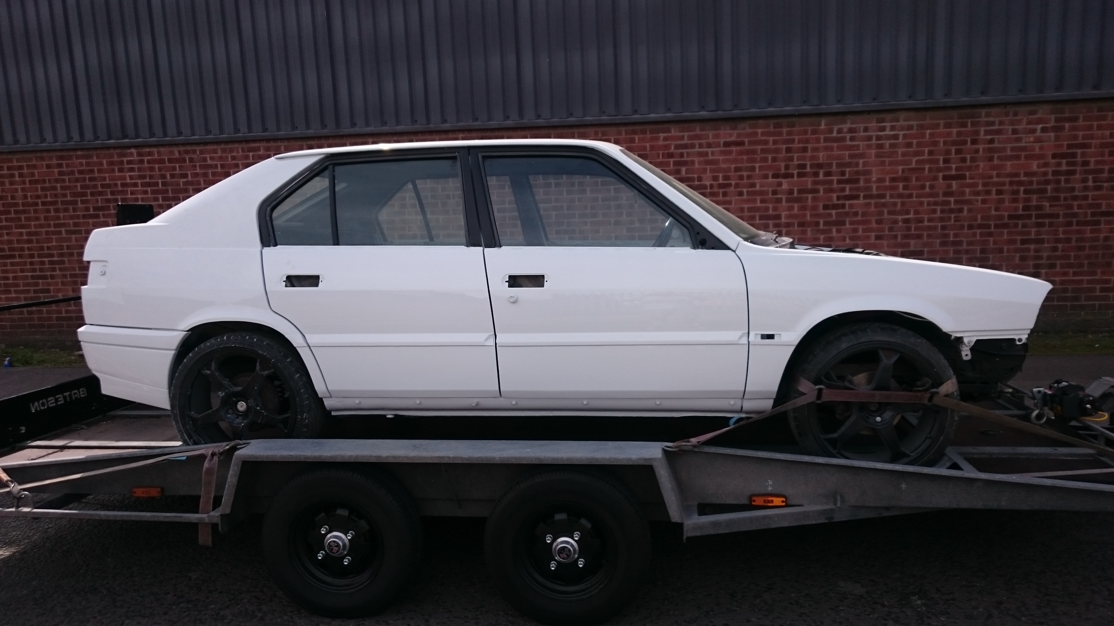

Is that the white one that was on that face book link?
There seems to be a bit of a resurgence of the humble 33 at the moment with a few popping up here and there and guys here with the odd project too.

The white p4 on Facebook belongs to guy called luke, not a million miles from me in notts. Its cheap but its also swiss cheese, so I'm in no rush for another project that needs 13yards of steel!
Thankfully, the p4 coming back to me is the one i put 13yards of steel in some years ago! :P
