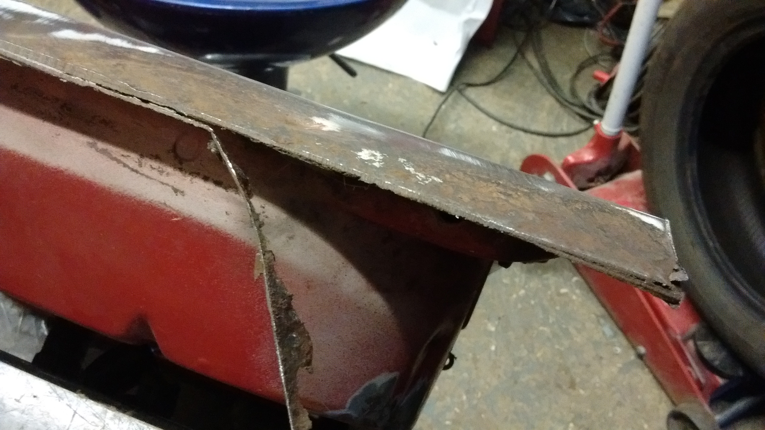

first job is to make a template of the curvature of the part to be repaired, so accuracy of the repair can be checked.
I used a piece of scrap plywood
the flange is obviously well gone but the folded edge on the other side appeared ok, but what could be hiding under there? only way to find out is to fold it open
although the surface had corrosion it was solid underneath the staining, more than good enough to last another 20 years.
a coat of zinc etch primer and the edge got folded down again
checking alignment using the template made earlier
as this edge is declared fit for purpose it meant that the repair section wouldn't need to go all the way across, indeed the wing mounting bolt hole could be kept

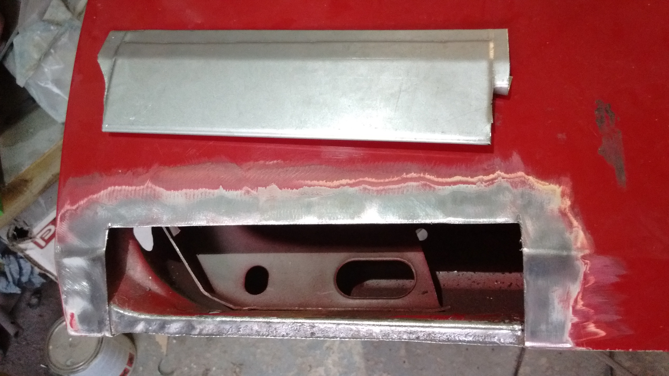

made up a repair section for the bottom of the wing, folded the flange over in my shrinker/stretcher which seems to work well, decent control over curvature
was gonna weld it in where my integrale is but the welder gas was playing me up...for the last time. never again will I buy a disposable bottle
mig welded it all in (still gotta practice a bit with the tig before trusting it) then ground the excess weld off
underside joggled edge
cleaned up and etch primed so it'll stay fresh and not start to rust already!

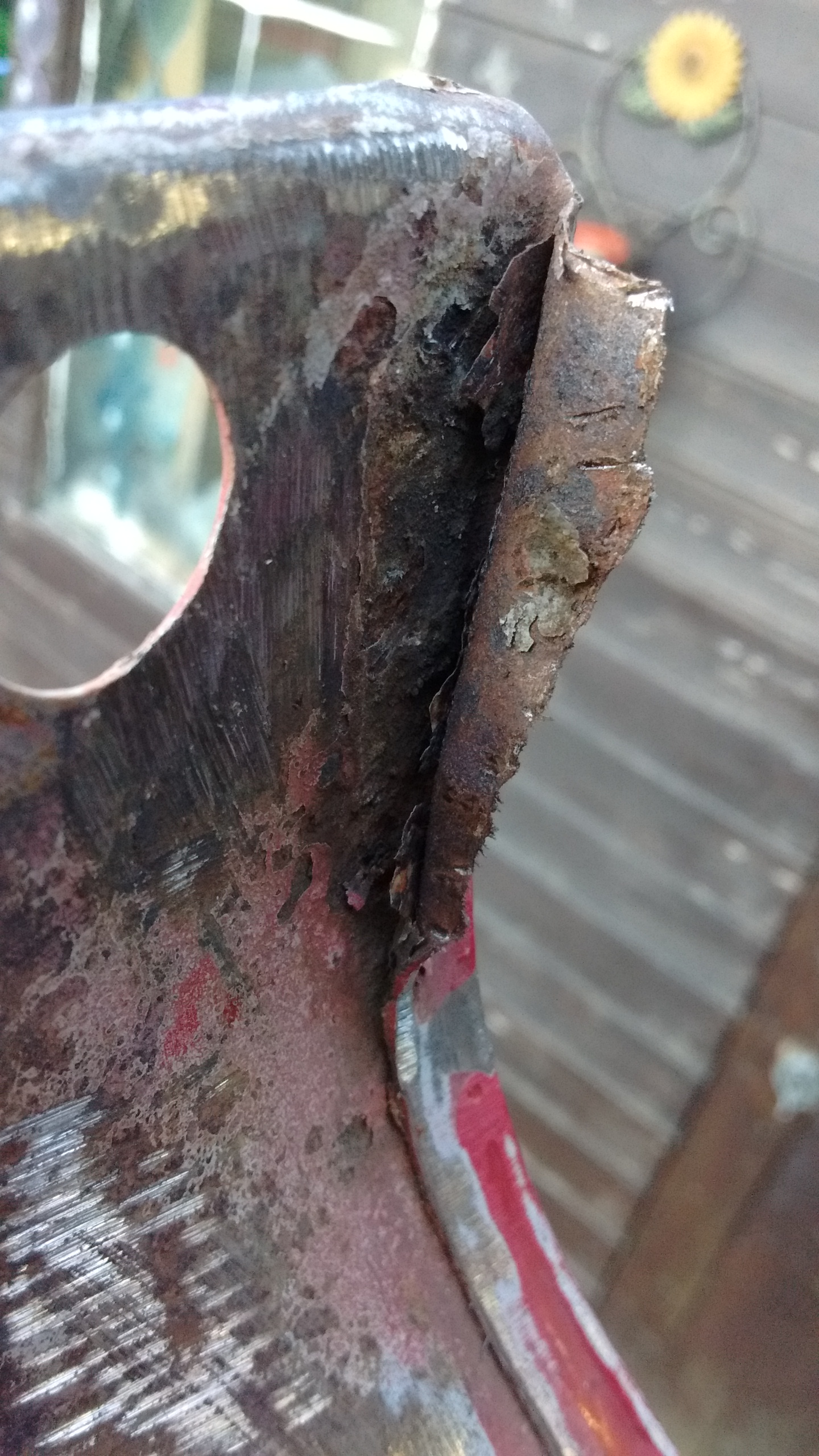

had to move the 2 doors in the shed tonight to find the 'grale radiator for the cross-member alignment
whilst I had moved them and having a half hour to spare I thought i'd have a look at one
the rear door has a smallish section of corrosion at the bottom of the front edge. no holes in it but not worth saving
method for peeling off the skin is to grind down the edge with a flap wheel on the grinder so it peels the skin off the central frame
central lip turns out to be in decent shape with a grind back
outer face likewise
I've given it a coat of weld through zinc rich primer so protect it until I get some time to make a repair piece but this ones pretty straight forward.
at least I've made a start.....

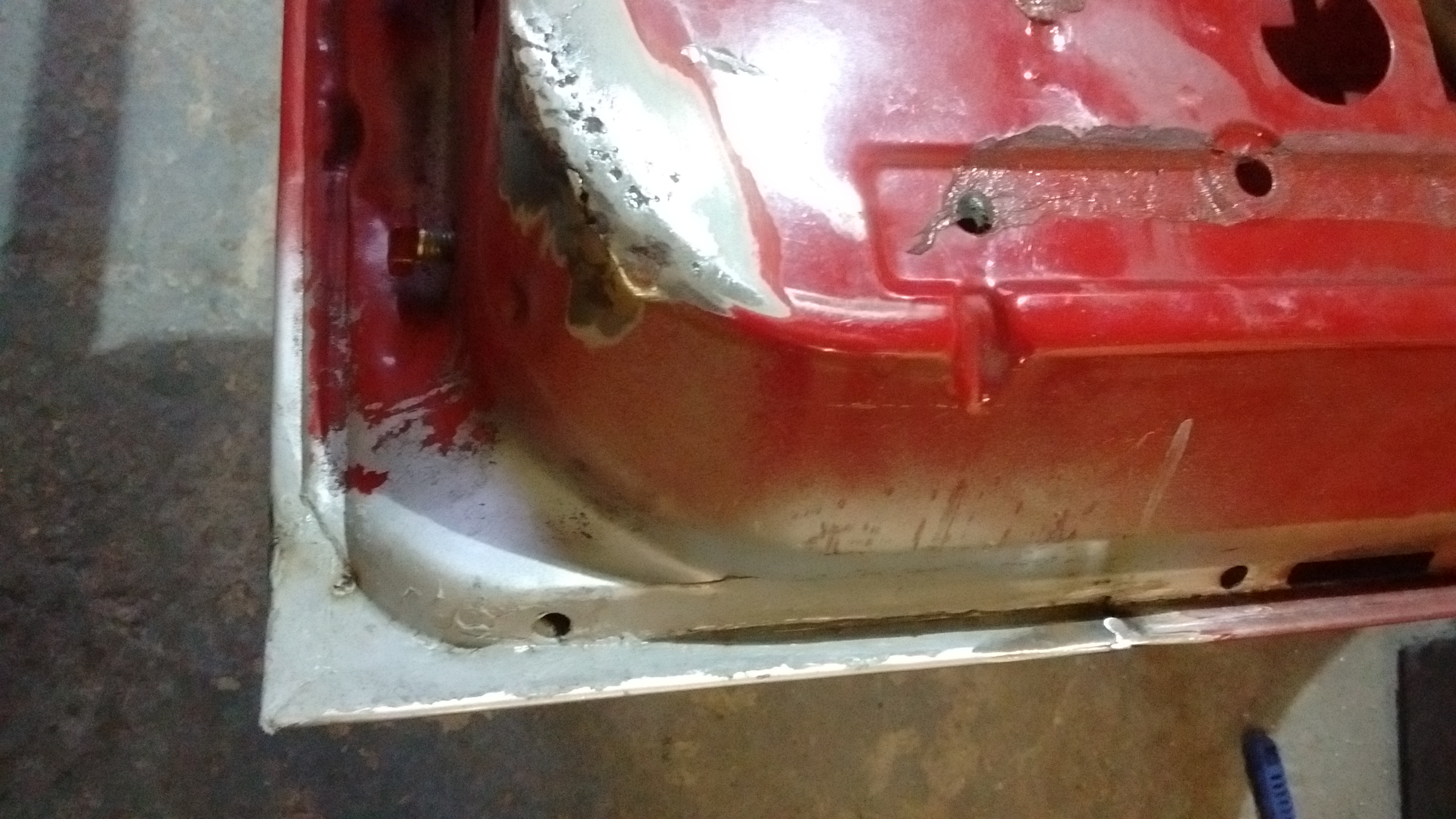

had a week off with family hols down to Cornwall, all very relaxing and that, but doesn't get any work done....know Paul needs the doors done sooner rather than later and I've had them for a while now so with enough sitting around doing nothing I set about finishing off the rear one..
the first task was to make up a repair patch for the hole at the door bottom that I cut out a while back, usual process that I follow, folded edges to create the edges plus a joggled edge to feed under the original door skin.
a layer of seam sealer was added to form a bond to the inner fold plus it will stop moisture falling down into the gap once the work is done, more product will be added but helps to get ahead of the game
takes an age to weld in, small tacks to avoid distortion
underside turned out ok to pretty well match the original lines..

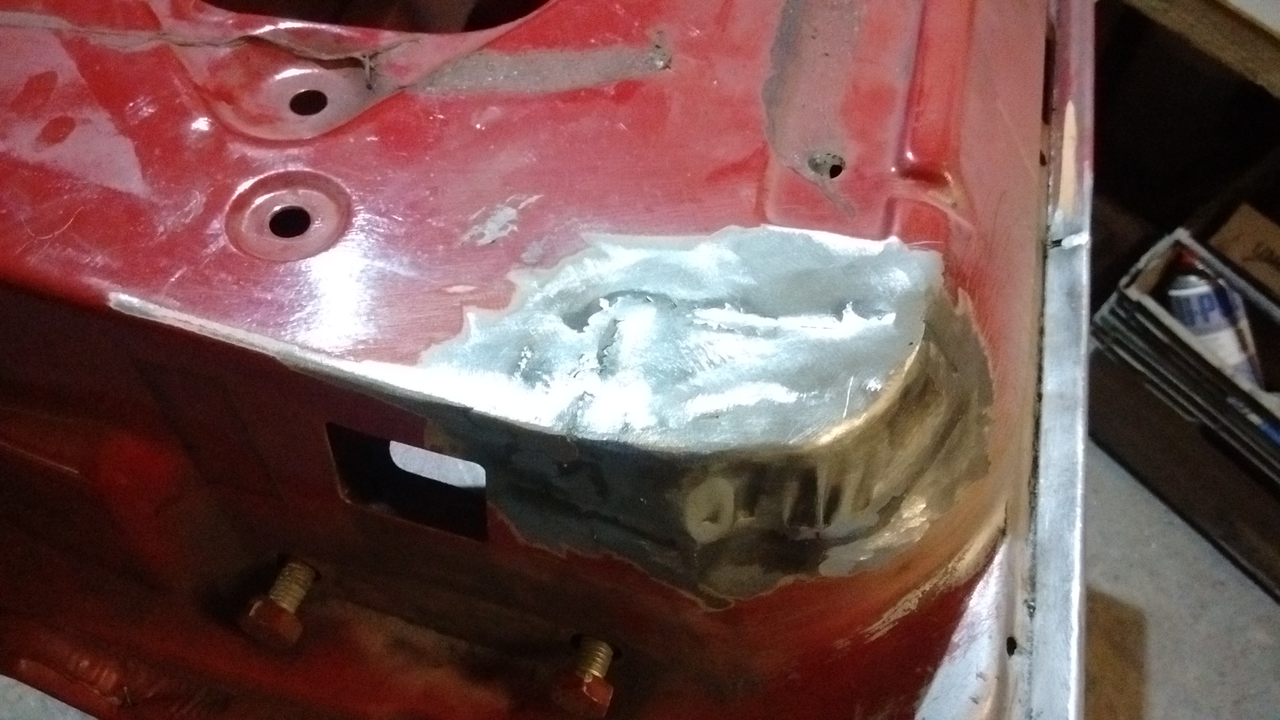

the other piece that needed repairing on this door was where the front corner of the door card would go, pitted but not really holed, but why not just cut it out....
so a patch was made up to fit and hole cut to suit, complete with the little dimple, don't know if it needs it but it's got it back
once ground down it's blended in decently enough

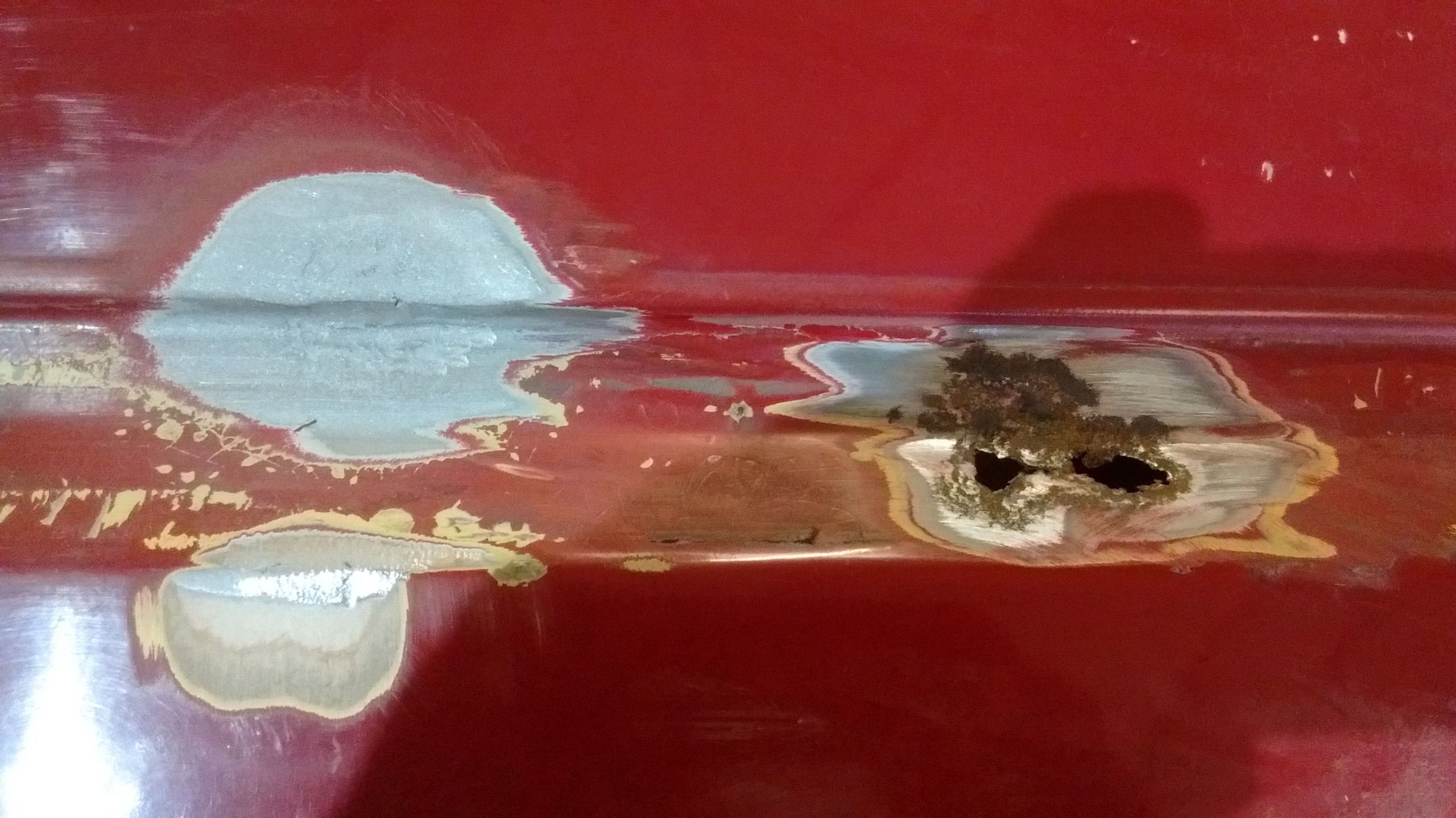

2 other sections needed repairs on the moulding recess section
first one turned out ok once sanded and blasted, just a small hole which was simply welded up and ground back
Re: And the side skirts are off...
the one next to it though was too big to simply weld up!
so a suitable plate was made up to fit from behind without encroaching onto the outer skin surface itself
all welded in and ground back
coat or two of zinc rich primer will protect it all until the proper prep is done

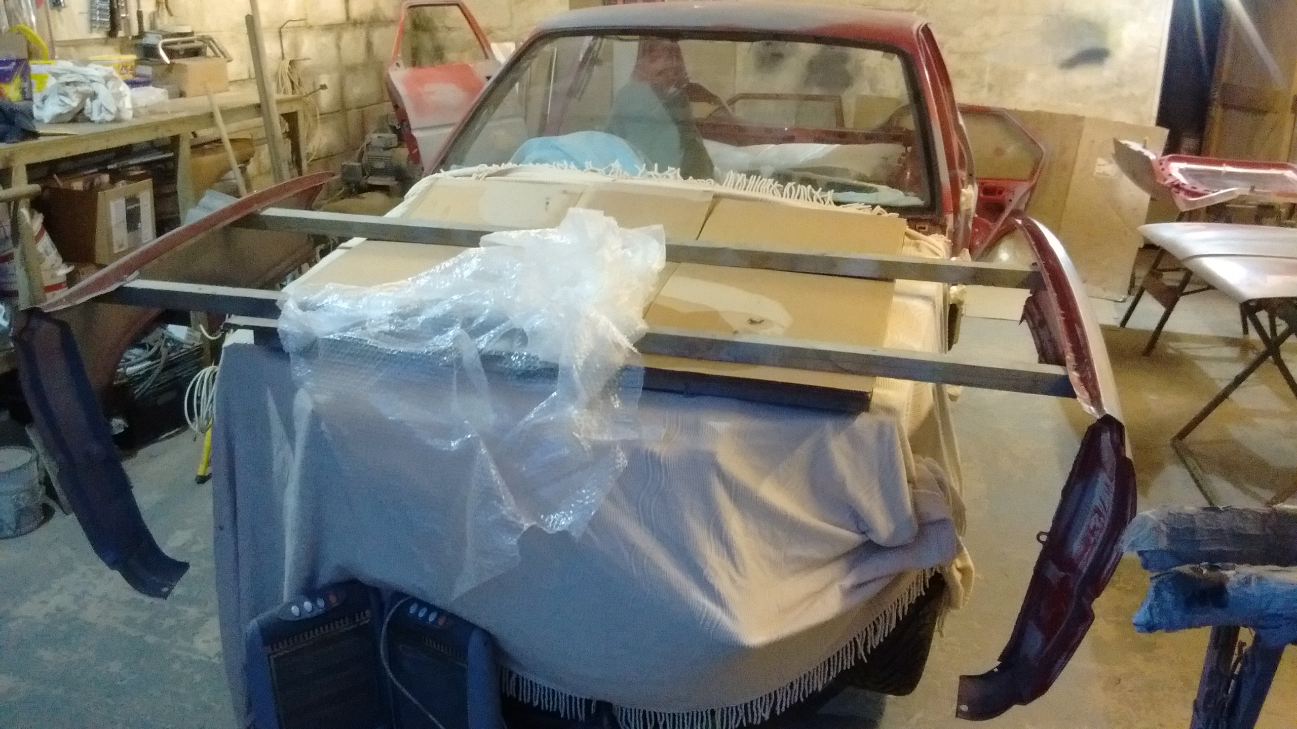

although it hasn't been updated since august last year!! there has been progress for paul and the 33.
he's been busy stripping it all down and sorting all the knocks and scrapes out to such good effect that it was ready to come up to the workshop today in preparation for some fresh paint to go on next week...
it will be a proper job in as far as door shuts etc will be done so means everything needs to come off, which rapidly filled up my little shop!
have since has a rethink on where stuff will go so with a little re-positing of the car I should be able to get the rear doors in position for painting too
as most of you know there is also a huge amount of plastic and rubber items that need painting like the bumpers, side skirts and rear spoiler let alone some smaller items, these i'll do after the metal parts as space is an issue plus there will be plastic additives in the paint & primer to keep it flexible for them
paul and his dad have done a great job on the car, mine will be the easier task of priming and painting it all. the glory leg!
the car is remarkably solid for a 25 year old, let alone an Alfa! still on original sills with not a hint of problems, pillars etc in exceptional condition, even the lower rear panel is complete!
I've devised a plan for hanging the wings which will allow the innards to be painted plus the A pillar without skimping on coverage
hanging them on backwards will let me get easy access to the rear edge where it tucks behind the door plus still be able to paint the pillar itself
i'll have a rejig on Saturday which if I've thought about it right on the way home should allow space for the rear doors to hang in a paintable position also....

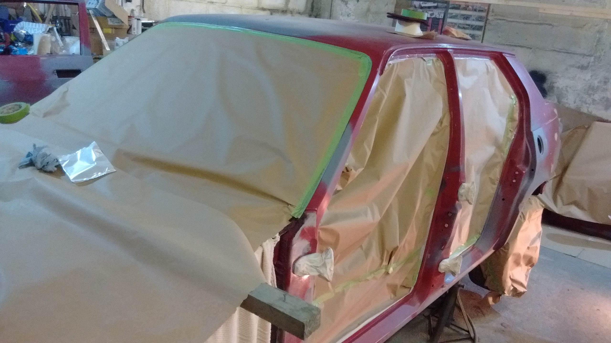

made a start this afternoon, shell pretty much masked up ready, bonnet and hatch undersides ready for etch which I've now done, a few other bits and bobs but tomorrow i'll get some primer all over it

a longer day than i'd planned, as these things always seem to end up being.
first job was to stoneguard the underside of the front wings so it had chance to harden off for later on
every surface had a going over with a 320 grit paper or scotch pad as needed, then of course it all needed de-greasing with panel wipe & tack rags....that took care of a good few hours!
eventually though it was ready for some etch primer, which is just a thin primer designed to aid adhesion so is pretty see through
the long process of the filler primer produces a nice thick layer that can be flatted back to fill in any nasties
which then got a guide coat of matt black
as I've this week off work i'll be down there tomorrow to carry on with things...

first job this morning was to start flatting off the primer, starting with the roof which had some previous dents. they looked ok but once block sanded the shallow dents became clear, still some work to do
could have tried more filler primer and sanding which eventually would have filled them in but a thin skim of filler sounded more sensible and sure to work
reapplied the etch and then a good few coats of filler primer so i'll have something to sand back
then spent the next never ending hours of sanding the rest back without any further real issue
although sara cox and her 80's danceathon kept me going I gave up the battle after 8pm, quite dusty too it seemed!
tomorrow with some help from paul we should be able to do the final sanding, clean everything down then re-mask it all before getting to put some red on....
