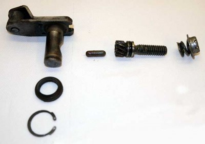

Hi Alfasam - sorry to resurrect this thread if you already know the answer, but I have recently acquired 3 pairs of ATE front calipers as back-up for my as-yet unresolved Budweg caliper leak problem. Anyway, I've successfully dismantled one caliper and can confirm that the parts as laid out in the pictures are in the order they go together.Alfasam wrote:Has anyone on the forum successfully dismantled and reassembled the handbrake mechanism on one of these calipers? If so, might you be able to point me in the right direction?
Please note - the locating pins you refer to are two roll pins inserted into the inner caliper body below the piston. They stop the brake pad from dropping out of the bottom. I noticed in the image that the pins were not present. The holes for them should be in the casting, hopefully they haven't been snapped off. That is all that is missing, so do not, repeat, do not scrap them!!!
What I did was this:
1. Split the caliper by removing the 4 bolts holding the two halves together
2. Use the 7mm hex adjuster to wind the piston out as far as it will go (the adjuster rotates via a worm the threaded shaft which screws into the back of the piston)
3. Assist the final removal of the piston with Mole grips - the close fit and seals mean the piston won't drop out of its own accord
4. Remove the circlip at the base of the threaded adjuster shaft. This allows the "top hat" cover and spring to be removed
5. Pop the shaft out of the bore. It has fluid seals to stop the grease from the handbrake mechanism migrating into the brake fluid chamber.
6. The steel pin that looks like a Tic Tac transfers the rotation of the handbrake shaft into the linear motion of the threaded shaft, with the worm drive taking up the clearance. The Tic Tac shaft engages into a cup recess in the handbrake shaft
7. Remove the circlip at the base of the handbrake shaft and withdraw from the caliper body. There are a number of seals to stop the grease getting out, as shown in the pictures.
That's the inner caliper. The outer one is even easier to dismantle...
1. Remove the circlip on the Allen key adjuster if fitted (it should be, otherwise you cannot retract the piston with the adjuster)
2. Use the Allen key adjuster to wind the piston out as far as it will go.
3. Using suitable packing, I put the caliper in a vice so that the adjuster pushes the piston out of the caliper body (you could use Mole grips again if you like). You are only overcoming the resistance of the piston seals so it should require little persuasion to get it out.
Reassembly, as all the best texts say, is the reverse of removal.
I hope this helps a bit. I haven't figured out how to remove the inboard hex adjuster, and it looks like these items weren't removed from your calipers either, so maybe they don't need to come out. There are no clips holding them in, they look like they might pop out...
But it's those pad locating roll pins on the outside of your calipers that are missing, nothing else.

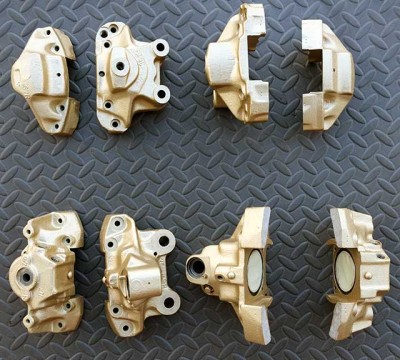

Out of interest, the gold finish on Alfasam's calipers look very nice, are they electroplated or painted? I might consider getting one pair electroplated as long as I can have them in gold!
