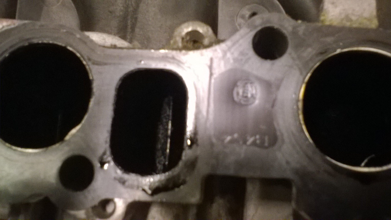

I how know what caused the problem the engine in the GT 2007 the swirl flaps are held on with 2 spot welds on cylinder 4 we have no flap which has done the damage to engine and turbo

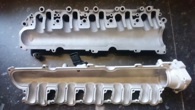

I can vouch for the benefits of inlet manifold attention.

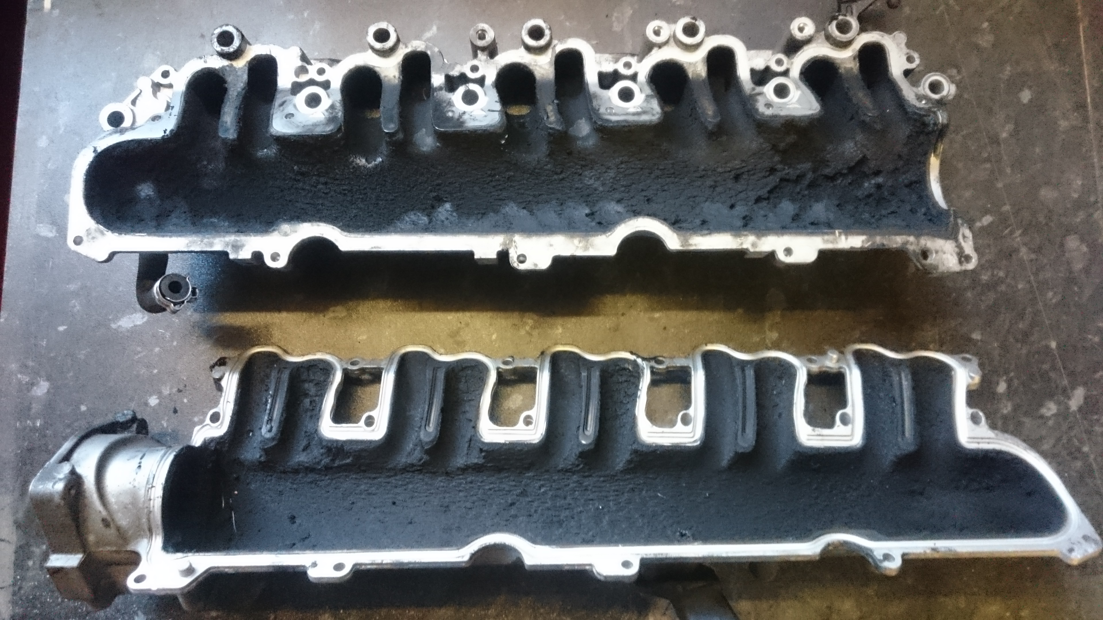

My eldests, Josh, 159 2.4 20v JTD has had some issues, all of them down to the emission control devices, and his inlet manifold was disgusting, largely down to the EGR of course :x
it might not look too bad, and i've seen worse, but just what i scraped out came up to 500ml in a measuring jug i collected it in, and then i used mr muscle oven cleaner to remove 90% of the rest.
finally, i media blasted the rest off and smooth sanded the internal surfaces, and its now better than new.

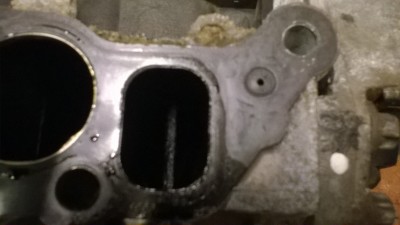

i was tempted to weld up the swirl flap and egr holes and eliminate them altoghter, but the jurys still out on that direction for the time being as the car is soon for sale.

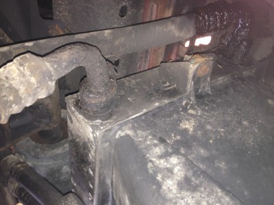

However, my next job on the GT is replacing the Oil cooler as I spotted some drips and looking underneath showed what looks like a corrosion induced hole somewhere. I have ordered the AutoLusso replacement kit - at £280, about half the price of genuine parts - so that will be my job for Easter weekend!
Leaking GT Oil Cooler (Upside down!)

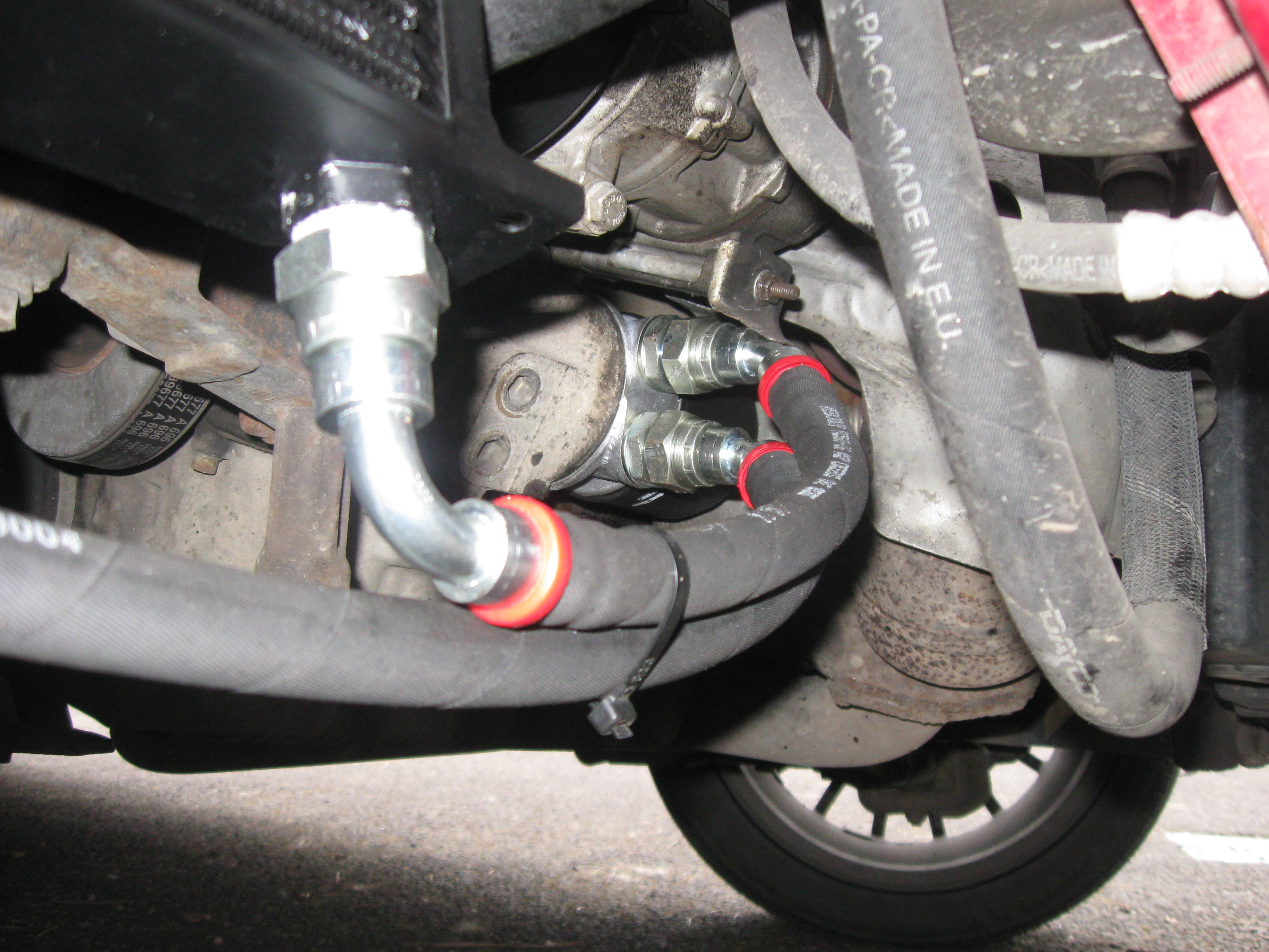

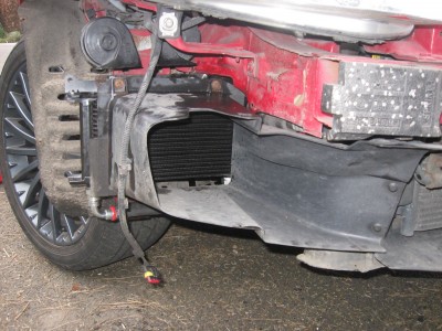

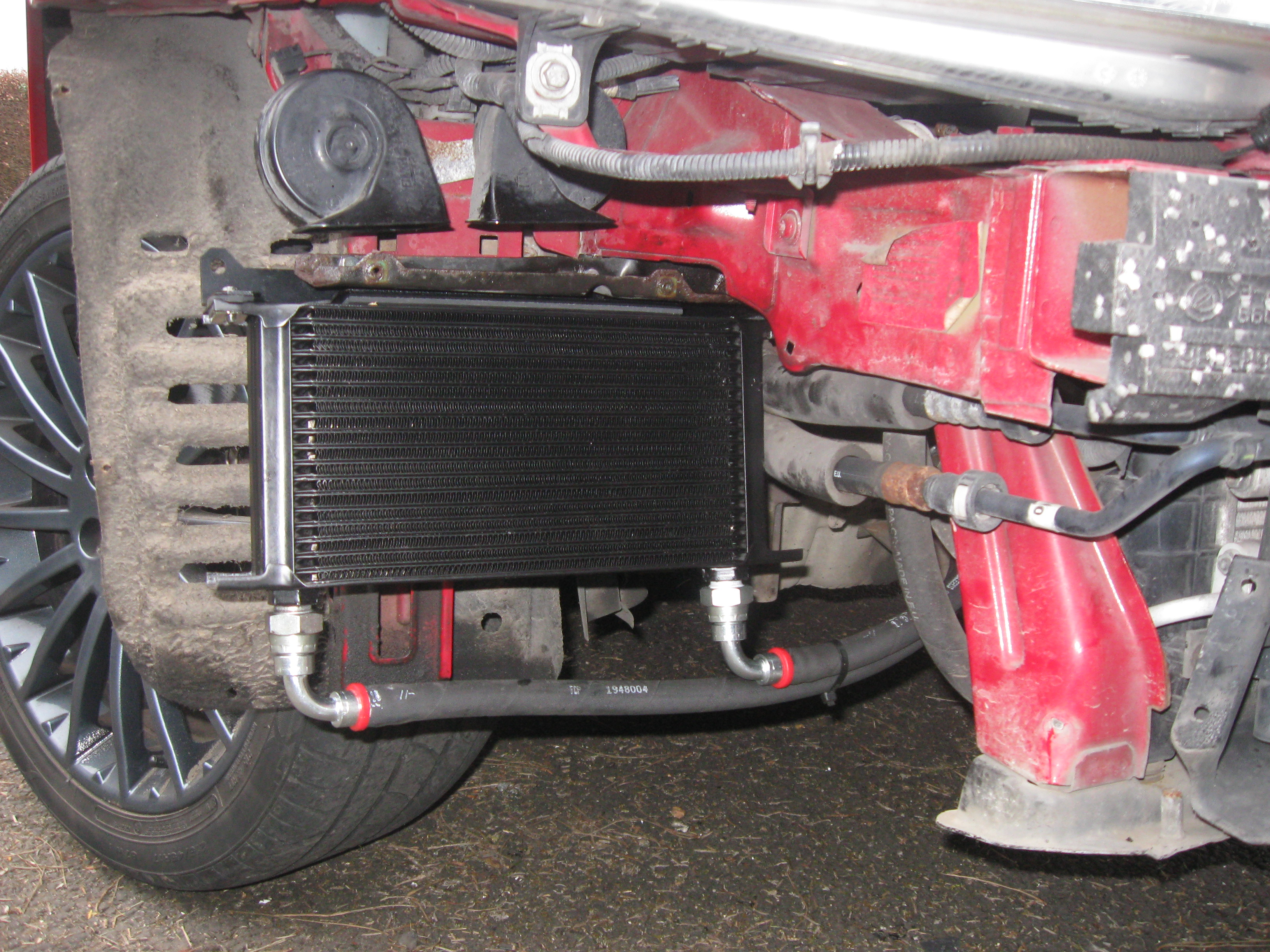

Spent the day working on the GT changing the rotten and leaking oil cooler. I went for the Autolusso kit as it was half the price of genuine parts. Some bits were a bit fiddly, notably the bracket which does not pick up on the mount holes of the original so needs some fettling to fit - overall reasonably straight forward though the guide on their site would benefit from some more detail - such as spanner sizes for the unions and oil filter housing as I found I did not have quite large enough spanners for some bits so had to get creative with Stilsons which was not ideal. Some pictures in case any of you consider doing it.
Cheers Ian

New cooler in place
New cooler in place
oil filter housing and new pipes

does look a decent kit, stainless hoses? the old ones always do look about to burst through rust!

All part of the Autolusso kit which all felt good quality. The AL guys were helpful by email with extra photos for some bits their website didn't show. This cooler is wider and shallower than the original so the pipes don't hang down as much as before. My GT seems to have lost its undertray at some point in its' past which makes access a bit easier, bit also means its exposed to more crud too potentially.
So far no signs of leaks so all good :-)
