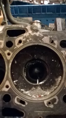

I started to strip the engine down to see what the problem was found the bottom for 3 glow plugs and injectors have melted............

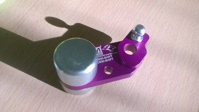

The snapped glow plugs and the mtech quickshift that I got in the post Tuesday
Plus the cleaned gearbox

Removed the cylinder head from the old engine to see the damage. Free'd off 2 of the seized injectors in the replacement engine but had to get the grinder to the 3rd one so I could remove cams then the cylinder head
Fitted the mtech quickshift
