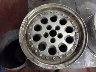

this is what many once beautiful fake split Speedlines look like today. through no or little fault of the owner, the finish and design of that particular wheel meant it ready to rot from the day it was made!
but all is not lost, trust me, even this nasty example can be turned around, and once again grace your Alfa smartly.
this is a quick thread on how i did it.

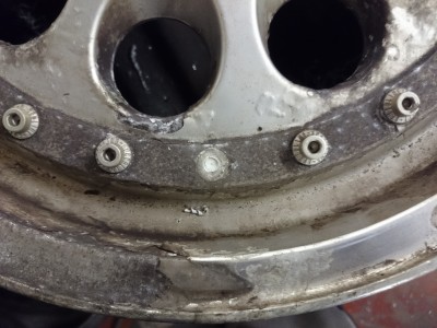

Before anything else, you're going to have to concede that the fake rivets have got to go, and being plastic, there's only one real way to do it, and that to drill them out.
i start with a 6mm or bigger hss drill bit, just in a battery drill, no need for massive speed or torque, and push down just enough that it bites through the first few mm of the head, cracking it away from the actual threaded bit, so that you are left with this.
this really doesn't take a lot of effort or push, just a steady hand, and a decent battery!

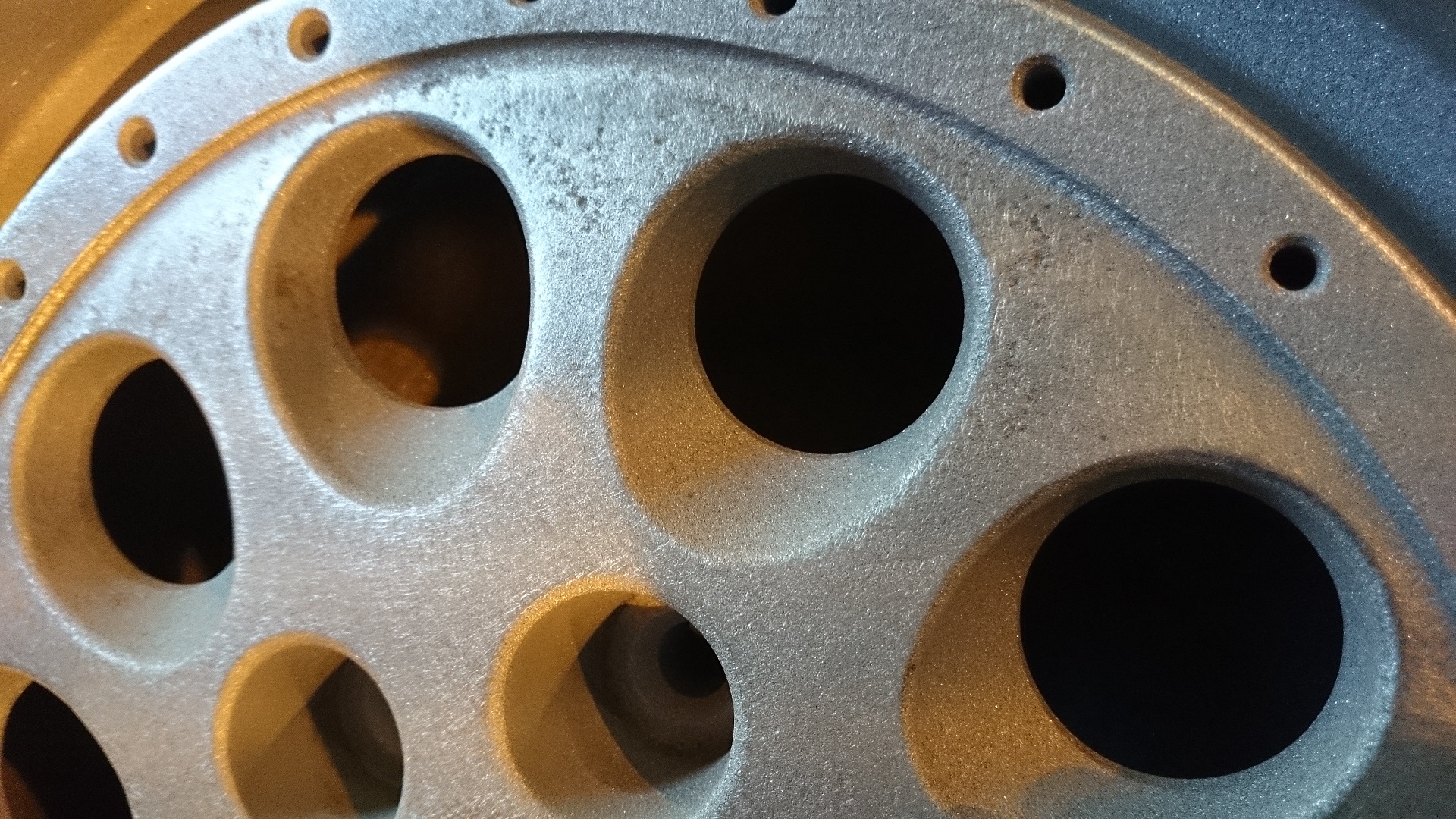

well, in my opinion, theres only one answer when the parts are corroded, and that is a shotblast.
a chemical strip will remove the paint, sure, or weeks of sanding too, but what they won't do, is open up the weak pockets of corrosion and erase the contaminated areas of future threat.
this has to happen, even at the risk of resulting in a less than glass like final finish, without eradicating the source of the corrosion, you won't have any finish at all!

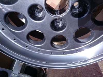

these weren't too bad, but still came out with occasional evidence of the corrosion in the form of this heavy pitting.
and heres the wheel, at the bad patch, shotblasted, and da/hand sanded with 40 grit abrasives, and blown of all dust and debris.
Now its into the oven, at between 180 and 190 degrees centigrade, for at least 10 minutes, probably more like 20, to try to cook out everything possible from those pits of corrosion.

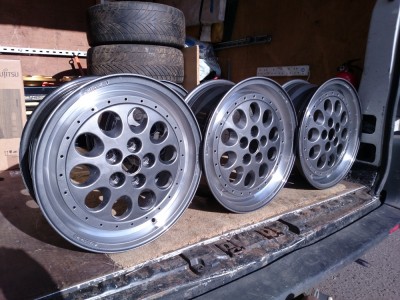

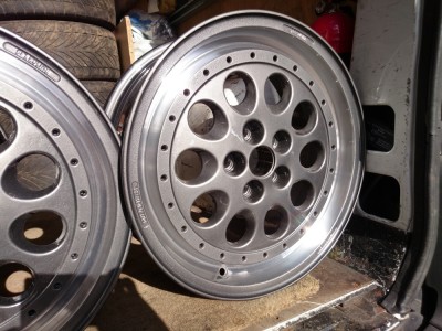

this is how the wheels look today.
Graphite Grey, with the U shape polished to mimic diamond cut, not mirror finish, instead of normally taking the polish to edge rim as usual.

yeah its very tough to get the Graphite Grey to show up properly in a photo.

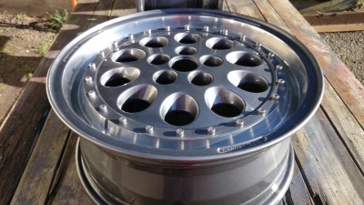

picked up the cap head allen bolts i'd sized and ordered in A2 stainless, 3/8ths long, UNC Coarse thread, and offered them up, they looked like they'll be great.
these are a good bit oversized for the hole, particularly as they are now thick with powder coat, but no bad thing, so i ran a blind thread tap into every hole to give them a start :cry:
the good thing is, they then went in a dream, and tightened up to a very respectable torque too, so even though they are decorative bolts only, at least they should be going anywhere in a hurry!
so here they are, all done, and although not really as Speedline did them, i'm thinking they look better, way better, and on a rosso red 75 V6 Veloce, they're going to look awesome!
